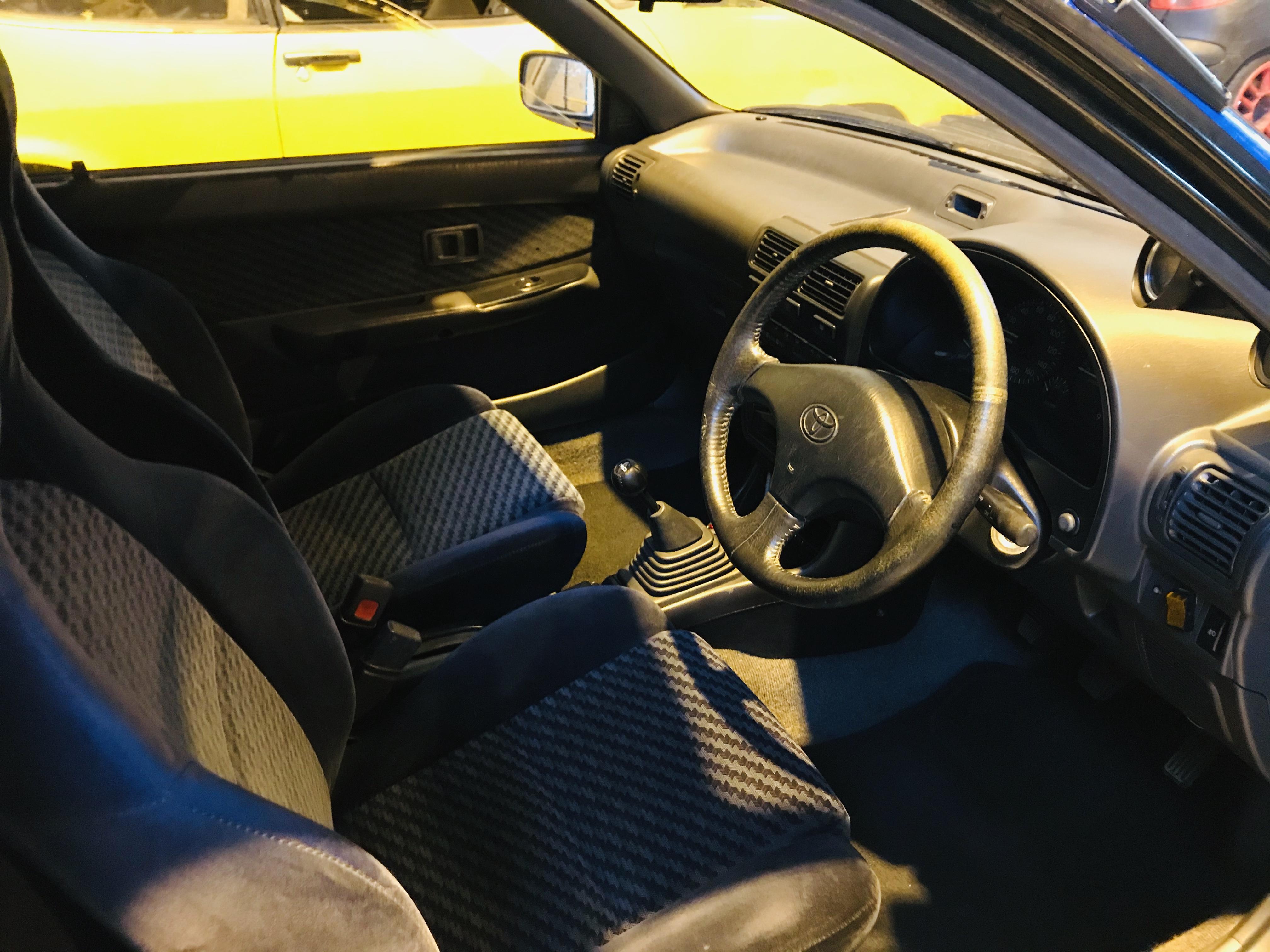

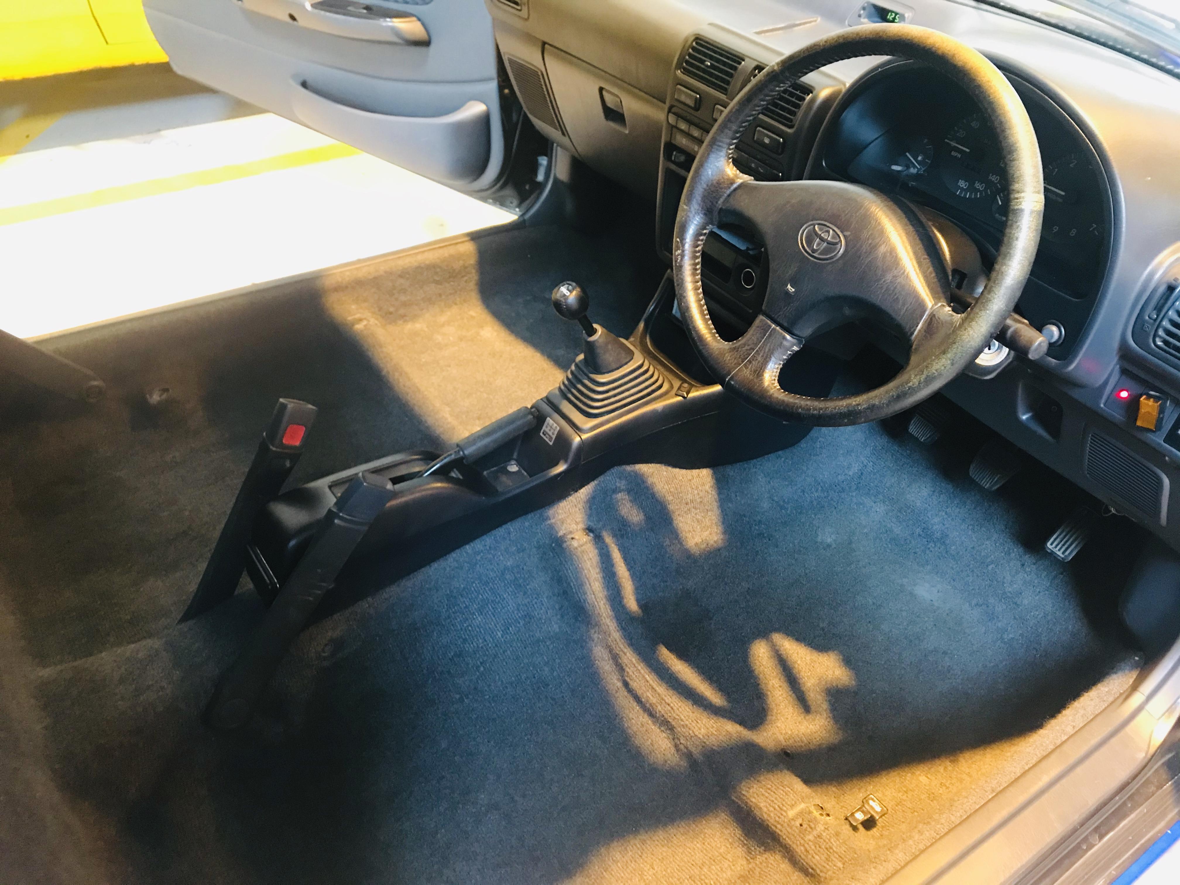

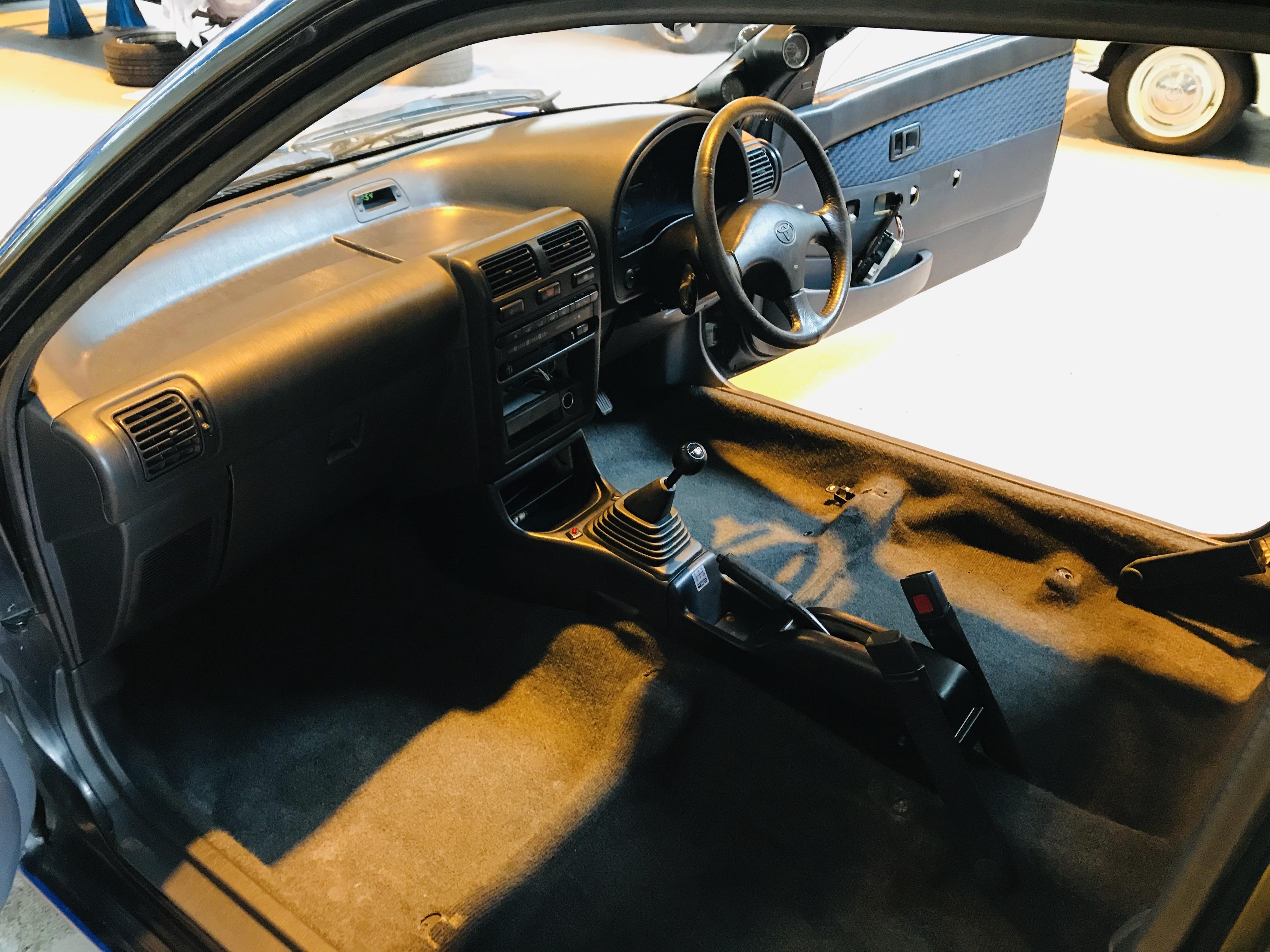

Pikey009 Posted July 28, 2020 Author Posted July 28, 2020 Gave the interior a good clean today and it came up really nicely. Lads at work keep taking the piss saying I’m anal with the cleaning 🤣 Quote
burty Posted July 28, 2020 Posted July 28, 2020 cleaned mine today before fitting seats then i saw this and realised i must try harder fair play mate Quote

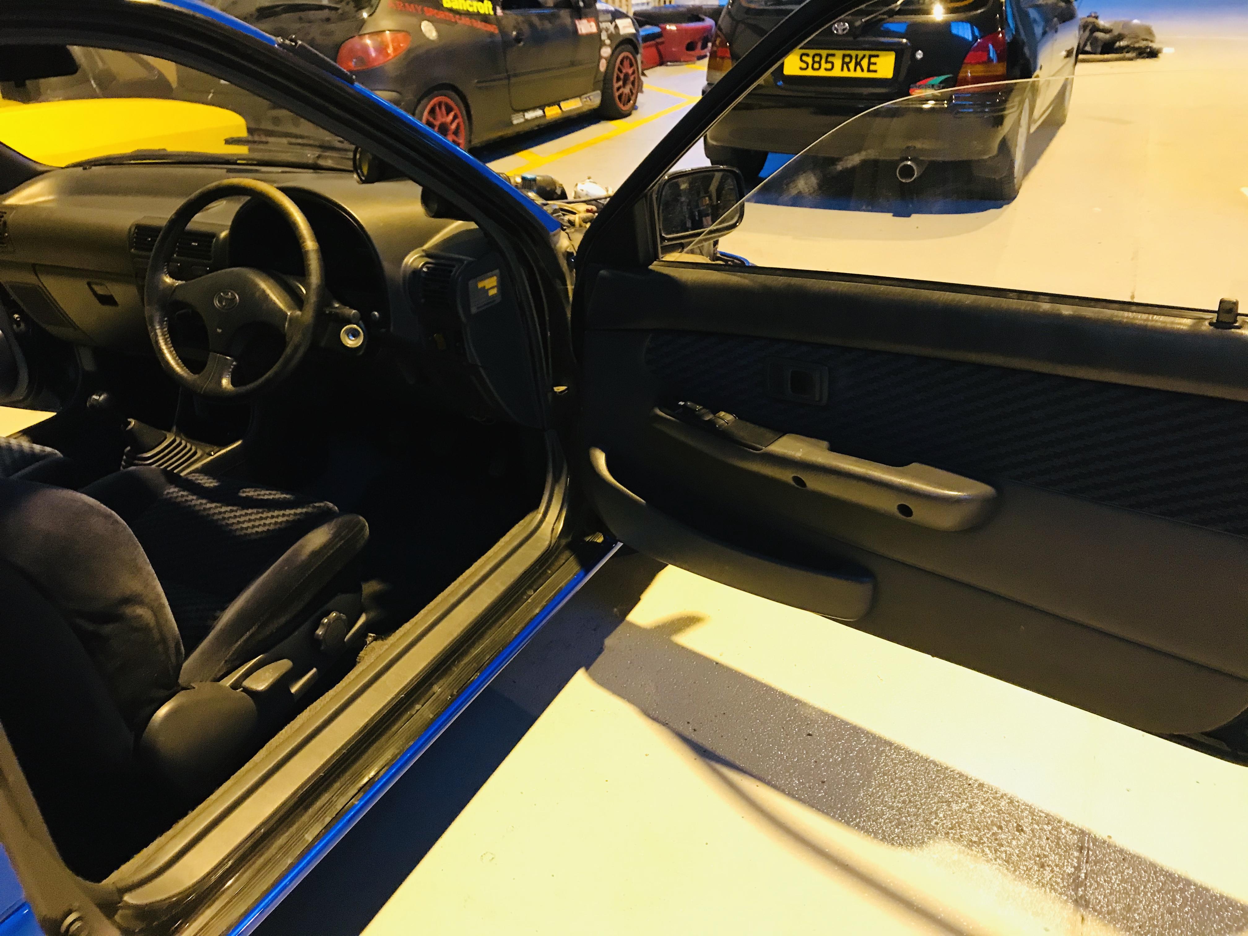

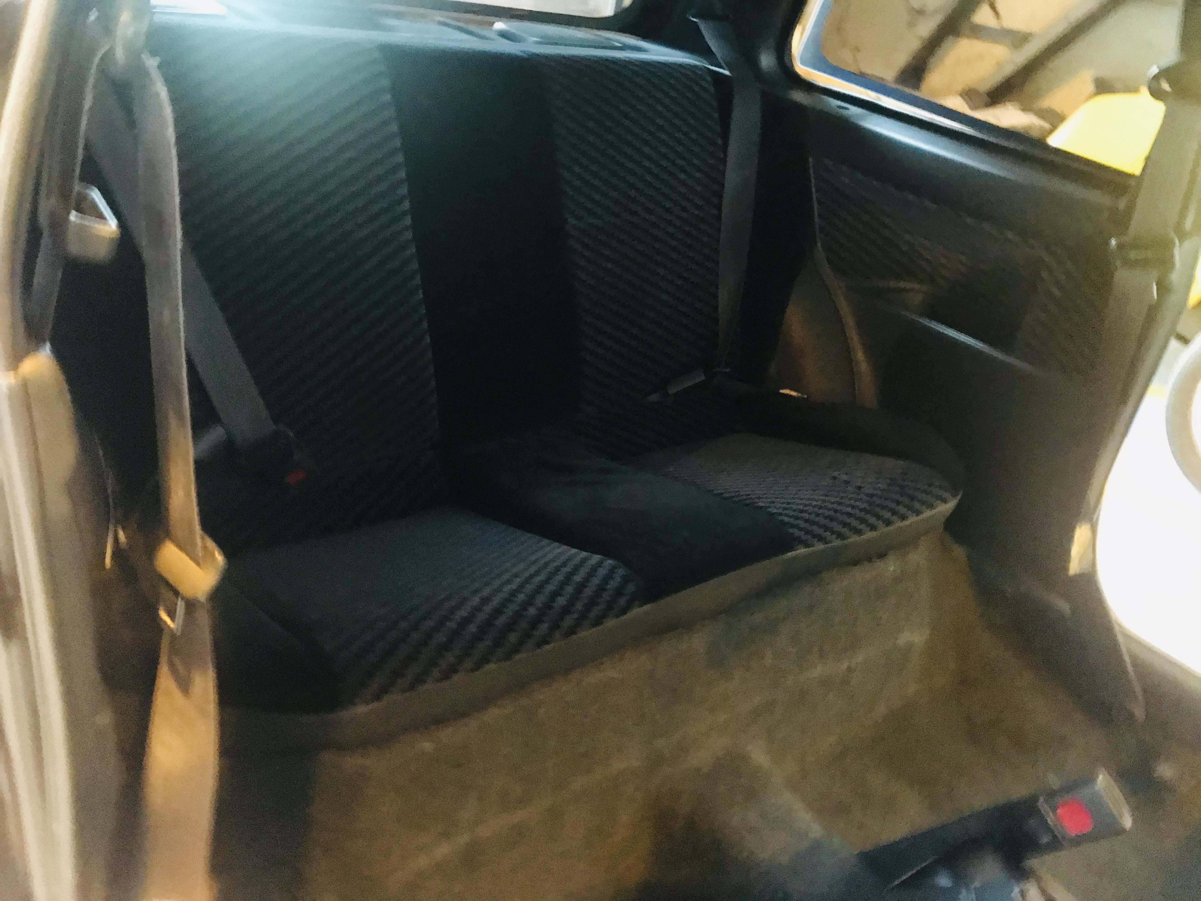

Pikey009 Posted August 3, 2020 Author Posted August 3, 2020 (edited) Seats in and door cards rebuilt, now it’s time to sort the braking system Edited August 4, 2020 by Pikey009 Quote
Pikey009 Posted August 3, 2020 Author Posted August 3, 2020 Had a little sit in the car on the original seats and I can’t wait to get it driving around now Quote
glanzadude Posted August 3, 2020 Posted August 3, 2020 Really coming together cannt wait for the next update Quote
burty Posted August 4, 2020 Posted August 4, 2020 Looking good mate really is gonna wet vac my gt seats and sort the tiny hole can't belive how comfy they are, whats next? Quote

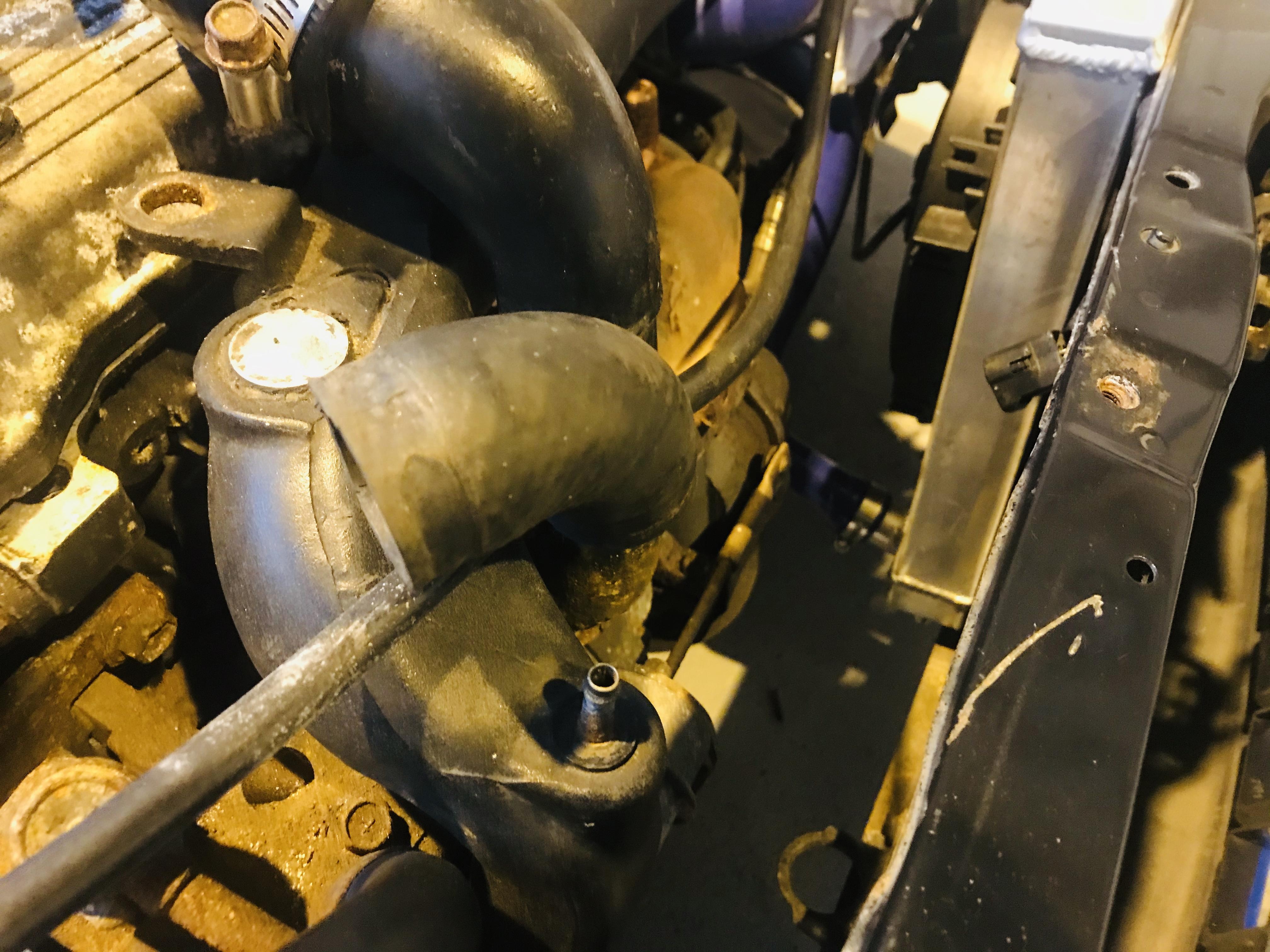

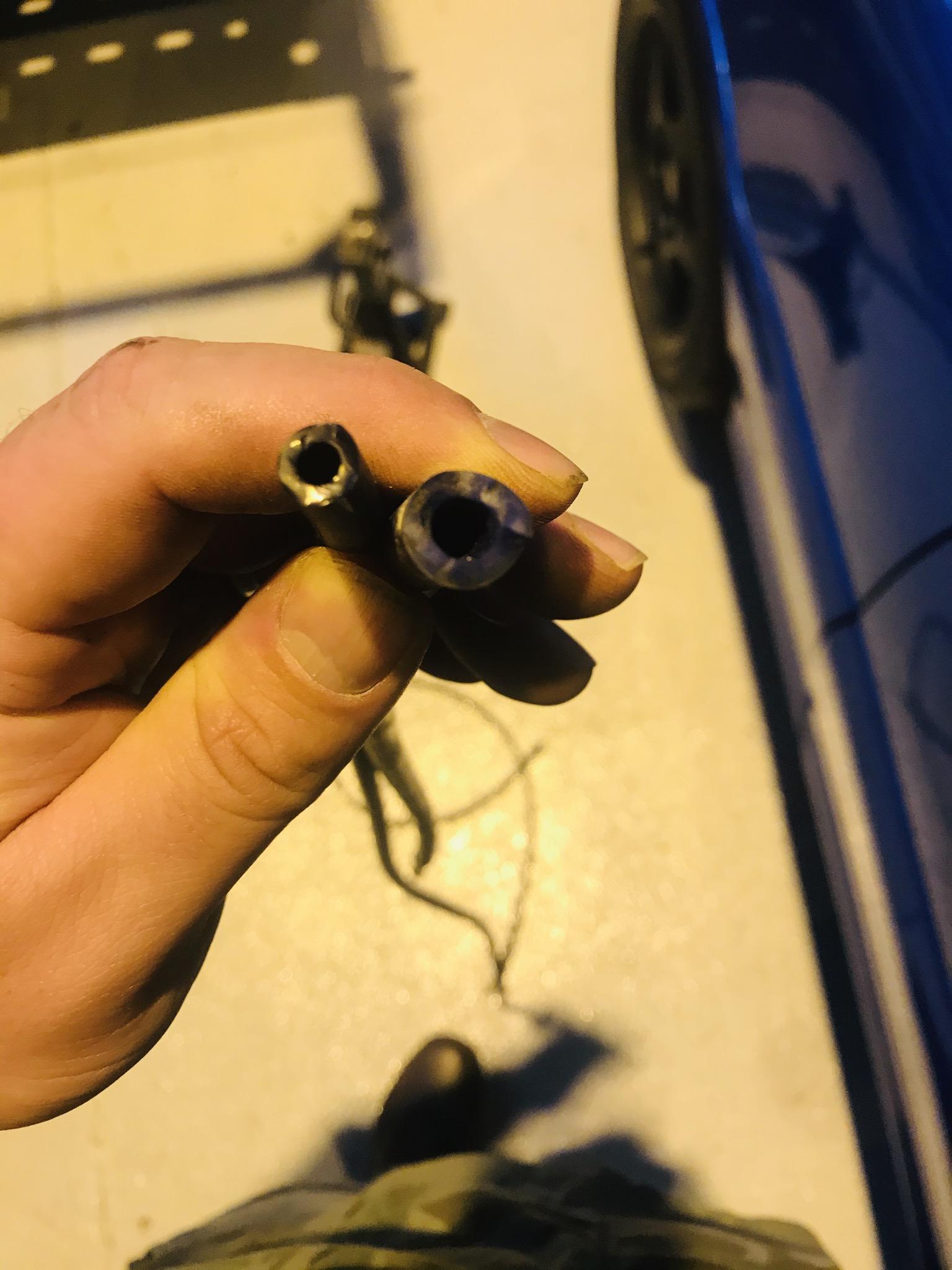

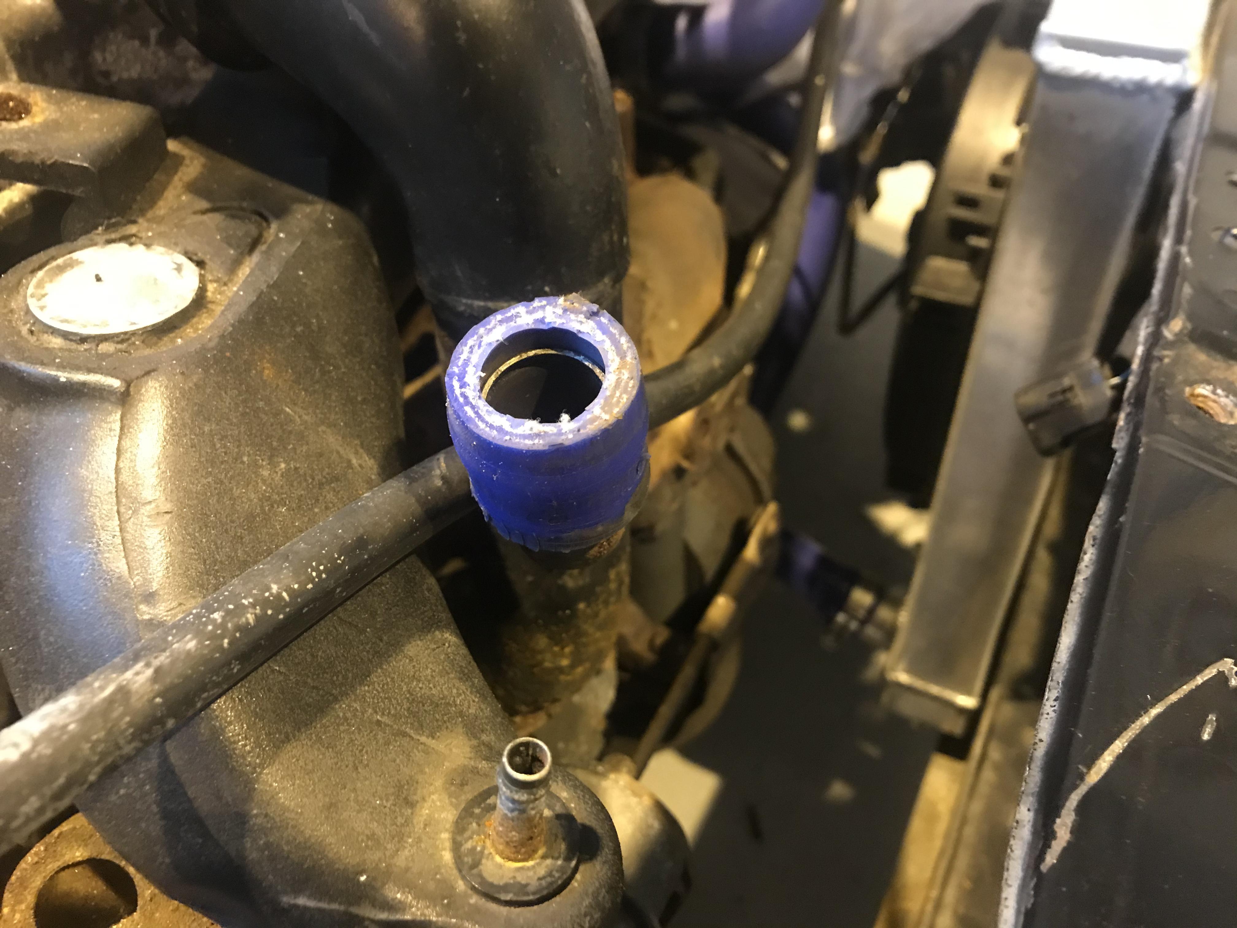

Pikey009 Posted October 5, 2020 Author Posted October 5, 2020 Boost leak #1. Thought I’d cheer myself up and fit my Sard Bov. Found that the hose holding the fake HKS one on actually had a smaller bit inside and pretty much came off in my hand. Boost leak #2. The ‘vac’ hose already fitted was more like washer jet tubing 🤣 so I replaced it with the proper stuff. This hose also pretty much just came off in my hand. Im nearly finished refurbishing the battery mount, it wasn’t rotten but did have surface rust so it got cleaned up, etch primed and painted. I’m STILL waiting for my batter tray which has been over 3 weeks since I ordered it. Once that arrives I can get the battery living in the car permanently. Quote

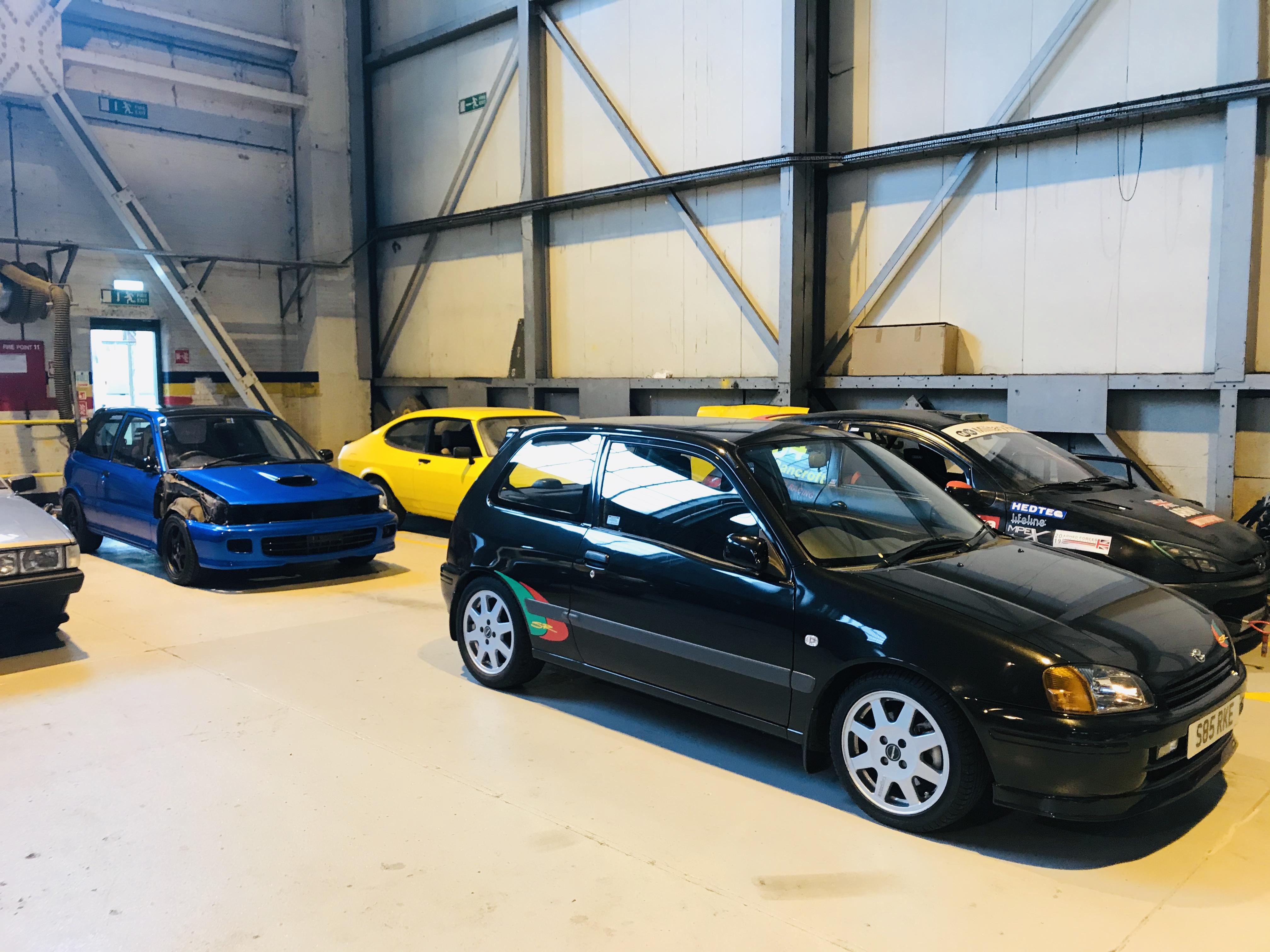

Pikey009 Posted October 5, 2020 Author Posted October 5, 2020 And during this time I’ve also fitted KW V1s to my fabia and bought a van, but I know nobody wants to hear about those as they’re German. Quote
Pikey009 Posted October 5, 2020 Author Posted October 5, 2020 Just incase some people do care though Quote
