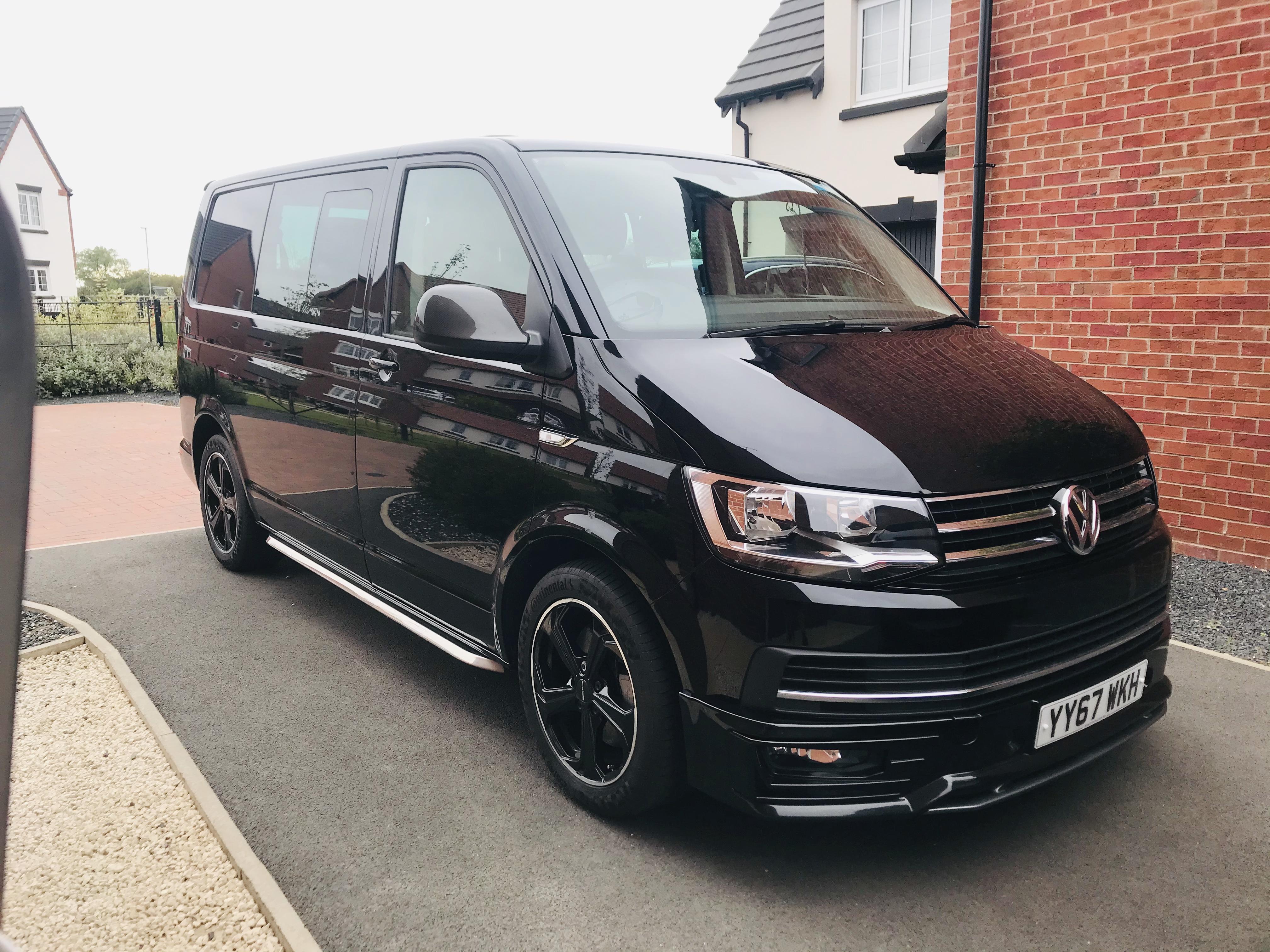

Pikey009 Posted October 5, 2020 Author Posted October 5, 2020 This is a t6 sportline with 204ps as standard, doesn’t hang around for a van that’s for sure. Quote

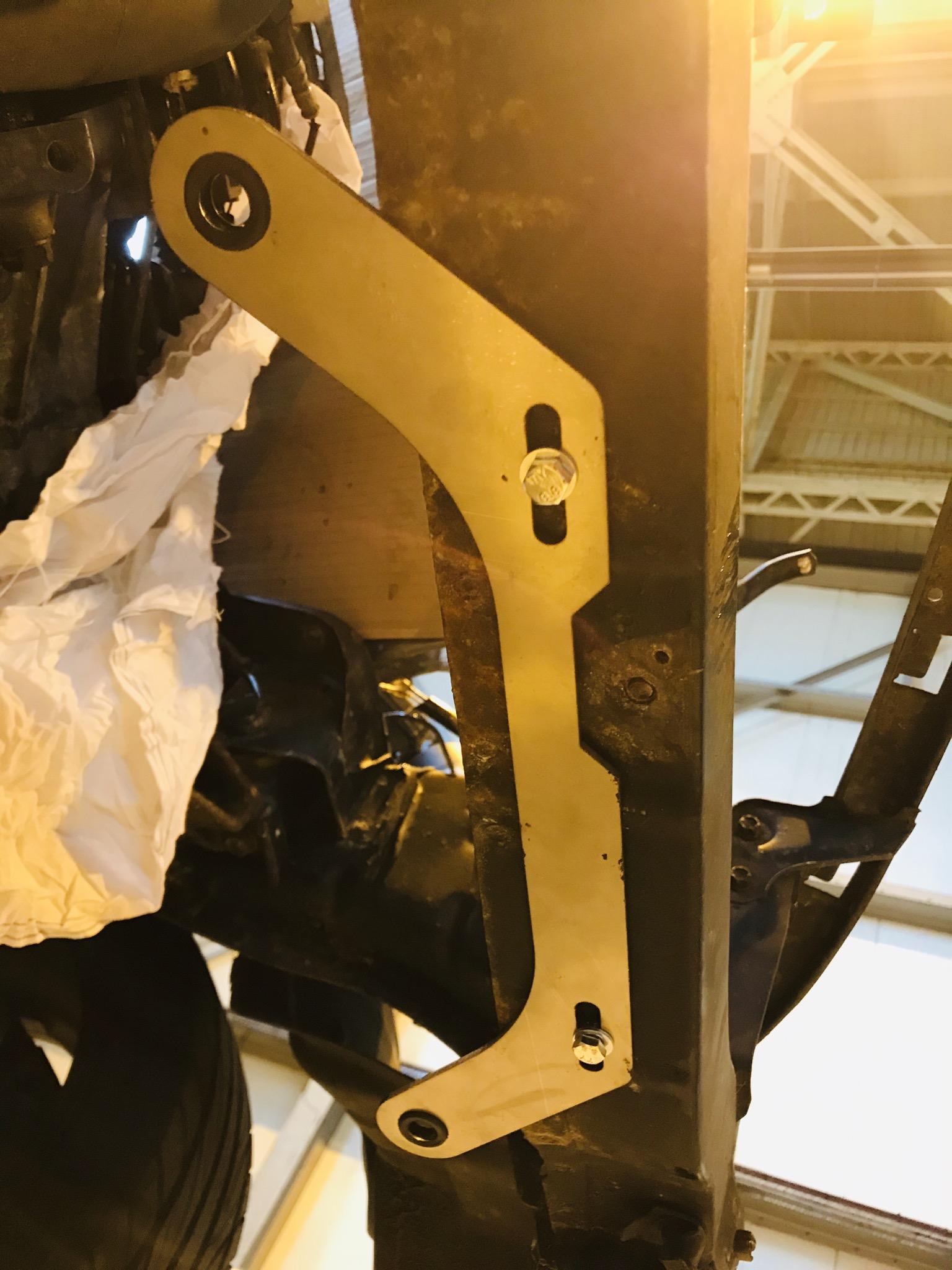

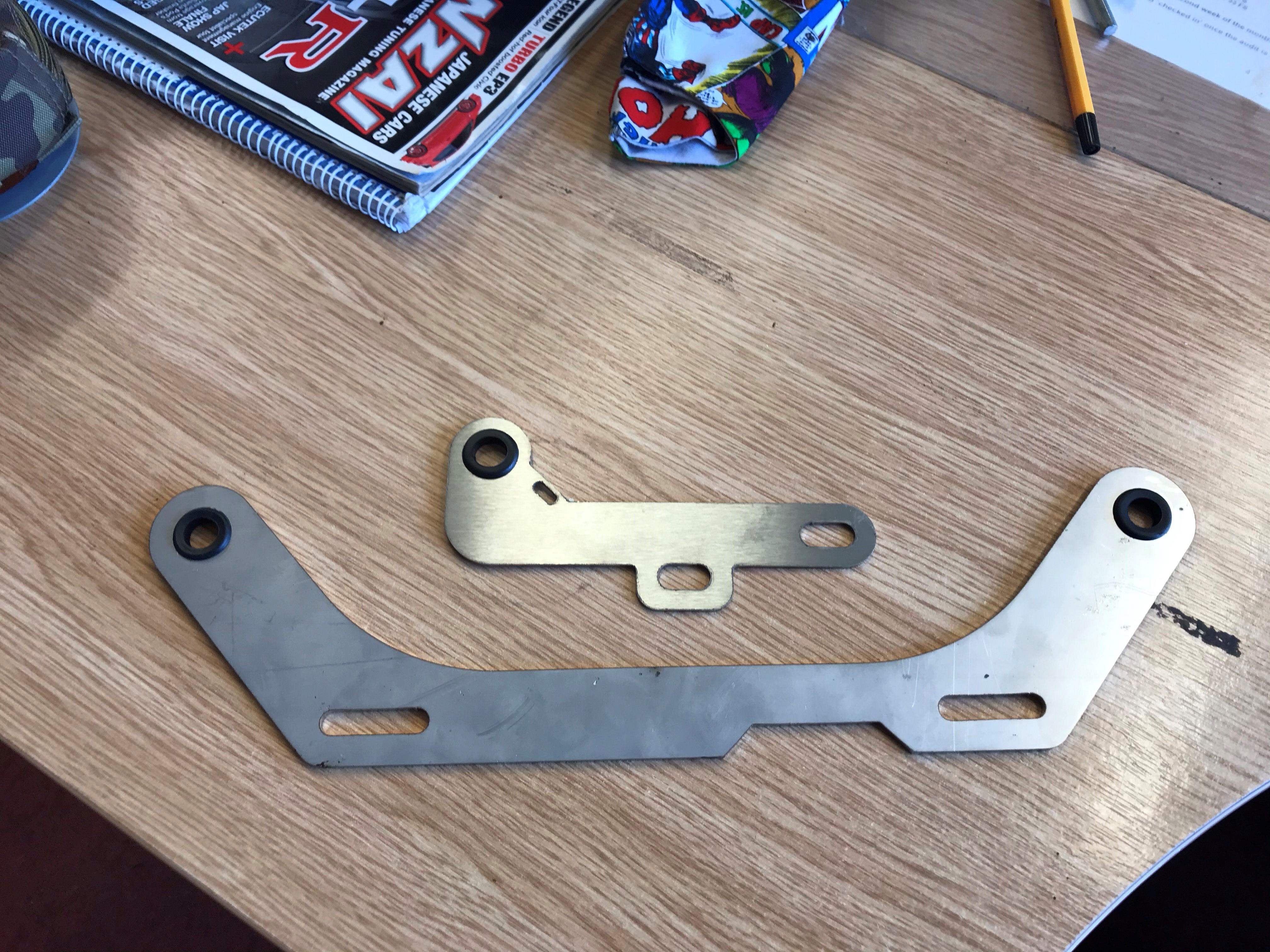

Pikey009 Posted October 8, 2020 Author Posted October 8, 2020 (edited) Starlets are hilarious because they are pretty much go-karts. That old SR of mine was great fun, i never really put the radio on in it because it was so much fun to drive. So.. some sort of progress. I bought rad mounting brackets from ID-W, they are excellent quality however, they don't come with rubber grommets. After some fun with my digital calipers I measured up and ordered some which arrived today and are spot on. They were only £1.30 too. Edited October 8, 2020 by Pikey009 Quote
Pikey009 Posted October 8, 2020 Author Posted October 8, 2020 Next week i'll be cutting the original rad mount out, painting the area and then mounting the half rad properly as it was just sat on the old mount and cable tied to the crash bar at the top Quote

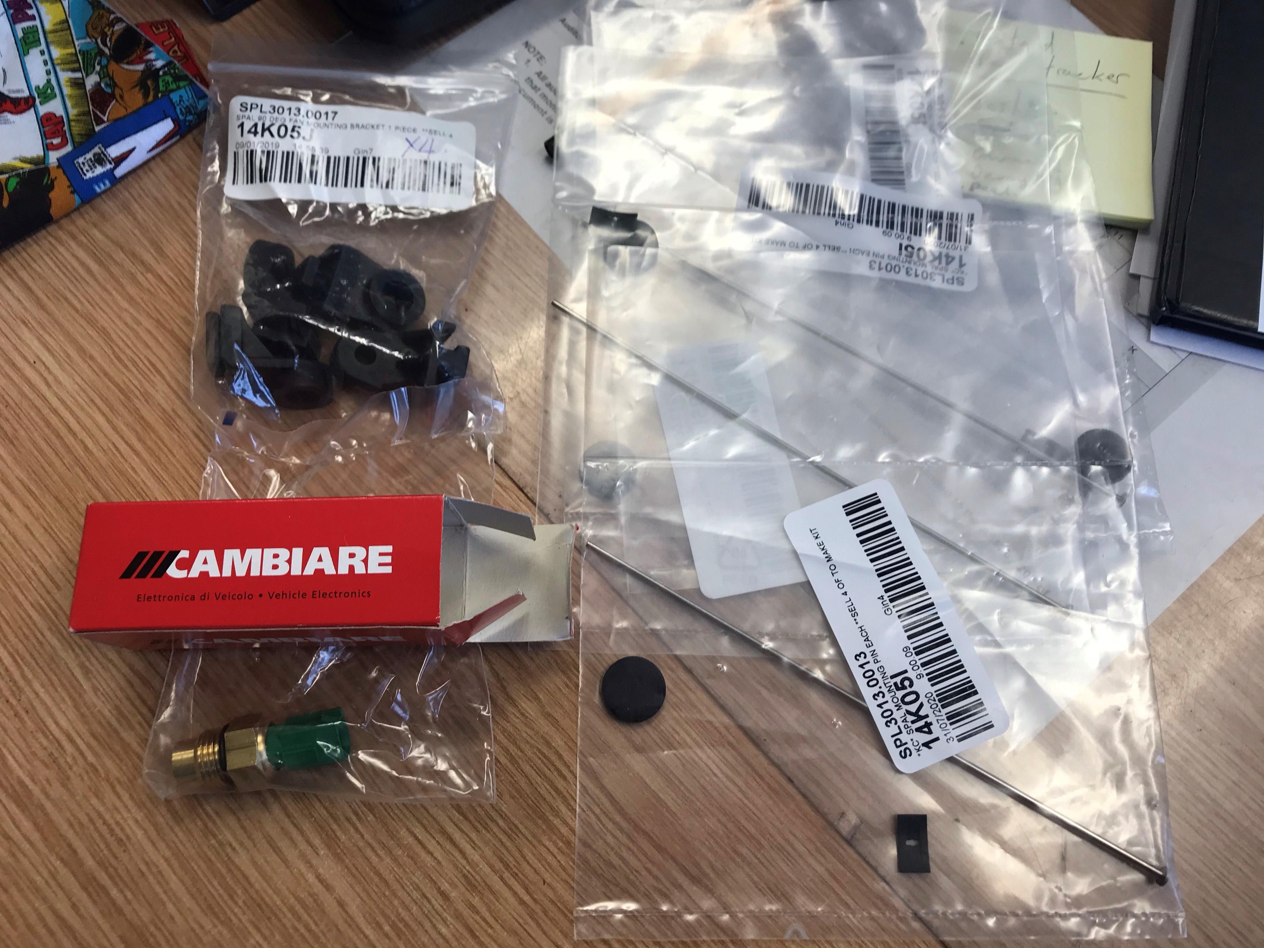

Pikey009 Posted October 8, 2020 Author Posted October 8, 2020 Once the rad is mounted i'll then actually secure the fan to the rad (its just flapping around at the moment). I got hold of an SPL mounting kit from Demon Tweaks (part numbers pictured). Once the fan is secured i'll then be replacing the fan switch (fan is on constantly which seems a common fault when fitting the new set up). Quote

Pikey009 Posted October 9, 2020 Author Posted October 9, 2020 Got home today and opened all my presents. Air filter relocation kit: Not from a company, just measured the bits up and ordered the two parts, fingers crossed it all fits. Quote

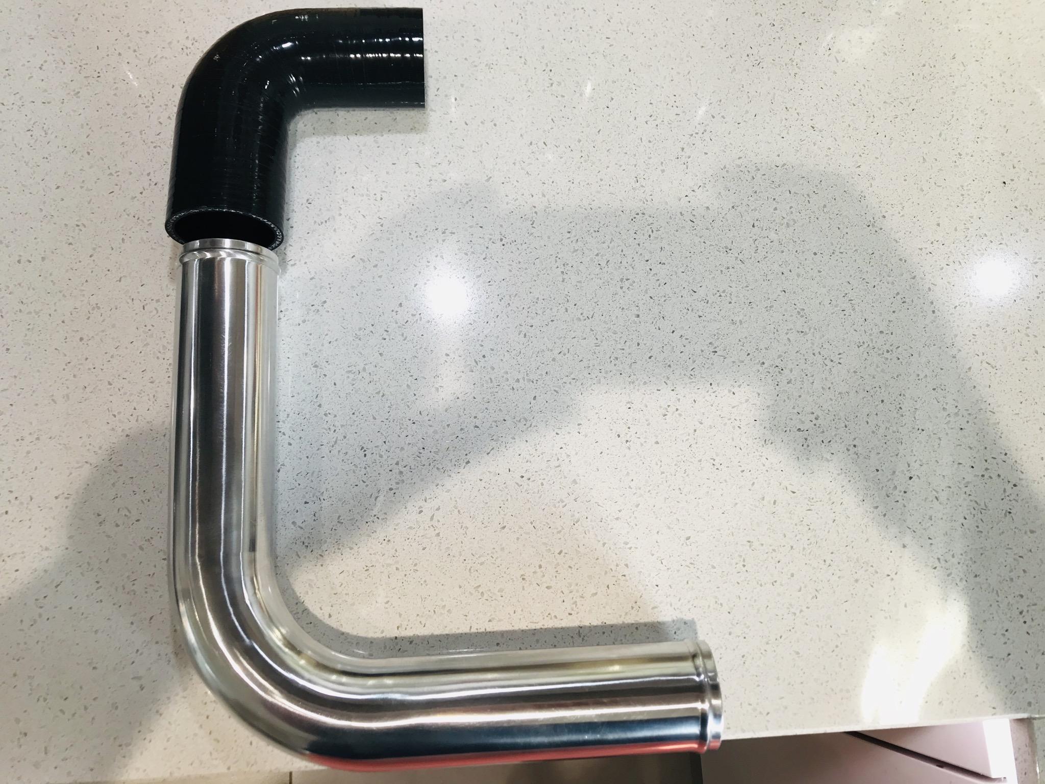

Pikey009 Posted October 9, 2020 Author Posted October 9, 2020 (edited) Also got some DEI metal protector in black, just helps prevent surface corrosion for the new turbo kit. Had good results with this on my gt4. The cool tape will be used on some of the FMIC pipework Edited October 9, 2020 by Pikey009 Quote

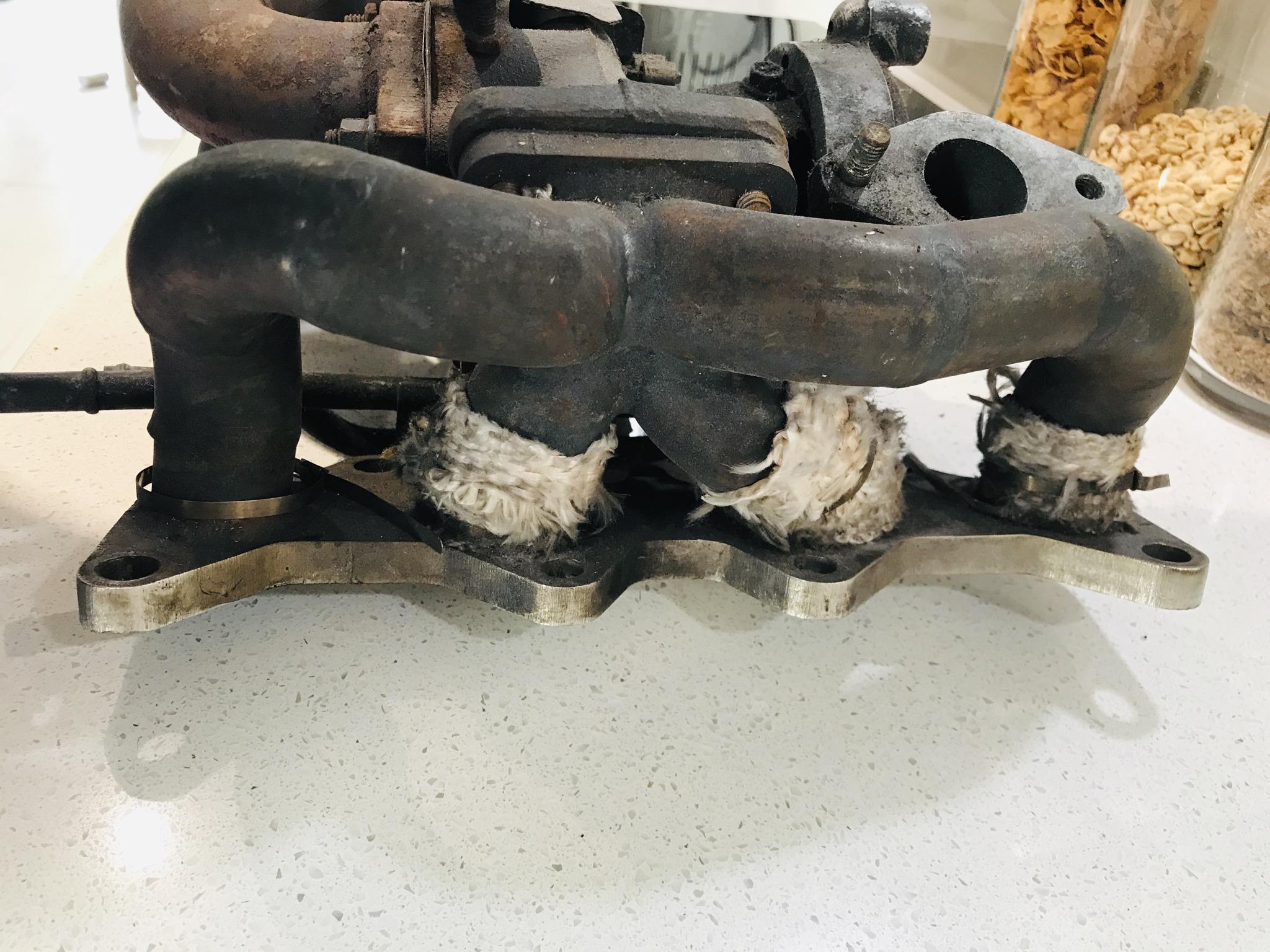

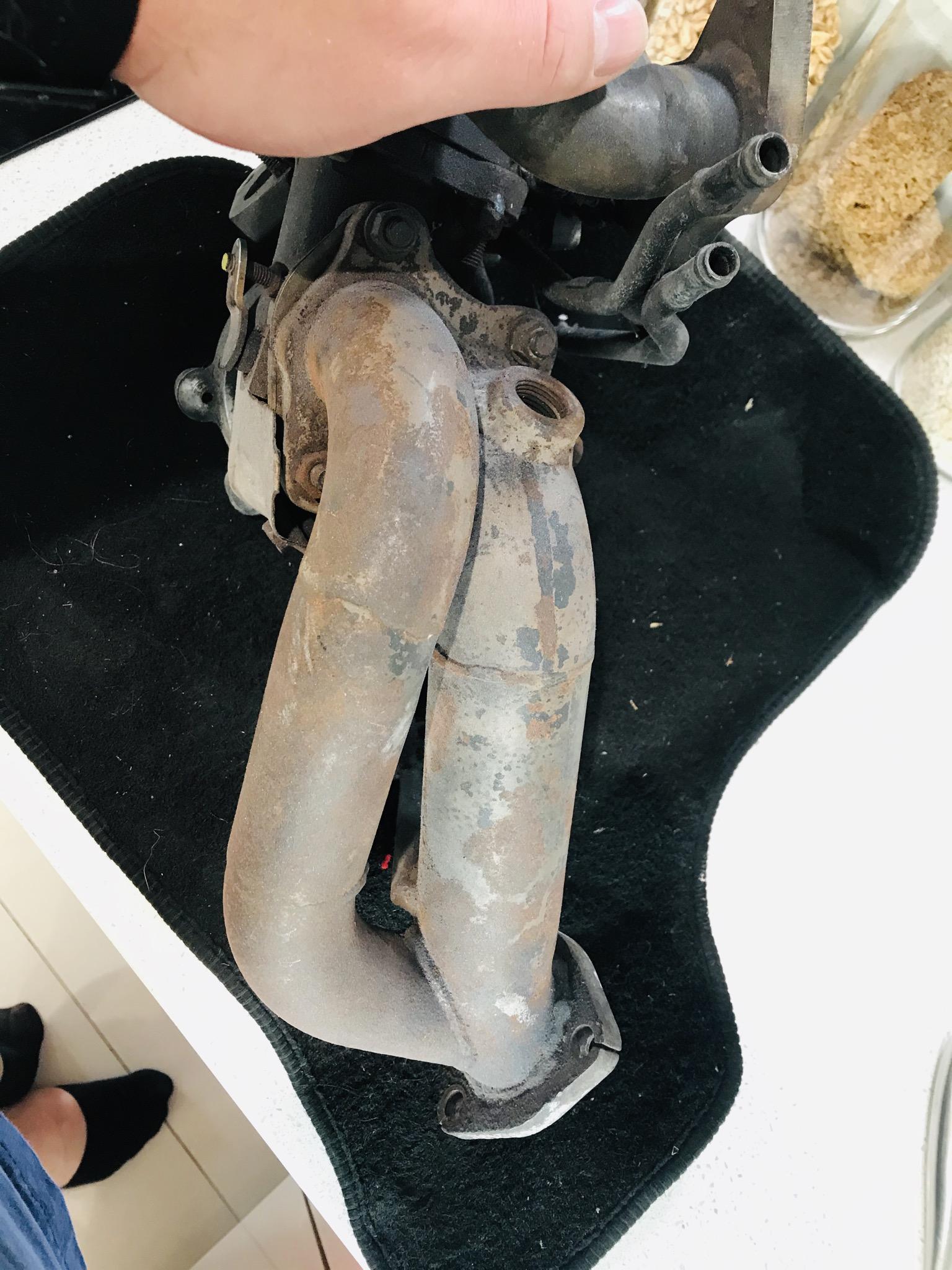

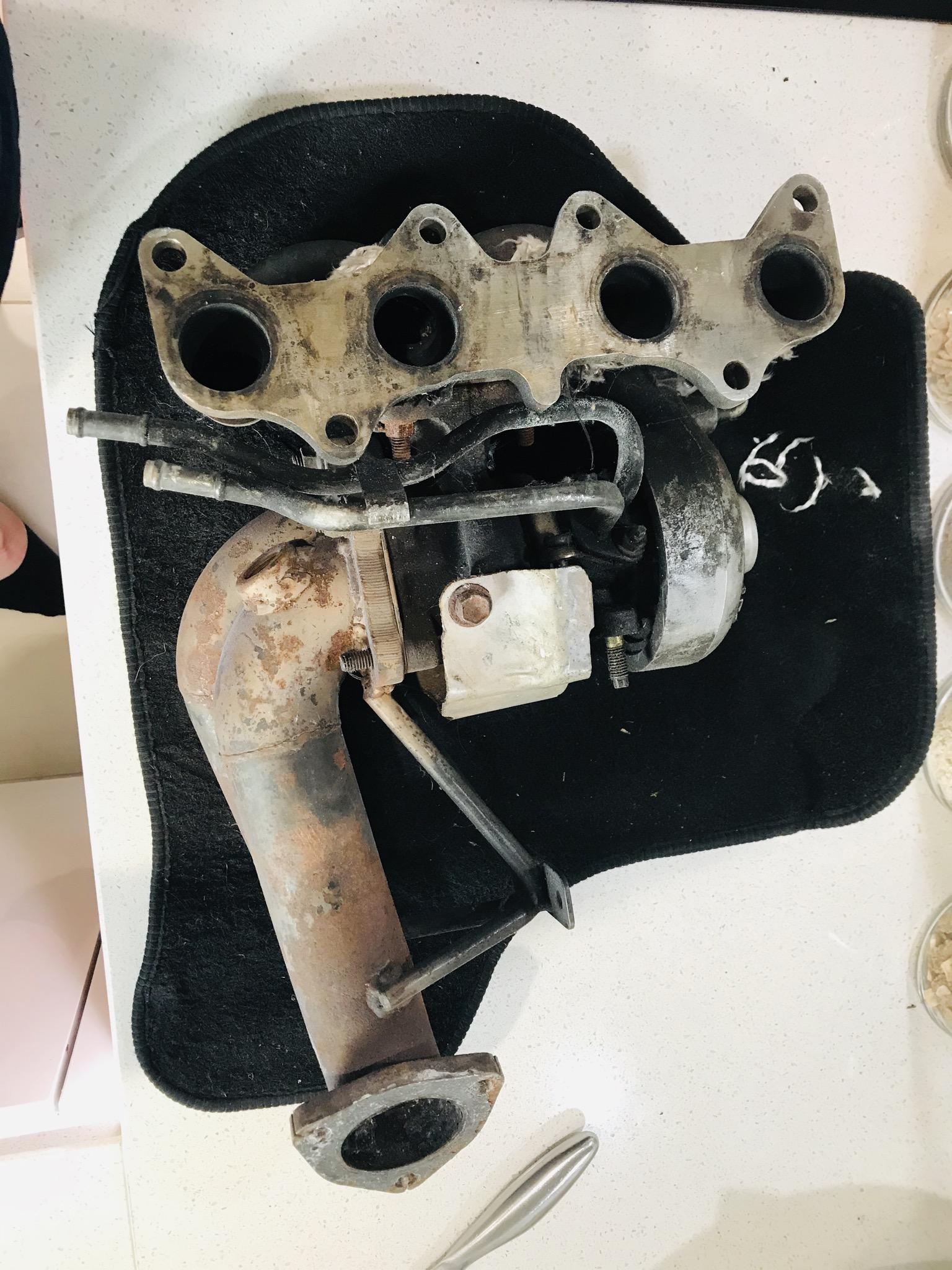

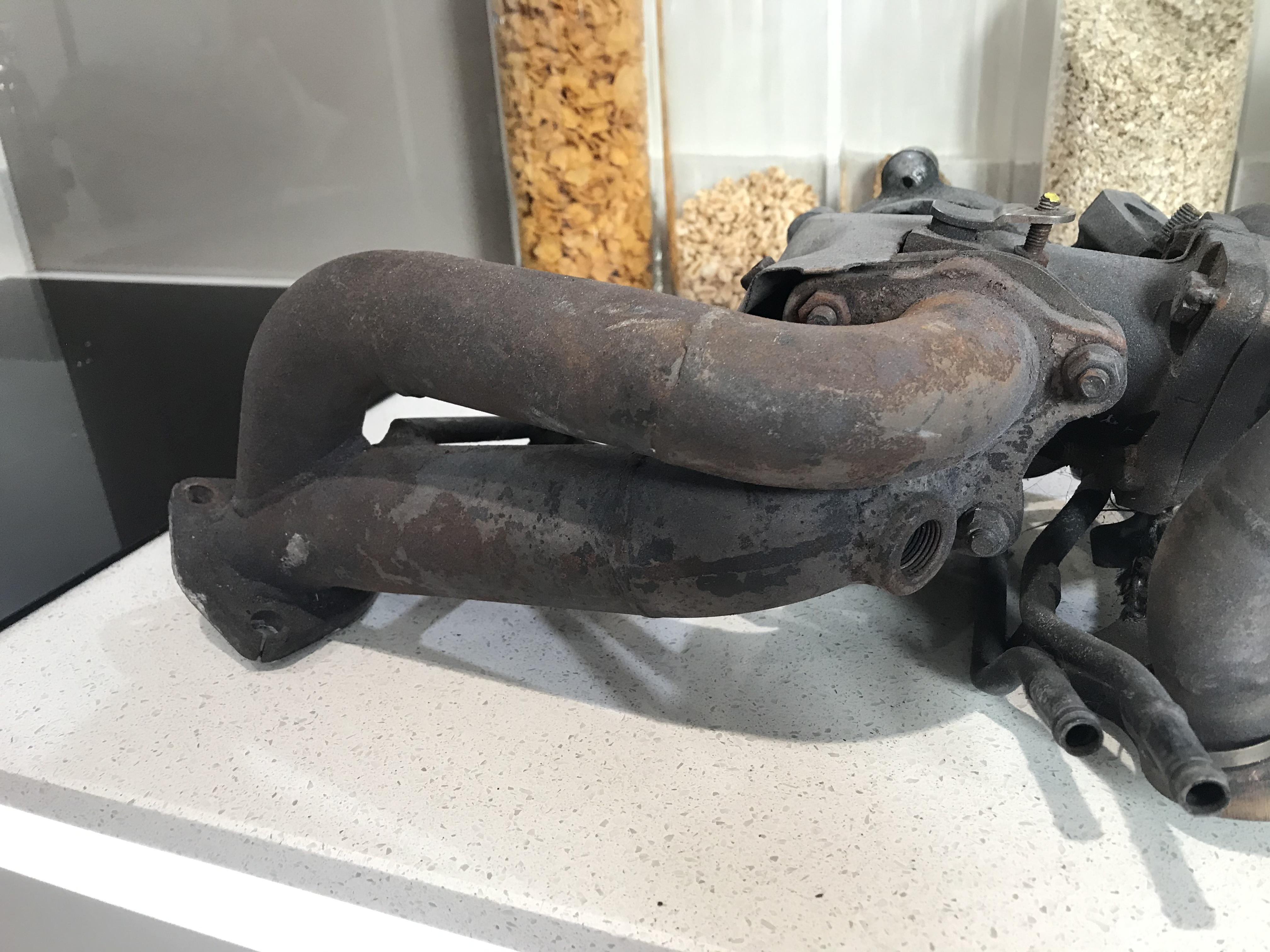

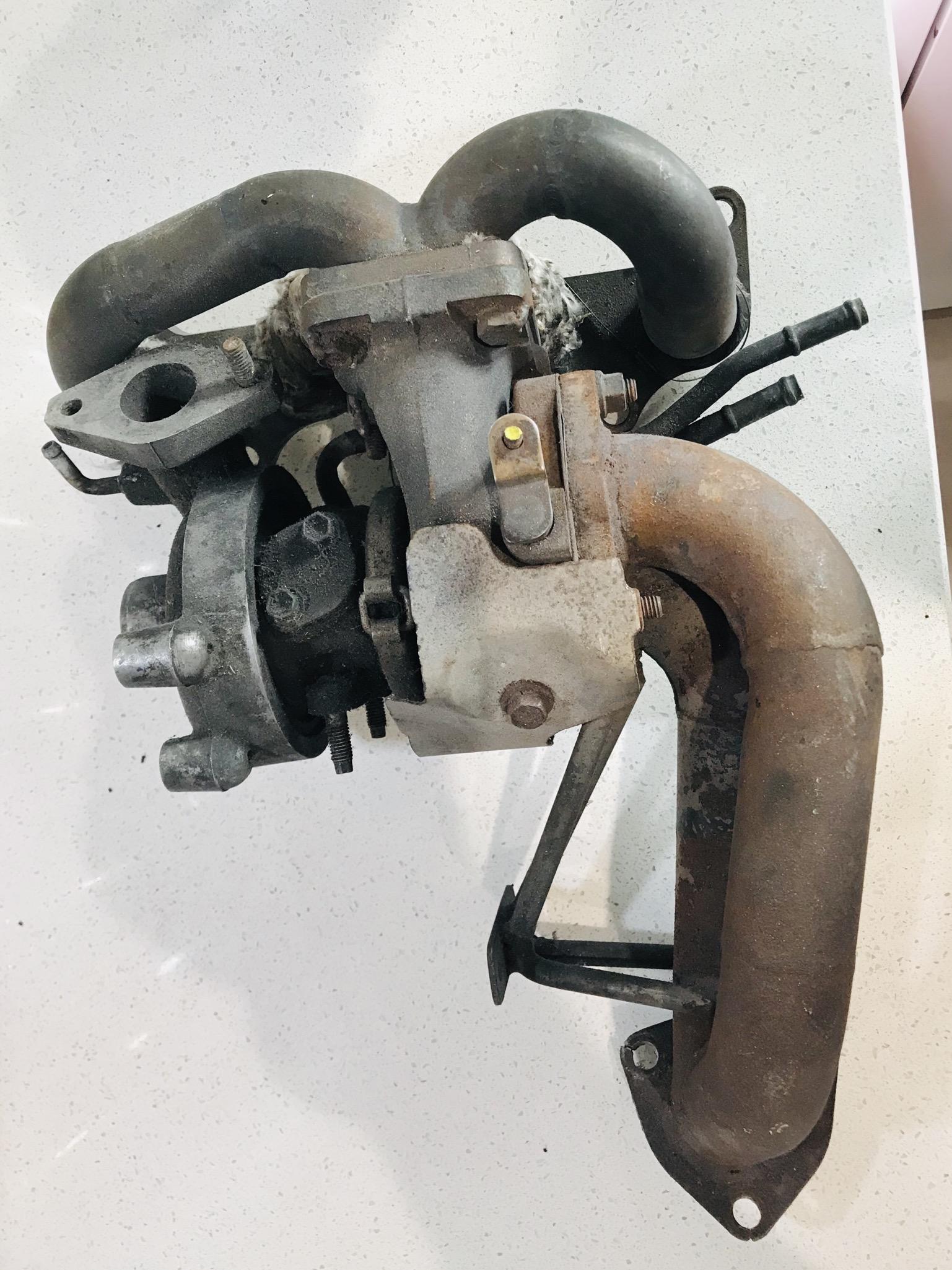

Pikey009 Posted October 9, 2020 Author Posted October 9, 2020 (edited) Which brings me on to a total punt I’ve made on a turbo kit. I knew the ct9 was already goosed but that’s fine. Not sure of the brand- looks like a custom job to me but it’s pretty good quality to be honest and no repairs or cracks from what I can see. Never seen a downpipe design like this for a starlet before. It’s a miracle it made it here in one piece as it was wrapped in 3 old car mats and some parcel tape! Why the seller didn’t put it in a box I’ll never know but no harm done I guess. Edited October 9, 2020 by Pikey009 Quote
Pikey009 Posted October 9, 2020 Author Posted October 9, 2020 3rd runner seems a bit restrictive but it’s nothing my dremel can’t fix Quote
SKINY Posted October 10, 2020 Posted October 10, 2020 I have the same radiator bracket kit and came with no rubbers(2nd hand but new)either, I used the rubber spacers with the steel sleeve from the factory intercooler mounts with no sleeve, absolutely perfect fit Quote
Claymore Posted October 10, 2020 Posted October 10, 2020 21 hours ago, Pikey009 said: Which brings me on to a total punt I’ve made on a turbo kit. I knew the ct9 was already goosed but that’s fine. Not sure of the brand- looks like a custom job to me but it’s pretty good quality to be honest and no repairs or cracks from what I can see. Never seen a downpipe design like this for a starlet before. It’s a miracle it made it here in one piece as it was wrapped in 3 old car mats and some parcel tape! Why the seller didn’t put it in a box I’ll never know but no harm done I guess. Saw this for sale a couple of weeks back (absolute bargain) didn't last more than a couple of hours. Can't work out why the previous owner welded the bolt heads to the turbo housing though? Using as studs or to stop them undoing? Laces out? Looks custom like you said, the downpipe looks a bit more special than the chinese junk too. Good find Quote
Pikey009 Posted October 10, 2020 Author Posted October 10, 2020 🤣 me neither but I’ll just cut them off. I need to re-finish the mating surfaces as there’s old gasket and corrosion. me and a friend were trying to work out the purpose of the downpipe design, maybe to help prevent boost creep 🤔 Anyway, even with all the quirkiness it looks well put together and I’m looking forward to getting it on. Quote

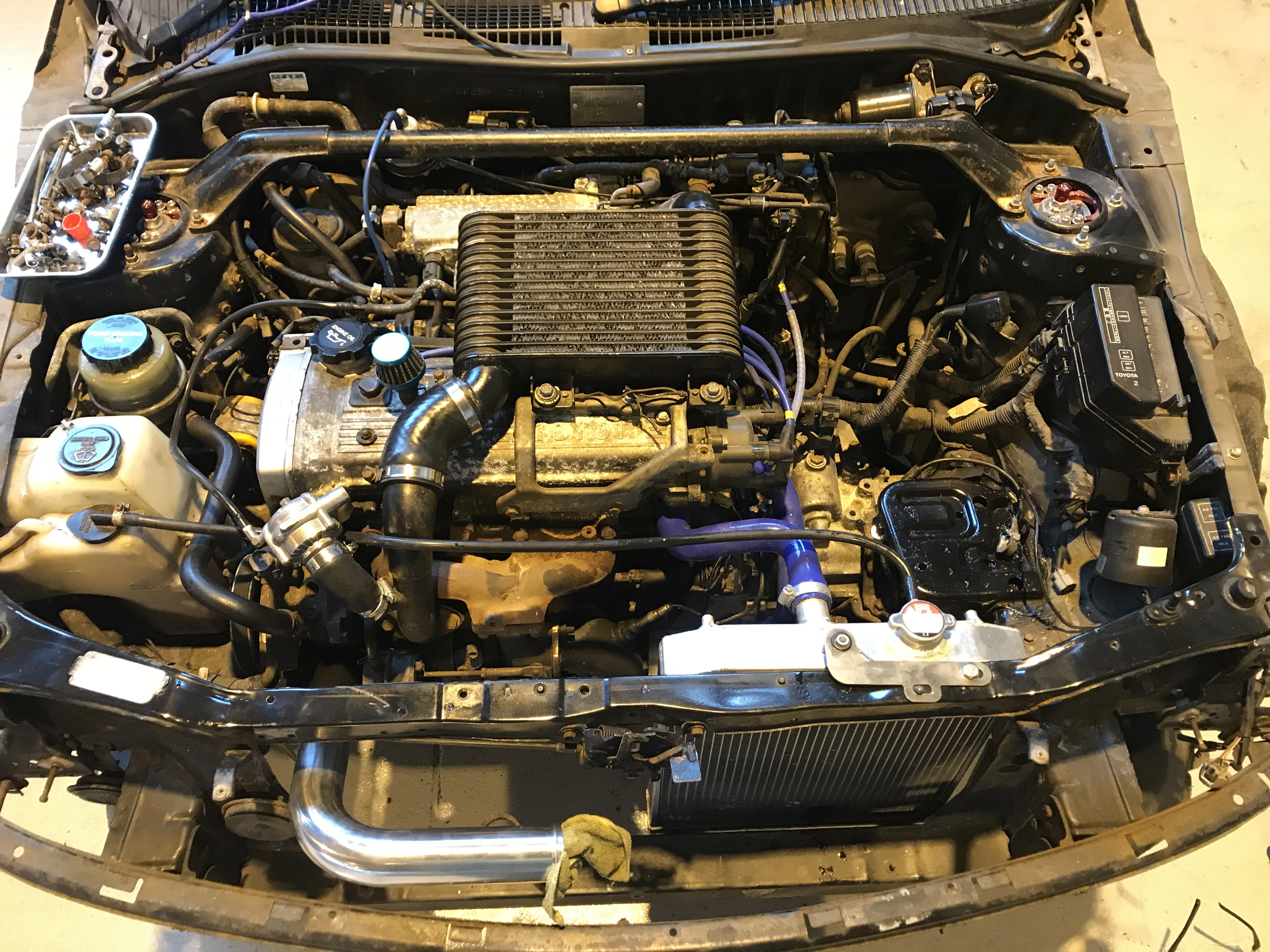

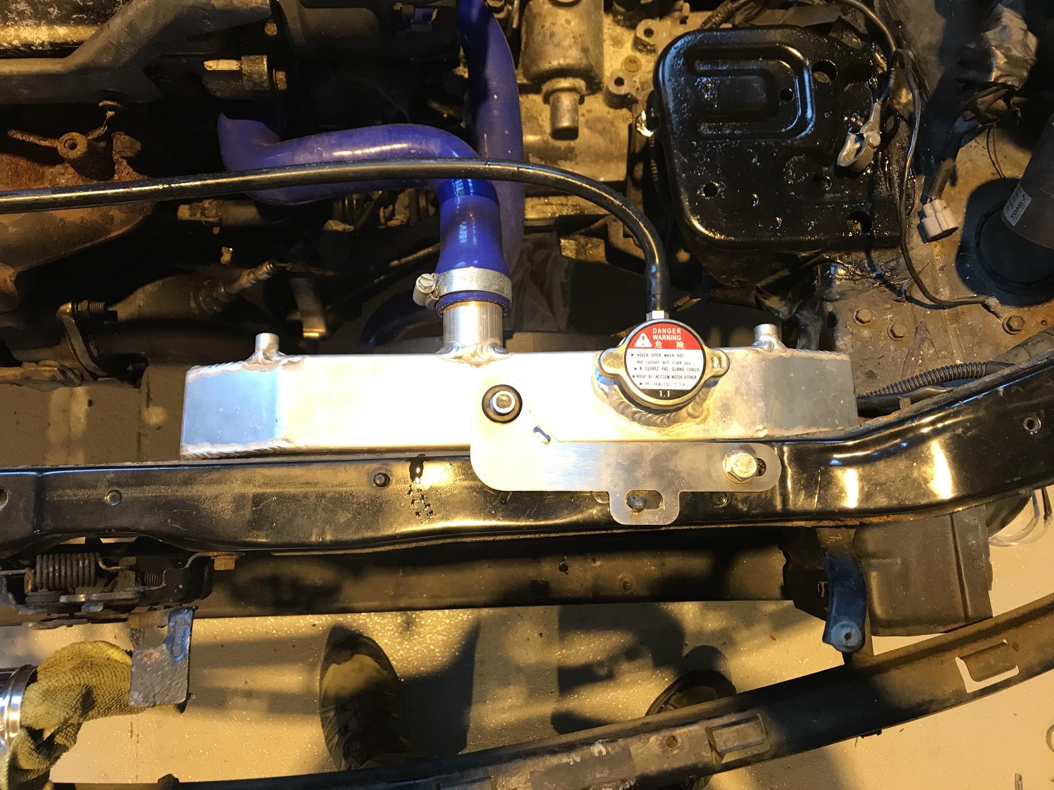

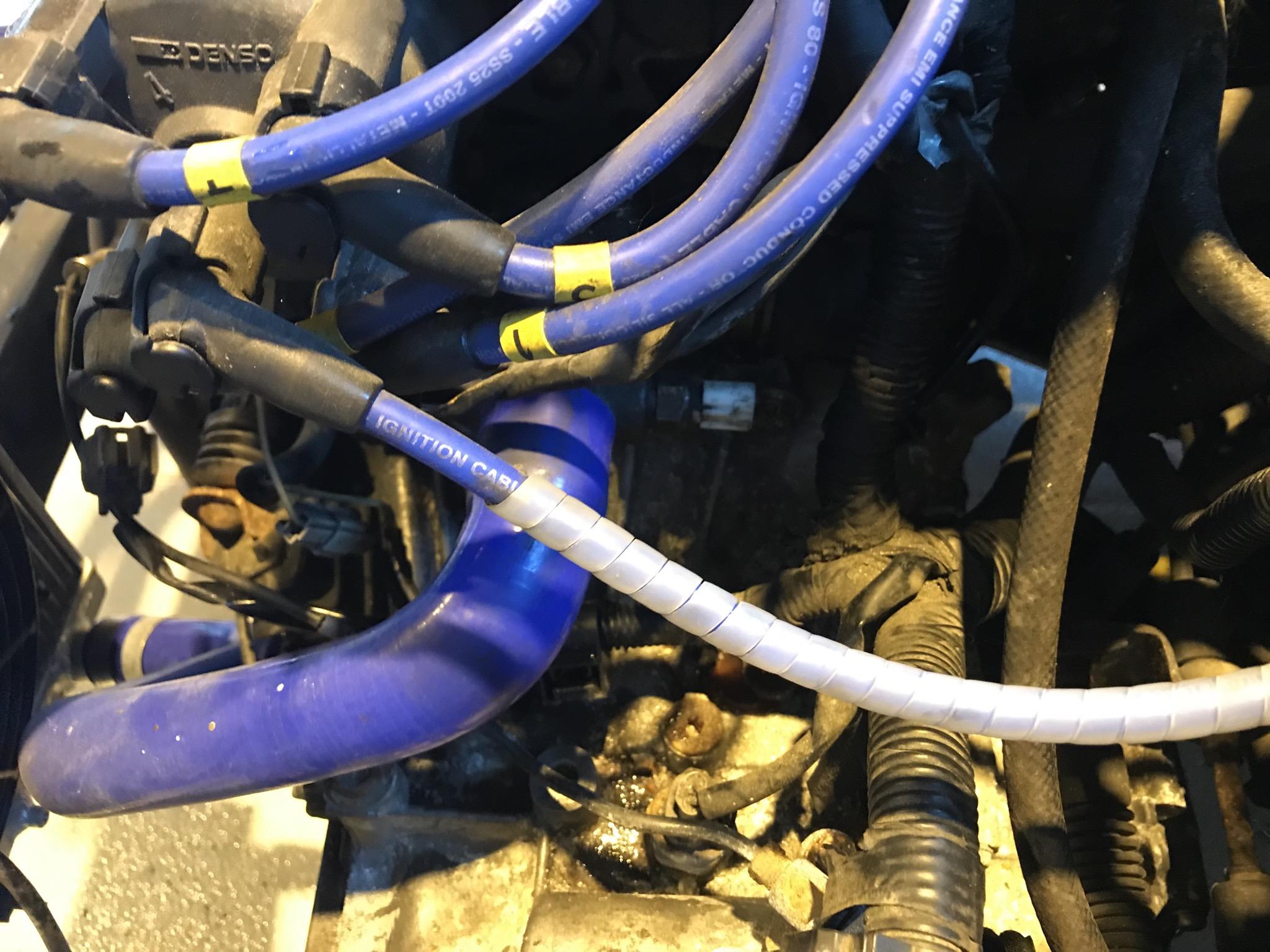

Pikey009 Posted October 14, 2020 Author Posted October 14, 2020 I got the rad mounted today and the filter relocation all trimmed so that it doesn’t fowl anything. I know the metal pipe is long but I’ll trim that when I find a filter Quote

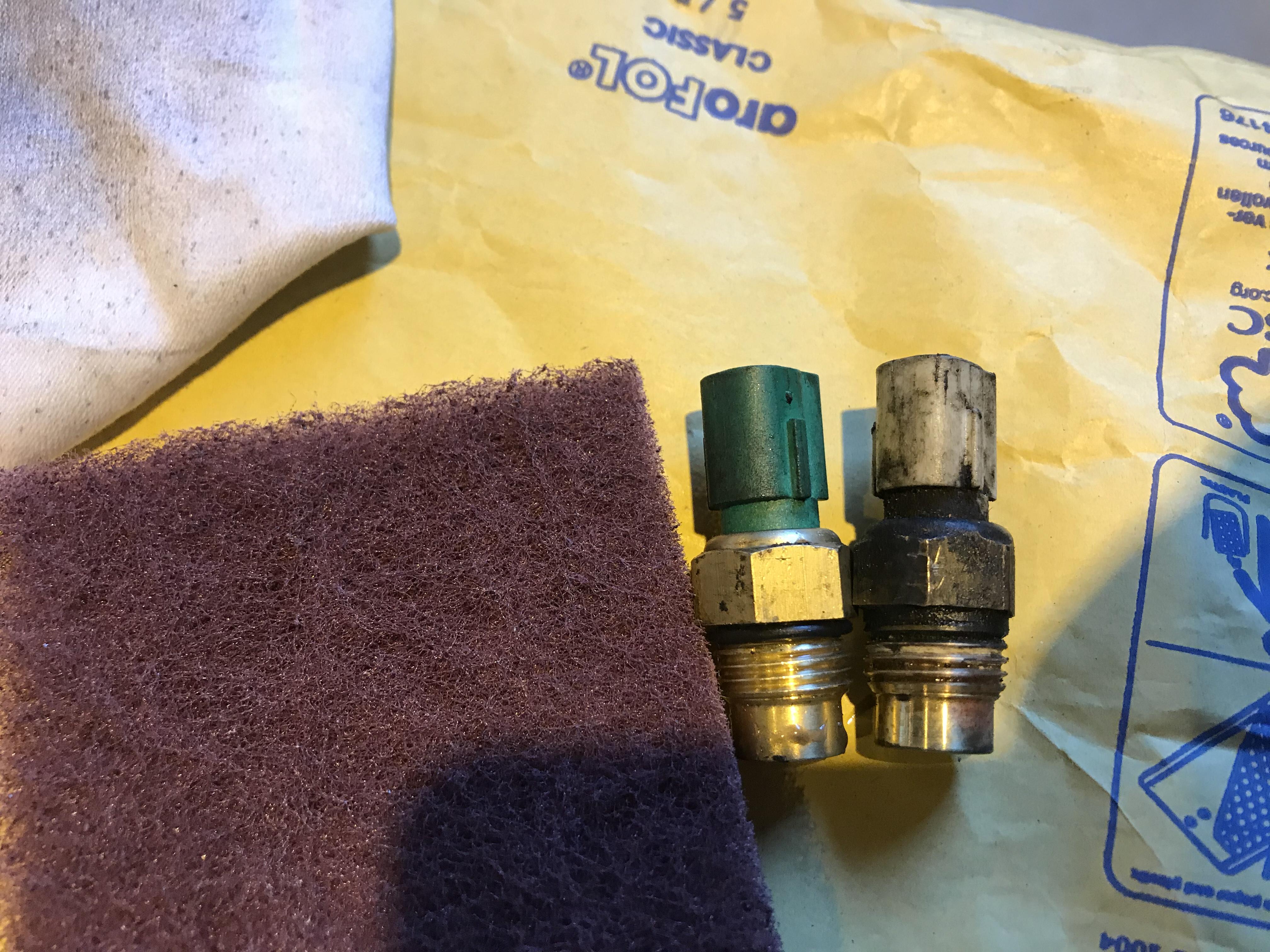

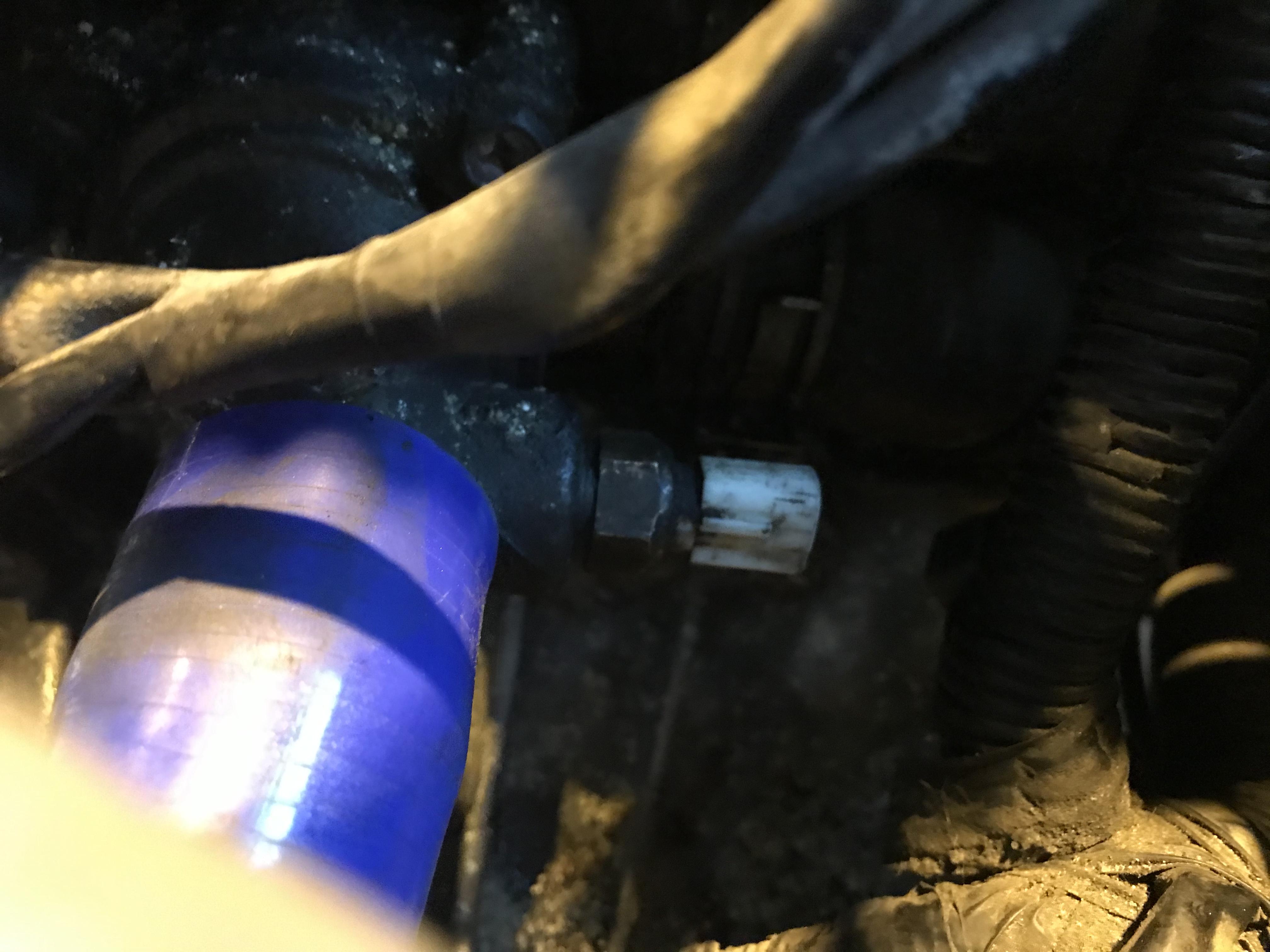

Pikey009 Posted October 14, 2020 Author Posted October 14, 2020 But then I hit a snag. It looks like I’ve either ordered the wrong sensor, am looking at the wrong one or have been sent the wrong one. is this the fan switch sensor thingy? Quote
Pikey009 Posted October 14, 2020 Author Posted October 14, 2020 Because the one I got is green and the plug doesn’t give the convincing ‘clip’ noise I’m after, I can just pull it off with minimal effort. the pic shows a comparison Quote

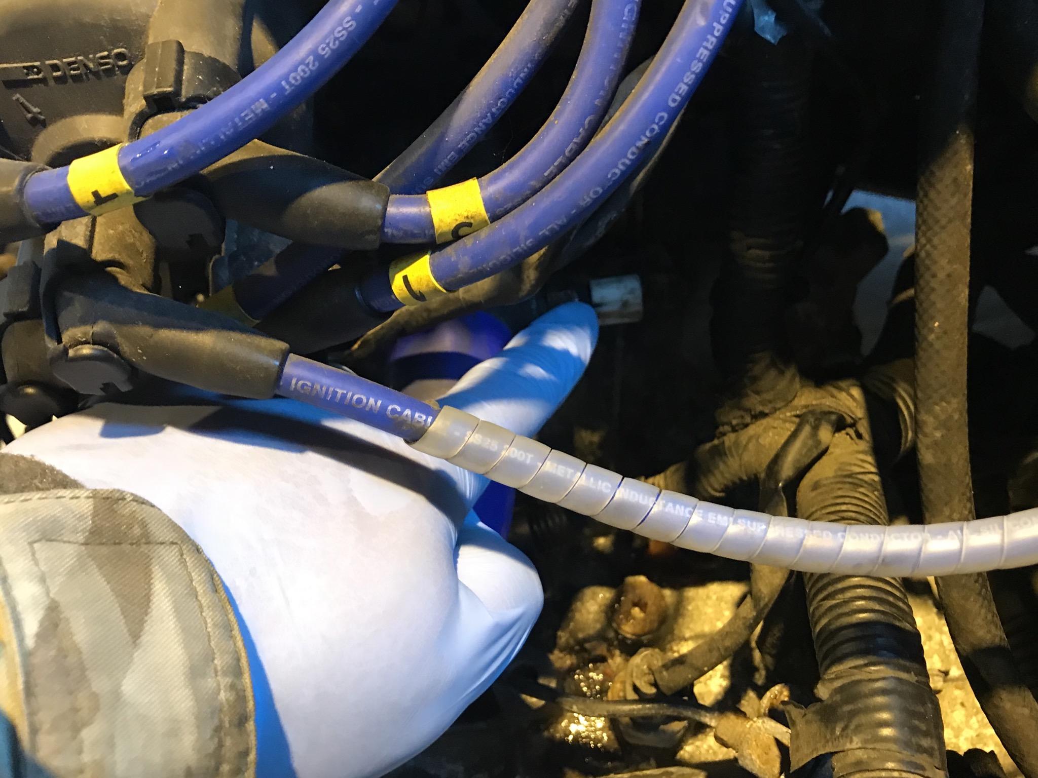

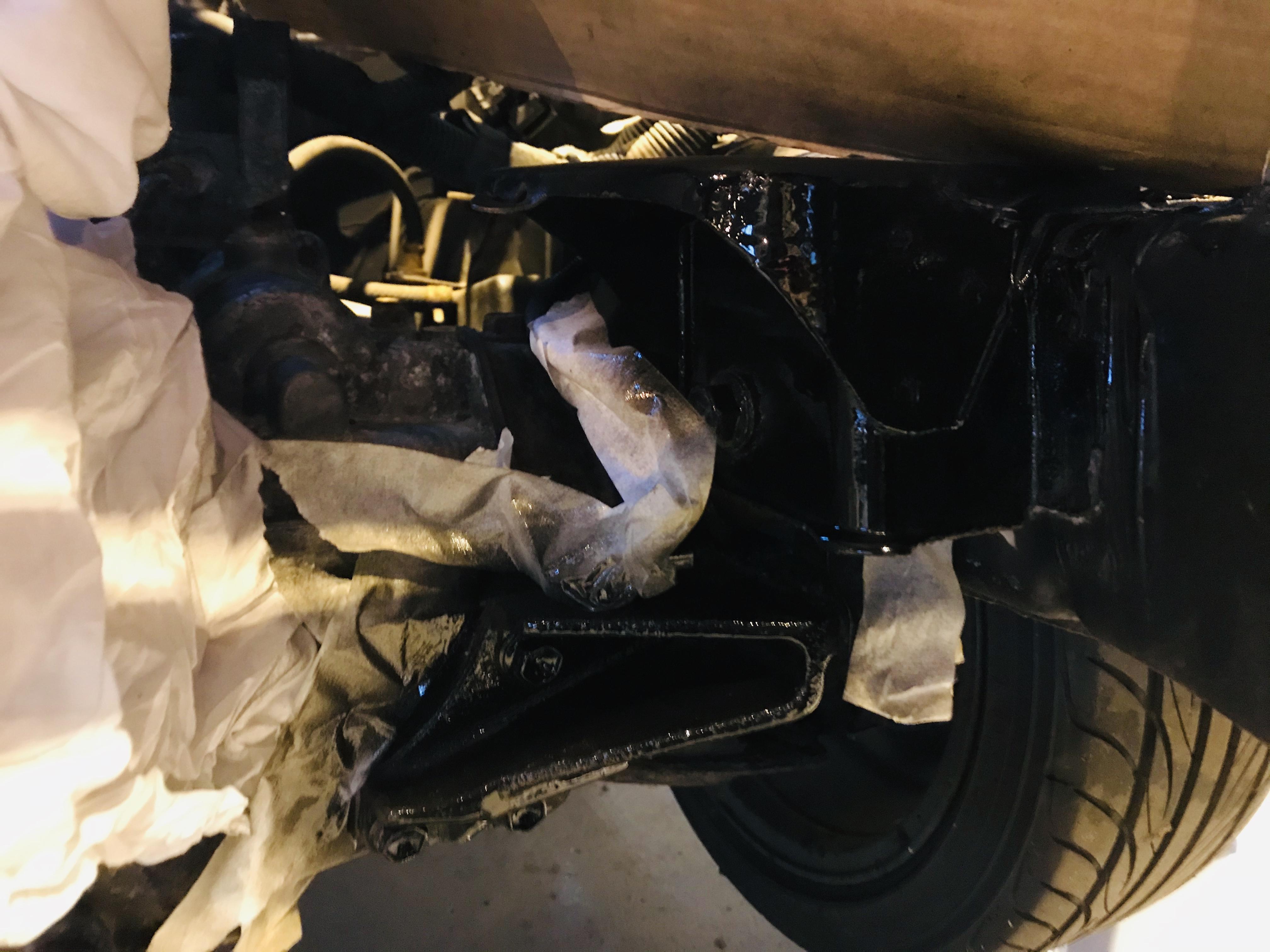

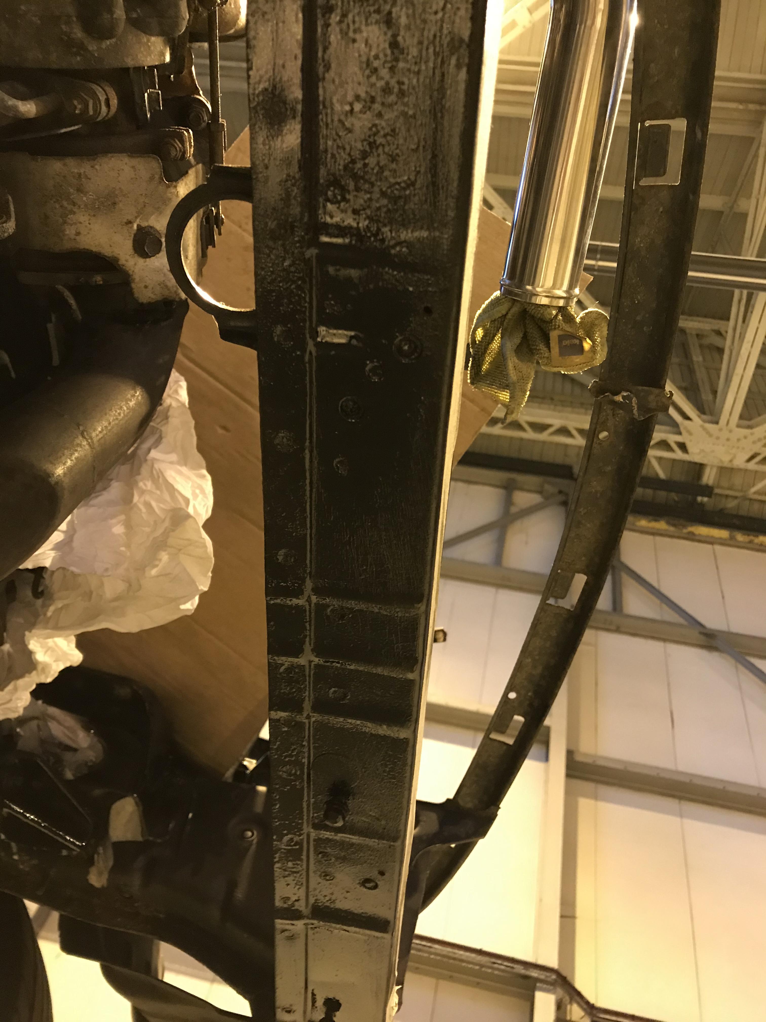

Pikey009 Posted October 14, 2020 Author Posted October 14, 2020 So the fan is still on permanently. Due to this, I decided to Take the rad back off (hadn’t filled the coolant system up anyway) strip, clean and paint where the lower rad bracket mounts to and underneath the battery mount. Quote
