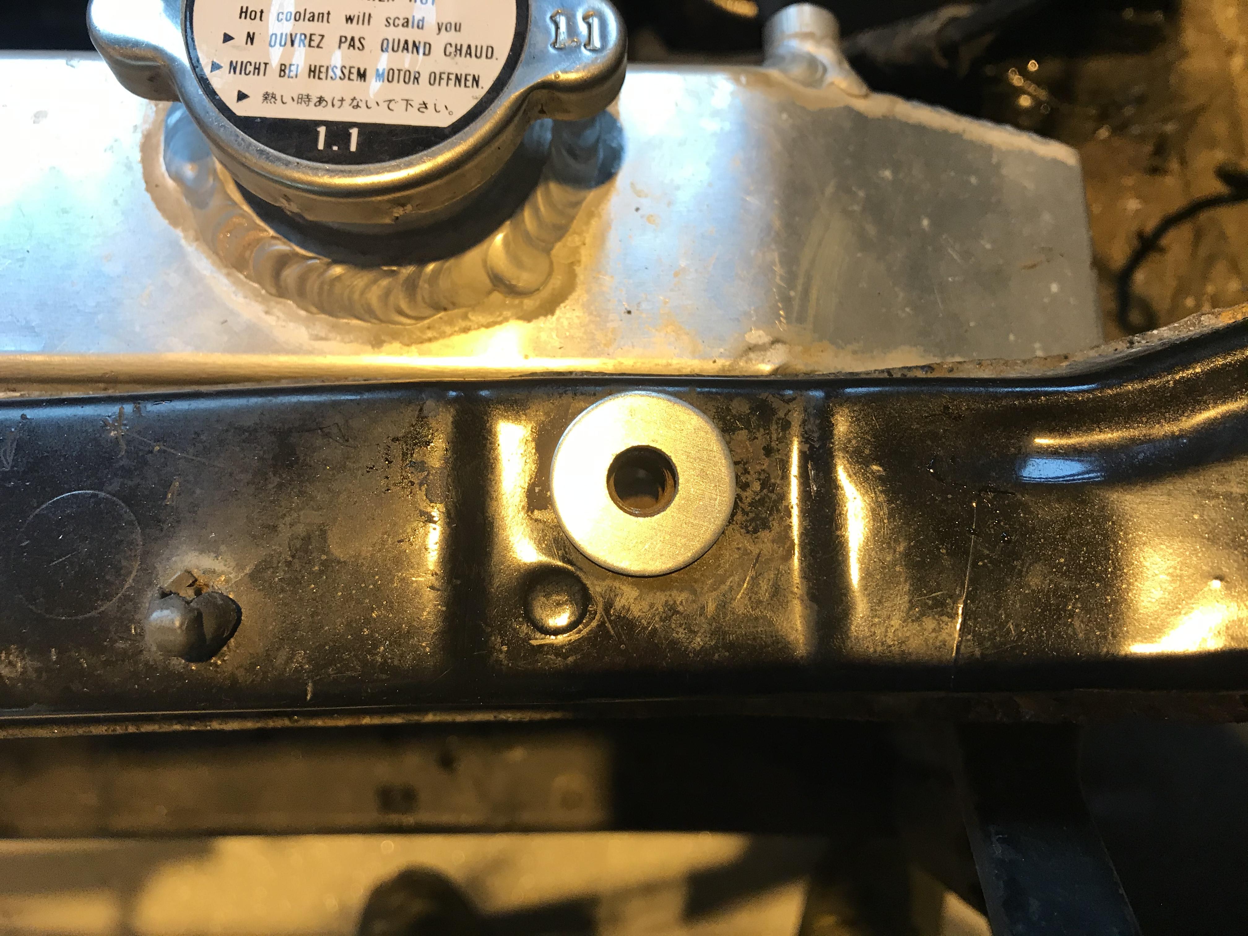

Forgot to mention, I never knew there were already two threaded holes for the lower half rad bracket, was chuffed to bits. Just re-cut the thread to avoid any issues. The top mount doesn’t sit low enough on the radiator for my liking to I just put a washer in the recess then fitted the mount over the top. Keeps it nice and level and gives it much more purchase on the radiator

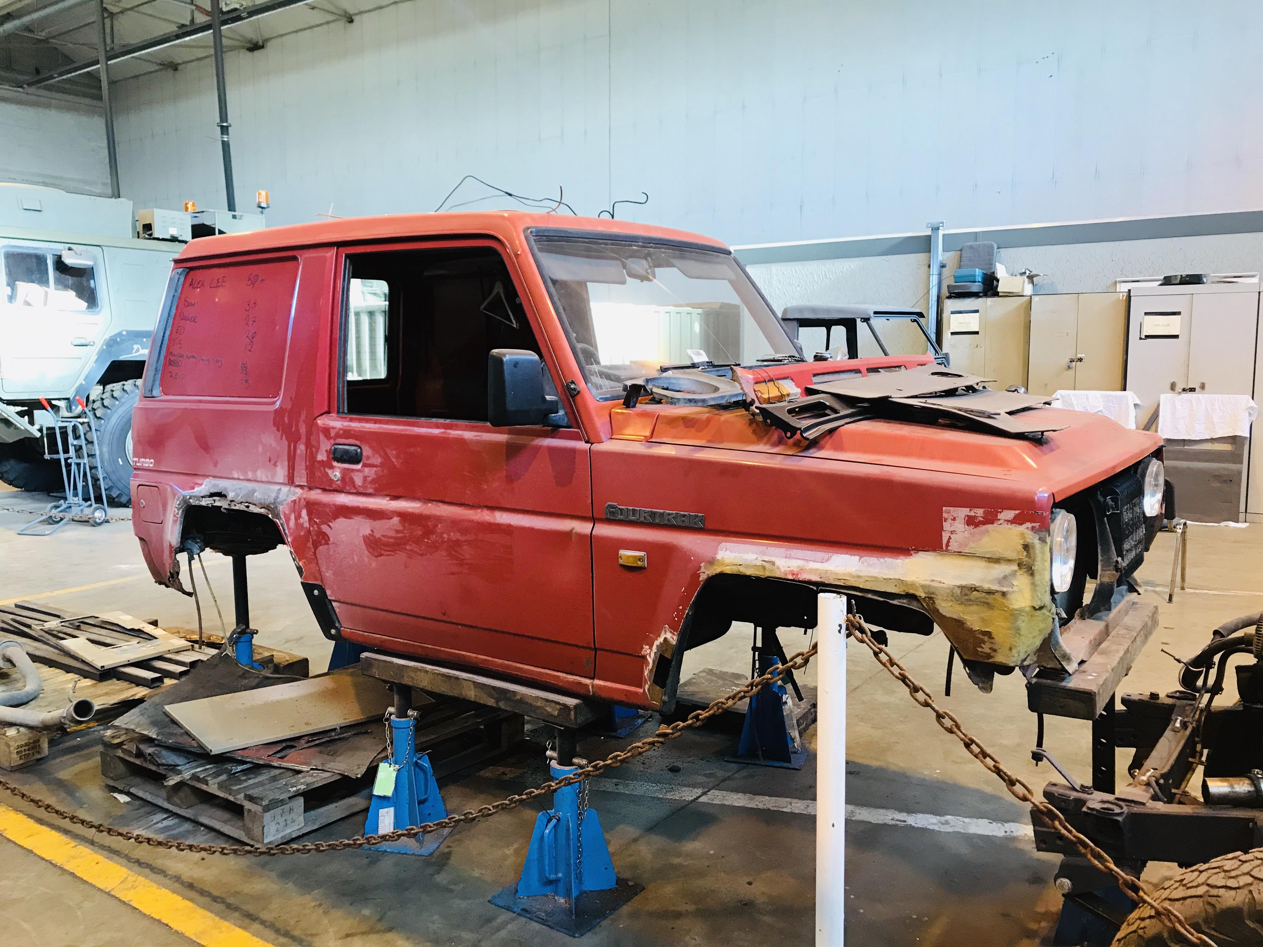

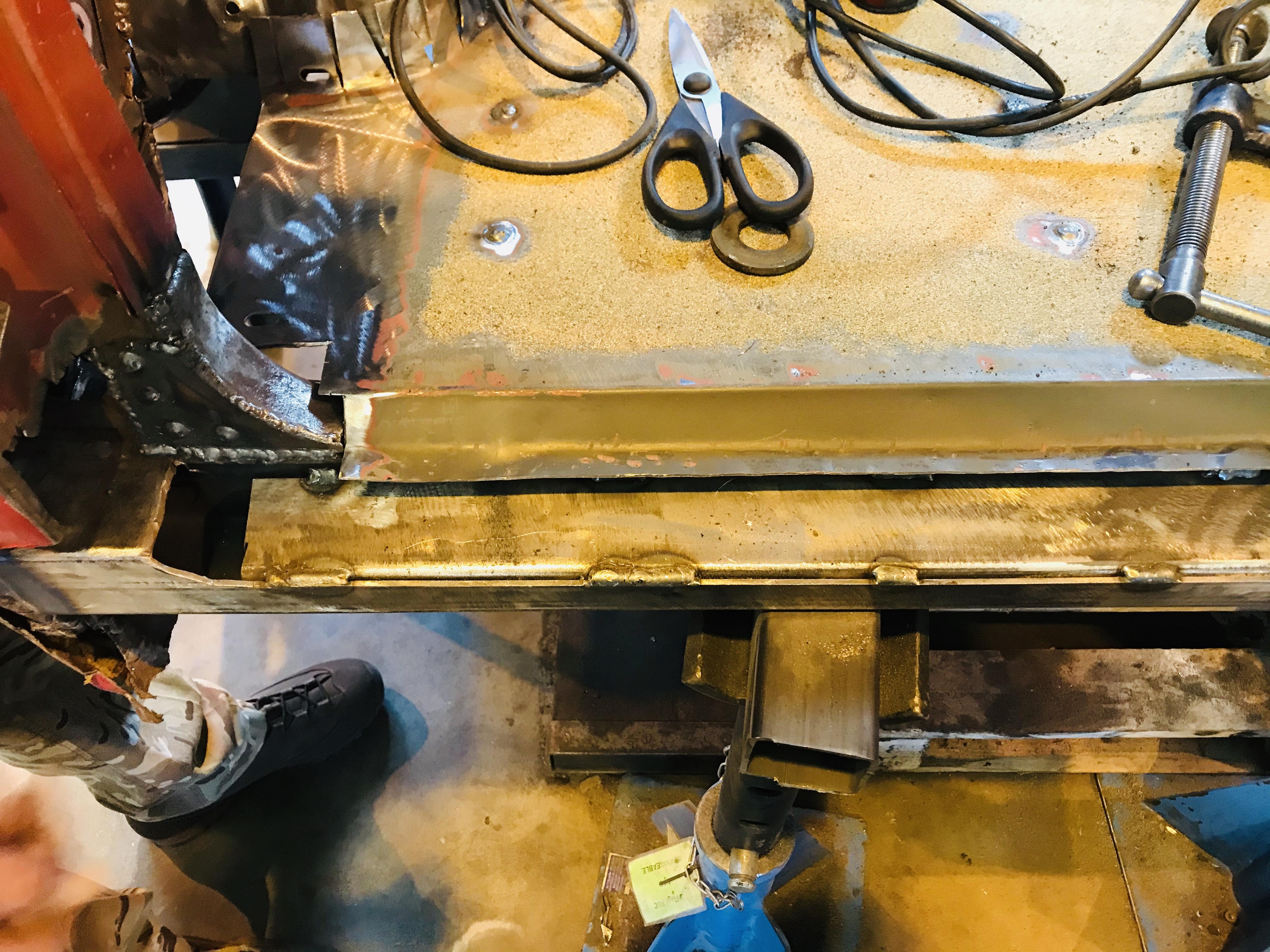

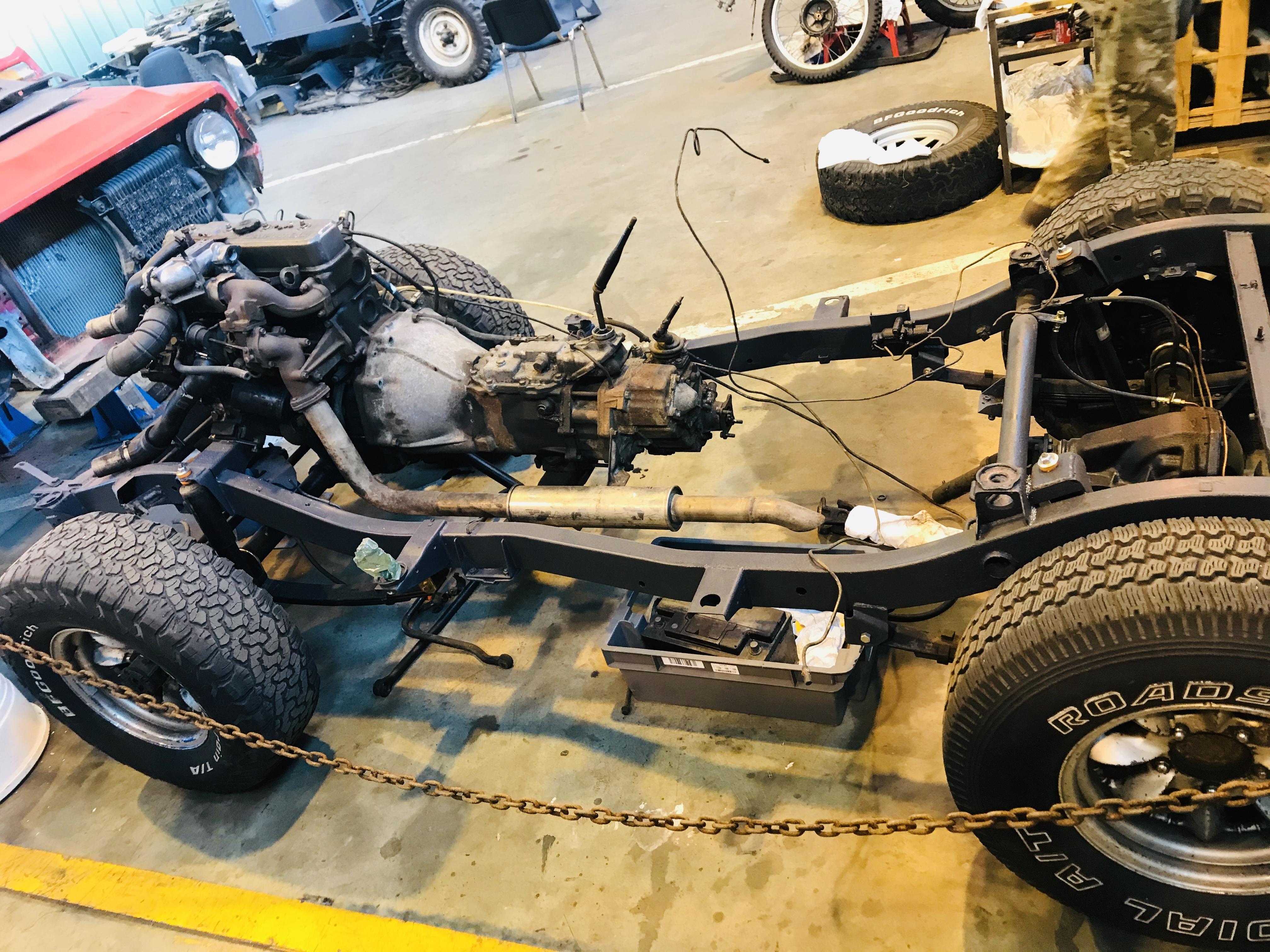

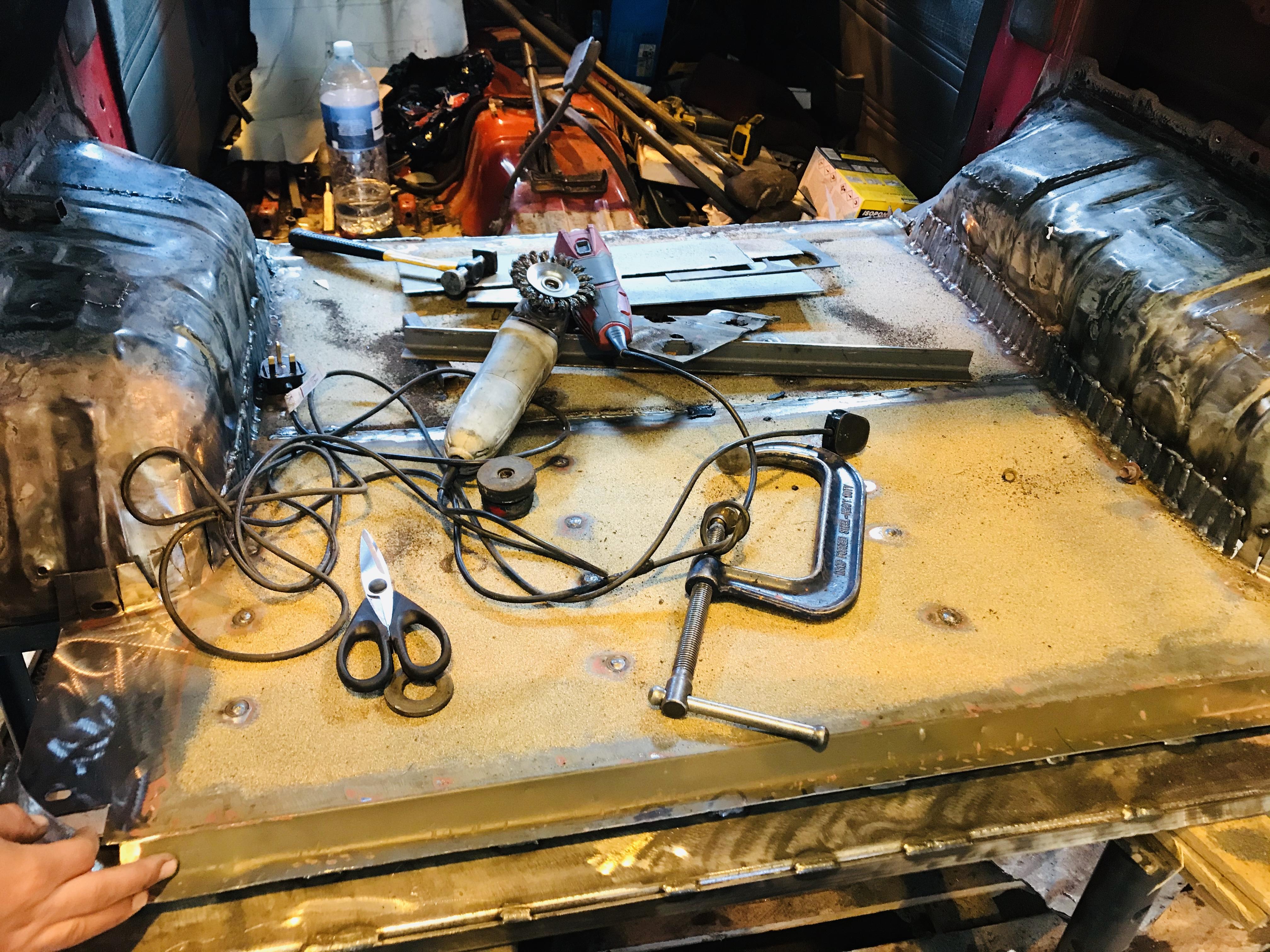

Thought I was making good progress until I went to see how my mate was getting on with his four-track. He bought it with a fresh MOT, started digging in to it and erm, the chassis needed a completed restoration as does most of the body which turned out to be structural. How the hell it passed an MOT I’ll never know!
WOW makes my inner arches seem pretty minor ,good progress on the GT

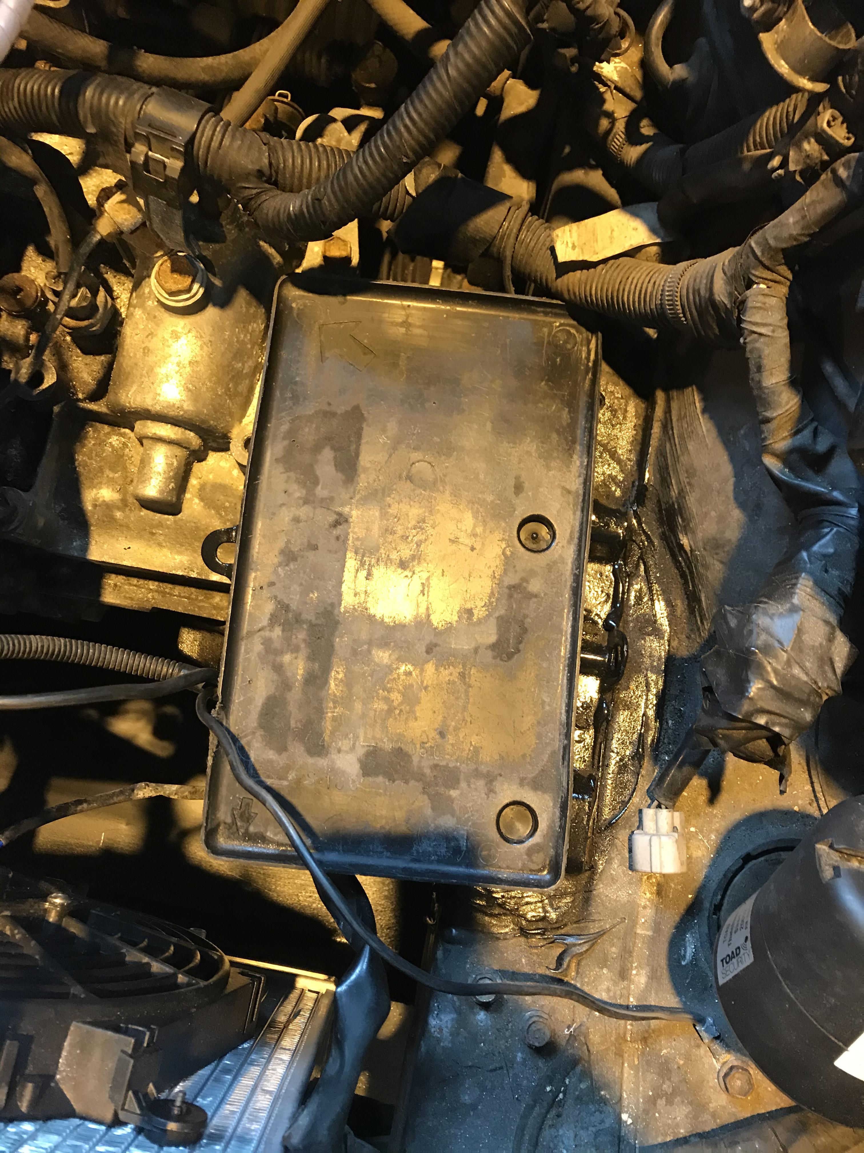

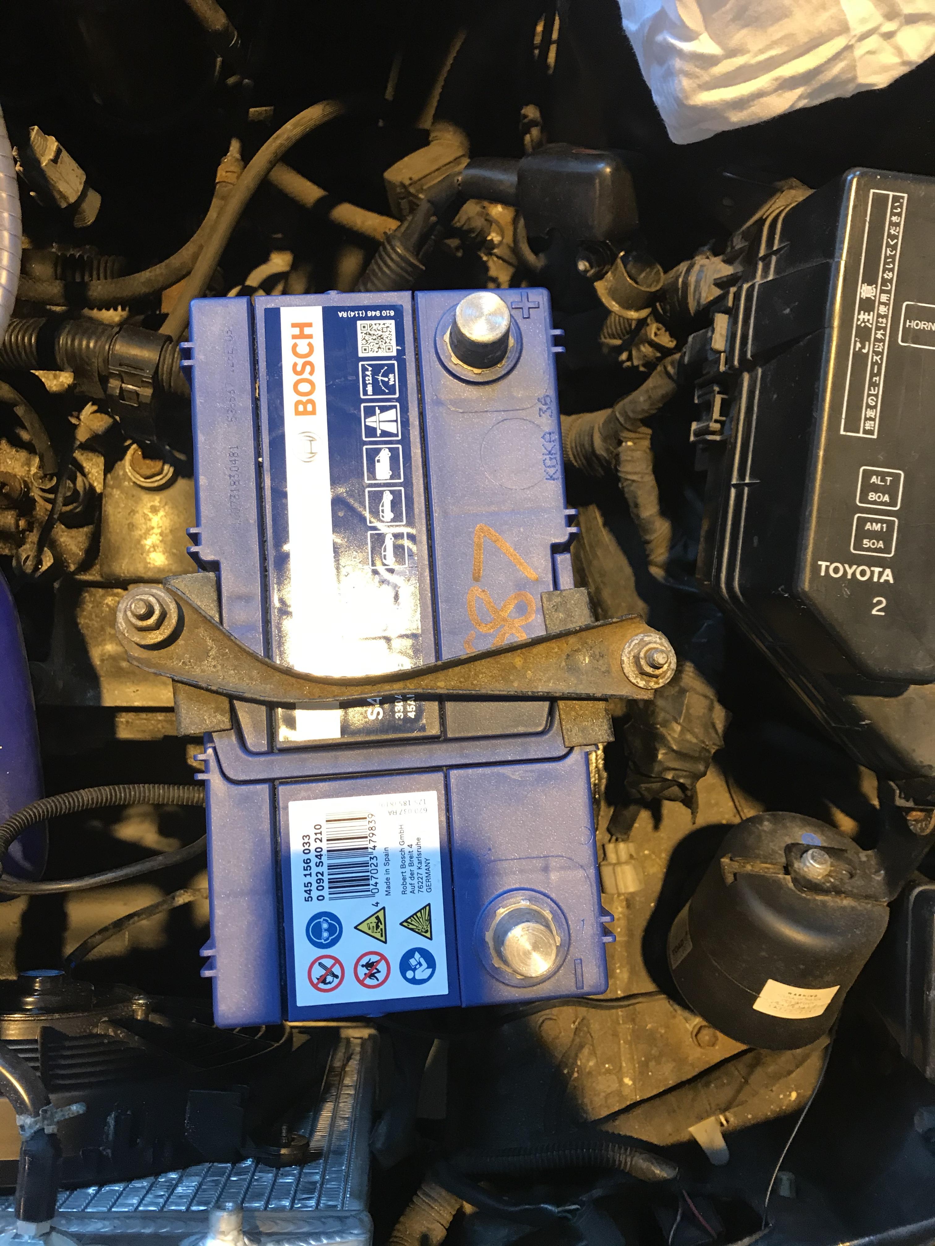

I’ll make no apologies for this post of a battery tray and clamp 🤣 For this car it’s a complete novelty compared to the battery being sat on the chassis tied down with some random bit of metal.
Edited by Pikey009
It’s getting a fresh lick of paint today, can’t be doing with any surface rust. I’ll also be fitting the door stays and the new weather strips.

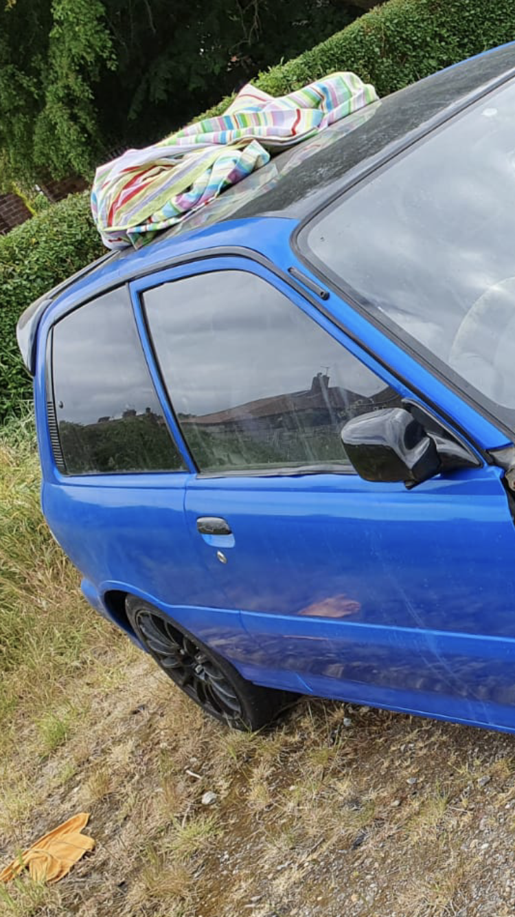

7 hours ago, glanzadude said:
Looks great. Nice colour blue on the Gt, nice to see a other colour then stock colours all the time
Thanks mate, I wasn’t sure of the colour at first but it’s really growing on me. I would prefer it the original if I’m honest though!

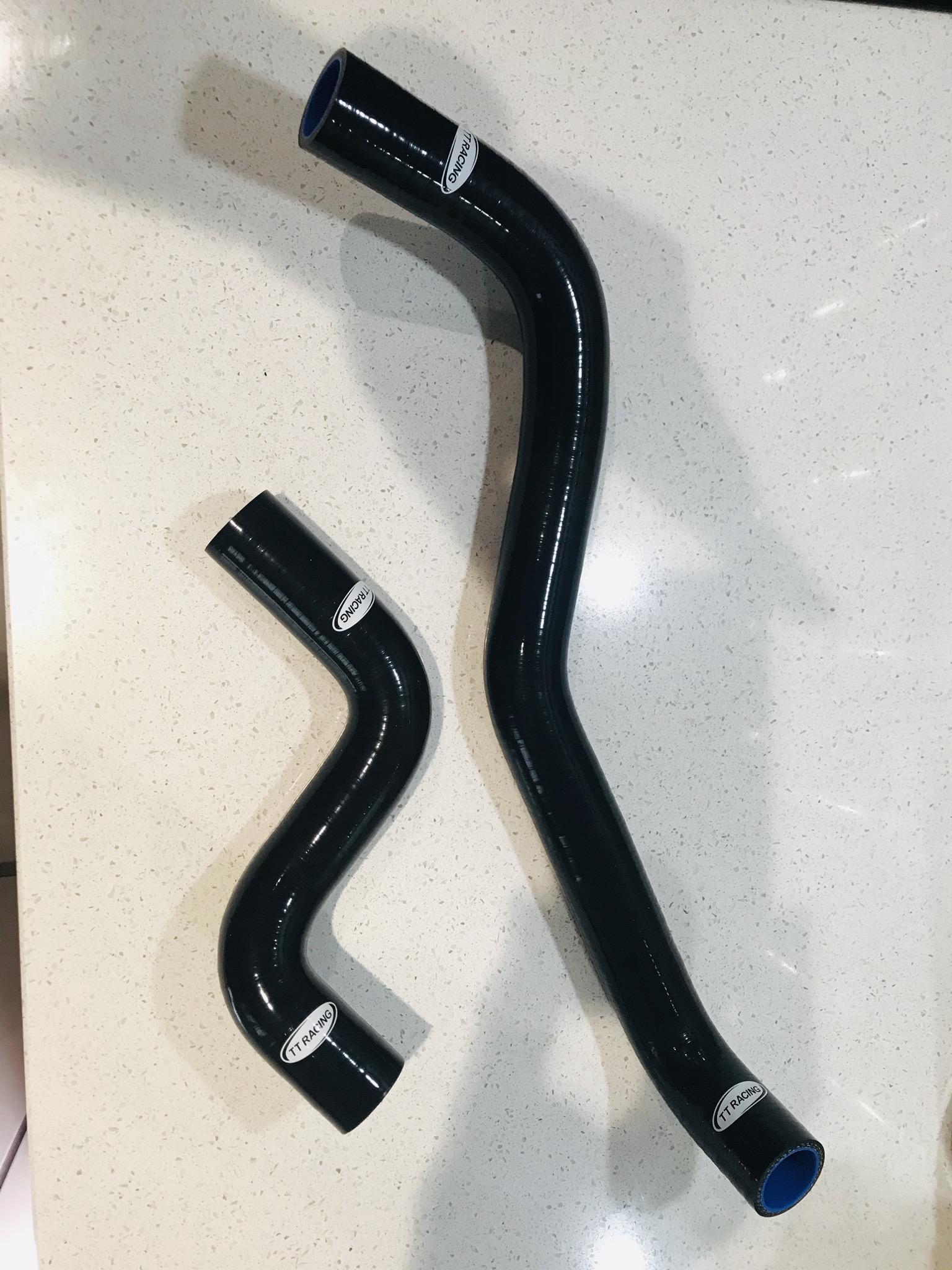

Went for these hoses in the end, bit more pricey but the quality of them is decent. Looking forward to getting back to the car on Tuesday and cracking on.
