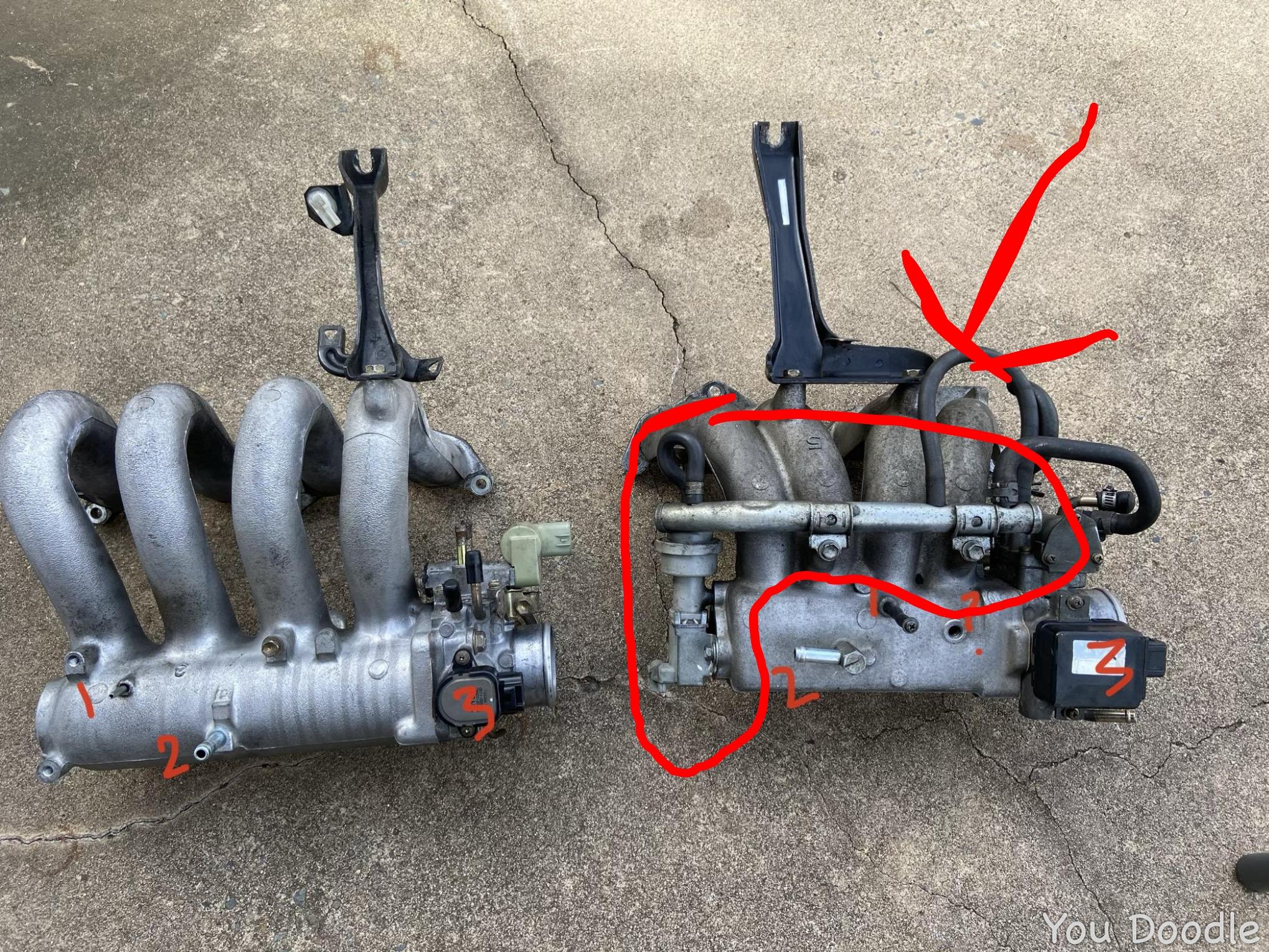

Yeh I'll fire them up.
If you visit my build thread listed just under my user name you will find on the first page at the top a list of all bolt on mainly engine components that are needed to convert a 4efe engine to a 4efte. Make sure these come with the engine. The only thing I think I've not listed is the 4efte inlet manifold which houses the 4efte intake air temp sensor. Which will be needed. The 4efe sensor is located in the air box (it's no good here on a turboed engine)
The sensors are different in looks but operate on the same resistance.
What you will need to do is rewire your temp sensor plug onto the 4efte sensor (the plugs are different).
If you also decide to keep the waste spark ignition system (use a piggy back controller)
You will have to swap the oil pumps over from the original 4efe. This houses the crank position sensor.
As well as use the original 4efe throttle body which uses veriable resistors throttle position sensor. The 4efte uses switch type.

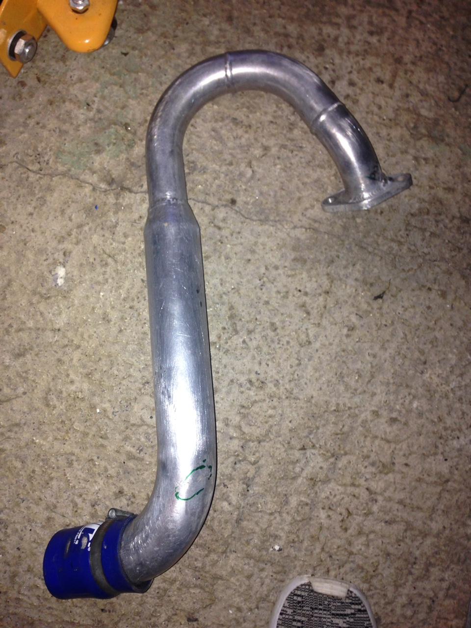

to start the exhaust system build you could get 1 of these. This bolts to the ct9,ct9b and will need cutting and modifying in order to clear the corrola front engine/gearbox mount, but it has the turbo flange and piping to work with. For this price it's a bargain to work with.
https://www.ebay.co.uk/itm/Mild-Steel-CT9-Decat-Downpipe-Toyota-Starlet-GT-Turbo-Glanza-V-EP91-EP82-4EFTE-/233330515233
you can see in the picture were the standard 4efte lambs/02 sensor goes in the decat/down pipe. If you want to use this for a wide band lamba sensor-gauge or your original 02 sensor will require it wiring extending to reach.

you will be able to get this to fit, the only other thing to do is either search for a ct9 bolt on hot pipe (this is the part of the intercooler kit that bolts directly to the turbo. Or use the kit and have a ct9 flange made (easy to do yourself) and weilded to 1 of the pipes in the above kit that has been cut to size. (You will have to cut down most of these pipes in the kit to fit. (Please clean them out before installing)
what a ct9 hot pipe looks like, hdi make:

I've been messaged on the Toyota owners site from a lad in the UK ho has fitted the 4efte power inlet manifold to his E11 corrola.
He has mentioned a difference in the idle control valves on the 4efte and E11 4efe, also the throttle bodies are a slightly different shape, the throttle body off the 4efe e11 bolts onto the 4efte manifold but overhangs on the bottom edge by afew mm leading to a leak. The way he fixed this was to make a spacer plate of flat 2mm thick aluminium cut to the shape of the 4efe throttle body. This sandwiches in-between the throttle body and manifold sealing things. Because of your engine control unit you need to run the 4efe throttle body.
The 4efte idle valve will also want to be removed along with the vacuum chamber/pipe it's attached to located/bolted to the rear face of the 4efte manifold. You will have to tape/thread the hole the 4efte idle valve locates into the 4efte manifold and fit a blanking plug sealing the manifold. I'll post up pictures of the 4efte idle valve and vacume chamber.
Precious info I never read in any description before. Thanks
