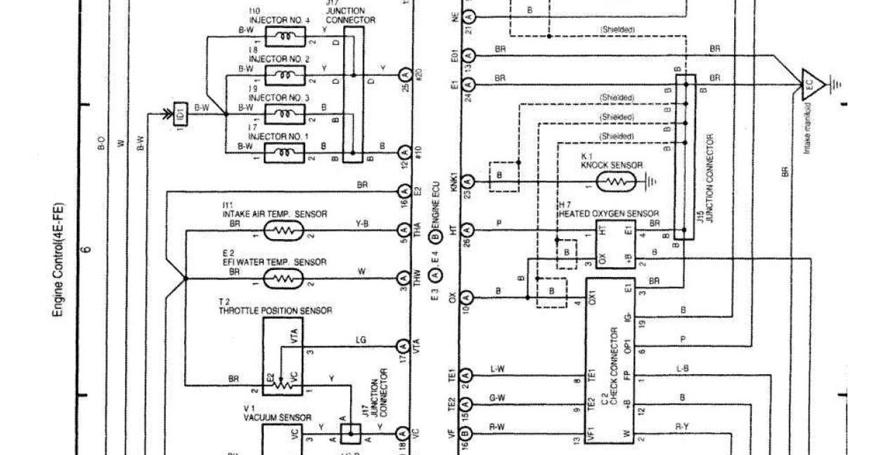

Sam44 Posted November 1, 2020 Share Posted November 1, 2020 (edited) Yeh very much agreed the 4efe will probably need engines seals like valve stem seals. And again the knock control is very very much recommended for higher compression engines like the 4efe. This was why high load ACL bigend bearings were recommended to me straight away while doing the 4efe+t conversion. As well as running it on higher octane fuel. Which you will find will cost you more over a long period of time. The ep82 and ep91 nock control does only operate in the lowwer rpm range. so im hoping the later and faster ems on the e11 4efe does a better job These are all reasons why for the money and limited experience I'd go for the 4efte complete. The 220hp is reference to the injector limit not engine limit around 160hp is what the tunning shops get on turboed 4efe with a long life expectancy. Cheers again claymore I'll edit the list now. List has been updated on the build thread. I've also added the oil filter housing main large hollow center bolt and sealing washer. Yeh the original power steering pump I've recommended keeping. You can remove some of the lower 4efte lower bracket and make a joining bracket to fit. I've also been told the lowwer mount on the E11 power steering pump can be removed and a new bracket fabricated to fit to the 4efte lower mount. This mount is needed to clear the offset 4efte oil filter housing & oil filter. The other option here is to design the turbo oil feed and supply like how the lad in the video above has done this will not affect the power steering pump. Edited November 1, 2020 by Sam44 Quote Link to post Share on other sites

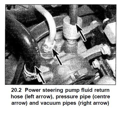

Sam44 Posted November 2, 2020 Share Posted November 2, 2020 (edited) just out of interest how much could you get a used low mileage 4efe engine for. in the video above ep80 turboed, we see a different approach to installing a turbo to a 4e engine. this means that not as many original 4efte parts are required also the power steering on the e11 would not require modifying. a simpler build to do, with parts being made from your local hydraulic hose repair shop (turbo feed pipe and return). the same approach stevei82 used to turbo his 4efe ep91 uk starlet, he might give you a run down on what he used if you message him on here, the link to his build is above. with the new use of what is know as the race spec rocker cover & catch can used a lot on the starlet builds you could sit your e11 at a commutable 130hp for now really quite easily on a tdo4l like in the kit above. your original clutch might hold up. id put the uprated corolla clutch (stage 2 clutch) in there for good measure, as well as a adjustable hks actuator so you can set the boost pressure right. the only worry I have with this approach is the volume of oil supplied to the turbo unit as well as the affects on the volumes delivered to the crank. I would up the oil pressure/volume if I used this method, with the simple washer in the oil relief valve, as well as making sure the turbo oil delivery pipe has the correct restriction diameter to not affect engine oil pressure and still maintain good delivery to the turbo. ill message the young lad that did the ep82 in the video link above I can see he will have been running this for awhile now, see if he has had any problems. you could then pick up a low mileage 4efe and get it sorted over a period of time ready to just drop in, and take more power. the interesting thing here is you can skim down the 4efe piston crowns to the 4efte compression with out any loss in strength. infact this will make the pistons lighter and able you to increase the stock rpm limit to the 4efte limit. the only other difference is the inlet cam and the valve springs are stronger for the higher rpm limit. ive been told to use acl high load bigends on this engine going near 170hp and past. which I think tunning developments uk sell for around £55. this engine would take 190hp all day long. a very respectable and hard to beat car. Edited November 2, 2020 by Sam44 Quote Link to post Share on other sites
