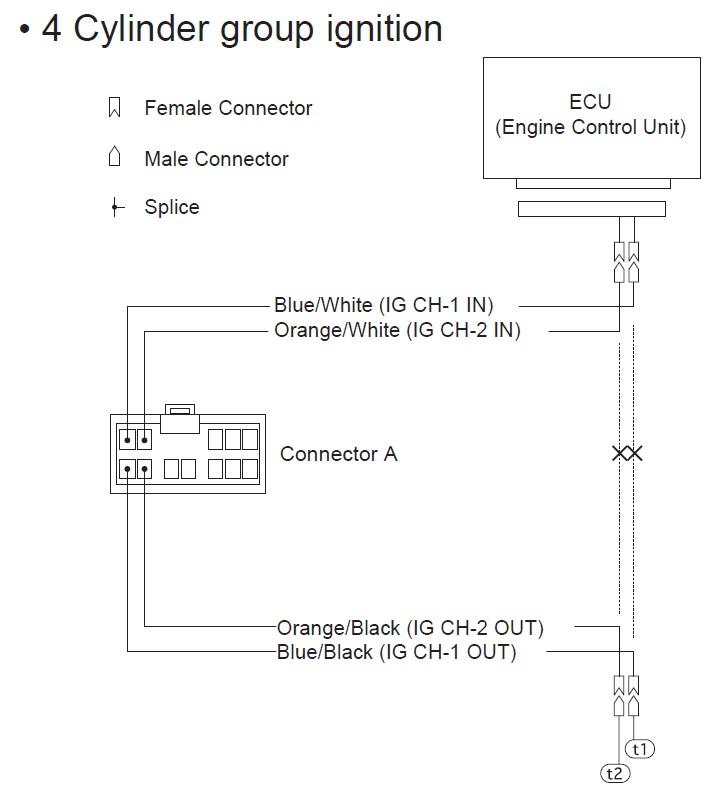

11 hours ago, Sam44 said:
the hks controllers look good and do clamp the map sensor voltage.  from what im reading, they seem to be map sensor orientated.
From memory the issue with the HKS F-con stuff is the tuning lisence. You can only get the software / licence to tune the ecu's if you are an F-con dealer? So home install and tune is not possible.
I was talking with a mate about det 3 last night and I seem to recall he mentioned that the Emanage ultimate can handle grouped ignition signals. Checked the archive and found this. Might work for the gen 3 DIS 4efe. Best to contact emanage and check if its possible before any purchases.
spot on: thanks again for your time, yeh i see what your saying about hks. i have found the software for the hks f-con pro online but the control units are £££ but you do only buy this once.
Turns out emanage blue has the same capability (wiring diagram) with the optional ignition harness added.
