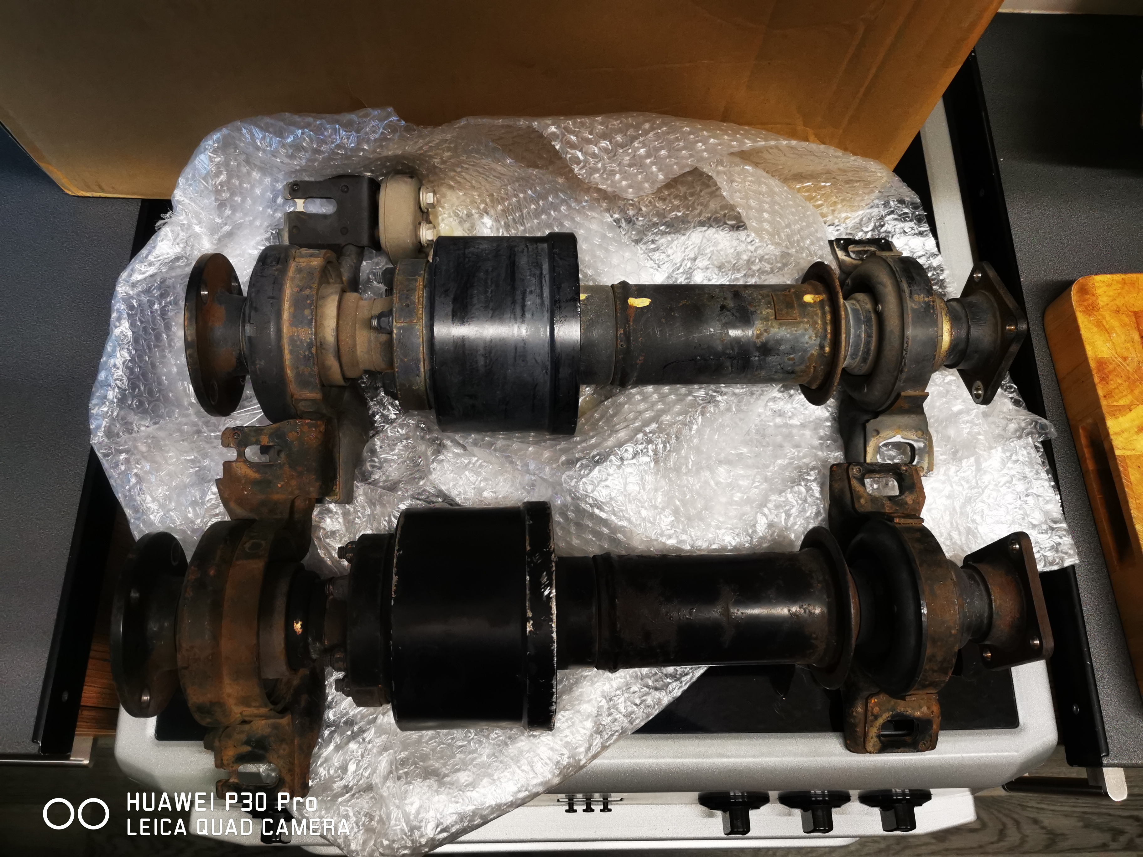

Took a while to find one as these are now discontinued by Toyota. But unlike my one which had gone solid this is working as it should. Can't wait to get my 4wd back as I had to drop the prop out to protect the diff and transfer box from damage.

It took a while to find one, tbh there's a fair few Toyota's that use very similar units that would almost certainly fit with modifications, failing that I had been in talks with a custom propshaft maker and a specialist in Land rover freelander viscous couplers that could tailor one to suit the starlet on a custom prop. This would have been considerably more expensive but would definitely work as its what the yanks are using now for their 4wd civic builds.
At the end of the day though this is the result I really wanted. A lot cheaper than custom. I can't tell you how relieved I was when I received it and tested that it was in good working order.

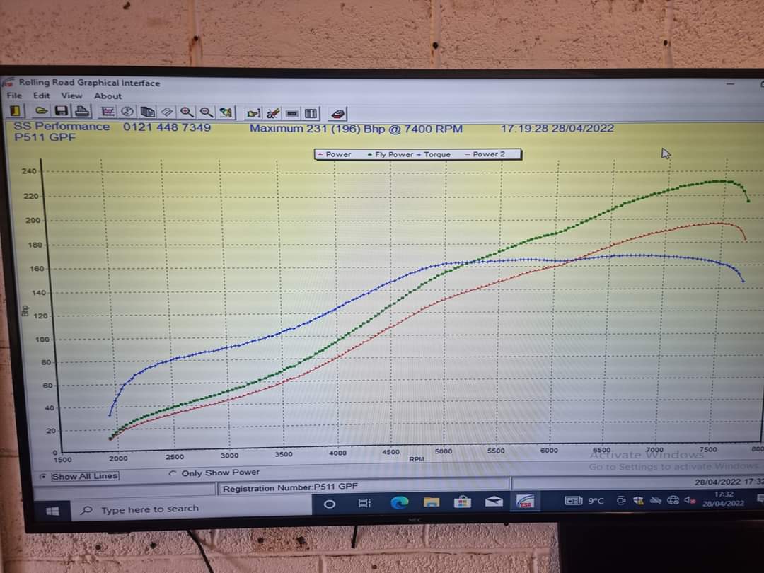

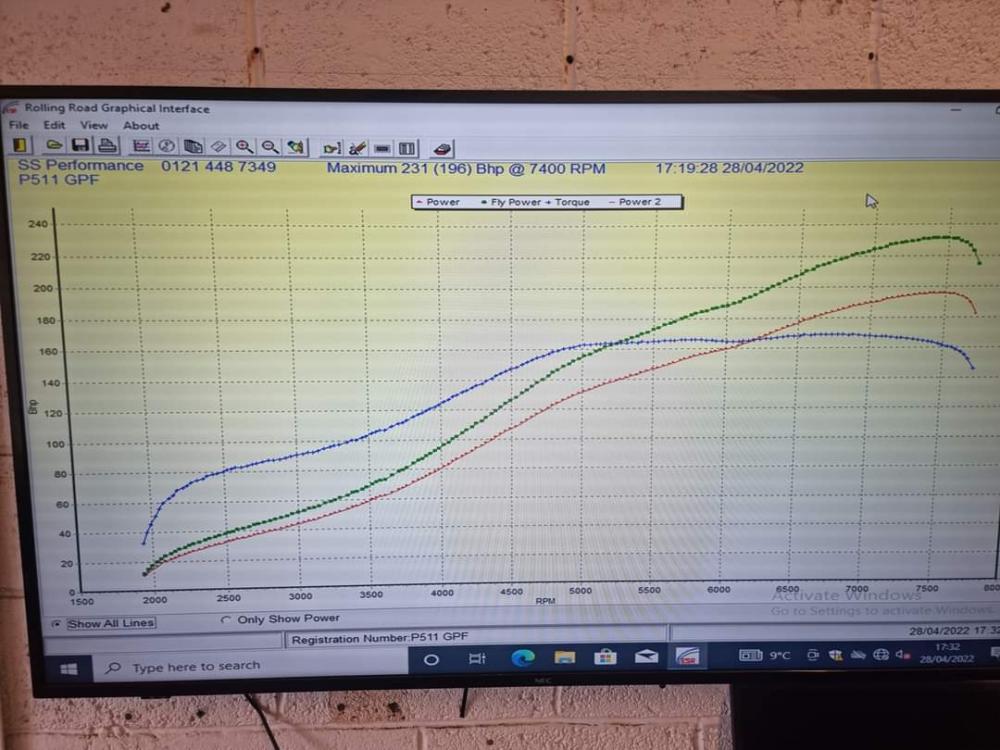

Cheers mate, dyno results are in.
Have to say I'm both surprised and impressed, Shaun clearly knows his stuff when it comes to tuning these cars. Can't wait to pick it up and feel the difference for myself.

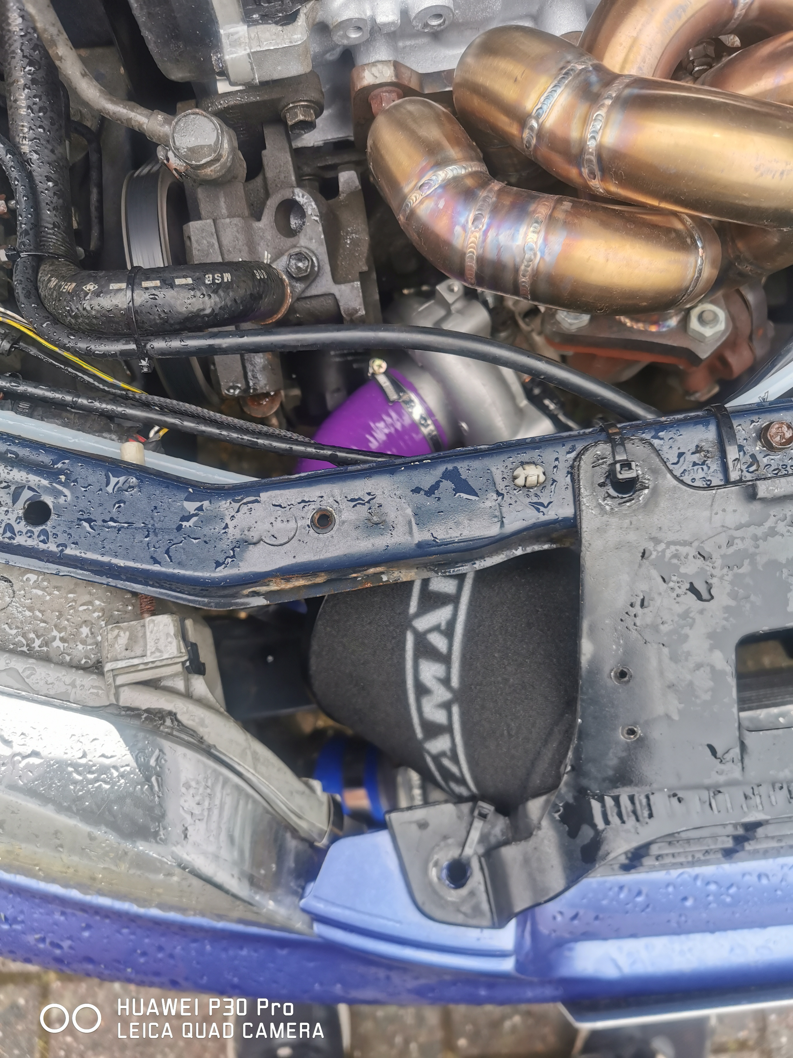

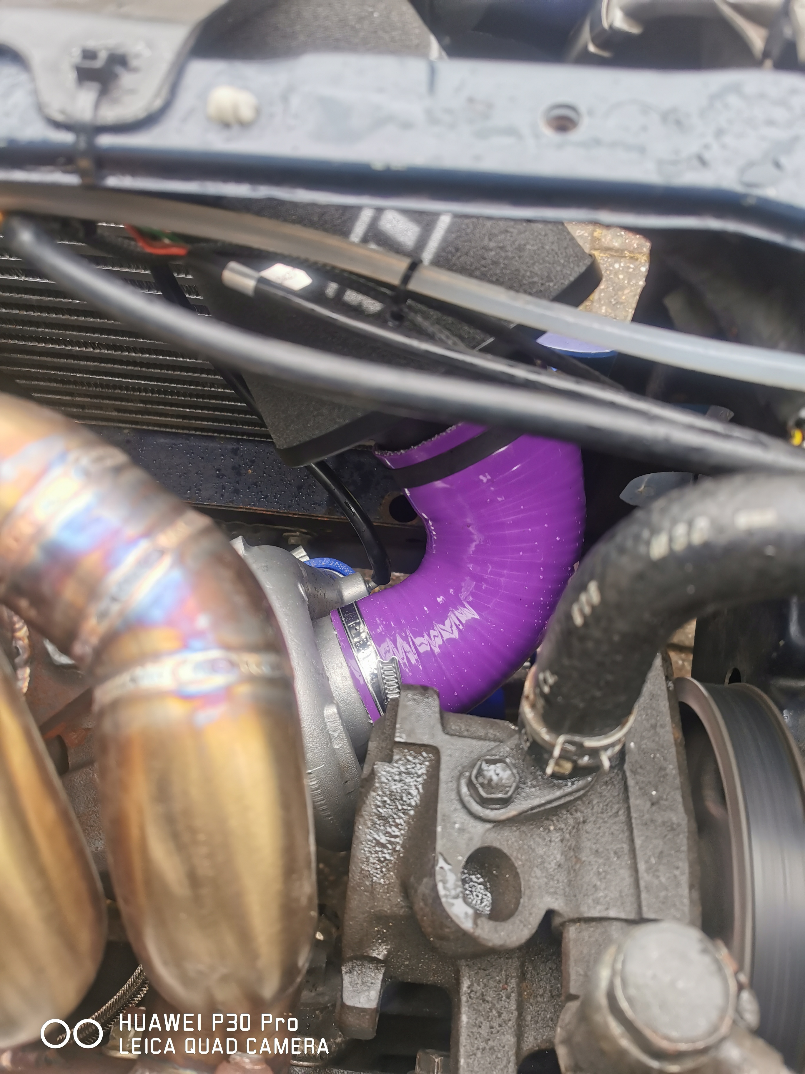

Only a small addition, but in my opinion an important one. Having seen the damage done when a friend sucked a rag into his turbo, it always makes me uncomfortable having no filter. Few quid on ebay and about 5 minutes to trim and fit, I'm feeling much more comfortable for the drive to jdm combe next week.
