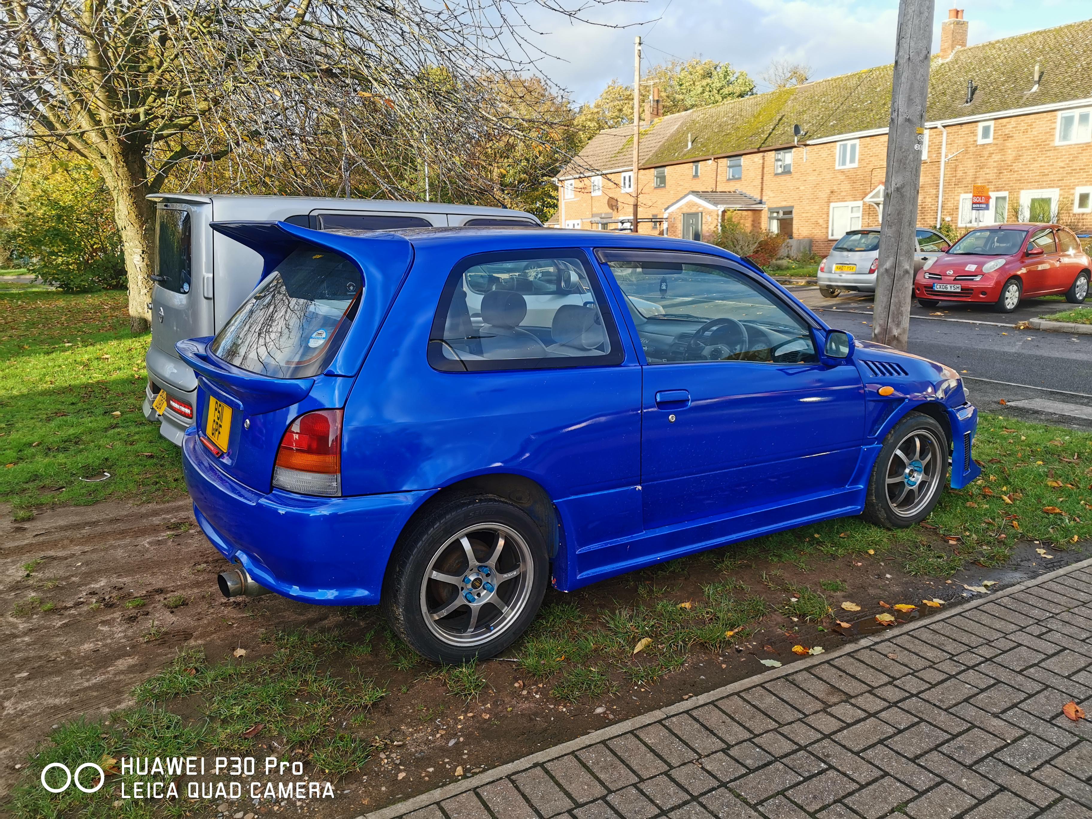

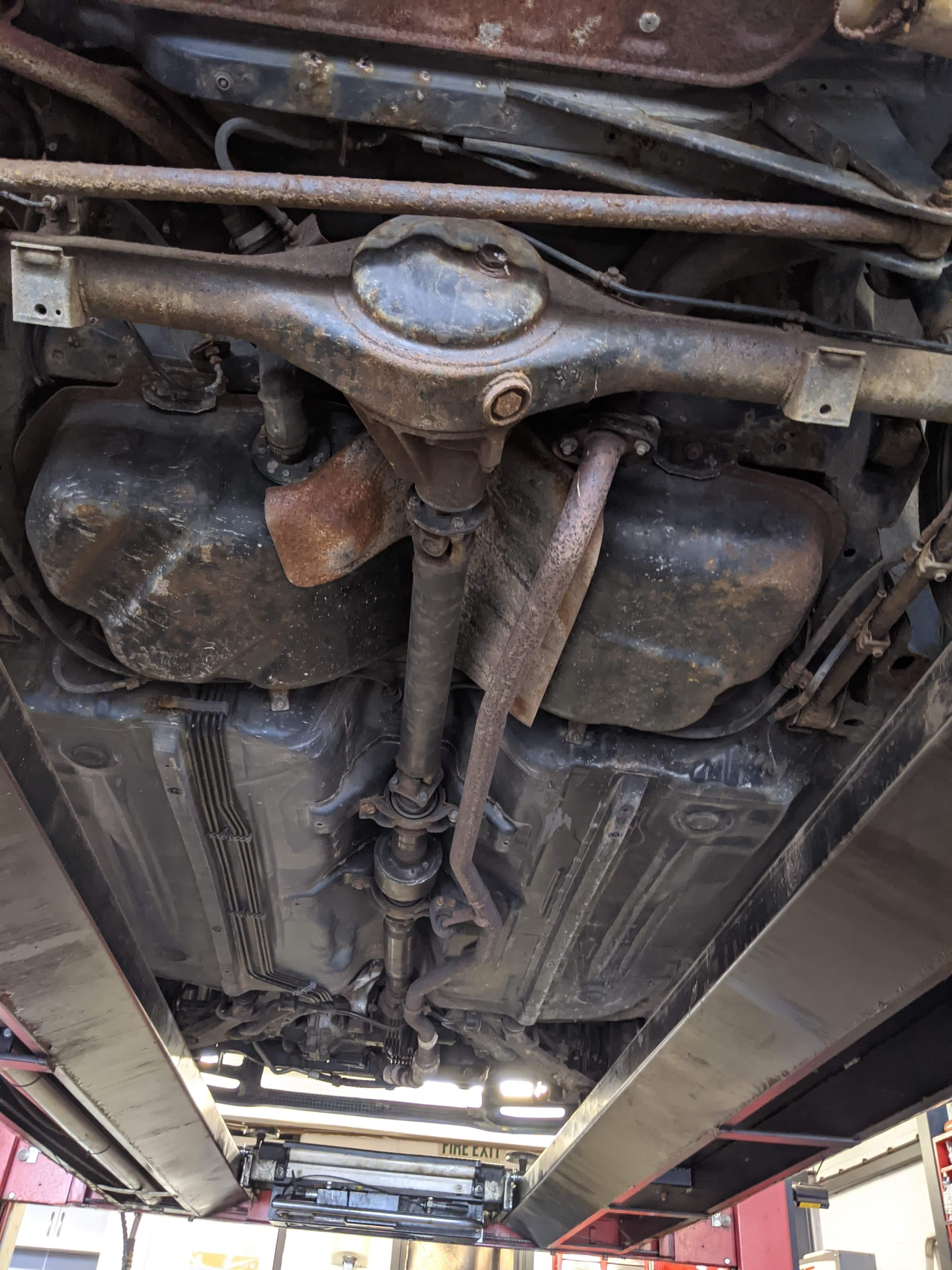

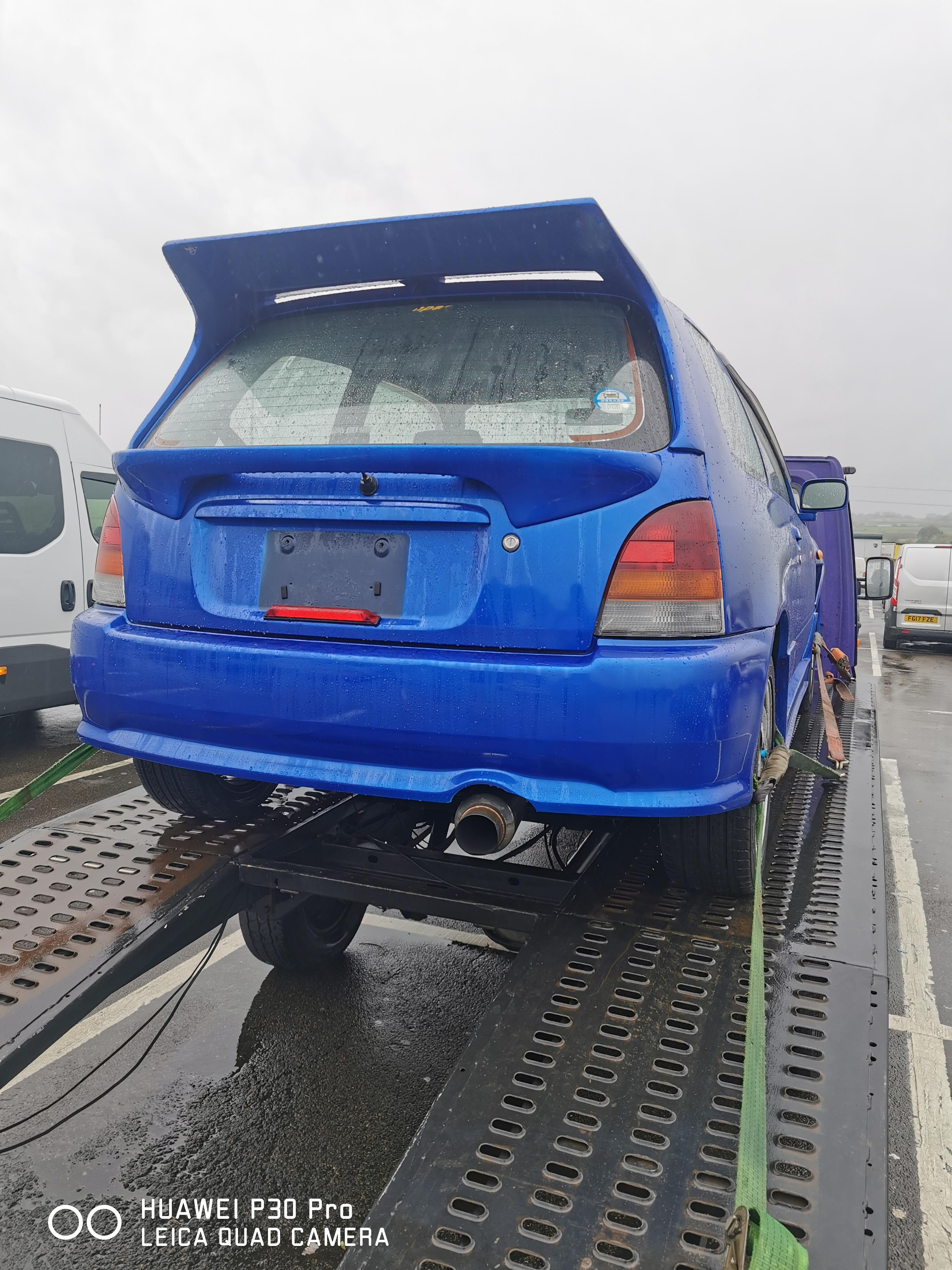

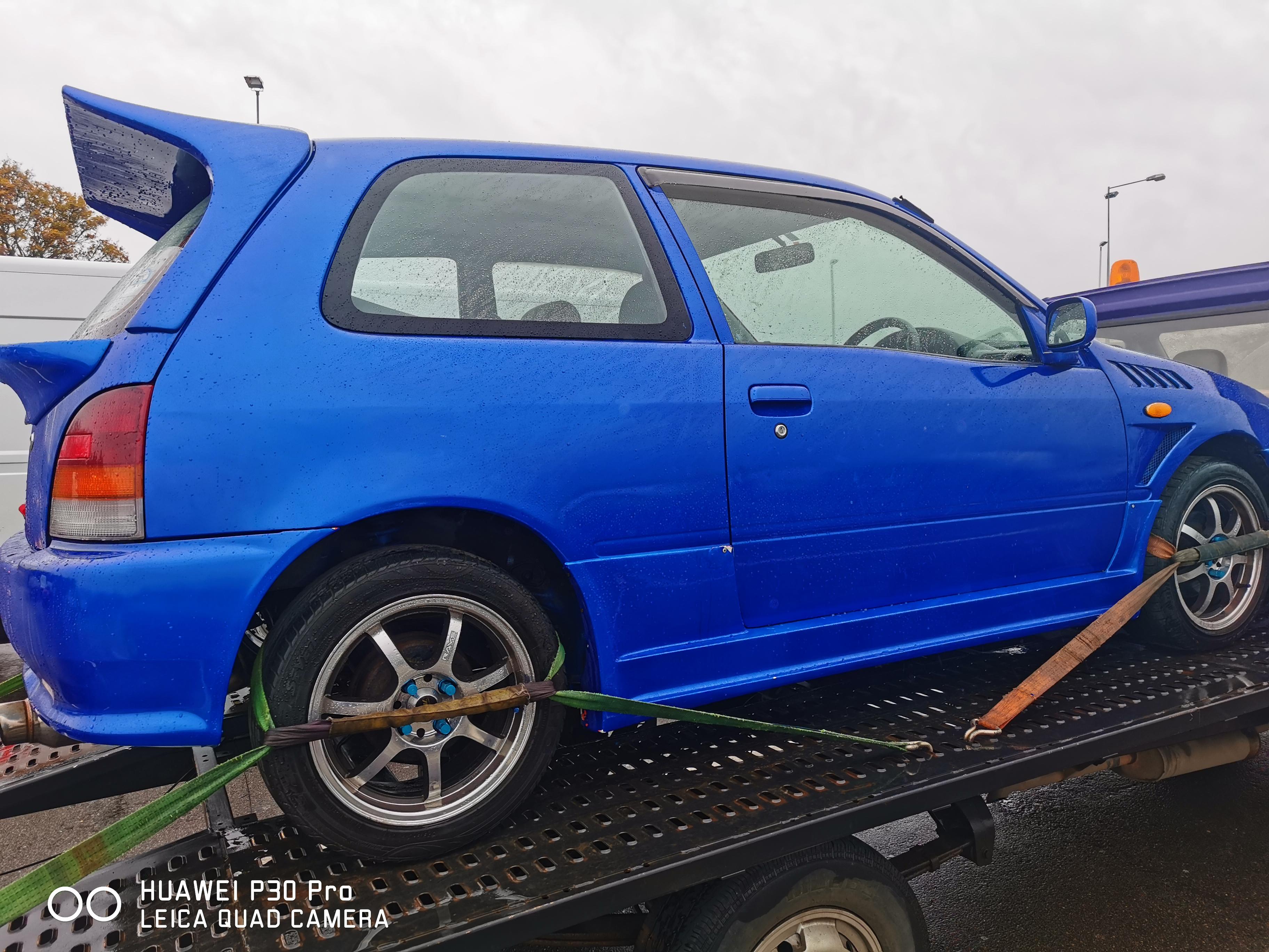

So fast forward a few months and it arrives, condition is every bit as rough as I was expecting. IMG_20201031_120919.thumb.jpg.8ee67fe0042e4c3ec1b23b56a0f34d47.jpgIMG_20201031_120927.thumb.jpg.625233809f7e25911bc9783fcc7d389a.jpgIMG_20201031_152137.thumb.jpg.6f49fda247fece391b50616469a5f055.jpgIMG_20201031_152152.thumb.jpg.484de1c554190642dda5c513411fa930.jpgIMG_20201031_152205.thumb.jpg.ecde3ce8ed9f79ef90fec04d832f175e.jpg

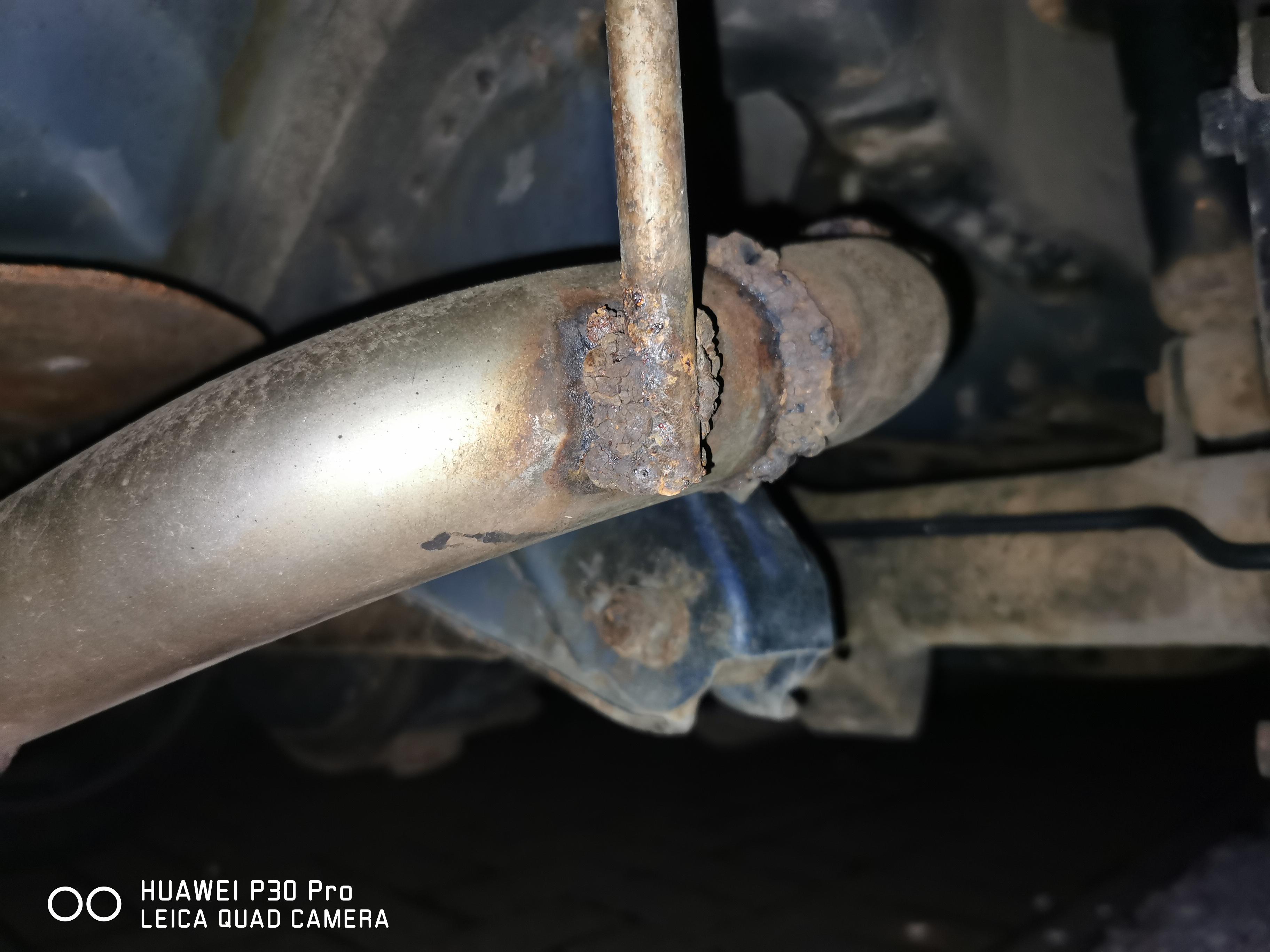

Underneath looks pretty good for the age, but of surface corrosion that will be duly treated but no real penetration.
received_434523114187589.thumb.jpeg.a49e04214dc335a3b859db693f2c570e.jpegreceived_833341894070270.thumb.jpeg.226afbbf33504c92fc08e436a20e2726.jpegreceived_341582960388195.thumb.jpeg.da414a7f9ccea9f28a4b0be4aedf9b68.jpeg

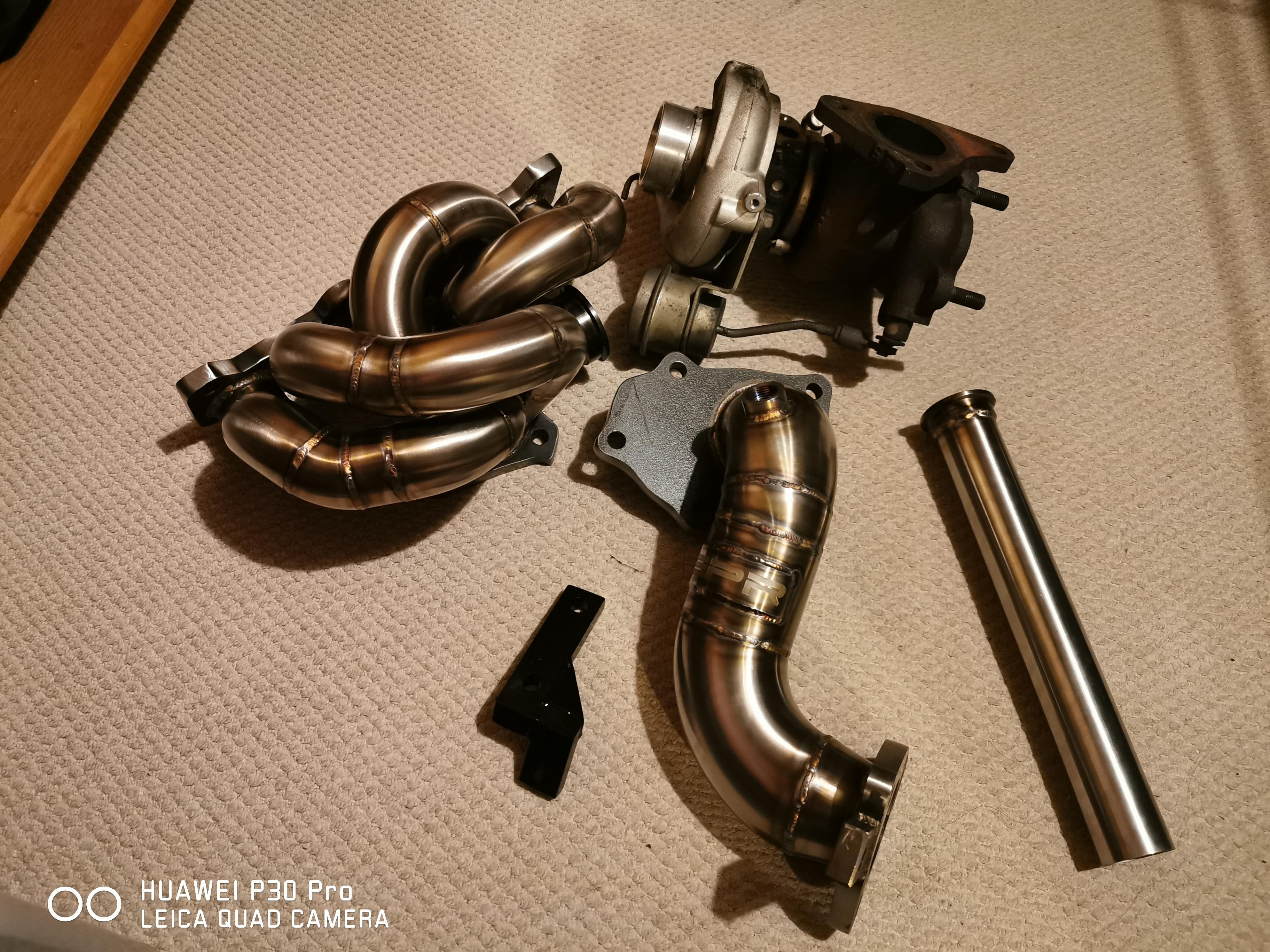

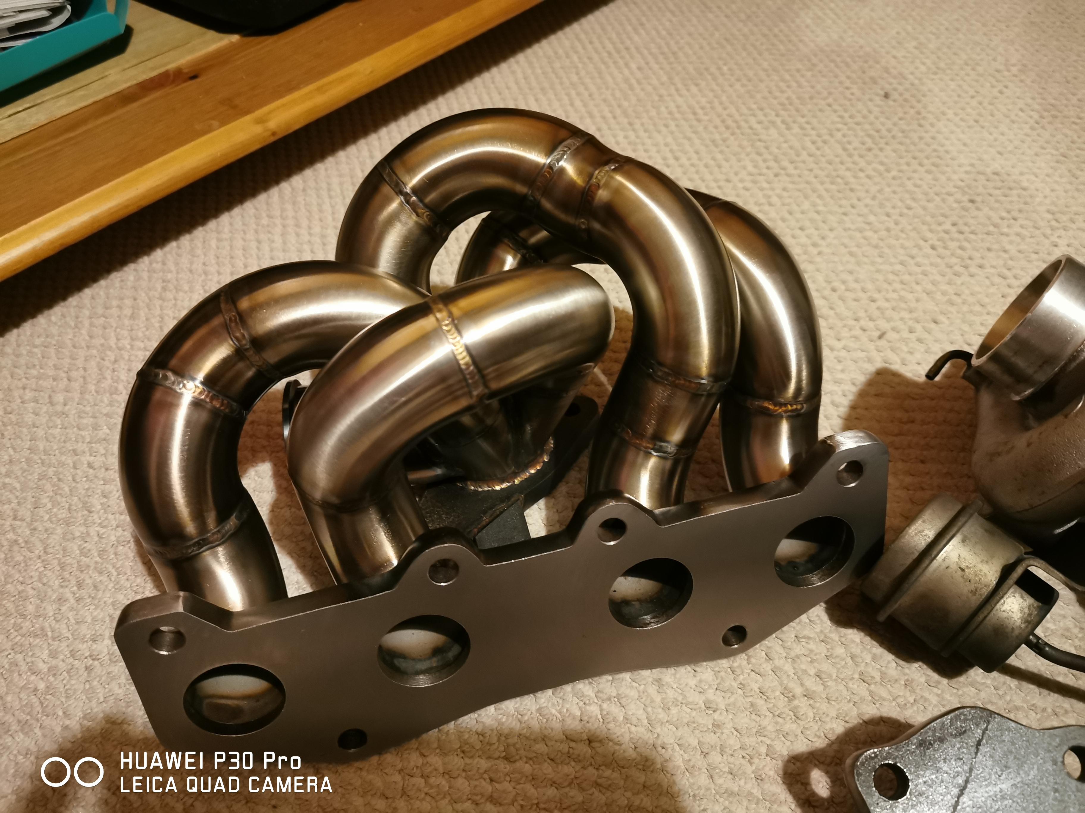

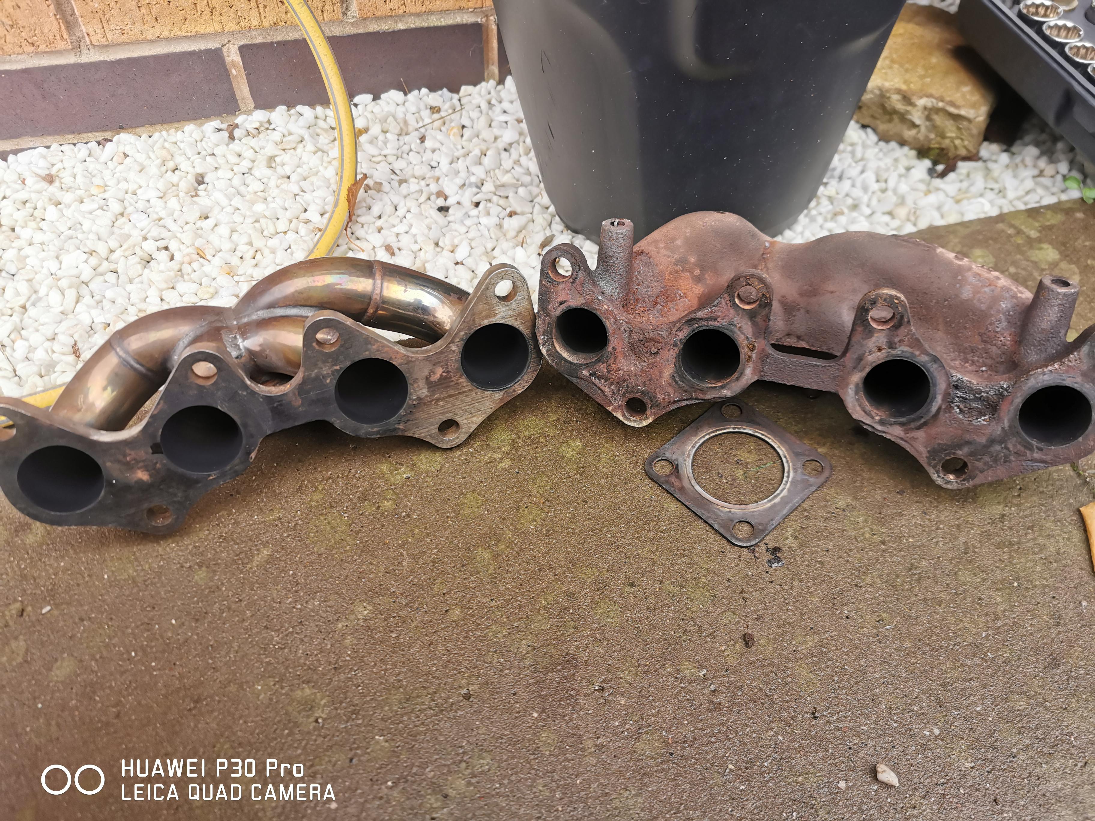

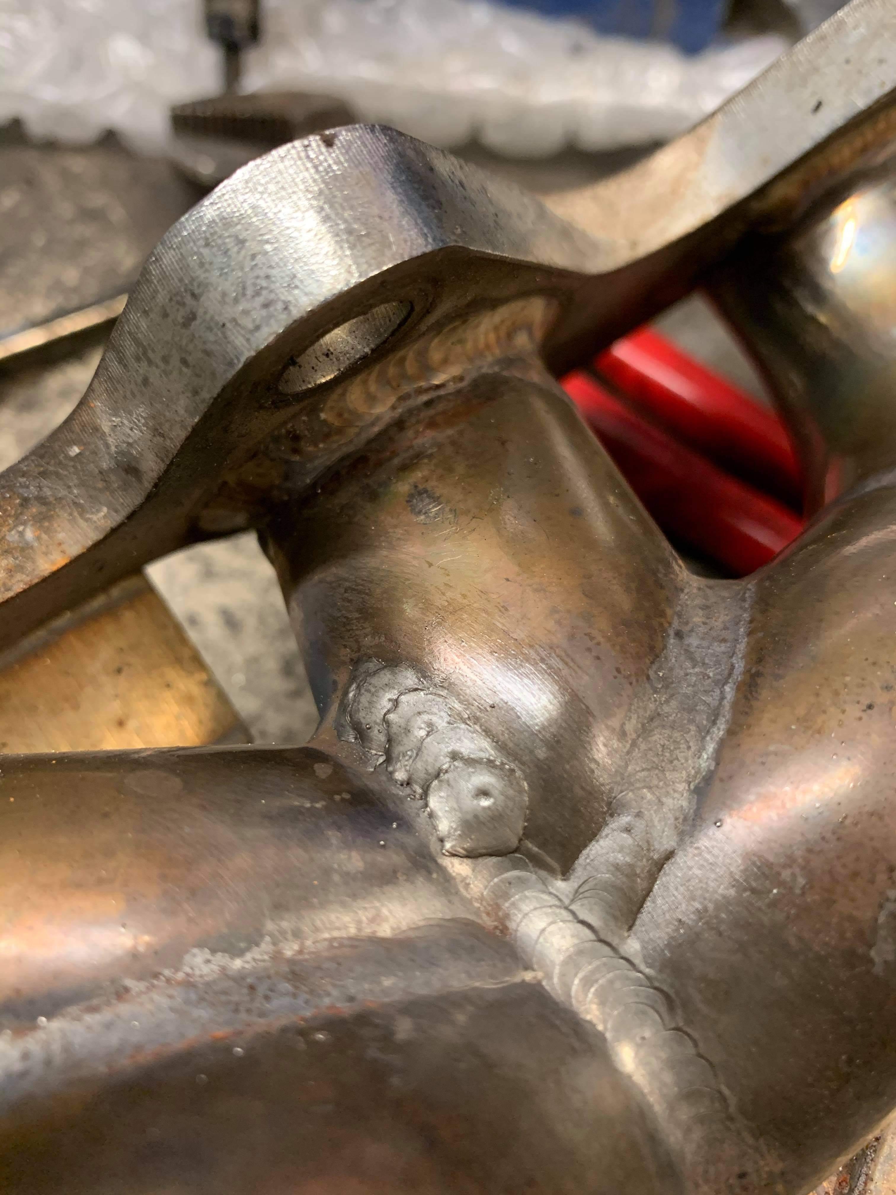

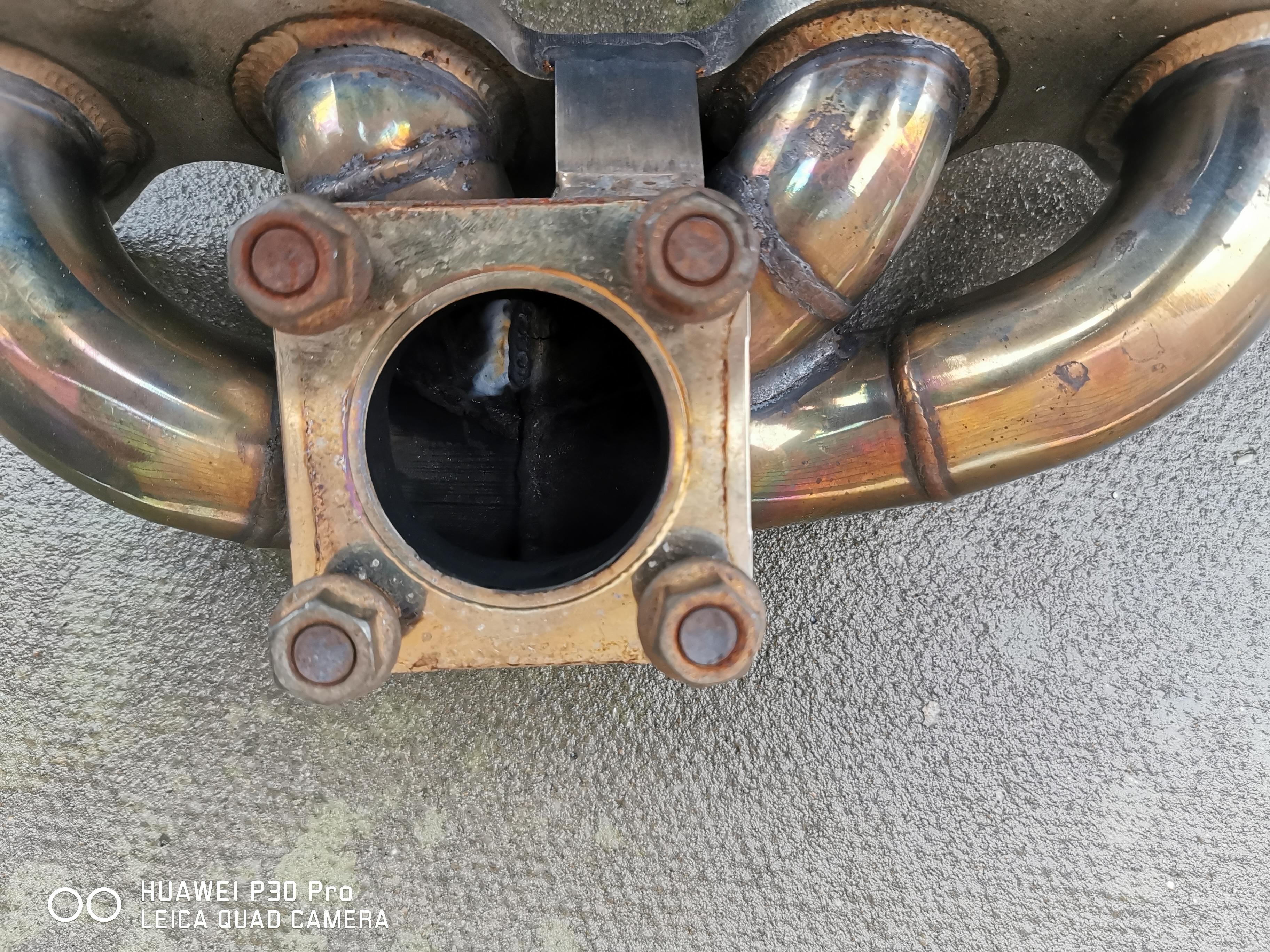

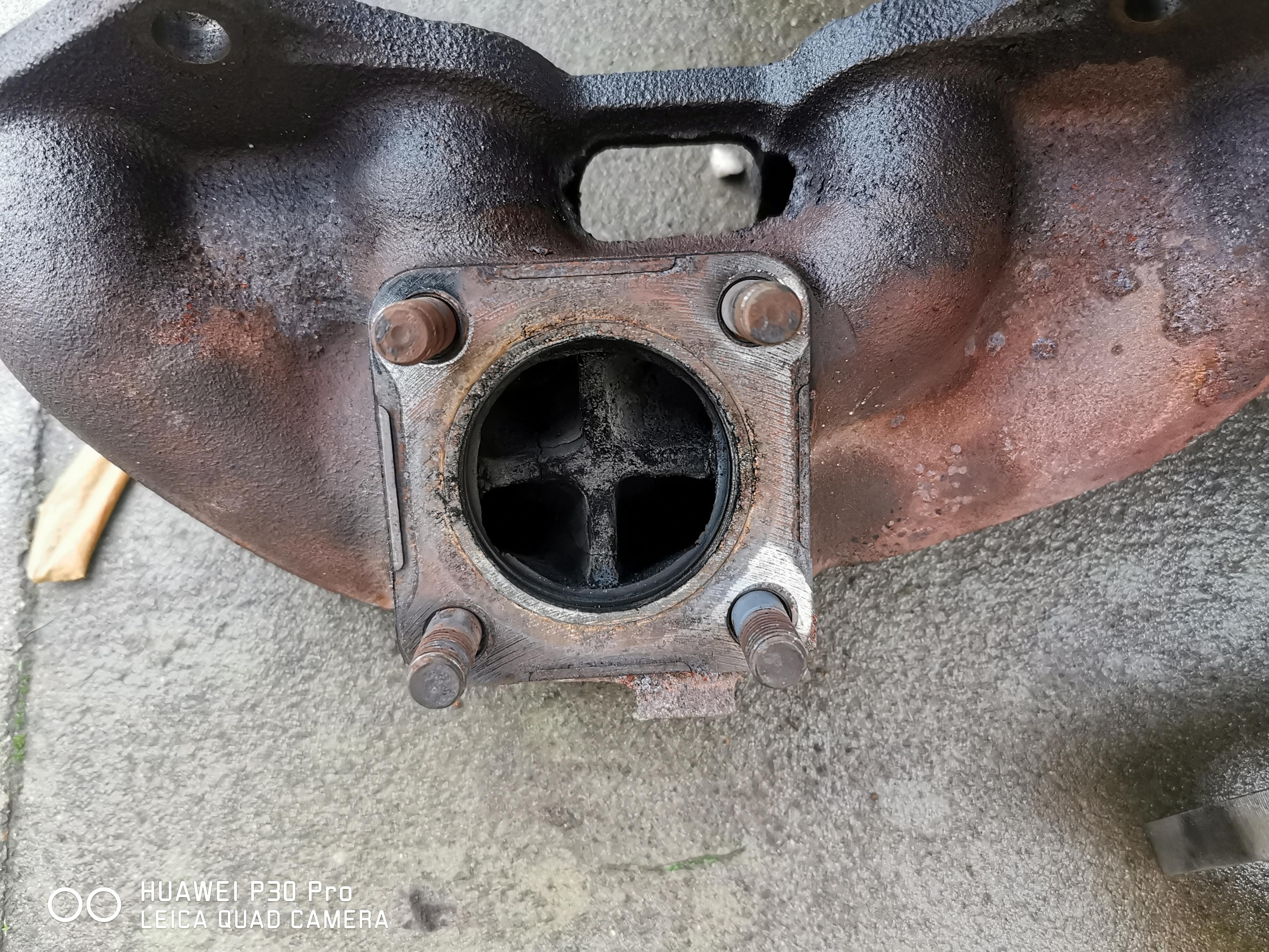

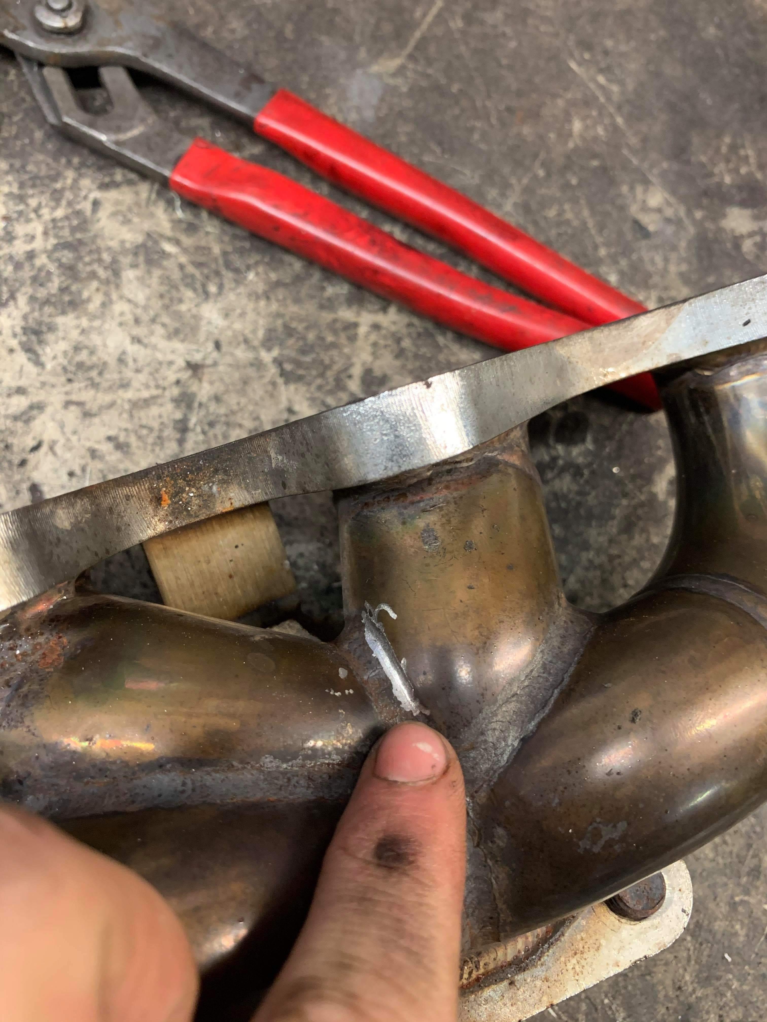

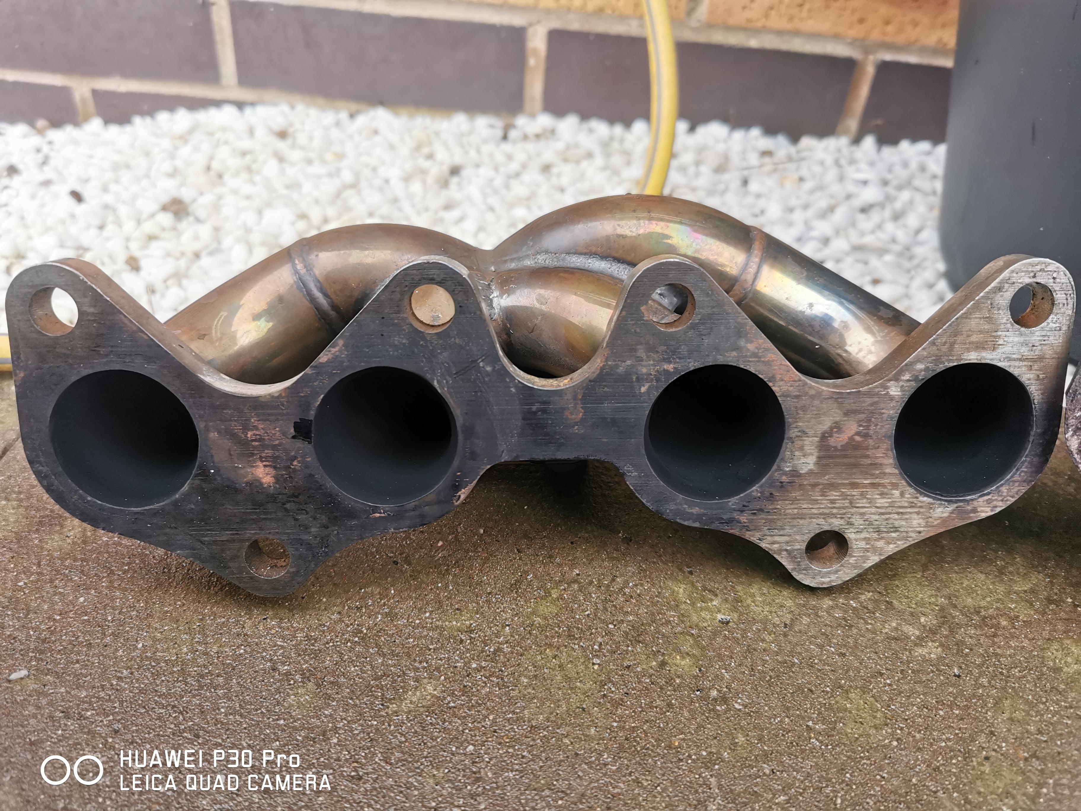

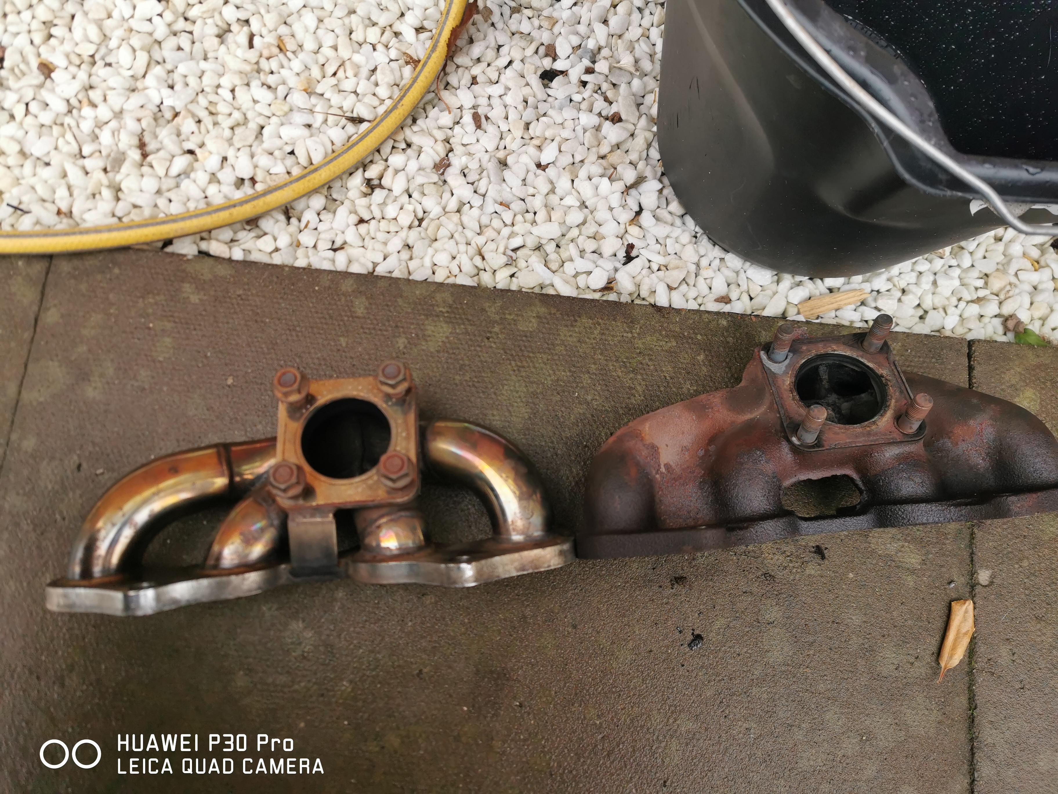

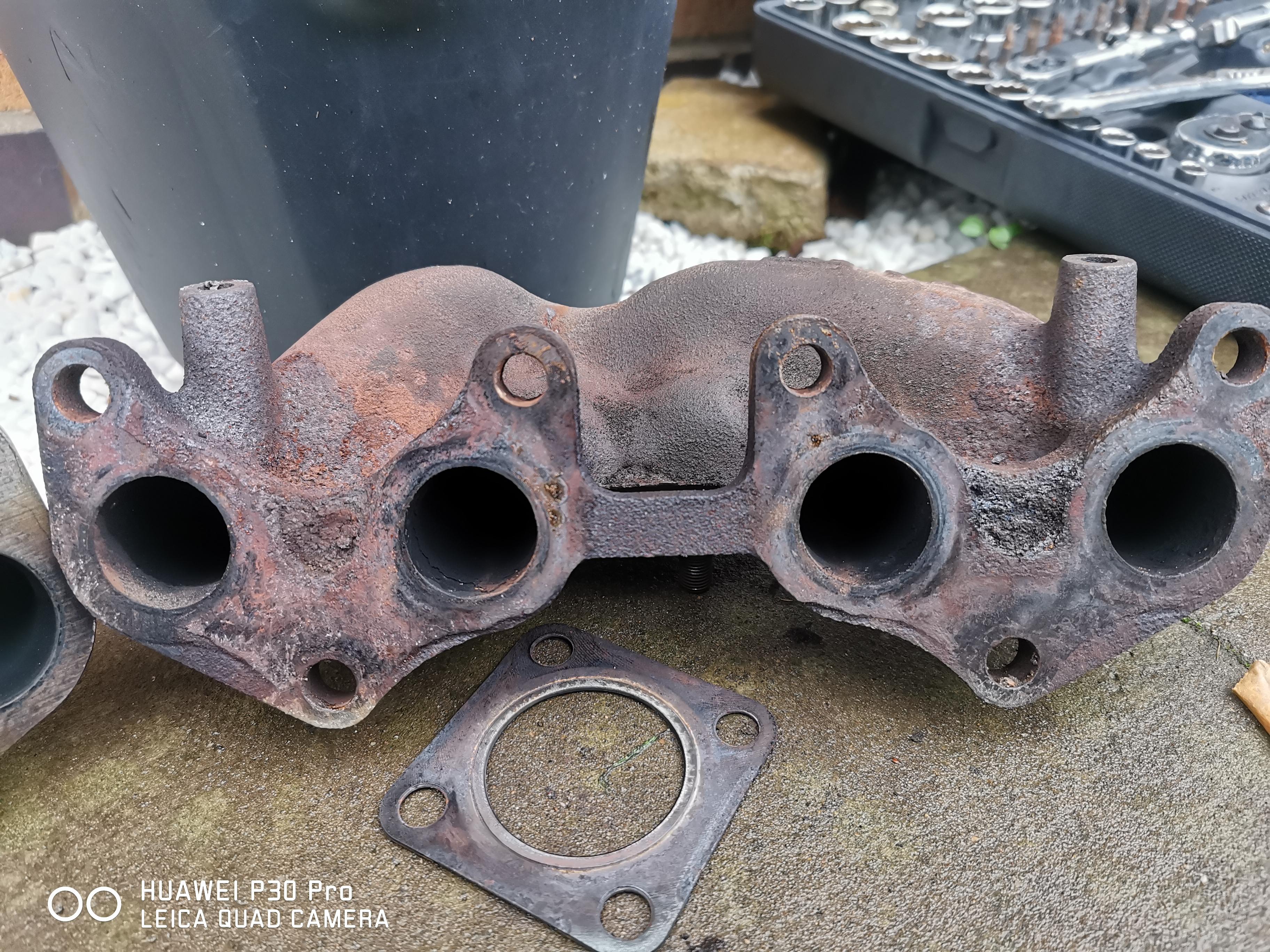

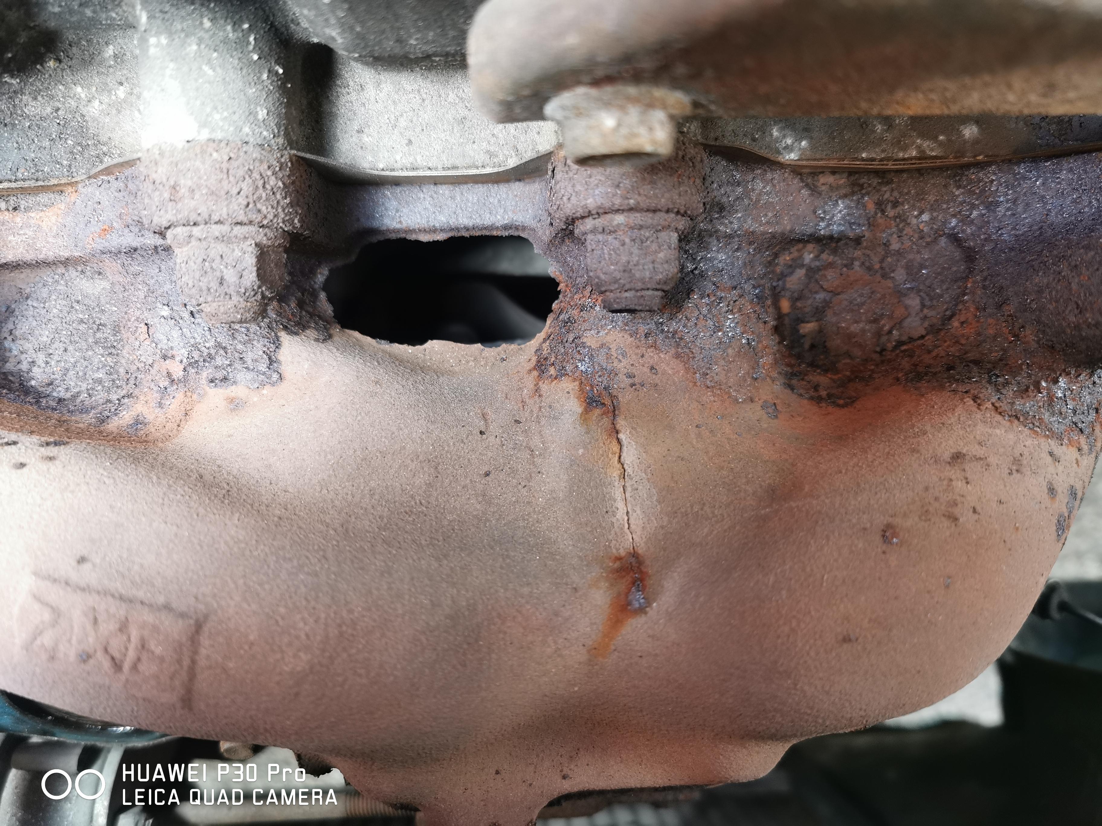

So despite already having a wepr on order I decide to look for a ct9 manifold just to keep me going for the time being. Had a small crack in it, which the seller kindly welded up for me before sending.
received_687466575213497.thumb.jpeg.c4431b69c49e77584118b3fbb7cb1195.jpegreceived_304561007204538.thumb.jpeg.7c12114d323509f63b93280b3cb91448.jpeg quite a difference from the stock manifold
IMG_20201114_103407.thumb.jpg.a29a0510a1436521dd3b33bdfceee785.jpgIMG_20201114_103415.thumb.jpg.afe00a2abffa73bcc6370432d47da6e4.jpgIMG_20201114_103419.thumb.jpg.0a1d223970b846cb7360b2b9e110741e.jpgIMG_20201114_103435.thumb.jpg.8f1713a067caac4ce0991e0ae50c4b82.jpg

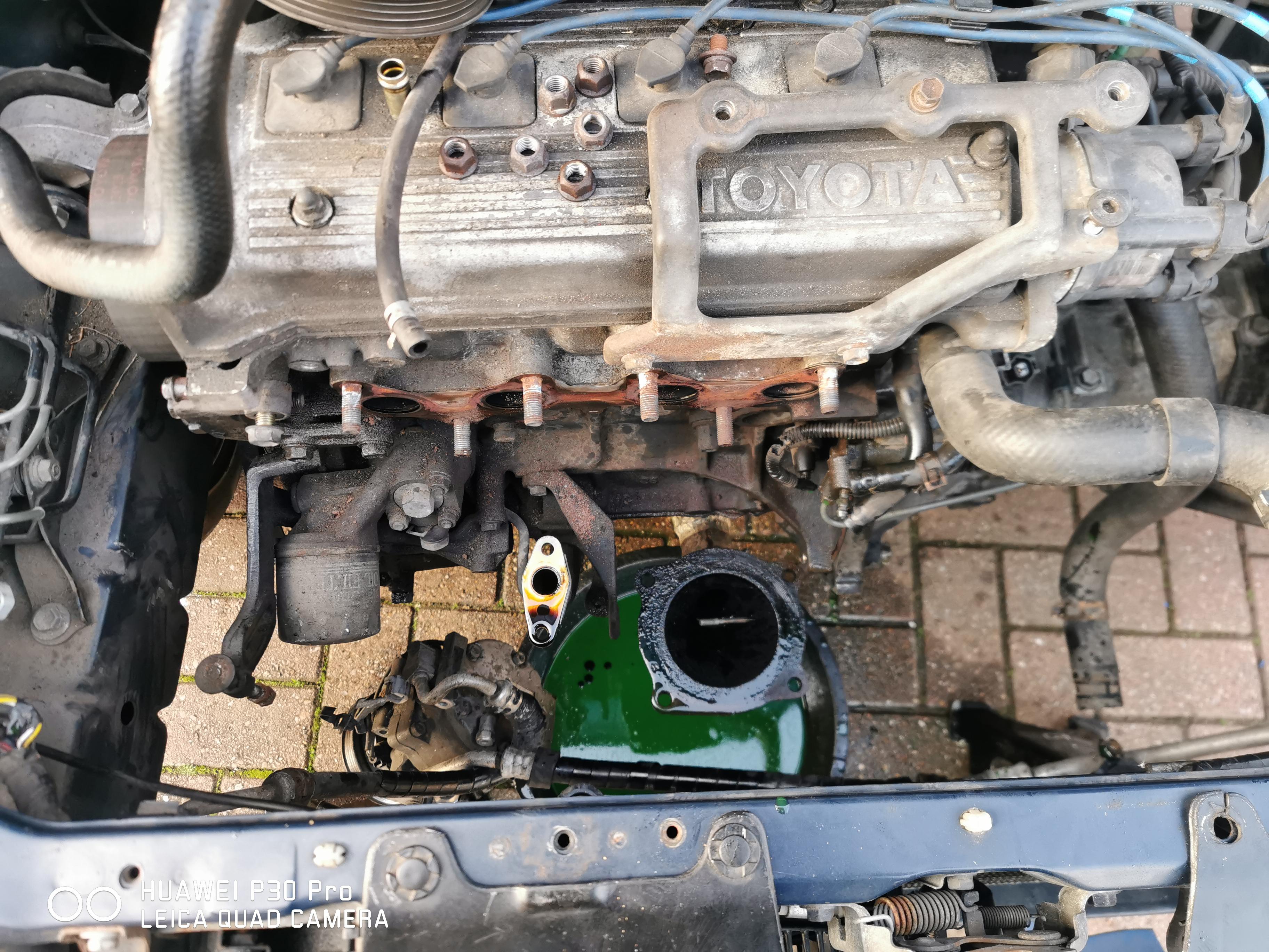

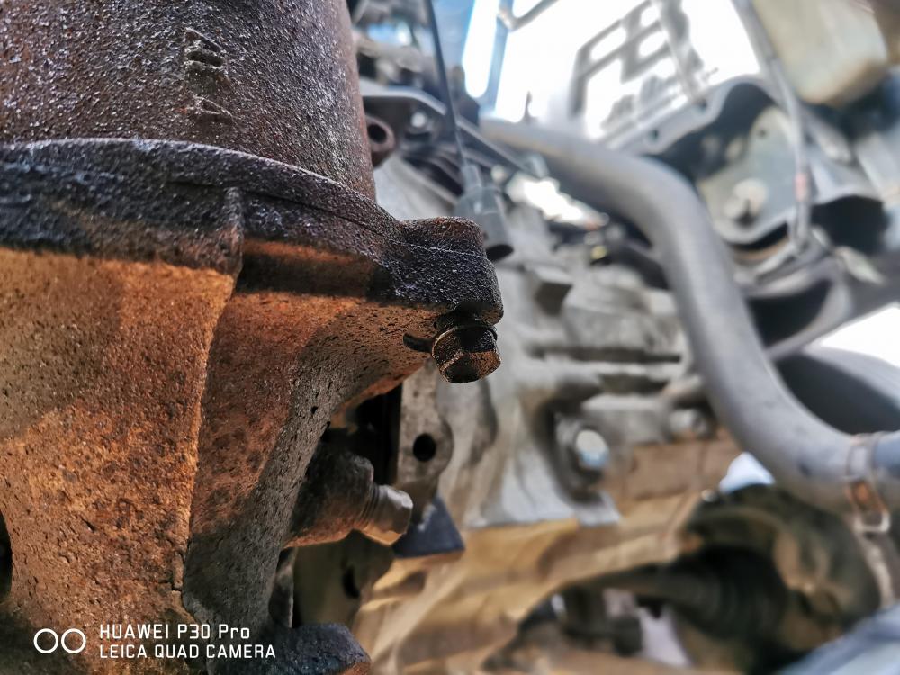

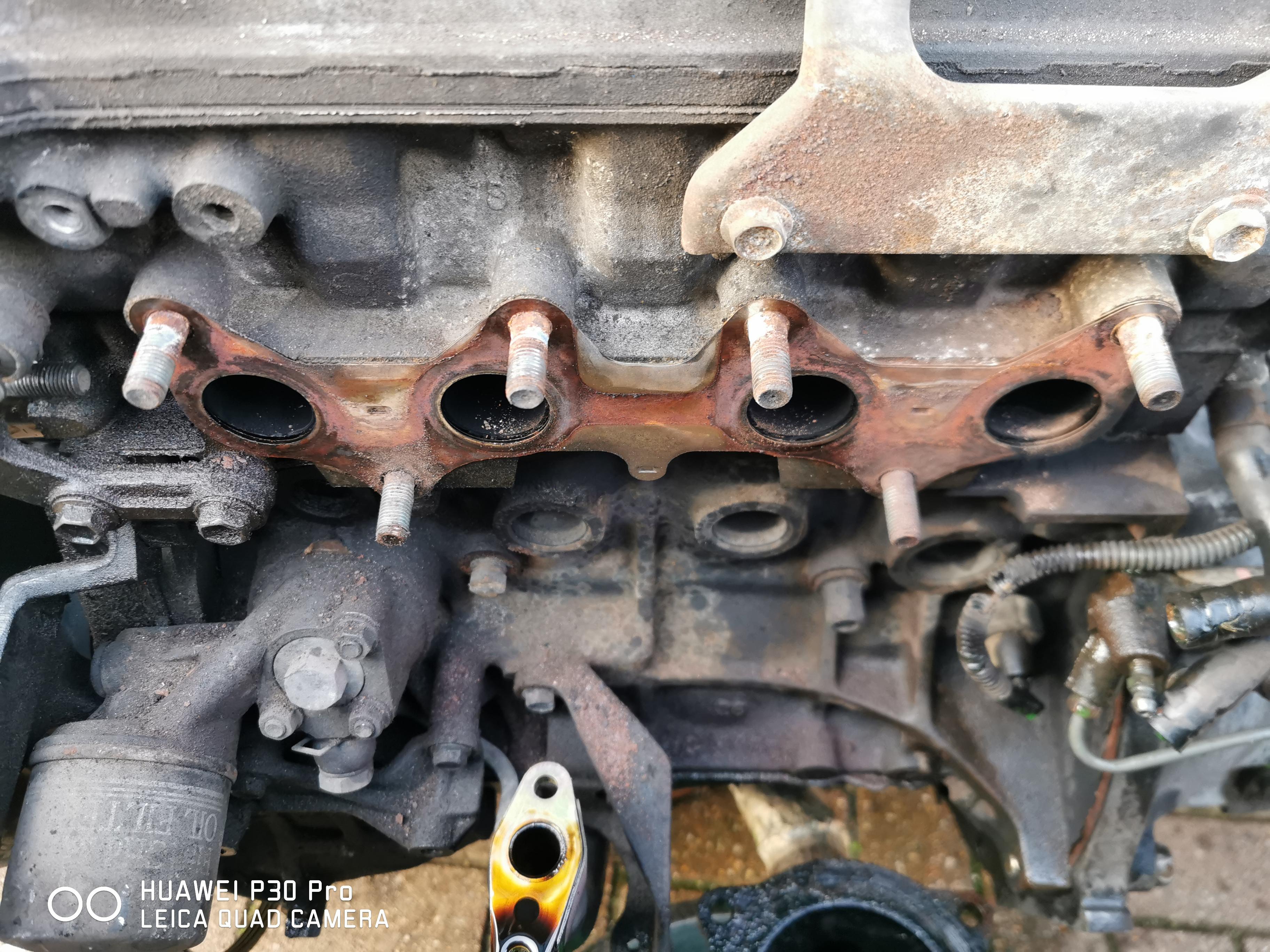

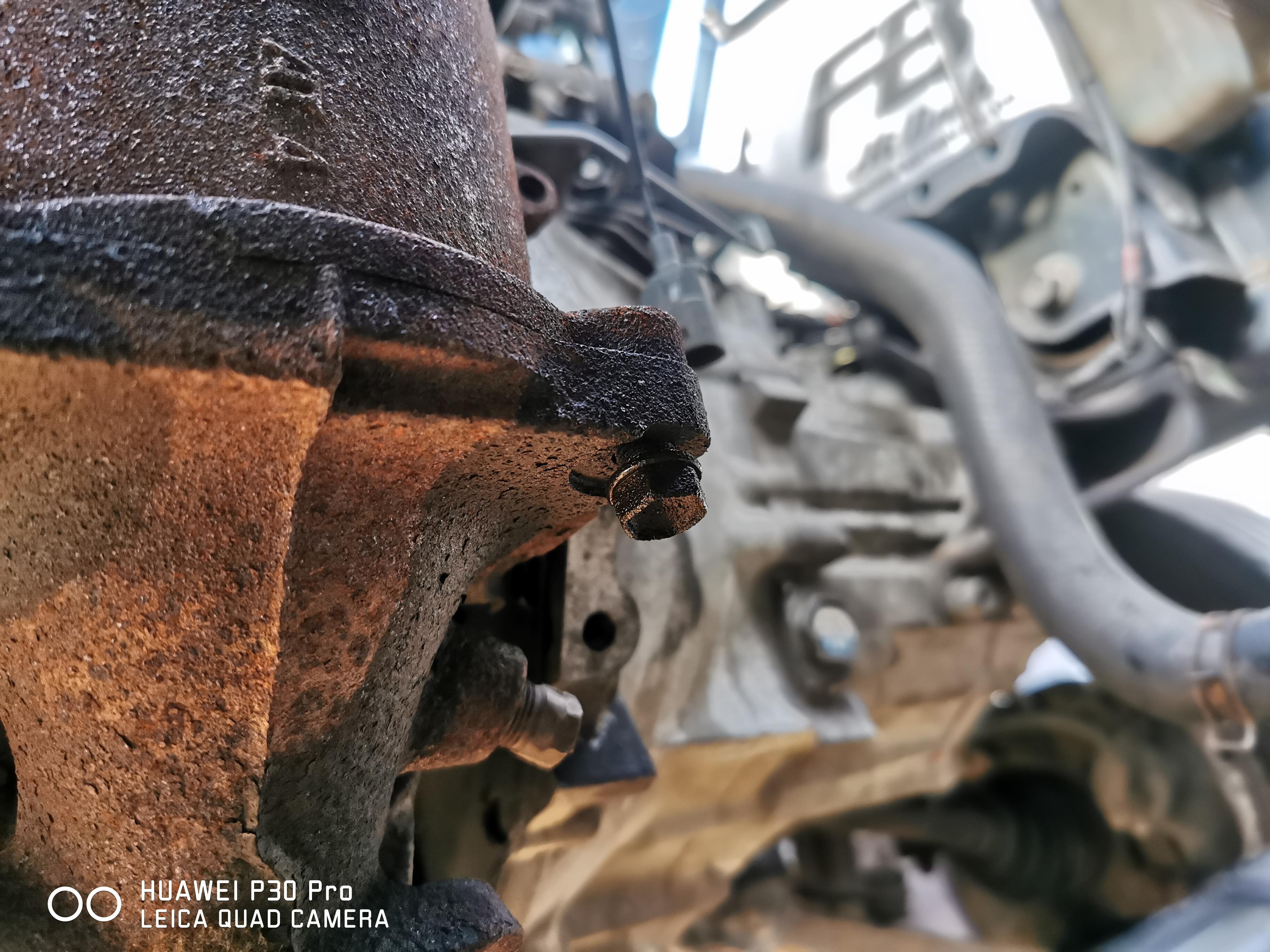

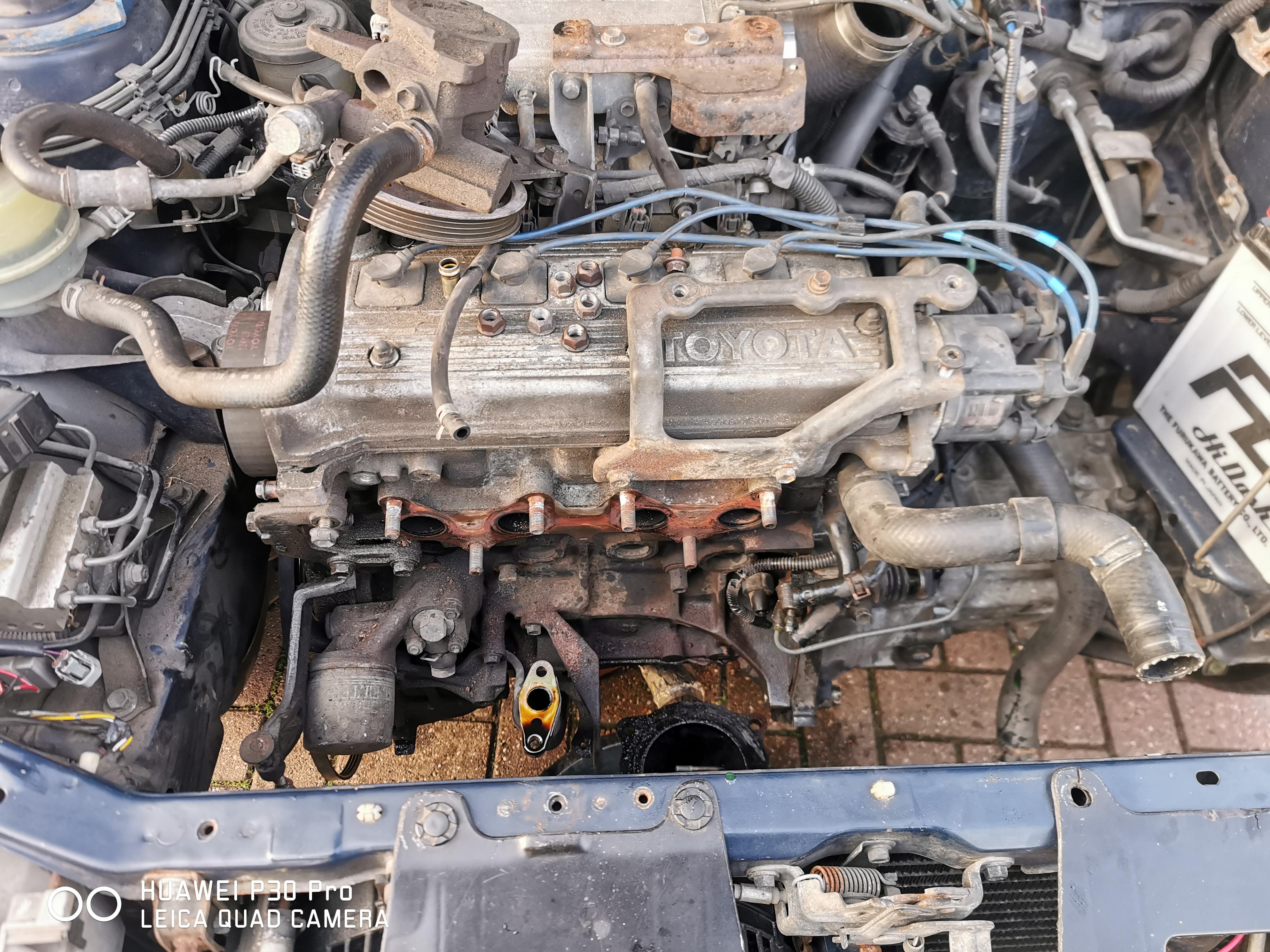

All goes smoothly and I find that with enough mapp gas even the most stubborn of nuts and bolts come loose
IMG_20201103_114228.thumb.jpg.f3dd6fa061395c918c846747f7515ff3.jpgIMG_20201107_151623.thumb.jpg.462820dcdea9e7c70dd15fcce5ff2324.jpgIMG_20201107_151630.thumb.jpg.2d24f96083b9a9ccd177a5b7fb2289fc.jpg
All except this one, but as this picture was taken before I attempted to remove it, it was obvious that this would shear from the start, however with more gas and some mole grips it was soon out.

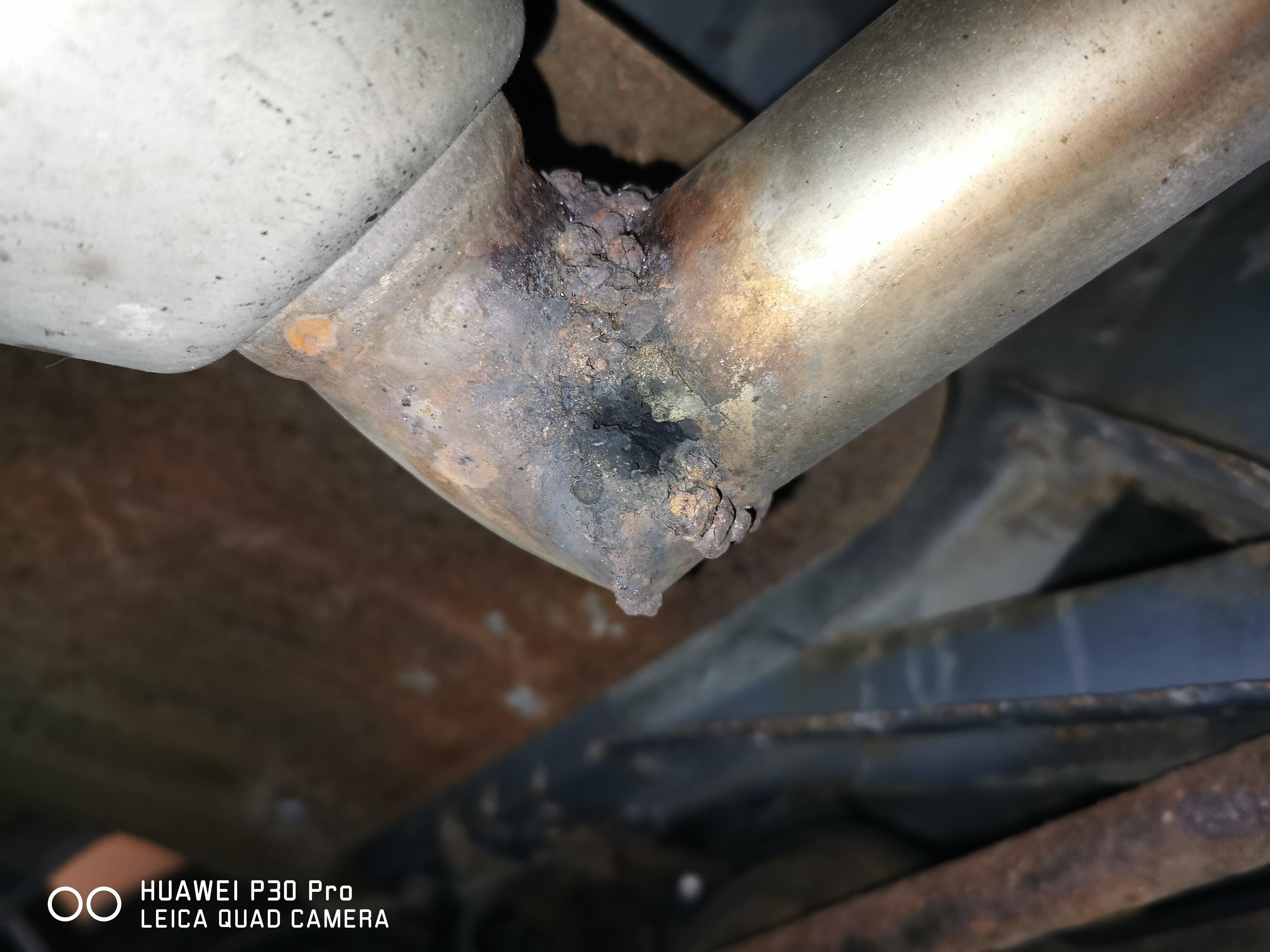

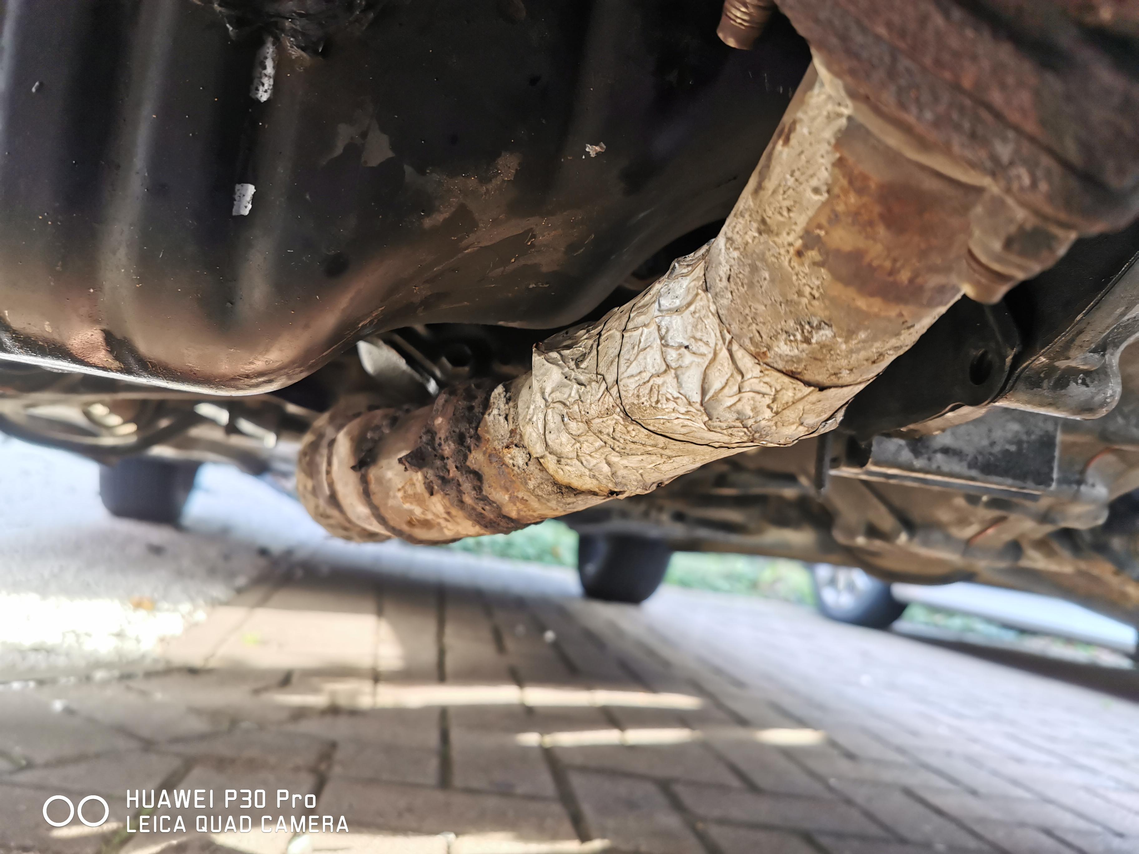

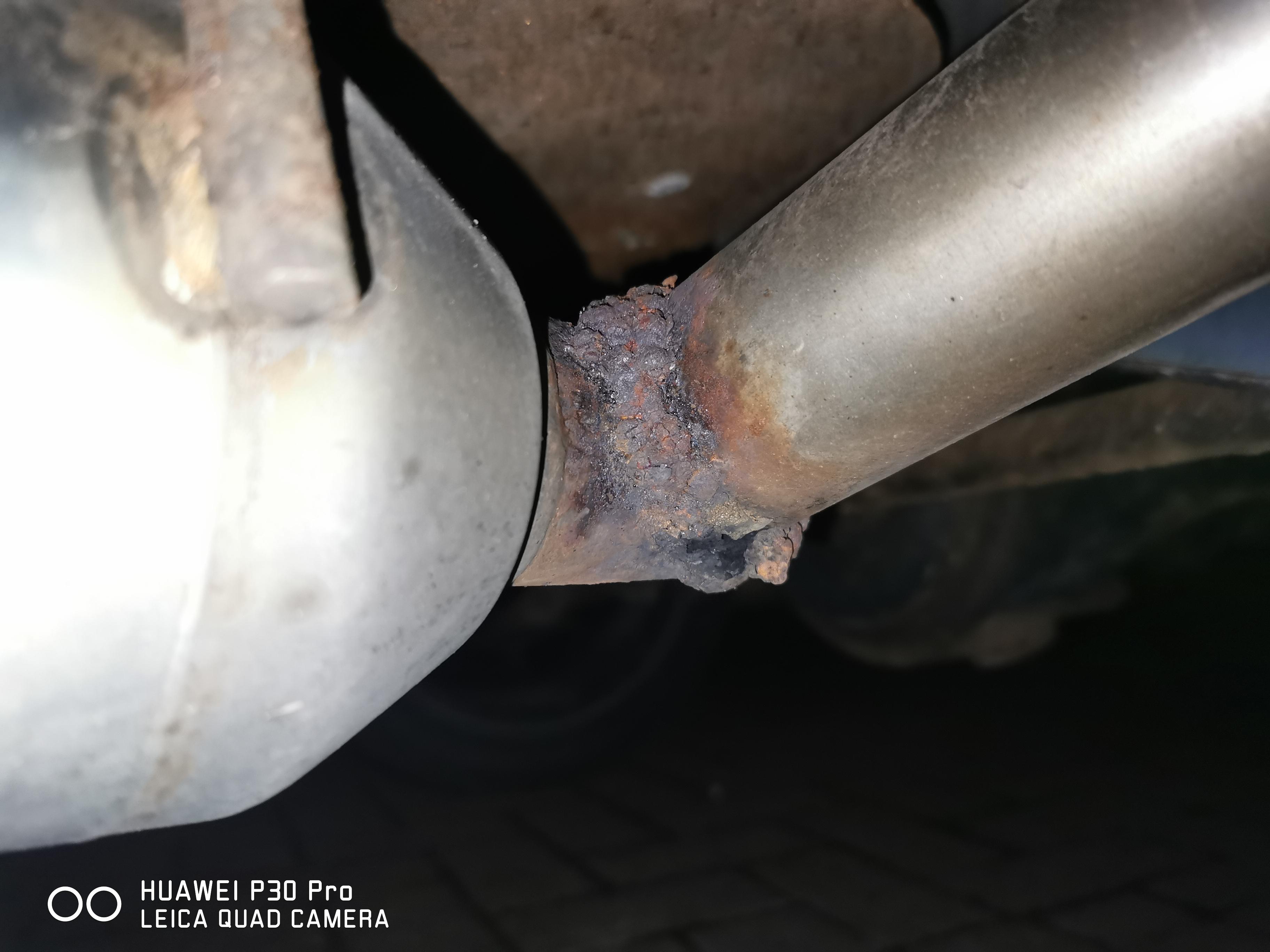

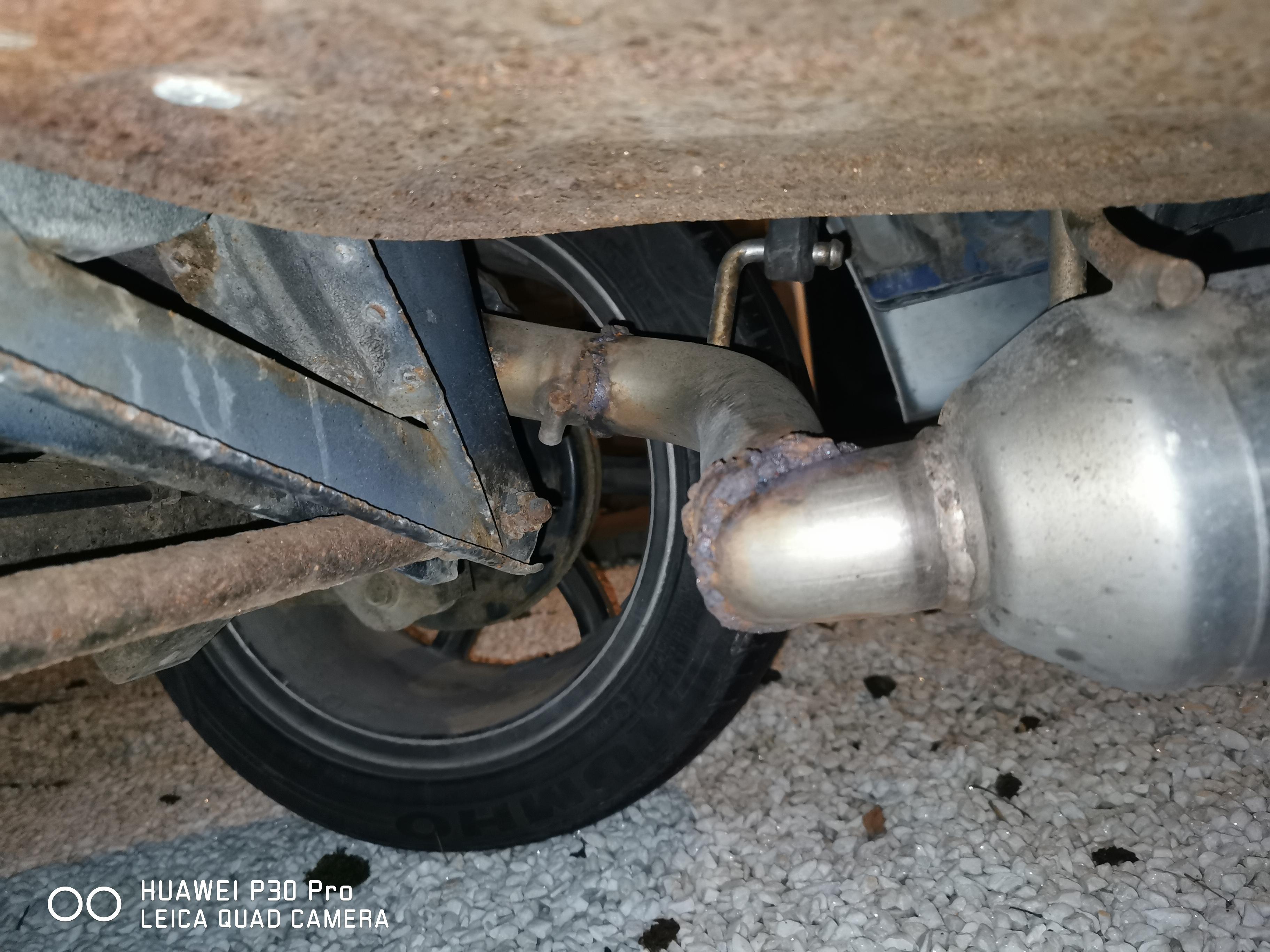

And at this point you all get to have a laugh at the state of the exhaust. I think a custom system may be required to replace this mess
IMG_20201107_141758.thumb.jpg.2b289c55691b39813b351463e4119cb3.jpgIMG_20201107_182236.thumb.jpg.31498cecd80cf6212cbe12530ee1e5f4.jpgIMG_20201107_182158.thumb.jpg.6245c38dc92abbc858671a8a8c2204d3.jpg

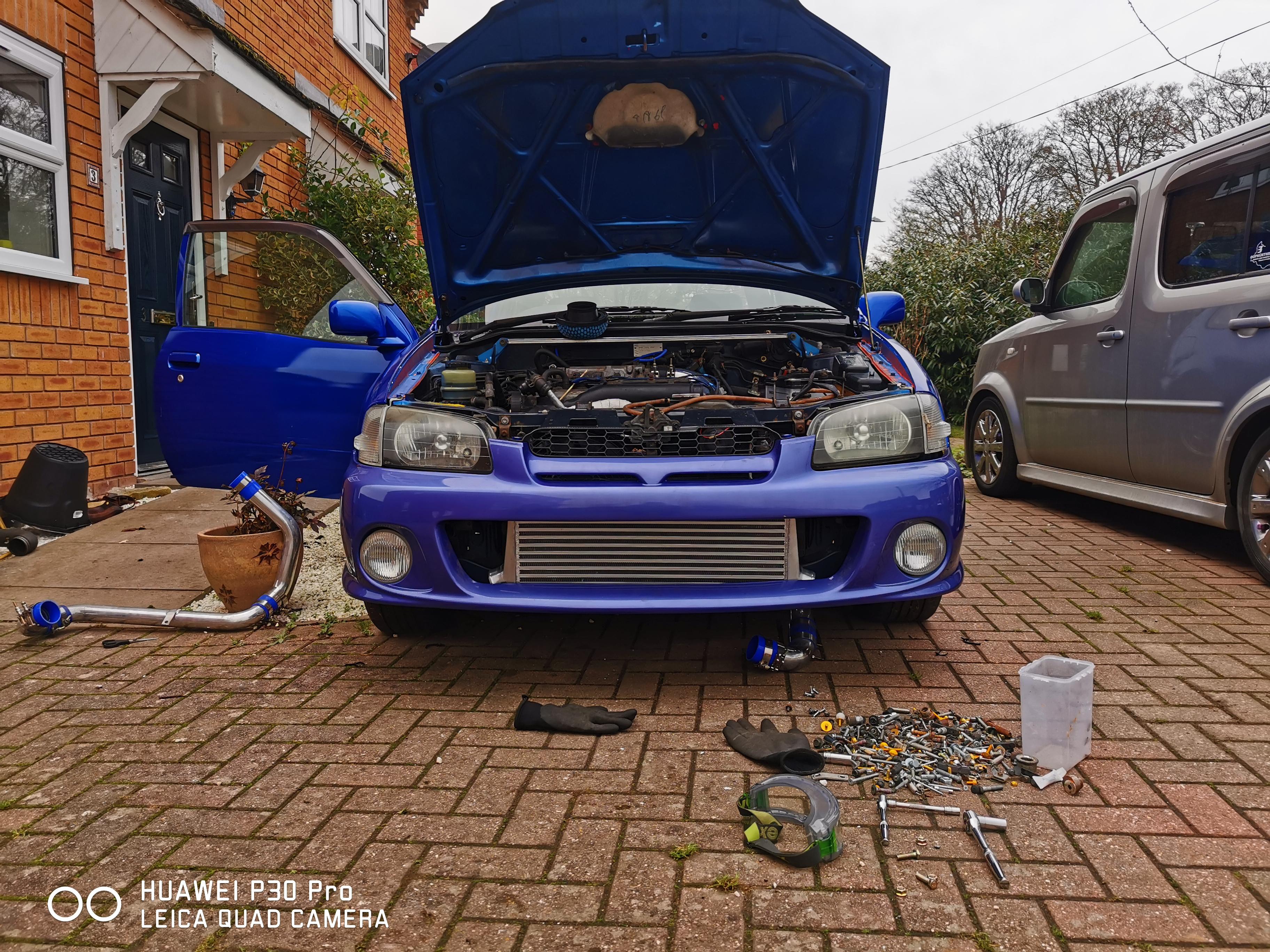

So unfortunately this doesent solve my problems, the strange high pitch rattle/squeal is gone (yes I did check the turbo for play) and in hindsight it was brobably just one of the heat shields as they were all missing bolts.
The noise has however been replaced by a high pitch whine when on boost. Now I'm no mechanic and new to turbocharged stuff so had to ask Facebook. (the obvious choice when wanting advice 😜) most people seemed to think it's a boost leak, and this seems to tie in with the fact that it only does it under load. This of course means that it is bloody difficult to find as I can't exactly stick my head under the bonnet whilst boosting down the road at 50mph. I tried to clean and reclamp all the pipes but no change. Perhaps its because they're 25 year old rubber pipes that didn't like being moved, perhaps its not a boost leak, time will tell. The boost guage is just a cheapy that someone local to me was kind enough to gift me, just thrown in to see what is happening with the turbo and the boost is holding a steady 9-10psi.

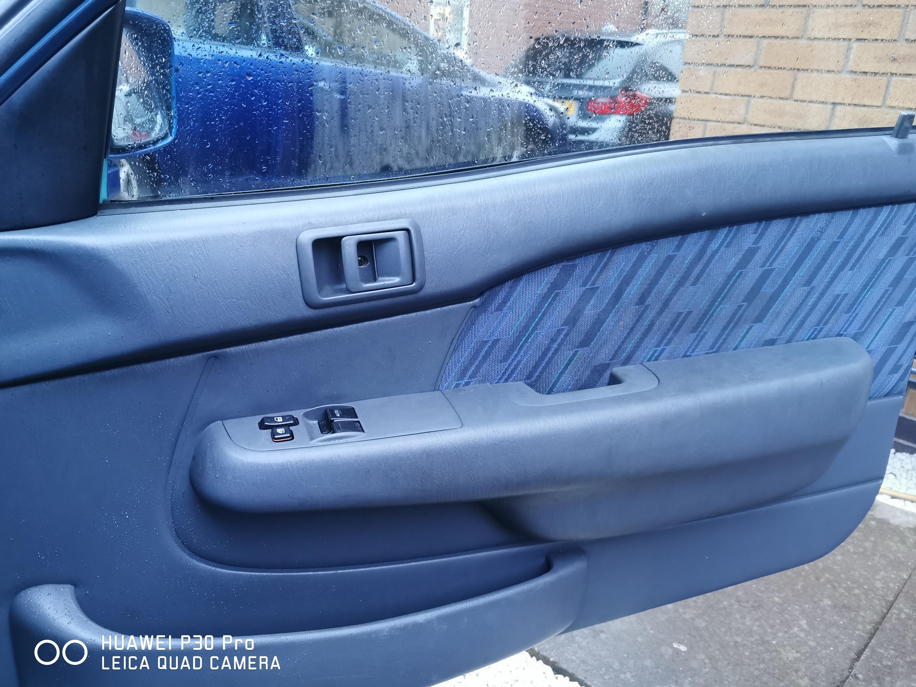

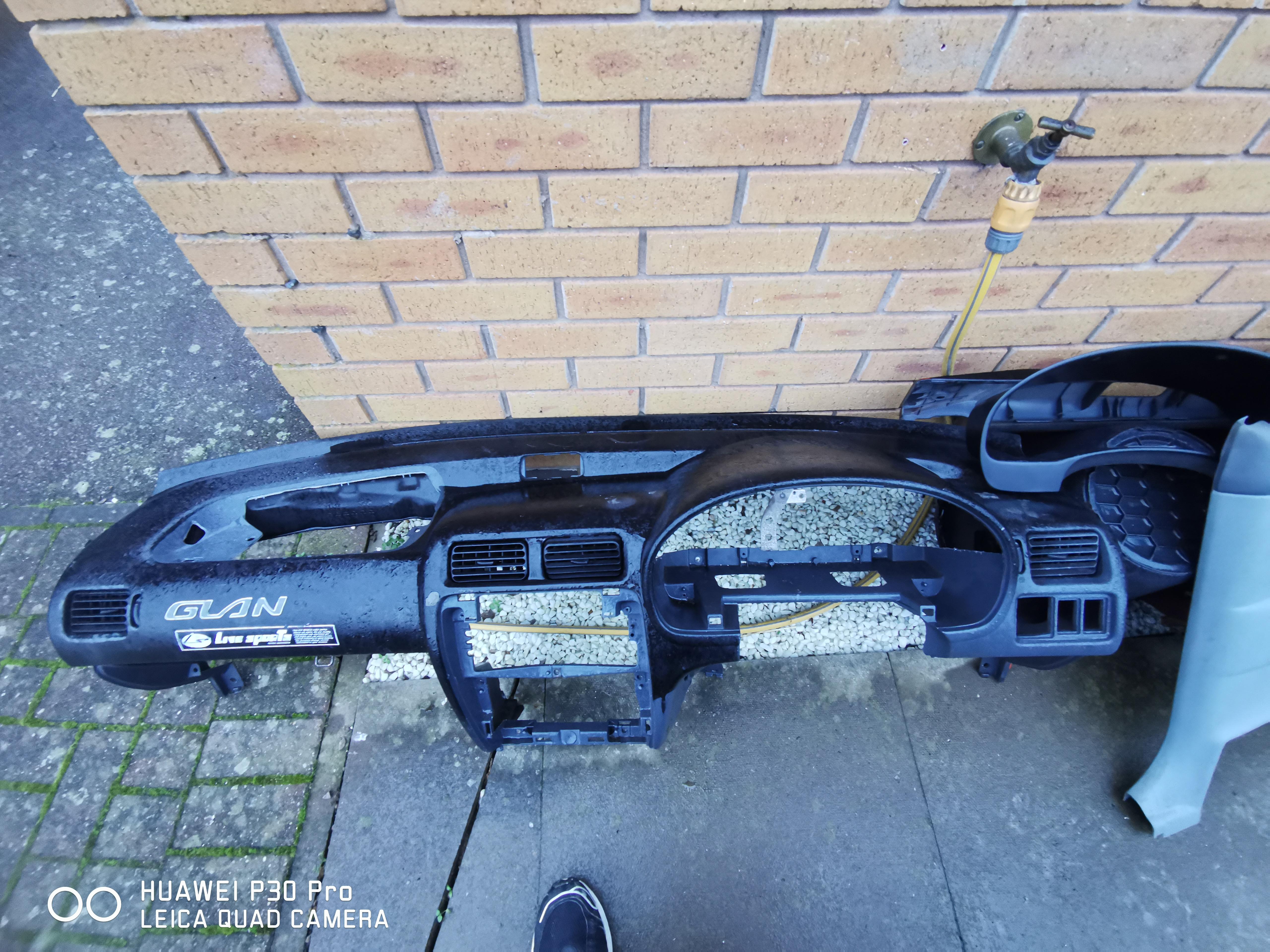

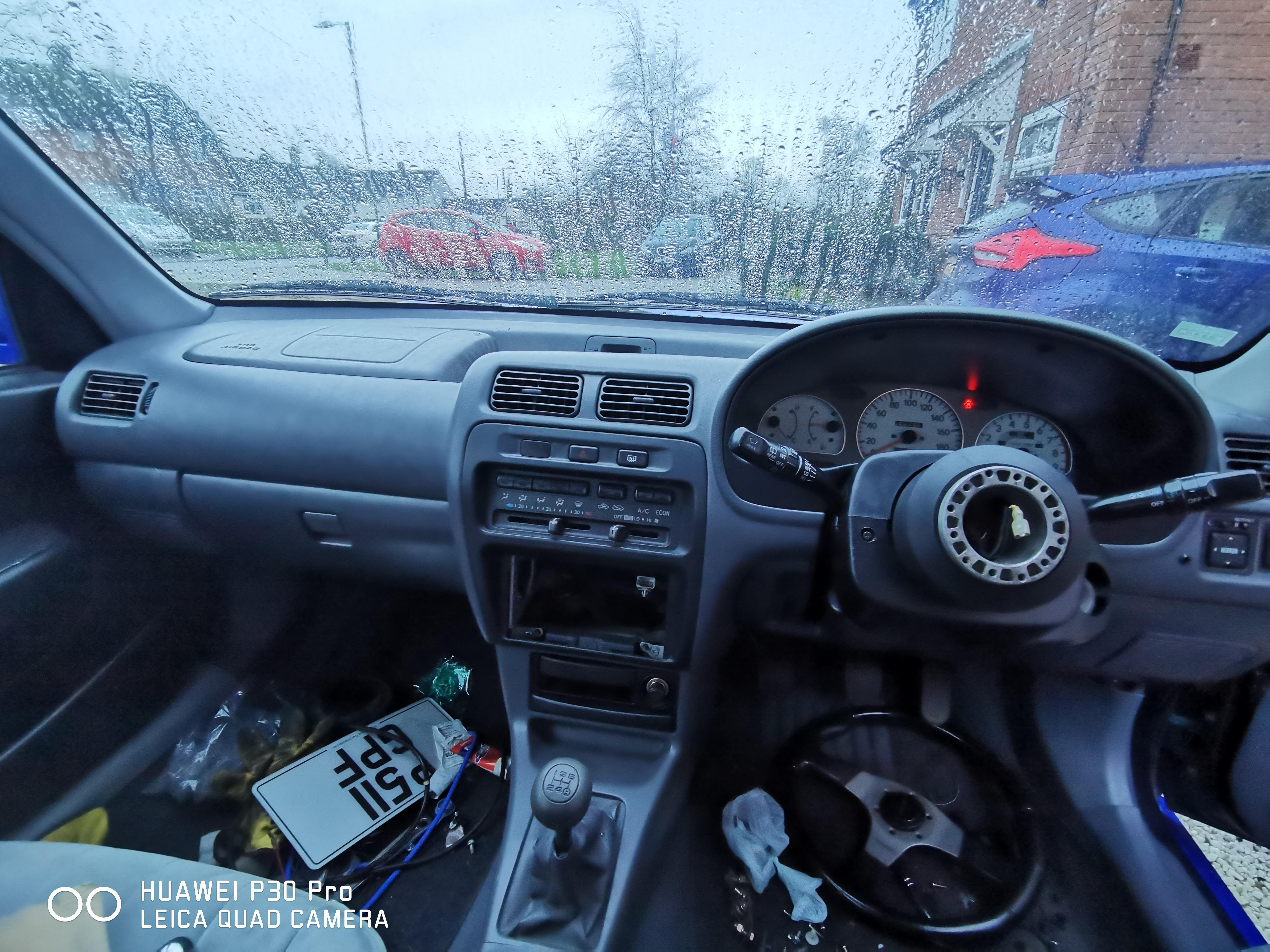

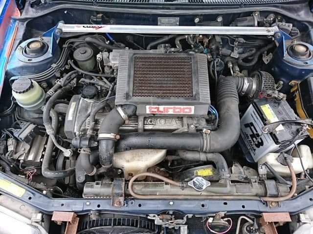

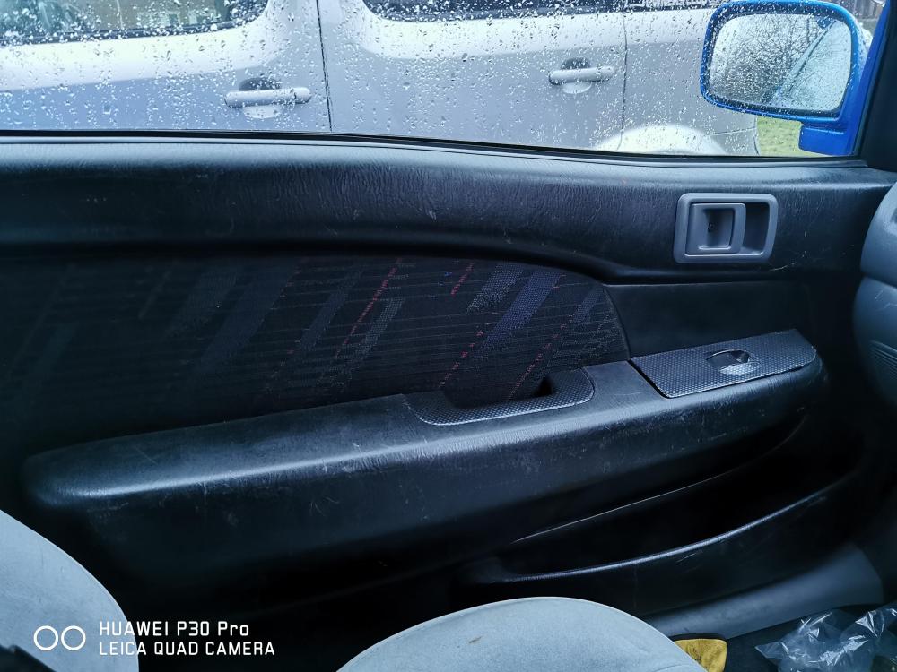

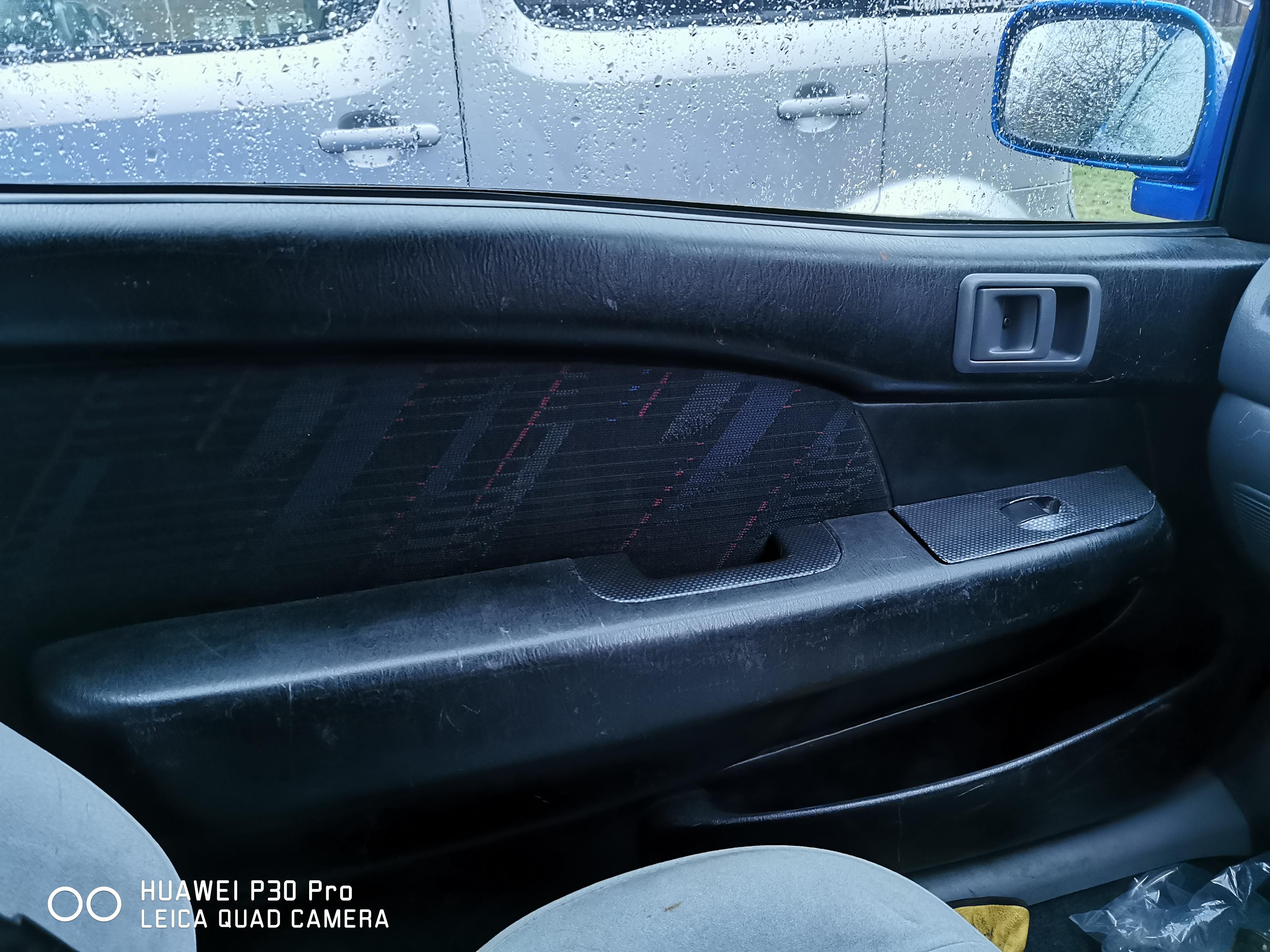

So having a break from turbo stuff, today I decided to tackle the grotty interior. The previous owner in Japan had decided to badly spray paint the interior black, it was horrible and needs to go. IMG_20201130_144801.thumb.jpg.78c08eec5f3a021985975a33fb2ae0ce.jpgIMG_20201130_144915.thumb.jpg.eafe4930b4844f9e69385e01c36d962b.jpgIMG_20201130_144413.thumb.jpg.ba9cb8d8006bf8b42a832d7269b22a3b.jpgIMG_20201130_144920.thumb.jpg.ac06ad1cd255f72b9d177760bcb5083f.jpg
New dash door cards etc all fitted, good few hours work but worth it.

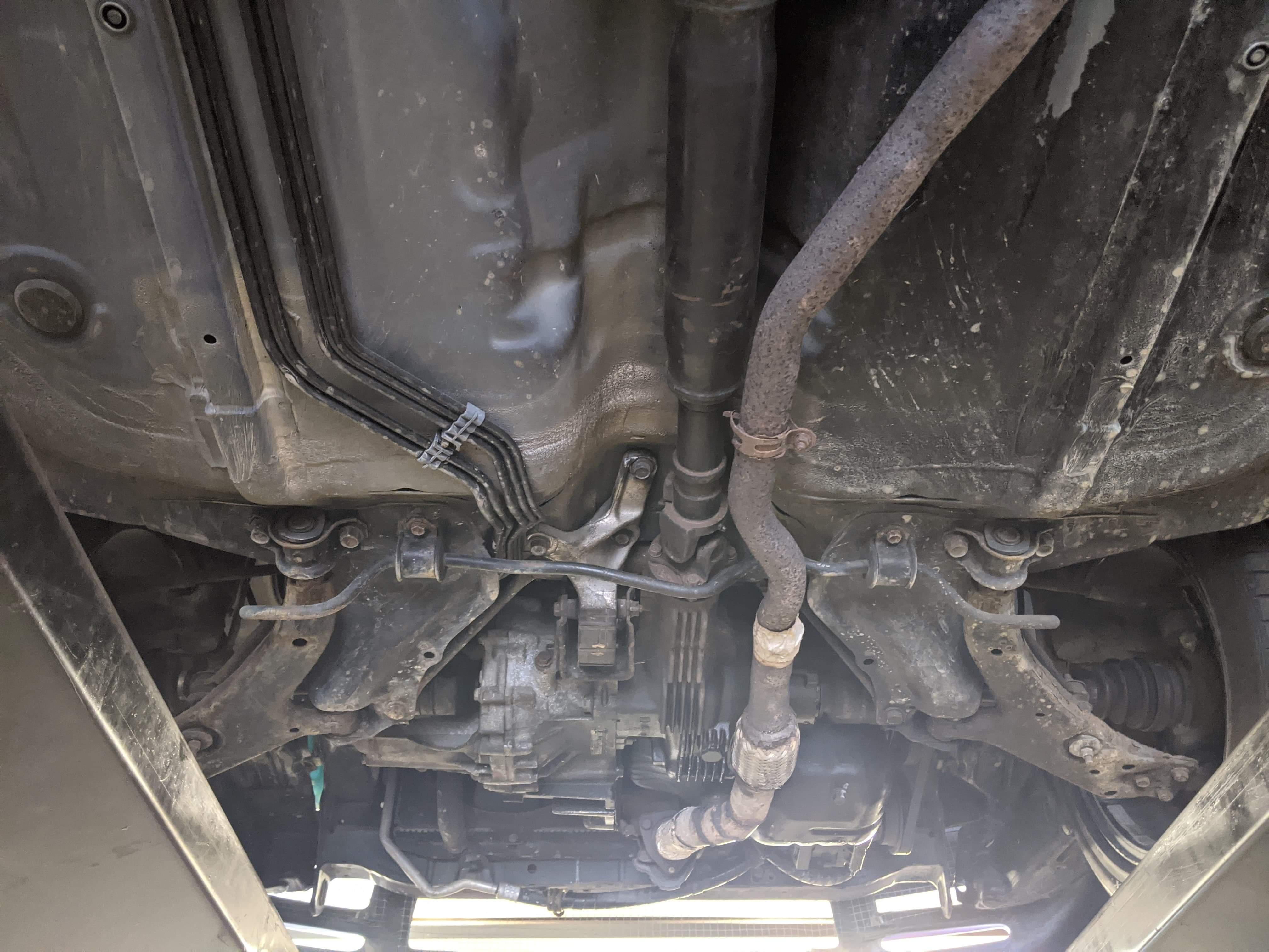

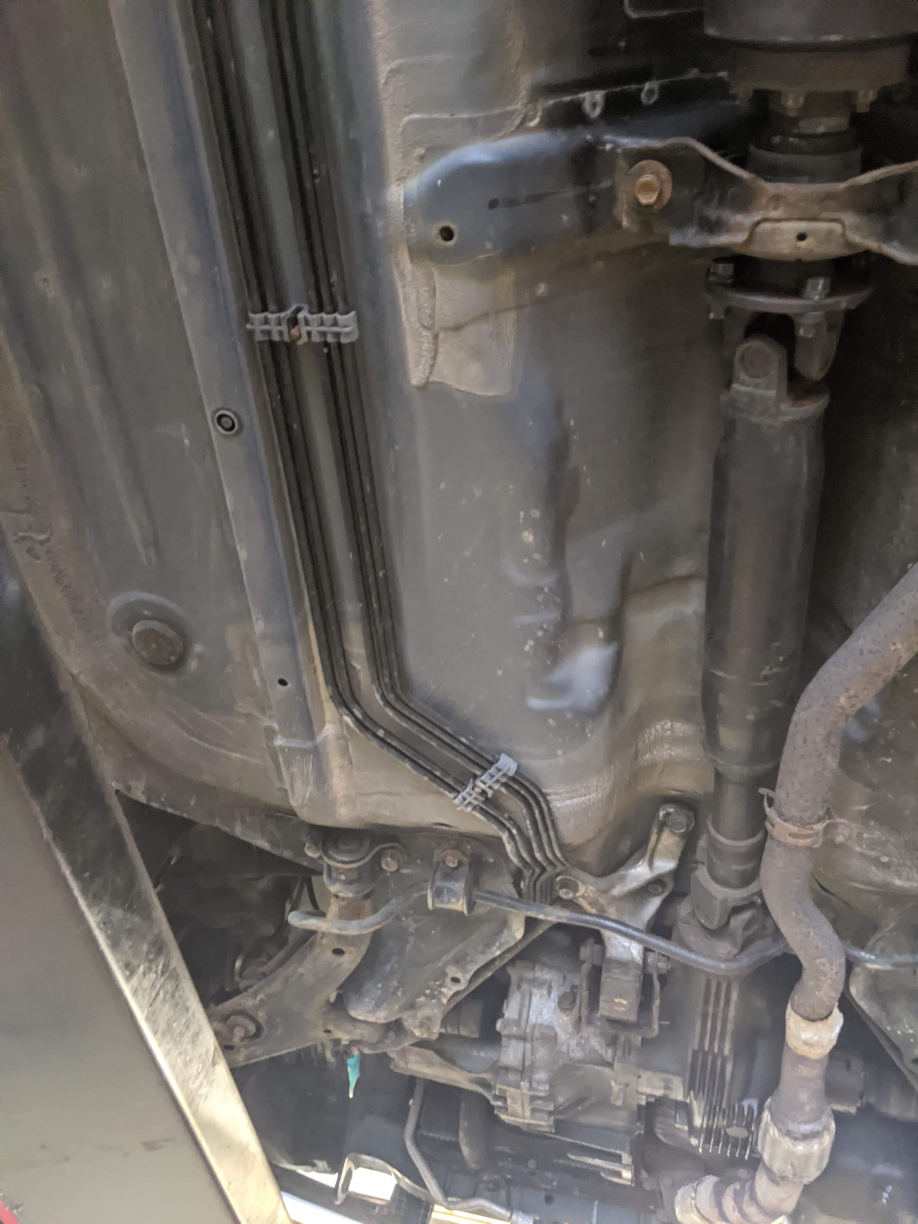

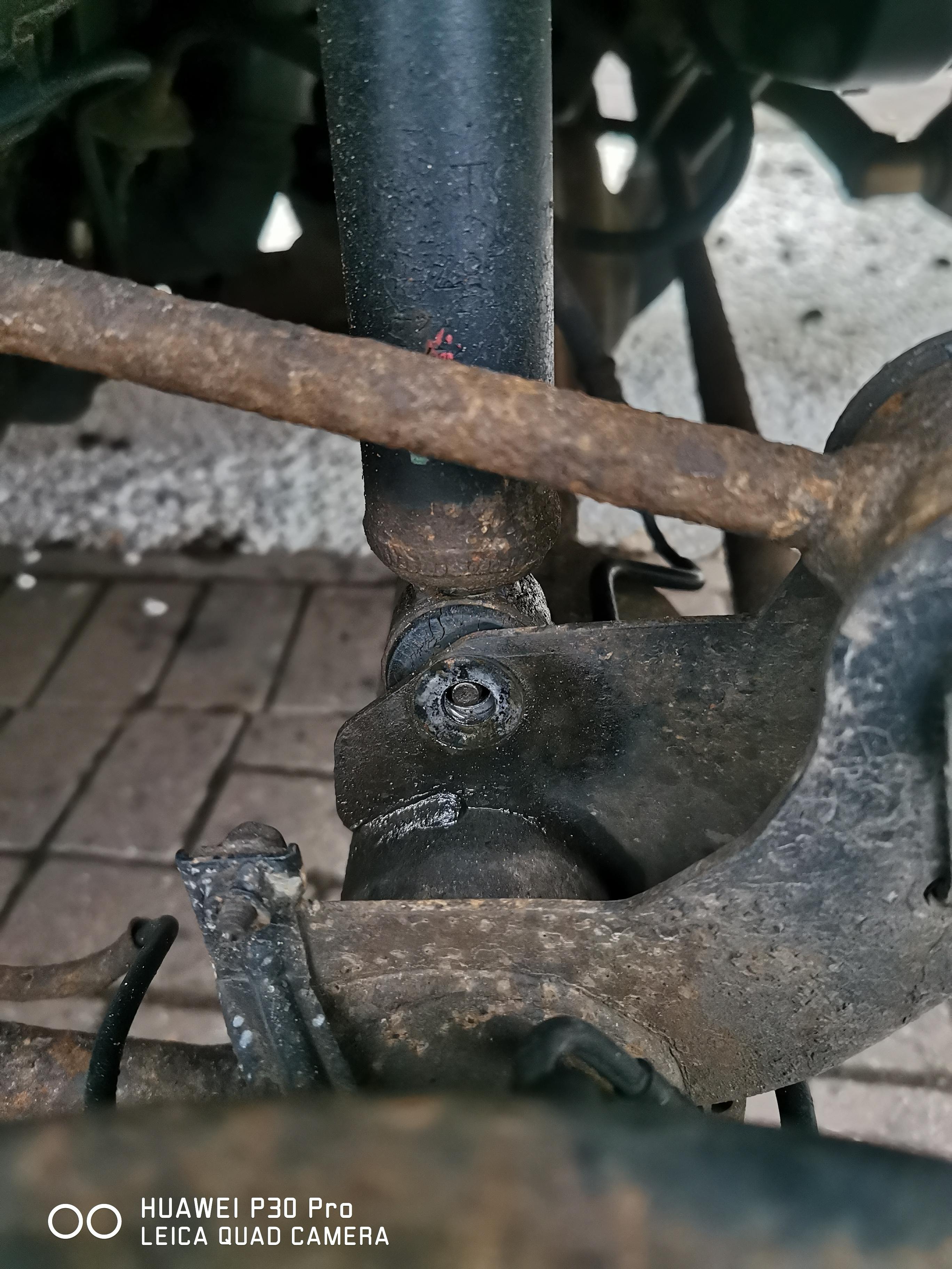

I'll see if I can get these fitted this week. Not sure how to tackle the panhard rod though as you can't get an adjustable one for the 95

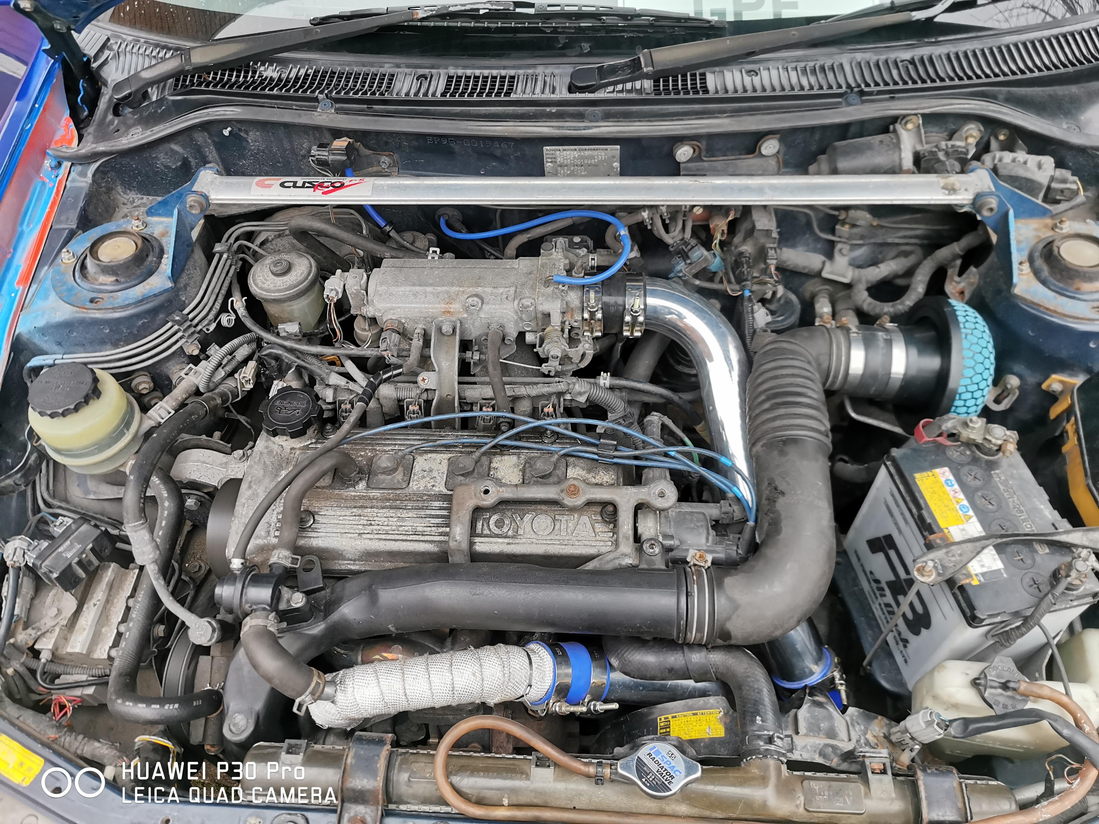

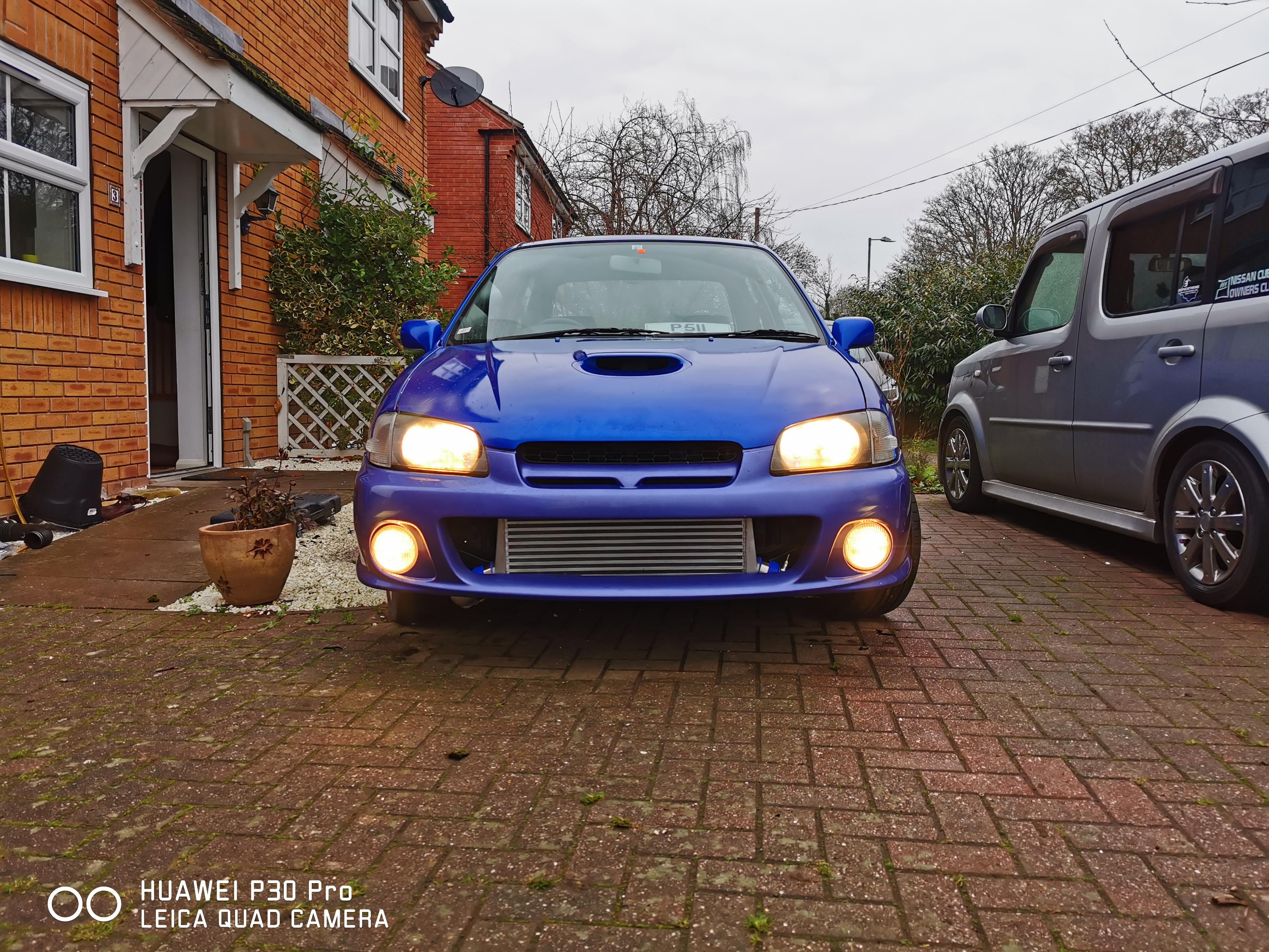

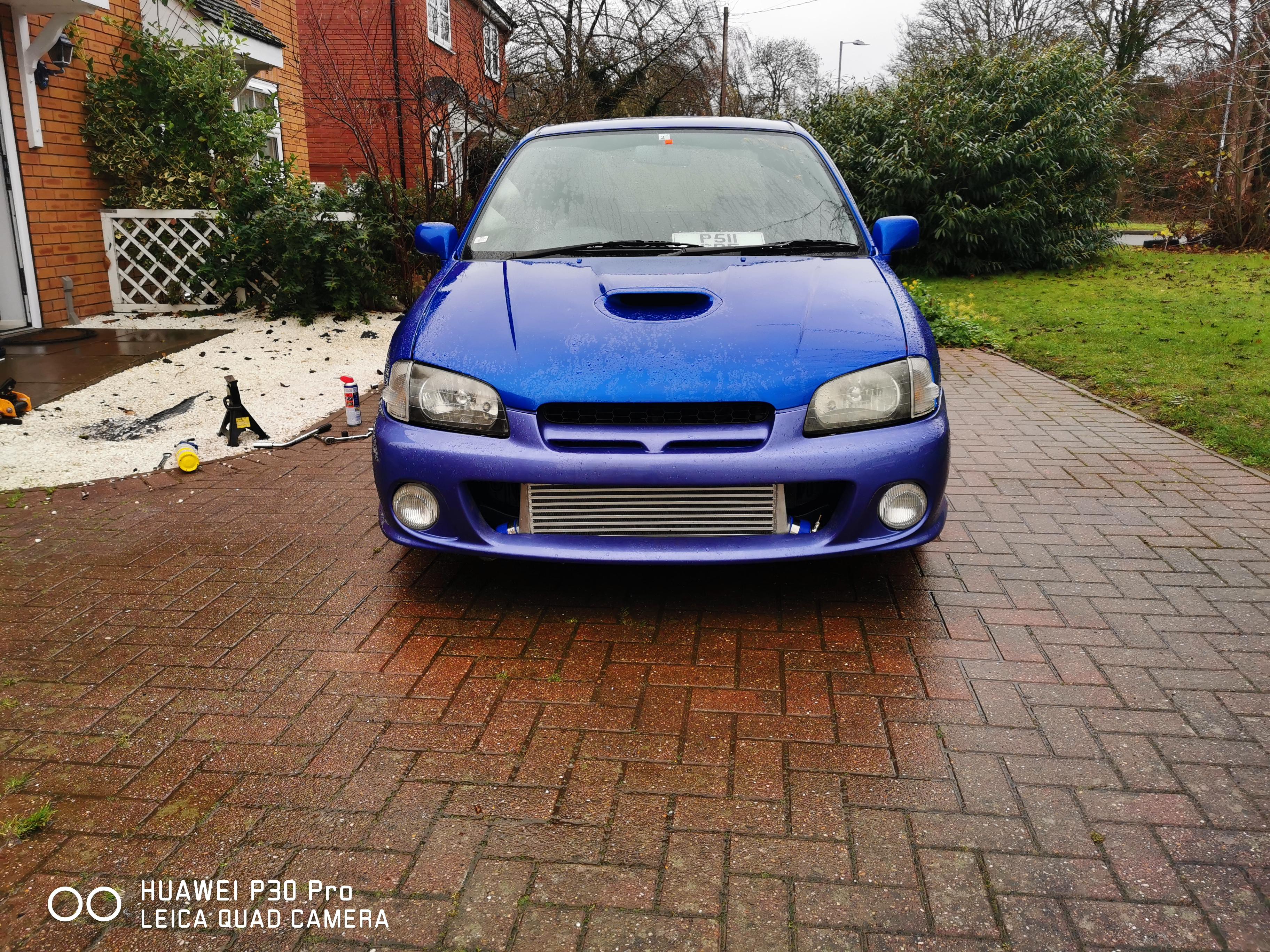

Cheers guys.

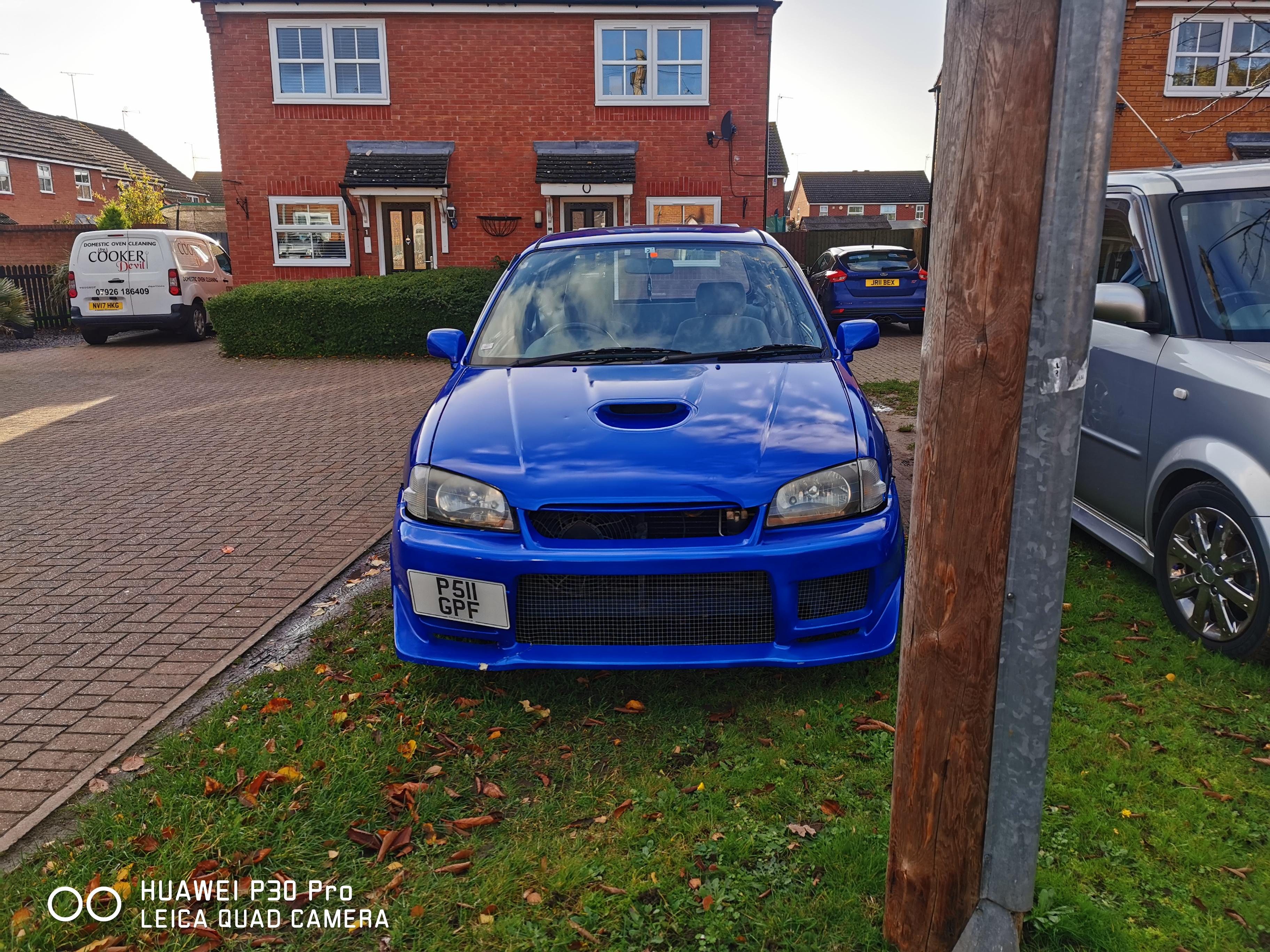

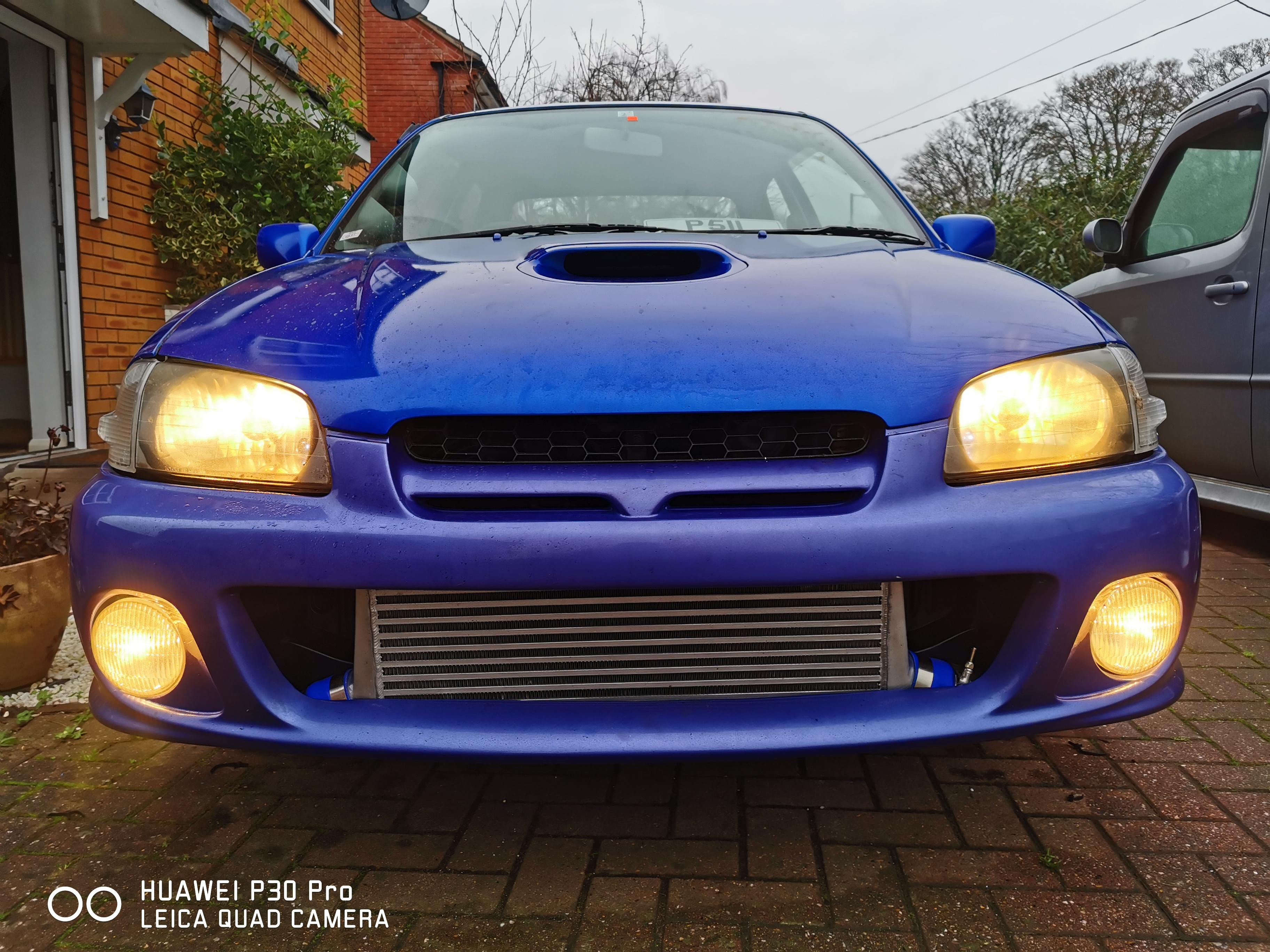

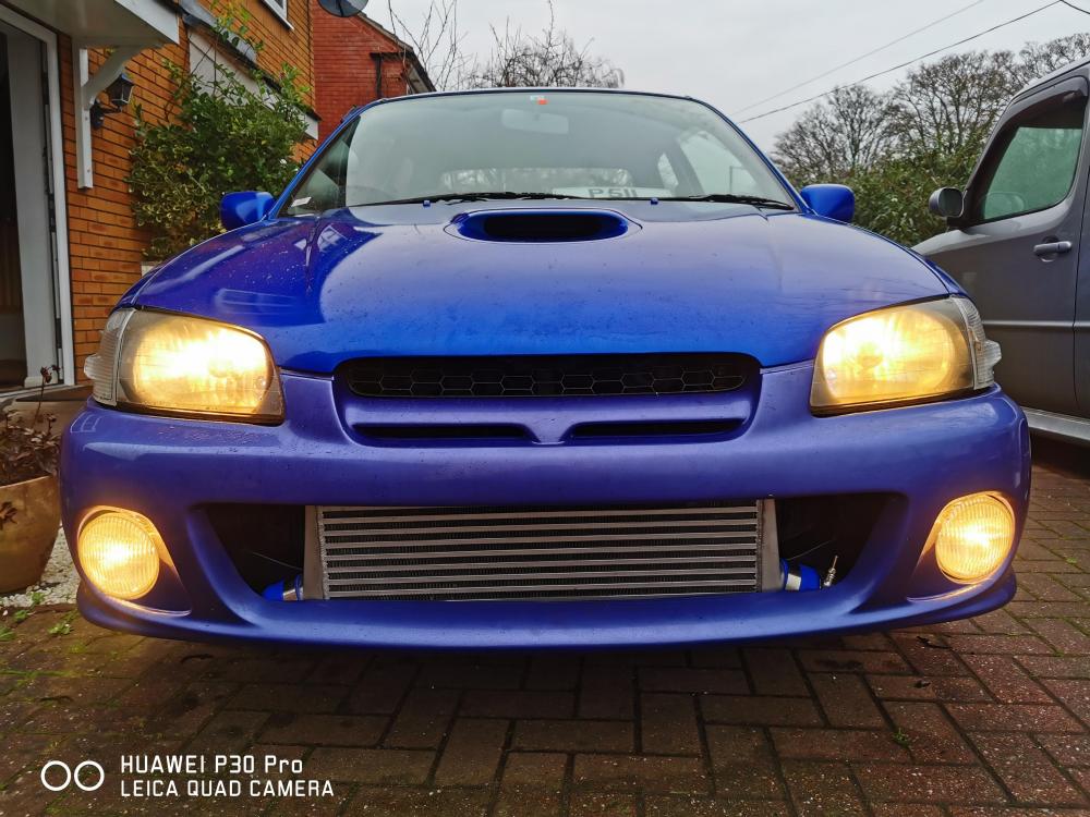

Today I solved the elusive boost leak, by replacing the intercooler and all associated pipework. All boosting correctly now and looking much better too.

12 minutes ago, Sam44 said:
nice work.
what make is that turbo kit looks mega.
It's a wepr kit, the turbo I'll be fitting is a tf035 from a forester, same fitment as td04 but slightly smaller and quicker spooling. I'm only aiming for 200bhp so I felt the tf035 will suit it better.

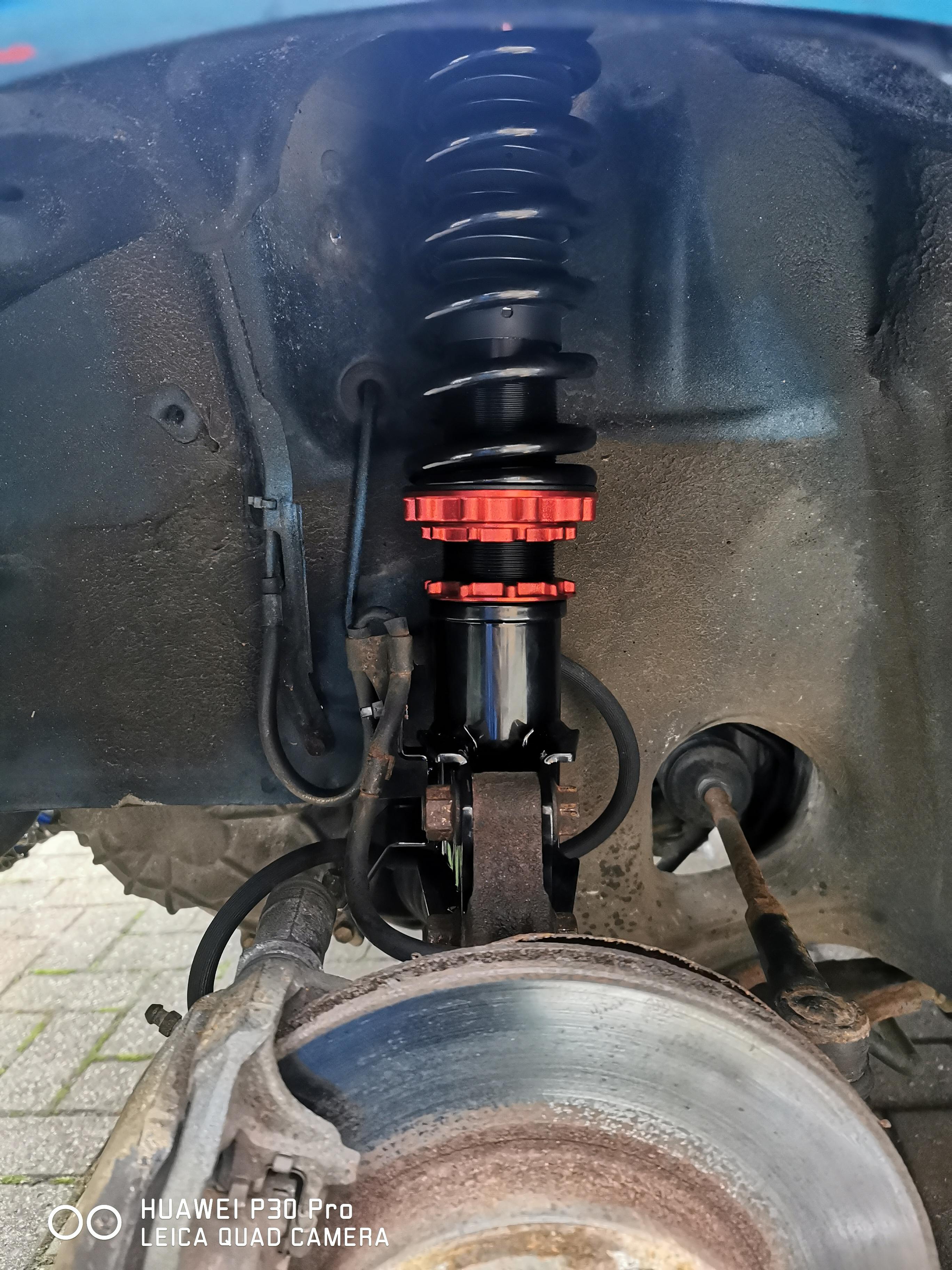

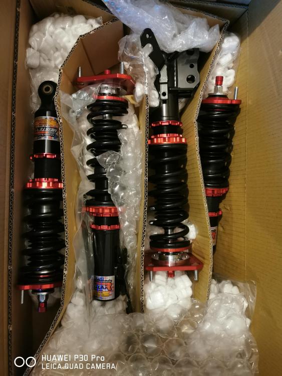

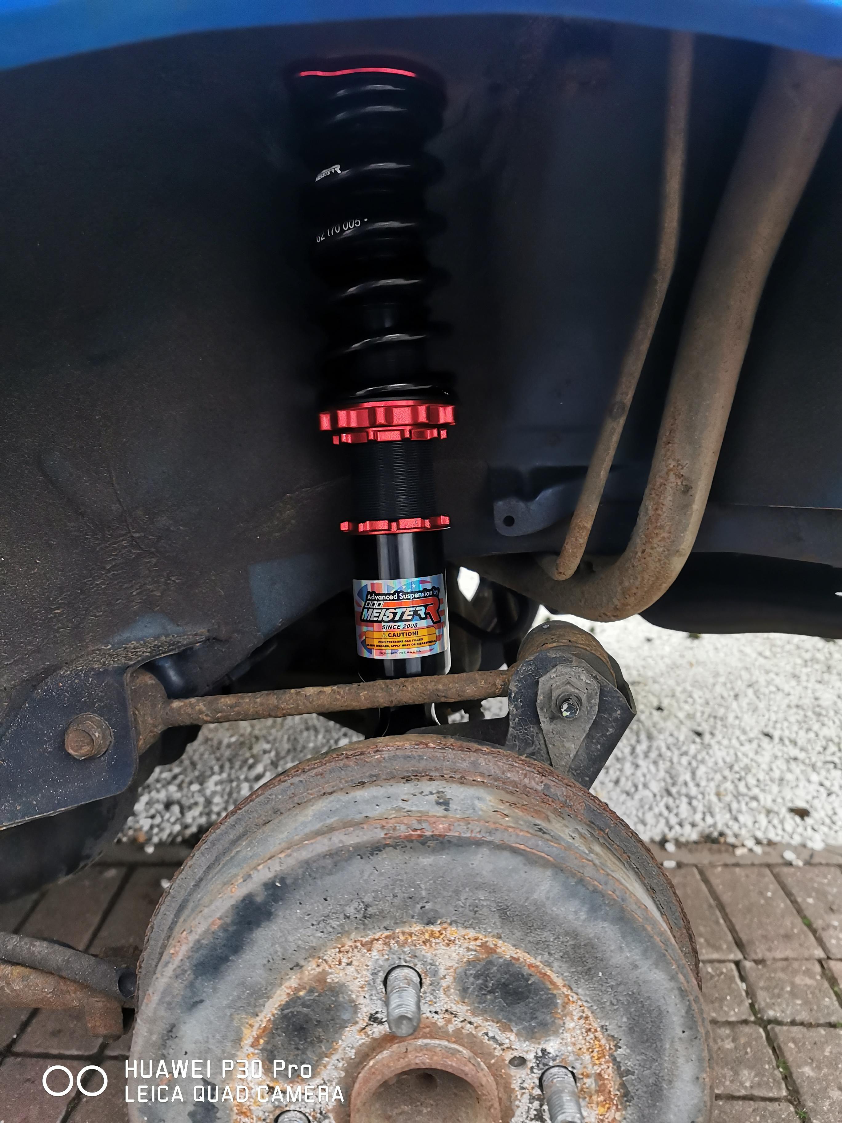

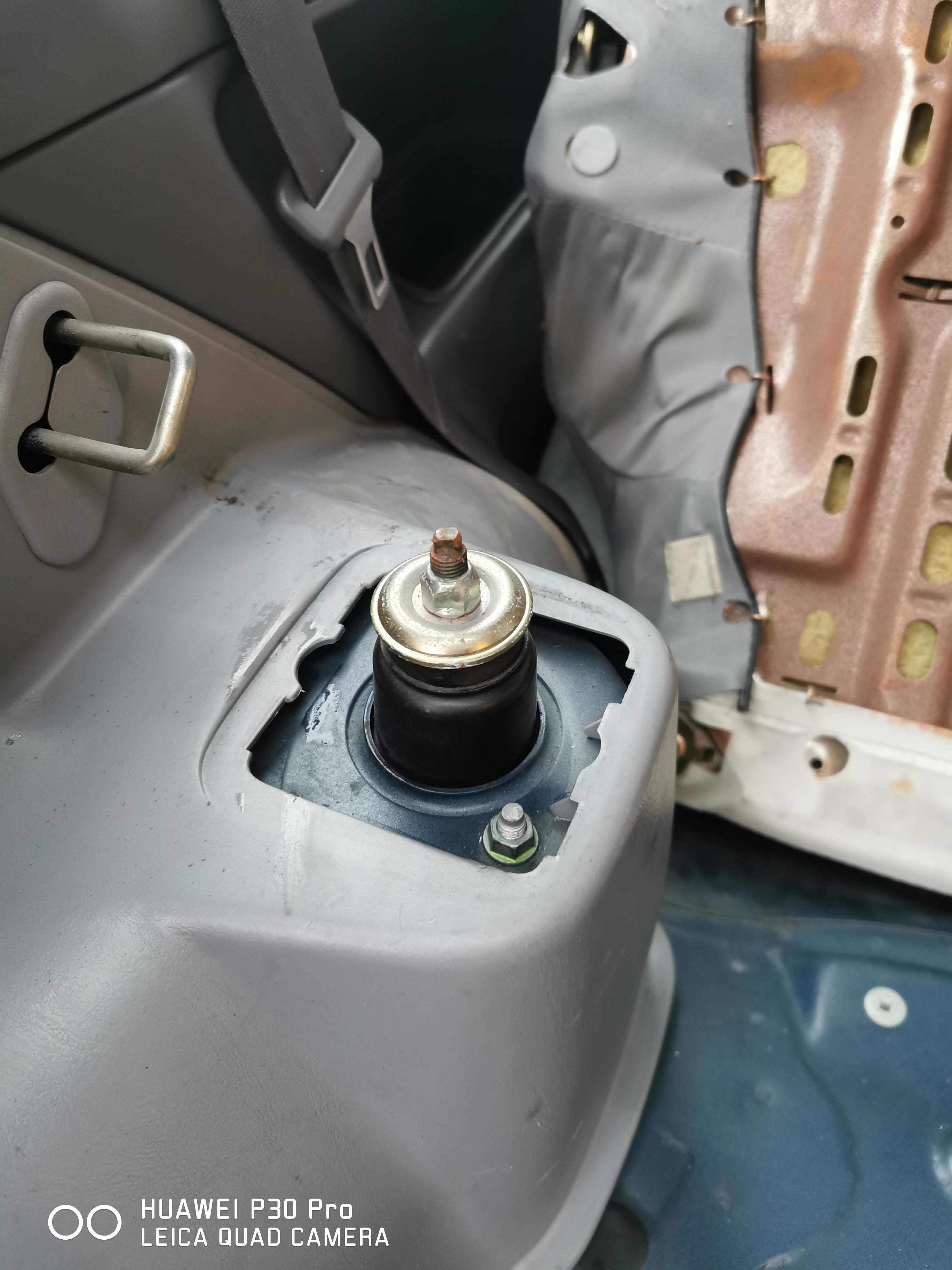

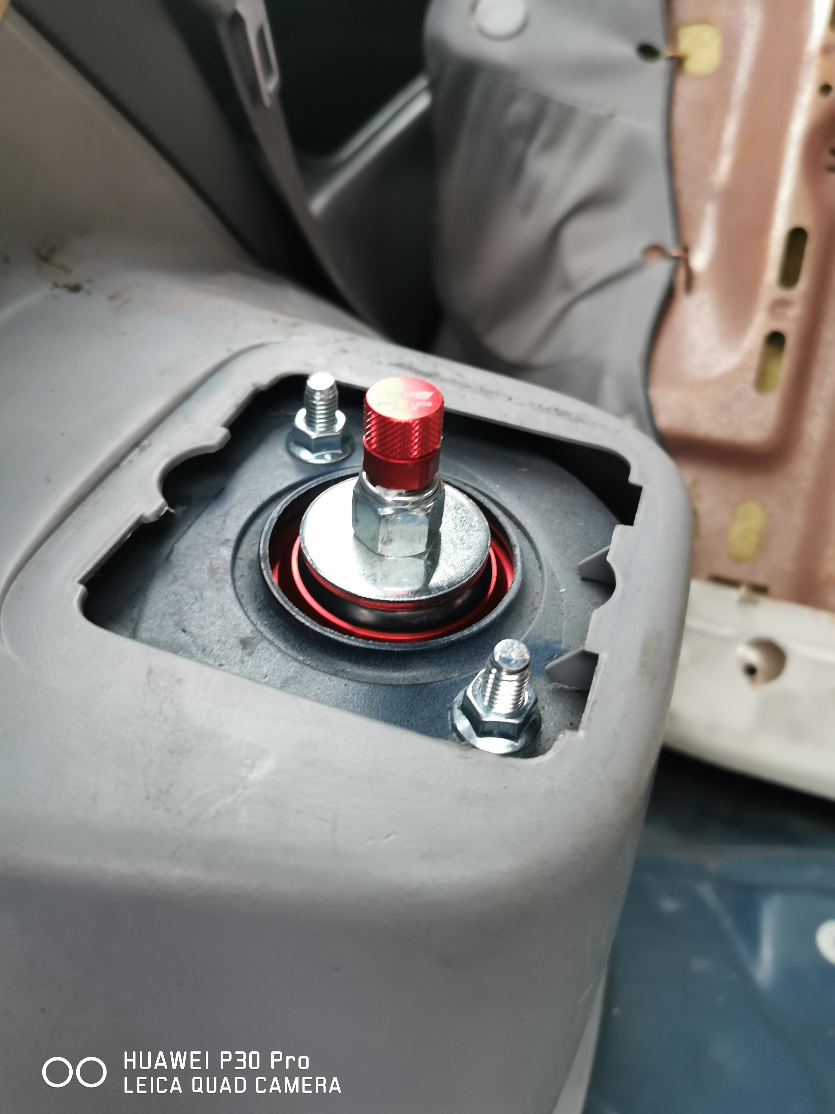

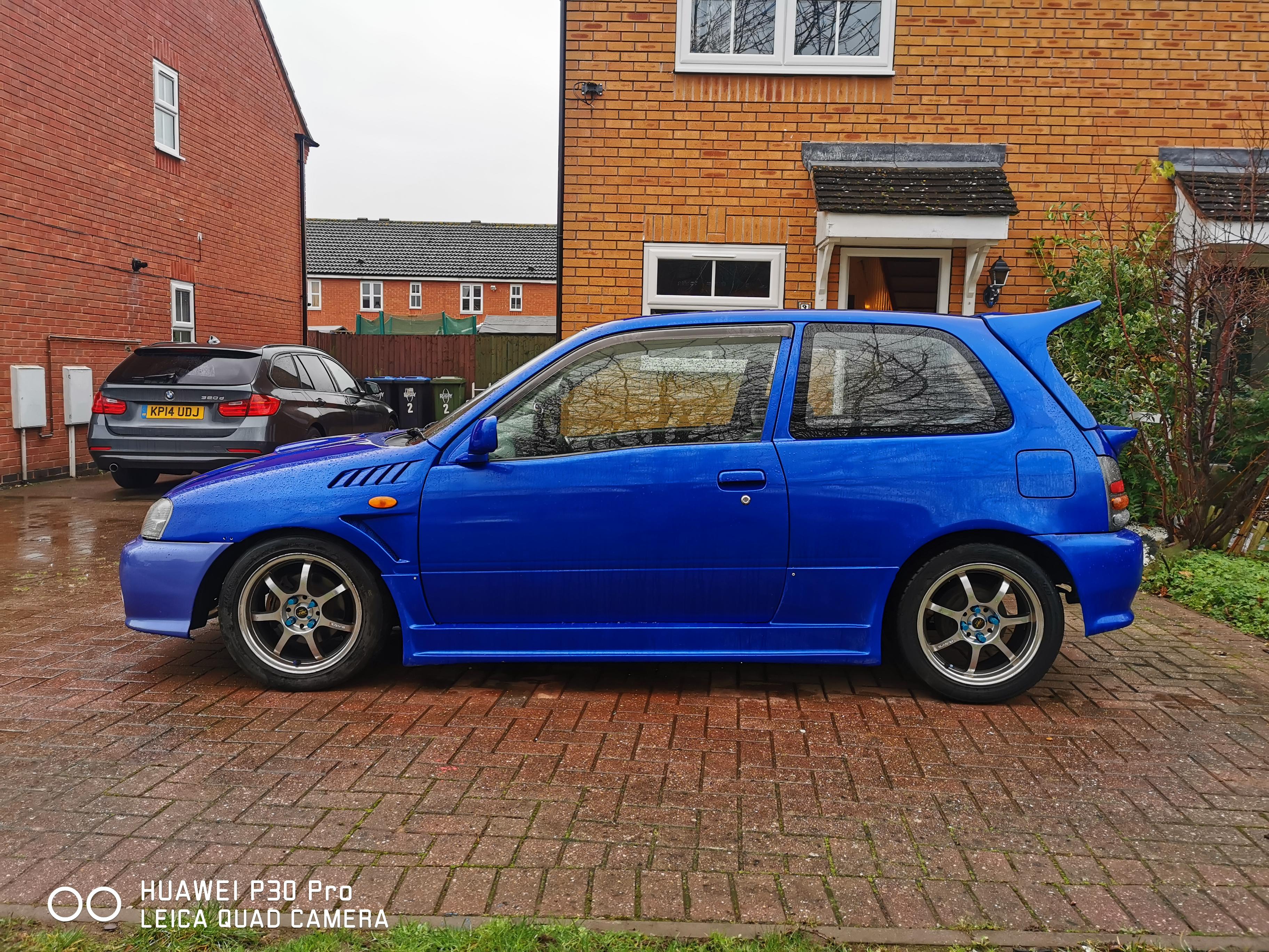

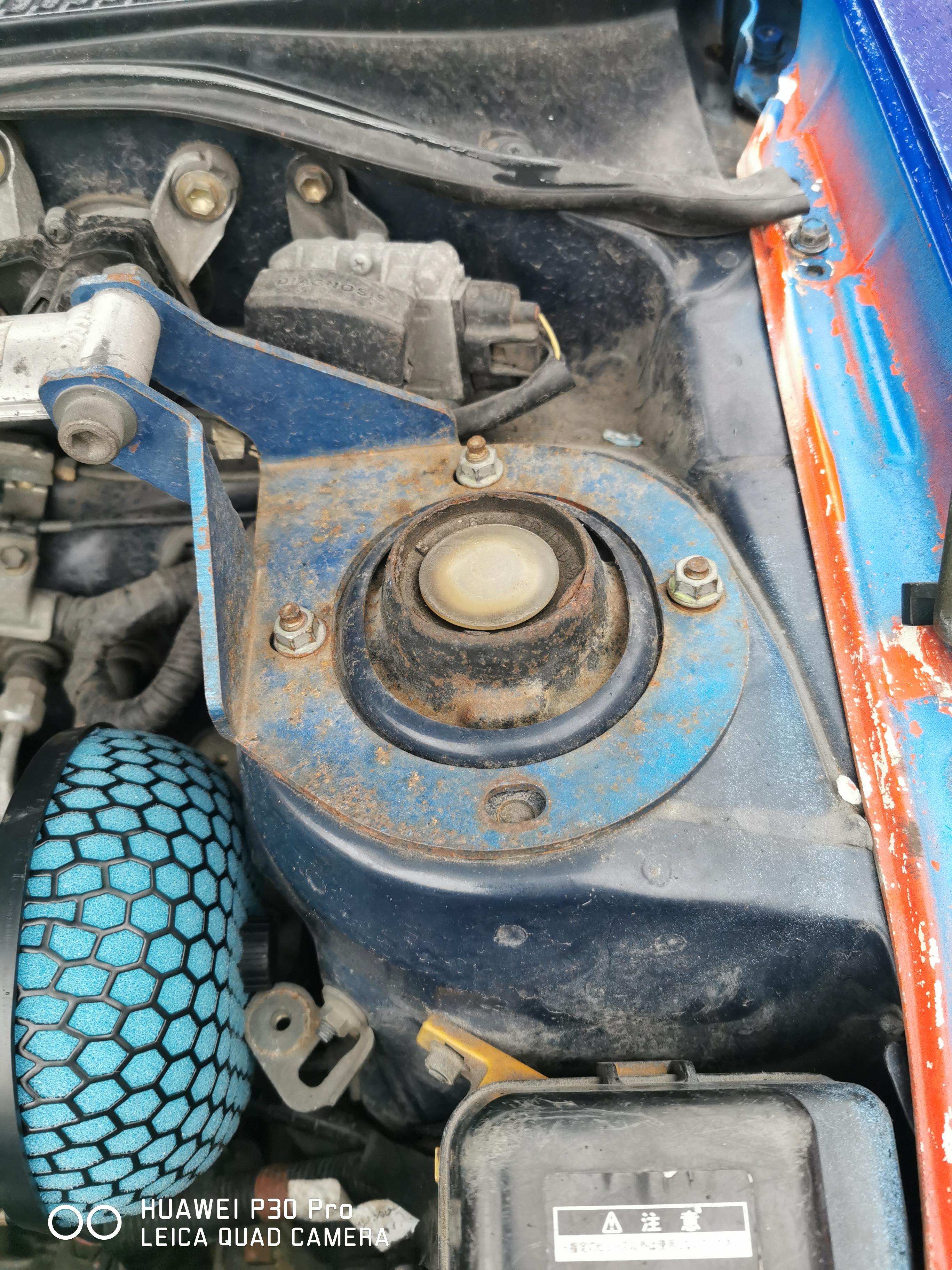

So more progress and more problems.

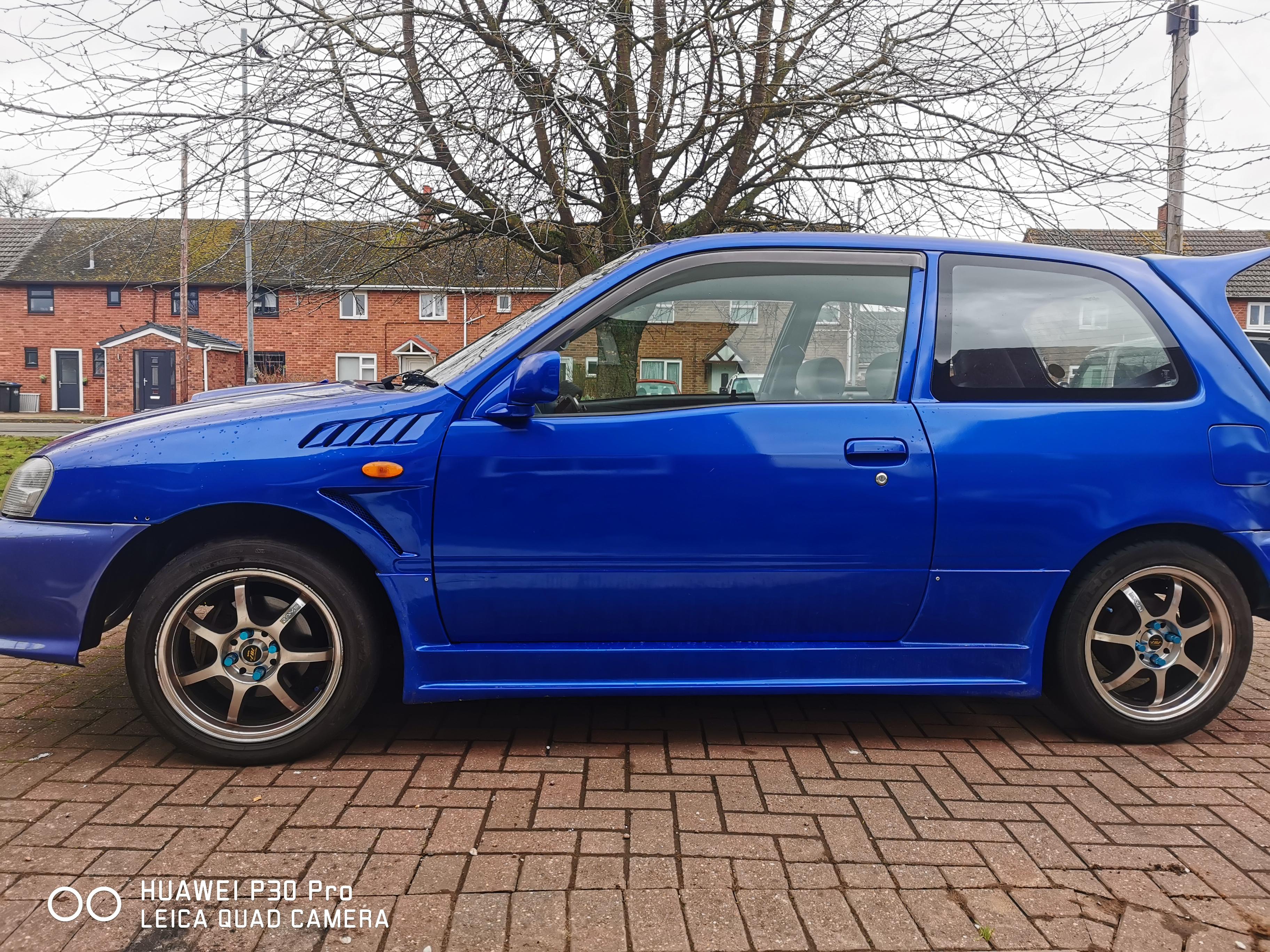

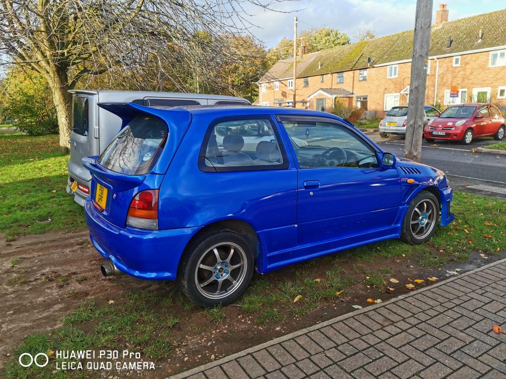

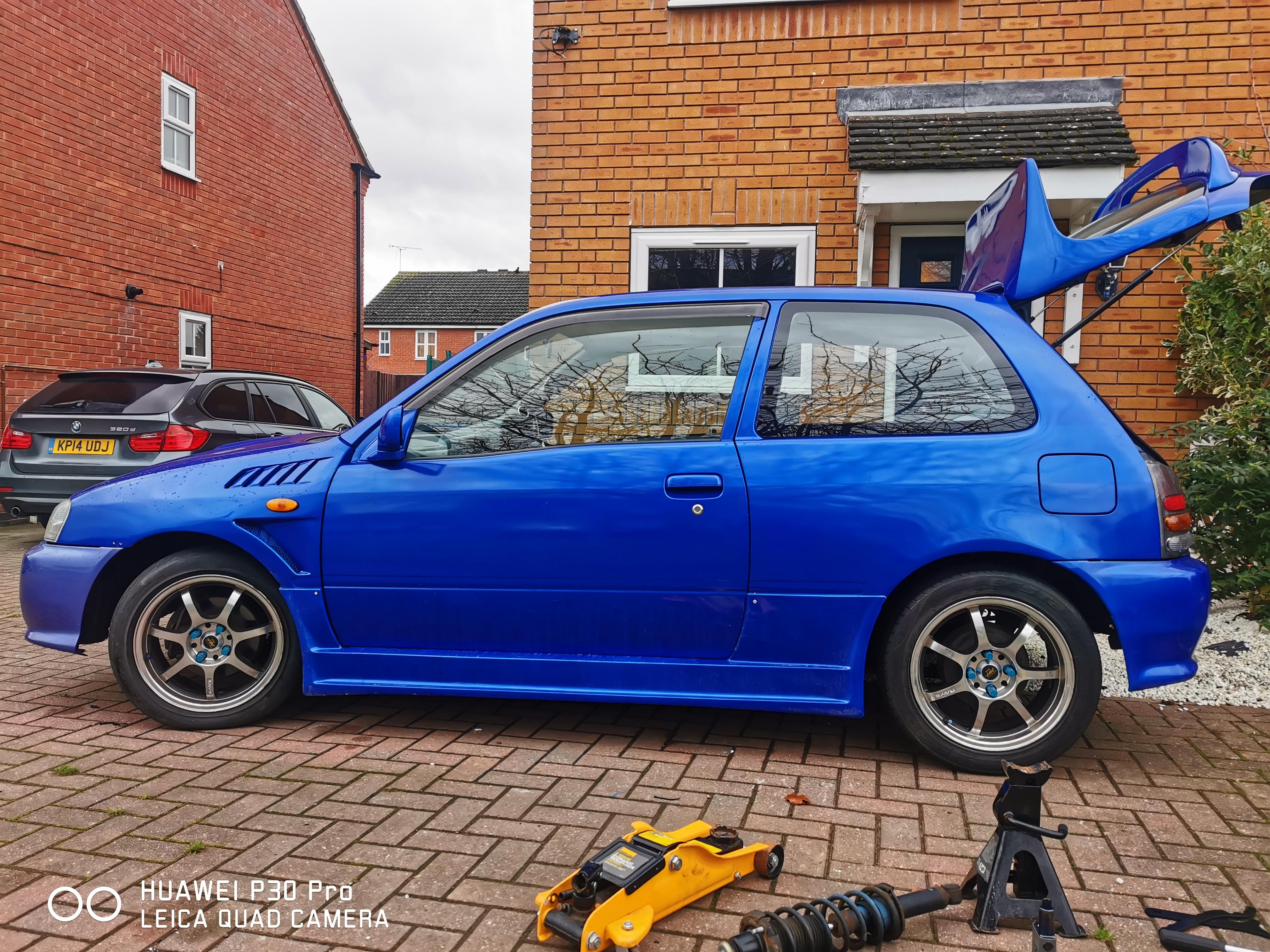

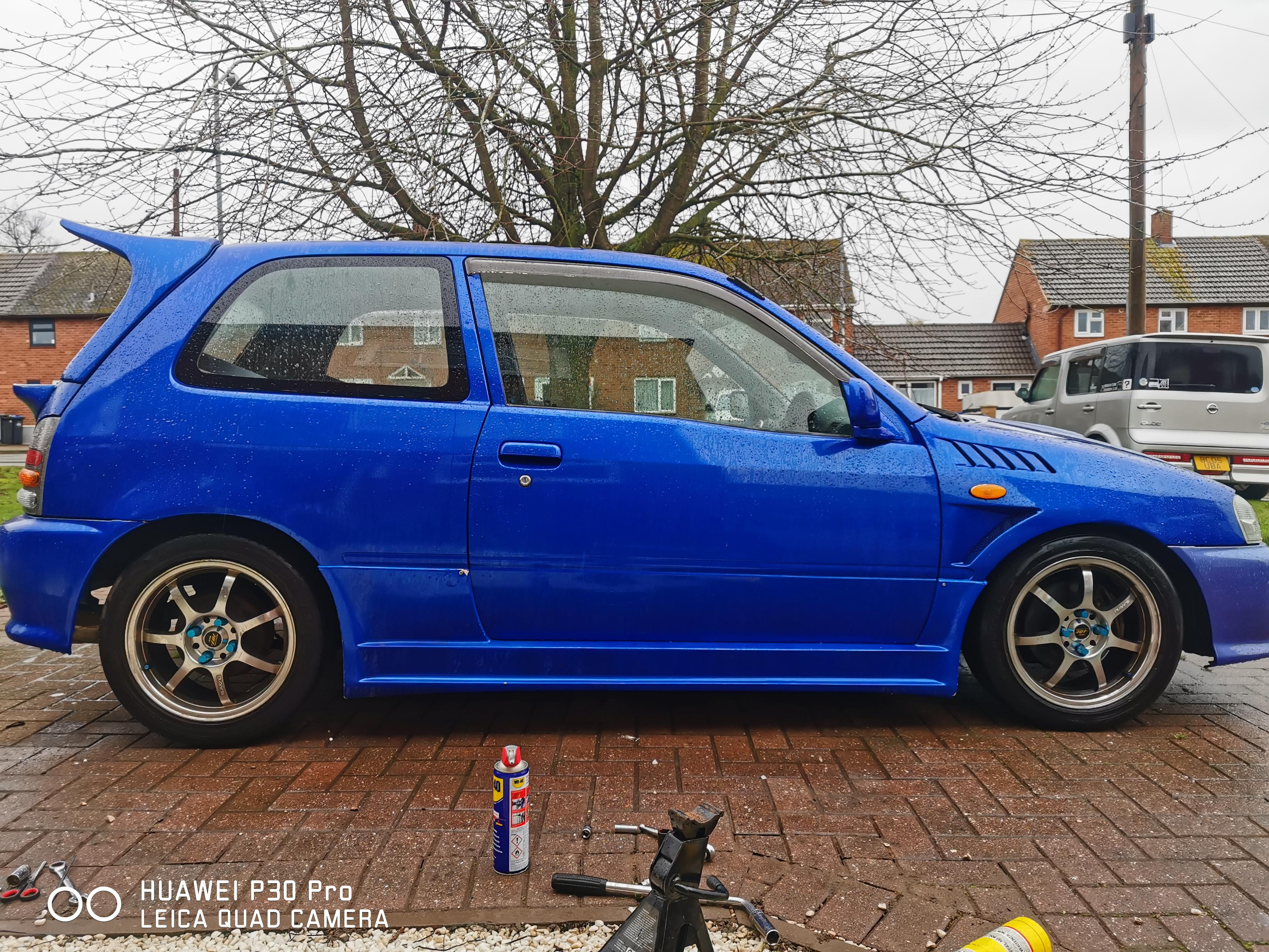

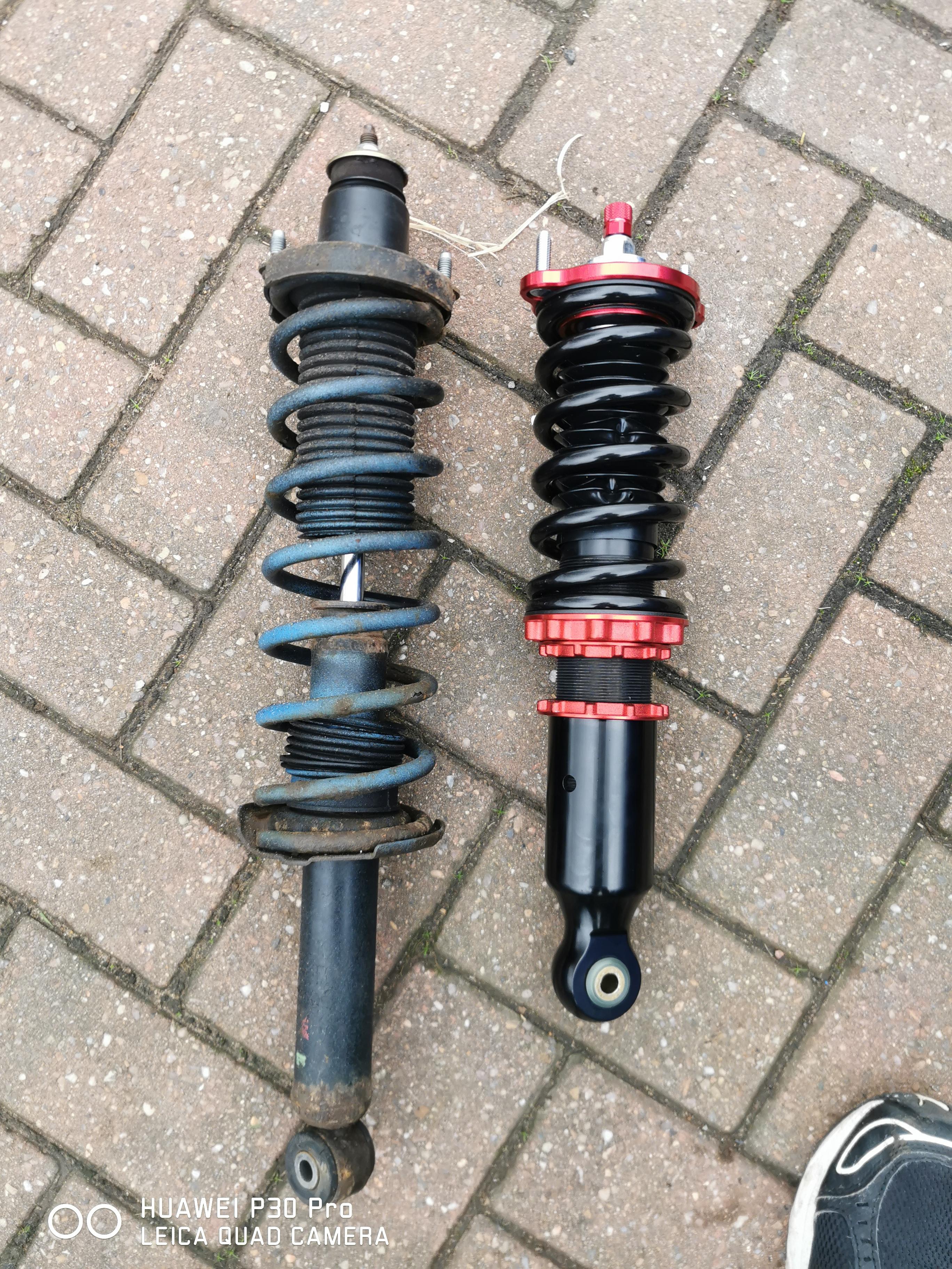

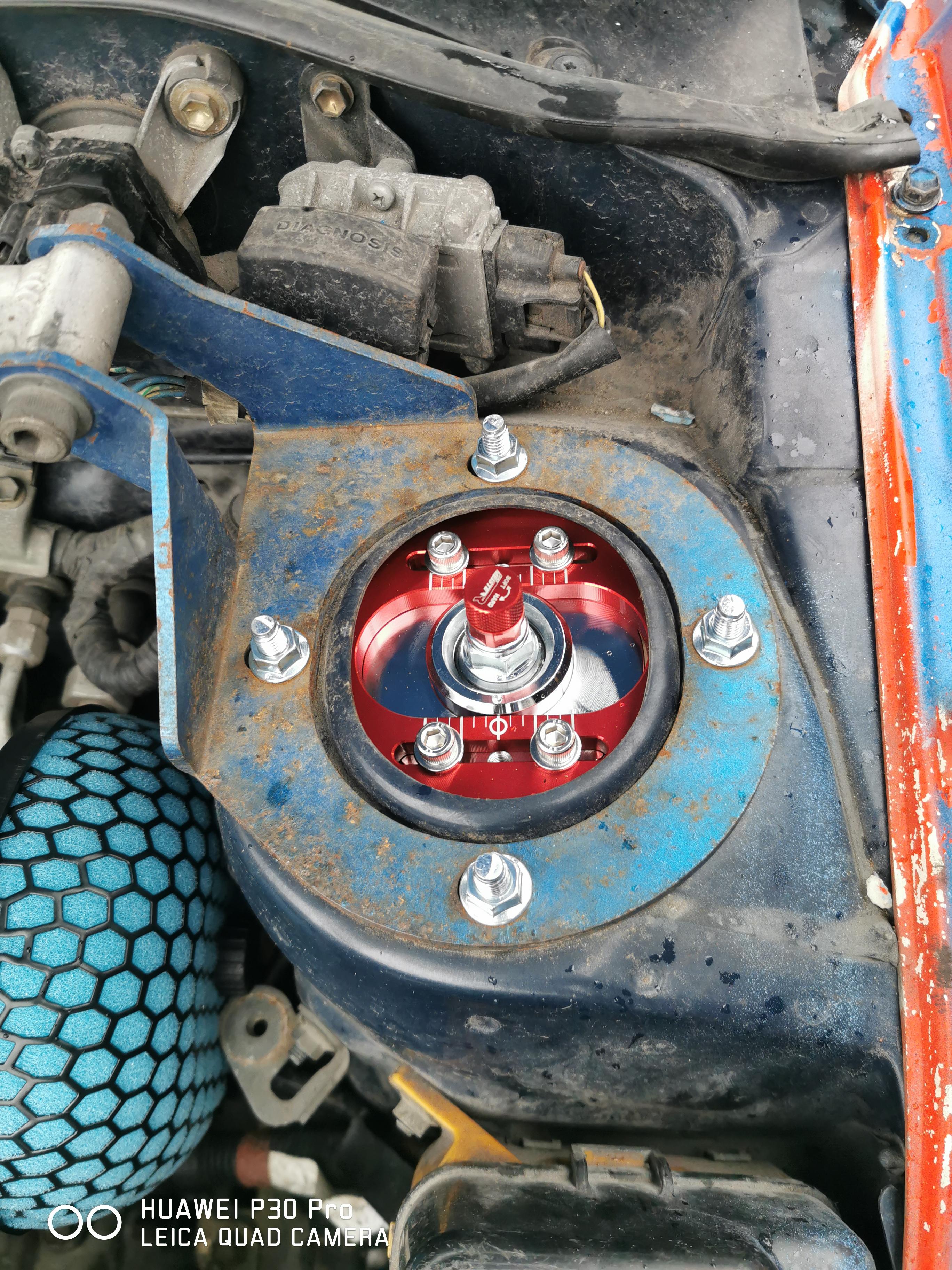

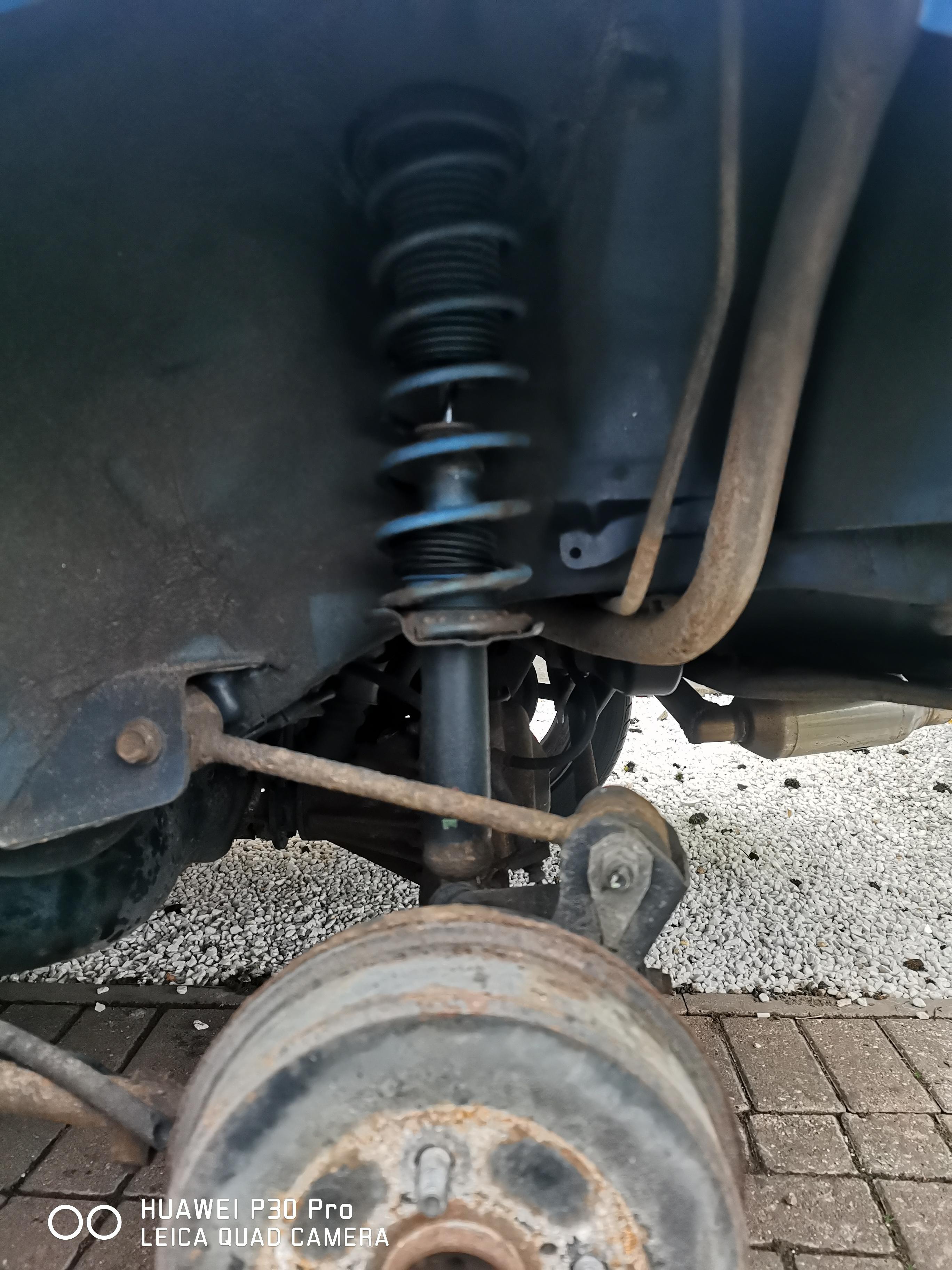

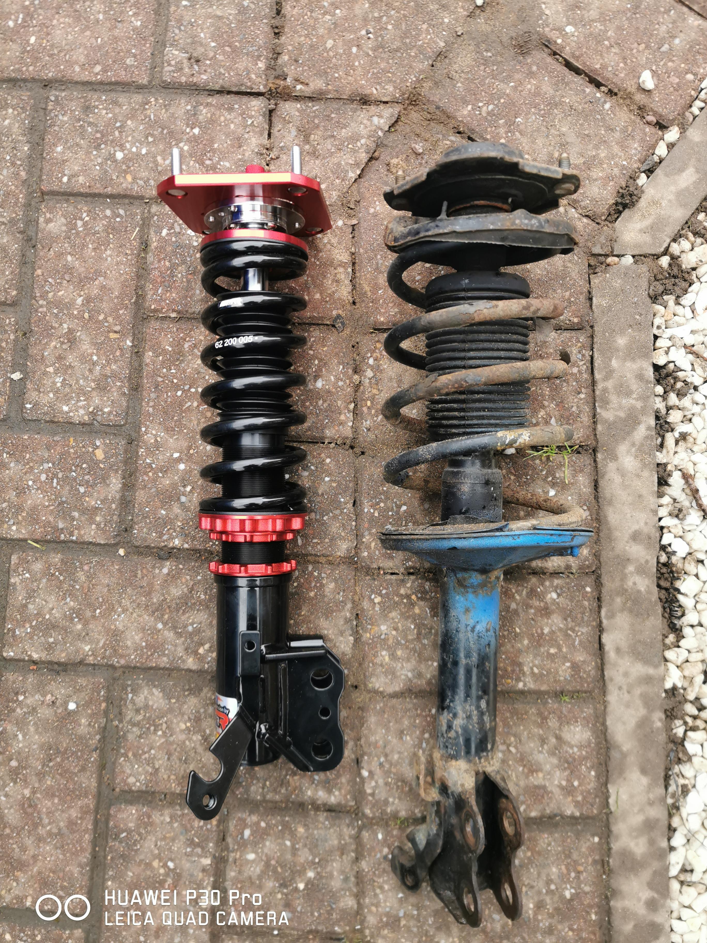

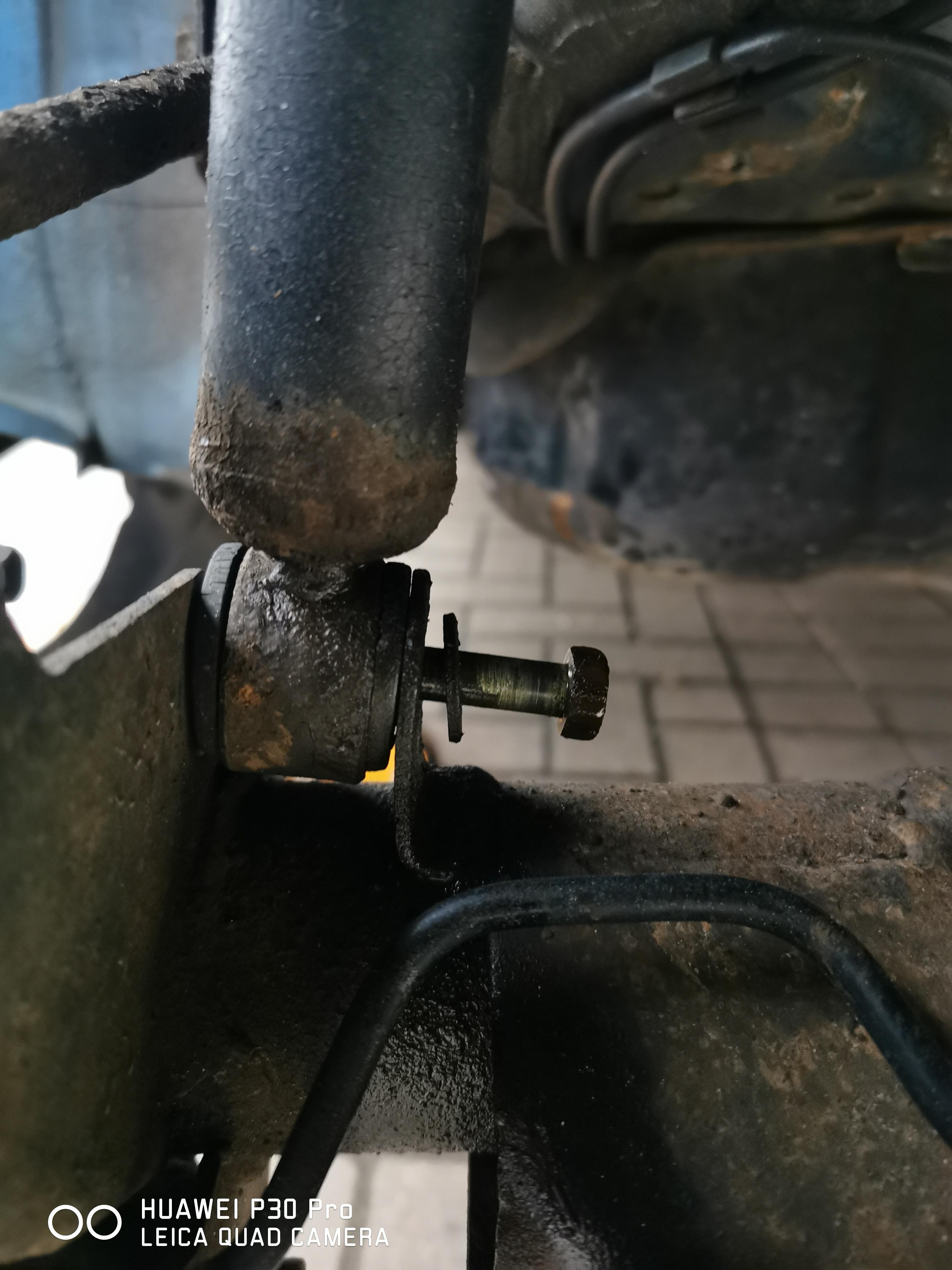

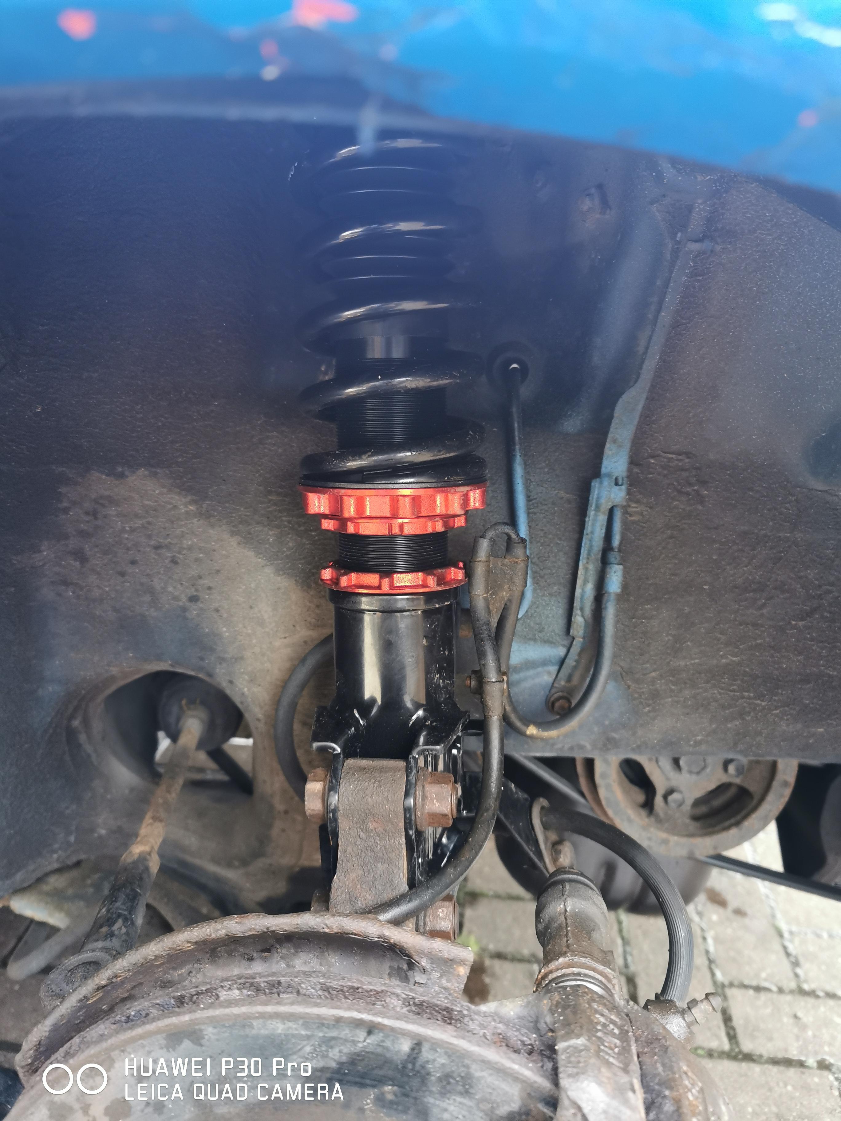

I couldn't just leave those coilovers sat in their box, so despite the lousy British weather I decided to get them on. These cars are so bloody easy to work on.
It's fair to say it was sitting a little high.
Started with the rears just to make sure I had been sent the correct kit.
IMG_20201204_095112.thumb.jpg.8b69f646976b78d40e0fd6b44e8a55d6.jpgIMG_20201204_095118.thumb.jpg.44eec89dc5a089d65c9ec030d0faac18.jpgIMG_20201204_095122.thumb.jpg.46b541cb3f684de13822d9b522a28550.jpgIMG_20201204_095141.thumb.jpg.6848cb889da65ed32c8462f9b187824e.jpgIMG_20201204_100655.thumb.jpg.dfea2578ec01ca5c5f12be7e046b10df.jpgIMG_20201204_101730.thumb.jpg.be18f6ea7b5a3ae2a2c05374a307c3ee.jpgIMG_20201204_101739.thumb.jpg.7c441de6b96ba7499676411d94ae6ec0.jpg
Don't really need to put pictures of me doing the other side, it's all the same.
Front next
IMG_20201204_112255.thumb.jpg.72a8721695845307fbd7c68a15b3ff20.jpgIMG_20201204_114412.thumb.jpg.e5e84fbcd29c391b1645151fbe73b085.jpgIMG_20201204_114837.thumb.jpg.61ef2b89c4ceec126e96b029edfde89d.jpgIMG_20201204_120444.thumb.jpg.f249f4b7870630a6a63cc4b33067f298.jpgIMG_20201204_120452.thumb.jpg.6aae31b496d73b2e446d1d37ffbcd8d1.jpgIMG_20201204_125306.thumb.jpg.9dea296a891fa0a30207fbf031d4872c.jpg

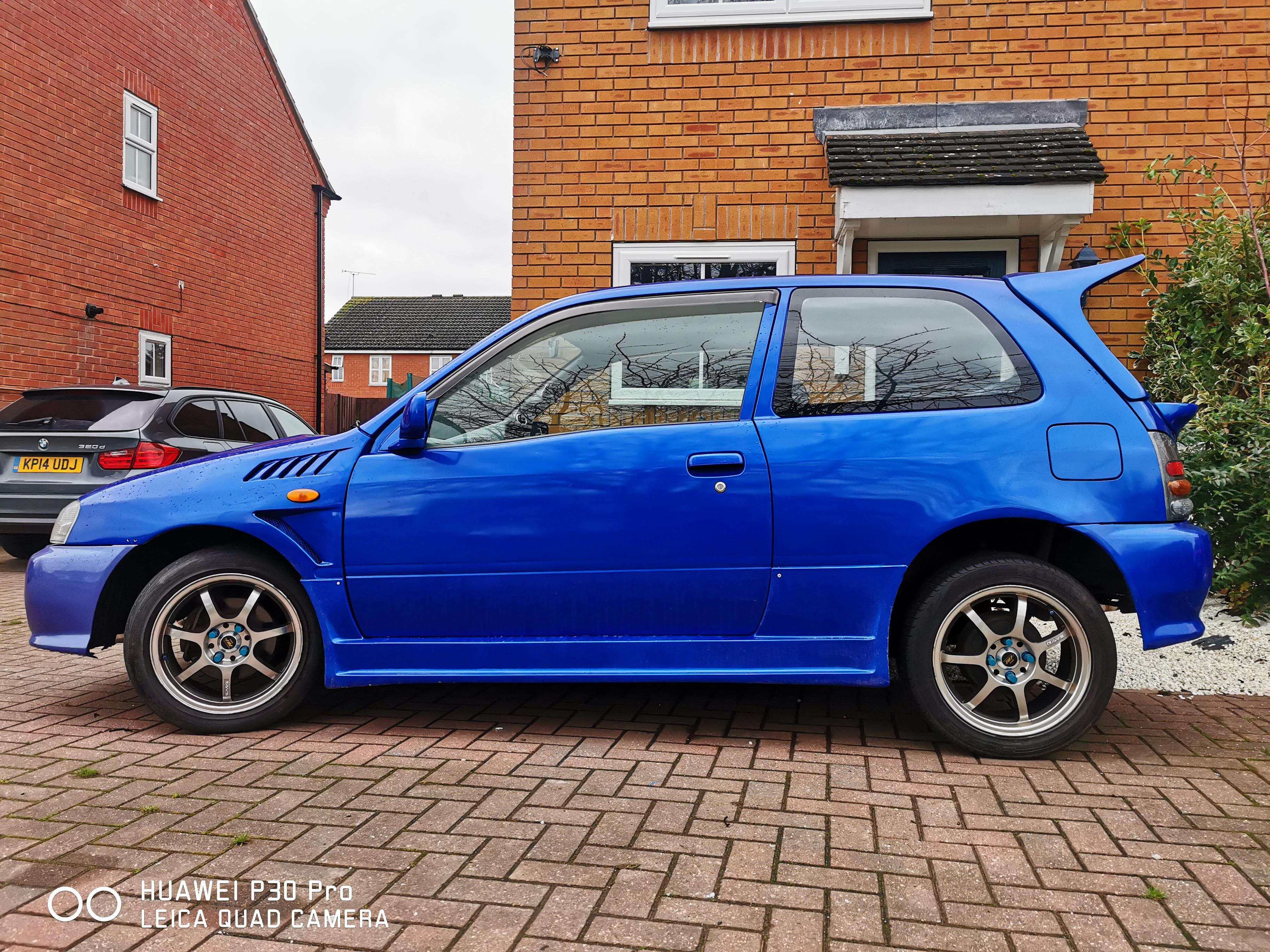

And the end result
IMG_20201204_130136.thumb.jpg.e4fa1308c776df1012b8b1c0d791d700.jpgIMG_20201204_130211.thumb.jpg.ef02eb74b7f346ffced012b080021987.jpgIMG_20201204_130150.thumb.jpg.b70f9b8a237536a80e8d9f494c99e5bf.jpg
and just for comparison

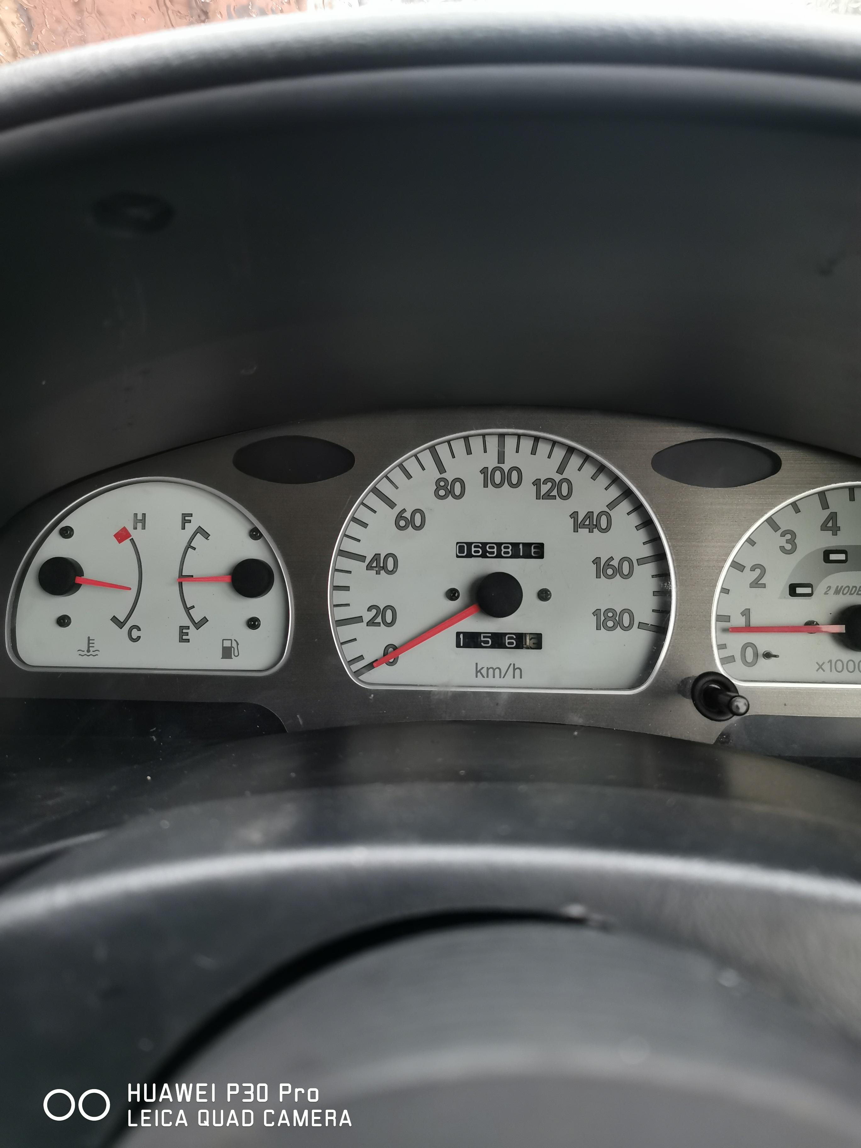

Will still need to sort the panhard rod, and get it in for an alignment. There was a little bit of arch rub on the test drive, so I might up the preload a bit and see if that helps. Also seemed to get a rotational knocking noise on the test drive, so will need to check that I did everything up and maybe look at the cv joints.
And on the test drive I discovered that 1/3rd of a tank on the guage actually means your gona be walking. 😂🚶‍♂️🤦‍♂️
This is where it sits with just 5.5l from empty lol.
Edited by Wardyep95
remove excess pictures
Link to post

Good progress so far. You'll love the 4wd when you get some decent power through it.
You can get aftermarket adjustable panhard rods and even 4 or 5 link kits for AE86 to fit to these, to help with the rear alignment. Or to get the back a bit lower.

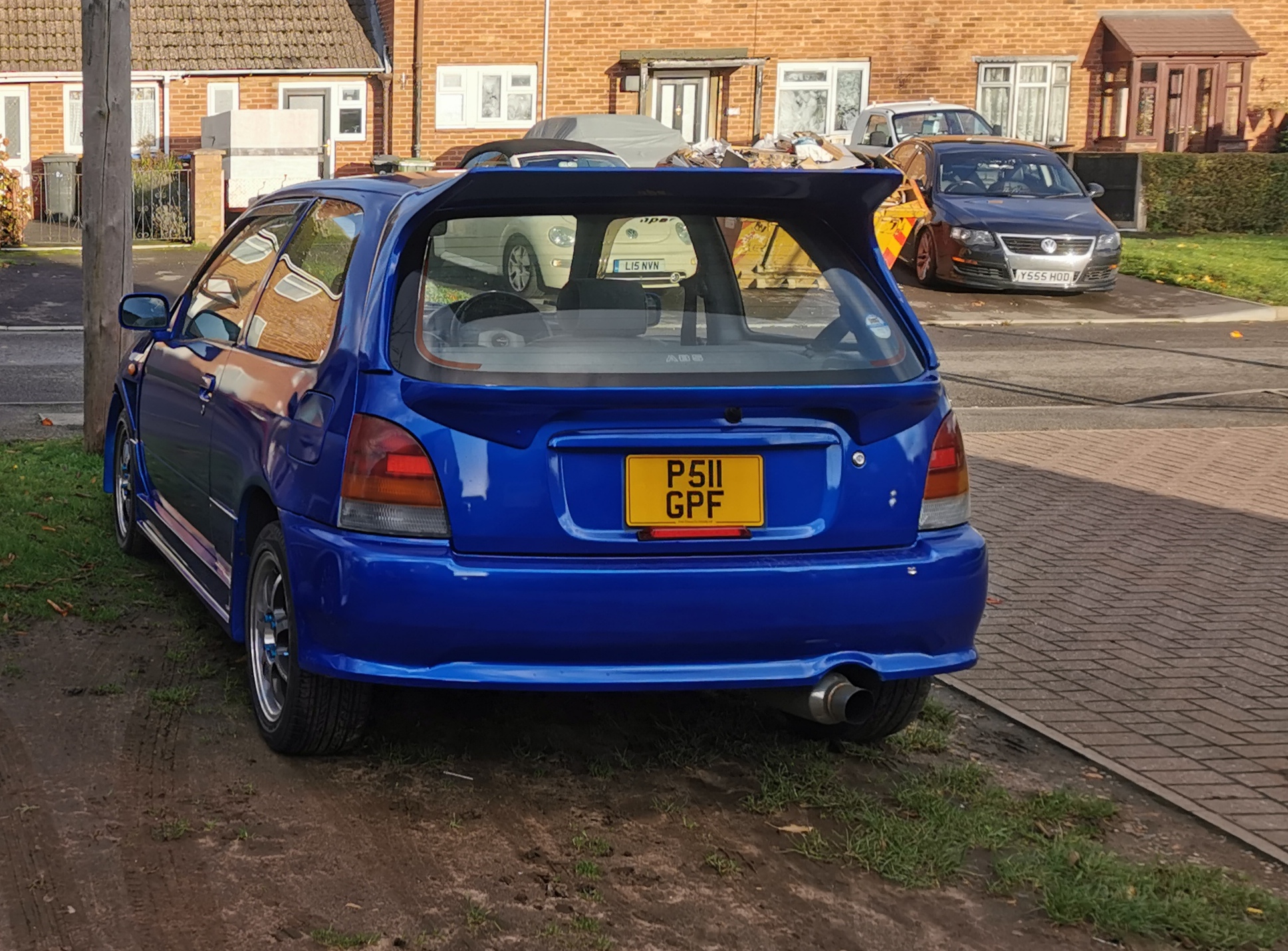

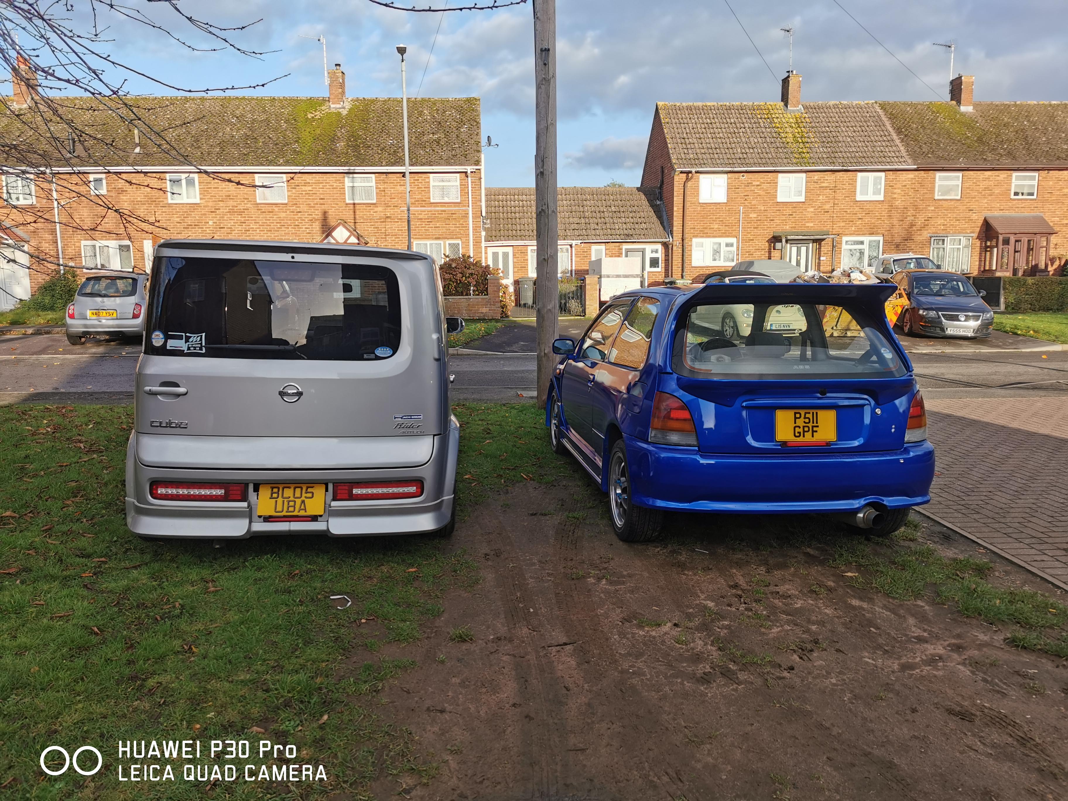

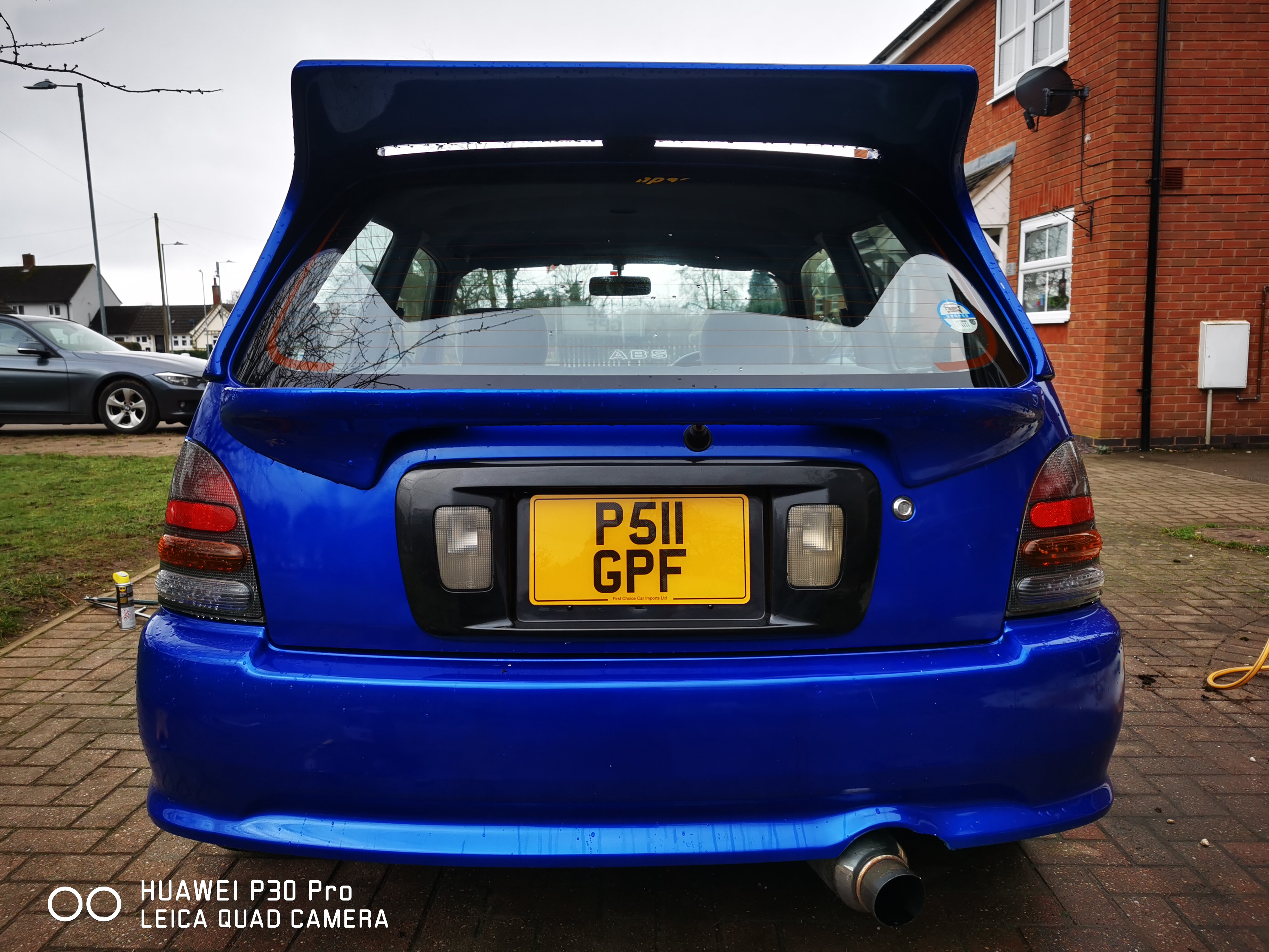

Not much progress at the moment, trying to recover financially from Christmas and the coilovers. Decided to chop some holes in the Bootlid to try and give it the proper glanza look from the rear. I can honestly say it's the first time I've ever taken a grinder to a perfectly good panel haha. IMG_20210209_202154.thumb.jpg.38a8fb51844a644a3fb7c6bd2b11cbcd.jpgIMG_20210205_122520.thumb.jpg.a2cf1586b573e25a4af99634cc372892.jpg
I know it's the wrong colour but I'll worry about that later.
