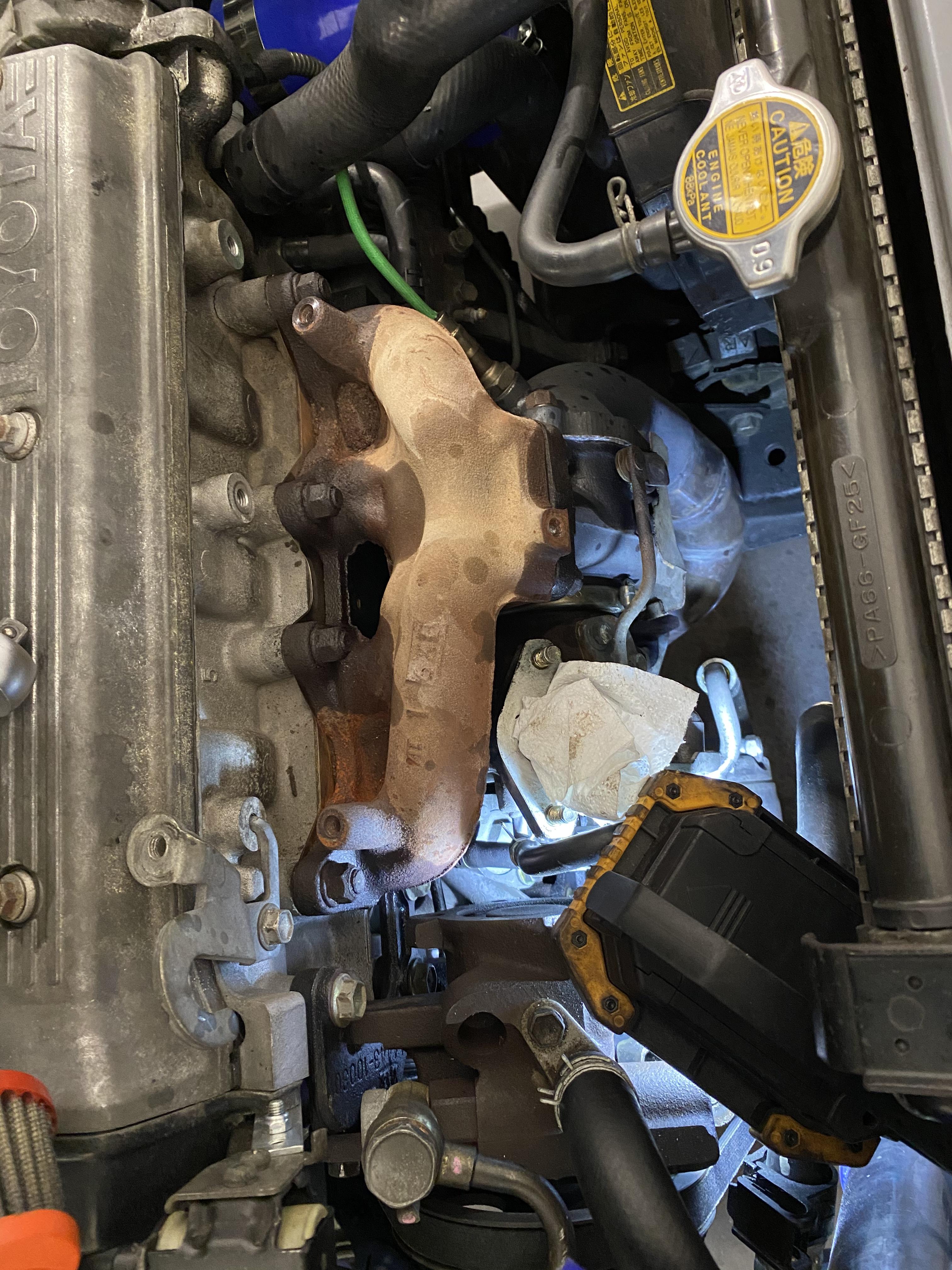

Frankieflowers Posted January 20, 2022 Author Posted January 20, 2022 20 hours ago, Claymore said: First I would check that the manifold is actually cracked. Sometimes a damaged / leaking gasket can cause the same noise. You need to inspect the manifold for cracks. Look for black soot marks on the manifold and head. You can also hold a piece of tissue next to the manifold / gaskets and watch to see it blow as you move it around different places. As far as manifolds go I would avoid all the cheap stuff on eBay as it usually doesn't fit the engine very well and cracks very quickly. The CT9 Tubular manifold Tuning Developments sells seems ok as the first upgrade, hopefully someone using one will comment on its fit and function. If you want the top level then WEPR make excellent products. But not sure how they will fit in a corolla engine swap vehicle. Or you can try and find a second hand item from wepr, race tech, zisco but these are probably quite rare in Italy. The question is do you want to upgrade to TD04l or stick with CT9 / hybrid? 😈 Thank you. I really wanted to get rid of them stock manifold internal flow reduction. Like you did in one of your threads where are you were showing the process of making the air flow better. I would keep the ct9 to stay around 180 hp for a daily use. I’m saving the money to buy the emu classic that my shop will map from scratch. It’s quite a lot of money including the lambda... but first I have to be sure that everything mechanic wise works. can you link the thread where are you modify the stock exhaust? Of course the FTE engine manifold. Thanks Quote

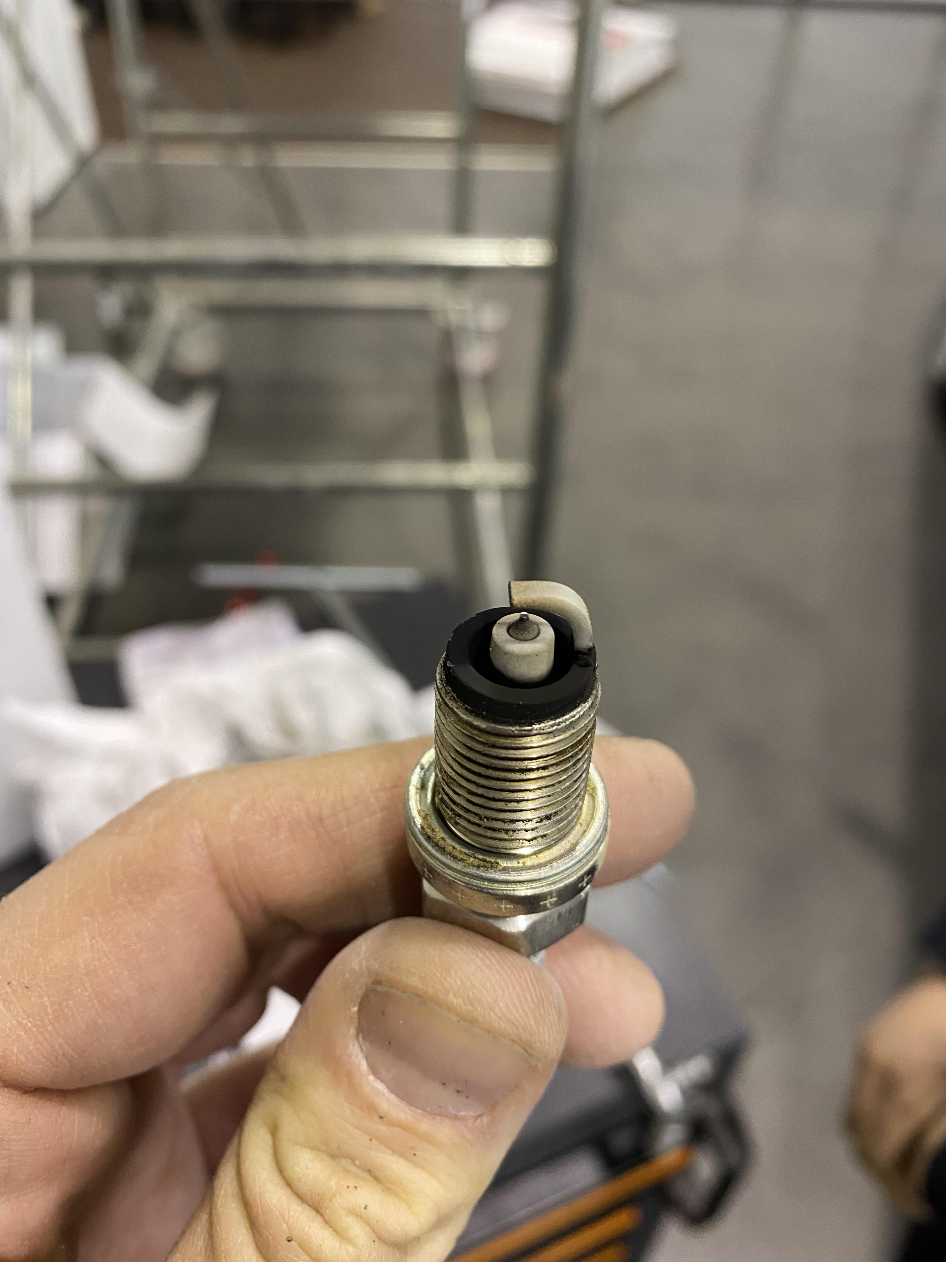

Frankieflowers Posted January 25, 2022 Author Posted January 25, 2022 Last time I checked spark plugs I noticed they were really lean but only on the ring. Could it be the exhaust manifold with a crack? Could it be too much air on Idle? The car seems to run perfect on meat and high rpm. We didn’t try to turn off the engine on high rpm and check the spark plugs. The EXU is custom so I wonder what could be wrong.  Quote
Frankieflowers Posted January 25, 2022 Author Posted January 25, 2022 On 1/19/2022 at 6:18 PM, Sam44 said:  A ported standard manifold is a good option. Also if they crack it's easy anuff to get them welded up. We’re gonna take it off the engine to check if and where the crackers. I already spoke to my welder. Quote
Sam44 Posted January 25, 2022 Posted January 25, 2022 (edited) Them spark plugs are ok. A nice burn on that one, nice fuel atomisation. Cylinder temps are up slightly. Nothing really to be worried about. Whats the heat range on these plugs. You can run a paseo 78deg thermostat to help. I'd expect them to start to go brown. you can only really get the original 78deg 5efe thermostat from Toyota. Most listed online are starlet units 89deg. The temp of the unit is normally stamped on the thermostat. going any lower than 78deg and you will struggle to clear the windows of frost. Thats the only reason really why manufacturers go above 70degC, in cab heating. for best power it's 60 to 70degC coolant temp that achieve this.  Edited January 25, 2022 by Sam44 Quote
Frankieflowers Posted January 25, 2022 Author Posted January 25, 2022 How do we get the exhaust manifold off? The turbo bolts are hard to reach. Quote

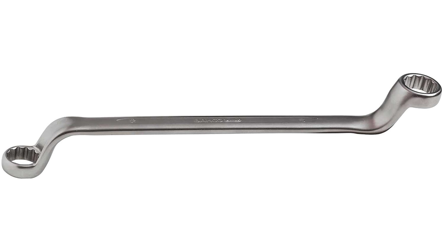

Claymore Posted January 25, 2022 Posted January 25, 2022 1 hour ago, Frankieflowers said: How do we get the exhaust manifold off? The turbo bolts are hard to reach. From memory to access the turbo to manifold nuts I needed to use offset spanners: Most people remove the manifold with the turbo still attached to it because the bolts are hard to access. In my experience the Toyota EP91 4efe/4efte thermostat (90916-03046) is stamped as 82 deg C which is what I removed from my engine. The Toyota epc states 82-95 (I assume this is starts to open at 82, fully open at 95). Found the euro Paseo 5efe 95-97 thermostat (90916-03082) rated at 76.5-90 deg C Quote

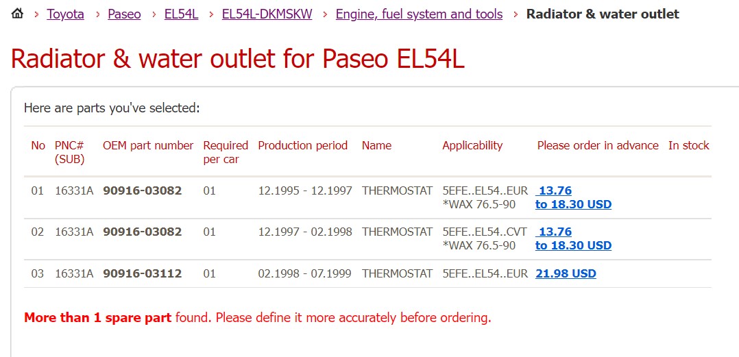

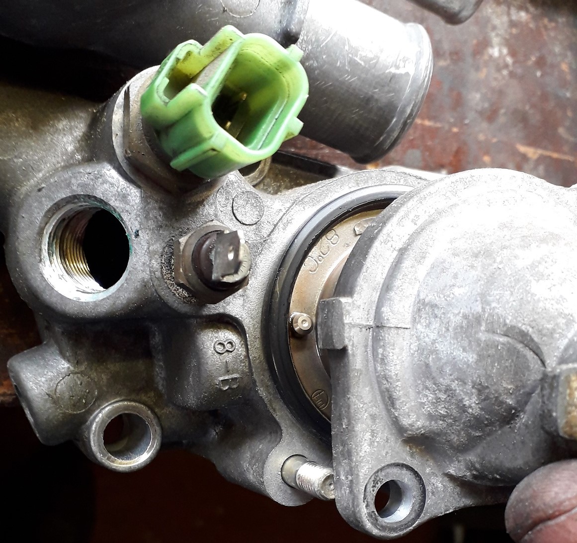

Sam44 Posted January 25, 2022 Posted January 25, 2022 (edited) Legend, great find claymore. Thank you. The nice gentleman has put a pic above showing that on these factory thermostat you can find the operating temp. is this a Toyota part number?. yeh my starlet on its standard stat regulated at 89degC near anuff constantly until I put the paseo unit in this runs around 78deg Near anuff constantly. 11 degC doesn't sound alot but to a engine were heat is a by-product and does more harm than good this makes a good difference. Edited January 25, 2022 by Sam44 Quote
Claymore Posted January 25, 2022 Posted January 25, 2022 5 minutes ago, Sam44 said: Legend, great find claymore. is this a Toyota part number?. yeh my starlet on its standard stat regulated at 89degC near anuff constantly until I put the paseo unit in this runs around 78deg Near anuff constantly. 11 degC doesn't sound alot but to a engine were heat is a by-product and does more harm than good this makes a good difference. From the online parts catalogue I use: Doesn't say deg c in the description but neither did the ep91 listing and the Starlet thermo is marked 82 deg C so it's a safe bet.  Quote
Frankieflowers Posted January 25, 2022 Author Posted January 25, 2022 1 hour ago, Claymore said: From memory to access the turbo to manifold nuts I needed to use offset spanners: Most people remove the manifold with the turbo still attached to it because the bolts are hard to access. In my experience the Toyota EP91 4efe/4efte thermostat (90916-03046) is stamped as 82 deg C which is what I removed from my engine. The Toyota epc states 82-95 (I assume this is starts to open at 82, fully open at 95). Found the euro Paseo 5efe 95-97 thermostat (90916-03082) rated at 76.5-90 deg C Problem is that the two bolts underneath the manifold are impossible to reach. How can I get there to get the manifold with a turbo attached out? Quote
