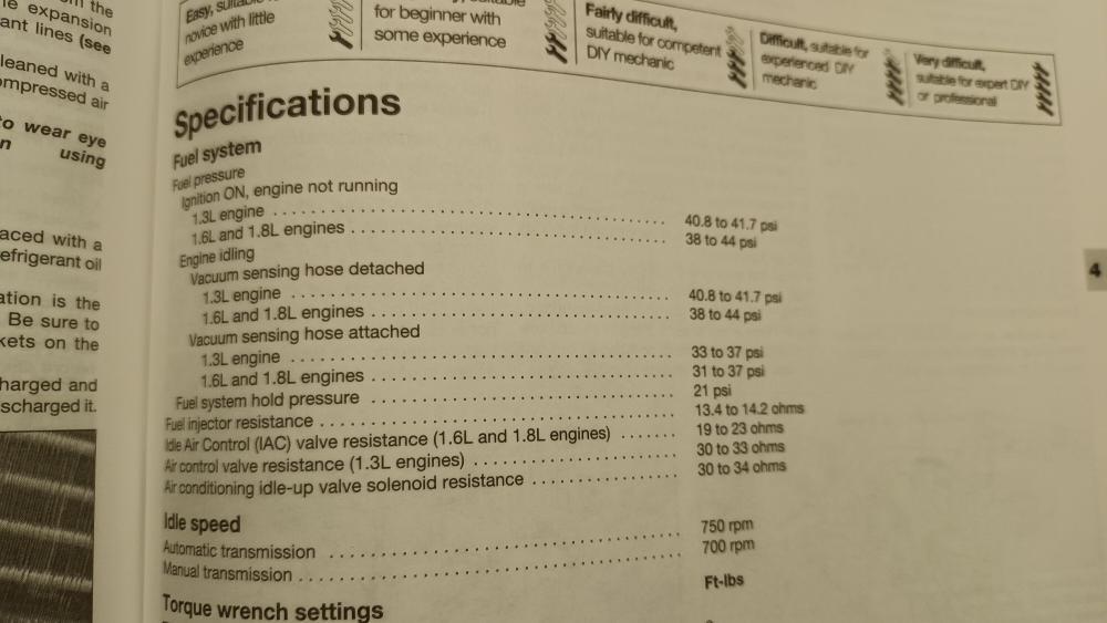

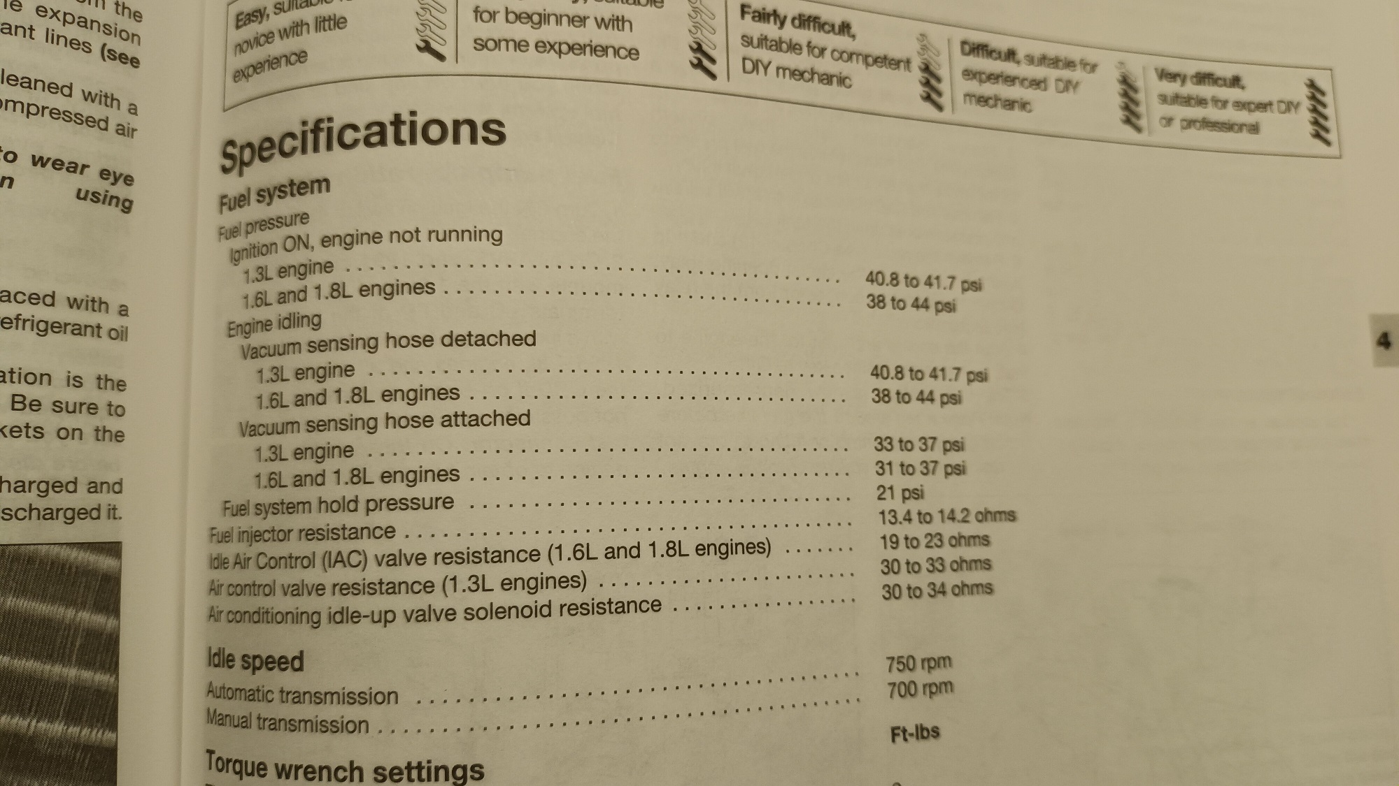

Claymore Posted January 25, 2022 Share Posted January 25, 2022 (edited) Just to add my research to this thread for 4efe. Have not measured on an actual vehicle yet. The 4efe (gen 2) Starlet 96-99, 4efe (gen 1) corolla 92-97 and 4efe (gen 3) corolla 97-99 and 5efe Paseo 95-99, all list the same fpr part number (23280-11070). There is no Starlet Haynes manual but there are for the 'rolla's. (92-97 rolla shown below) Both Haynes manuals show a base fuel pressure of about 2.8bar and manifold referenced fuel pressure at idle of about 2.4 bar. That is what the Haynes manual states is correct. Can't say for the 4efte as it uses a different reg (23280-11040). If someone can ask Jay on the other forum (I'm not a member), he may be able to check in the official Toyota workshop manual he has for the Toyota 4efte data. Let's not forget the age of some of these Toyota fpr's and fuel systems aswell (clogged filters, weak pumps, clogged returns etc.) Edited January 26, 2022 by Claymore Clarity Quote Link to post Share on other sites
Sam44 Posted January 25, 2022 Share Posted January 25, 2022 (edited) Great information as always. Love this, the 4efe/5efe do look slightly different. I didn't measure any of the ones I did under boost conditions either I just snapped the throttle open. The ones that responded hit about 3.2bar. all the same near anuff. Edited January 25, 2022 by Sam44 Quote Link to post Share on other sites
