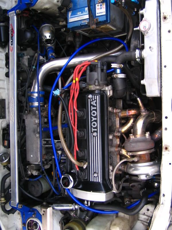

Starlet_Bristol Posted August 29, 2008 Posted August 29, 2008 Hey All,Dont really come on this forum alot, i recently fitted my new turbo Kit to my car i suppose most would have seen the update on the GTT forum but thought i would update those who might not have seen the update. Mapping it taking place this Tuesday coming and hoping to reach as close if not break the 300hp mark. Time wil tell i suppose but i think it will be more likely around 280-290 anything more and i will be very happy regardless. Quote

Sparky Posted September 3, 2008 Posted September 3, 2008 Just seen this!!What was the outcome and are the kits going to produced? Quote
StarletRick Posted September 3, 2008 Posted September 3, 2008 thats different for sure, what made you decide to topmount it? Quote
