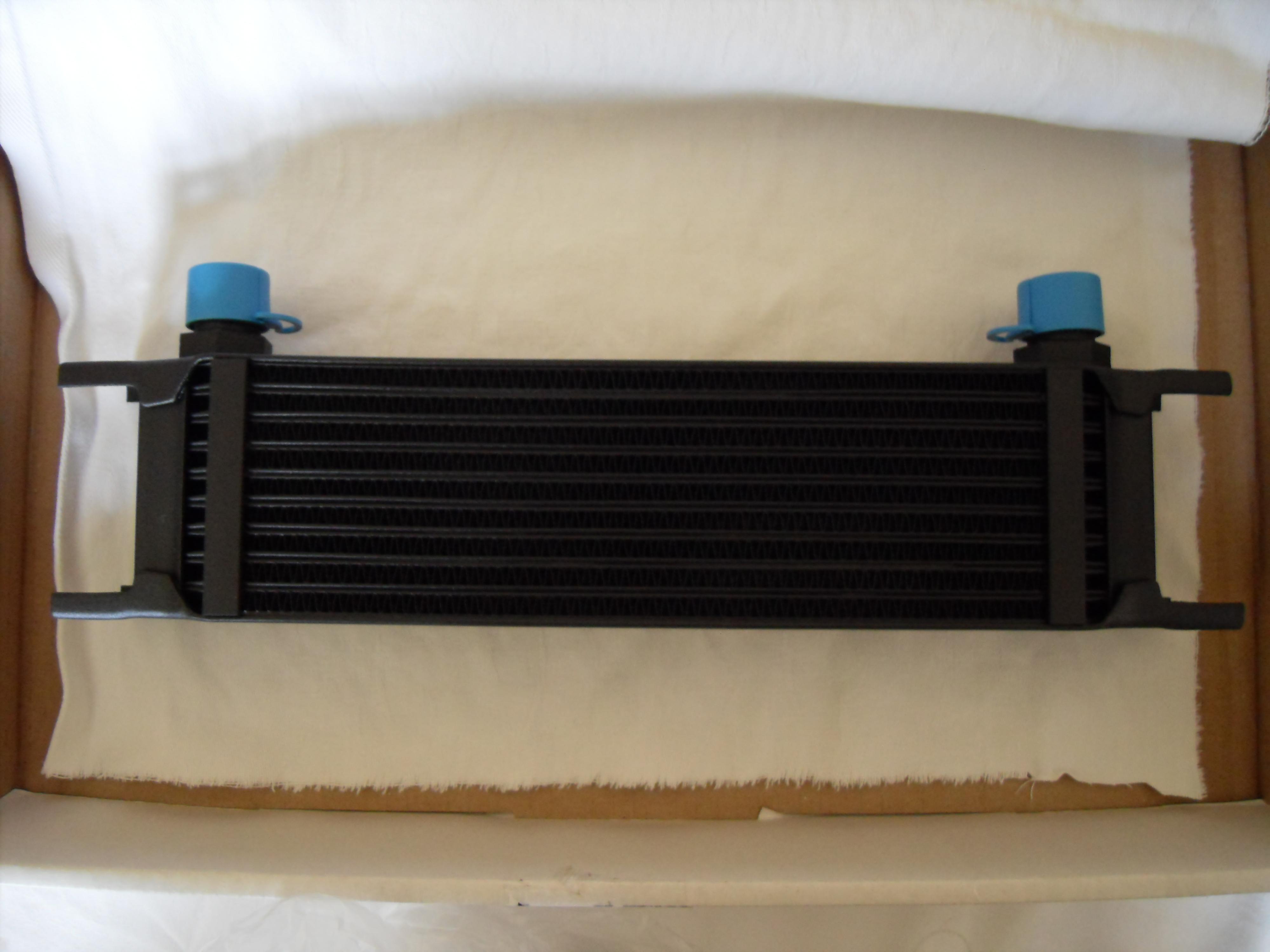

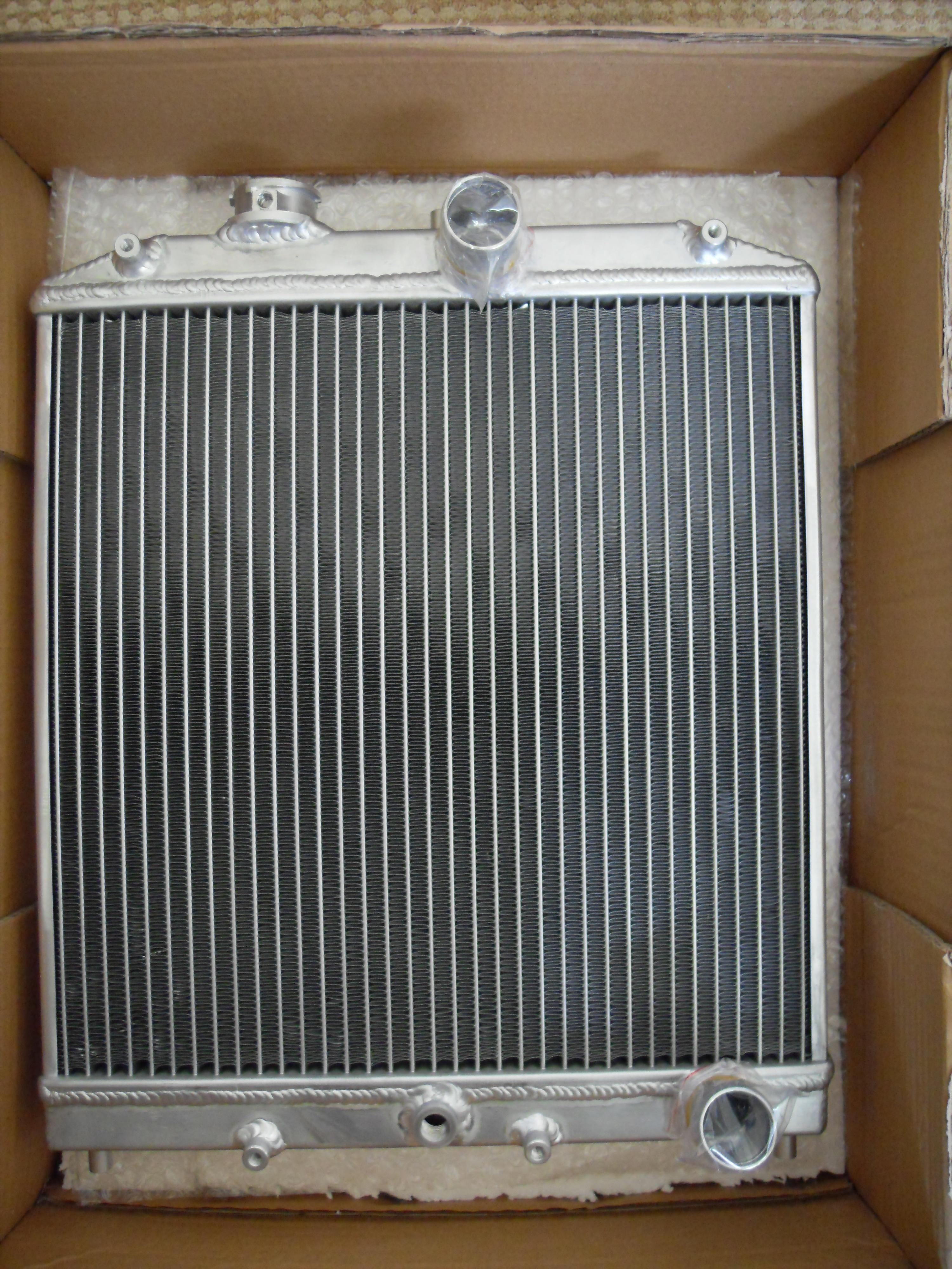

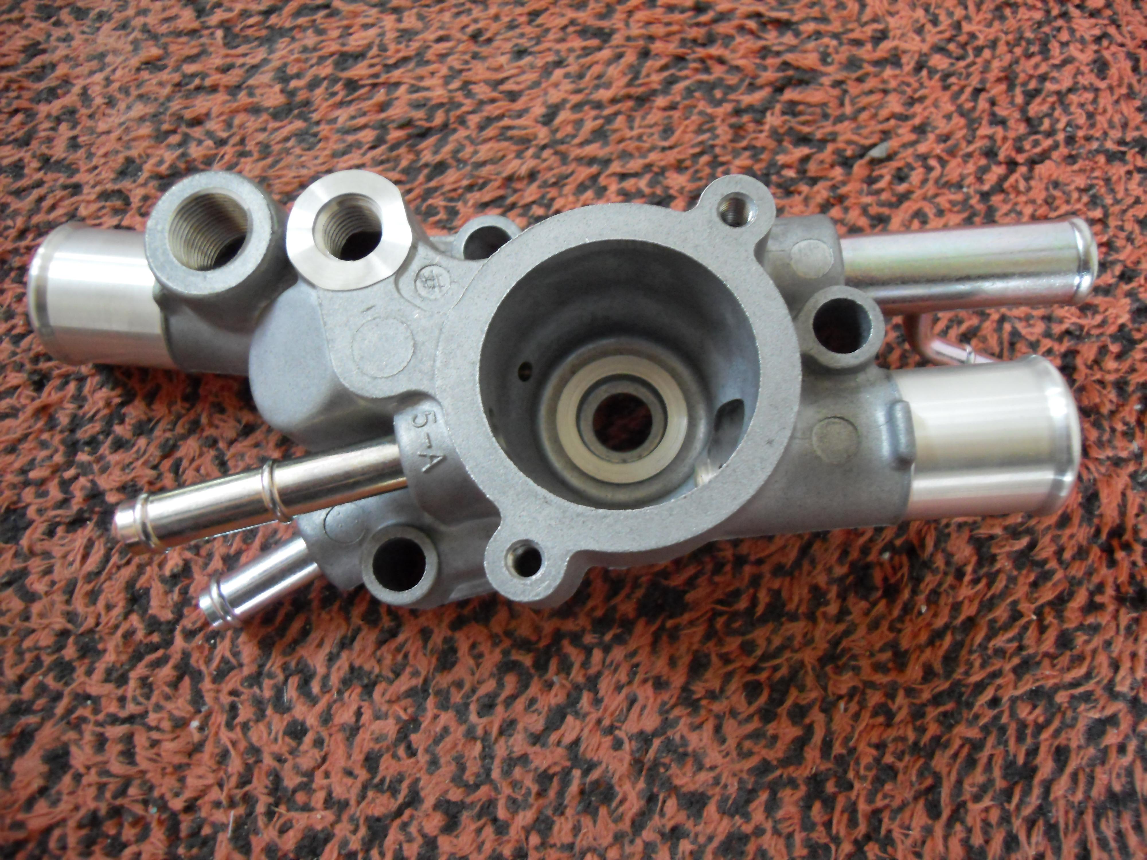

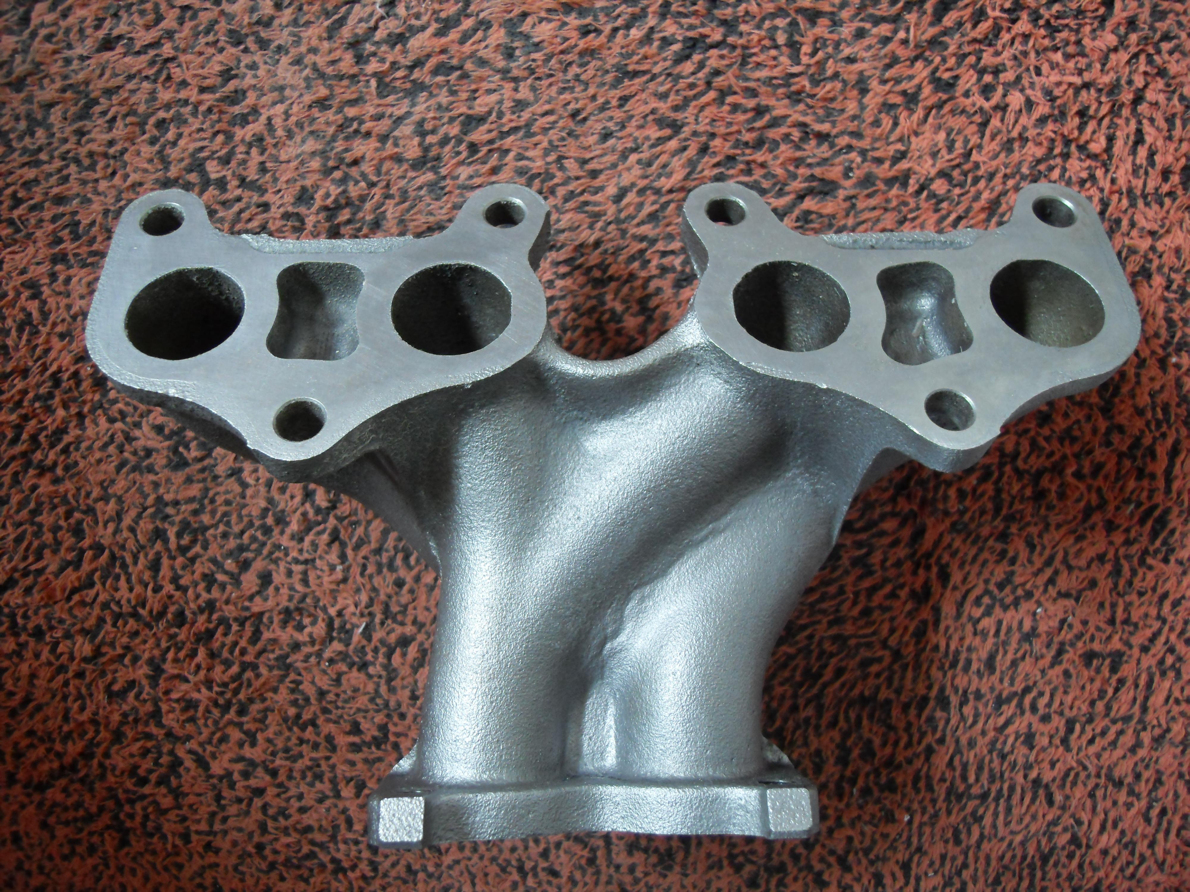

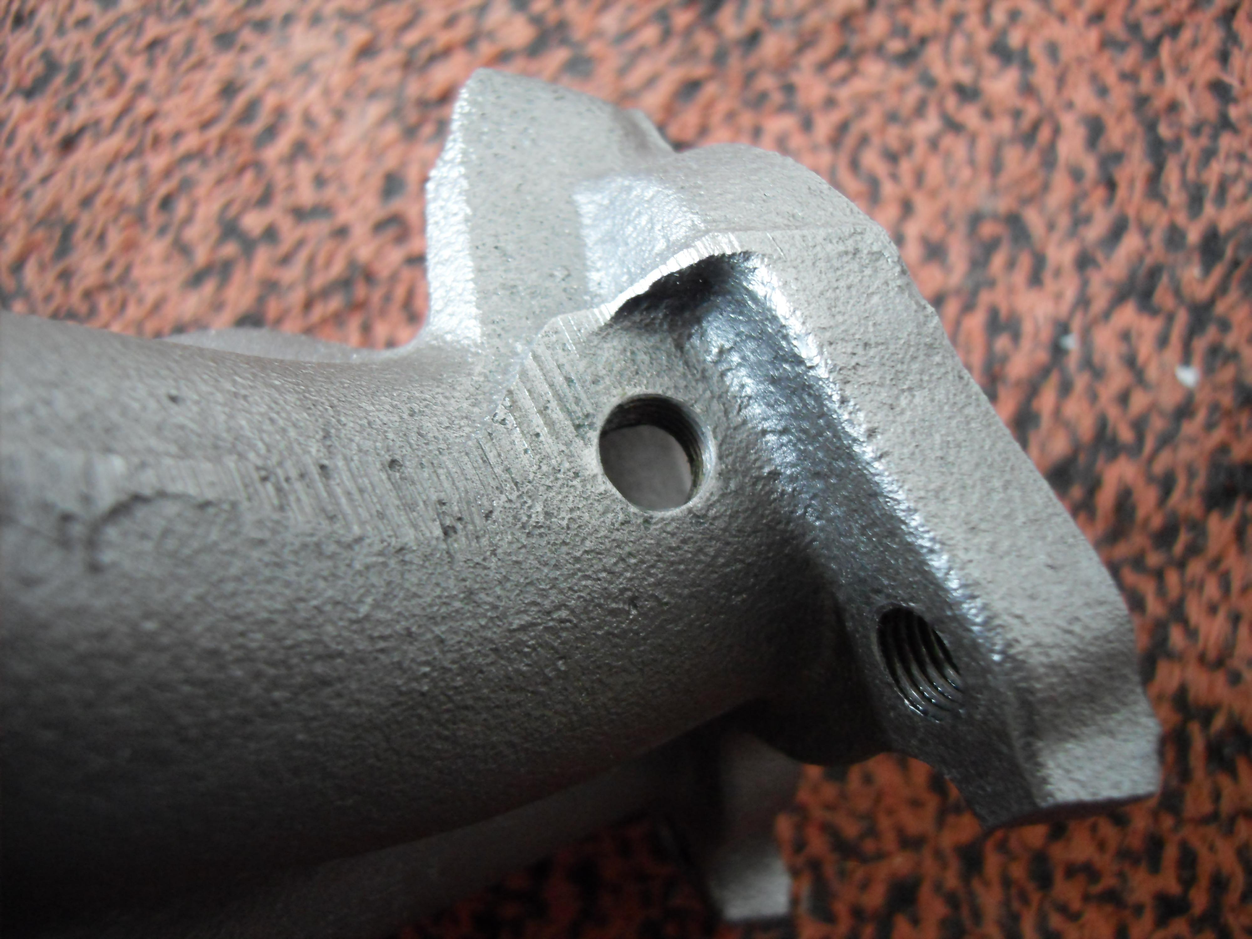

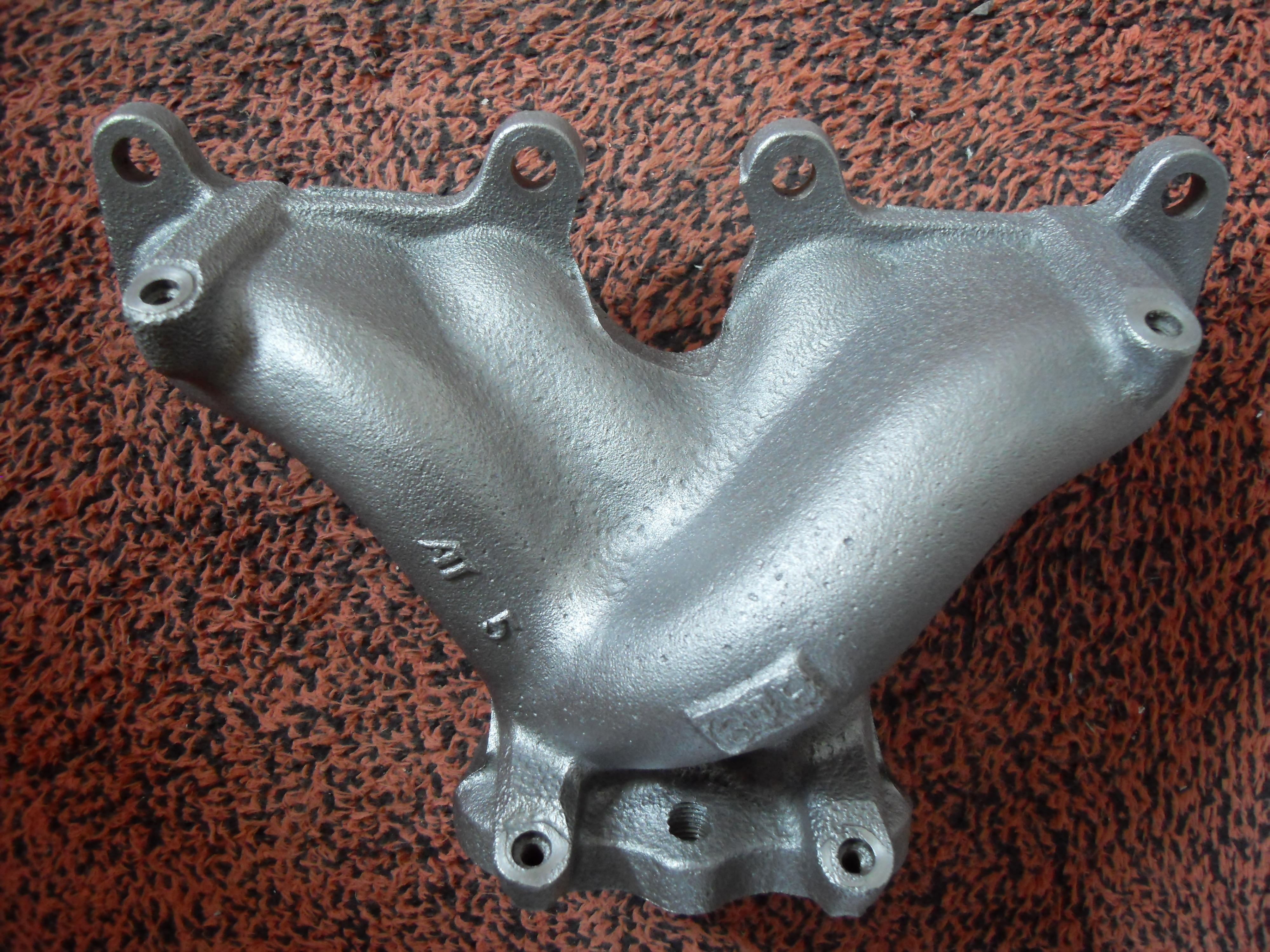

enzo_e492901 Posted August 1, 2011 Author Posted August 1, 2011 (edited) Now that I have ordered most of the parts I'm gonna need it's time for a little update on the parts I've already been collecting over the past few months. Chemically Cleaned Corolla 4-2-1 Exhaust Manifold. Threaded for E.G.T Gauge.  Painted Mocal Oil Cooler  Turbo Thermostst Housing (Used to supply water to the oil-to-water oil cooler using what would of been the turbo water lines)  Civic Half Size Radiator  1 of 3 Stack Carbon Gauge Pods  Glanza S Back Box (I didn't know they were made from stainless steel! Bonus!)  Restored Headlight Protectors  New Door, Boot and Window Seals and Weatherstrips  Corolla Gen 1 88HP ECU  More to come in a few weeks! Gavin Edited September 29, 2020 by enzo_e492901 Quote
