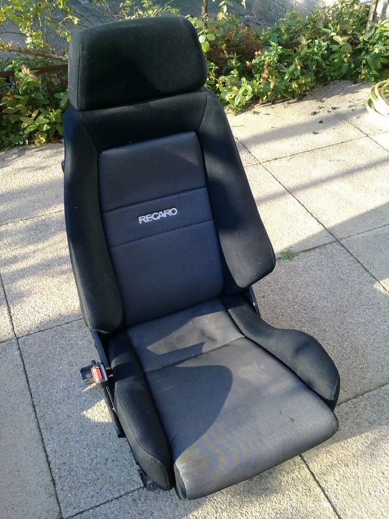

jezza Posted September 5, 2010 Author Posted September 5, 2010 Since getting the Honda SMX as a daily driver, I'm spending some time on the GT. Engine is almost out for some TLC.Will be changing the water pump, thermostat, timing belt, crank oil seals, engine mounts, exhaust mani and generally tidying up the bay and protecting from corrosion. I picked up a pair of these for added comfort. Need to figure out how to adapt/modify the gt rails in order to fit. They came out of a Proton Satria and have no rips or fag burns. Need a good clean but all in all, a bargain at £80 for the pair. Quote
bucketep91 Posted September 6, 2010 Posted September 6, 2010 looking good jezza! bargian indeed!i just sold some modified ep82 rails from my GT aswell:( Quote
jezza Posted September 6, 2010 Author Posted September 6, 2010 I noticed that. At least I know it's possible to modify them. Quote

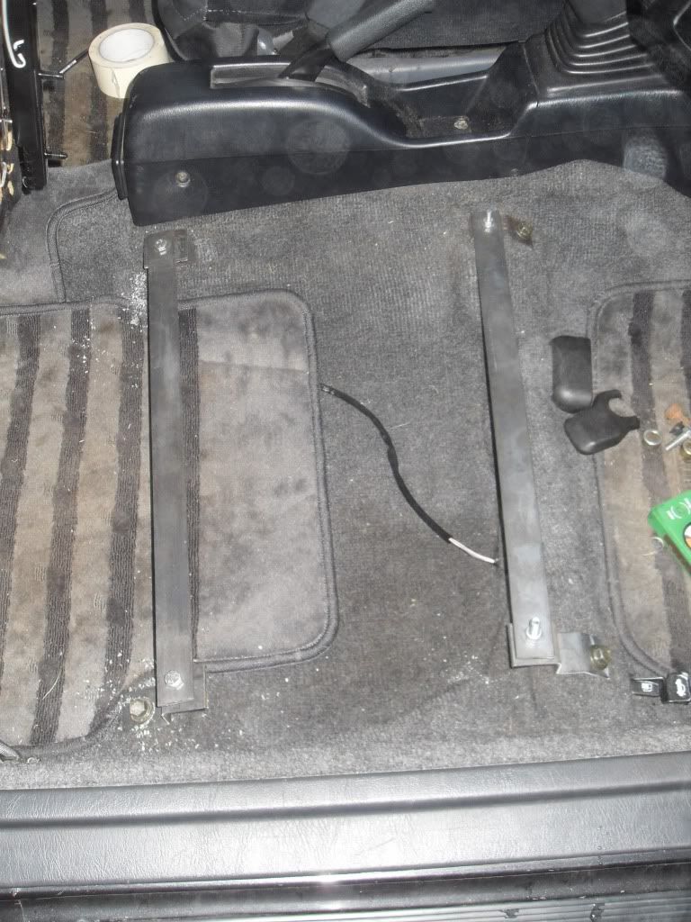

jezza Posted September 20, 2010 Author Posted September 20, 2010 I've stripped out the rear and painted the floor. Now in the process of making custom rails for the seats, relocating battery, rehanging radiator...the list keeps getting longer!A moment of inspiration lead me to paying a visit to metal supermarket to purchase 6 metres of 1.5" CDS tube to make a 5 point roll cage. I'm hoping to spend no more than £150 on materials so not too expensive. With the aid of my trusty manual hydraulic pipe bender I hope to get it right first time!Will be modelling the main roll hoop in CAD first to give me the best chance of getting the bends correct. Watch the space for photos! Quote

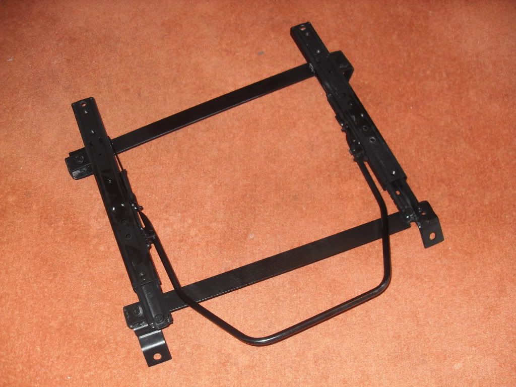

jezza Posted September 30, 2010 Author Posted September 30, 2010 Small update...The engine is out ready for some TLC.Parts arrived from camskills on Tuesday.Manifold and turbo gasketsThermostatWater pumpCrank oil sealsTiming belt kitEngine mount poly bushesDrop link poly bushesMade some progress with the seat rails. The drivers rail is preassembled in situ. Now need to tack weld the rails in position and remove to get fully welded. Then it's just a mirror image for the passenger rail.Spent a bit of time stripping the rear and painting the floor. Making way for the roll cage!Decided to relocate the battery so made up a bracket that utilises existing captive nuts. Need to splice into and extend the positive battery cable next. Should hopefully look neat and tidy when finished. Quote

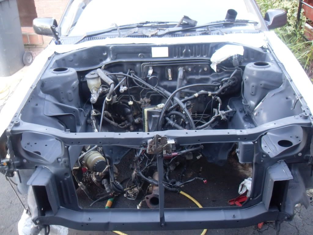

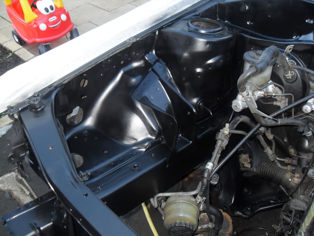

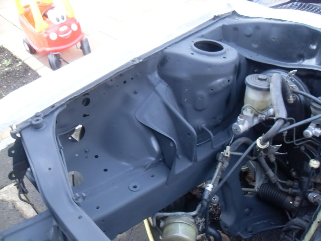

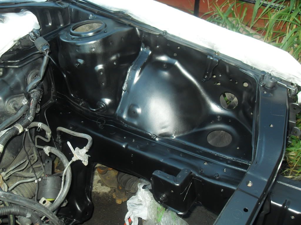

jezza Posted October 3, 2010 Author Posted October 3, 2010 More progress this weekend!Eventually finished the drivers seat rail and seat fittedAttacked the engine bay today.Removed the battery tray to clear some space. Going to make up a plate to bridge the engine mount bracket back to the chassis leg for added support. Started by removing everything from the front and sides, leaving the fire wall as it was. Clean, scotch pad, degrease, body schutz then gloss black. Happy with how it turned out!Good days work Quote

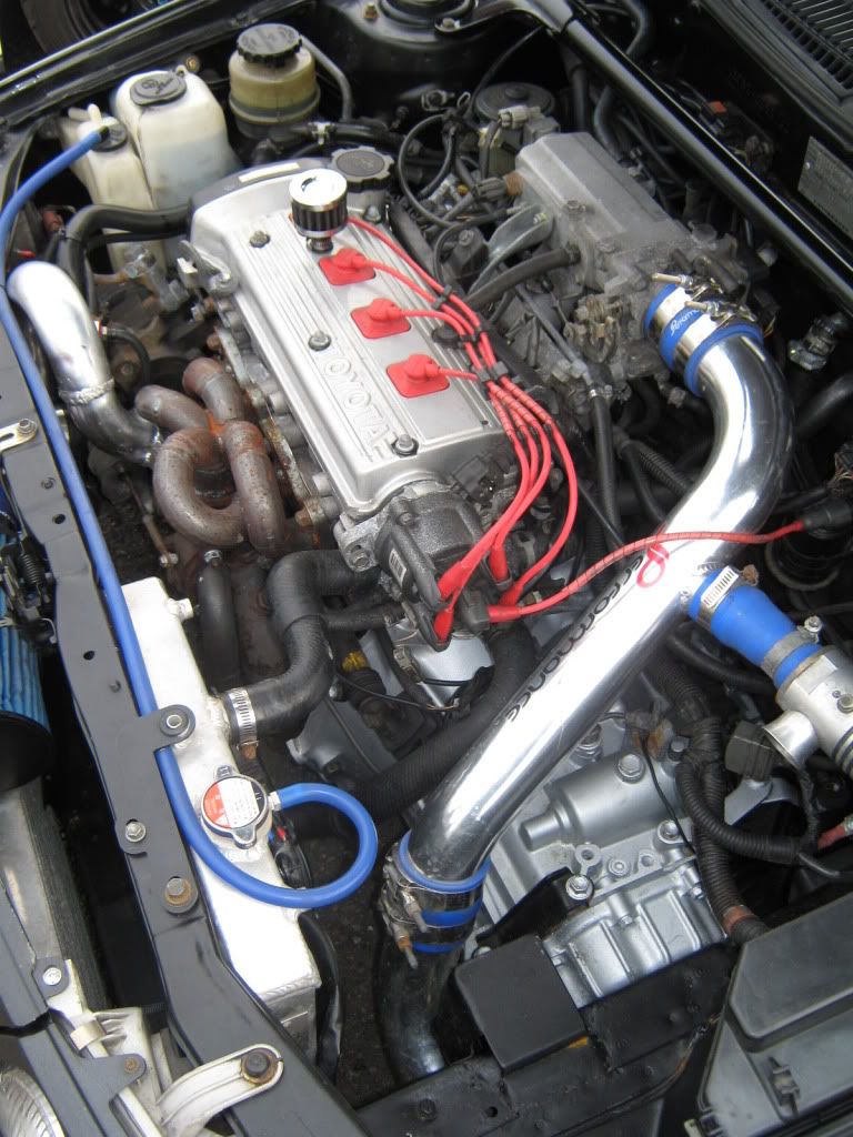

jezza Posted November 18, 2010 Author Posted November 18, 2010 Back on the road again and boosting strong. Still a few niggles to sort out but glad its back up and running.Few snaps of the bay: Quote
micky boy Posted November 18, 2010 Posted November 18, 2010 Looking good jezza i see you have got the new minifold on How's it copeing? also did you have to trim abit of the intercooler pipe on the hot side, the bit that bolts to the turbo just it looks abit close to the manifold? Quote
jezza Posted November 18, 2010 Author Posted November 18, 2010 the mani is coping well. Runner 2 is too low meaning i had to rotate the turbo and mod the hot pipe to fit. Not ideal but will be corrected on any production manifolds. Quote
micky boy Posted November 18, 2010 Posted November 18, 2010 Sweet i had the same problem on my zisco mani believe or not, keith made runner 2 abit to low so i had to trim abit of the intercooler pipe to allow it to sit flush on the turbo.. Quote
