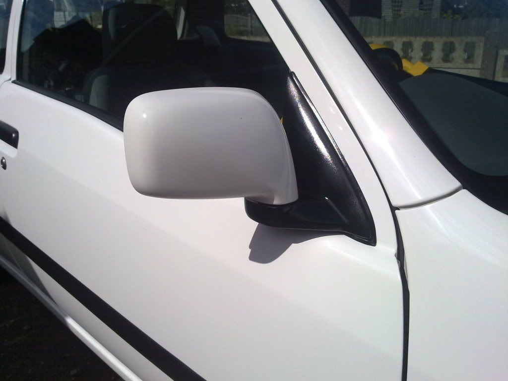

ali_legend Posted November 24, 2010 Posted November 24, 2010 Thinking off painting my side mirrors and door handles myself. whats the best way to do this on a very low budget.? Quote
Josh@TunerLifestyle Posted November 24, 2010 Posted November 24, 2010 id also like to know how do they come off? i need to paint mine Quote
Amjad Posted November 24, 2010 Posted November 24, 2010 Take the inner trim off, the bolts, BOOM Ali, just sand them down lightly with fine/extra fine grit wet and dry, degrease, few coats primer, few coats main paint colour, optional lacquer coats and you're done! Satin Black looks good IMO Quote
ryan lang Posted November 24, 2010 Posted November 24, 2010 josh, how did you manage to carbon wrap yours, without taking the platic bit on the inside off, surely you took it off?should be 3 bolts behind it and wham! mirrors off Quote
drongo boi Posted November 24, 2010 Posted November 24, 2010 amjads right satin black ftw my wing mirror bases were painted satin black and liqured Quote
ali_legend Posted November 24, 2010 Author Posted November 24, 2010 You reckon satin black base ad white side mirror. ? Tbh if i did it id just do white all over. Gunna have a go maself cuz been qouted bwt £130ish for it. F**k that Quote
Amjad Posted November 24, 2010 Posted November 24, 2010 You could do it for £15!I reckon all white looks a bit tacky, the black breaks it up a bit! Quote
drongo boi Posted November 24, 2010 Posted November 24, 2010 yeh get it done i did mine myself lol wernt 2 hard just primer the hole think, cover the base up n spray the mirror white, thn cover the mirror and spray the base, thn laquer the hole thing only cost me like 20 25 quid lol all halfords paiint lol Quote
Tyron Devine Posted November 24, 2010 Posted November 24, 2010 Make sure you get your lines correct with the masking paper nothing worse than a tacky job also preparation is the key Quote

drongo boi Posted November 24, 2010 Posted November 24, 2010 this is what forums are all about pal helpig eachother n making friends n im sure there are just 2 nuts behind it loland just spray it as sai above lol Quote
