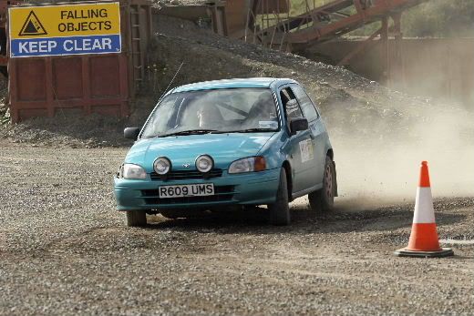

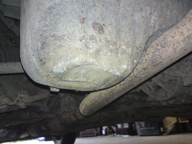

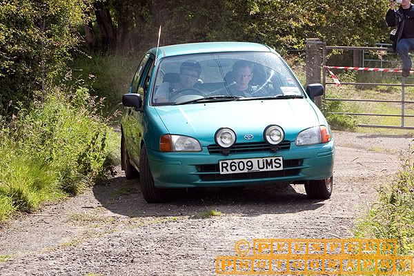

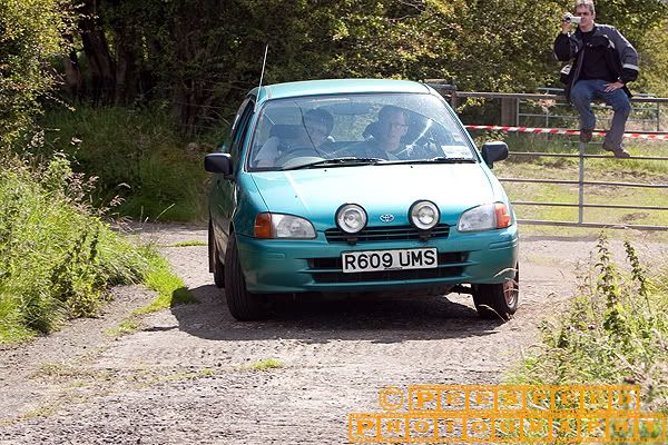

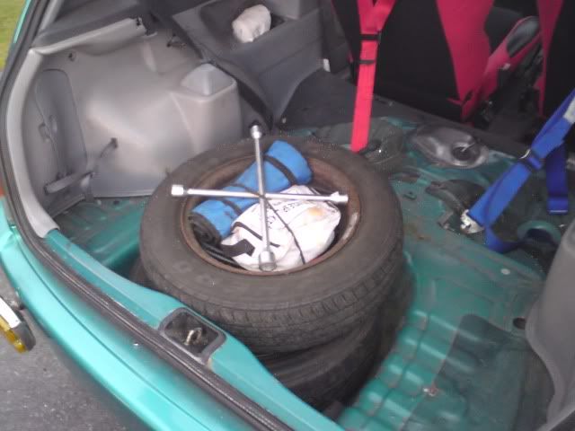

navrallystarlet Posted August 22, 2011 Author Posted August 22, 2011 I think this is due an update. Okay so we have competed in two more lanes rallies since the last update. the Springfling and the Summer Lanes. I have some in-car footage from the Springfling so I'll get it uploaded at some point. Heres a few photos from the Summer Lanes event though.The sump just about survived, so a guard is next on the to do list.The link below is a video from the event. We feature in it at about 6.27 Modification wise, there has been a few changes.....new tripmeter with remote zero unit and shrowdFly off handbrake with custom wooden block Also fitted a set of reclining bucketsRigged up a way to carry two sparesAnd removed the bump strips on both sides and the "toyota" and "Starlet" stickers from the tailgateThats about it. She's still going strong and is booked in for MOT in coming weeks and doesn't need anything for it.......yet. Fingers crossed Quote

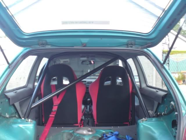

navrallystarlet Posted September 10, 2011 Author Posted September 10, 2011 Rear cage now in. Will get pictures up tomorrow. Quote

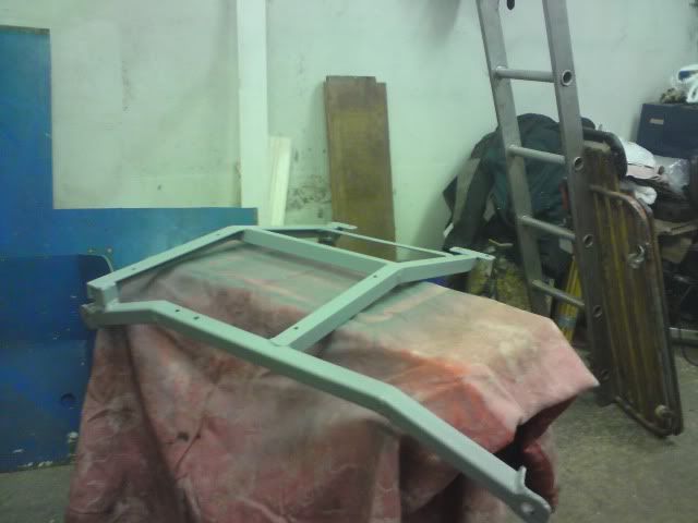

navrallystarlet Posted September 11, 2011 Author Posted September 11, 2011 Update. So I stripped more of the rear trim out to allow access to the rear arches. then drove her 70miles up the road to a mate who fitted a rear cage. Collected her on Thursday night past only to find the hoop was quite close to my head as I drove it home. So I spent yesterday making a new seat subframe for the drivers side. The original one that came on the buckets was made with 10mm think mild steel. Totally unnecessary. I built a lighter frame and took the opportunity to lower the seating position about an inch to give more head clearance. Managed to get it fabricated, painted and fitted yesterday. Also removed the front seat belts to save a bit of weight now that they are surplus to requirements. Also removed rear wiper and motor.We have an event in two weeks, so just have to get a sump guard sorted and we will be sorted. Photos....The original bruteToken MOT shot....Had her out at a local quarry last night just to check the handbrake still worked. Didn't look too dirty in the dark, but woke up to this, this morning... Quote

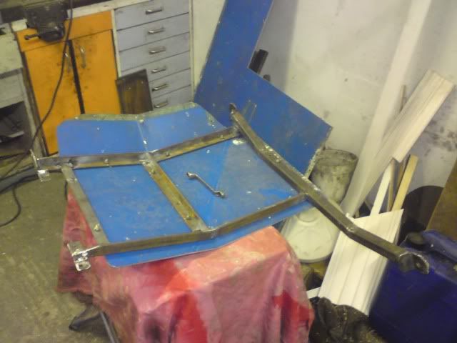

navrallystarlet Posted September 14, 2011 Author Posted September 14, 2011 Spent last 2 days making a sump guard. Problem with these cars is the front pipe hangs low and there is no great place for mounting it at the back. But we took some inspiration from the Paseo Rally car build on here and used a similar design/method. It was an awkward job with a lot of guess work and welding in place under the car, but another job down. Pictures speak louder than words.Now thinking of a possible change of colour for the wheels. Our metallic bronze turned out rather brown, so looking something non metallic and....well....in your face. Red? Quote
