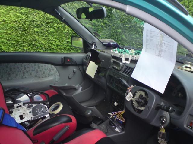

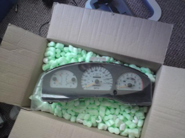

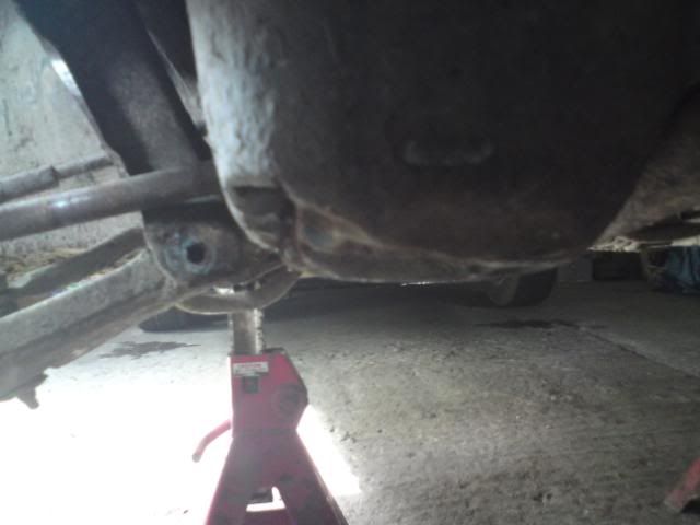

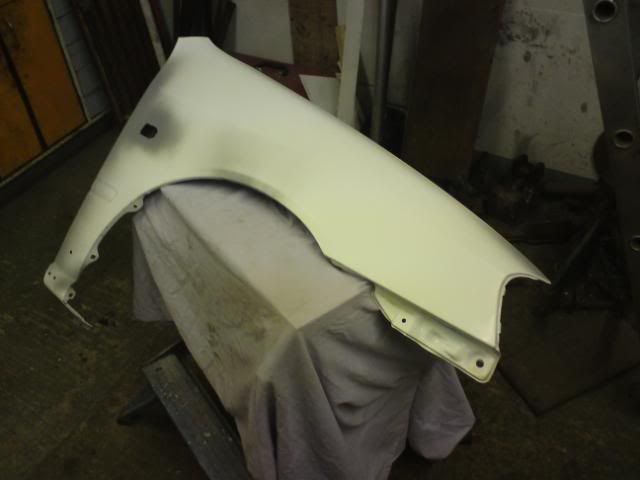

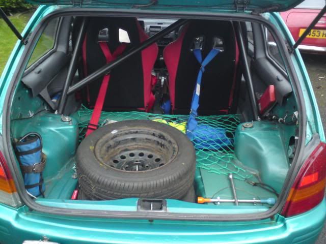

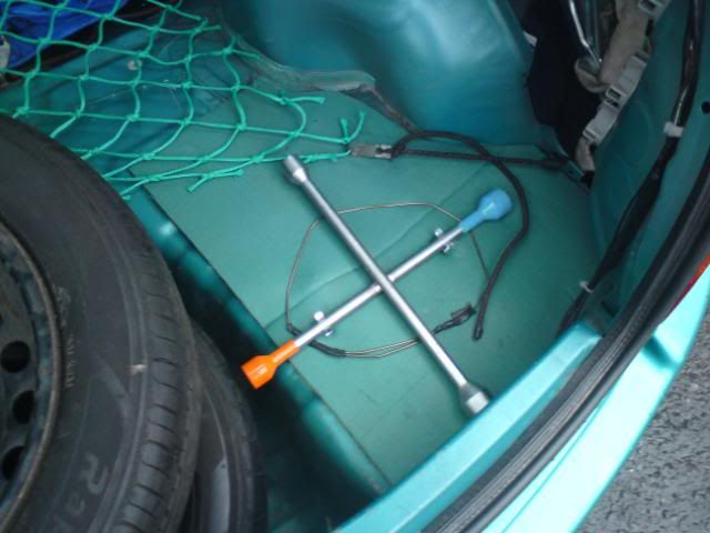

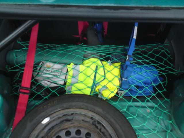

navrallystarlet Posted October 18, 2011 Author Posted October 18, 2011 Just to keep this up to date. I have a few photos of how we tidied up the rear for storage, a few of the damage to the sump (can't believe its not leaking) and few photos of the new wing and glanza clocks.Just a wee note, regarding the dials I read on here that you cannot swap the trip from a sportif to a glanza. You can, it fiddily work but its far handier than winding the clocks back or forth. Quote
Billy SR Posted October 18, 2011 Posted October 18, 2011 my sump is in the same state all for doing a good deed and pulling up onto a kerb because an ambulance was behind me Quote

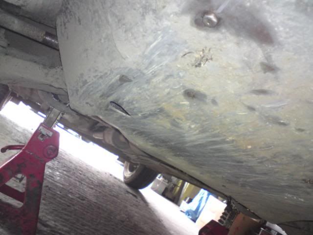

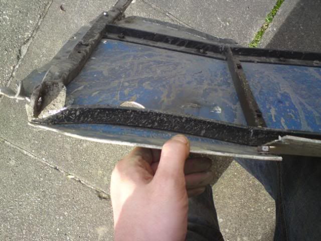

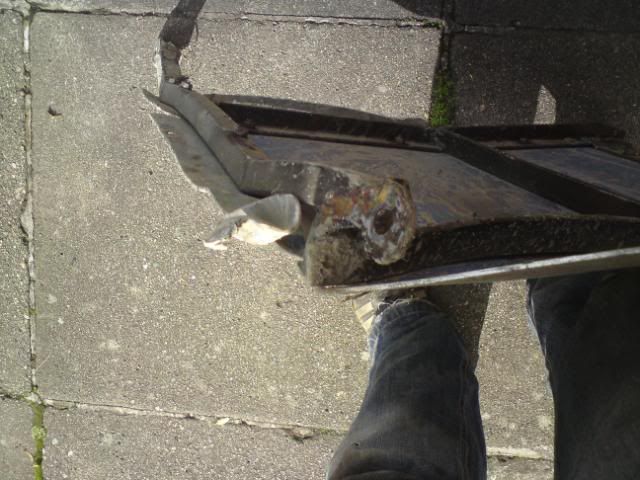

navrallystarlet Posted October 18, 2011 Author Posted October 18, 2011 my sump is in the same state all for doing a good deed and pulling up onto a kerb because an ambulance was behind meNot good. We had a fairly substantial sump guard on. I'll have to throw some photos of it up. Its totally wrecked. Thinking cap is now on to come up with something stronger but no heavier. Quote
navrallystarlet Posted October 18, 2011 Author Posted October 18, 2011 Damage to sump guard....Sad to see something we spent so much time on in flitters but still glad it was there in the first place or we could have been a lot worse off!!! Quote

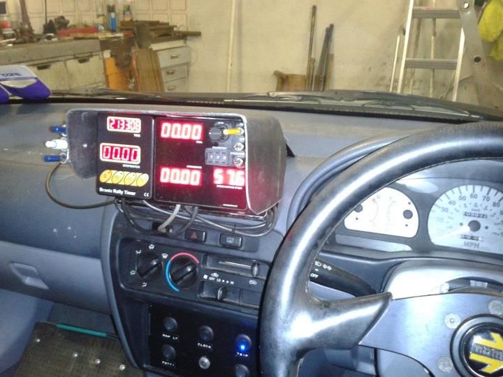

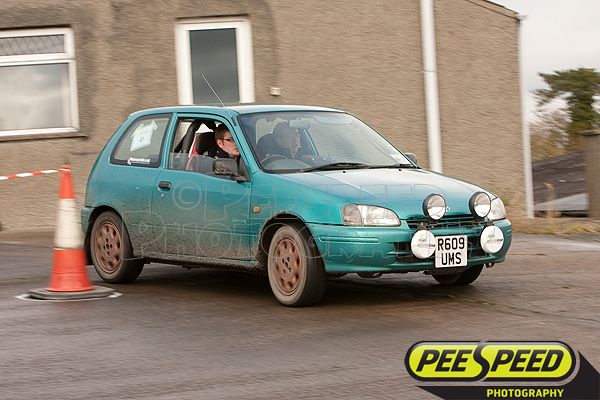

aquascrotum Posted August 6, 2012 Posted August 6, 2012 (edited) Quick update...the Starlet is still going strong despite all efforts to break it. Couple of recent photos....Nice new trip and countdown timer / stopwatch timing gear with shroud...Trying really quite hard here!New quad-lamp setup on the front - like staring into the sun when she lights up!We're about to spend a few more quid on the car with some upgrades (like decent tyres, shock horror - at the minute we're running tyres and rims we got off a 20yr old Cavalier found in a barn ) - have posted a Wanted ad in the Classifieds, at http://www.ukstarletclub.com/forums/index.php?showtopic=55710. Basically the intention isSome decent Yoko A021Rs for the frontLooking into Eibach or similar adjustable camber bolts on the front, as well as the adjustable camber top-mount setup for the front strutsPolybush all roundWhiteline ARB for the rearPossibly a rear strut brace (though with the cage in she's stiff as already in the back)Hydraulic handbrake Maybe a short-shifter - might not suit with the hydraulic handbrake though, will have to see what room is left on the transmission tunnel.Also, does anyone know if GT Turbo shocks are stiffer than standard EP91 N/A, and if so would OEM parts fit our car? Edited August 10, 2012 by aquascrotum Quote

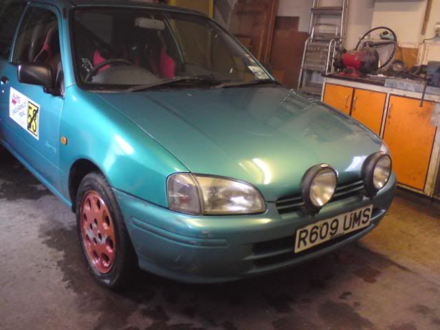

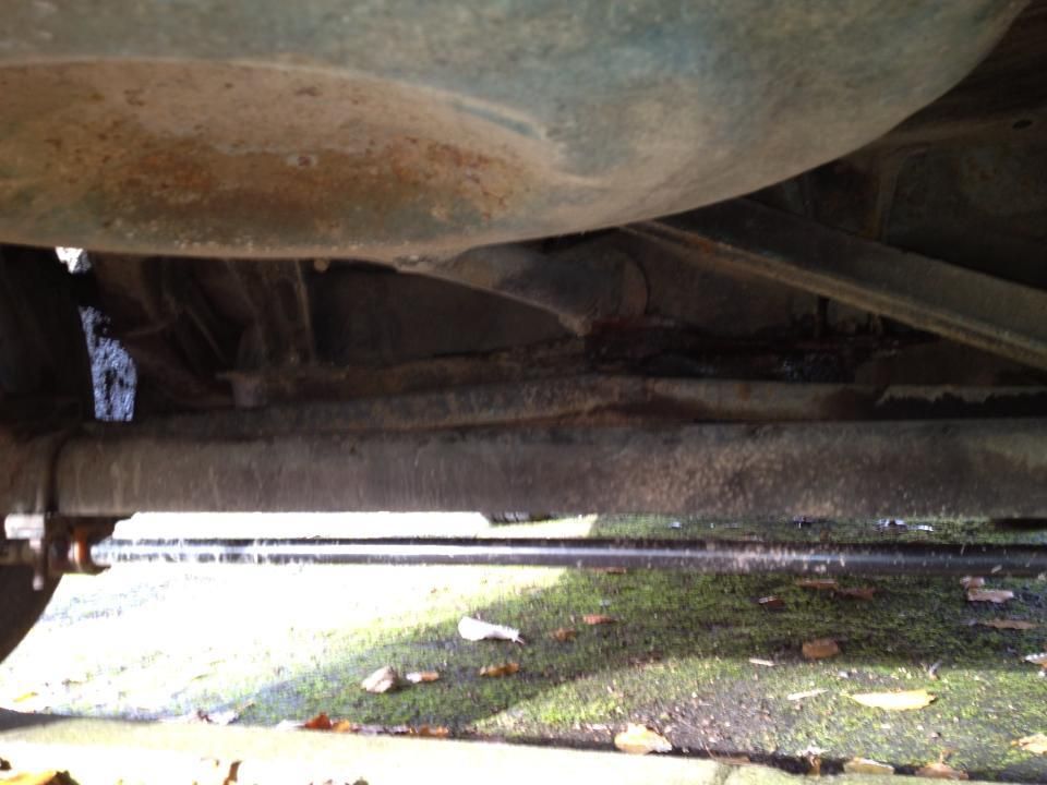

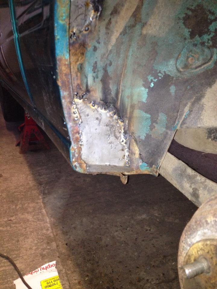

navrallystarlet Posted November 12, 2012 Author Posted November 12, 2012 (edited) So an update. After a bit to work to get through MOT (huge hole in the rear n/s arch), we entered our first night navigation in just under a year. It was tight goin at times, trying to get into the swing of keeping regularity again. And we had alot of braking and understeer issues with cheap tyres on the front but we managed a class win.Then I had her out on Saturday past for a lanes event. Some great stages, had a rather close moment with a set of tyres. It was taking me a while to get used to the car being more tail happy as we now have a rear arb fitted and its hardest setting. So the times I was setting weren't great but about half way through we were in a stage in a car park and everything was going so nicely, hitting every apex, very little wheel spin and controlling the slides, UNTILL.......I slid sideways straight into a kerb. That was us out. I managed to shift the axle across to the right by about 3inches, bending the panhard rod which in turn pierced our petrol tank.As always, photos...MOT PrepThe RallyThe Damage Edited November 14, 2012 by navrallystarlet Quote
