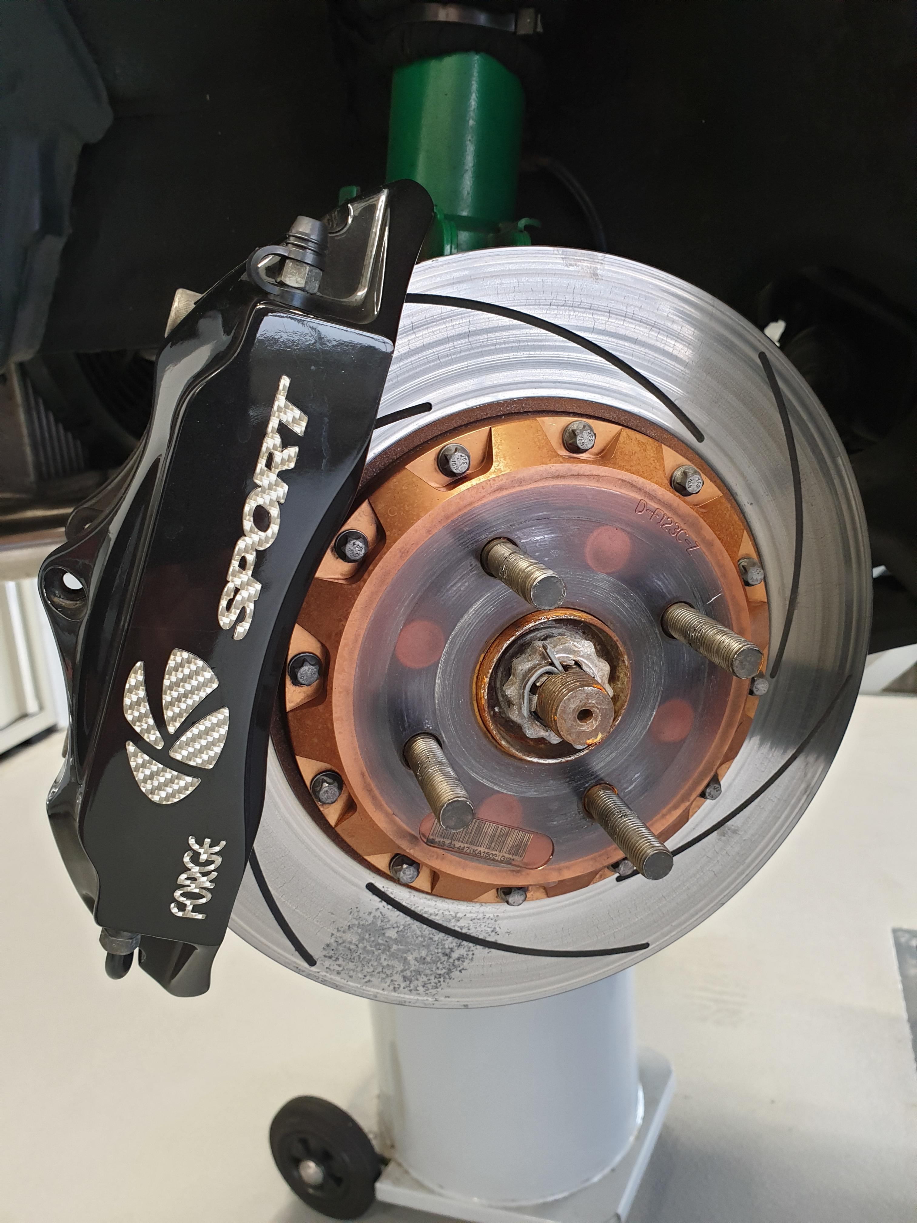

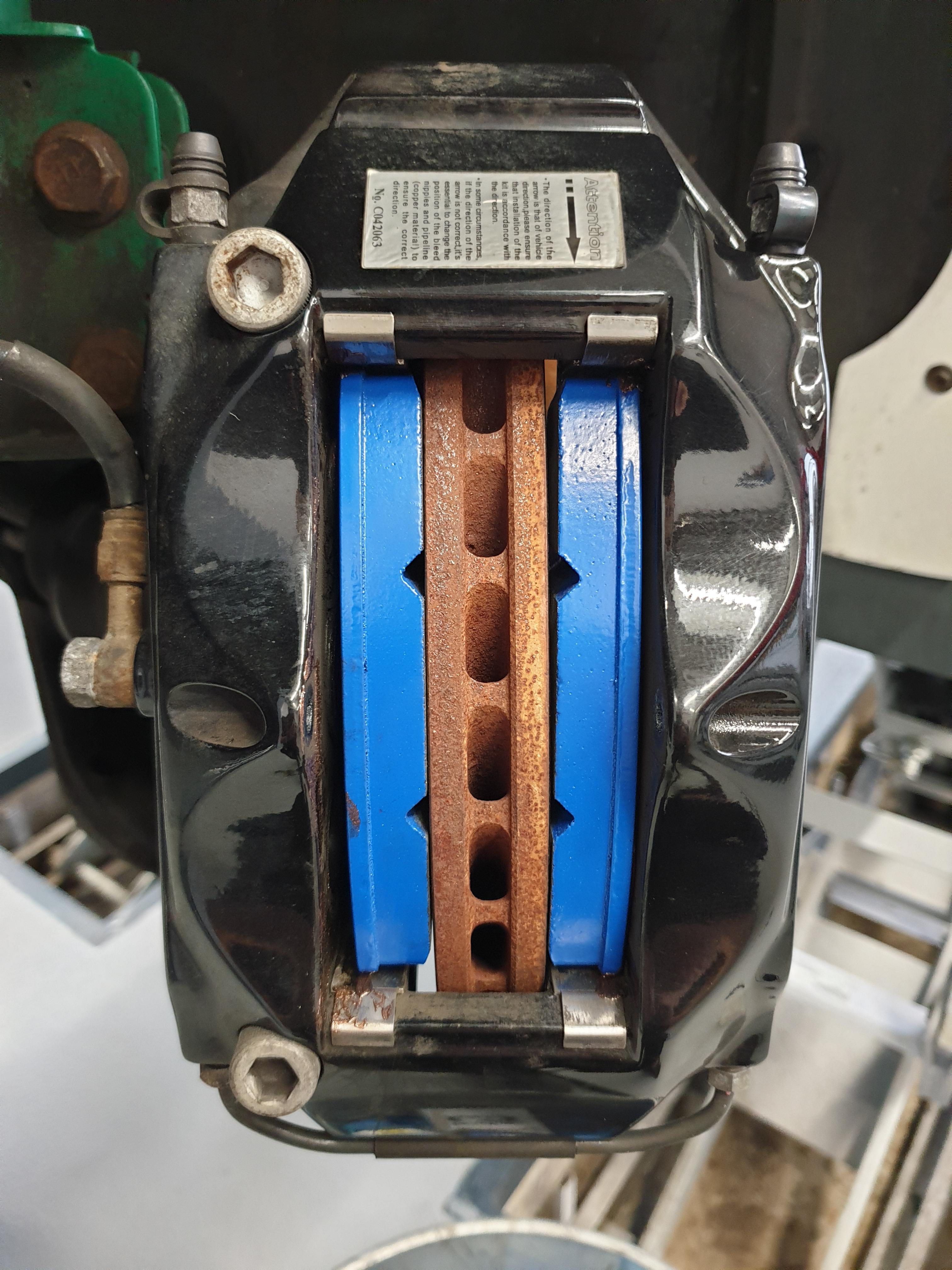

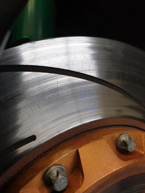

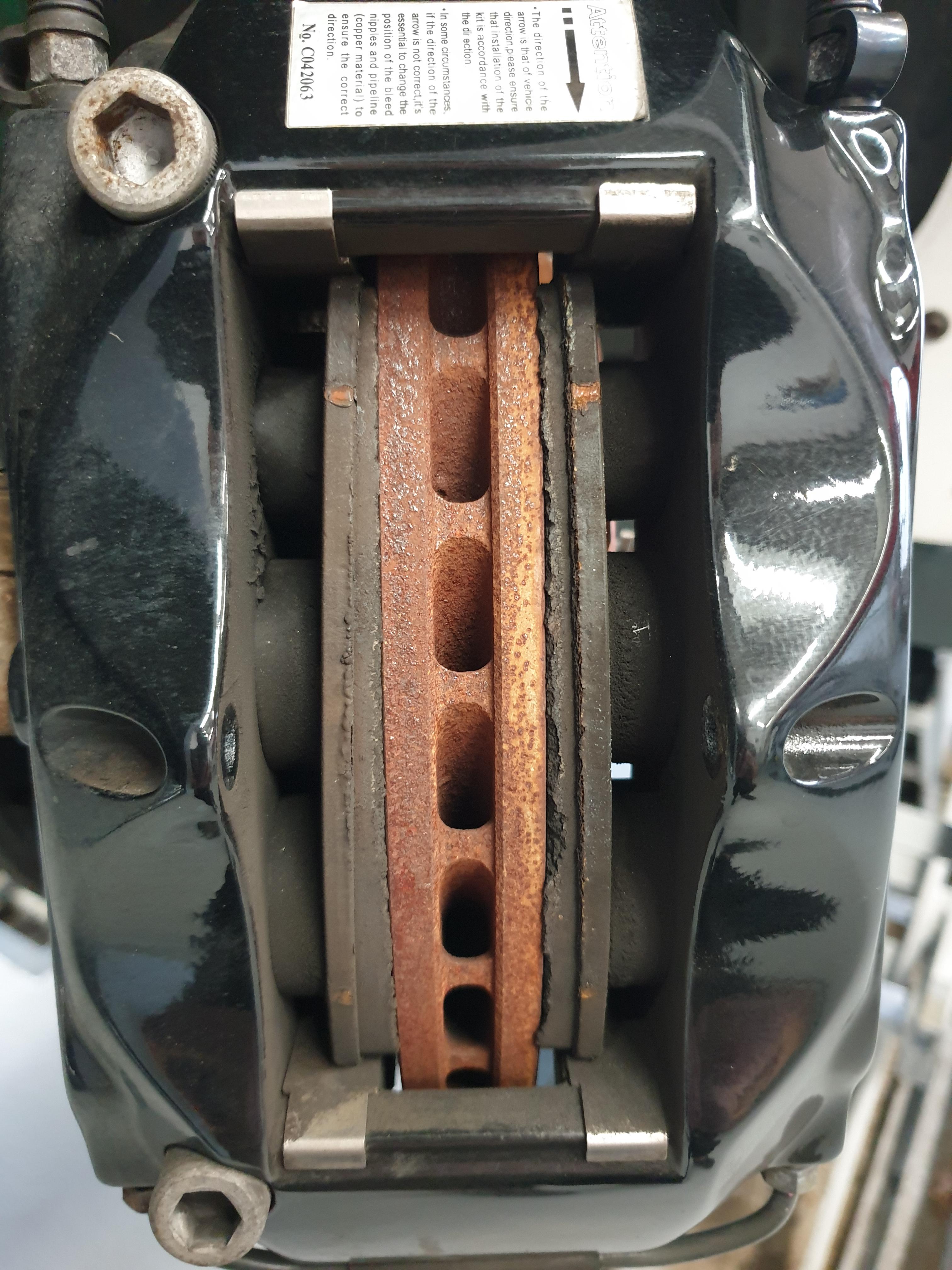

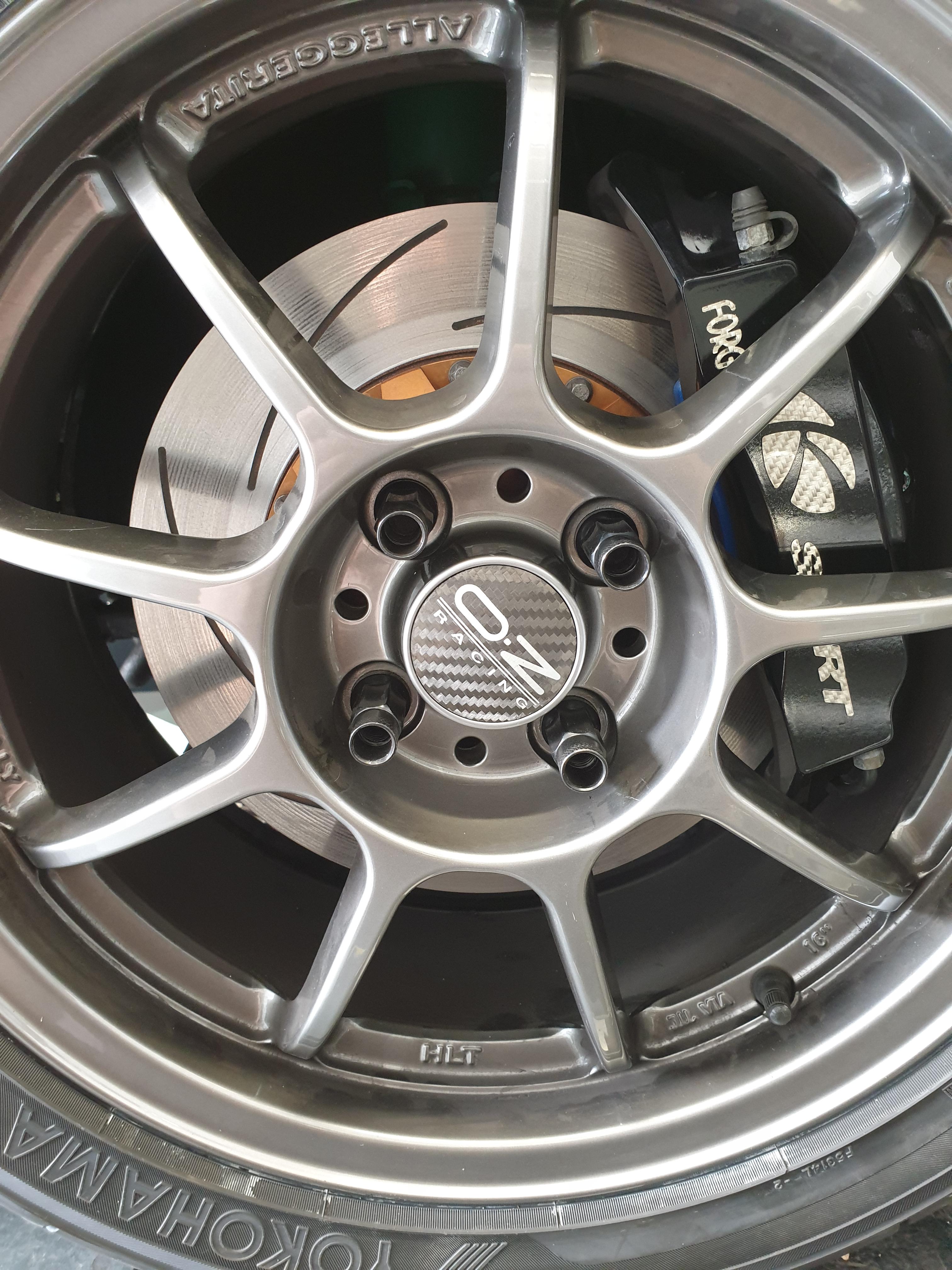

Dave D Glanza V Posted August 15, 2020 Author Share Posted August 15, 2020 Small update after getting more into trackdays last year and hitting up the donnington gp circuit, Silverstone gp, spa gp and a few laps of the ring my ksports were in bad need of a refresh, light heat marks all over the discs and pads completely gone, went for ebc blue stuff pads, gave the brake discs a go over with a on car brake disc lathe (never seen these before video is mesmerising) cleaned up the rear discs and fitted some ebc pads with new rbf 660 brake fluid throughout. I think I'm going to have to add in some brake ducts as I'm obviously way too hard on them, have already gone up a wheel size to try and help cool them slighy, had considered a brake bias valve so that the rears are slightly more involved too, going to send off some spare rear calipers to be refurbished and painted a similar colour to the ksports next also add similar looking grooved rear discs, pics to follow. Quote Link to post Share on other sites

Sam44 Posted August 15, 2020 Share Posted August 15, 2020 (edited) Minor heat cracks Looking good. Nice stoping power there what size are them discs. Edited August 15, 2020 by Sam44 Quote Link to post Share on other sites
akyakapotter Posted August 15, 2020 Share Posted August 15, 2020 To help with the heat was it....... Where have the cool wheels gone ? Oh wait they don't fit now do they haha 😂 Quote Link to post Share on other sites
Dave D Glanza V Posted August 16, 2020 Author Share Posted August 16, 2020 On 8/15/2020 at 9:51 AM, Sam44 said: Minor heat cracks Looking good. Nice stoping power there what size are them discs. Thanks, 286mm I believe On 8/15/2020 at 10:14 AM, akyakapotter said: To help with the heat was it....... Where have the cool wheels gone ? Oh wait they don't fit now do they haha 😂 hey these wheels are cool too 😅 Quote Link to post Share on other sites
