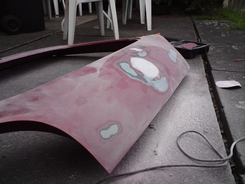

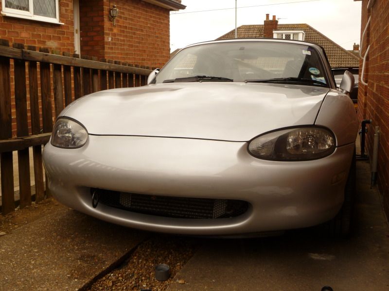

aaddzz123 Posted October 12, 2011 Posted October 12, 2011 Well painting is a bit of a growing passion of mine. I orginally started on my first car when I colour coded the door handles. |Come a long way since then! Just thought I'd share some of my jobs with everyone and see what everyone else has been doin .I'm gonna start with a bumper fill and respray that I did for my mate's mx5 over the weekend. He had attempted to do it himself previously and left holes in the bumper, covered by a clowdy paint match lol! I took all the paint down and refilled the holes, got rid of all the imperfections using filler primer and eventually finished it with a layer of clearcoat.I did the whole respray with rattle cans bar the clearcoat which I used a compressor and spray gun as it needs to be mixed.Pictures ;)How it used to look after his first fill and spray attempt Safety first when using 2 pack paints!And finished Big loves Quote
Amjad Posted October 12, 2011 Posted October 12, 2011 Now that's a nice job! Can it withstand jet wash? Quote
aaddzz123 Posted October 12, 2011 Author Posted October 12, 2011 Now that's a nice job! Can it withstand jet wash?Cheers mate Yep! I have no doubt at all that it will withstand jetwash and 95% of stones that'll hit it. Seal the edges propperly, use 2 pack clearcoat (a clear coat and a hardener) again making sure you're covered all the edges, bake it with some kind of make shift source lol and it should last at least a couple of years before it may need touching up ;) Quote

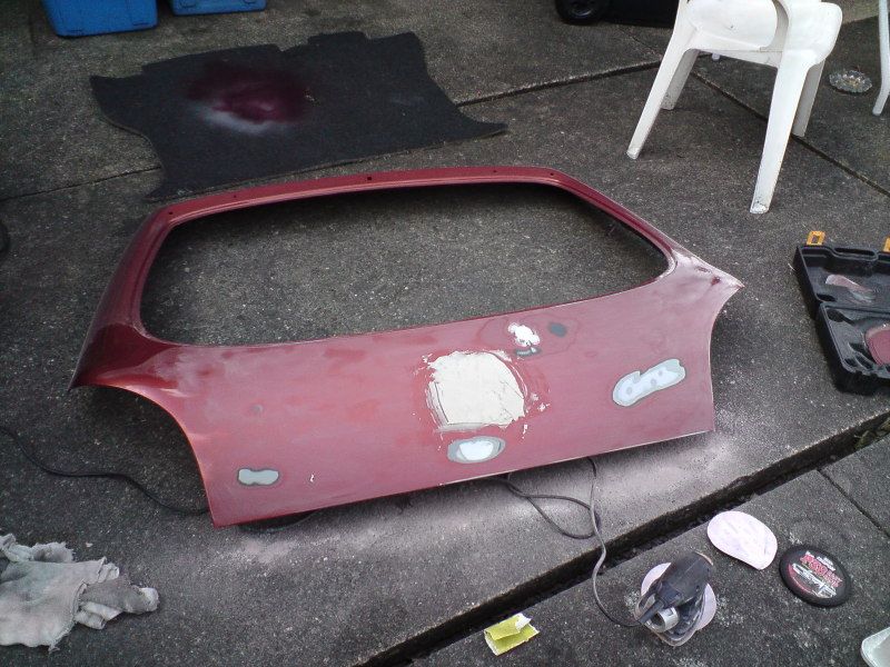

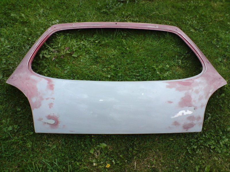

aaddzz123 Posted October 13, 2011 Author Posted October 13, 2011 Just thought I'd add another job that I've just found on my computer lol.I used to have a fiesta that cost me £140 lol, I stripped it out and put a 1.7 puma engine in it and eventually tried to make it look better on the outside and ended up fitting a ZS kit and smoothing a bootlid off. Some pictures ...Anyone else got any jobs? lol Quote
