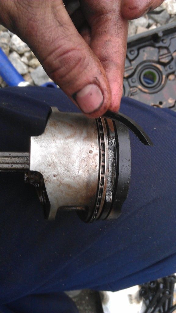

Taggy Posted March 20, 2012 Posted March 20, 2012 Was off work today after coming back from a stag party on the weekend, so thought i would crack on repairing my car to get it ready for japfest. I was getting excessive air/oil coming out my top breather and a scooby kinda engine note aside from this the car ran the same. But i was advised a cracked ringland was probably at fault by socks so told me to sort it asap.So thats what i did today : I estimated it would take about 4 hours, and did it in 3:30 but i was really methodical and took my time, especially with the parts.Here is the first video i posted in case you missed it of the symptoms[media]http://youtu.be/87J3eKxsE_wJust pulled the head off and checked the valves and bore[media]http://youtu.be/g32z_Y1ZS7QPulling the piston out and inspecting it for the first time[media]http://youtu.be/Gdk4A7ryi-kOnce i took the rings off a big chunk fell off!What do you think i should do now in terms of repair, i dont want to spend shit loads on this engine as im building a 5e in addition to this engine, but i do need to fix it to use until the end of the track season 2012, i was wondering what people do when they do a repair on one of these faults. Do i just buy a new piston, head gasket and head bolts and put it back together, or should i also change the rings while i have them off, or should i replace all 4 pistons?What is the recomended practice for a repair such as this, I want it to be reliable but at the same time dont want to spend an arm and a leg as ultimately the 5e will go in come end of the track season.Another thing what the hell has caused this, my car definetly wasnt detonating, so i am a bit confused, maybe age? Quote

Taggy Posted March 20, 2012 Author Posted March 20, 2012 Ai good advice, i was thinking the same, gonna pull the other 3 out anyway as the piston rings come in packs of 4 so they have to come out either way. I'll visually check them for any hairline cracks and if they are good ill pop them back in with new rings and a charitable donation of a piston I suspect the problems i have been having over the past month with boost spiking due to a faulty actuator are to blame, i was seeing peaks of 1.5 bar a few times not good! probably stressed the piston ringland and popped it..I can see why people put forged ones in now, the ringland is a really weak section of the piston as its such a thin bit of metal.Oh well this has been a good education lesson at least for my forged build Id go with james's sugestion tagman. is exactly what id do in your position. i wouldnt replace the others but saying that id probably dropem just to see how they look. nothing worse than doing the same job sevral times over. Quote

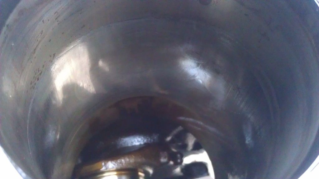

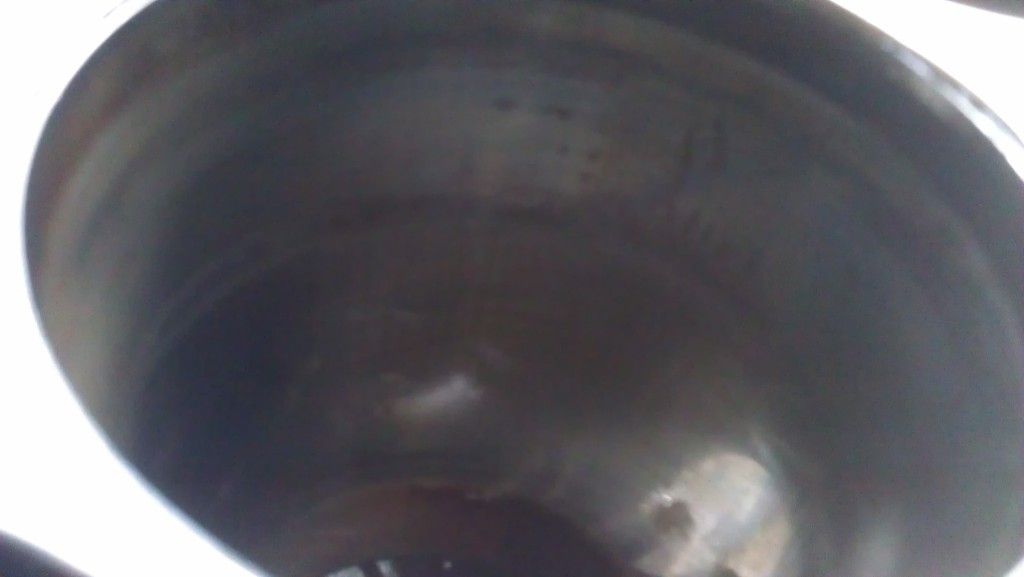

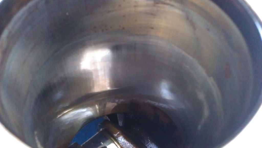

Taggy Posted March 21, 2012 Author Posted March 21, 2012 Ah fuck the sage continues, i dropped the other 3 pistons out today and i have found another ringland fucked on number 2. So thats two screwed pistons.And although the ringland hasnt scored the barrel, i have found an unrelated problem with the bore, its worn really werid on the top quarter of the cylinder and it has a made a 360 degree ridge which you can catch your finger nail on, its hardly anything but it now HAS to be honed to get rid of it, what the hell has caused that, take a look.Another fooked pistonThe bore has worn really weird on no.2,any ideas, it goes all around the entire piston and its slightly ridged. Quote
Flaminsam Posted March 21, 2012 Posted March 21, 2012 `yea that comes for age. basically the rings are a kind of spring steel. they are putting constant pressure on the wall of the cylinder causing the wear. usually if its only at the top you can use a tool called a ridge reamer. that should square the bore back up. a rebore is probably the only way forward with this if you want it to last. why not use this excuse to get the 5e built up and just slap that in Quote
