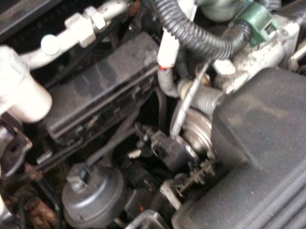

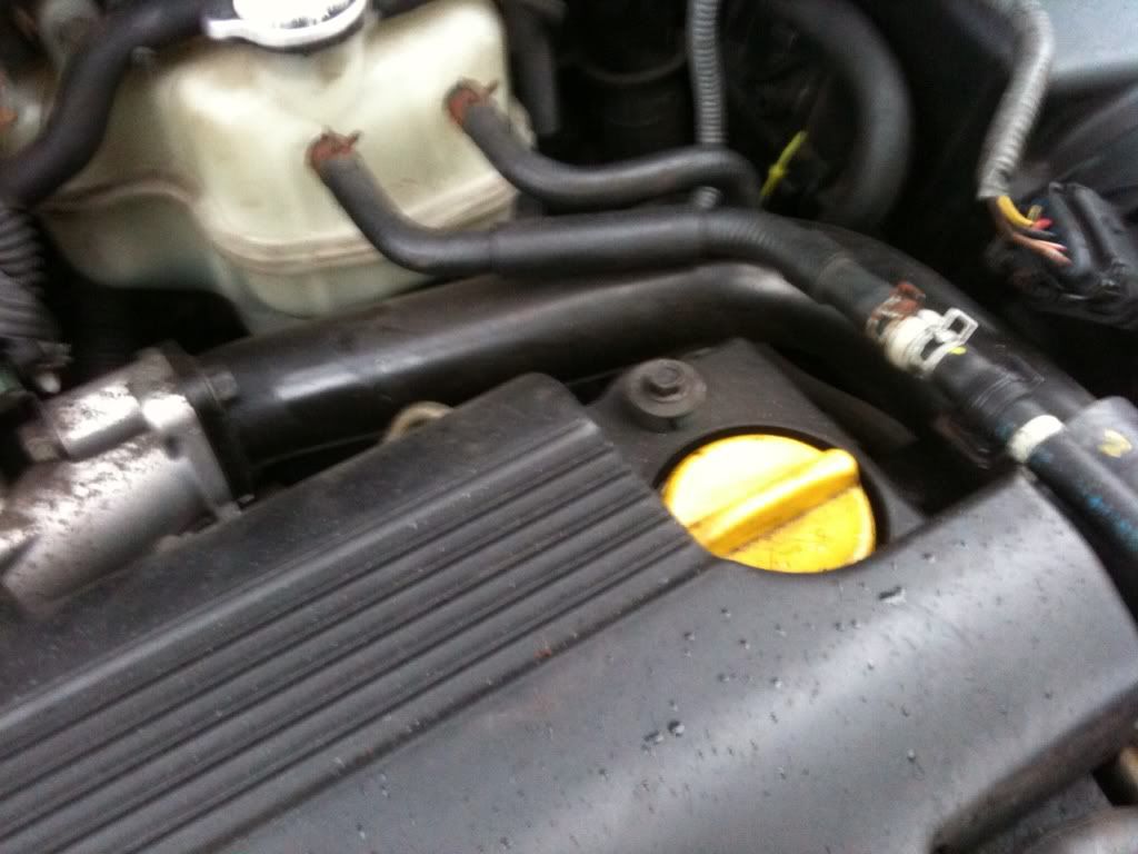

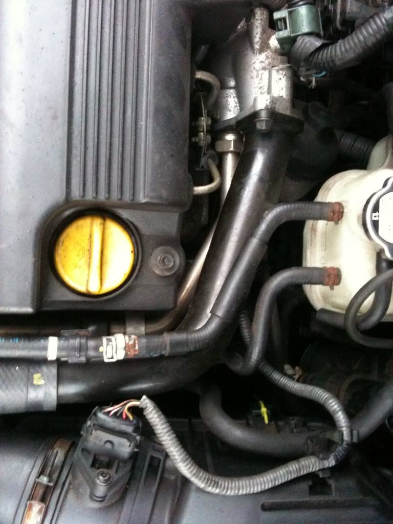

aaddzz123 Posted April 26, 2012 Posted April 26, 2012 Ok! I've thought about it and it needs to be a t peice... You're basically taking the air reading from somewhere thats already running. You don't change the way it works or anything so it must be a T peice to just "tap in" to it... Big question is, what size piping is it used on the civic? and will your T peice fit that... Other than that, its easy peasy. Just a bit of wiring and hiding wires inside... Any chance you have a few pictures of your inlet and the pipes coming off it? Looking for a layout now but would be a lot easier in person Quote

ali_legend Posted April 26, 2012 Author Posted April 26, 2012 I'm trying to find you some piks of the engine bay on google but if not I'll take some tomorrow. What piks you after? Quote

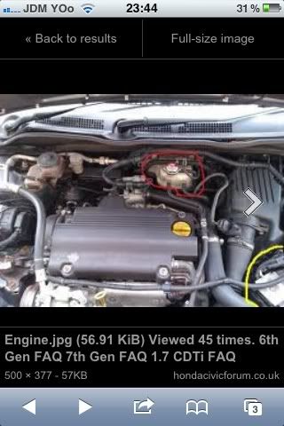

ali_legend Posted April 26, 2012 Author Posted April 26, 2012 Ones I could find of google. Not much use i don't think lol Quote
aaddzz123 Posted April 26, 2012 Posted April 26, 2012 an L piece? surely that would be absolutely pointless and it would only have 1 in and 1 out hole? so you may aswell not cut what ever pipe, or just use a straight connector?Yeah I realised that earlier I'm trying to find you some piks of the engine bay on google but if not I'll take some tomorrow. What piks you after? Basically we need to find the pipe that we need to cut. For example on the GT it goes from the inlet to the dump valve (or recirculating valve if stock) and to put the T peice on that.... I imagine its the same or at least roughly the same on all mechanical reading engines.... Are you sure you don't need an electronic boost gauge? I'm not sure how the 1.7 CDTI works to be honest! It might be as easy as splicing into a boost sensor wire with an electronic gauge.... I could be talking bullshit right now lol! I'm just trying to think of options if there is no pipe because I can't find anything on google or civic forums Quote

Starbuck Posted April 27, 2012 Posted April 27, 2012 That big fat rubber hose in the first image is that from the tubby? As that look like the best bet to take the nipple from??? Someone correct me if im wrong Quote
