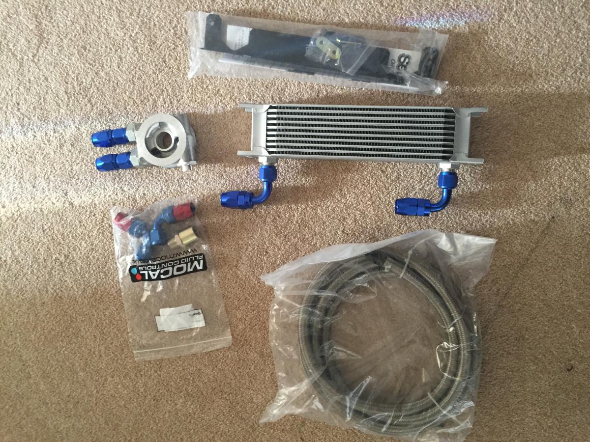

Got all my parts to fit my oil cooler now so that will be getting done tomorrow night hopefully with a cheeky oil and filter change and fit my boost controller aswell after that she will be about ready to go down to Mike next weekend ???? excited now
Always wanted an oil cooler they look class how much was it all? TD is a nice drive down even better coming back :D
Yeah they look mean as fuck when they're sticking out of the grill can't wait to see what it looks like 😈
Price isn't as bad as you would think if you buy all the bits seperate it works out cheaper than buying a ready made kit
And tbh I'm not looking forward to the drive down there off boost all the way down and in a completely stripped car it will be a proper shit drive lol but the drive home might be a bit different :)
