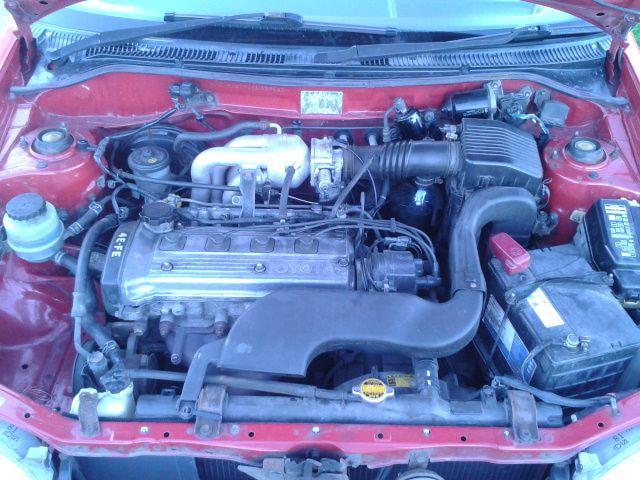

rmsnoel Posted August 8, 2013 Author Posted August 8, 2013 (edited) Corolla 4branch manifold is fitted. No immediate improvement but I have a really cool exhaust note now. It lined up so well with my standard exhaust that it only needed 1 cut and 1 weld to fit, a very handy job.5efe intake cam has made the biggest difference gainin nearly 10mph more on the 'flagpole to the flyover' dragstrip Edited August 8, 2013 by rmsnoel Quote

rmsnoel Posted August 17, 2013 Author Posted August 17, 2013 Gen1 corolla exhaust manifold works! Ive a auto and now when I shift into 3rd the car continues to pull instead if the flatspot I used to get. It was shit until I found the exhaust gasket was blowing out badly and prob affecting my af ratio.I got so alloy chequered plate to make up a heatshield next, I really notice the increased unbonnet temp without one Quote

rmsnoel Posted October 5, 2013 Author Posted October 5, 2013 50mm 4afe throttlebody, paseo intake sytem, gen1 4_2_1 exhaust manifold and corolla intake manifold. Timing advance 12° Ill do a timed run tomorrow and see if its faster though it does feel happier now a high revs. Quote

rmsnoel Posted October 6, 2013 Author Posted October 6, 2013 No man you need the intake piping to create torque. Tried and tested with cold air ducting and green cotton cone I had less pulling power uphill.Exhaust maybe, Ill just take off the backbox and do a timed run again Quote

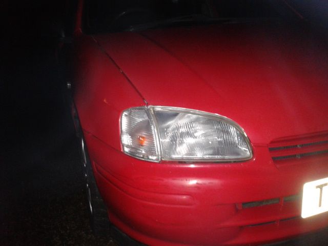

rmsnoel Posted October 20, 2013 Author Posted October 20, 2013 Finally coloured my grey indictors silver. Huge difference to the look of the car. Clean and silver instead of that dark look with just clear lens covers. Compare to my very first photo to see the change. I used a silver paibt marker from easons, at £3 it was cheaper than a can of spray and gave a much better finish. Quote
