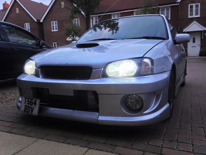

Arnold Posted May 1, 2015 Author Share Posted May 1, 2015 (edited) Another photo, this time of my new sidelights that I fitted yesterday. Nice and bright Edited May 1, 2015 by Arnold Quote Link to post Share on other sites

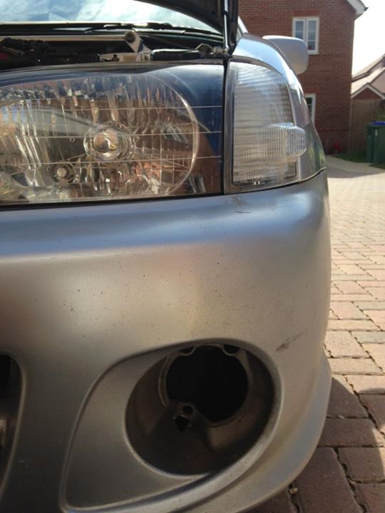

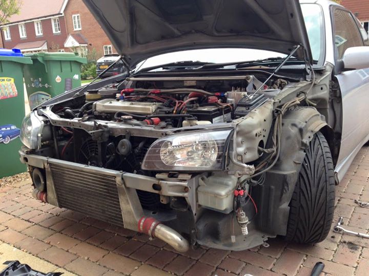

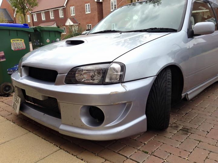

Arnold Posted August 25, 2015 Author Share Posted August 25, 2015 (edited) I haven't posted since Japfest as I've been busy getting married and stuff, so some small updates. The day before Japfest 2, I was taken out on a roundabout by some woman in the wrong lane. The damage is fixable, and thankfully their insurance admitted liability and settled on a payment after a few days. They were talking about writing it off at one point, but I don't think they realised the actual value of it at the time, and just assumed it was a UK Starlet. So a few photos, which i've previously posted in a different thread. I've acquired a replacement front wing, and front indicator. I've also gone for a new panel behind the headlight that the wing bolts onto. The bumper has also been ordered from ID Workz which needs to be made. Once the replacement is fitted and painted up, i'll have a go at repairing this one. Something i've done before several years ago and it'll be good to have a spare. About 4-6 weeks ago, I had an exhaust o2 sensor bung welded on my exhaust for my Wideband, and completed a front LED and HID upgrade too. I may remove the HID's though as i'm not sure if they're blinding other drivers! Fitted these (right) which weren't bright enough, so replaced them with the ones on the left instead Once my wedding is paid off, I expect to be doing a lot more to the car again! Edited August 25, 2015 by Arnold Quote Link to post Share on other sites

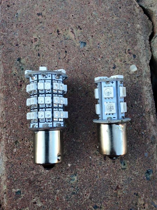

Arnold Posted August 25, 2015 Author Share Posted August 25, 2015 On 8/25/2015 at 3:50 PM, jellybaby said: Them lights for the rear ???? The led ones ? Fronts sorry. The rears have been converted to LED already, with some details about that conversion somewhere on the first page. I've upgraded the front sidelights and indicators. Had to change the polarity of the indicators and connect up a set of load resistors too. Worth the hassle as they're very bright! Quote Link to post Share on other sites
Arnold Posted November 23, 2015 Author Share Posted November 23, 2015 (edited) Hello all. Another quick update. I repaired the car using a second hand wing, front indicator housing and stuck the original bumper back on, and managed to get it to JAE. Front fog is a little cracked, but that's in and working ok. I've got some replacement headlights as they're both damaged but unfitted as yet. I've also got a replacement Toms bumper from ID Workz, but that's still sealed as I may not fit. At JAE, I had some of the car park dents in the rear 1/4 pulled, which makes the car much nicer to look at. They bugged me for ages. Shortly after, I noticed that I might have a water leak, but not sure where from. There's a pool of water at the bottom of the radiator, but the water level doesn't appear to be dropping much so i'm unsure. I bought a second hand radiator just to rule that out, but annoyingly and typically my luck, the "Glanza fit" radiator turns out to be a standard single core 57cm one, which is just crap and won't do. Just to add more misery, my Tuning Developments manifold has cracked again for the third time this year, so I've really lost interest at the moment. Spending like £120 a time to get it repaired, only for it to crack months later isn't fun. The MOT has run out now so she doesn't currently move anywhere really. I went to start the car the car just to keep it moving and the battery was dead, so chucked a new one in (under guarantee). She still leaks oil! Despite various attempts at sorting that, it's coming out from various places. I love her when she works, but I don't love her as she is right now, and seriously lost faith in it. I guess we've all been there at some stage! Some Photos of the repair. Edited November 23, 2015 by Arnold Quote Link to post Share on other sites

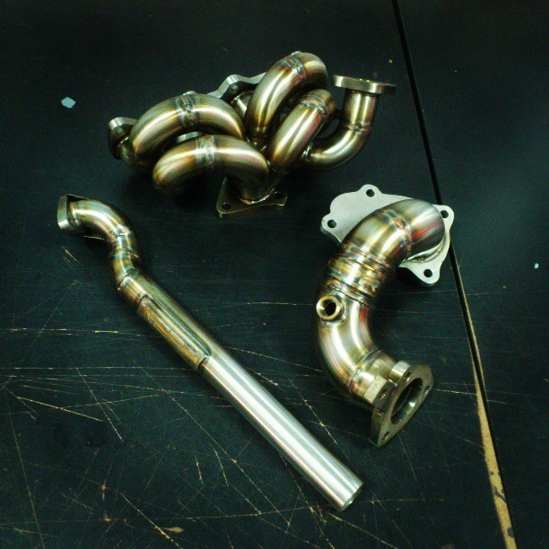

Arnold Posted December 18, 2015 Author Share Posted December 18, 2015 (edited) Bought myself a ex gated TD04 compatible mild steel manifold, downpipe etc from WEPR to replace the one I've currently got, so hope to have that and a few other electrical bits fitted January! Can't wait to get her back on the road again. The screamer will be plumbed back into the downpipe, and the manifold adapted by WEPR to support a clamp vband Tial wastegate (Pic of the stainless kit) Edited December 18, 2015 by Arnold Quote Link to post Share on other sites
Arnold Posted February 17, 2016 Author Share Posted February 17, 2016 (edited) It's arrived! Stunning bit of kit from WEPR, can't wait to get it fitted. Gaskets have been ordered separately from one of the traders on here. Edited February 17, 2016 by Arnold Quote Link to post Share on other sites

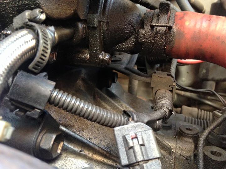

Arnold Posted February 29, 2016 Author Share Posted February 29, 2016 Have taken the Glanza to my mechanic friend to fit all the new WEPR stuff above, fix the radiator leak and MOT the car. The radiator is leaking from where the manifold had cracked, which basically burnt a hole straight through it! The radiator will be replaced for a new one too. Can't wait to have her back! Quote Link to post Share on other sites
