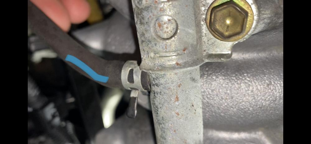

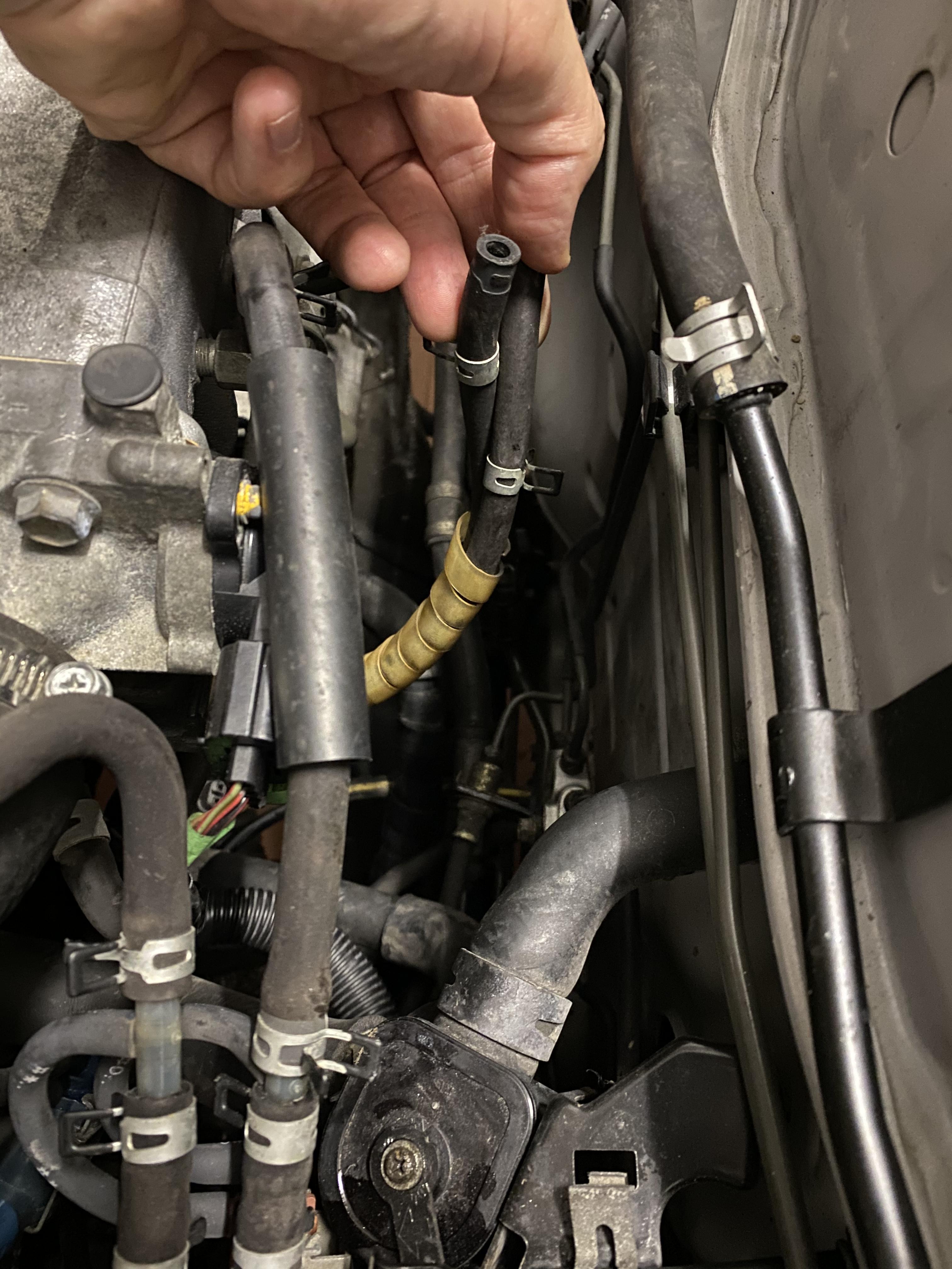

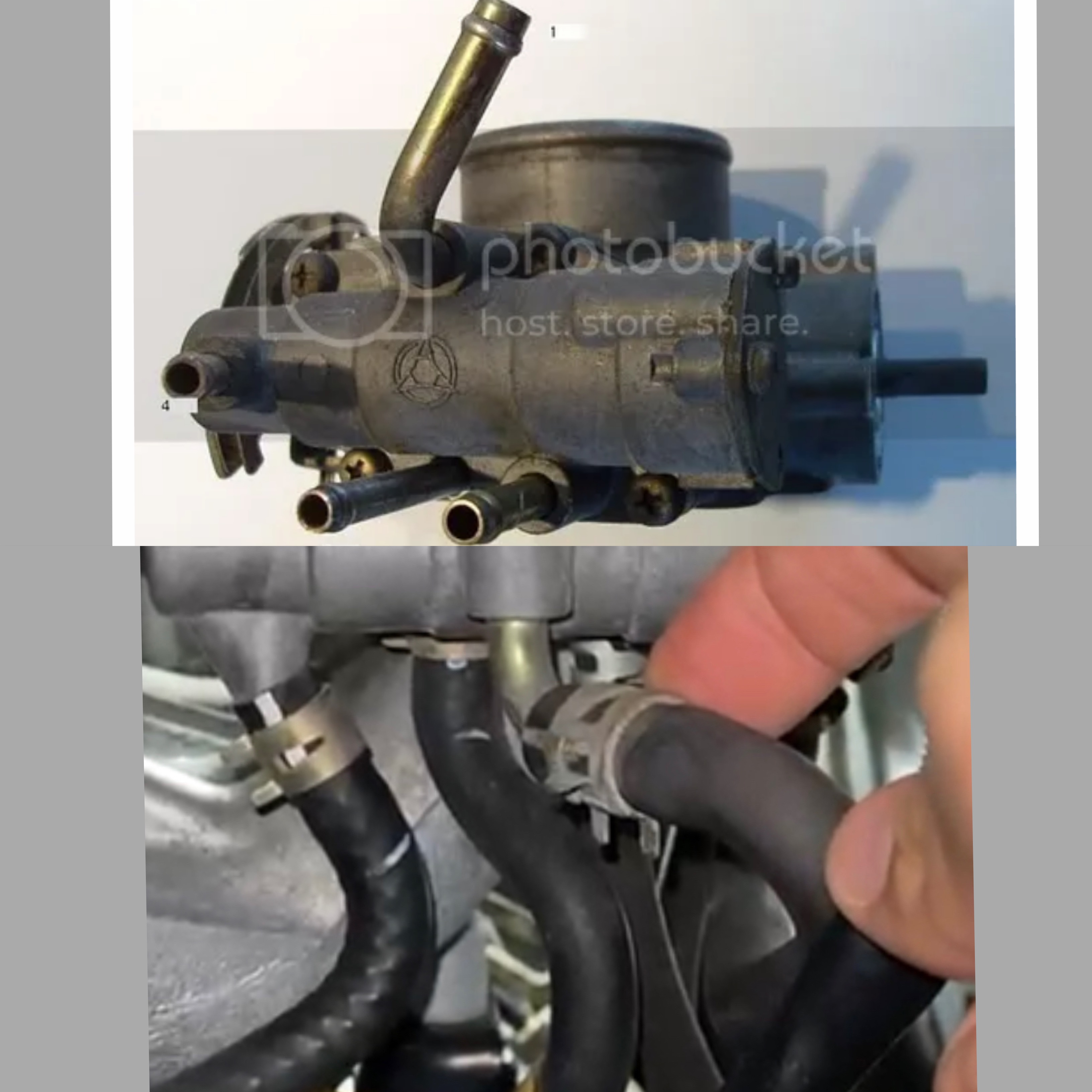

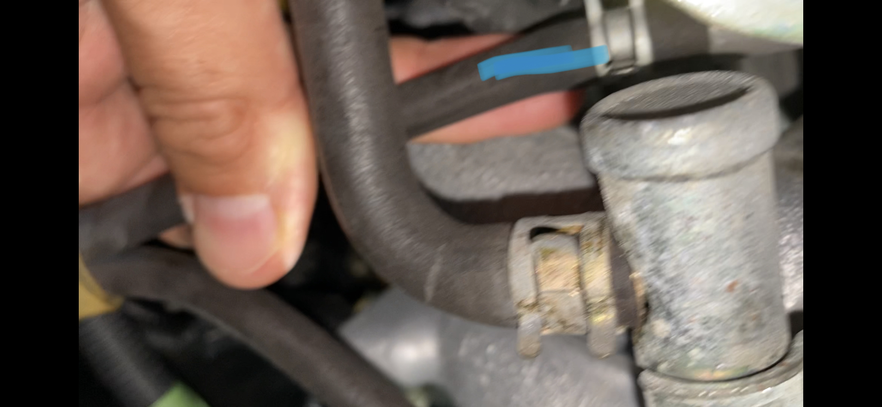

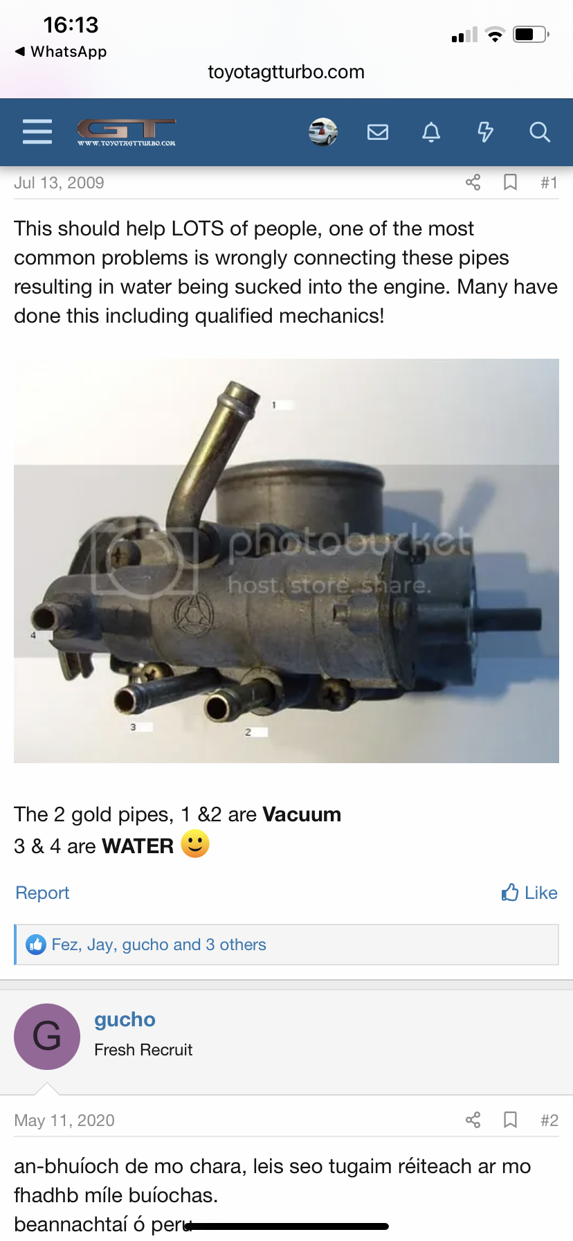

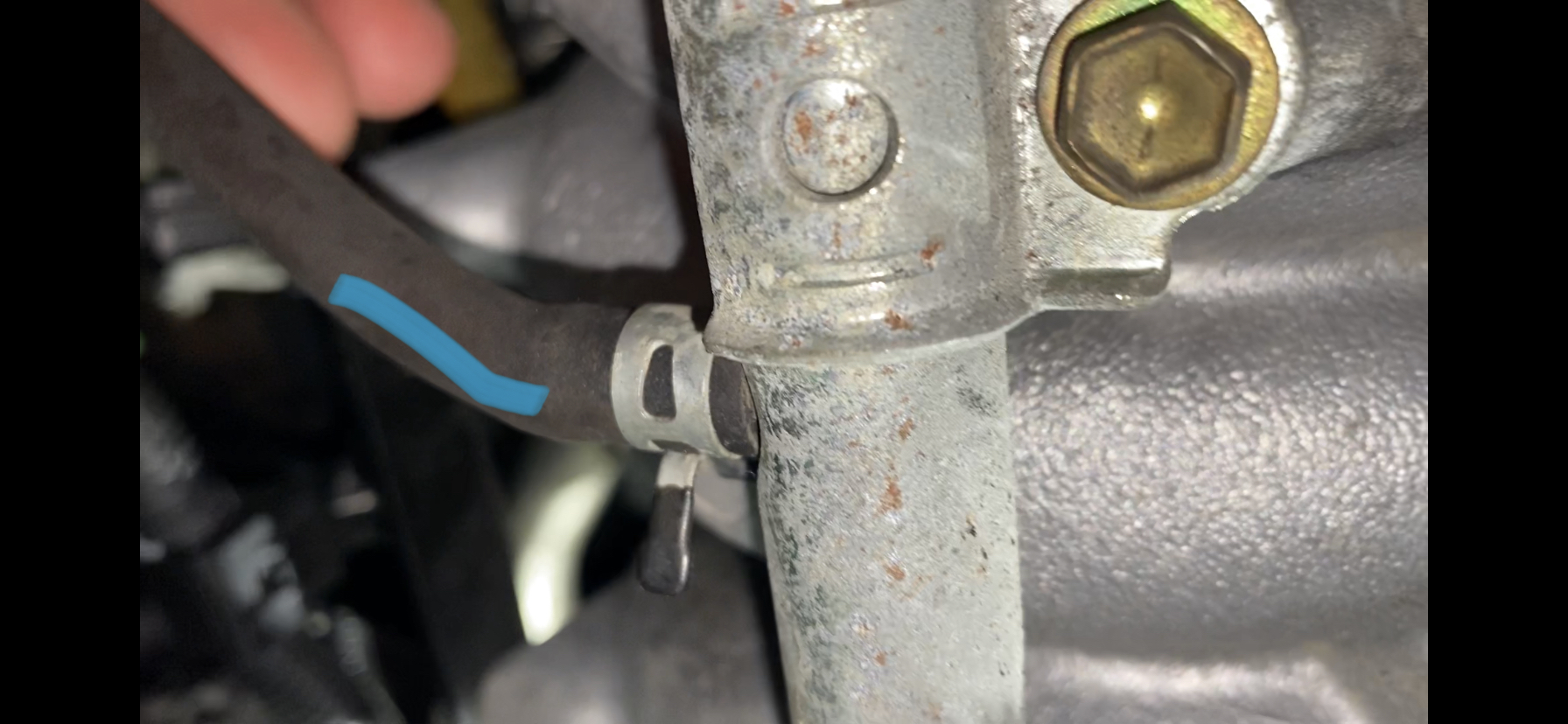

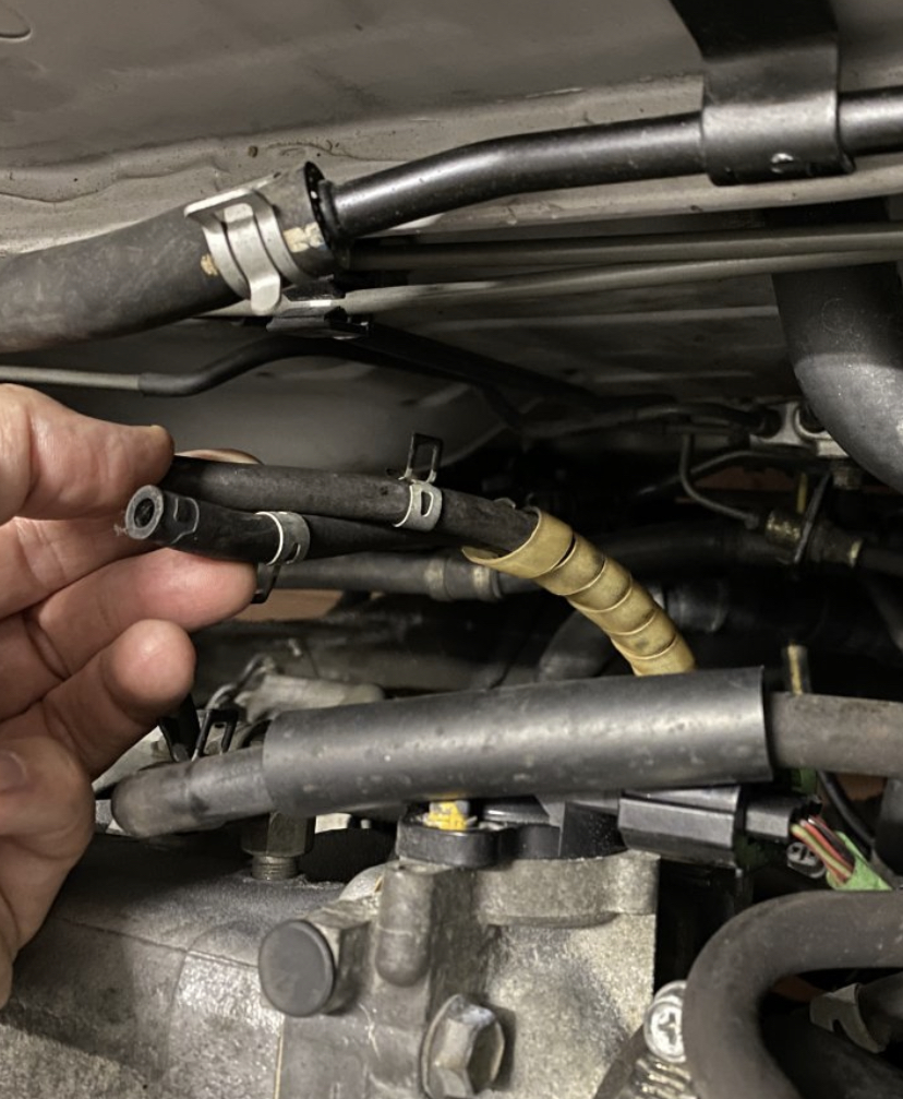

Frankieflowers Posted July 23, 2021 Posted July 23, 2021 (edited) On 5/16/2013 at 11:43 PM, daniel_g said: If you have this still attached to the coilpack ignitor then get it in the fucking bin and block off the top TB ports. Just causes hassle and random vac lines everywhere. http://i1149.photobucket.com/albums/o585/daniel_gg/20130324_153420_zps3bd4293c.jpg And the carbon canister that lew mentioned. This is the best pic i have atm of the vac pipes youre talking about. http://i1149.photobucket.com/albums/o585/daniel_gg/20130318_201038_zps72e5be8e.jpg Anyone still here? I’m having trouble with a few hoses. Swapped the engine in a Corolla. I don’t want to leave anything hanging. The two pipes I have a loose are apparently one for water and one for air. One of those plastic spirals is holding them together. @Jay send me a picture of the throttle. Number two is next to another hose which isn’t on the throttle but on the inlet right next to it I need to know how to connect them and where. Thanks Edited July 23, 2021 by Frankieflowers Quote
