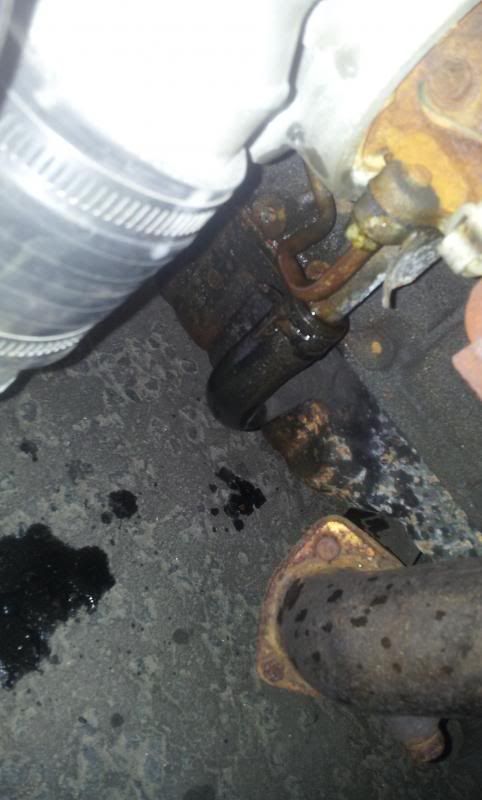

white-gt Posted May 22, 2013 Posted May 22, 2013 well guys i had my hybrid rebuilt a good few months ago and its done less than 1k miles but was running sweet untill sunday.. i just left knockhill with the engine all warmed up, i done an overtake boosting at 1 bar to about 75MPH i then slowed as i pulled back in but when i tried to power again their was no boost at all.. i thought a pipe so when we pulled over we checked all pipes but everything was solid! when i tried to accelerate the turbo made a high pitch sound which sounded like boost leak.. we eventually nursed it home and the turbo tone kept changing from a high pitch to nothing and then a low pitch sound which was odd.. when we got home (50 miles) we noticed oil was now dripping from the feed/drain.. their was no squeal on idle so i dont think the turbo was running dry.Whats your thoughts? http://s4.photobucket.com/user/twaiter/media/20130519_193123_zps44f824e2.jpg.html'> Quote

StuDoc 72 Posted May 22, 2013 Posted May 22, 2013 Aw does he have it thats sound then i'm sure he will diagnose it. To me it sounds more and more like the bearings have collapsed although if they had I would expect it would be smokey as hell rather than having oil running from it. Hybrids arent cheap though pal so if you want it repaired or replaced you will be forking out.. Is it TD04 im assuming from what looks like a downward facing hot pipe? Where in scotland you from? Quote
white-gt Posted May 22, 2013 Author Posted May 22, 2013 no pal its just a CT9 hybrid rebuilt by Jezzas cousin.. it was running great so i dont see what the problem is.. im in EK dude, often in town etc, black ep82 with toms kit etc. i cant afford to forge which is why i wont run a td04.. theirs no smoke from the car at all, it was very strange! boosted past people fine then suddenly nothing. not a sausage.their was no oil at the time, no smoke no nothing. io think its the bearing or something as well tbh, it sounded like the wheels just would turn easily. Quote
StuDoc 72 Posted May 22, 2013 Posted May 22, 2013 Just looks strange in that pic looks like the hot pipe is facing downward with a pop on hot pipe rather than bolt on. Ah I see Jezza's a good guy. Do you know what was done when he rebuilt it? If it wasnt balanced that would almost definately mean the problem is that the bearing has collapsed. EK I actually got my new car from down there. Quote
white-gt Posted May 22, 2013 Author Posted May 22, 2013 their is a list of what was done and balancing was certainly done. its a SS mani which has been welded (off the car). im not sure what you are talking about with the pipes? is how it is setup wrong? i bought mine from Manchester, it was a shed! ive gradually got her good! Quote
StuDoc 72 Posted May 22, 2013 Posted May 22, 2013 Im assuming the mani hasnt cracked again? Just the way the pic looks mate nothing is wrong. Quote

white-gt Posted May 23, 2013 Author Posted May 23, 2013 Well Iain has came back saying the hybrid is fine. No play in and out and very little side to side with no damage to the blades or anything.. Is their an after market fees pipe? I think Iain is gonna put it back on and see how it goes.. No idea what the problem was.. Quote
