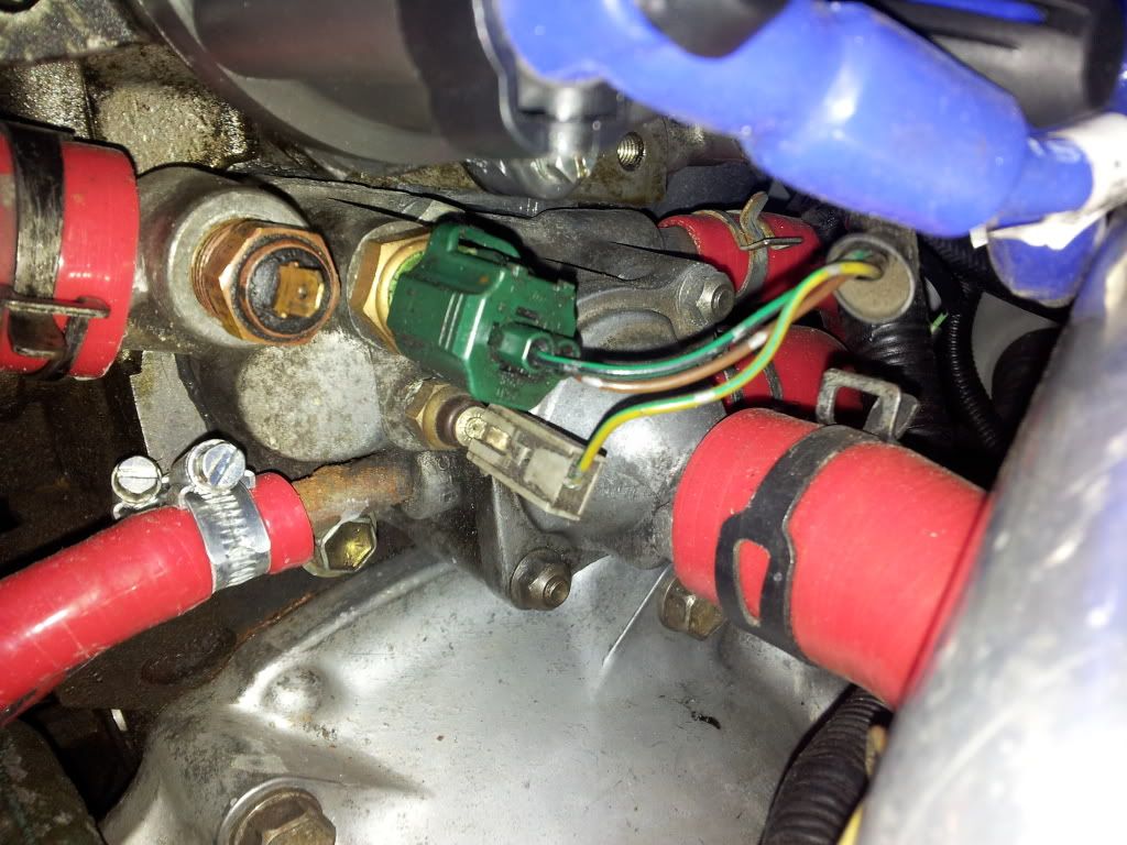

mikey4410 Posted June 14, 2013 Author Posted June 14, 2013 http://s140.photobucket.com/user/mikey4410/media/SELLING%20STUFF/IMAG0394_zps9990f08e.jpg.html?sort=3&o=0#/user/mikey4410/media/SELLING%20STUFF/IMAG0394_zps9990f08e.jpg.html?sort=3&o=0&_suid=1371234765317020580412731423703 i unplugged this plug and the rad fan turned of,does this mean this is the rad fan issue and i need a new sensor,can somebody please confirm and also whats the plug called ?? also the other issue which might not be helping is that i found this with no wire goin to it andi have no idea were the wire is to go to it,can somebody please let me know the colour of wire going to it ?? http://s140.photobucket.com/user/mikey4410/media/SELLING%20STUFF/IMAG0394_zps9990f08e.jpg.html?sort=3&o=0#/user/mikey4410/media/SELLING%20STUFF/IMAG0393_zps7f25716f.jpg.html?sort=3&o=1&_suid=137123507555509557269677565028 Quote
AdamB Posted June 14, 2013 Posted June 14, 2013 http://s140.photobucket.com/user/mikey4410/media/SELLING%20STUFF/IMAG0394_zps9990f08e.jpg.html?sort=3&o=0#/user/mikey4410/media/SELLING%20STUFF/IMAG0394_zps9990f08e.jpg.html?sort=3&o=0&_suid=1371234765317020580412731423703 i unplugged this plug and the rad fan turned of,does this mean this is the rad fan issue and i need a new sensor,can somebody please confirm and also whats the plug called ?? also the other issue which might not be helping is that i found this with no wire goin to it andi have no idea were the wire is to go to it,can somebody please let me know the colour of wire going to it ?? http://s140.photobucket.com/user/mikey4410/media/SELLING%20STUFF/IMAG0394_zps9990f08e.jpg.html?sort=3&o=0#/user/mikey4410/media/SELLING%20STUFF/IMAG0393_zps7f25716f.jpg.html?sort=3&o=1&_suid=137123507555509557269677565028 The first one I think is the fan switch at the back of the thermo housing from what it looks like. The second one is the temp gauge in the car. Quote
mikey4410 Posted June 14, 2013 Author Posted June 14, 2013 the second one thats unconnected cant be that as my temp guage in car works ?? need to know what 1st ones called ? Quote

daniel_g Posted June 14, 2013 Posted June 14, 2013 Does you thermo housing plugs look similar to this ? Quote
mikey4410 Posted June 14, 2013 Author Posted June 14, 2013 no way,so u genuinely havent got a wire for that sensor either ? what things haveu treid to get the idle down then dude ? Quote
daniel_g Posted June 14, 2013 Posted June 14, 2013 When i was building my car up i changed the looms, on my current one there is no spare plugs around that area, apart from one which i think is for the cat temp sensor which is long gone. I'll switch a few about and see whats what. I had the oil pressure switch plug plugged into that black one, oops, which constantly had the oil light on. I still have my old looms, so im gonna see if i can find this wire on that. I set it with the idle screw on the throttle body. My idle control valve was spotless so was my throttle body, i also checked my throttle position sensor, but that was fine. As i said my throttle cable was too tight. Cant get my fan to work though, if i give it 12v and earth it works but its not turning on when the car is up to temp. Well halfway up the gauge. Quote
