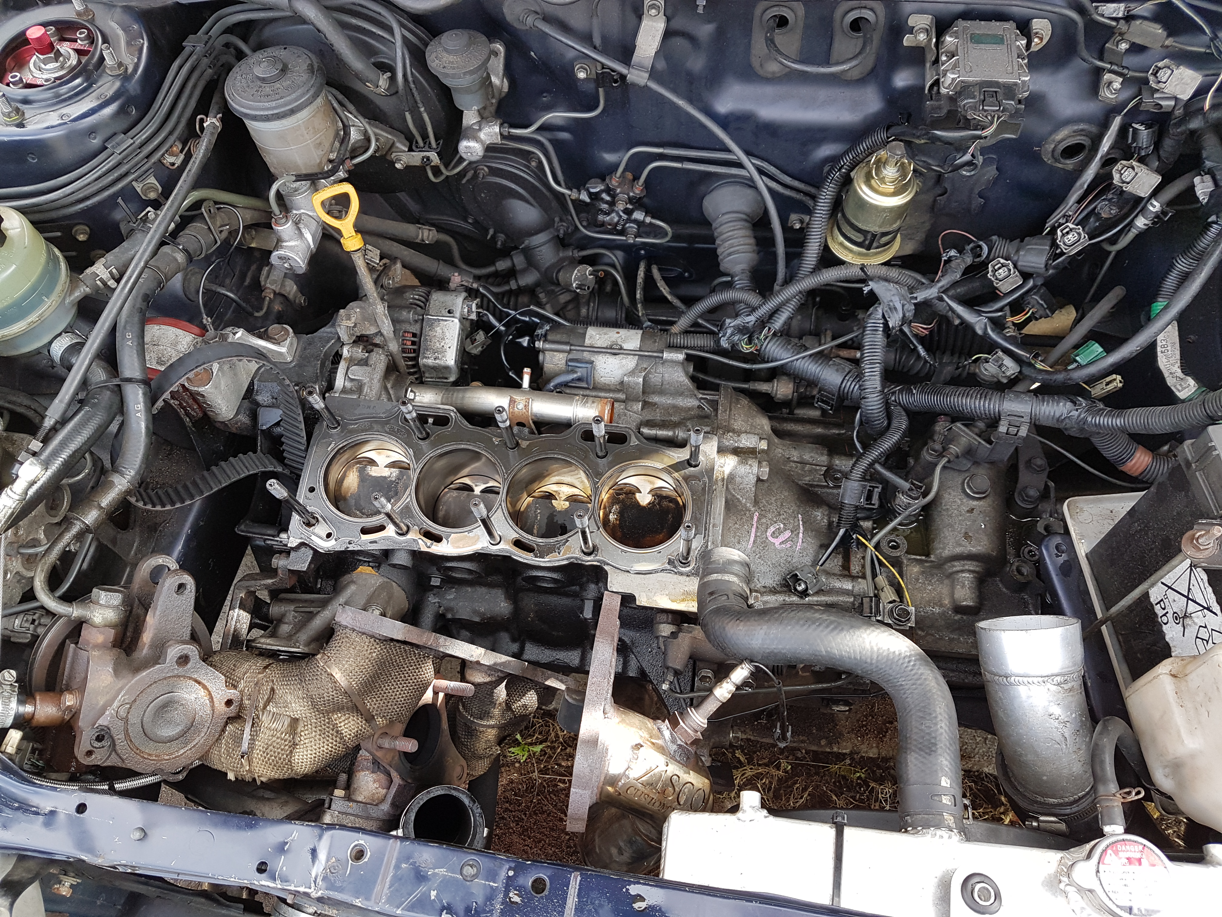

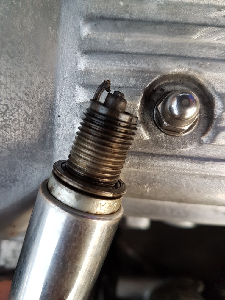

Whipped the plugs out yesterday and found ive melted one. So bought a set of NGK BKR7E. Hopefully the rest of the ignition system is ok for now.. it does need updating soon though.
Not really sure whats up next.

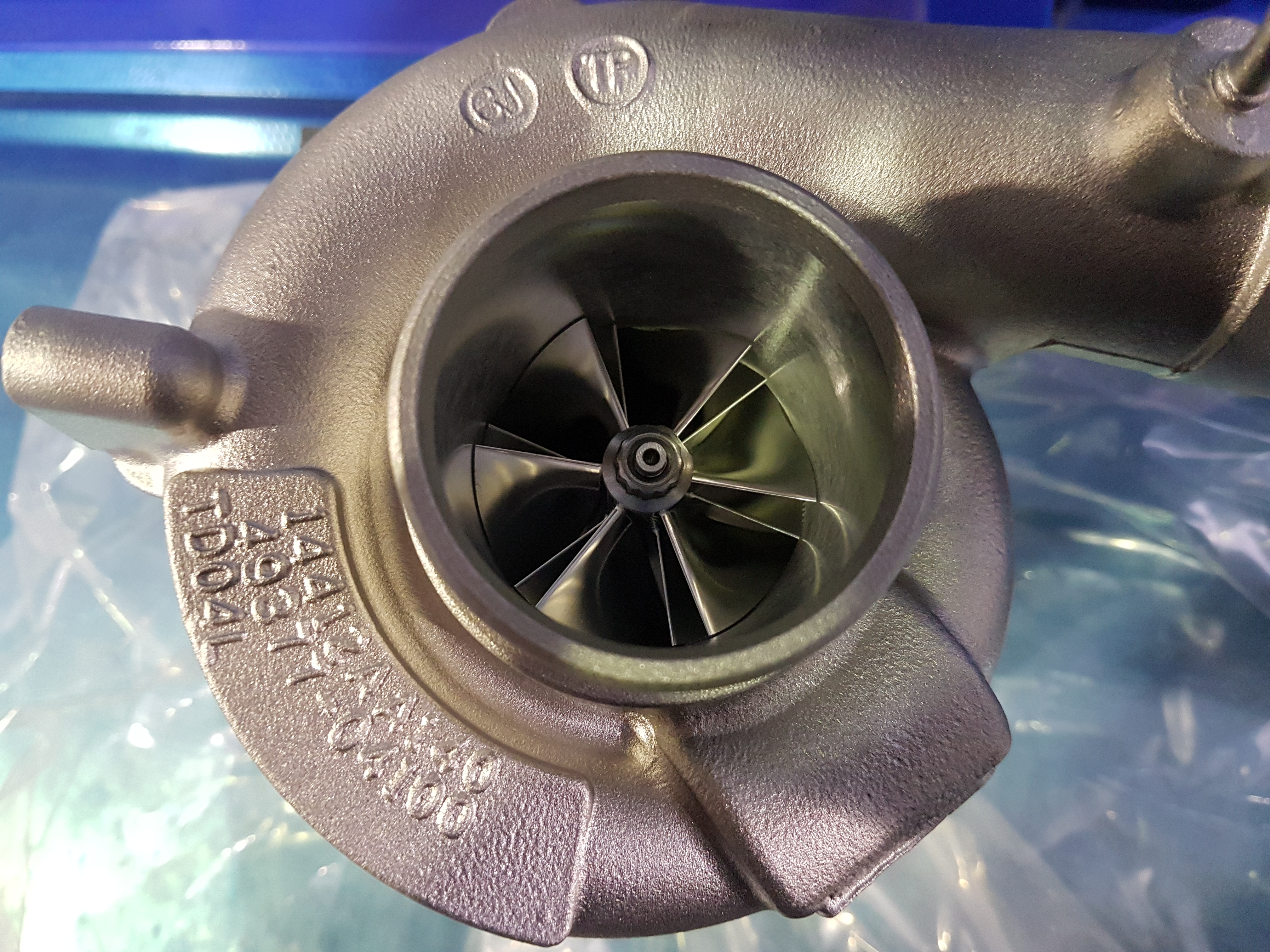

Midland turbo have my TD04.. 'oil contamination' so might get billet wheels put in. I have a 0.83bar EWG spring arriving.
Crail on the 24th

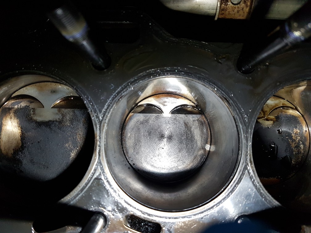

Comp test was 180 - 0 - 180 - 180

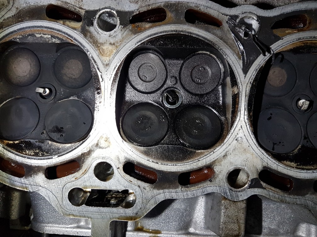

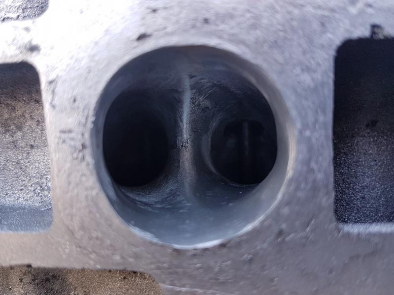

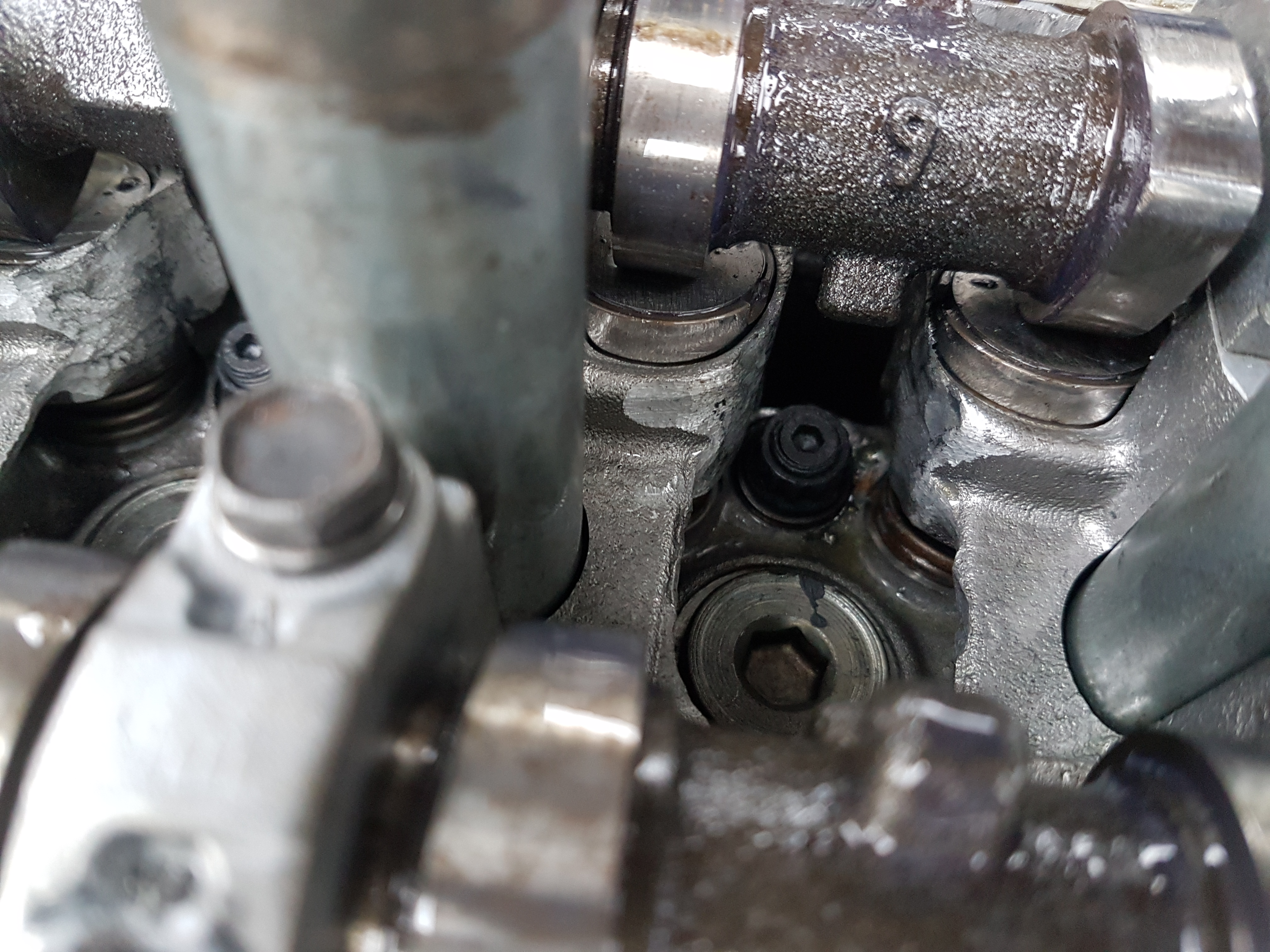

So i stripped the head off.
Exhaust valve on cylinder 2 has had it if you look closely at the pic.
All is good though! Bore is fine and there is no damage to the flat top Wiseco! Just a small mark (which will buff) not a dent.
Will order another 0.5mm HG.
I have spare heads to steal valves from. I will built it back up in a few days 8)
Edited by daniel_g
Oh shit, what you think caused that Dan? Maybe knock?
Yeah bit too much heat in that cylinder for sure. The knock sensor was changed a couple of weeks ago. Swapping injectors aswell.

Sent the TD04 off to midland and whilst it was getting rebuilt i've had a billet comp wheel installed too.

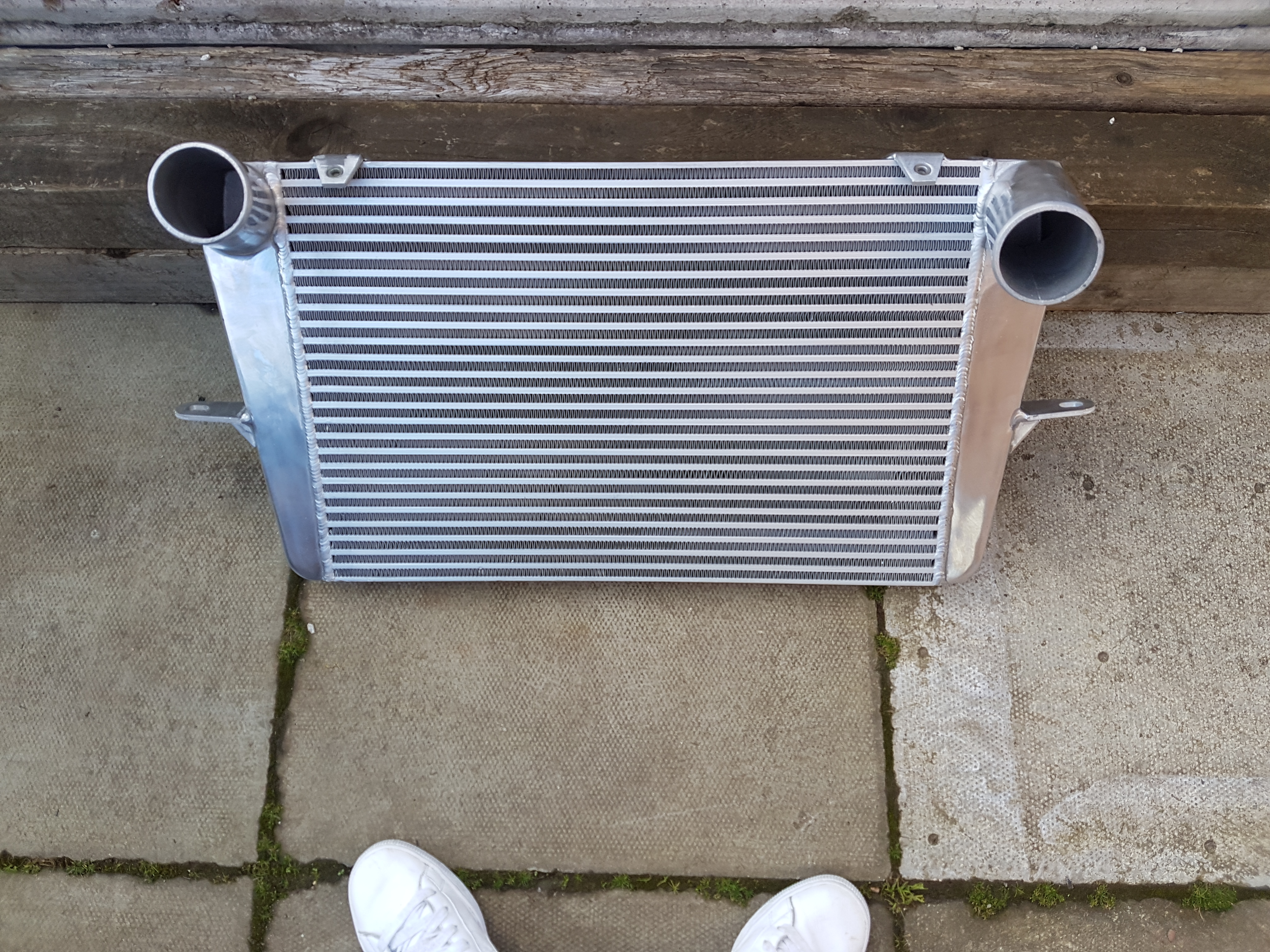

Also bought a massive intercooler, with rear outlets to the top, so slam panel will be getting the chop, also gonna have to fire the Gi FRP bonnet from my MK2 onto this, it has locking aero catches.

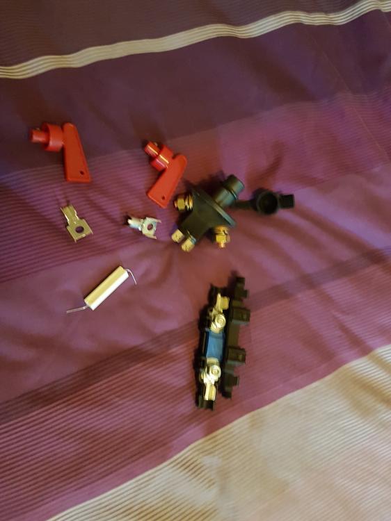

Battery relocating kit arrived so will need to get round to that at some point aswell.

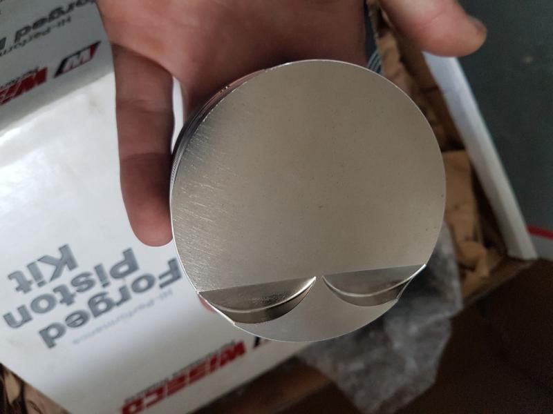

Havent forgot about the 4paw though! Bought some forged rods and pistons for it, will be collecting the rest of the parts in a bit. Pistons are wiseco 74.5mm, and went for Maxspeeding rods, the engine builder im gonna use swears by them. Will be going for a 0.5mm HG and ARP headstuds not bolts :)

Mounted a fairly large intercooler which just about fits minus some metal upfront, which was replaced with steel bar.

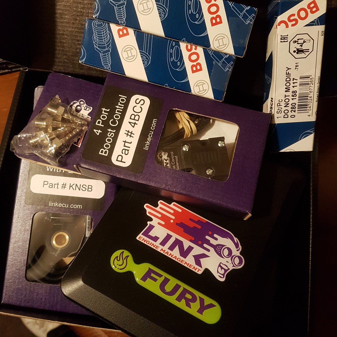

Best purchase recently has been a new Link Fury ECU. (Crazy amount of features)
This will essentially modernise and bring the car up to a relevant standard.
Also its the best protection my engine is gonna get!
4 port boost solenoid controlled via the ECU, Link knock sensor, oil pressure sensor, Link 4 bar MAP, Bosch 4.9 LSU o2 sensor via the ECU etc..
I will be switching to electronic throttle body and pedal with COP ignition in due course.
Had a loom made up and the map is still to have a few tweaks here and there, but so far its very impressive. No power figures as of yet as with being 4wd it wont go on a hub dyno so has to be road mapped.
