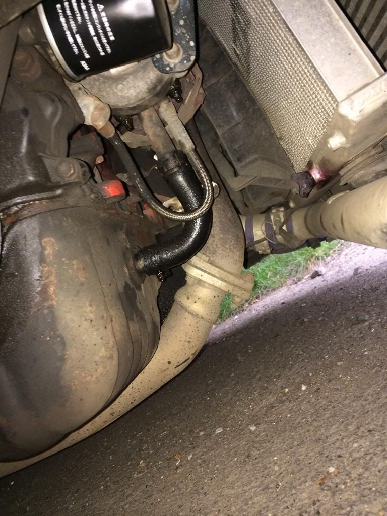

Kate Posted April 3, 2014 Posted April 3, 2014 There is a rubber pipe coming from my sump that seems to be leaking. What's this pipe called? Quote
TurboTobz Posted April 3, 2014 Posted April 3, 2014 Oil return, make sure your oil feed just above it isn't leaking. It's common for them to rupture due to an aftermarket manifold slightly moving the turbo from original positioning and stressing it. You can't see it cracked often but will drip slowly when engines running. Quote
Kate Posted April 3, 2014 Author Posted April 3, 2014 Hmm I'll take a pic. I think the return it after market. Have a look.... Quote
Kate Posted April 3, 2014 Author Posted April 3, 2014 So it's the black rubber one I think is leaking... Is the oil return the stainless steel pipe? I've just ordered another one but dunno what one it is now? Quote
Kate Posted April 3, 2014 Author Posted April 3, 2014 I've also just noticed the radiator is leaking.... See that plug thing?? Where would I get that? The rad is less than a year old, do I go back to japspeed? Quote
daniel_g Posted April 3, 2014 Posted April 3, 2014 The oil return is what looks like is leaking, you already have a braided oil feed so thats all good There should be a rubber grommet on the radiator drain plug, check its not perished and obviously check its tight aswell. Quote
daniel_g Posted April 3, 2014 Posted April 3, 2014 Also looks like the front crank seal is leaking, very common on these engines. Quote

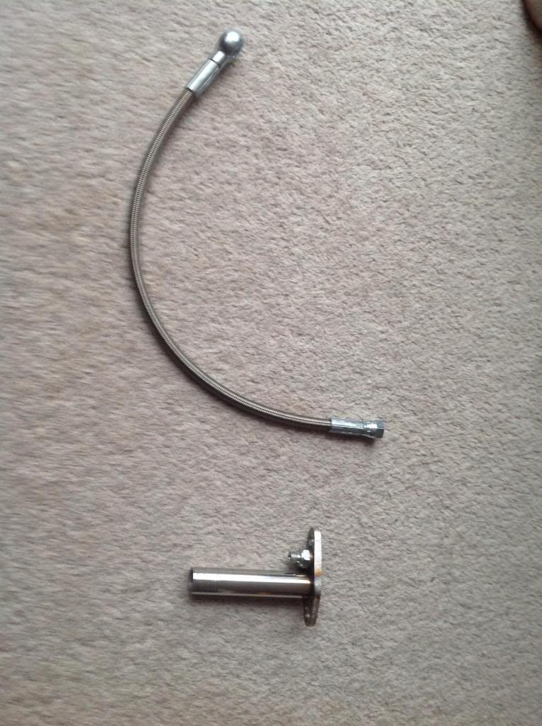

Kate Posted April 3, 2014 Author Posted April 3, 2014 So I have these to fit.... These both of those pipes? Quote
Kate Posted April 3, 2014 Author Posted April 3, 2014 And where is it leaking? Crank seal? Aghhhhh!! Lol x Quote
daniel_g Posted April 3, 2014 Posted April 3, 2014 Thats a braided oil feed youve bought which you already have !! You'll be able to sell it on though no worries Its an oil return you're looking for, a silicone one is best. And yeah just under the timing belt its got a bit oily leak there Quote
