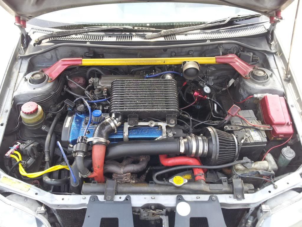

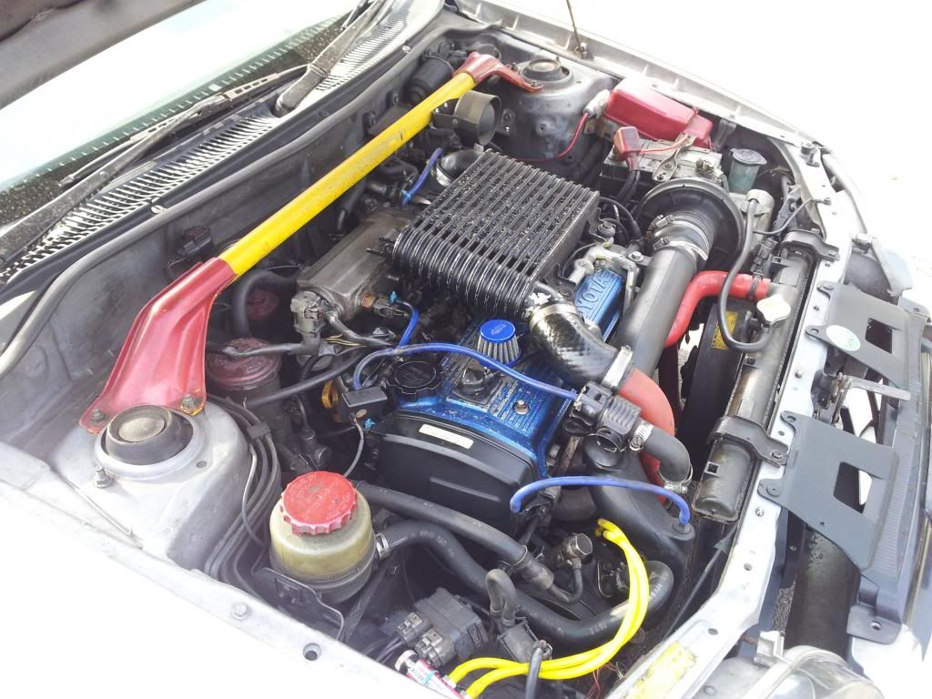

SakGlanzaV Posted April 21, 2014 Posted April 21, 2014 hi guys here is the set up of my standard glanzaI have had a gt turbo engine swapI am running a standard ct9 turbostock ecumanual boost controllerfuel pressure regulator I have recently purchased this, it seems a little wierd and I am confused as to why someone has put a FPR on a standard glanzamy problem is that at full foot in third gear the boost shown on the gauge does not exceed 0.5 bar. I'm not too sure but perhaps it might be something to do with the FPR? any help is appreciated thanks guys Quote

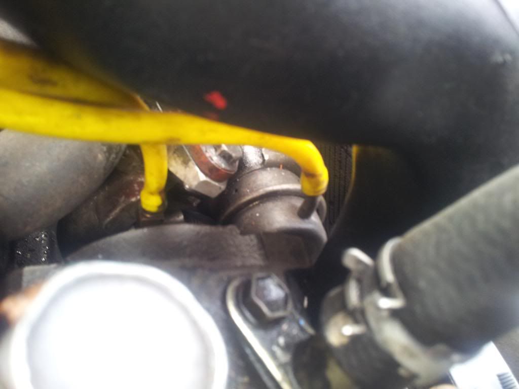

SakGlanzaV Posted April 21, 2014 Author Posted April 21, 2014 Thanks for the response guys ok I will get some photos of the actuator up tommorw. I''m pretty sure it's a standard one. Also if The FPR is causing the problem how do I remove it Quote

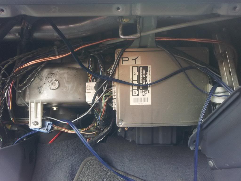

SakGlanzaV Posted April 22, 2014 Author Posted April 22, 2014 hi guys it looks like the actuator is a standard one? and I also whacked off the glove box to see if I was running a FCD which it doesn't look like I am ANY IDEAS PEOPLE? Quote
Aamir Posted April 22, 2014 Posted April 22, 2014 You have a standard actuator. You will need an adjustable actuator to increase the boost. Aamir Quote

mikey4410 Posted April 22, 2014 Posted April 22, 2014 with a rrfpr thats worth adjusting is how. unless thats a turbo smart one in the picture above u really need to get a decent one regardless of wether it works ok. the quality of those is shocking and it will destroy ure motor if it starts to fail which is likely. i still think ure actuator is fooked.yes they are 0.65 standard but your talking about a spring that is potentially 18 years old plus. Quote
SakGlanzaV Posted April 22, 2014 Author Posted April 22, 2014 with a rrfpr thats worth adjusting is how. unless thats a turbo smart one in the picture above u really need to get a decent one regardless of wether it works ok. the quality of those is shocking and it will destroy ure motor if it starts to fail which is likely. i still think ure actuator is fooked.yes they are 0.65 standard but your talking about a spring that is potentially 18 years old plus. ok yes I do think it is a cheap turbo smart one, I haven't touched anything in the bay as I brought it like this would it be better to remove the FPR as I am running totally standard anyway? Quote
