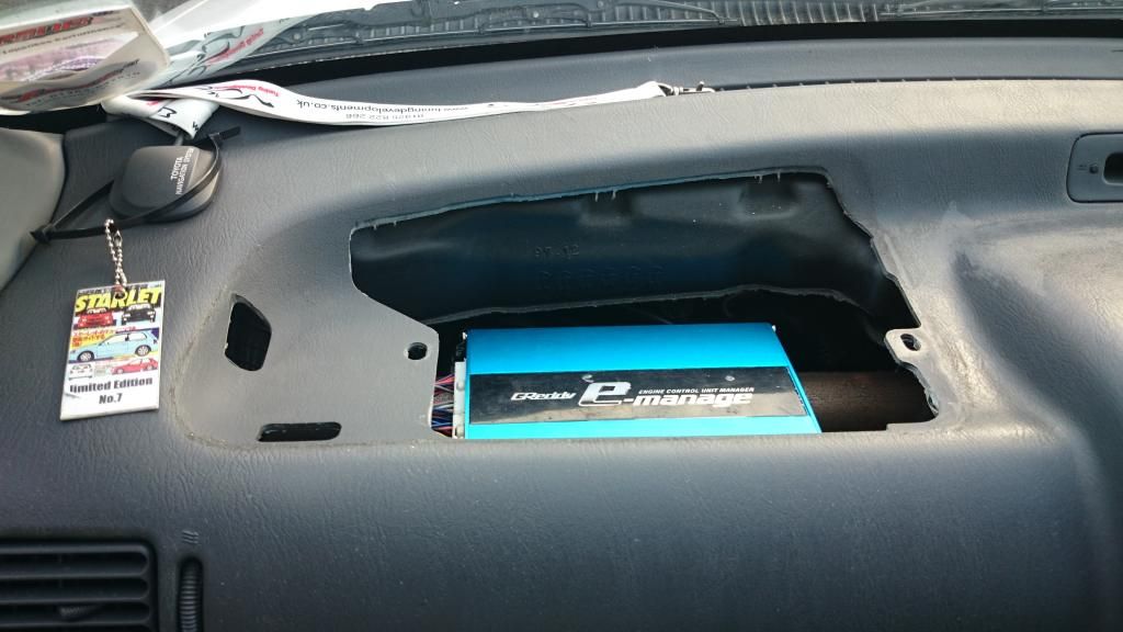

TrisK Posted July 13, 2014 Posted July 13, 2014 E-Manages cane fit behind the glovebox, if you have skills.. I say emanage ultimate. launch control, better mapping tables....Emanage can also go down under the headunit Quote

Gainzy Posted July 13, 2014 Author Posted July 13, 2014 Emanage can also go here Haha I have my airbag there which I don't want to mess with Quote
akyakapotter Posted July 13, 2014 Posted July 13, 2014 Haha I have my airbag there which I don't want to mess with There so old now I didn't trust mine anyway and wanted my little girl to ride shot gun so out it cam now I can fill the glove box with crap again lol Quote

Gainzy Posted July 13, 2014 Author Posted July 13, 2014 There so old now I didn't trust mine anyway and wanted my little girl to ride shot gun so out it cam now I can fill the glove box with crap again lolYeah I see what you mean airbags are meant to be changed every 10 years or at least checked! was it easy to remove? Quote
akyakapotter Posted July 13, 2014 Posted July 13, 2014 Yeah I see what you mean airbags are meant to be changed every 10 years or at least checked! was it easy to remove?Very easy few nuts to undo and some electrical connections to remove and cut the cover off it and fit a resistor to make the airbag light work for mot Quote
