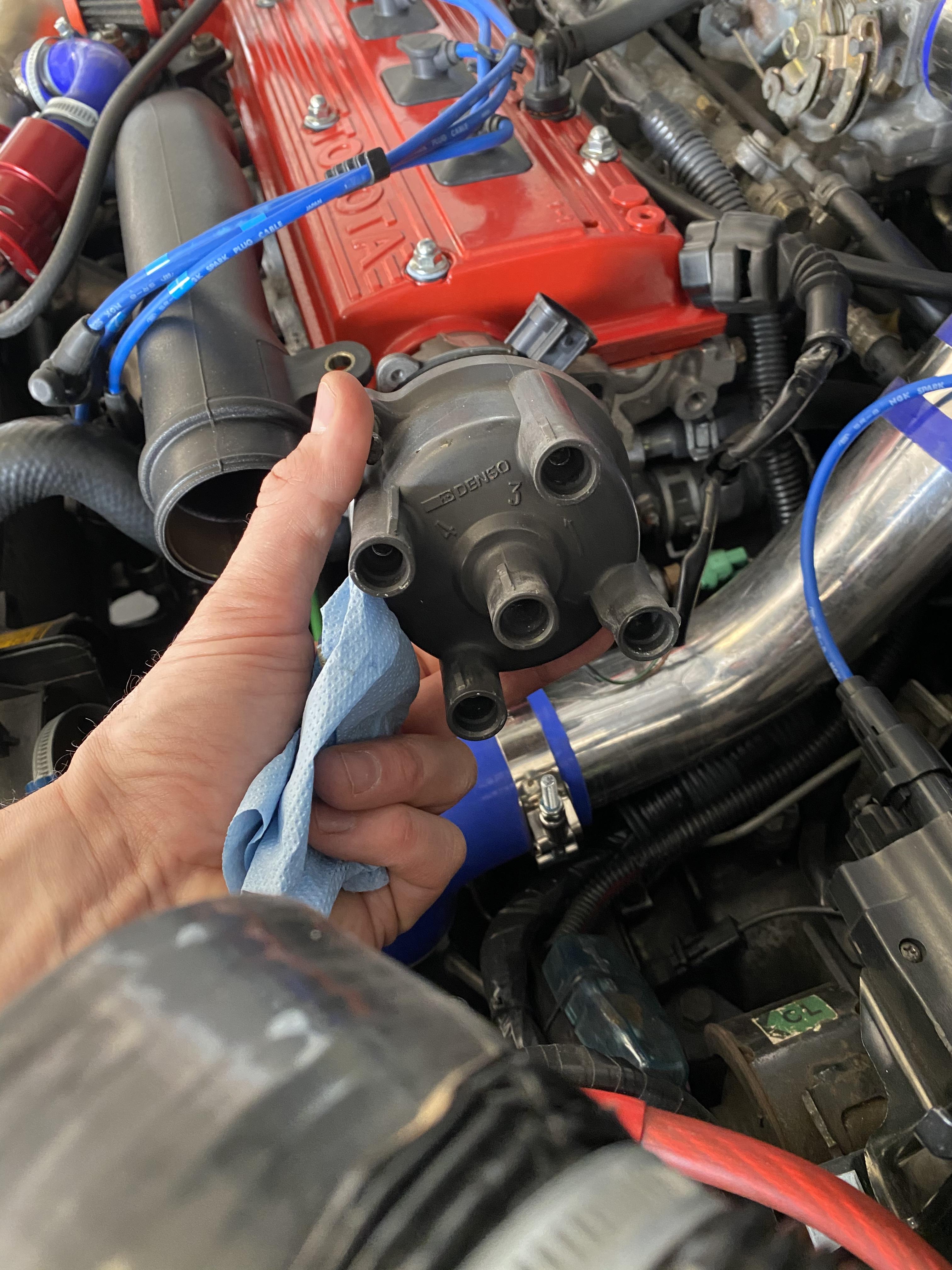

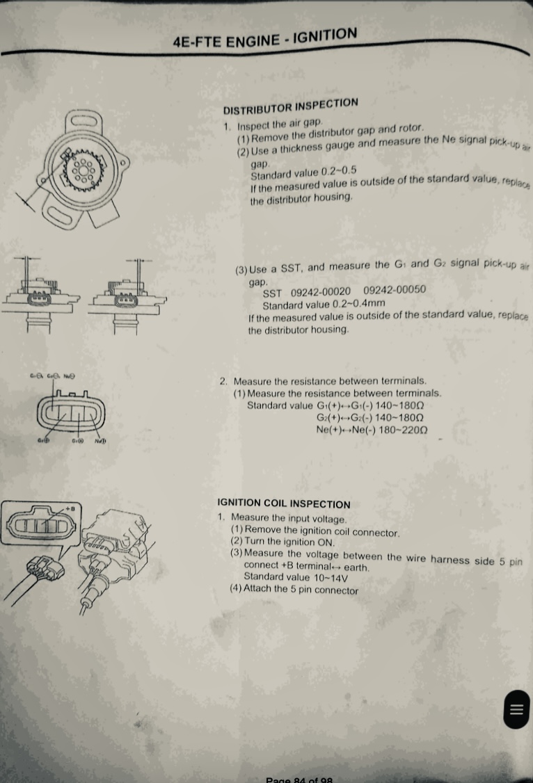

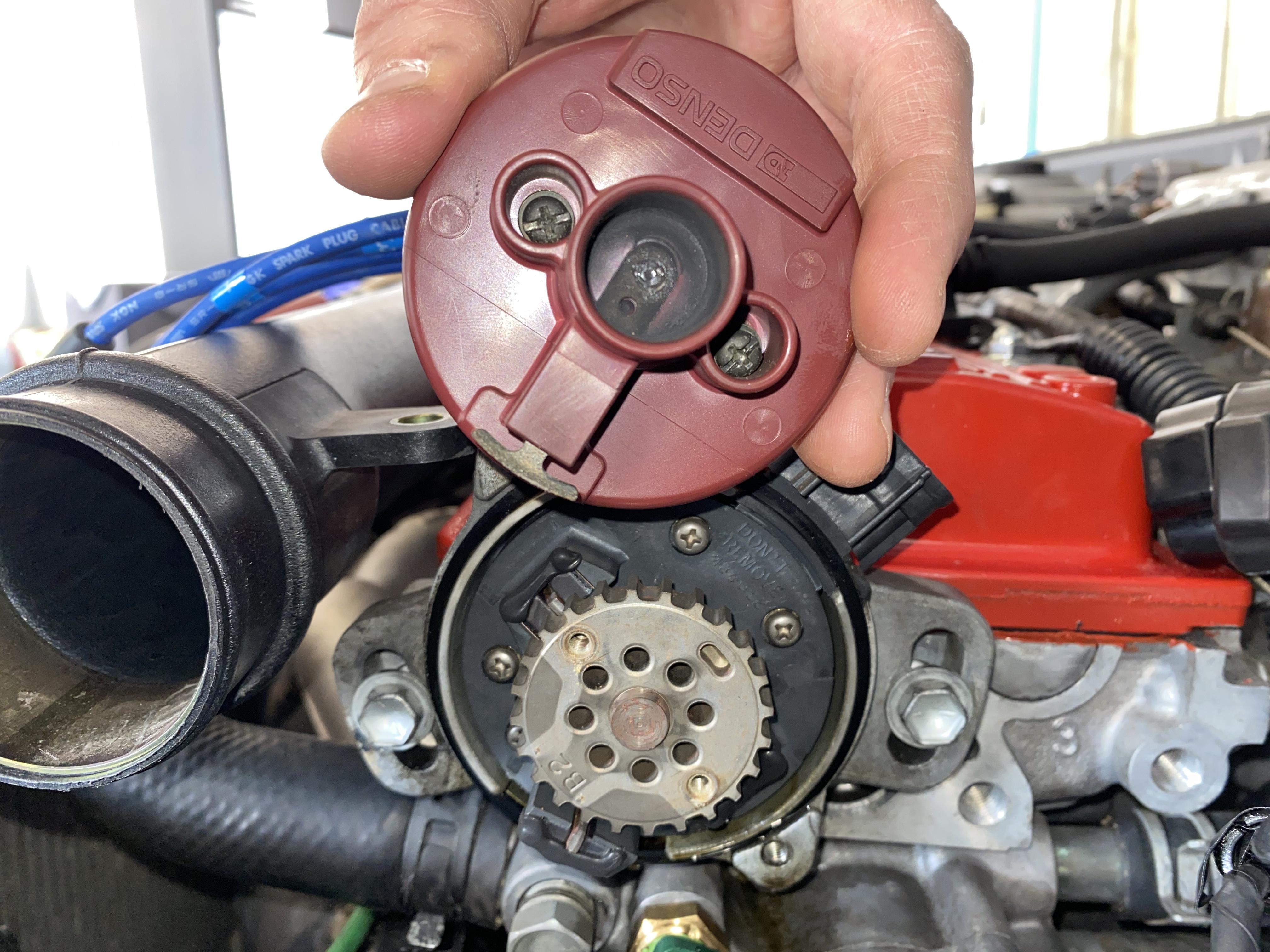

Claymore Posted March 19, 2022 Posted March 19, 2022 1 hour ago, Frankieflowers said: Hey guys. I received the new distributor cap, rotor, NGK wires and dust cat seal from Japan. I already change the small gasket on the cam when we opened the engine. Although there is still a small leak in the distributor cap. I read around that it might be the bearing or the bearing ceiling gasket. It could be leaking around the shaft. we did take care of putting ceiling paste in the proper position to avoid it but it still leaks. This is why I also bought a new bearing. I haven’t found information about a distributor regeneration on this model. Do you guys have experience of putting one apart and replacing these parts for regeneration? I also received the new TPS. I would like a piece of advice to change it. I understand the procedure about the position and electric check that has been done and I would like to know if the throttle has to be unbolted to do the job. if I am correct, the four pin TPS reads from 0 to 100 with its fader. There is no switch. The three pin TPS works differently but that is not my case. I'm sure the 4 pin tps does have an idle contact (see diagram a few post up) then it is a variable resistance sensor when it's off idle. It needs to be set up with feeler gauges. Ask Jay if he will look in the official Toyota manual for the 4efte auto procedure. The access to the TPS screws is limited (might be easier in the corolla). You can try to loosen them as it is on the car. From my experience the screws will have corroded into the throttle body and you will have difficulty turning them. Try it and see mate, but don't round them off. Quote

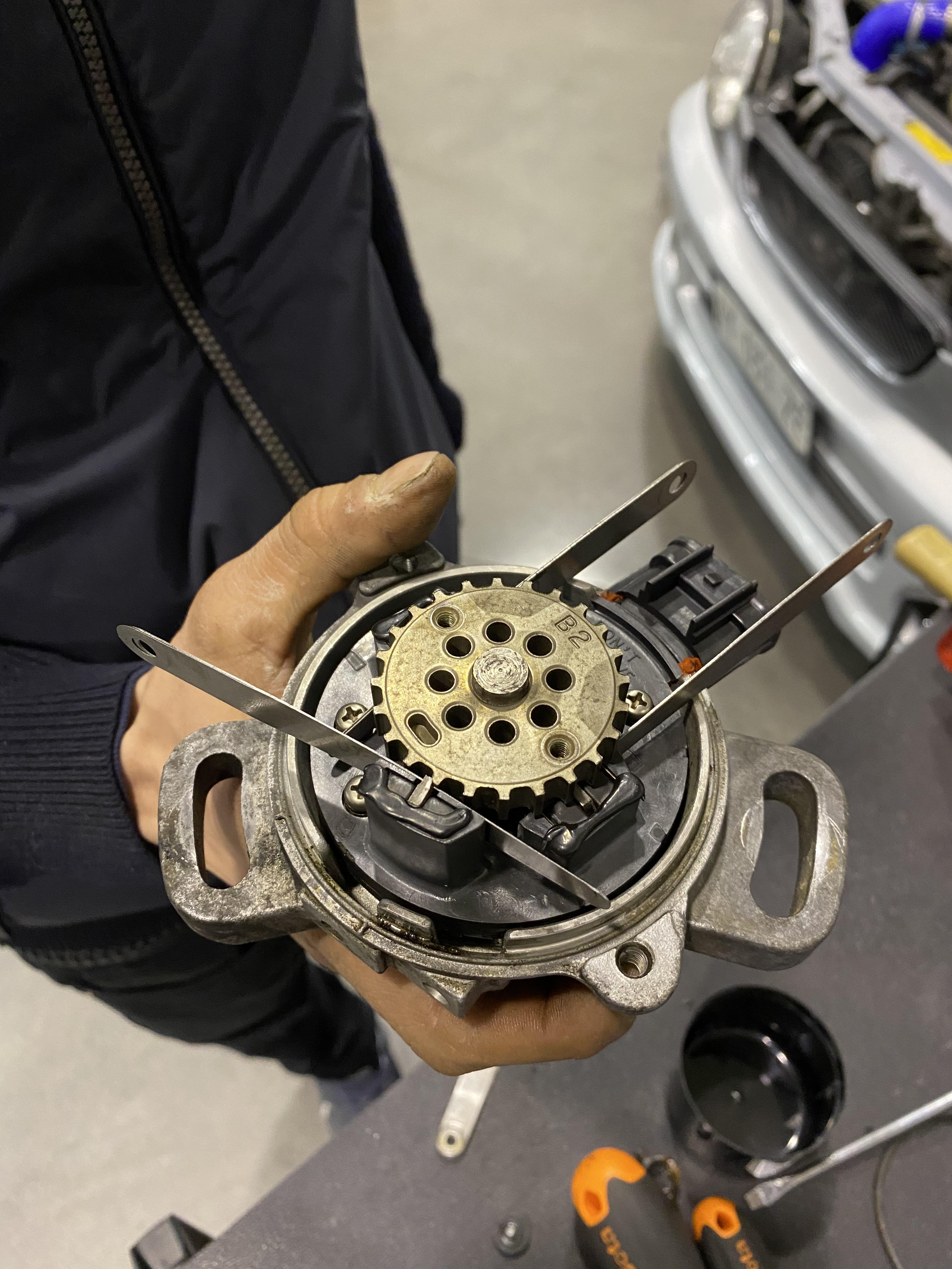

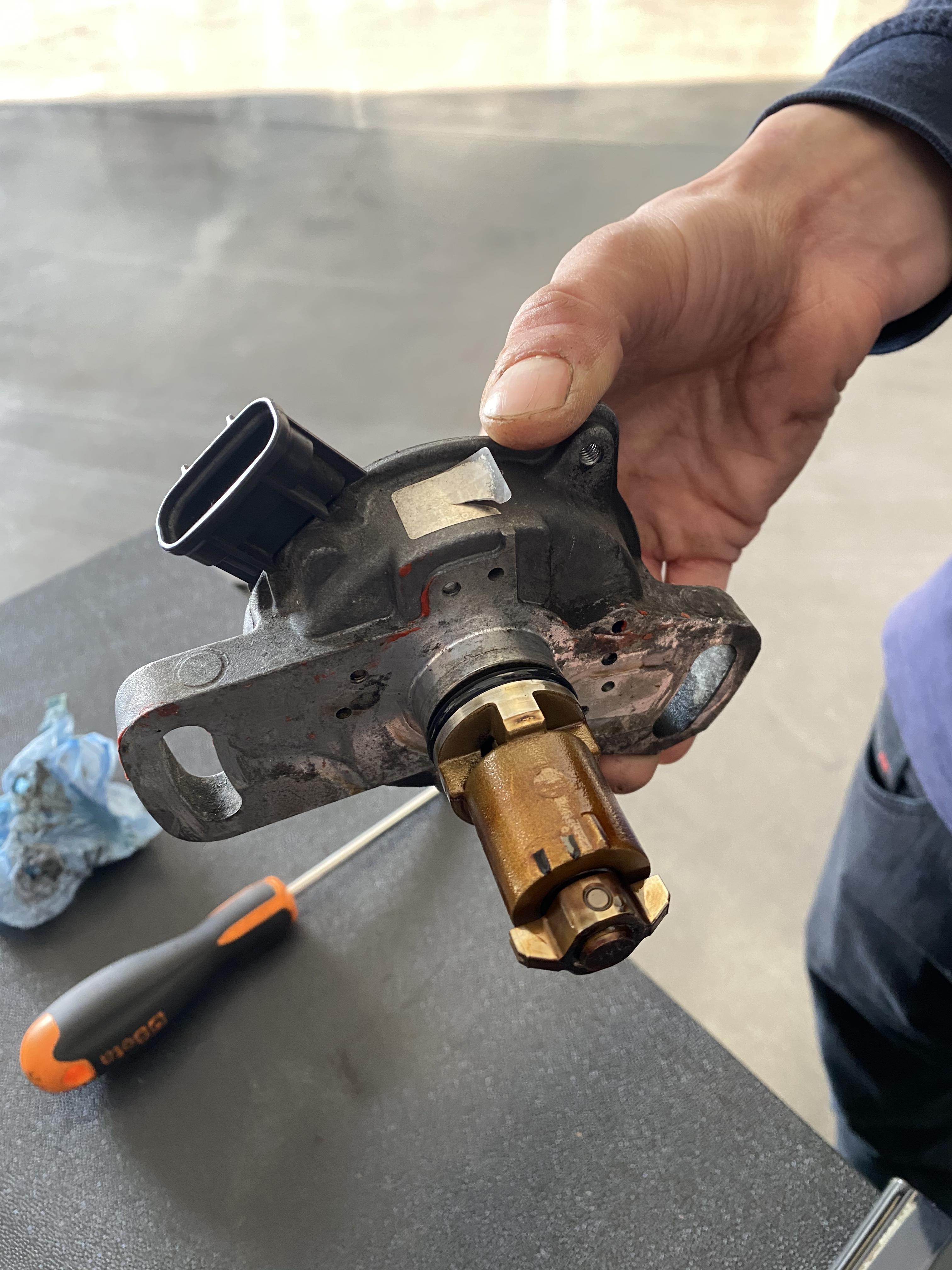

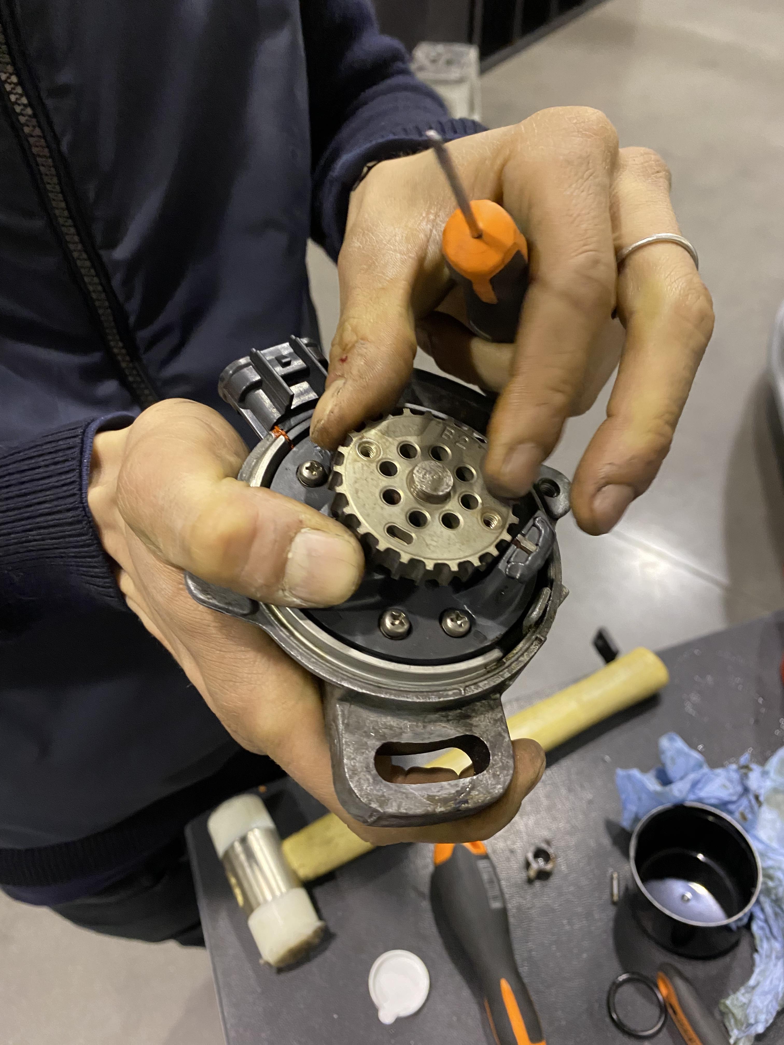

Frankieflowers Posted March 20, 2022 Posted March 20, 2022 Today we pulled out the distributor and we opened it to replace the bearing. Unfortunately I did not find any replacement kit on the Internet (besides the 2 gaskets, rotor and cap) and it is impossible to find the internal Teflon oil gasket. I figured it out opening it. The Toyota manual doesn’t show what is inside the mechanism. Your video was helpful but the Starlet distributor is different. The magnets moved so thanks to the manual I’ve managed to distance the magnets and get get back in to nominal measures. I’m glad it worked out. . Quote

Frankieflowers Posted March 27, 2022 Posted March 27, 2022 (edited) i opened the distributor to stop the oil leak and discovered the teflon seal inside. It needs to be replaced but there is no information about it and no OEM on the parts website. Why? I changed both gaskets but obviously the oil gets through the dented arm all the way in the rotor box. Please help. Edited March 27, 2022 by Frankieflowers Quote
Claymore Posted March 28, 2022 Posted March 28, 2022 10 hours ago, Frankieflowers said: i opened the distributor to stop the oil leak and discovered the teflon seal inside. It needs to be replaced but there is no information about it and no OEM on the parts website. Why? I changed both gaskets but obviously the oil gets through the dented arm all the way in the rotor box. Please help. Do you have photographs of the teflon seal? Any measurements? You might be able to find a similar seal or have a custom one made. Quote
Frankieflowers Posted March 28, 2022 Posted March 28, 2022 5 hours ago, Claymore said: Do you have photographs of the teflon seal? Any measurements? You might be able to find a similar seal or have a custom one made. I was so upset that I didn’t take pictures and measures. My partner was helping me out so we put it back together. Let’s say we were hoping it would stop leaking for a bit... I will wait that some of you guys will open a distributor and measure it for me because taking it apart means moving the magnets and needing to reposition them properly. Not a 20 minute job. Quote
