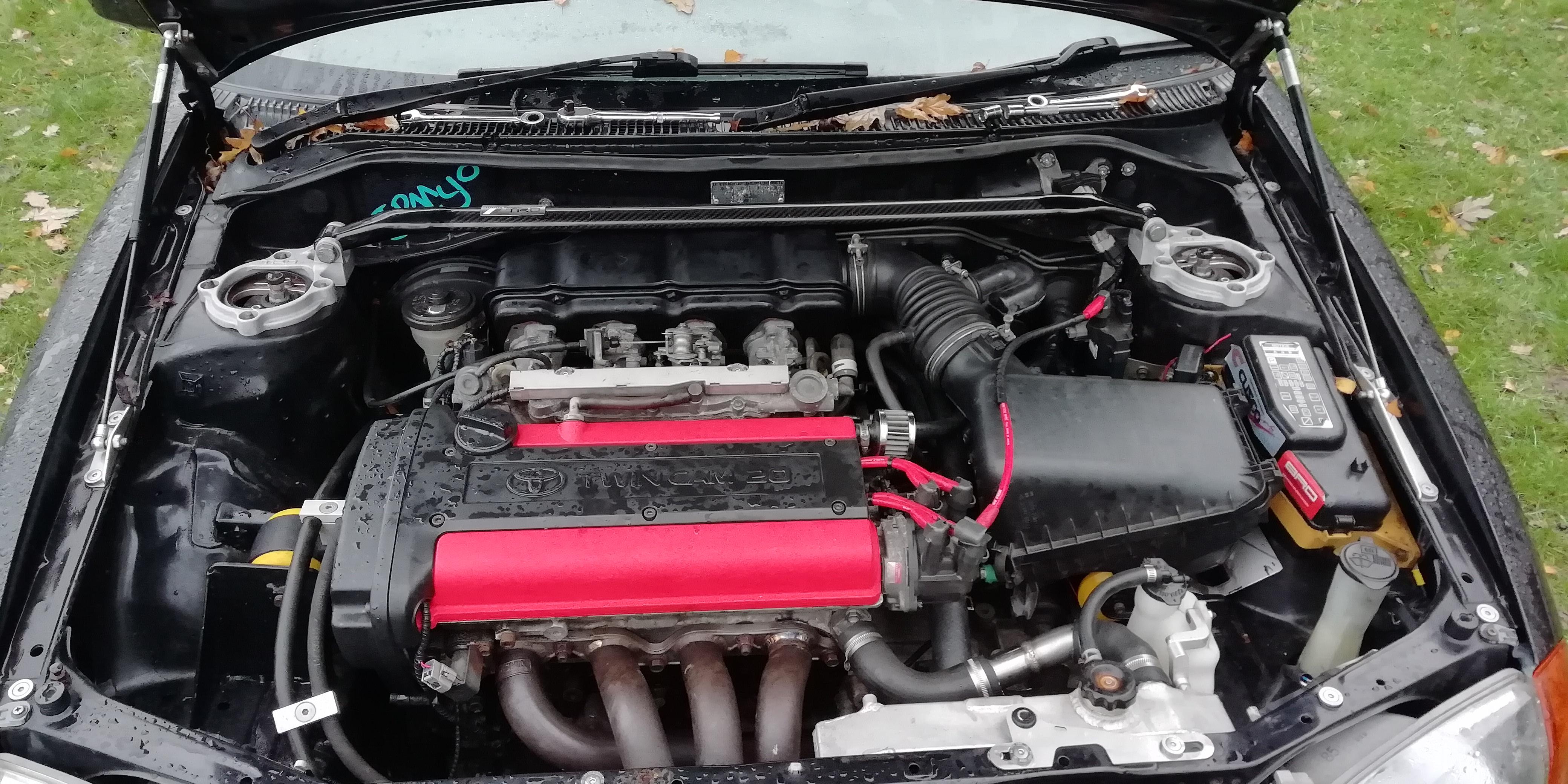

Well been faffing around testing things to try and get to the bottom of my over fueling issue, still none the wiser. So I decided to book it in for a Dyno run to find out when exactly it's over fuelling to try and narrow things down a bit.
In the mean time I fitted the OEM intake plenum and airbox to make it quieter, I used to 30mm imec trumpets inside the thing so these will still make the power a bit peaky but I think overall it should have shifted down a bit. But It definitely is missing some urgency which I'm assuming is down to the fuelling, compared to my daily corolla with a 20v its no where near as responsive
It's a bit of a squeeze and I need to modify the top of the plenum to give clearance to the strut brace but it's all in. Actually quite like the sound of it, it's got a good grunt to it

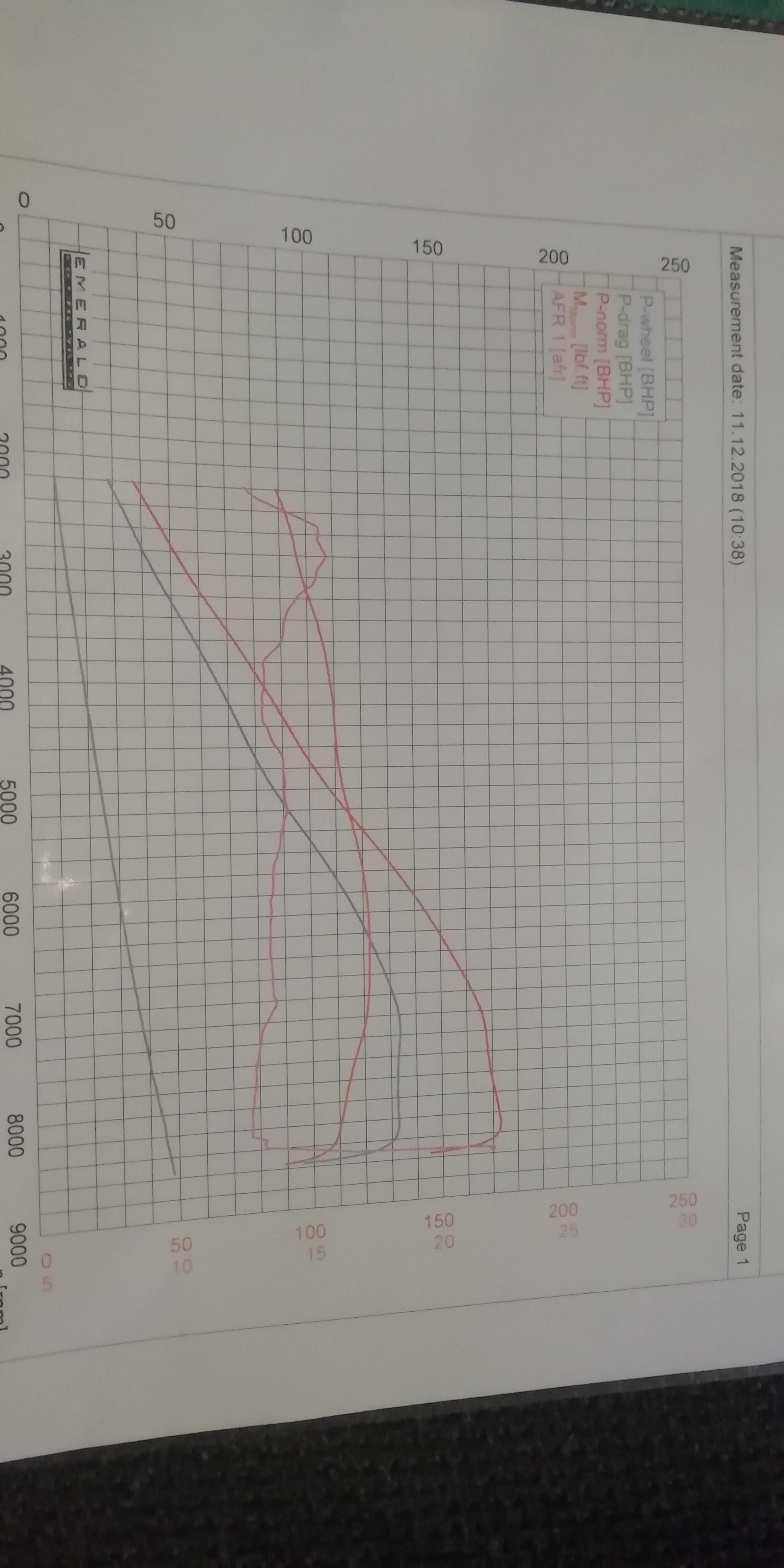

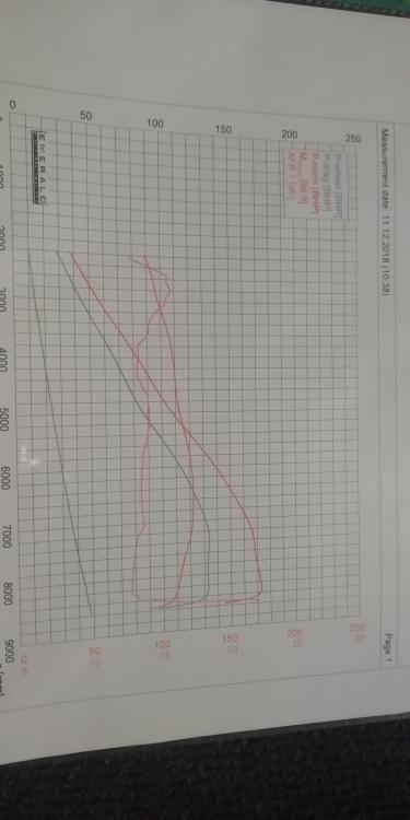

Riiiight, so had it on the dyno, did some load testing and power runs to test fuelling under a range of conditions.

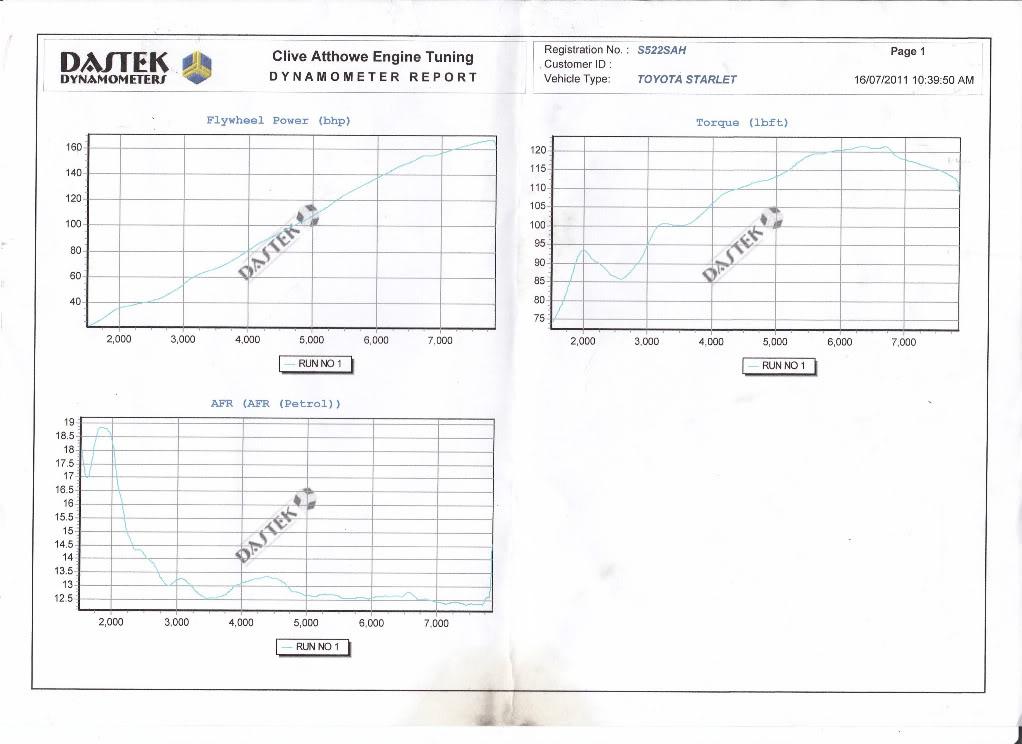

Good news is its not that bad, its rich on idle, around 13.5 - 13.9. Cruising was ok at 14.7-15.1, jumping around a bit but otherwise where it should be. And under WOT its pretty much where it should be and i had a look back over an old dyno from 2011 when it had a similar setup and the AFR graph was almost identical so i guess i got panicked over nothing other than maybe a faulty o2 sensor.
As for power, its a different dyno to previous runs but the figures were about on par.
Again huge driveline losses but identical to previous runs elsewhere so not sure whats causing that but results were
178fly @ 8400
132wheel 46hp loss... :sad:
122lbft @ 6200
New run fuelling is the ditty one in pink lol
old run from 2011 fuelling at bottom
As you can see, they are almost identical leaning out and richening up in the same places.

Looking at your dyno runs you are quite a bit leaner on your latest run. You are running 13.5:1 average on WOT, it only really tapers down to 13.0:1 over 7000rpm for 1k, whereas before it was 12.5:1.
Ive never mapped a 4AGE so I don’t know what they like, but rule of thumb as a starting point on a n/a is 13.0, Honda’s like it a bit richer at 12.5:1 like you were before so that may be another reason why it doesn’t feel quite as spritly too.

Now you mention it it is a tad leaner, maybe thats down to it having some drop in poncams now. Itsmaking more power and torque than previous and the tester did seem happy enough with it so ill carry on using it for now. I took it out for a drive afterwards and it did feel quicker so im wondering if it was just a bit choked up for being sitting around and only warmed from time to time?
The other issue is I dont have any means of adjusting fuelling currently so unless i stick an aftermarket fpr i cant see me being able to make any changes.
