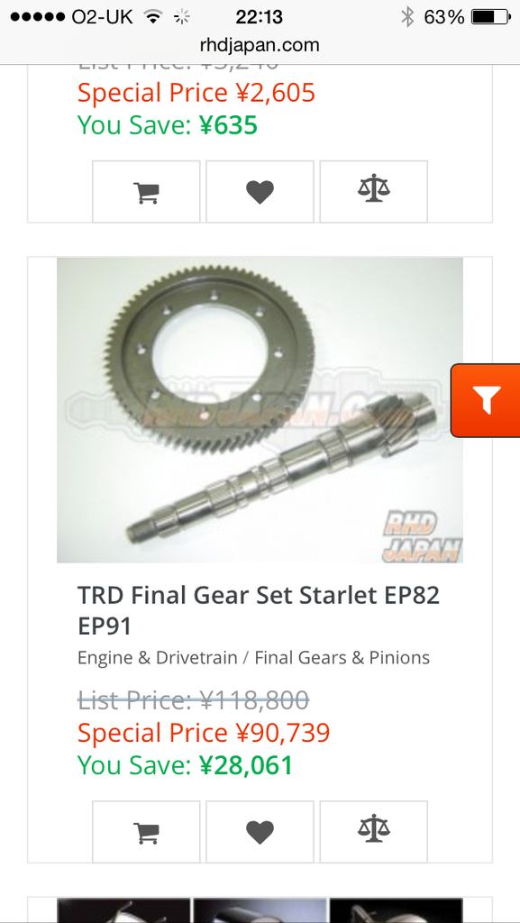

Whitenoize Posted April 21, 2015 Posted April 21, 2015 im going to go for a cusco next time has anyone ran a trd gear set like this trd one ? Quote

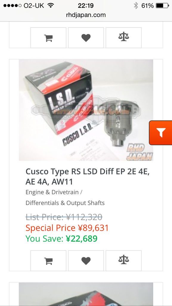

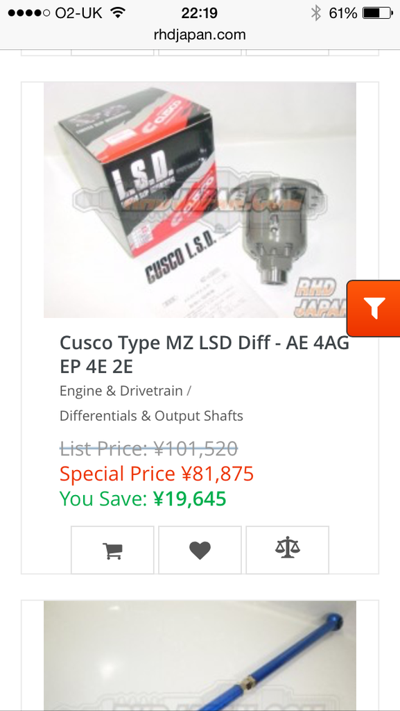

Whitenoize Posted April 21, 2015 Posted April 21, 2015 (edited) What Cusco lsd is best for starlets ? This one Or this one Edited April 21, 2015 by Whitenoize Quote
_shaun_ Posted April 21, 2015 Posted April 21, 2015 mines a noisy car in general big rattle clutch side exit blah blah. TD ran that gear set on there demo gt am sure not sure who bought the gearbox after them tho Quote

RobSR Posted April 21, 2015 Posted April 21, 2015 Also what you've posted up there isn't a gear set, its just a final drive, which as far as I'm aware with the TRD one shortens all the gears and lowers the top speed. depends what you want really. Quote
Whitenoize Posted April 21, 2015 Posted April 21, 2015 Mirror what Adam has said and for the same reasons i don't like helical diffs. Drove plenty of Quaifes and they just aren't as instant to lock up like a proper clutch type diff too.They don't clonk if you run them in properly and run the correct oil too. Always frustrates me when people say they do! They won't of ran them in or use the correct oil. that's y am going to give the Cusco another try next time after we talked about them on another thread I'm sure whoever I got my old box from with the Cusco in hadn't been ran in properly it was extremely noisy Quote
