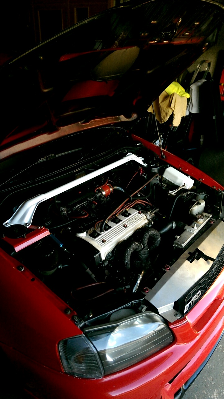

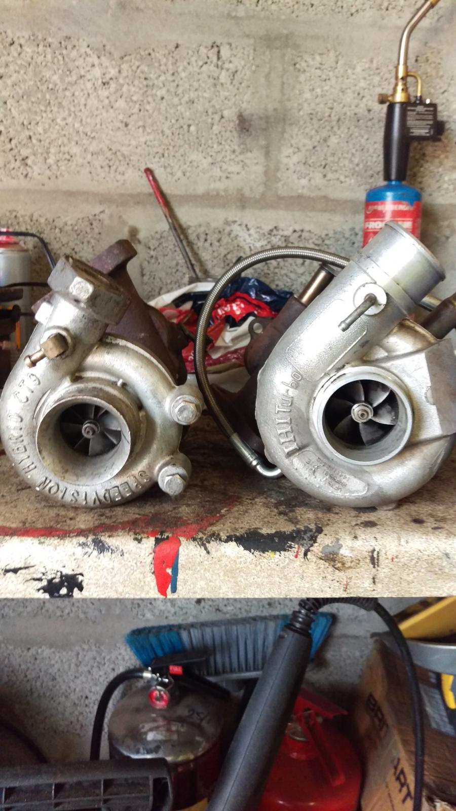

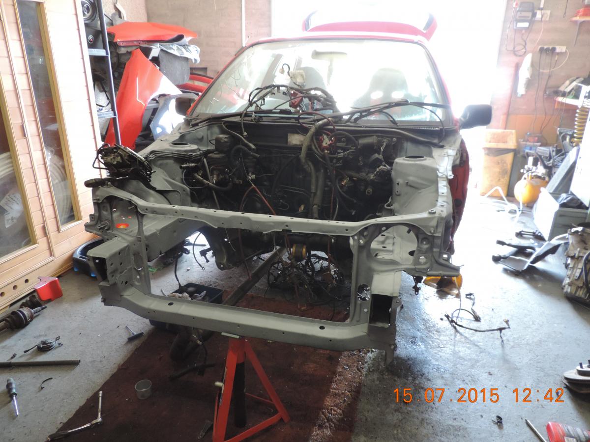

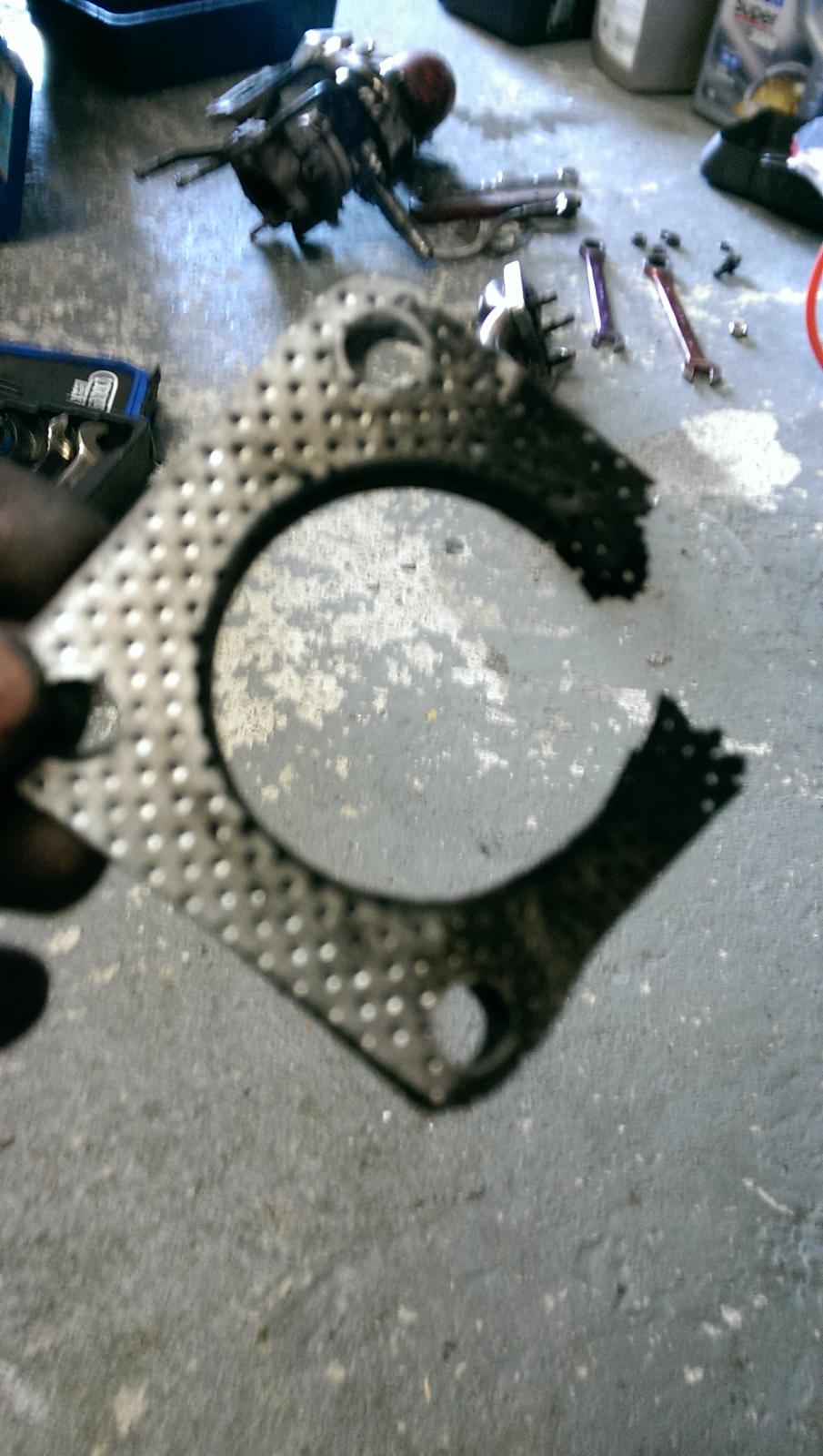

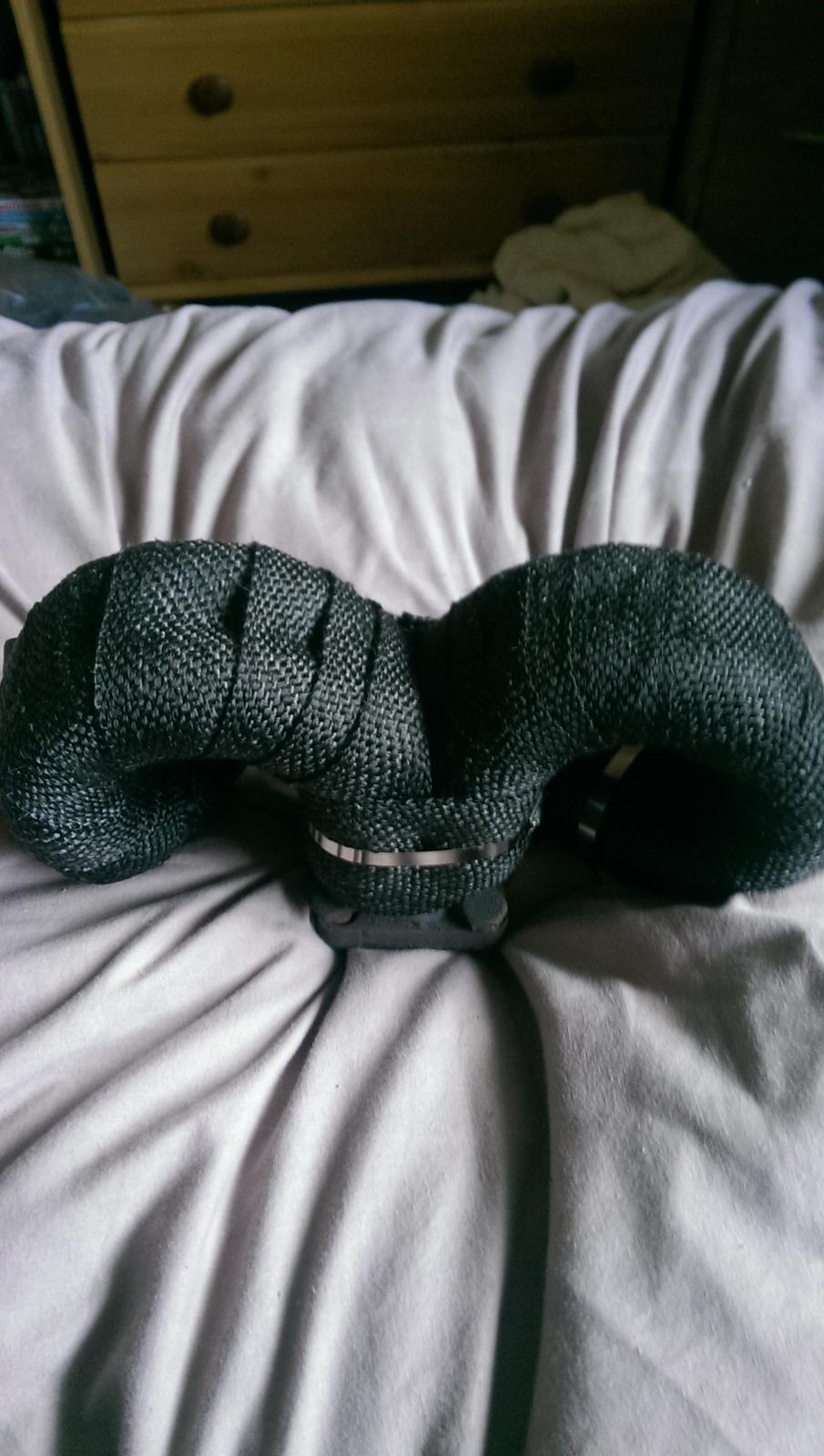

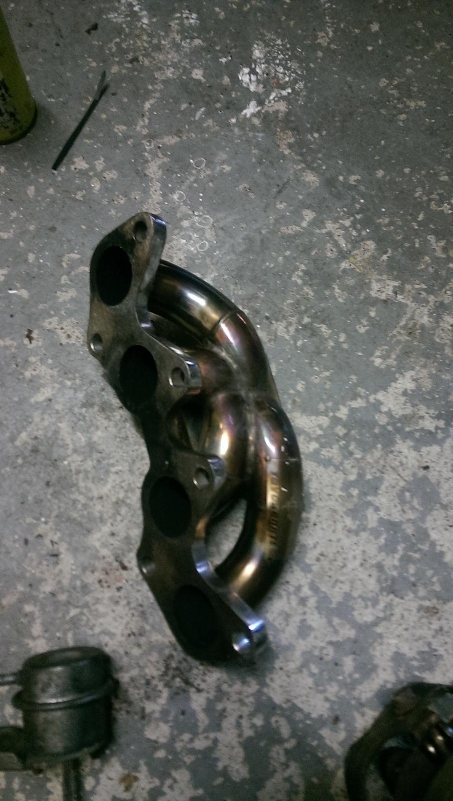

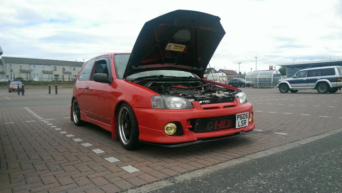

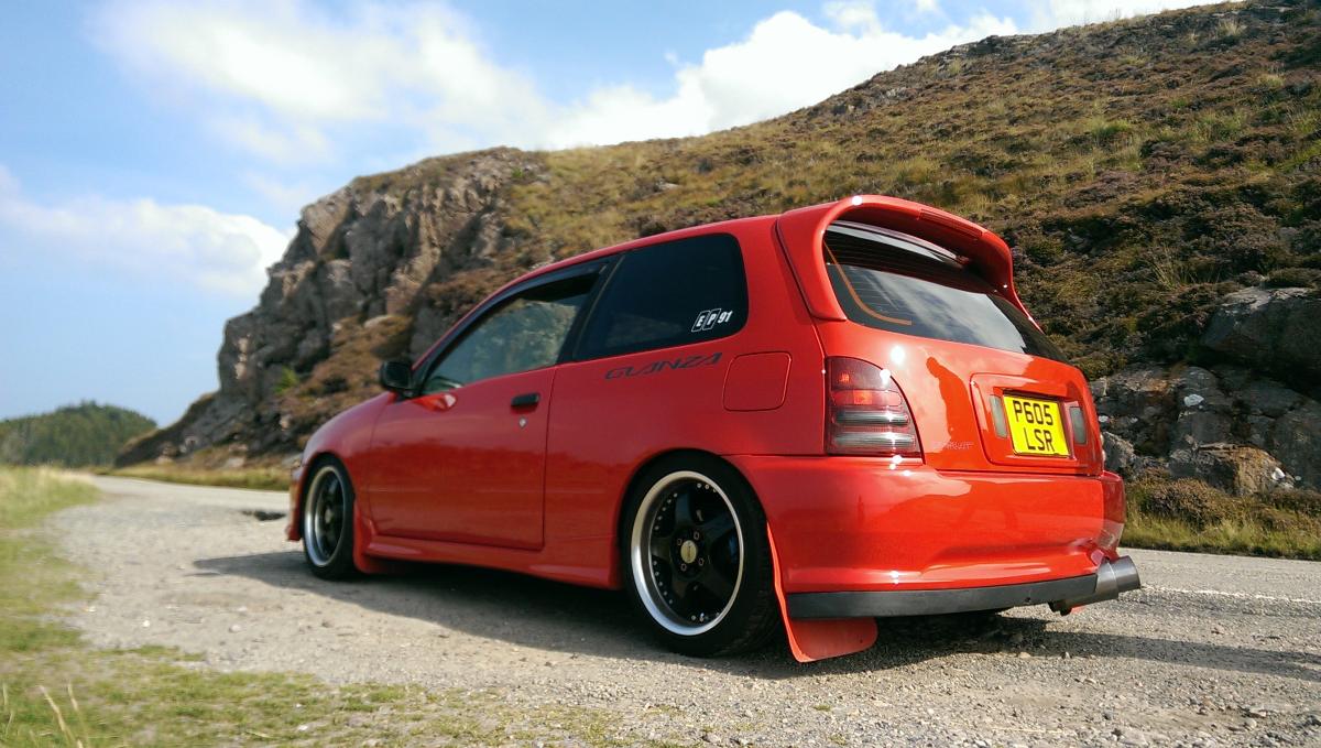

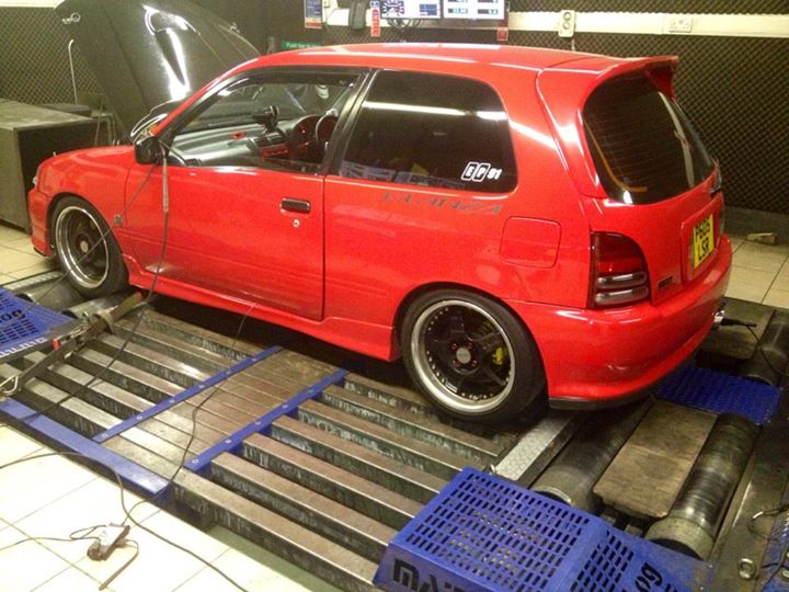

Craigtrials95 Posted July 15, 2015 Share Posted July 15, 2015 (edited) Well thought i better start a build thread since some big plans have come along for my glanza v. I bought her just over a year ago and well a bit of work was needed, however it was a clean shell, here she is. Went a wee blast with a mate and grabbed a few photos So the car was in need of a new turbo so i treated her to a speedvision phase 2 ct9 hybrid, with a clean up along the way, and i stupidly bought a shity toyosports manifold along with cheap gaskets and well i learnt the hard way after cracking the mani in a week, So I invested in a zisco ramhorn manifold and heatwrapped it, Heres the finally result after a slight tidy up and new turbo and mani,Delighted with the result. So the following weekend i decided to make use of the rare sunshine in Scotland and head out west for a blast, was excellent fun out on the back roads of Scotland in this thing with a mate heres a few snaps, I came across a photo from her on the dyno getting a reasonable 208bhp at 1.3 bar on the hybrid ct9 The car was running perfect up until January 2015, when i got a knock sensor fault so replaced that with a new one from td all was fine until i drove about 100m to the end of my street and it conked out, started again and sparked out the interior fuse box and conked out once again and she hasn't run since. I tried numerous things including a new ecu and engine bay wiring loom but nothing worked. So I decided i wanted to strip the glanza apart clean everything up and buy lots of new goodies whilst tidying everything up, so i bought a fiesta st as a daily for now. Started by taking off all the calipers, wishbones, suspension and a few things out of the engine bay to get the engine out easier.It ended up like this, So i de-greased all the wing area in the bay and started sanding it down ready for a coat of primer, used gunk to de-grease and i would recommend 100%Just redoing it in gloss black to make it look a bit cleaner when its all back together.Ive seen some people re-locate the braking unit in the engine bay, but where do they put it? cheers Edited July 20, 2015 by Craigtrials95 Quote Link to post Share on other sites
GlanzaJ Posted July 15, 2015 Share Posted July 15, 2015 Looks good mate , have got a soft spot for a red glanza ! is it forged or standard internals , didn't think 1.3 bar was a good idea on stock pistons and rods ? Quote Link to post Share on other sites
Craigtrials95 Posted July 16, 2015 Author Share Posted July 16, 2015 was the previous owner that had it mapped at 1.3 bar on high boost and im pretty sure it went bang on the dyno first time round then mapped again at 1.3 all fine but i never ran it at 1.3 always boosted at 0.7 bar. still standard internals but hopefully be changing that over winter or next year. Still need to keep updating this still not up to date yet, cheers mate Quote Link to post Share on other sites

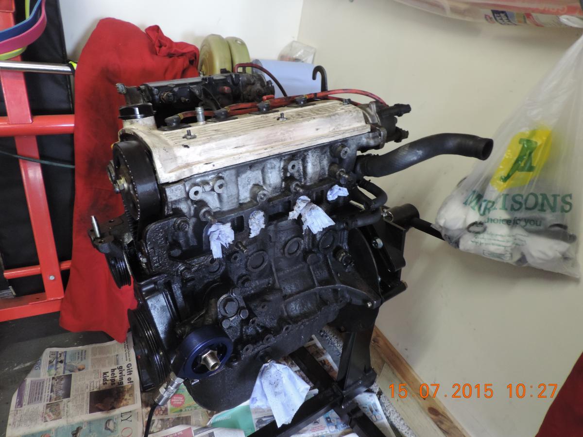

Craigtrials95 Posted July 20, 2015 Author Share Posted July 20, 2015 Got an engine dress up kit from JDM-Ep for when it all goes back together. hopeful get the engine done gloss black this week! Quote Link to post Share on other sites

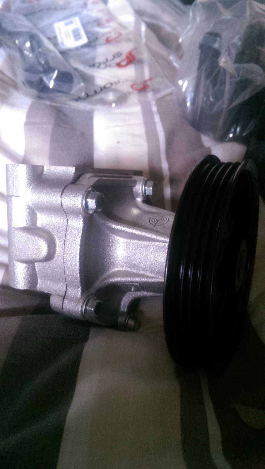

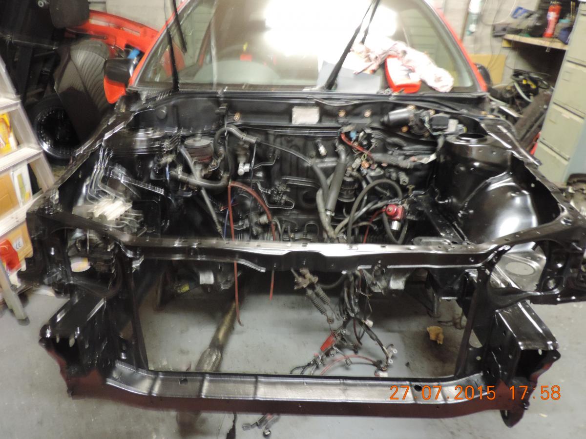

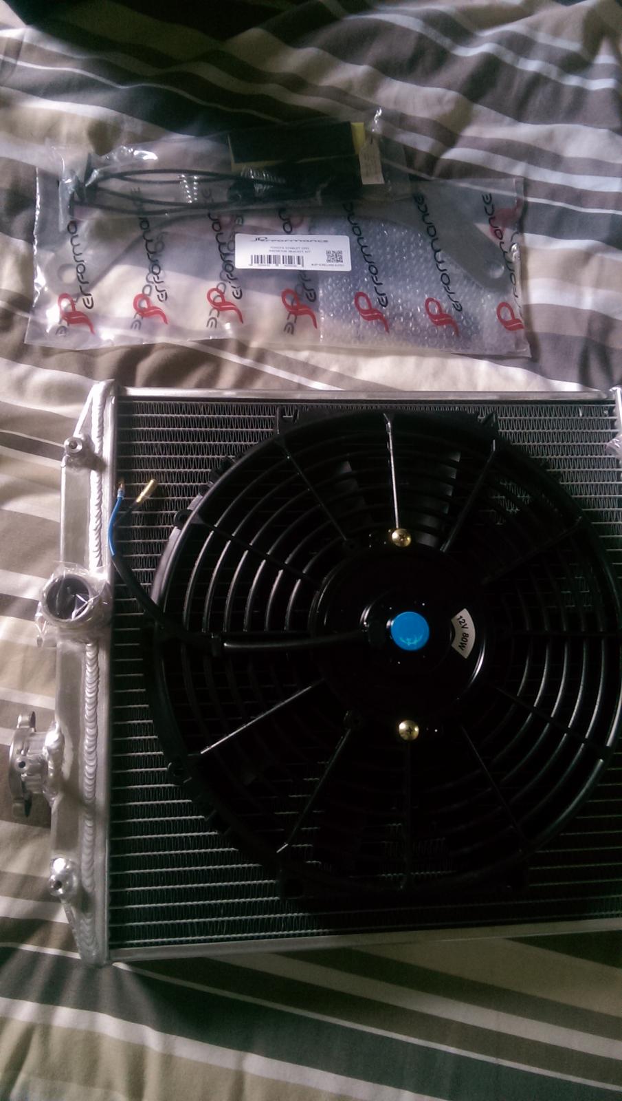

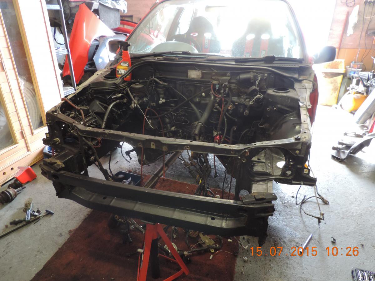

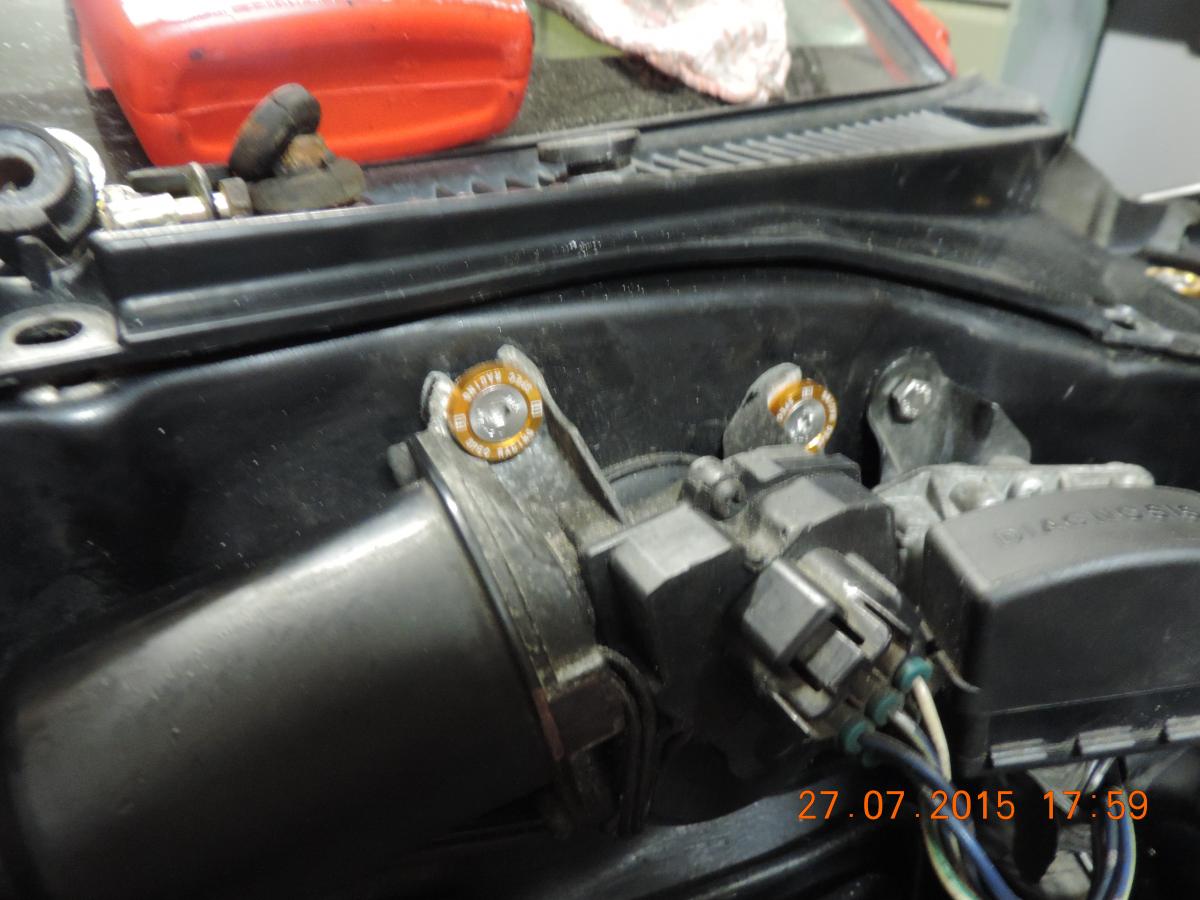

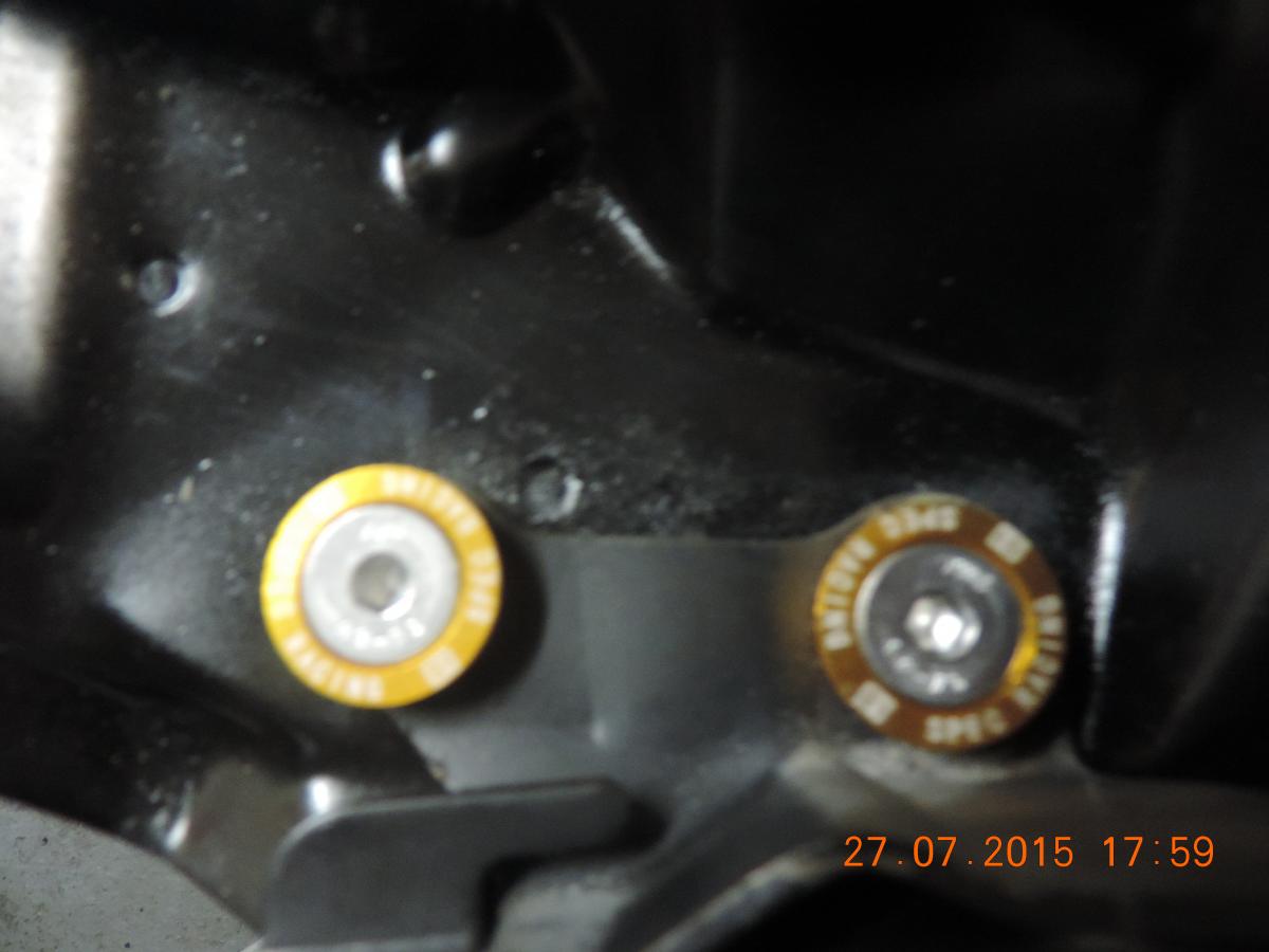

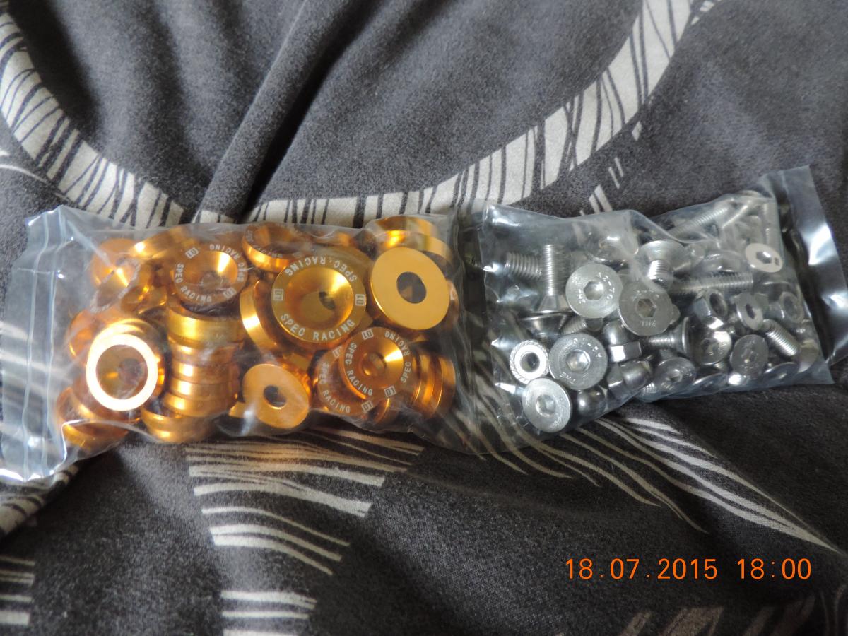

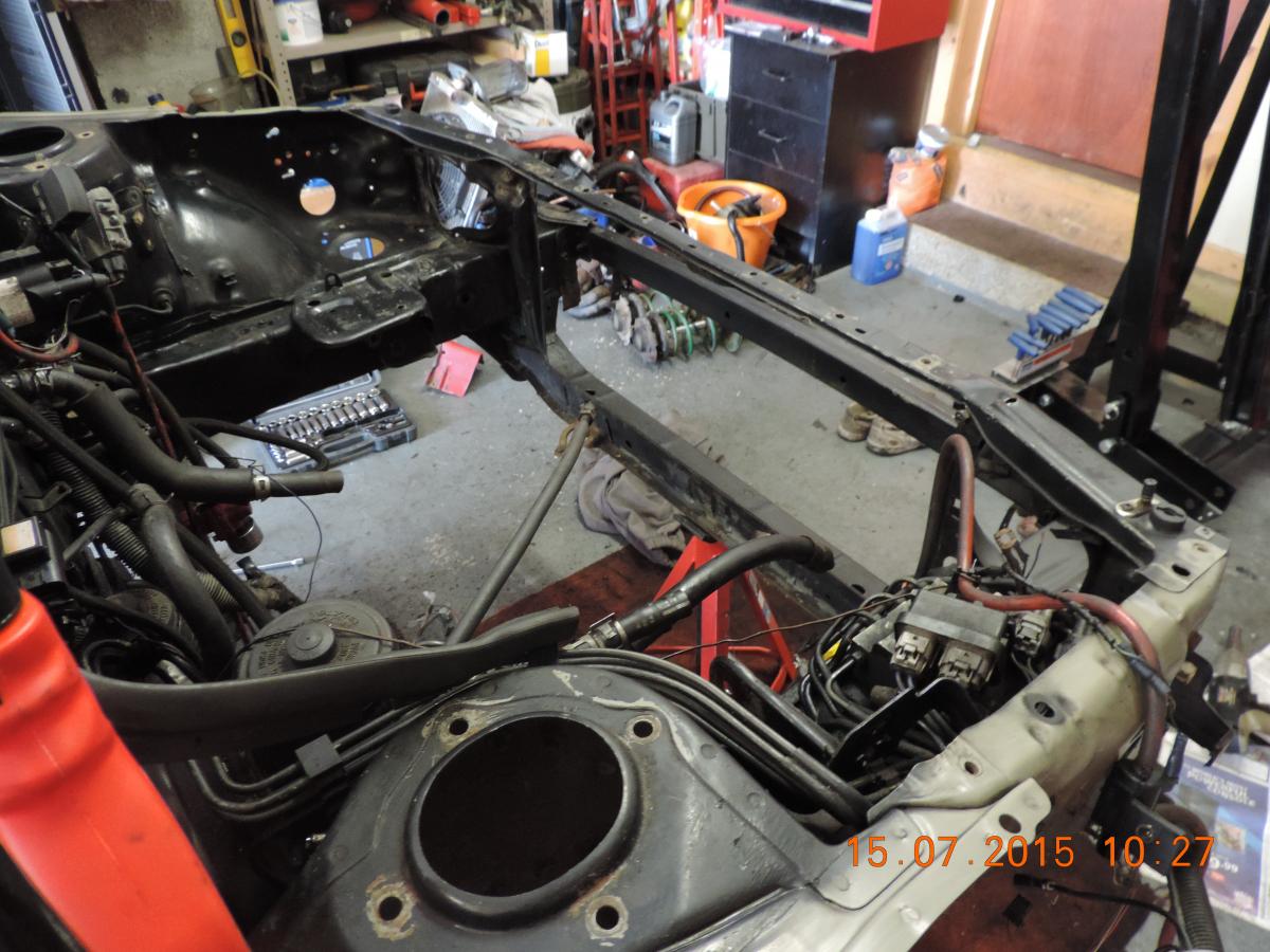

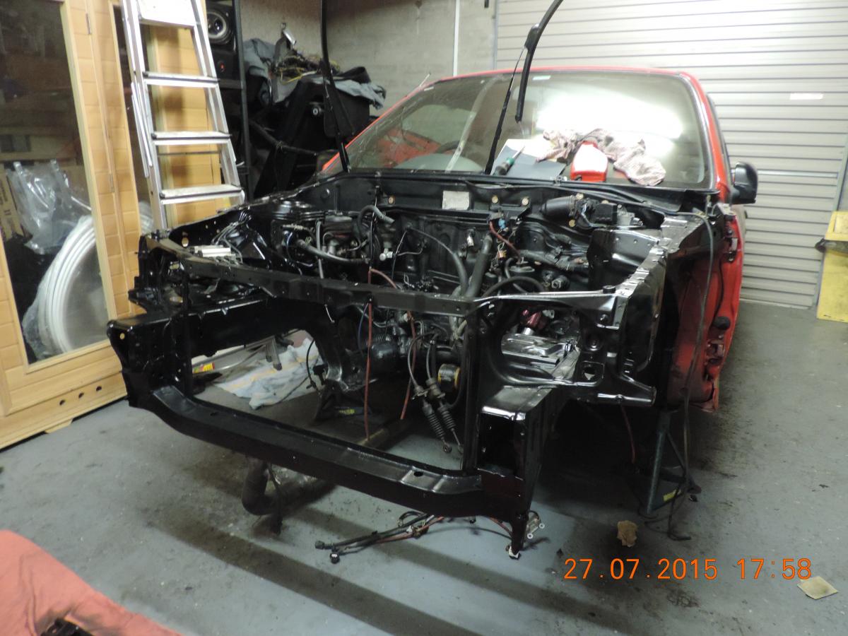

Craigtrials95 Posted July 27, 2015 Author Share Posted July 27, 2015 Got the engine bay painted up, its not a professional job but im not going for a show car. Also started fitting a gold dress up kit from jdm-ep Got some new ball joints and track rod ends along with a timing belt kit from ID-Workz. Also just ordered a new radiator with mounting brackets, water pump, 8.5 ignition leads in red, genuine dizzy and rotor from Mike at TD that should arrive this week Waiting on a prototype of a cam pulley from TD too, hopefully get one in gold. Also im looking for a clear timing belt cover so let me know if you're selling one! Quote Link to post Share on other sites

Craigtrials95 Posted August 6, 2015 Author Share Posted August 6, 2015 Managed to get a hold of a clear timing case from JD Tuning along with some bonnet struts. just waiting on a cam pulley from tuning developments and its all ready to go on and get the engine back in the car also gave the wiring loom a tidy by redoing it in a nice felt tape, delighted with the result! Quote Link to post Share on other sites

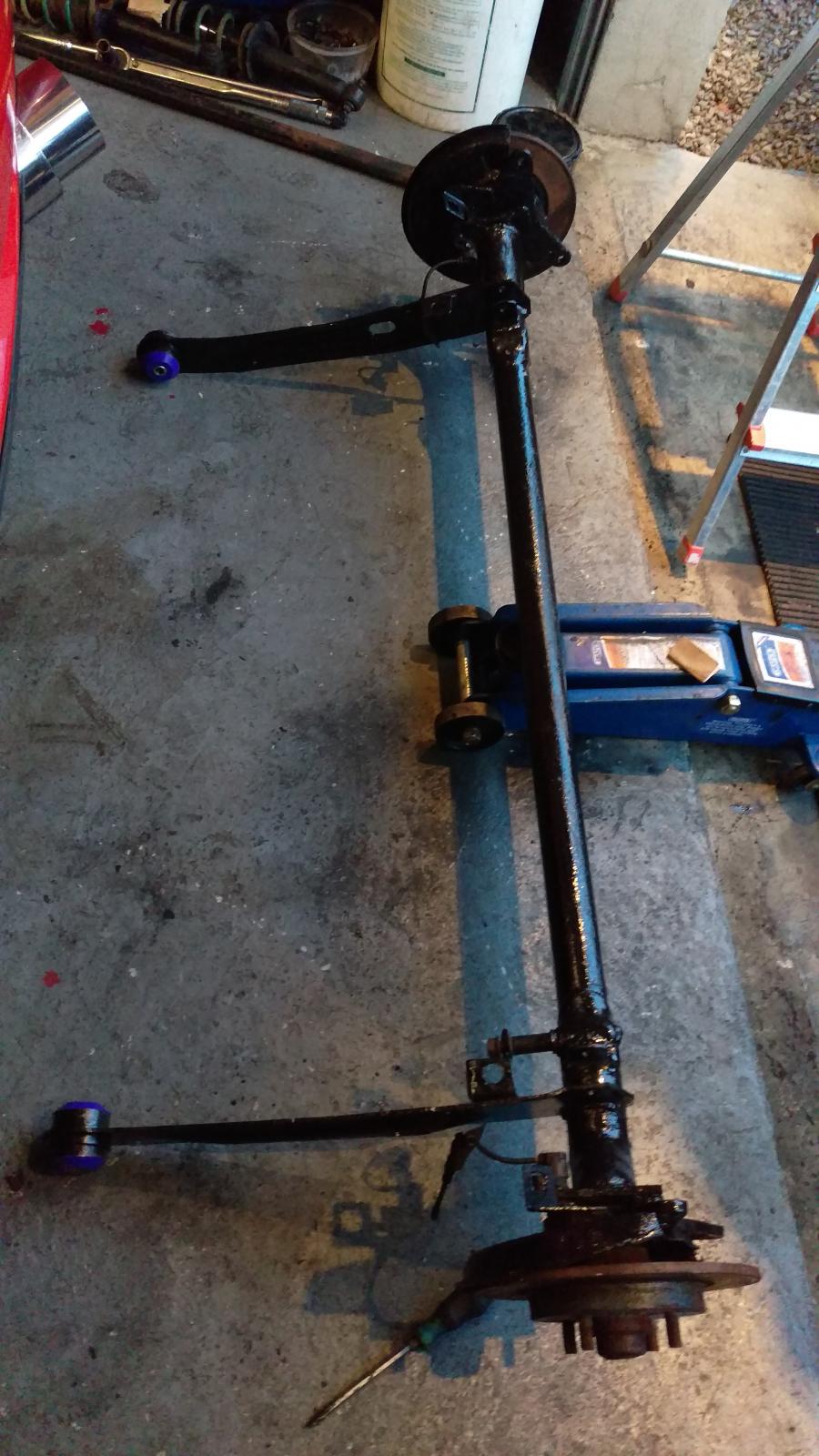

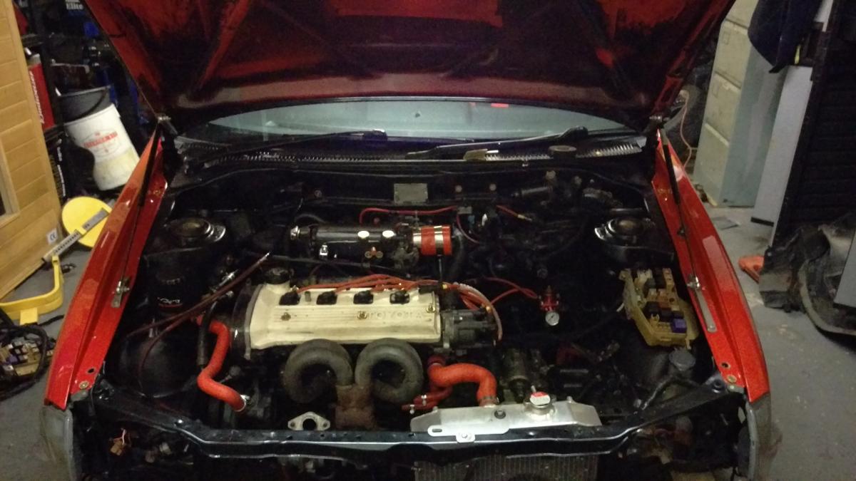

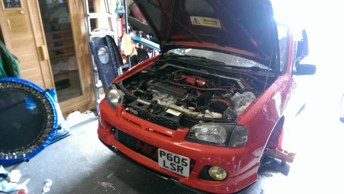

Craigtrials95 Posted February 2, 2016 Author Share Posted February 2, 2016 (edited) Its been a long time coming for an update, cant remember exactly what ive done since but heres a rough update. Removed and stripped the rear axle for paint and fitted new poly bushes, rear brakes are currently being rebuild Rear calipers are an absolute pain to rebuild haha. - Engine is back in the car sitting nicely on JD tuning poly bush engine mounts- All timed up with an adjustable cam gear and clear timing case- New 8.5 red ht leads, spark plugs, new dizzy and rotor - Fitted an abs removal kit as big brakes are definitely on the list- Got myself a full red silicone hose kit that will be fitted- Braided clutch line fitted- Monster triple core half rad with slimline fan- New water pump- All the wiring has be re wrapped and tidied up- Began fitting a gold dress up kit- New power steering and alternator belt How the engine bay is looking just now with jd bonnet lifters fitted too Now for the good stuff, Got myself a mint VF035 turbo So going to need a few upgrades to run that turbo, Sorced a 5e block of a friend thats already been machined, bored out to 74.5mm got some forged pistons and 5e rods. got lots of 5e goodies to go along with this build. hoping to build the engine over the next year ready to be running good power by summer 2017 pictures too follow Edited February 2, 2016 by Craigtrials95 Quote Link to post Share on other sites
