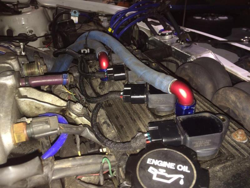

turbo-fever Posted July 24, 2015 Posted July 24, 2015 (edited) People might remember might first starlet about 8 years ago:Had this for over 3 years before it died and I have basically been 1.8 20v since until I sold up and came back to the ep82 seen and impulse bought this :I bought this from a person that I found out after is known to sell dodgy starlets "brilliant news" not ! So I had it all checked over and turns out it has a 5efte fully forged engine This is the spec to date:Mk2 gt5efte fully forged engineTd05 16g turbo billet wheel uprated journal bearingRc 550 injectorsFprZisco manifoldCustom downpipeJ d tuning engine mountsExternal wategate ECUMASTER standalone ecu mapped to 1 bar making about 280 Unknown LSD Greddy boost gauge Recaro interior Buddy club p1 plus 2 on Toyo proxesStraight through exhaust Hdi front mounted intercoolerCusco bolt in rollcage dash dodger and rear seat friendlyBc racing coiloversHks dumpvalveCelica gt4 brakes up frontK20 coil on plug conversion Nissan gtr throttle position sensorCompression check 180 psi across all 4 cylinders Rolling anti lag fitted Launch controlSo plans are to tidy up and then introduce more boost ! Edited November 14, 2016 by turbo-fever Quote

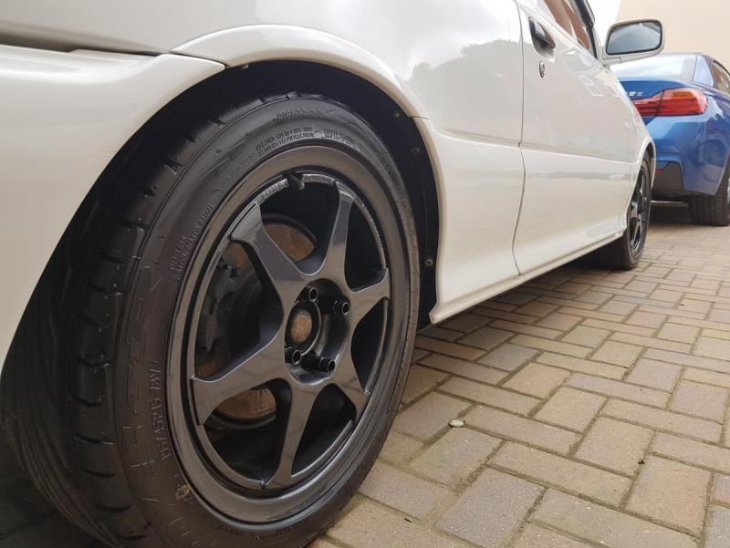

turbo-fever Posted July 27, 2015 Author Posted July 27, 2015 Well little update apart from having to do a compression check this week , I thought I might as well lower starlet on the bc coilovers that got delivered Sunday Gonna let it settle a little but really wanna go lower also got a Leon cupra r splitter to go on to should help the front look a little lower. Quote

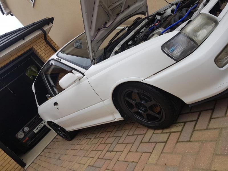

turbo-fever Posted September 25, 2015 Author Posted September 25, 2015 A little update cage is in and brakes are on ! Also gonna make a removable silencer so the exhaust will be straight through all the way Rollcage took a lot of modification to get in ! Brakes looking pretty big under 15" wheel Quote
turbo-fever Posted September 25, 2015 Author Posted September 25, 2015 Non sunroof rollcages are not an easy mod into a sunroof car lol Quote
