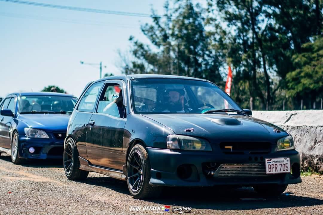

Gerard Posted September 29, 2015 Posted September 29, 2015 hi im gerard from paraguay idont speak very well english.. sorry but this is my Glanza V 4efte 311whp forged with Injepro Ecu now i swap a 4agte forged in my garage Quote
ro55ifumi Posted September 30, 2015 Posted September 30, 2015 Stunning and welcome to UKSO John Quote
jimmymac101 Posted September 30, 2015 Posted September 30, 2015 Welcome along buddy, looks like you have put some hard work into that glanza James Quote

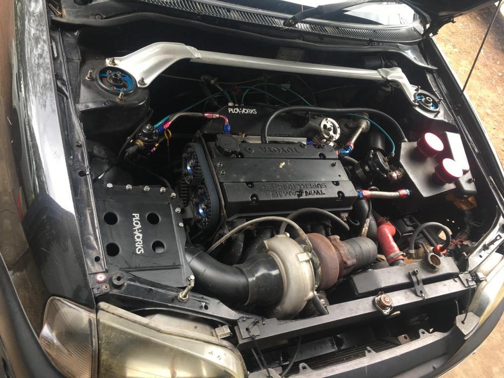

H_D Posted September 30, 2015 Posted September 30, 2015 welcome mate 4efte ???? funny cam cover indeed looks like he is in the process from swapping to a 4agte from his 4efte Quote
Gerard Posted September 30, 2015 Author Posted September 30, 2015 Thanks friends , I have worked very hard to finish the car, with the engine 4e Quote
ro55ifumi Posted September 30, 2015 Posted September 30, 2015 Please start a build thread on UKSO John Quote
5e colin Posted October 1, 2015 Posted October 1, 2015 id love to see how she is fitted and where its cut/welded keep up the good work :) Quote
Gerard Posted October 6, 2015 Author Posted October 6, 2015 (edited) thanks for the welcome.. the new motor haveCp pistonsBC rods for 800hpcometic gasketacl race bearingsarp main, head and flywheelJasma 272°camshaftgates racing timing belt bosch 1700cc injectors450lph fuelpump with Ethanol and few upgrades more Edited October 6, 2015 by Gerard Quote

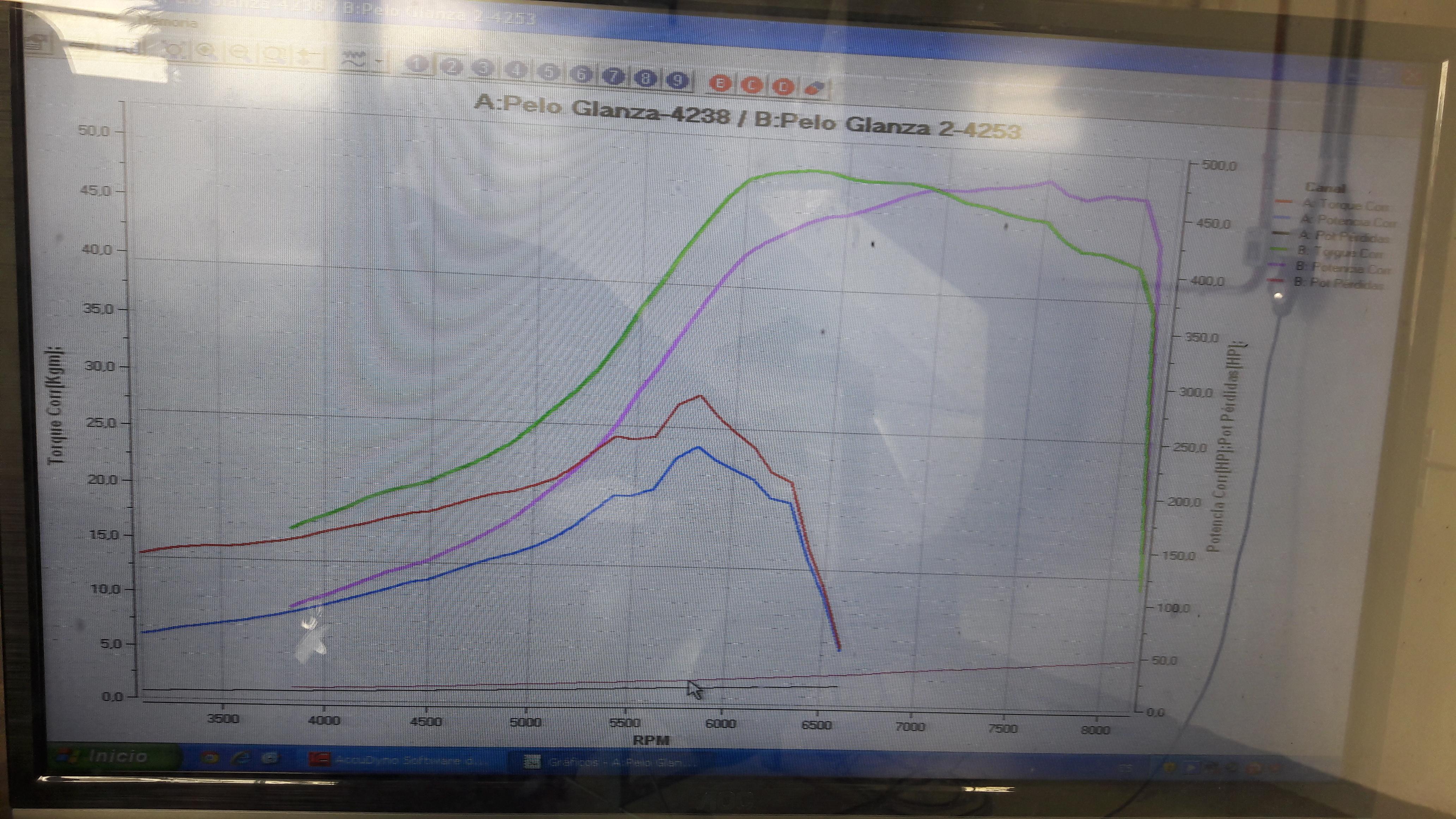

Gerard Posted May 12, 2019 Author Posted May 12, 2019 hi friends, a long time ago do not update about my project, at the moment the project is paused the car is now with 480hp and 50kg of torqur the turbine is a gt3582 with 2.4bar of boost a etanhol 100% Quote
snails ep91 Posted May 13, 2019 Posted May 13, 2019 now this is cool.. some videos would be awesome Quote
