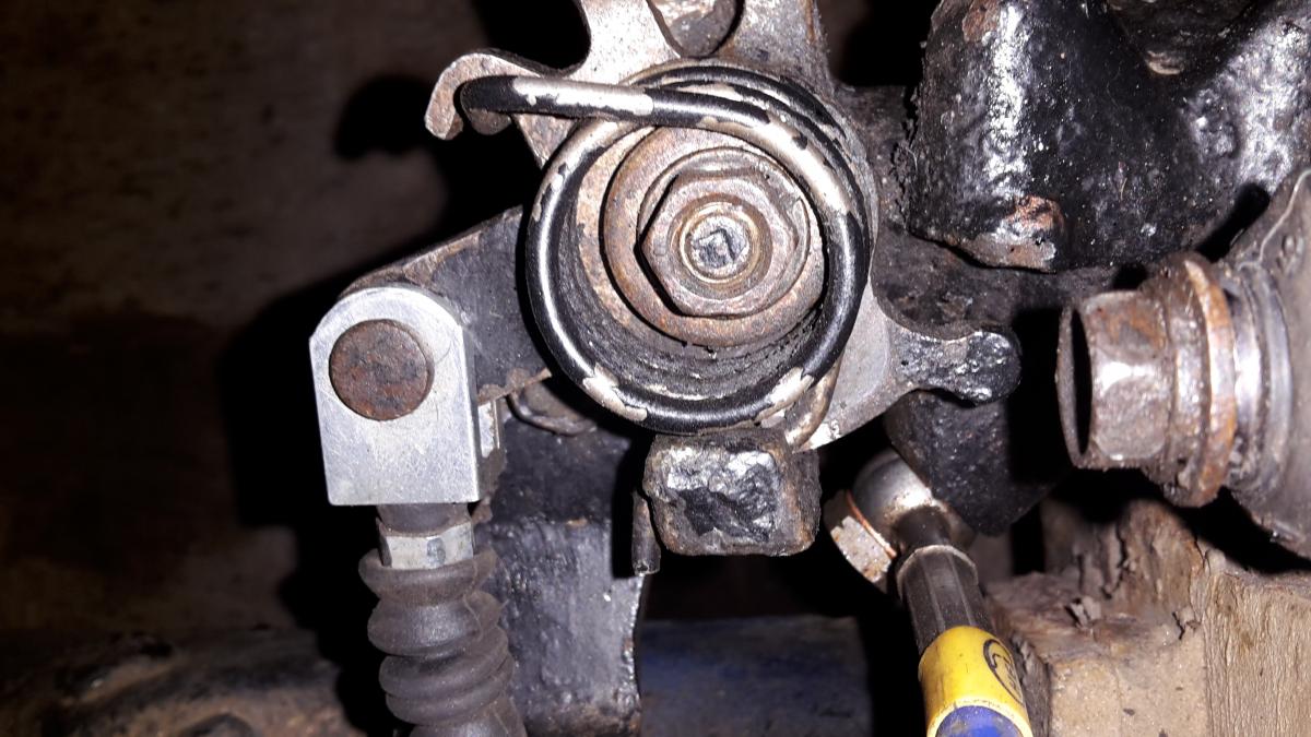

Johnboy GT Posted October 14, 2015 Posted October 14, 2015 This is where my caliper sits with the handbrake off bud. I took a photo of my adjuster at the handbrake. I'm pretty sure it's been cut.John Quote

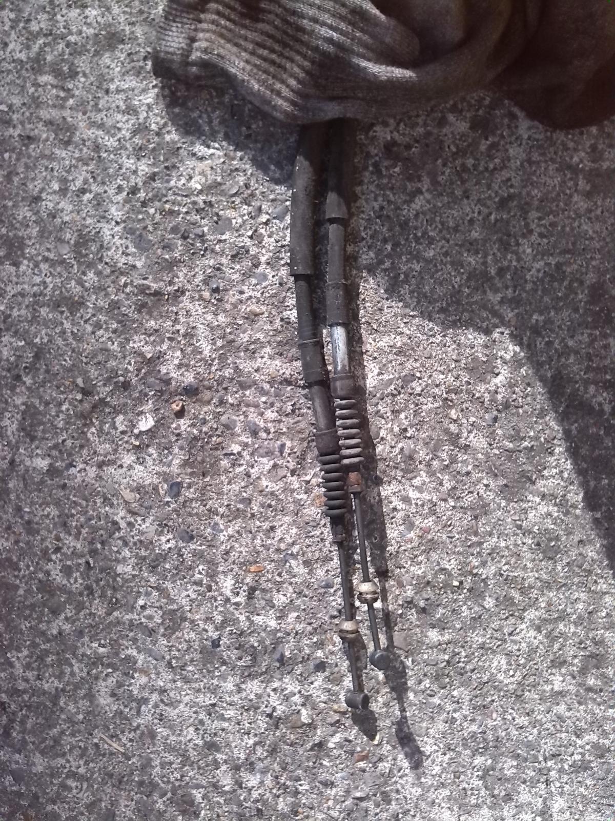

5e colin Posted October 15, 2015 Author Posted October 15, 2015 (edited) wel lads my cables are free of movement i took them off to check but i noticed 1 is longer then the other 1 also wich 1 gose on what side orange / gray Edited October 15, 2015 by 5e colin Quote

glanzadude Posted October 15, 2015 Posted October 15, 2015 Orange for passenger side and gray for drivers side. Try tighten the handbrake first and adjust the T section after Quote
glanzadude Posted October 15, 2015 Posted October 15, 2015 The two rear hb cables have different part numbers so that tells you they are different Quote
