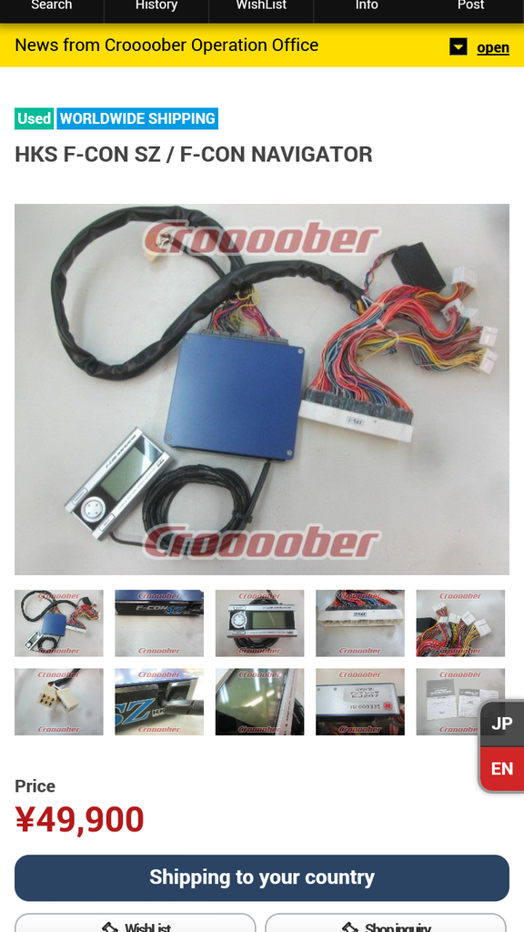

lukEp Posted October 5, 2015 Author Posted October 5, 2015 Found this on TGTT. http://www.toyotagtturbo.com/forums/showthread.php?41233-EP82-FCD-with-ext-harnessLooks like it could be real and apparently in the Hyper Rev's book? Quote
Gainzy Posted October 5, 2015 Posted October 5, 2015 (edited) I dived into hyper rev couldn't see a fcd there but you can see they use the hks f con and I found this pic... not to say they never made one though!That plastic type material look exactly the same as what was on the blitz sld I had. You can buy tidy universal harness's from Japan and Nengun. Edited October 5, 2015 by Gainzy Quote
