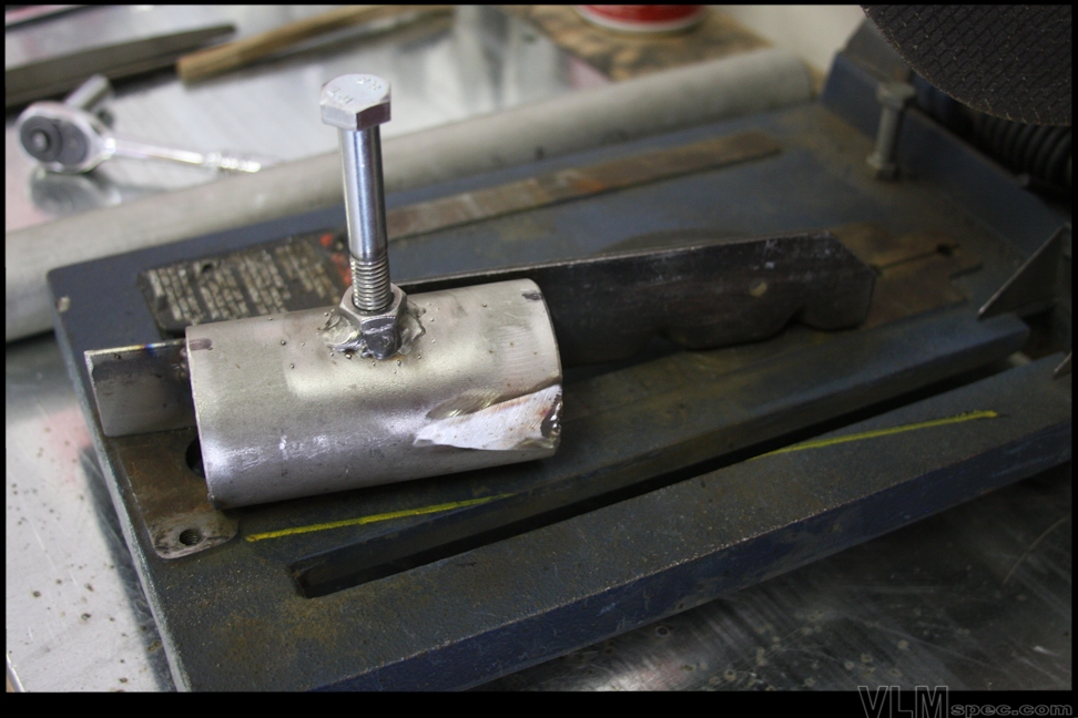

5e colin Posted January 10, 2016 Author Posted January 10, 2016 (edited) have a go :) if i had a shopsaw i would do it myselve you just have to make something like this Edited January 10, 2016 by 5e colin Quote

Bean Posted January 10, 2016 Posted January 10, 2016 That looks pretty simple Colin and should get them all the same angle. nice pic. Quote
5e colin Posted January 10, 2016 Author Posted January 10, 2016 yes its pretty simple like that just need a few test cuts to get the angle right i was pricing shop saws a while back there not in my budget atm :( but 1 day for sure its al simple to do but without the propper tools its a hard job Quote

Stu Posted January 13, 2016 Posted January 13, 2016 Im making manifolds all the time and just use a grinder, a bench top belt sander and some patience. Drop saw makes the job a bit easier Quote

Stu Posted January 13, 2016 Posted January 13, 2016 Haha thanks, im just a guy with a grinder Few other bits and pieces on my Facebook page if you want a look, link in signature below Using a mill would be way easier, trick is to get the two pairs made and tacked together then machine the two pairs to merge together - if that makes sense. Will post some photos of making one if I can find them Quote
