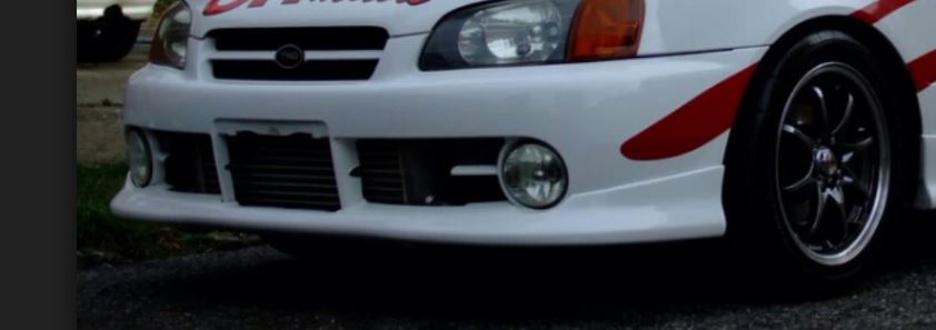

Timmah Posted March 23, 2018 Author Share Posted March 23, 2018 Update for the sake of an update, The gauge fell off, so I'll screw it on. I've also found a front lip that's now on it's way from Japan Quote Link to post Share on other sites

Timmah Posted March 26, 2018 Author Share Posted March 26, 2018 On 3/24/2018, 12:45:45, Gainzy said: Bit of scoth pad to rub the plastic helps stick! What lip you got? It's just an OEM one like so: Quote Link to post Share on other sites
