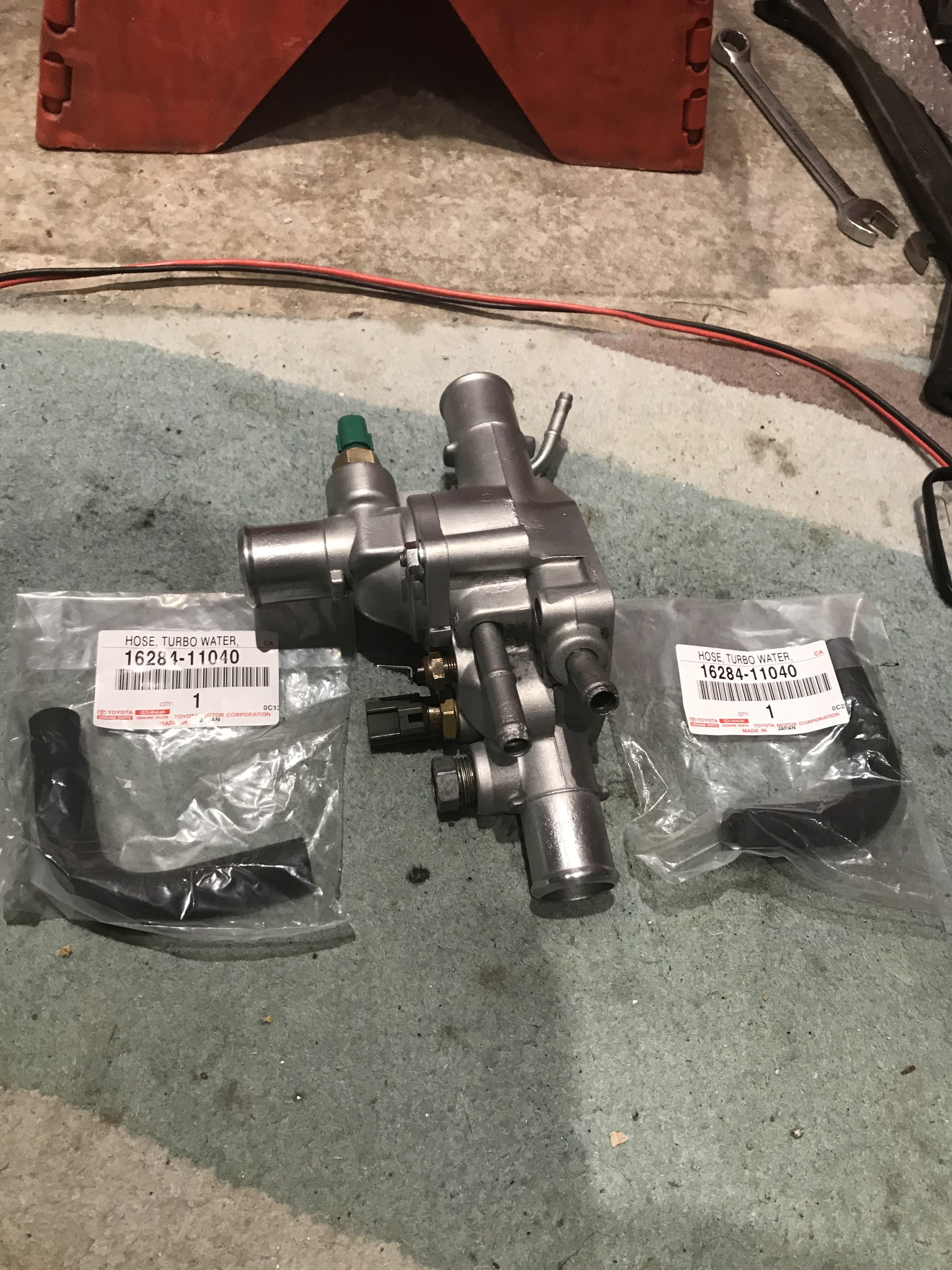

stevie82 Posted June 28, 2020 Author Share Posted June 28, 2020 Refurbished thermostat housing running a td low temperature thermostat and new turbo coolant pipes bargain at £7 each from Toyota Quote Link to post Share on other sites
Pikey009 Posted June 28, 2020 Share Posted June 28, 2020 Good stuff. Yeah TD have boosted a few now which ran around 160ish i think. I looked in to when I had mine Quote Link to post Share on other sites

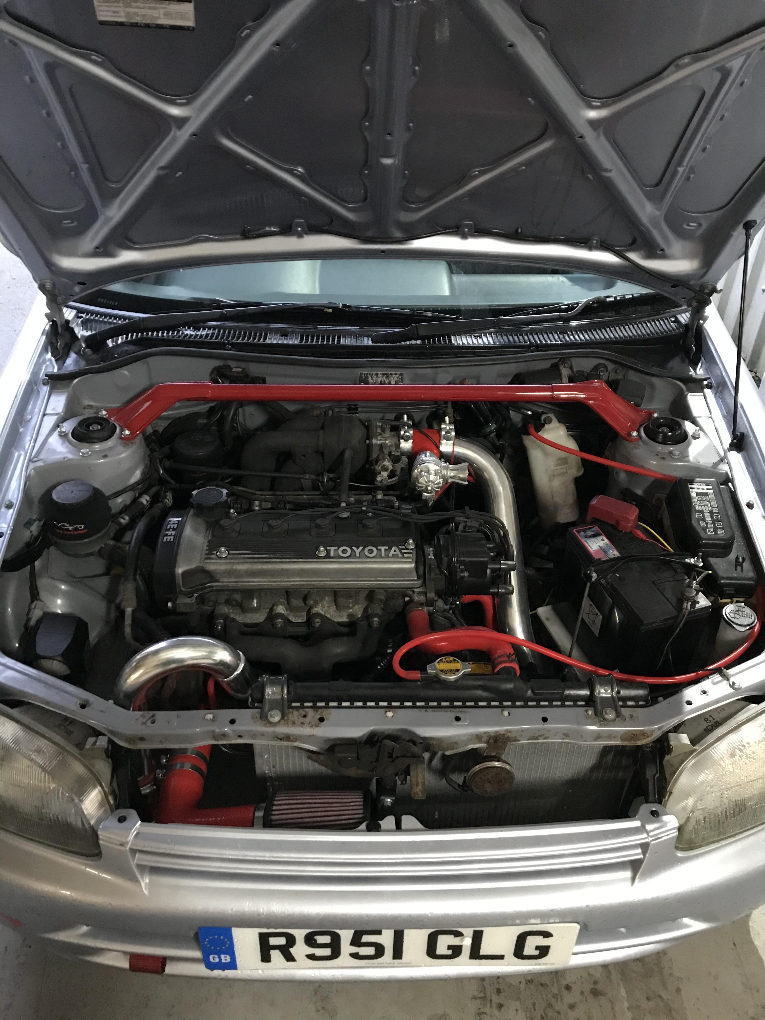

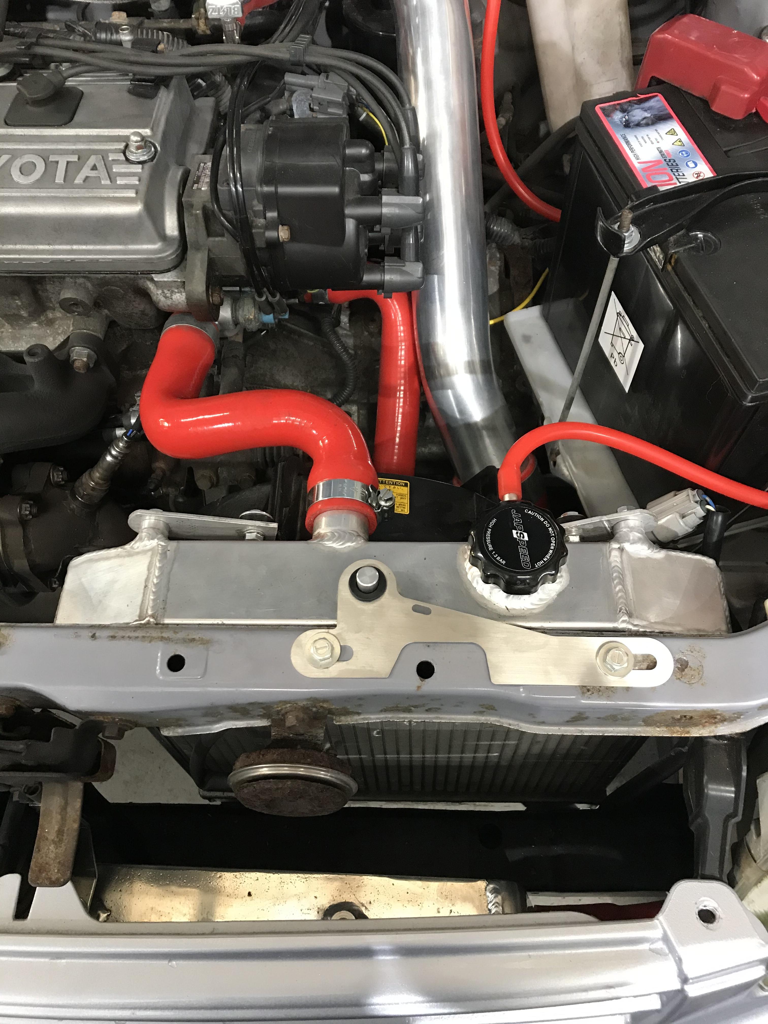

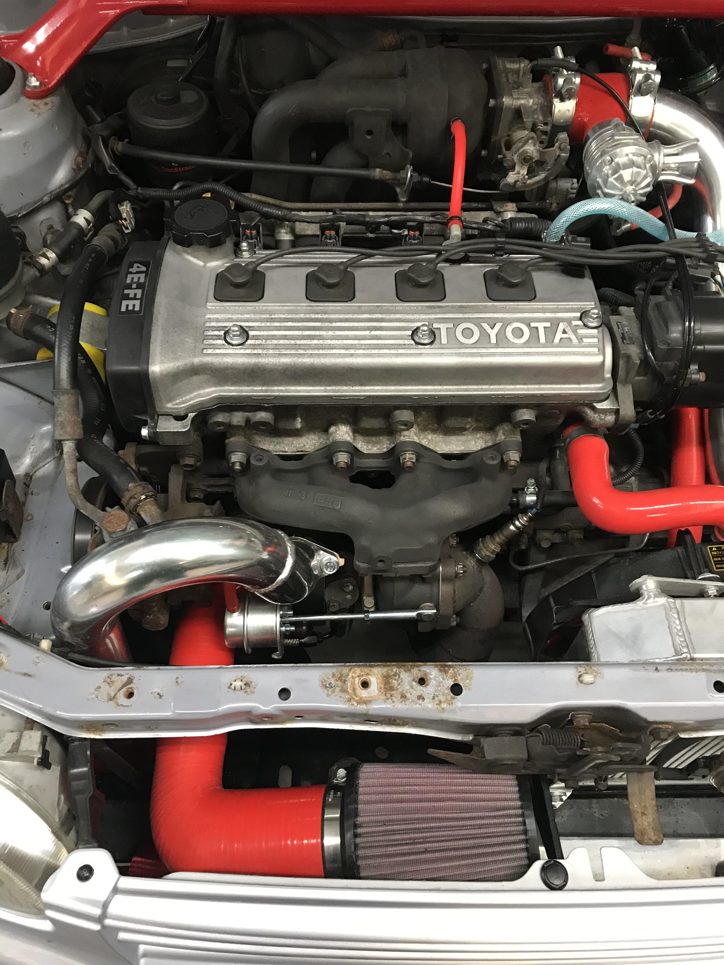

stevie82 Posted October 28, 2020 Author Share Posted October 28, 2020 Not updated for a while unfortunately as I’ve been busy with the boxster, but dug it out of the unit today and finished the intercooler pipe work which I’m not chuffed with so I’ve ordered some more 🤦♂️. Gave it a bath too, still some more engine bay work to do and still on the look out for an emb if anyone’s got one ? Here’s how she stands atm Quote Link to post Share on other sites
Sam44 Posted October 28, 2020 Share Posted October 28, 2020 (edited) fantastic work. really is looking very nice. is the ct9 a ct9a or ct9b?. this is going to spool up so fast. Edited October 28, 2020 by Sam44 Quote Link to post Share on other sites
stevie82 Posted October 28, 2020 Author Share Posted October 28, 2020 1 hour ago, Sam44 said: fantastic work. really is looking very nice. is the ct9 a ct9a or ct9b?. this is going to spool up so fast. It’s just the old ct9 from my glanza and yeah I’m hoping for a decent spool time as it’s going to be used for time attack 😀 Quote Link to post Share on other sites
burty Posted October 28, 2020 Share Posted October 28, 2020 Coming together nicely this one 👍 Quote Link to post Share on other sites
Sam44 Posted October 28, 2020 Share Posted October 28, 2020 43 minutes ago, stevie82 said: It’s just the old ct9 from my glanza and yeah I’m hoping for a decent spool time as it’s going to be used for time attack 😀 the glanza ct9 unit is the harder hitting ct9b. this is a great combo. really impressive tune. Quote Link to post Share on other sites
Pikey009 Posted October 28, 2020 Share Posted October 28, 2020 Looks cool mate. What core are you using? Think i'm going for a mishimoto as they seem good quality and the small ones seem the perfect match for a ct9. What air filter are you using? Quote Link to post Share on other sites

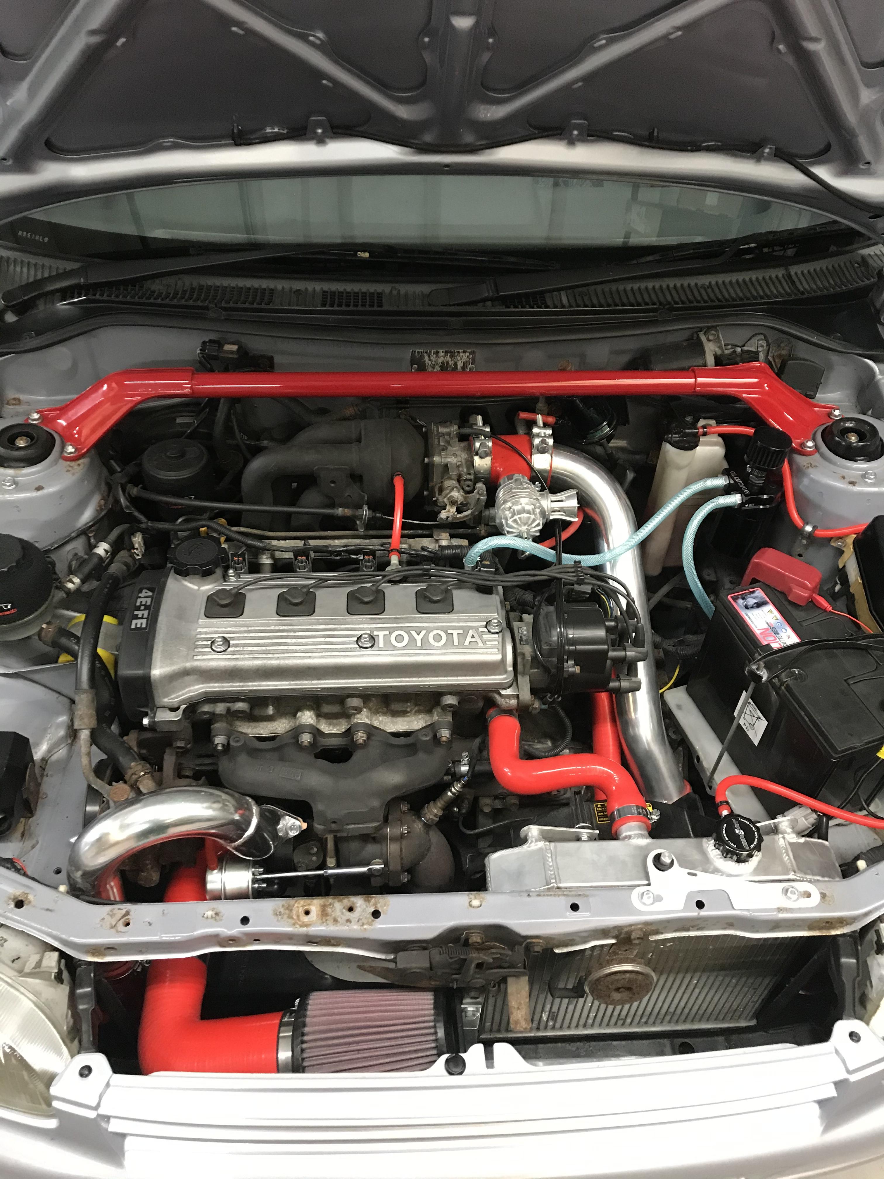

stevie82 Posted November 12, 2020 Author Share Posted November 12, 2020 Quick update, decided to redo the intercooler pipework as I wasn’t happy with how it looked so waiting for pipes from auto silicone hoses. Also gone for a dual core alloy radiator so waiting for brackets to arrive from jd tuning. I had some timing belt cover “4efe” replica stickers made up and have one spare if anyone wants it fire me a pm and I’ll post it out foc of course. Quote Link to post Share on other sites

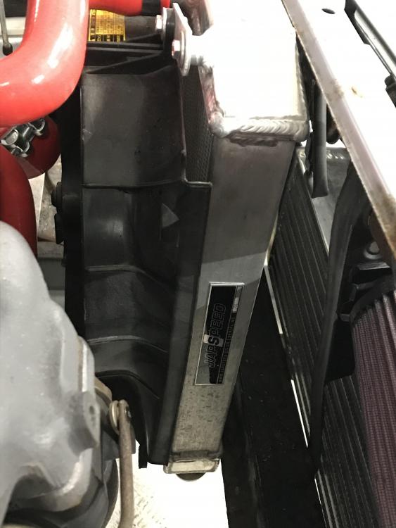

stevie82 Posted November 21, 2020 Author Share Posted November 21, 2020 New japspeed twin core radiator fitted today with jd tuning mounting brackets, managed to finish the revised intercooler pipework also. Quote Link to post Share on other sites

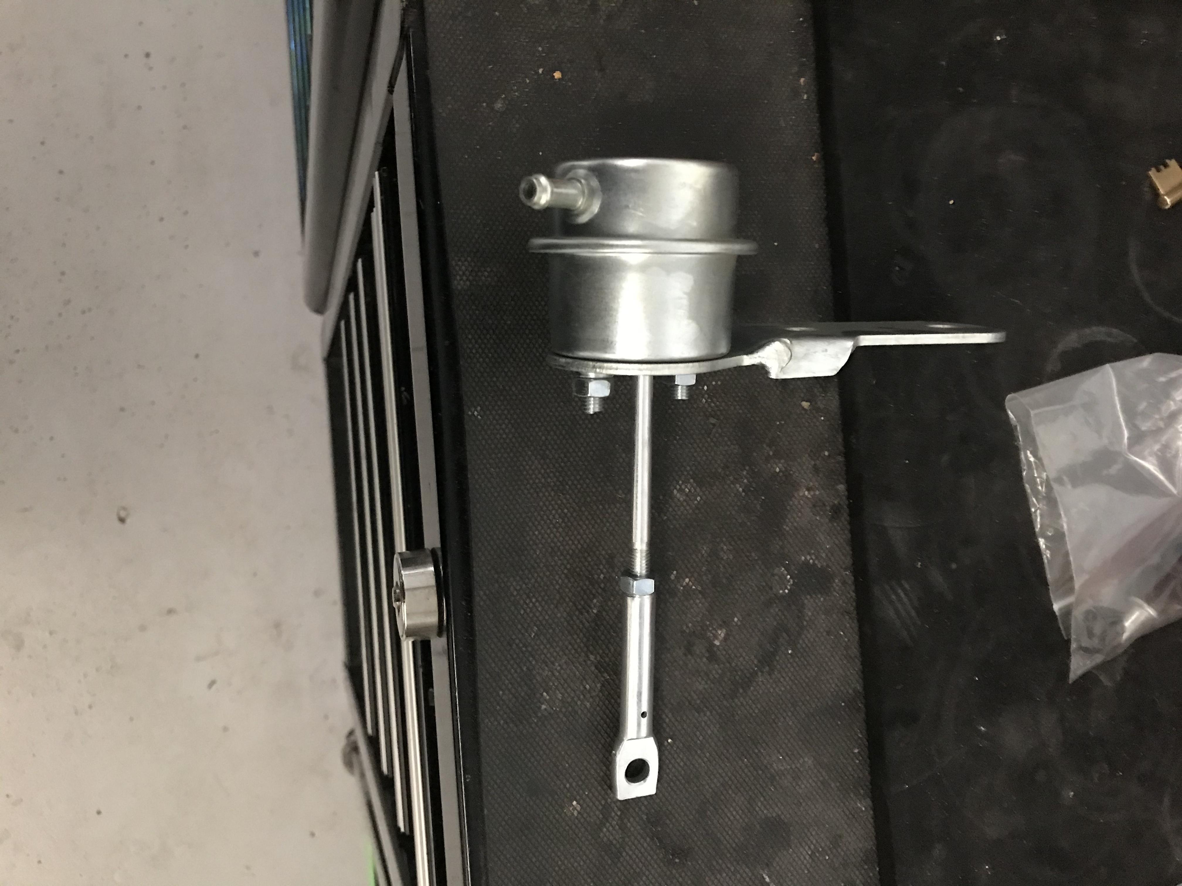

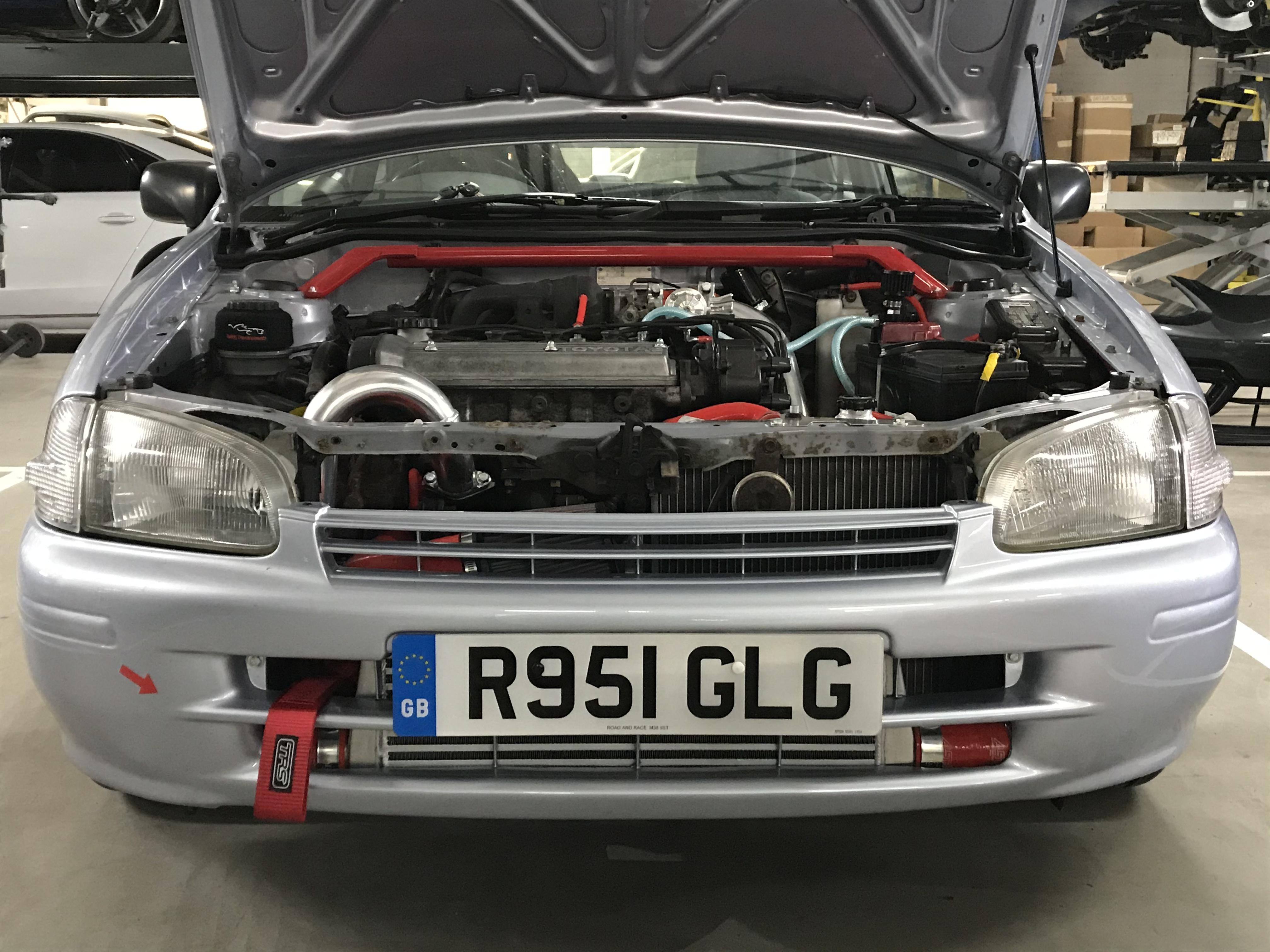

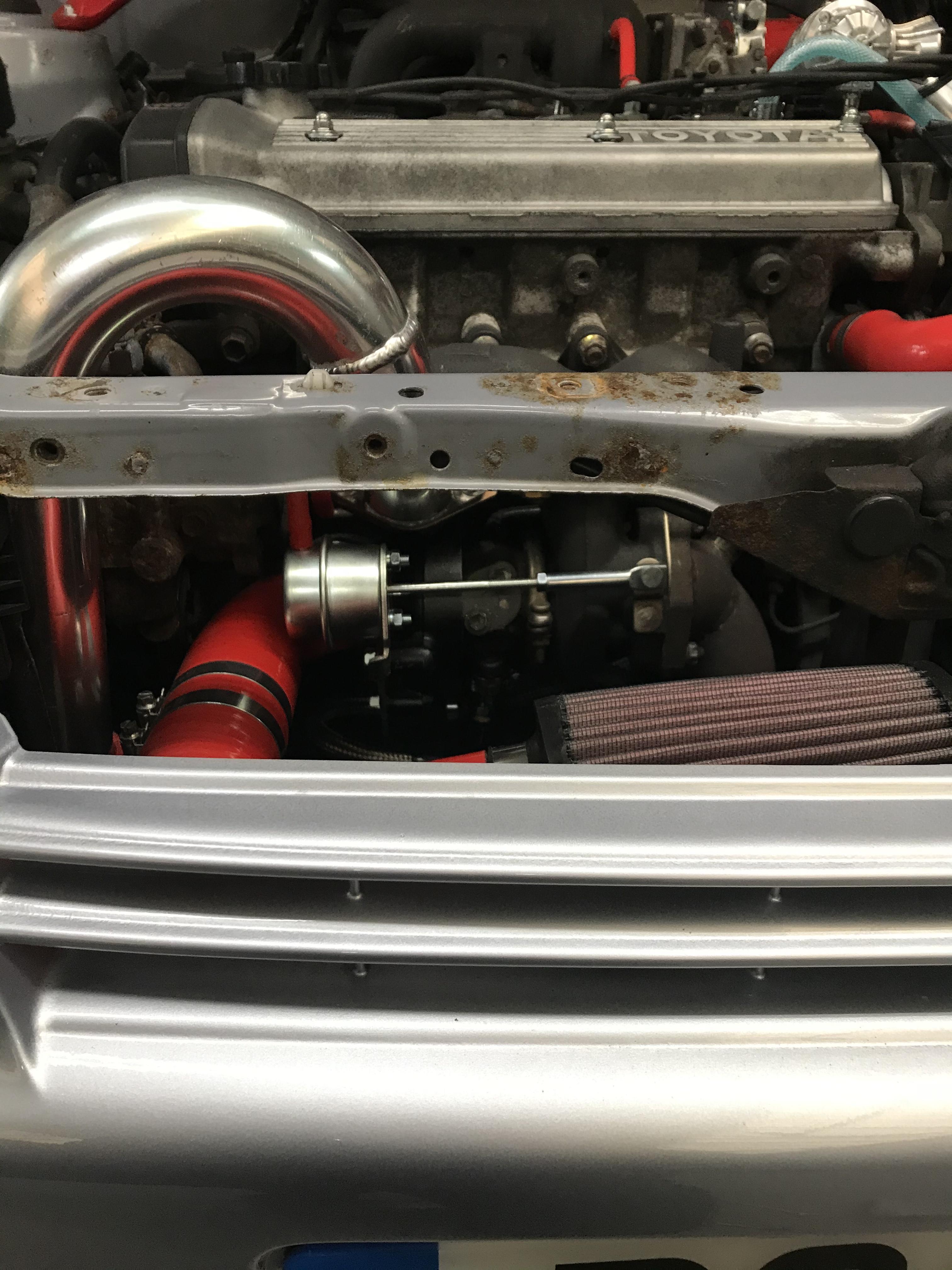

stevie82 Posted November 28, 2020 Author Share Posted November 28, 2020 Managed to get a couple of hours in on the sr today, trimmed the front under trays and front dirt guards to fit around the intercooler pipework. Fitted a catch can, made a bracket to fix the relocated header tank. Also managed to nip over and see mike at td and came away with an adjustable actuator and new seals for the glanza injectors. Last piece of the puzzle now is a standard glanza map sensor then it’s going to td for emanage to be fitted and mapped! Quote Link to post Share on other sites
burty Posted November 28, 2020 Share Posted November 28, 2020 42 minutes ago, stevie82 said: Managed to get a couple of hours in on the sr today, trimmed the front under trays and front dirt guards to fit around the intercooler pipework. Fitted a catch can, made a bracket to fix the relocated header tank. Also managed to nip over and see mike at td and came away with an adjustable actuator and new seals for the glanza injectors. Last piece of the puzzle now is a standard glanza map sensor then it’s going to td for emanage to be fitted and mapped! really looking forward to see the results at TD on this intercooler installation looks really tidy Quote Link to post Share on other sites
