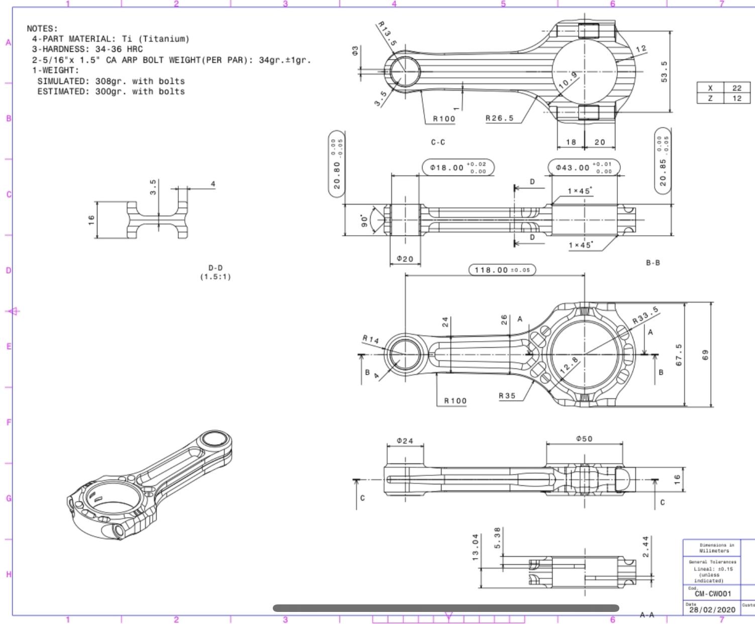

Now we are talking. What's the estimated cost. Are you pushing rpm.
Whats the desired compression ratio and finally are you designing a piston as well.
Well these cost me a lot but they will be available for anyone on a made to order basis
in 4340, 300m and Titanium
built for 11,000rpm
cost is unknown just yet but depends on what
they are getting made from.... hp rating estimate 500hp+
