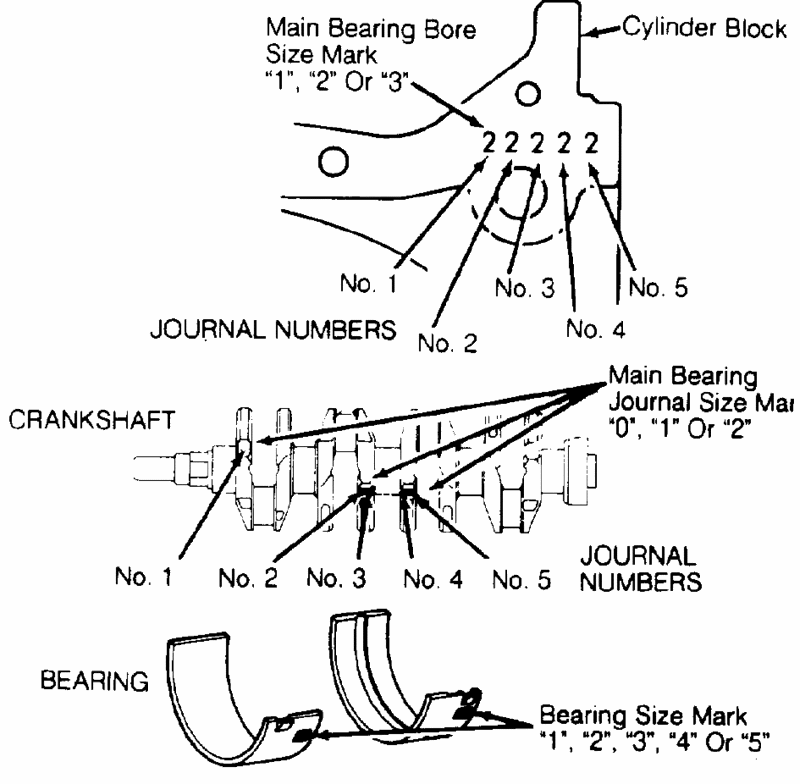

5e colin Posted October 11, 2016 Posted October 11, 2016 Explain why this is a disaster waiting to happen?I have an invoice stating they have measured the crank, I have spoken with the engineer on the phone a few times and he's a friend of a friend. I doubt very much he's out to ruin my engine.. ya they measured the crank to what spec ???? as toyota uses multiple bearing sizes in the stock spec its like rebuilding a stock old engine with middle spec size with moterfactors bearings if you get me because i didnt read your regrounded Quote

patman Posted October 11, 2016 Posted October 11, 2016 So if the crankshaft has just been polished and wash then of course it's still at standard size, now the question is what size bearings are going in, remember Toyota have 3 different sizes. Quote
morgey Posted October 12, 2016 Posted October 12, 2016 Dont toyota stamp the bearing sizes for. The crank on the crank and sump face of the block? Quote

morgey Posted October 12, 2016 Posted October 12, 2016 Yeah but theres 3 std sizes for the inner crank face and upto 5 for the caps if i understand correctly So STD doesnt really clear it up. You can have a factory car with size 0,0,2,1,2. For each journalFor instance My 4age had the stamps on the block and they were like 1.3.2.2.3 meaning that there were a variety of sized bearings used from factory.Its better to double check and get it right than have to do it all again with extra work with a damaged crank etc Quote

patman Posted October 12, 2016 Posted October 12, 2016 Just for peace of mind Tim please ask him what size bearings your need that's all just ask do I need 1,2 or 3 😃 because when I rang up toyota and asked for bearings awhile ago they asked me which size Quote
