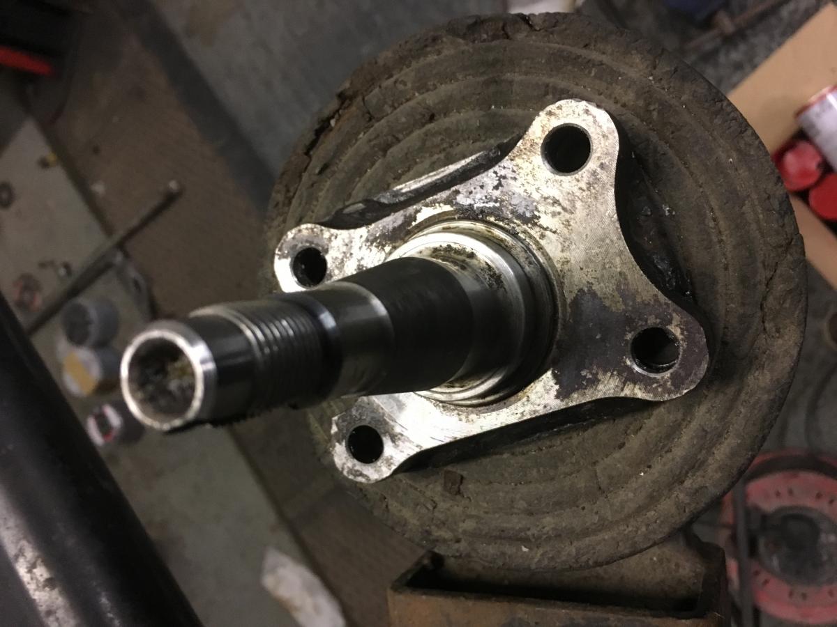

TrisK Posted September 21, 2016 Posted September 21, 2016 So I need to start this by thanking my two best mates, Kieran and Flint. They are amazing and make my stupid ideas not so stupid and actually do things, otherwise my ideas would simply remain ideas. Kieran is an engineer/welder by trade and Flint is just Flint, give him any power tool and he'll get on with it. So I've wanted rear camber on the GT for quite a while, and have looked at the way that other people have done it, Grant and Mikey and taken some inspiration from that. Originally I was planning on just following the way that they have done it, but with Kieran's help and advice, the way it was done has changed slightly and I think its for the better, resulting in more strength and a safer set up. So, I had a set of stub axles that had been roughly chopped off a glanza beam by grant and sent to me a year or two ago. Last weekend, I finally got the rear axle down the workshop and Kieran and Flint got straight to work, whilst I pranced around asking stupid questions and taking photos: Here are the stub axles in question recived from grant. The first thing to do was to remove the majority of the material from the back of the stub axle chop and then get it in the lathe. at that point Kieran then lathed material off the back until we had a completly flat face: This was then checked with a micrometer to check it was even across the whole face. Kieran took several readings, and the average came out at 21.7mm, there was a discrepancy of less than half a mm across the face, We decided this was within acceptable tolerances. The next part was to chop the beam off, So again Kieran got cutting and removed the stub nose from the stub axle on the beam: Flint then got the grinding disk out and being careful not to touch the rest of the plate flatted down the last few mm of the stub axle Once these were ground back they were checked with engineer layout fluid, and found to be flat The next thing was to get the stub axles in the pillar drill and drill them through so they could be bolted back to the axle This is currently as far as I've got. I am currently waiting for some High Tensile bolts to be delivered - m12 x 1.25 - 12.9 Strength. These will be used to bolt the stub axle and the braking backing plate to the beam. The alignment will be adjust by use of a shim like the example below on a lupo: The advantage of doing it this way and utilising two rear axles are as below: Increase in track, like spacers, but much less load on the bearings When inspecting the stub axles, it appears the nose of the axle is welded right the way through, so attempting to cut the stub axle from the beam may compromise some of the strength in the stub axle, this could potentially lead to your whole rear wheel assembly falling off in the event of a catastrophic failure. This method means all the material is still there and should hopefully result in the maximum strength I will update this post once the bolts and my polybushes have arrived. Then hopefully the modified axle should be going on the car in the next week or two again its necessary to thank Kieran and Flint for all their help/doing it for me. Quote

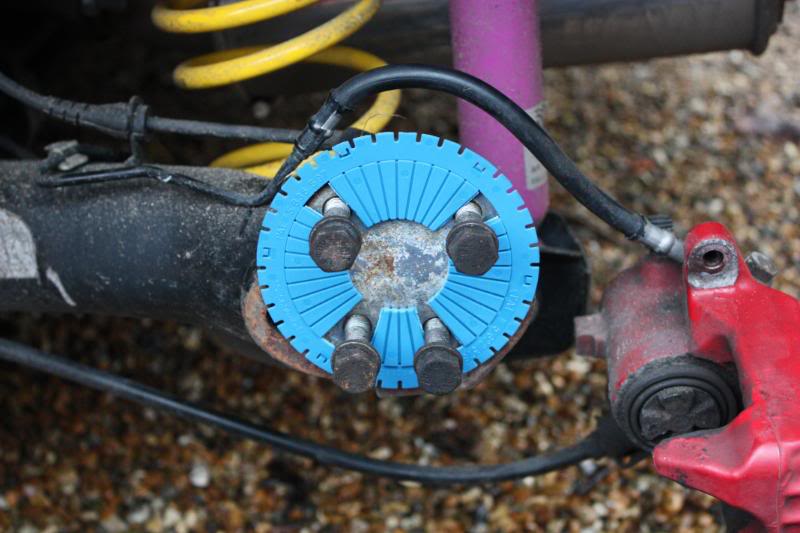

TrisK Posted September 22, 2016 Author Posted September 22, 2016 the only way i see camber added is if the spindles are machined at an angle ?? is that how its done ?The blue shims add the camber and toe colin Quote

MR-2 Posted September 22, 2016 Posted September 22, 2016 How does that blue shims work, plactic adjusting mold for metal plate? My country not legal anyway, can't modify anything, so have to do very original looking patent. Any links for that VW Lupo system? Quote
TrisK Posted September 22, 2016 Author Posted September 22, 2016 I think mine were done the same way Tris, you'll love it when it's done! Been running mine 3 years hard road and track use, such a worthwhile mod. Went from -1.25/-2 F/R to -2/-1.2 rear to help negate understeer and it feels great. Some toe out on the front would help but I want to minimise tyre wear while the GT is still my dailyDid yours require two axles too Amjad? or was it all done with one? How does that blue shims work, plactic adjusting mold for metal plate? My country not legal anyway, can't modify anything, so have to do very original looking patent. Any links for that VW Lupo system? The blue shim is two plates, one adjusts camber and one adjusts toe. you spin the discs to be aligned to the spec you want and then install it like a spacer between the axle and the stub axle Quote
MR-2 Posted September 22, 2016 Posted September 22, 2016 http://www.clubgti.com/showthread.php?257949-HOW-TO-Fit-Adjustable-camber-toe-EZ-Shims-to-the-rear-beam-stub-axleFound it, plastic shim, not coming to my car... Quote
TrisK Posted September 22, 2016 Author Posted September 22, 2016 http://www.clubgti.com/showthread.php?257949-HOW-TO-Fit-Adjustable-camber-toe-EZ-Shims-to-the-rear-beam-stub-axleFound it, plastic shim, not coming to my car...They are made by Eibach who know what they are doing generally And they are TUV approved. So I think the risk is mjnimal Quote

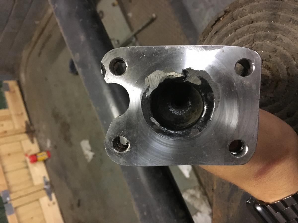

TrisK Posted September 22, 2016 Author Posted September 22, 2016 I just realised you're using two. I'm not sure it was two, but it looks like mine bolts up the same way as yours.That's the way I was originally going to do it. Cut down the middle and bolt it back onBut when some stubs for quite cheap came up we revised the method. Also on inspection it looks like the splines are welded from the back. So by only using one I would be slightly concerned about the strength of it Quote

Amjad Posted September 22, 2016 Posted September 22, 2016 That's the way I was originally going to do it. Cut down the middle and bolt it back onBut when some stubs for quite cheap came up we revised the method. Also on inspection it looks like the splines are welded from the back. So by only using one I would be slightly concerned about the strength of itAh sound, I see what you mean now! I suppose your one sits wider then? Or have you kept the original track? Had no issues with strength tbh with my use of the car, 4 high tensile bolts as I'm sure you've seen if Mikey sent you pics Quote
TrisK Posted September 22, 2016 Author Posted September 22, 2016 Ah sound, I see what you mean now! I suppose your one sits wider then? Or have you kept the original track? Had no issues with strength tbh with my use of the car, 4 high tensile bolts as I'm sure you've seen if Mikey sent you picsNo. 20mm wider track with my method. Do you know what rating bolts Mikey used? Hoping he might pipe up with some details Quote

TrisK Posted July 20, 2017 Author Posted July 20, 2017 I've had a bit of a delay as my local machine shop had a back log (race season)With a bit of help from flint the back end was reassembled Still have the other side to do. But this is how far I am Quote
TrisK Posted August 16, 2017 Author Posted August 16, 2017 So all the rear brake stuff went back on and the car back down on the floor havent driven on it yet, more than moving it round the workshop, but it feels solid and seems to work Quote
