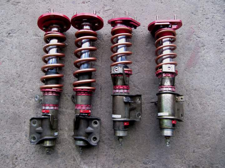

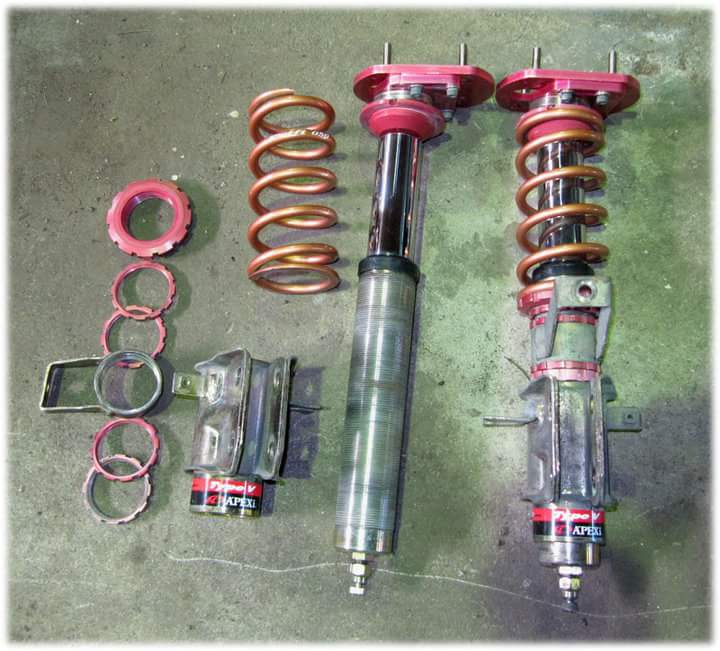

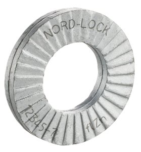

MR-2 Posted February 24, 2017 Posted February 24, 2017 My MR2 had had problem with topmount nut losening, solved with Nordlock washer.Some annoying sound still coming sometimes from inverted monotube bearing, whic is inside lower tread pipe top. Coilovers are Apex N1... Quote
