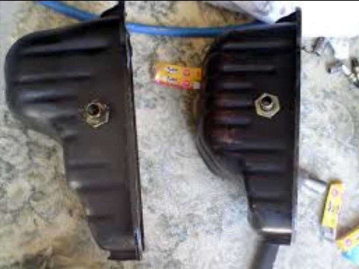

akyakapotter Posted April 22, 2017 Posted April 22, 2017 Yes they are different gt sump is shallow. Glanza one is deeper both need pick up pipes to suit. Glanza left gt turbo right.Cheers nick. Quote

Calum122 Posted April 22, 2017 Posted April 22, 2017 Yes they are different gt sump is shallow. Glanza one is deeper both need pick up pipes to suit.tmp_29227-_20170422_1752591948883292.JPGGlanza left gt turbo right.Cheers nick. Thanks Nick, I wanted to know what the difference was! Quote
H_D Posted April 23, 2017 Posted April 23, 2017 Yes they are different gt sump is shallow. Glanza one is deeper both need pick up pipes to suit. tmp_29227-_20170422_1752591948883292.JPGGlanza left gt turbo right.Cheers nick.The oil dipsticks are also different Quote
