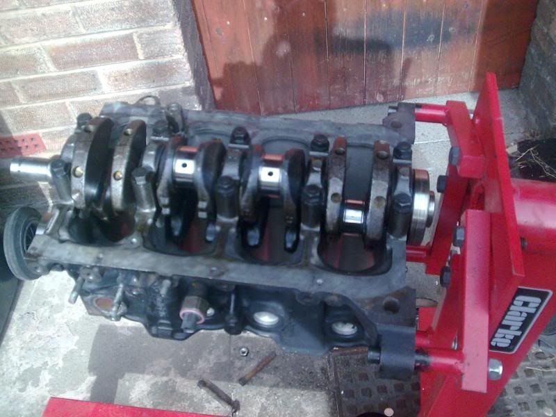

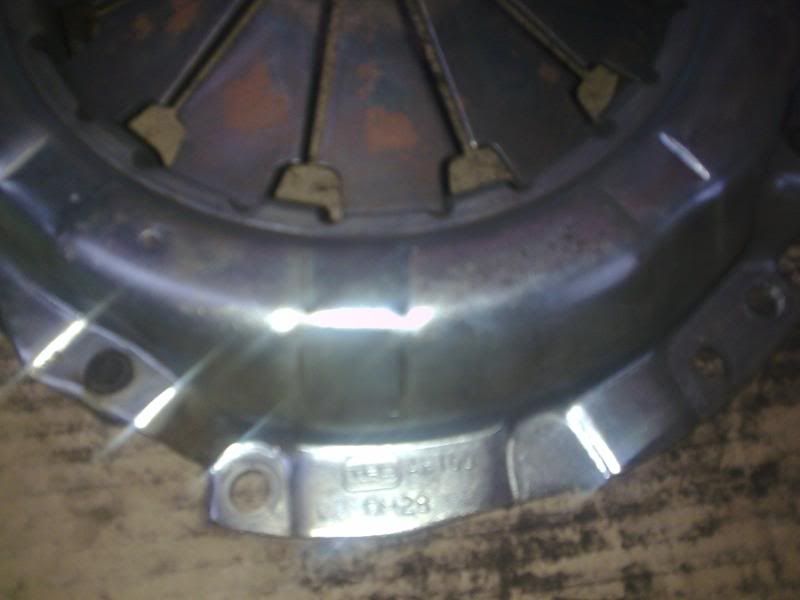

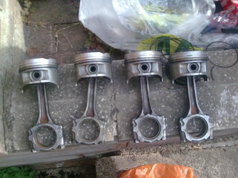

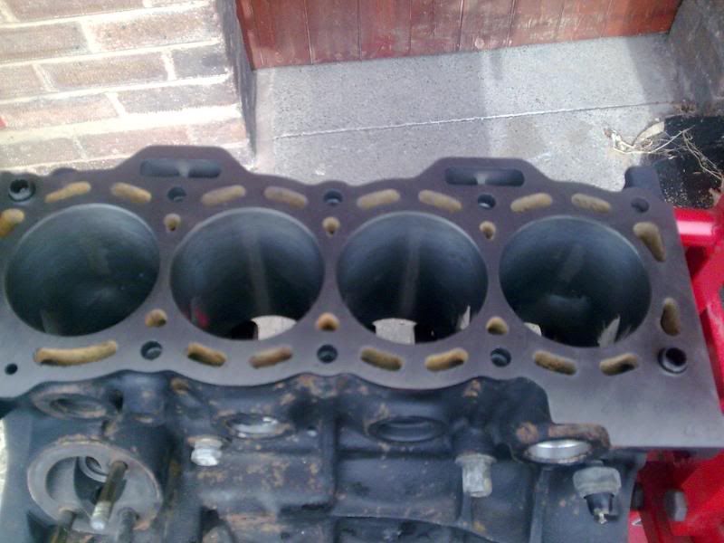

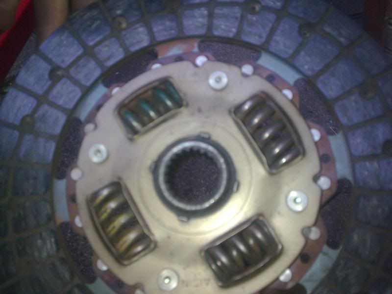

Dean @RW-Developments Posted September 28, 2010 Author Posted September 28, 2010 small update well from a while back will gt more pics up tmoz!well first of all the starlet was off the road for 10 months so decided to get it back on the road! so took engine out ready for a small rebuild, loaded the hyundai up lol then re build, head skimmed, block skimmed, re shimmed,honed, chemically cleaned etcfound out id cracked 3 pistons so ian aka dub7 to the rescue with gt turbo rods and pistons also put new toyota piston rings on with new head gasket, head bolts etconce engine was all back together i installed my trd clutch which ive had sitting here for over a yeari also bought a pasanger side headlamp for mot. with lots of lil things to get it up and running, had issues with electric headlight adjusters for mot so ripped it all out and made my own manual adjusters that work mint!lots more to come comments welcome as always Dean Quote

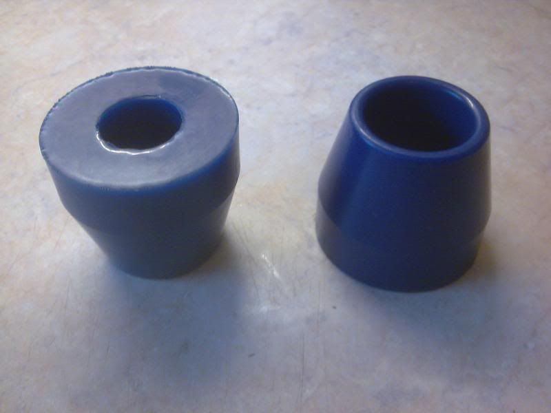

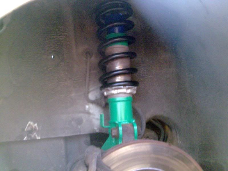

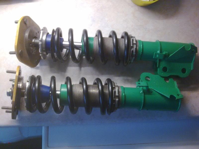

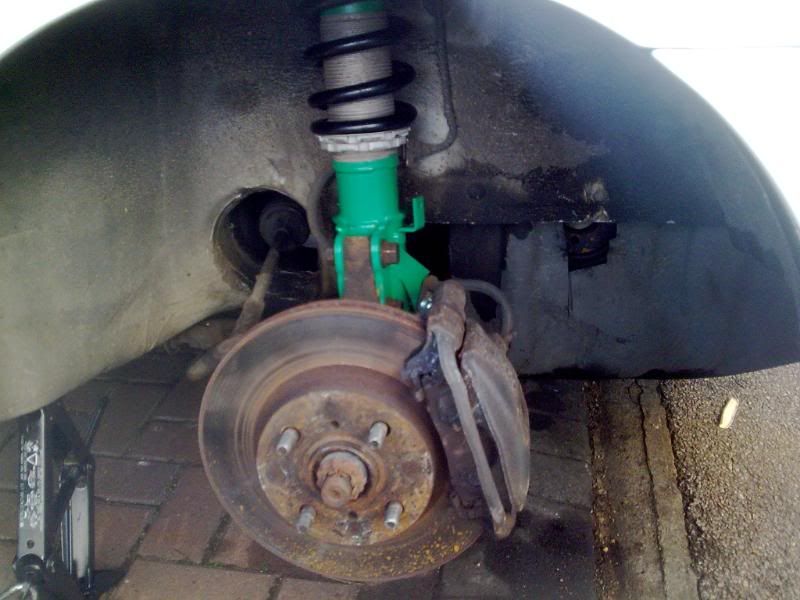

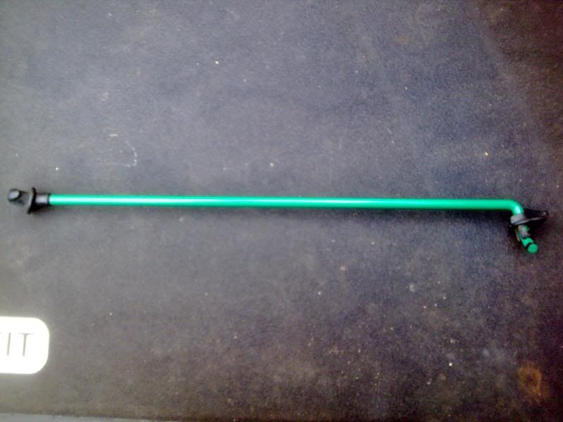

Dean @RW-Developments Posted October 3, 2010 Author Posted October 3, 2010 more updates. excuse pic qualityso whilst i was building the engine i bought a set of tein coilovers off a mate, that had seen better days tbh but worked fine with no leaks etc, so took them all apart and made a new locking collar on the lathe at work as 1 of them was missing, i also sandblasted them bare and repainted them and sent the springs off for zinc plating and powdercoated, also put some poly bush bump stops on them!!dont have any before pictures.poly bushesloved the tein green so did a few lil bits in the bay etc.fittedrear boot struts ftwsorry about picture quality! as always comments welcomelots more to come thanks for looking Dean Quote
Sparky Posted October 3, 2010 Posted October 3, 2010 Colour code for the Tein green? I want to see more Quote
Dean @RW-Developments Posted October 5, 2010 Author Posted October 5, 2010 Colour code for the Tein green? I want to see more well its not actually tein green but its probally 1 of the closest matches off the shelf lolupdate coming Quote

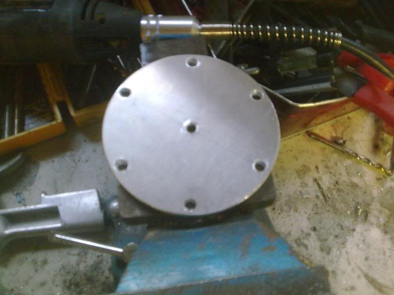

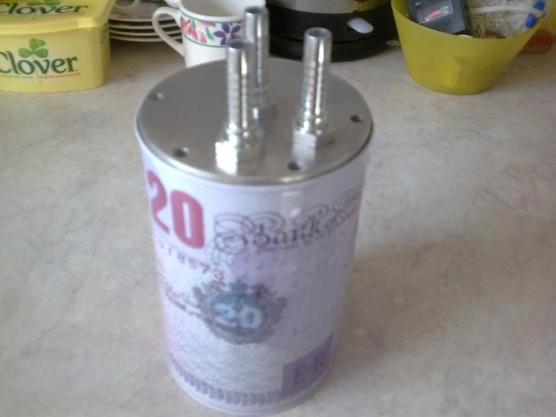

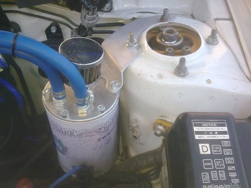

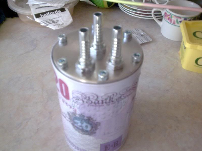

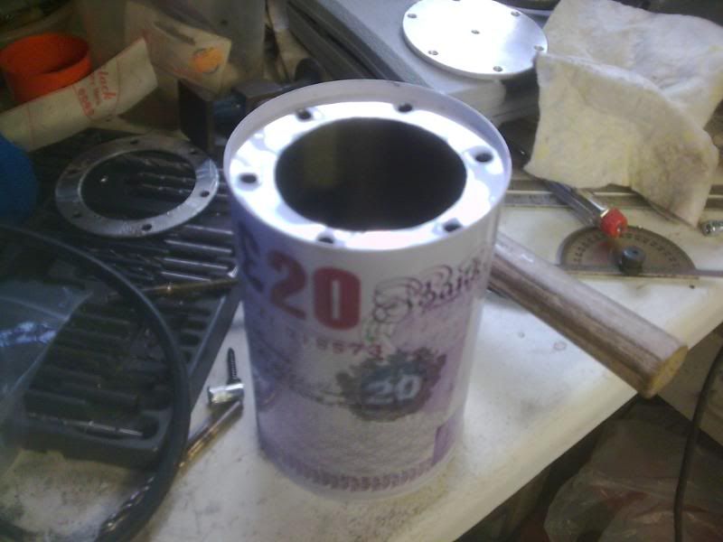

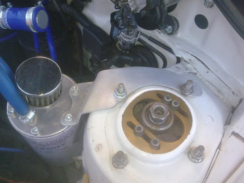

Dean @RW-Developments Posted October 5, 2010 Author Posted October 5, 2010 update from a month or so agoso whilst getting the car ready for the road after having oil go all over my clean bay when the engine blew, i decided to make a custom canch can!so first got a £20 note money tin ftw and then started fabricating the lil beastfabricated a nice alloy removable lidi then added m6 nut inserts in the holes so i could thread bolts in to hold the lid onafter that it was time to fill the tin once this was inserted i used 3 10mm nipples and nearly finishedpics still to come of the custom bracket etc will update soon watch this spaceas always comments welcomeDean Quote

Asad Posted October 6, 2010 Posted October 6, 2010 Where did you get the nozzles from on the catch can? were they cheap? Quote
Dean @RW-Developments Posted October 7, 2010 Author Posted October 7, 2010 Where did you get the nozzles from on the catch can? were they cheap?tbh a mate got me them for free from his work, so not too sure bud? Quote

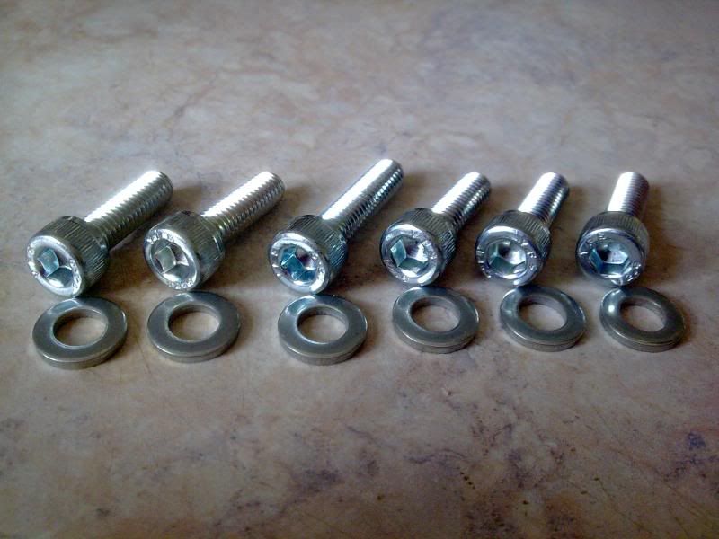

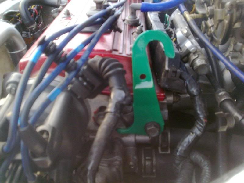

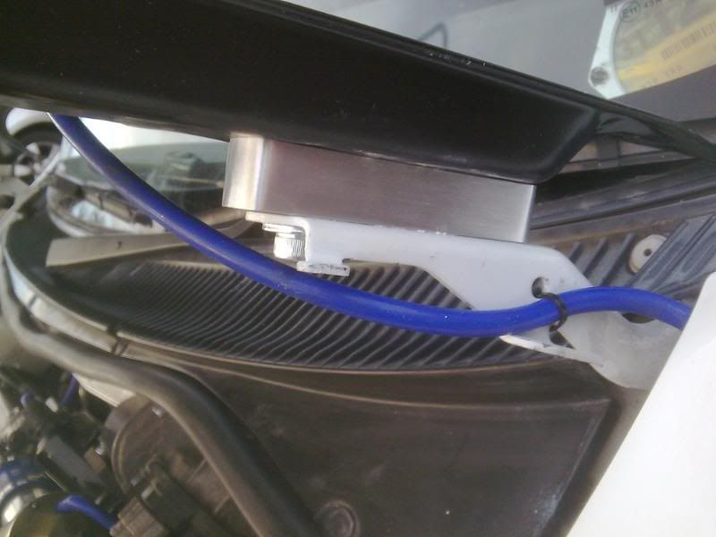

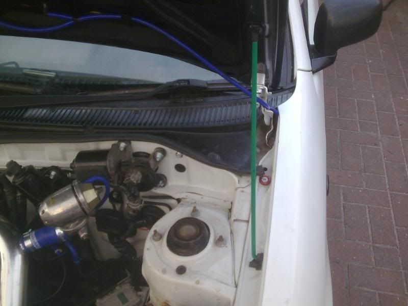

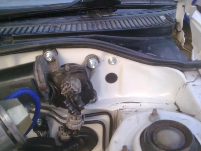

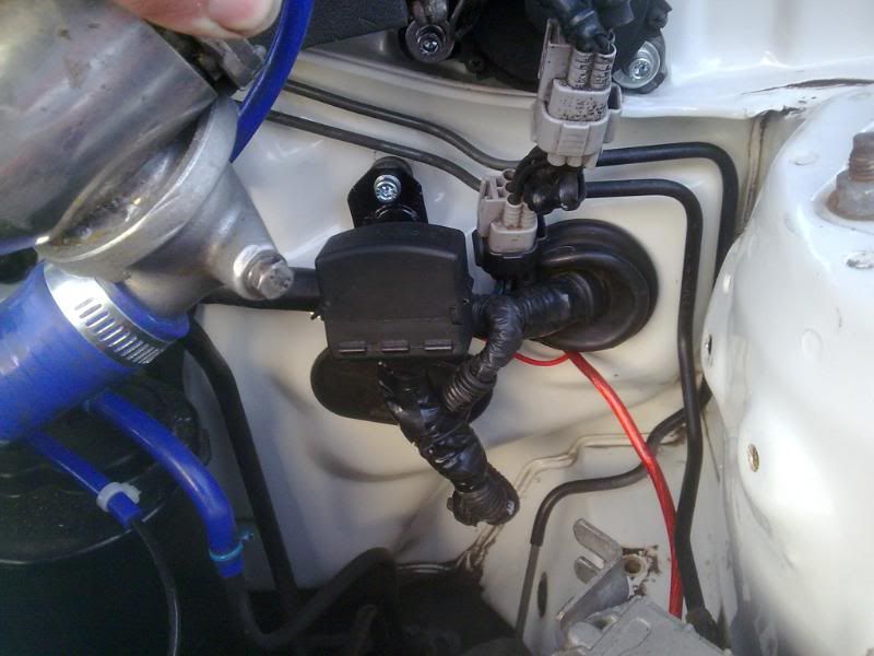

Dean @RW-Developments Posted October 8, 2010 Author Posted October 8, 2010 updateheres a few pics of the custom bracket i made to hold the catch can on,also you can see the breateher and pipe setup.aslo did another bay tidy up where i replaced every bolt with a new allen key bolt! and started moving stuff around for the clean bay look!diagnostics box moved down and all the brackets in the bay that werent needed were taken off!!my custom bonnet rasers i made from alloy block lots more to come and as always comments welcome!more updates coming soonDean Quote
Galliano Posted October 8, 2010 Posted October 8, 2010 How much has it cost you roughly to replace all these bolts with the clean ones? And also will you be making bonnet raisers for your stock? If so I may take a set in anodised pink.. Really your attention to detail is great, considering you were going the wrong way about modifying cars from the first Starlet !! Quote
Stulet-GTT Posted October 8, 2010 Posted October 8, 2010 Looking good..I have started replaceing bolts with the allen key ones to, they look so much nicer an are pretty cheap to pick up aswell... Quote
Dean @RW-Developments Posted October 9, 2010 Author Posted October 9, 2010 How much has it cost you roughly to replace all these bolts with the clean ones? And also will you be making bonnet raisers for your stock? If so I may take a set in anodised pink.. Really your attention to detail is great, considering you were going the wrong way about modifying cars from the first Starlet !! cheers dude ye because ive had starlets since i was 16 id come from the whole maxpower and redline era think most of us have done it with first cars now im going full bore jdm/usdm hellaflush styleee not forgetting some decent power lolthe allen key bolts didnt cost that much tbh and make such a difference ive pretty much replaced everey m6 and mate theaded bolt on the car. im going to be getting some bolts in to make up some bolt tidy up kits for the starlets prices will be good also let me know if your interested? there fully zinc plated so wont rust etc il look into bonnet raisers Quote
