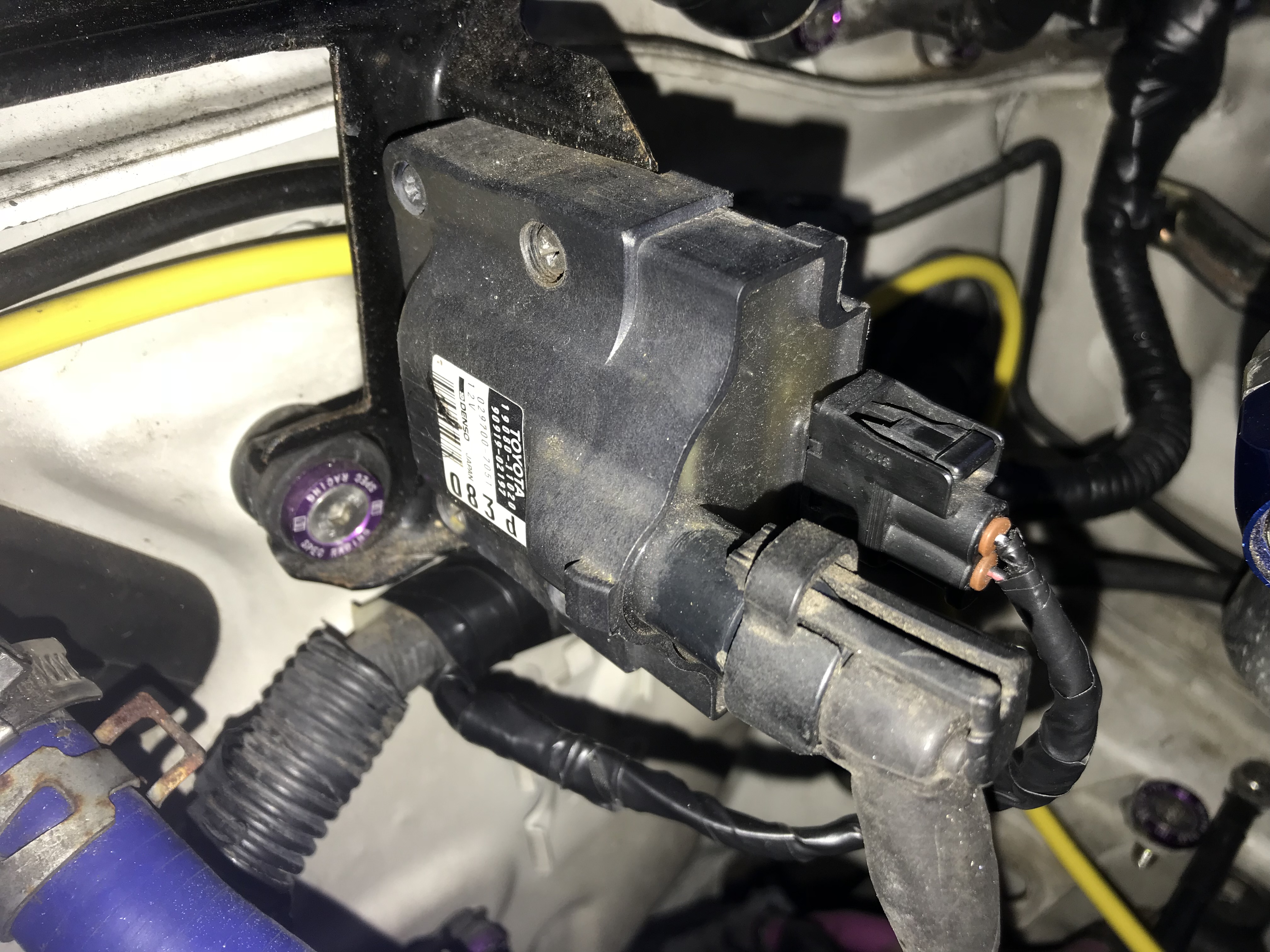

T-dog Posted November 3, 2017 Posted November 3, 2017 I wired in a omex Rev limter the other day on my Glanza , I first tried the ignition neg from the diagnostic port , but had no joy , so I then tapped into the 2 pin plug on the coil pack that is bolted on the bulkhead and works perfect , will look tomorrow and tell you the wire colour I tapped into Toby Quote
Matty1997 Posted February 13, 2018 Posted February 13, 2018 On 03/11/2017, 22:25:29, T-dog said: I wired in a omex Rev limter the other day on my Glanza , I first tried the ignition neg from the diagnostic port , but had no joy , so I then tapped into the 2 pin plug on the coil pack that is bolted on the bulkhead and works perfect , will look tomorrow and tell you the wire colour I tapped into Toby What colour wire was it Toby? As I’m planning on doing the same thing to mine today and I don’t want to run in to any issues lol, rather know what wires I’m going to be chopping in too! thanks Quote
Patches Posted February 13, 2018 Posted February 13, 2018 (edited) With the ignition on and using a multi meter, one wire should have a constant 12v and the other wire should have nothing with the engine not running which will be the negative you are after. When the engine is running this connection will be grounded by the igniter to create spark. Edited February 13, 2018 by Patches Quote
T-dog Posted February 13, 2018 Posted February 13, 2018 7 hours ago, Matty1997 said: What colour wire was it Toby? As I’m planning on doing the same thing to mine today and I don’t want to run in to any issues lol, rather know what wires I’m going to be chopping in too! thanks I’m sure it was the red and black wire , but one worked and one didn’t Toby Quote
Matty1997 Posted February 14, 2018 Posted February 14, 2018 Aha thank you! I’ve tried one of them and no luck so it’s gotta be the other lol! Cheers mates Quote
Matty1997 Posted February 15, 2018 Posted February 15, 2018 Sorted it mate it ended up being the other wire aha! Only issue I’m having is my after market taco reads around 300rpm higher than my actual taco on the clocks lol Quote
