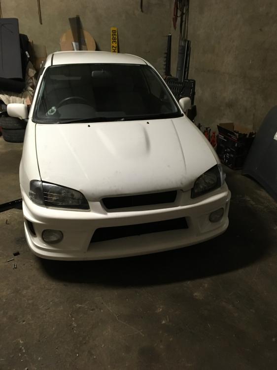

Ryan.Truesdale Posted April 10, 2018 Posted April 10, 2018 (edited) This is the build thread for my ep91 uk spec starlet which shall eventually be built into a pretty decent spec glanza. I shall write an in-depth build on it but for now i shall just include a before and after pic of how i bought it and how it currently sits over a year later. Edited April 10, 2018 by Ryan.Truesdale Quote

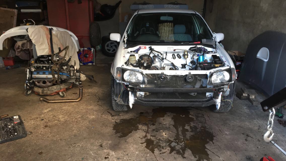

Ryan.Truesdale Posted April 15, 2018 Author Posted April 15, 2018 Engine out as the passenger side chassis leg has been tweaked in a small accident. It was bent very slightly in front of the battery tray. Quote

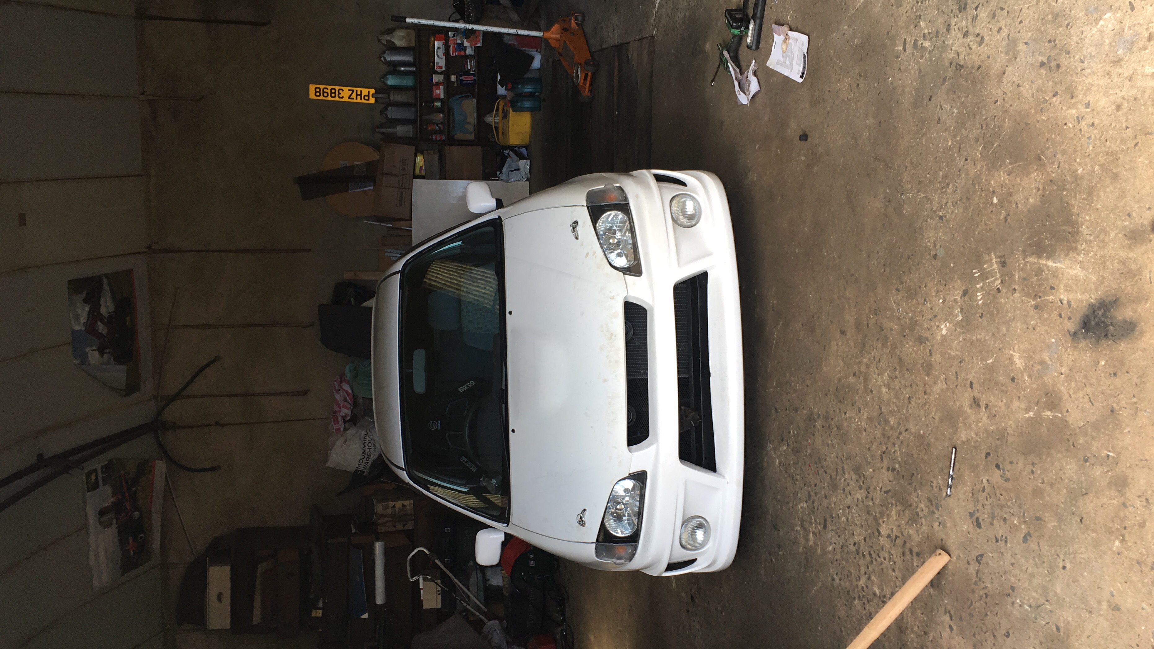

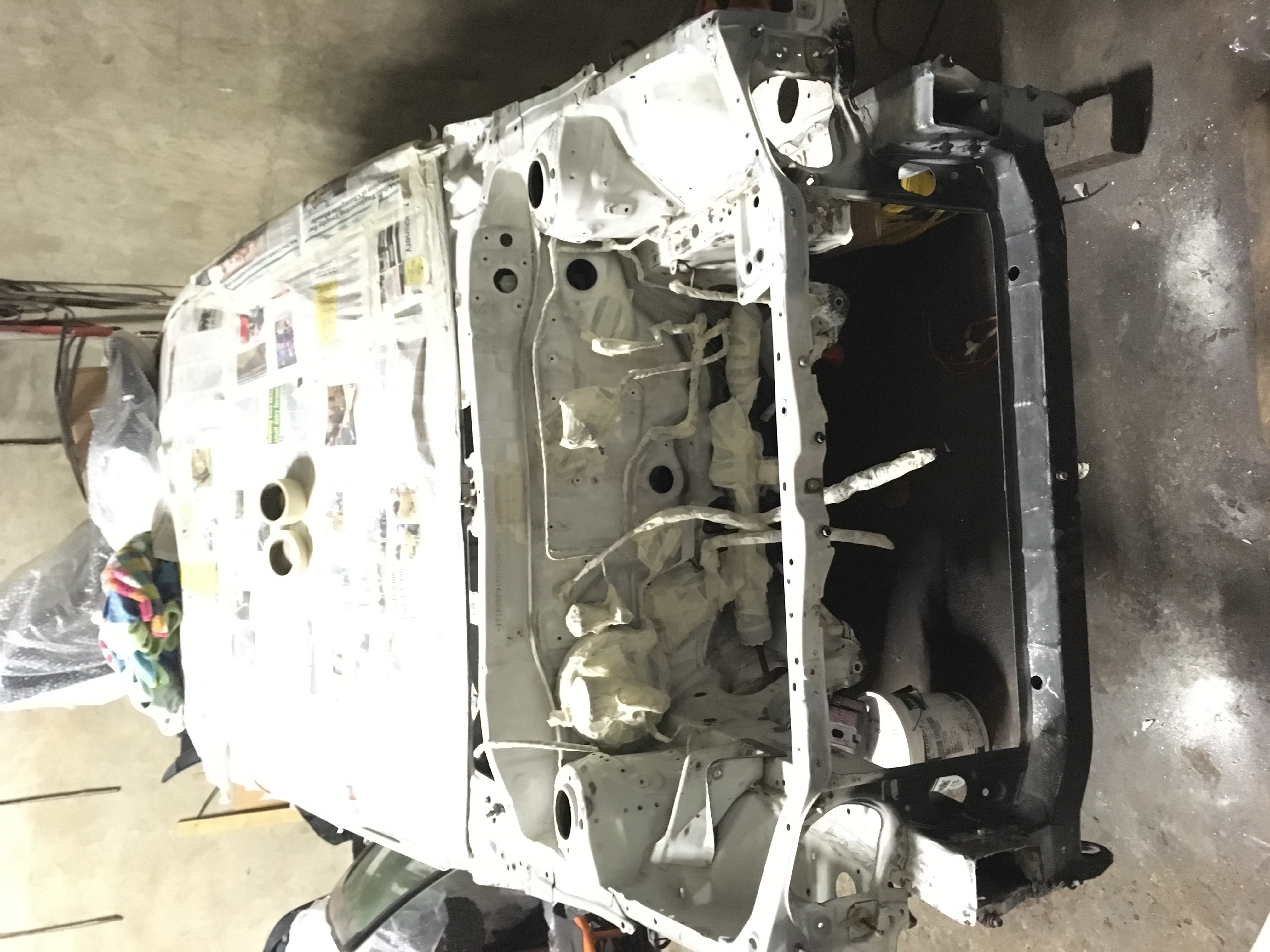

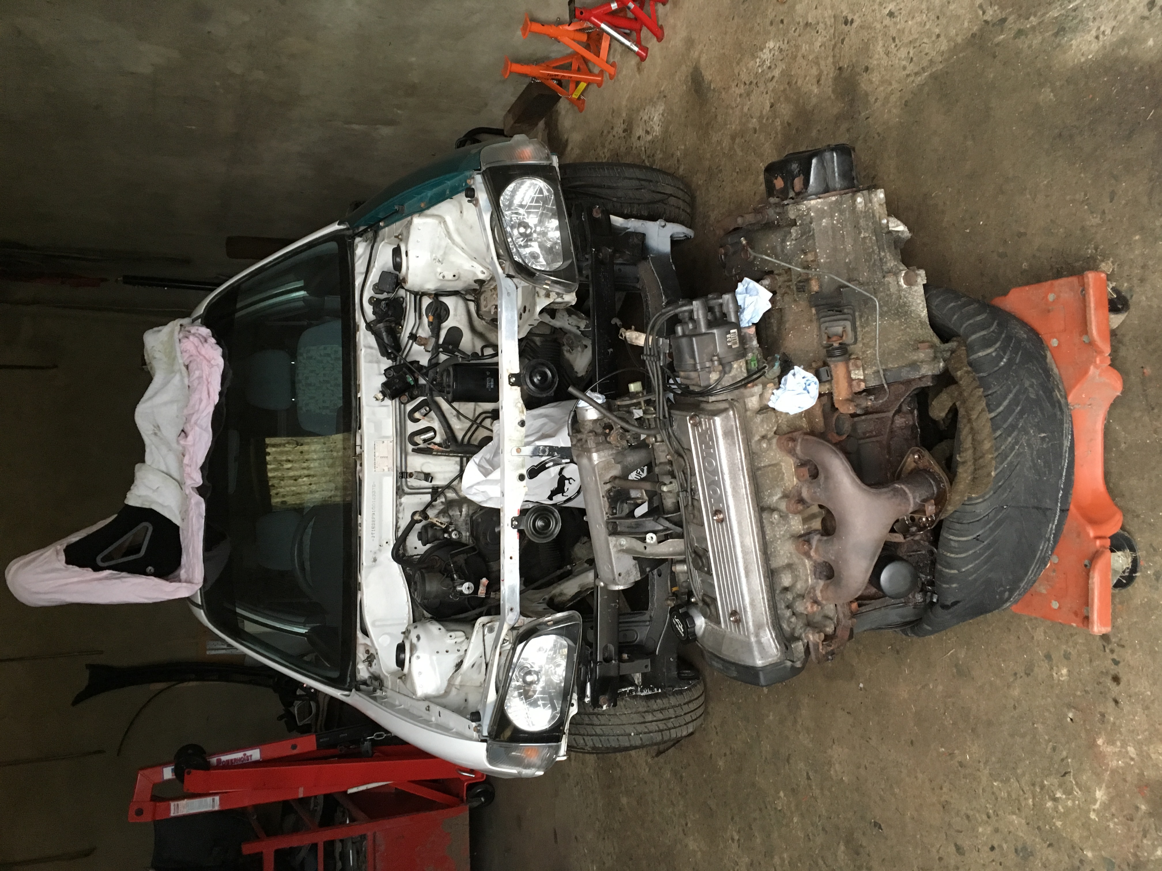

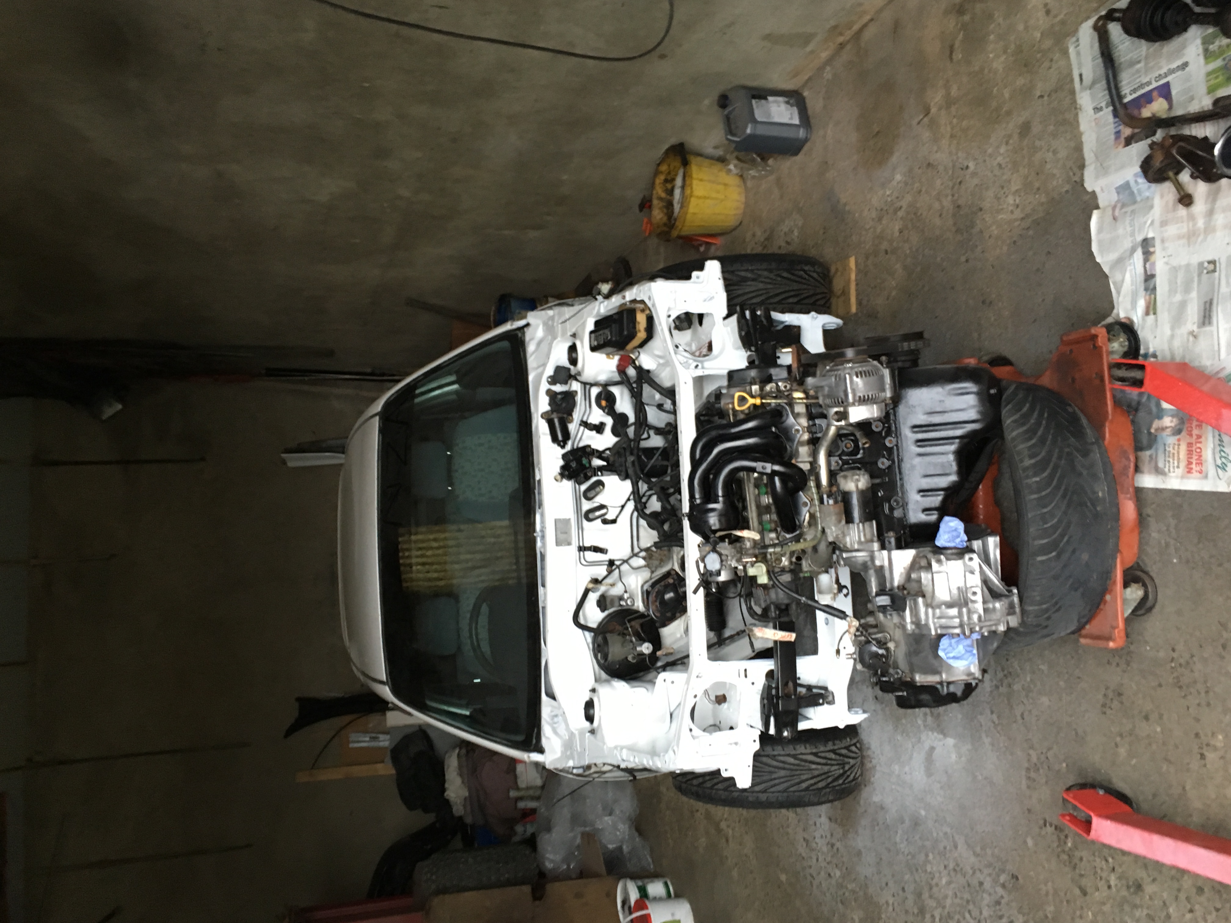

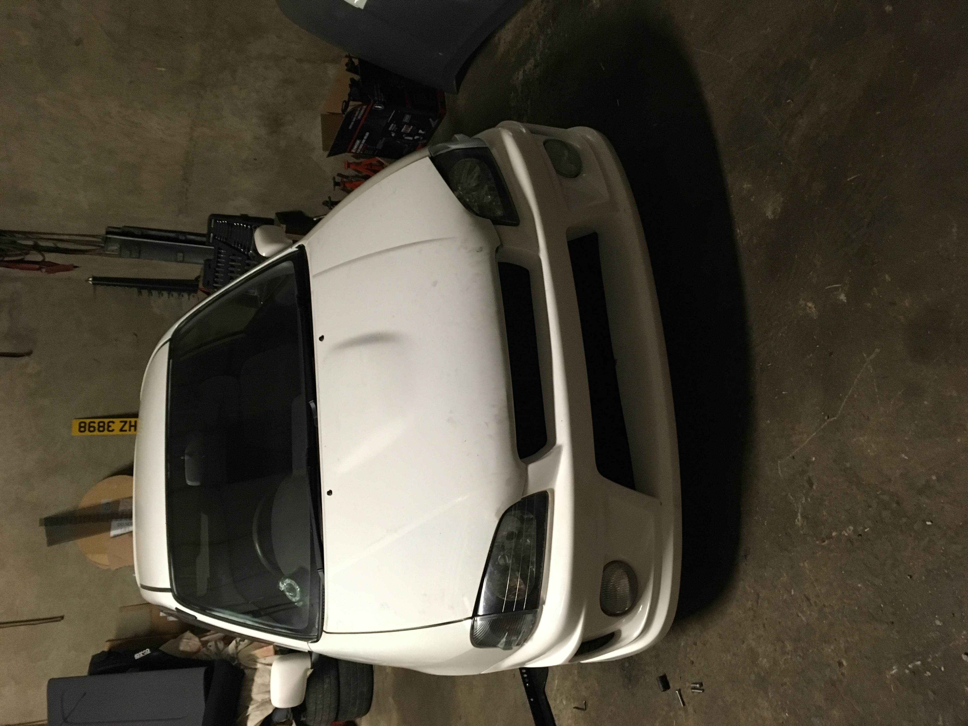

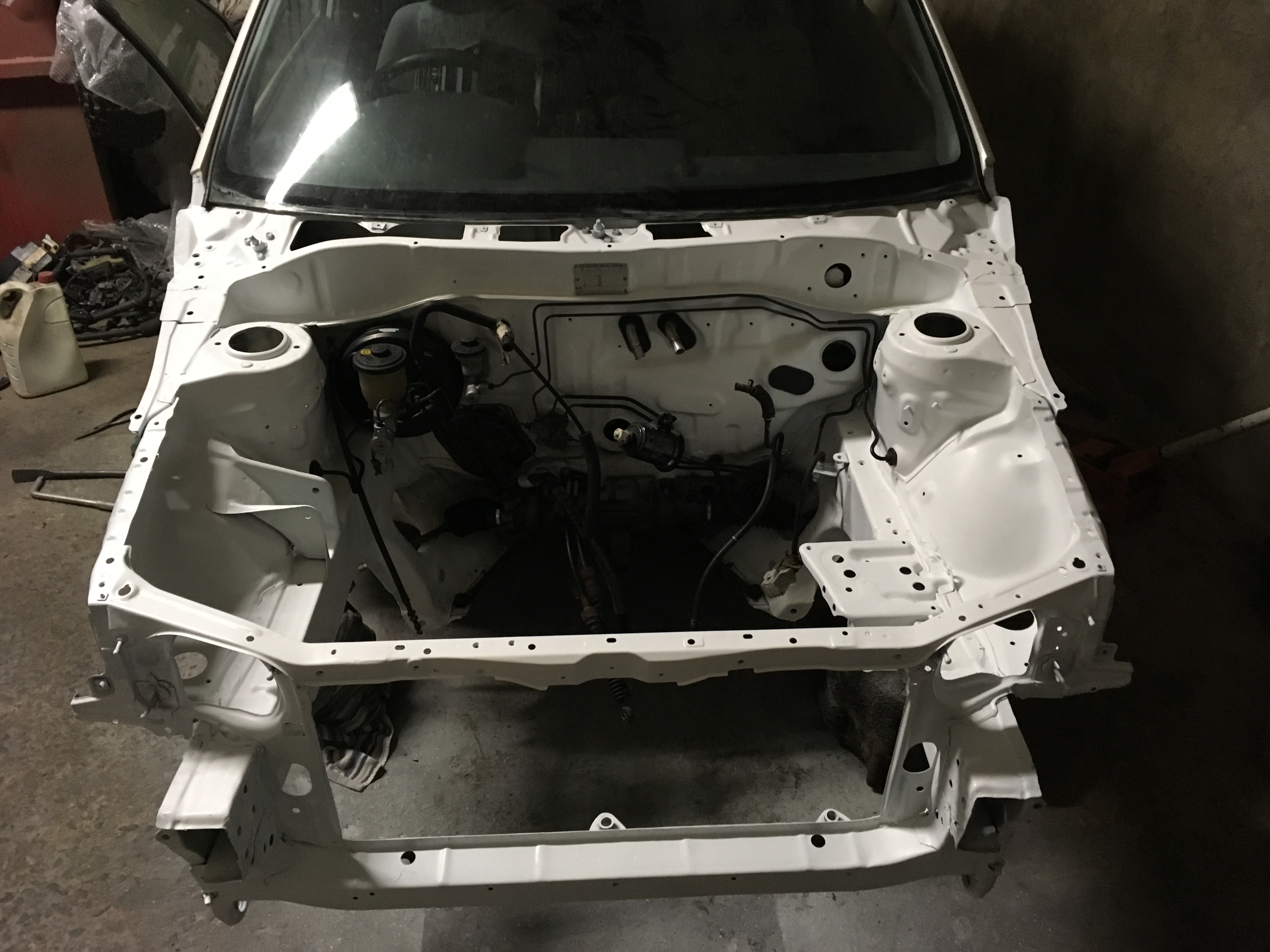

Ryan.Truesdale Posted April 15, 2018 Author Posted April 15, 2018 (edited) Completely stripped the front. All suspension out to be refreshed. Also stripped the engine bay to paint it. Edited April 15, 2018 by Ryan.Truesdale Quote

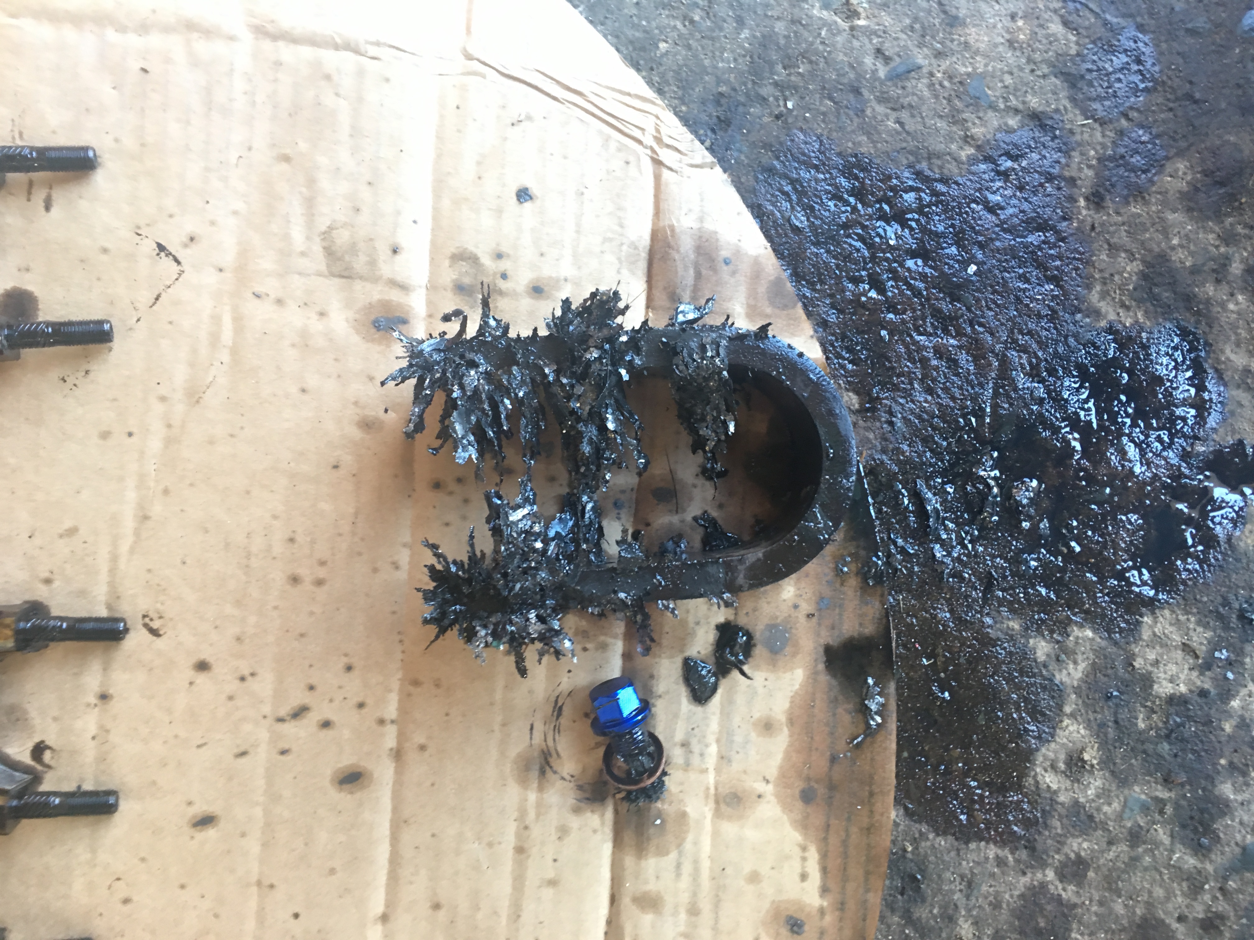

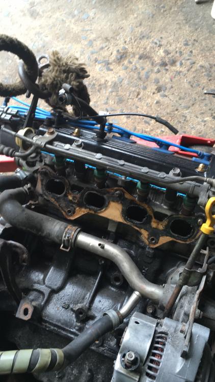

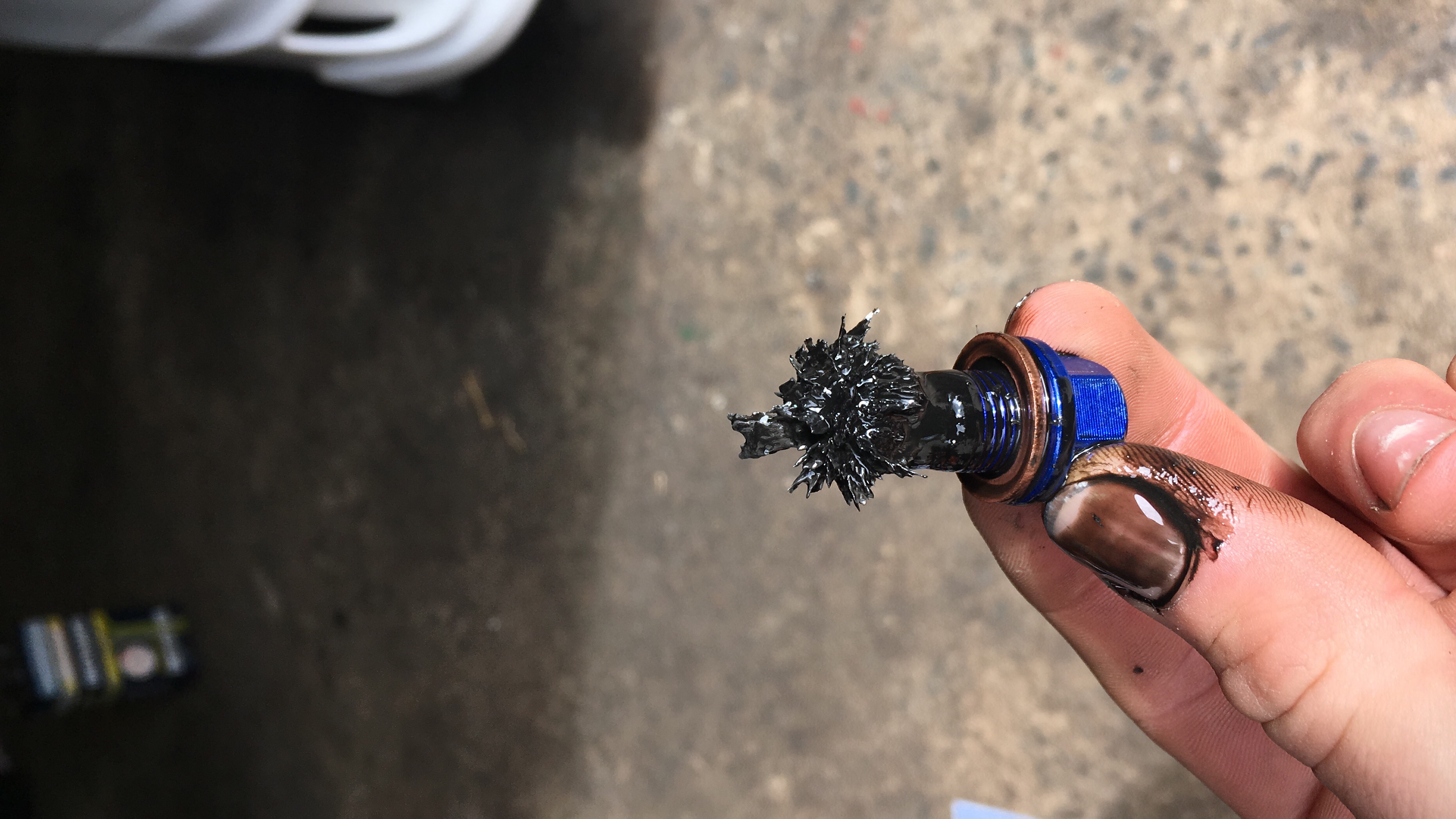

Ryan.Truesdale Posted April 15, 2018 Author Posted April 15, 2018 Refreshed the engine with a lick of paint as the block was a bit crusty. (This turned out to be a waste of time and paint) Also fitted a corrola intake manifold,  magnetic sump plug and serviced the engine. Quote

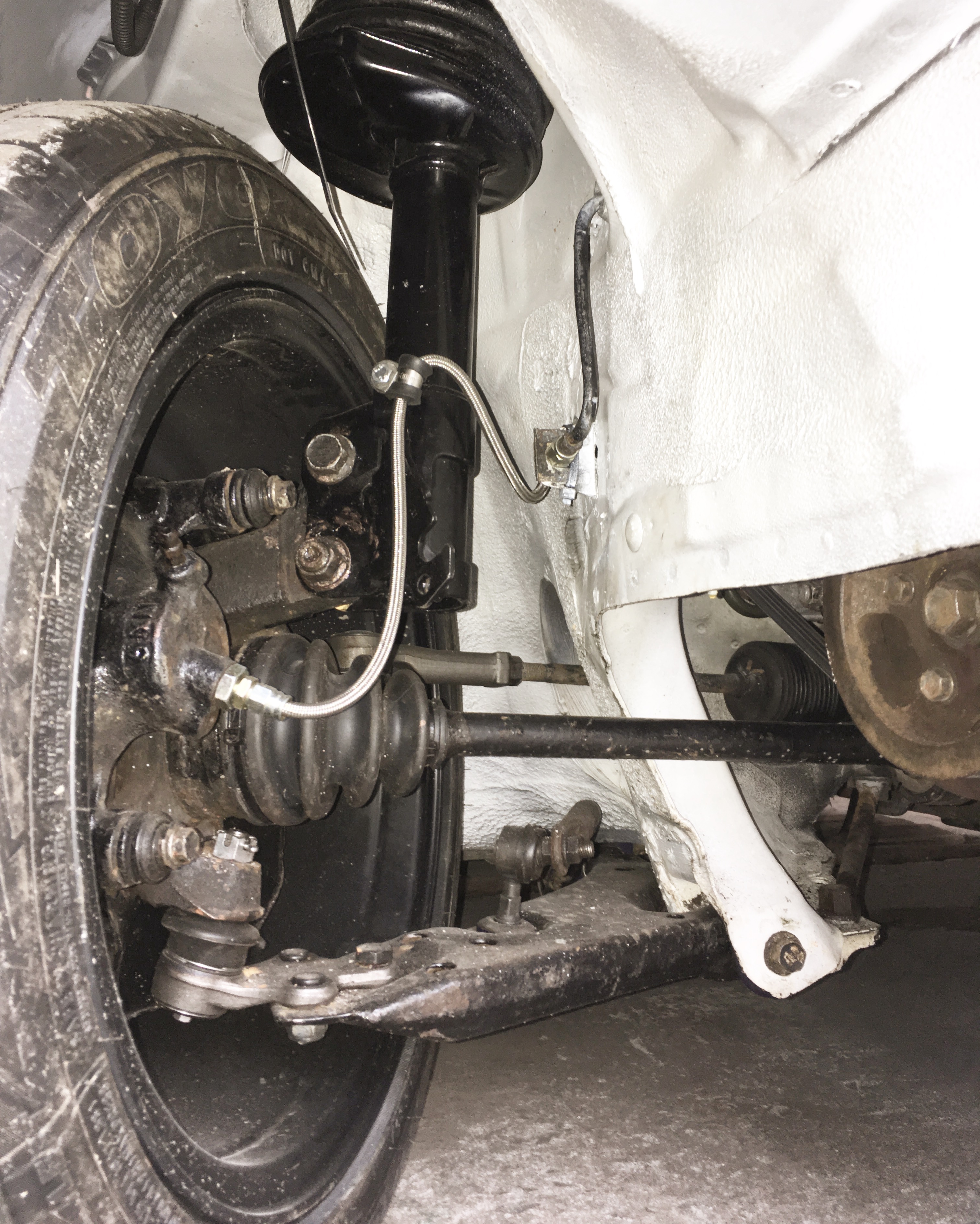

Ryan.Truesdale Posted April 15, 2018 Author Posted April 15, 2018 Suspension time! The front wishbones received a fresh set of polybuses and were repainted with hammerite black. I managed to source a very cheap set of lowering springs, rear shocks and new front shocks. I fitted a glanza antiroll bar and polybushed droplinks. New ball joints and trackrod ends were fitted also. I got the brake discs skimmed and put a fresh set of brake pads in along with a set of braided brake lines. Quote

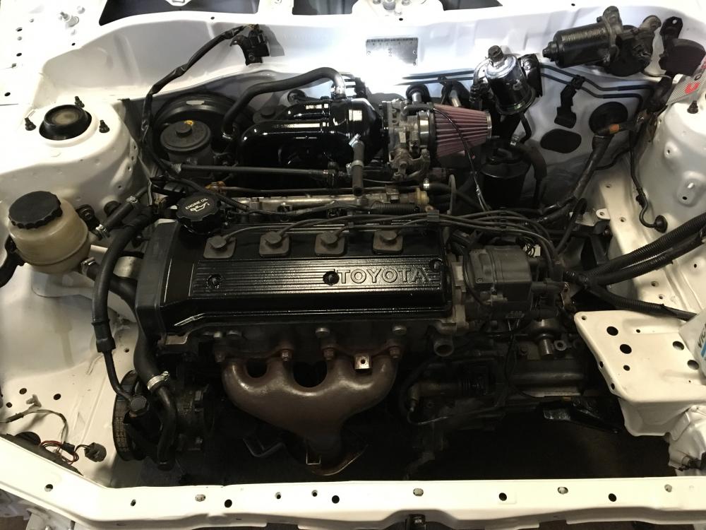

Ryan.Truesdale Posted April 15, 2018 Author Posted April 15, 2018 (edited) Engine in! Took me a very long time to get it going though. I forgot to sand the earths back to metal oops. Other than that no issues. Â Â Edited April 17, 2018 by Ryan.Truesdale Quote

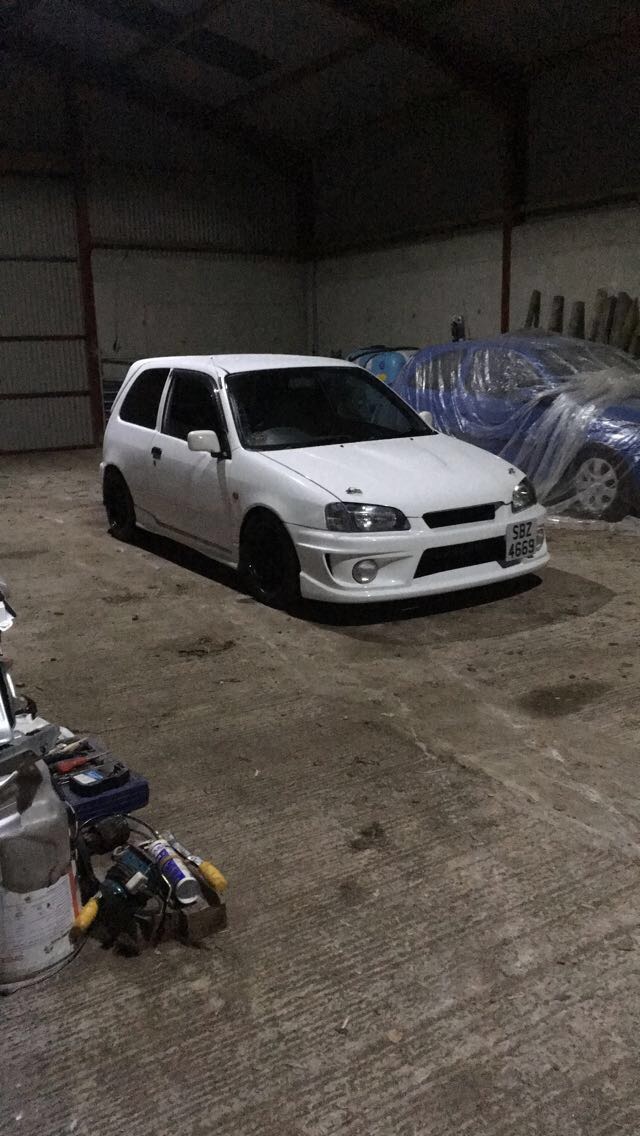

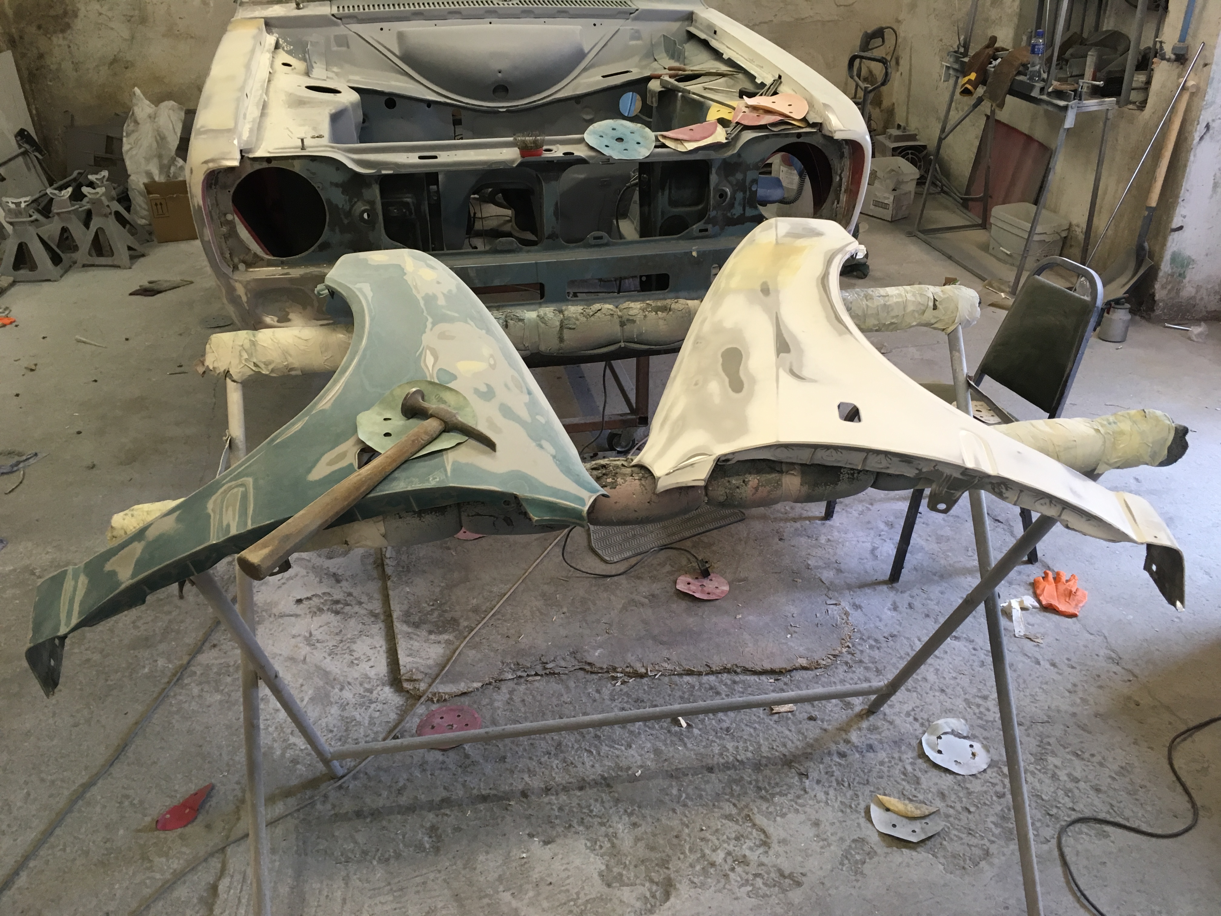

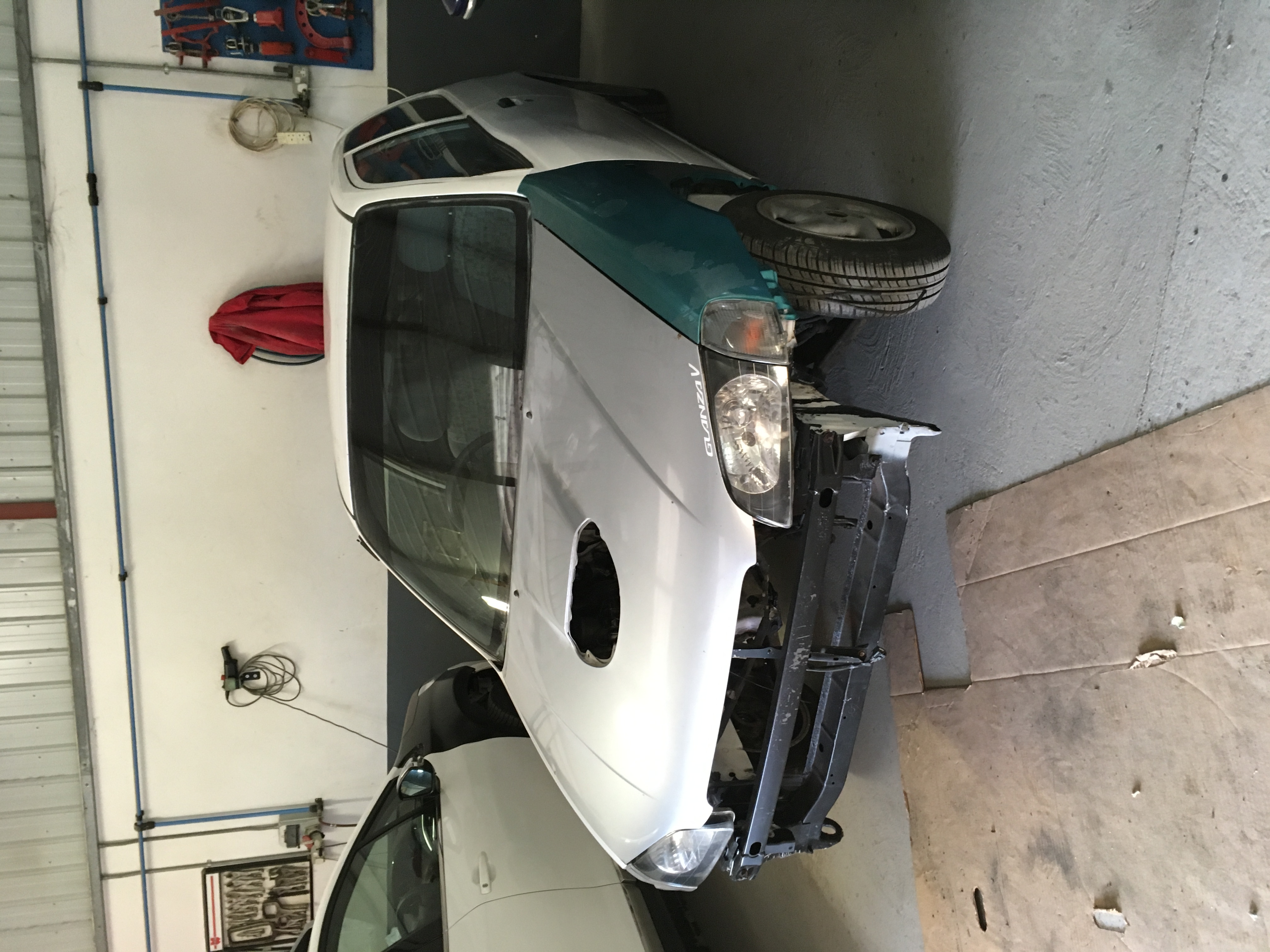

Ryan.Truesdale Posted April 17, 2018 Author Posted April 17, 2018 Painted the wings, bumper and picked up a glanza S bonnet that was slightly damaged but I got it fixed up pretty good. (Bumper and bonnet were not painted in those pictures) Quote

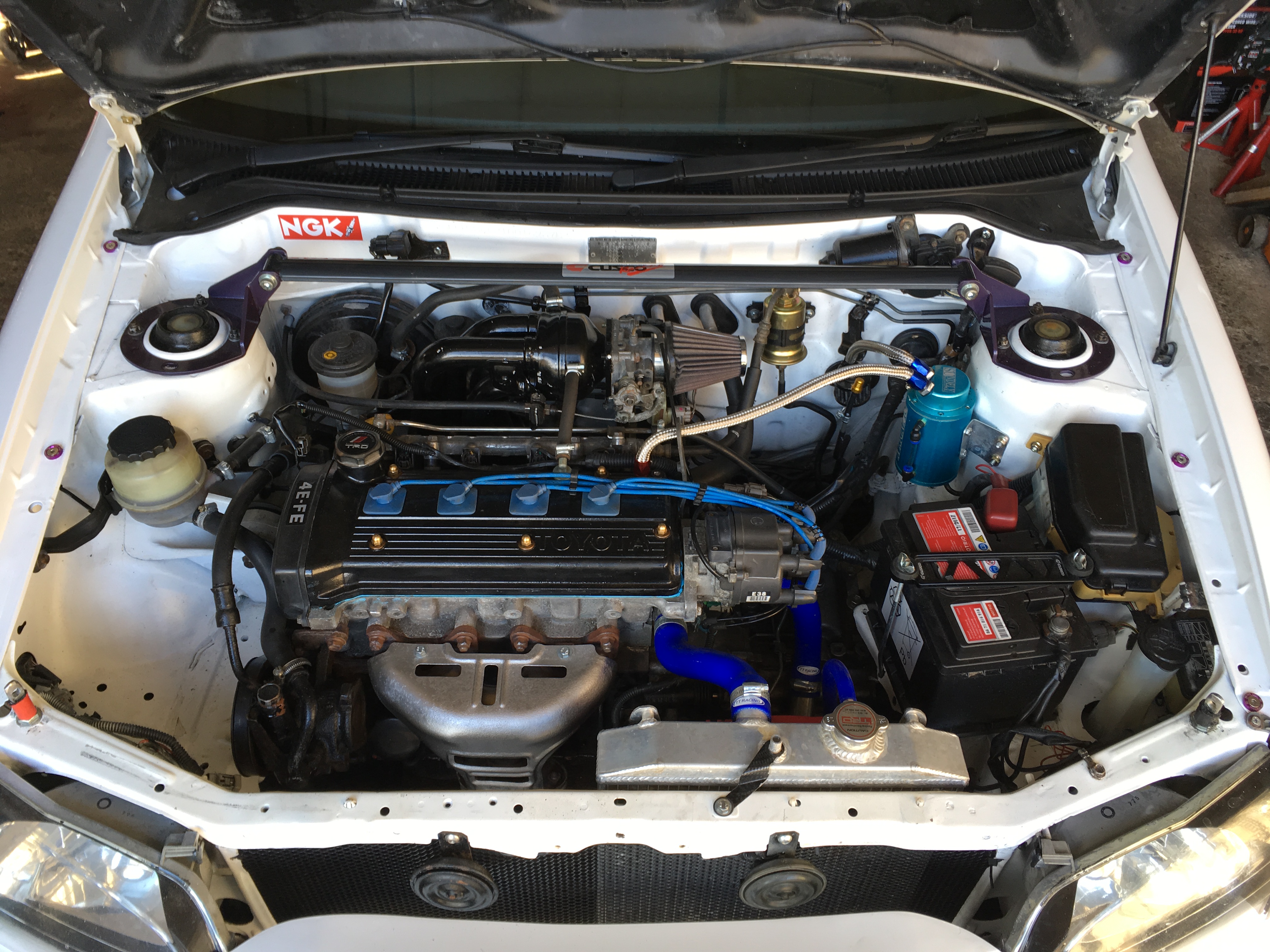

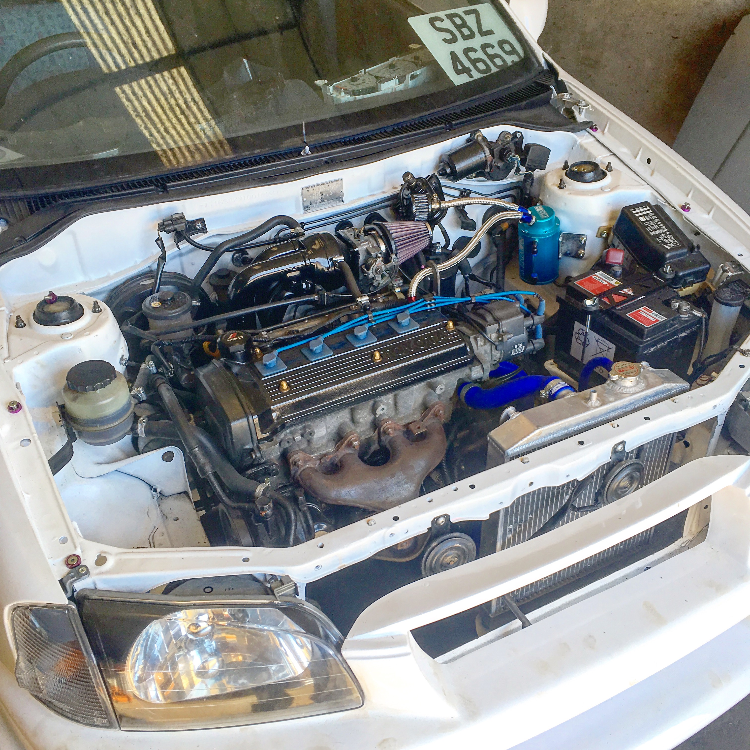

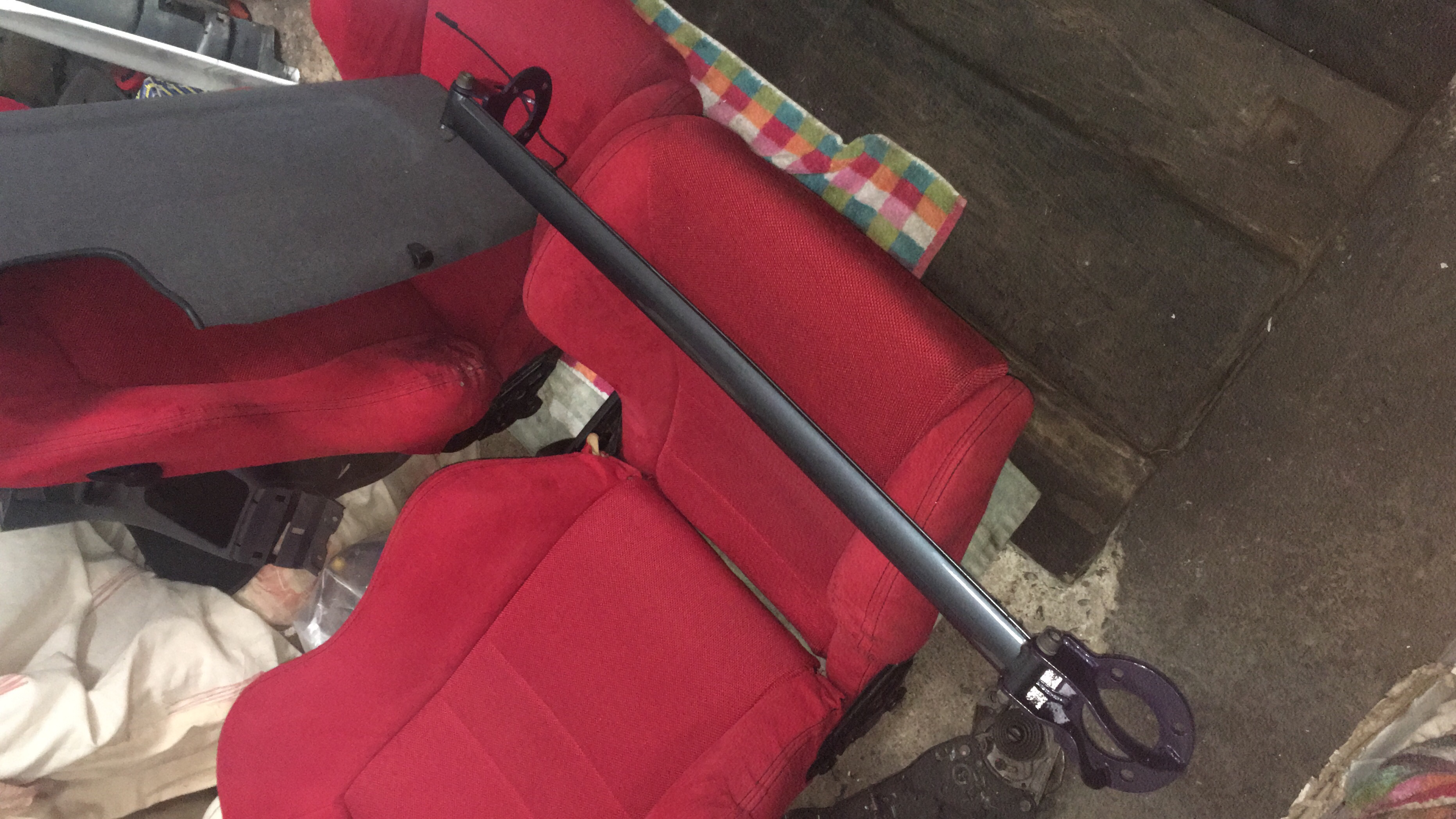

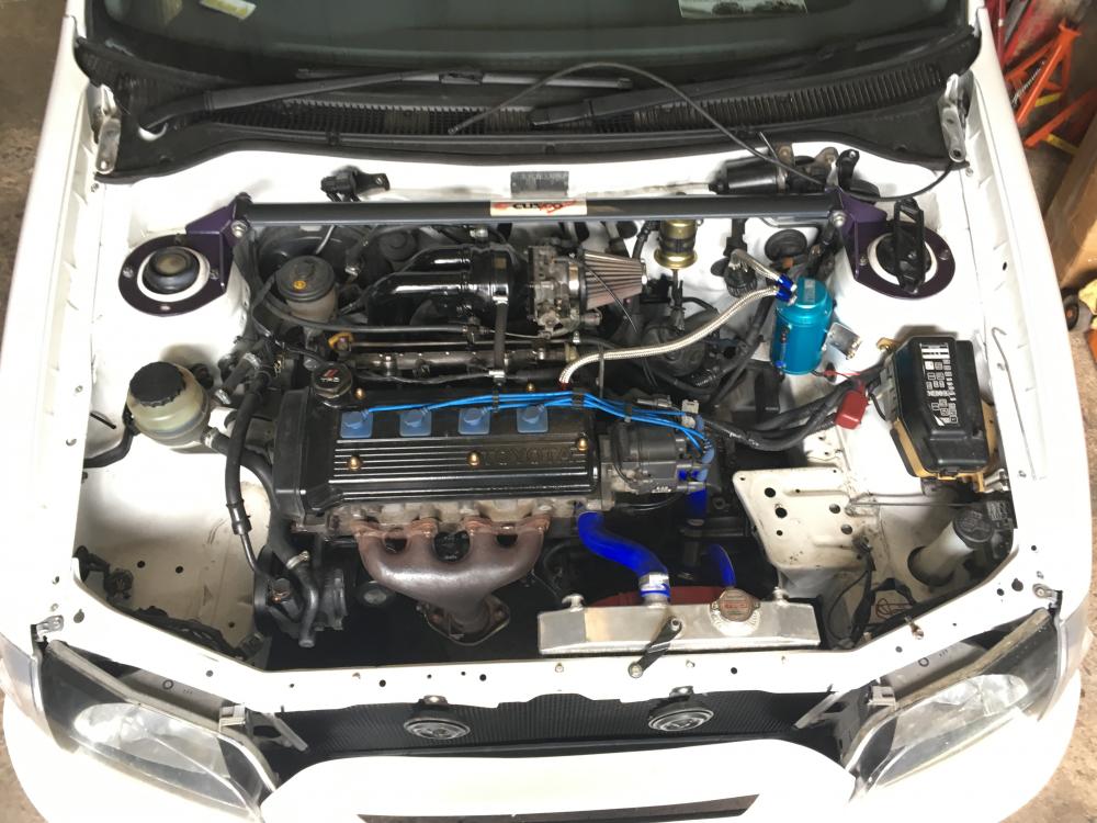

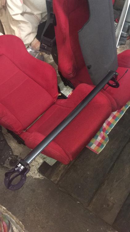

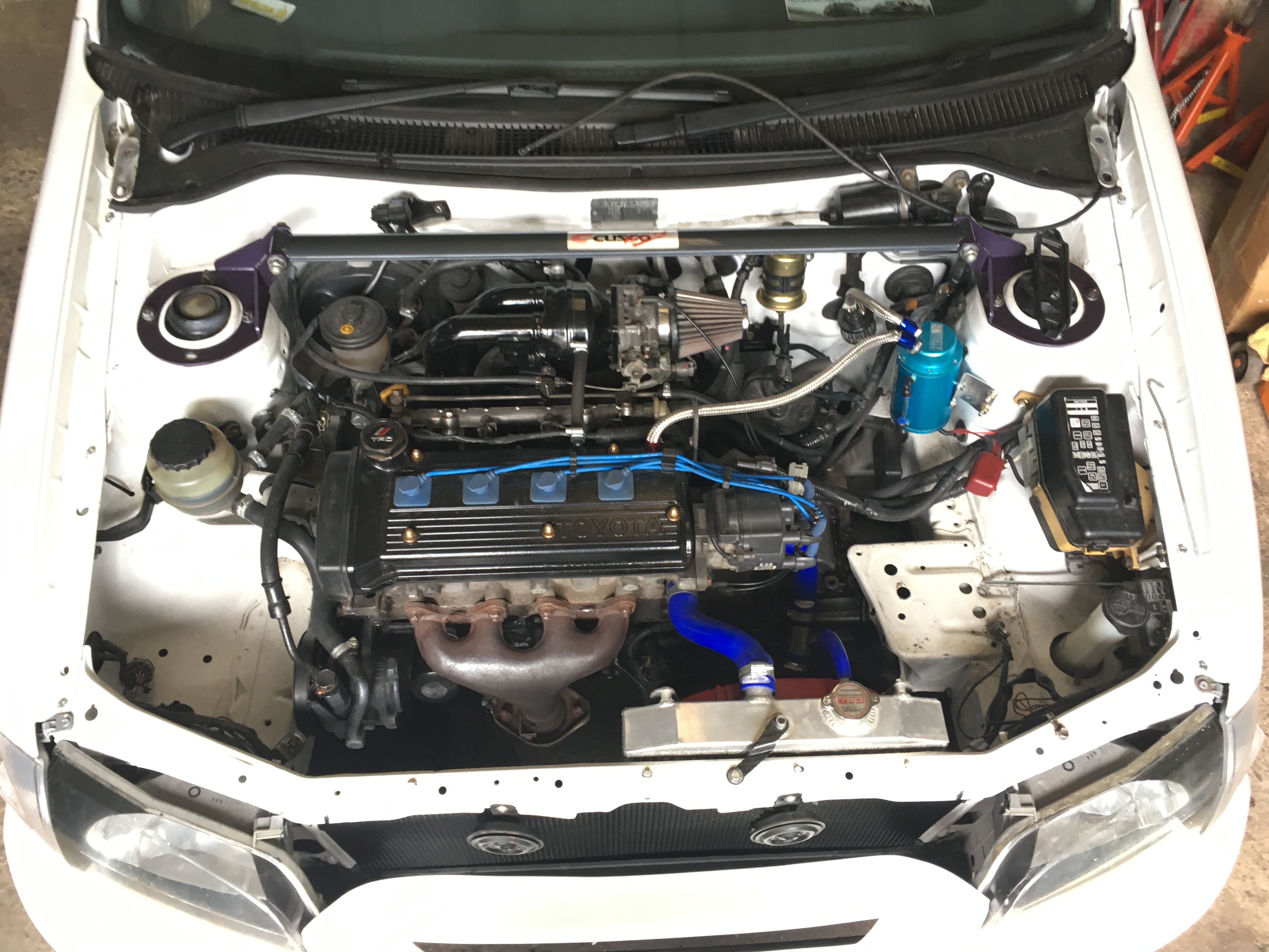

Ryan.Truesdale Posted April 17, 2018 Author Posted April 17, 2018 Pictures of the engine bay after completion. I fitted a half size double core radiator. I made and welded on my own mounts and then ordered up a fresh set of hoses for it. Also picked up front and rear Cusco strut braces. Fitted a catch can also. Quote

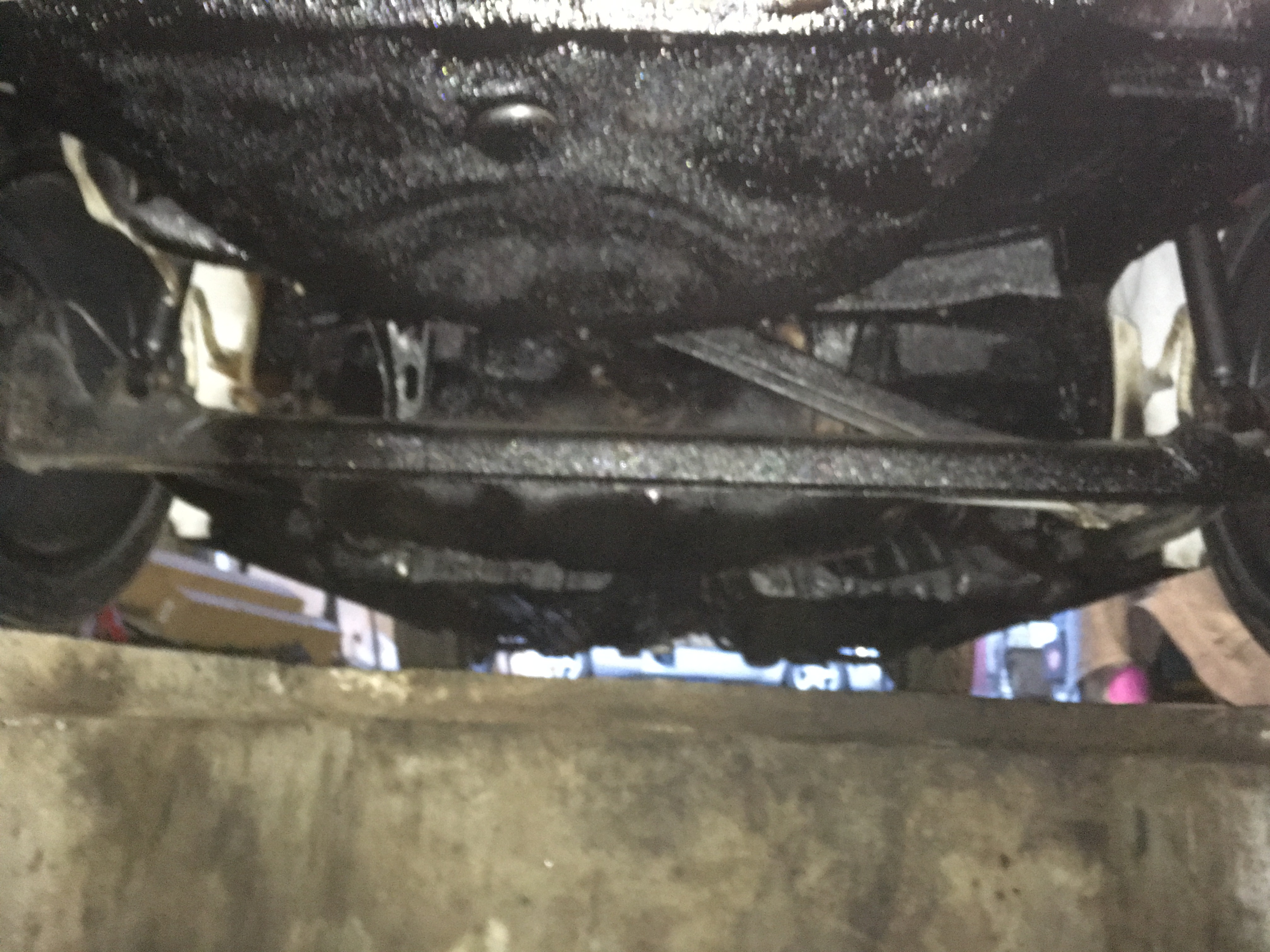

Ryan.Truesdale Posted April 17, 2018 Author Posted April 17, 2018 A bit of waxoil to seal the body. Hateful stuff makes a right mess. Quote

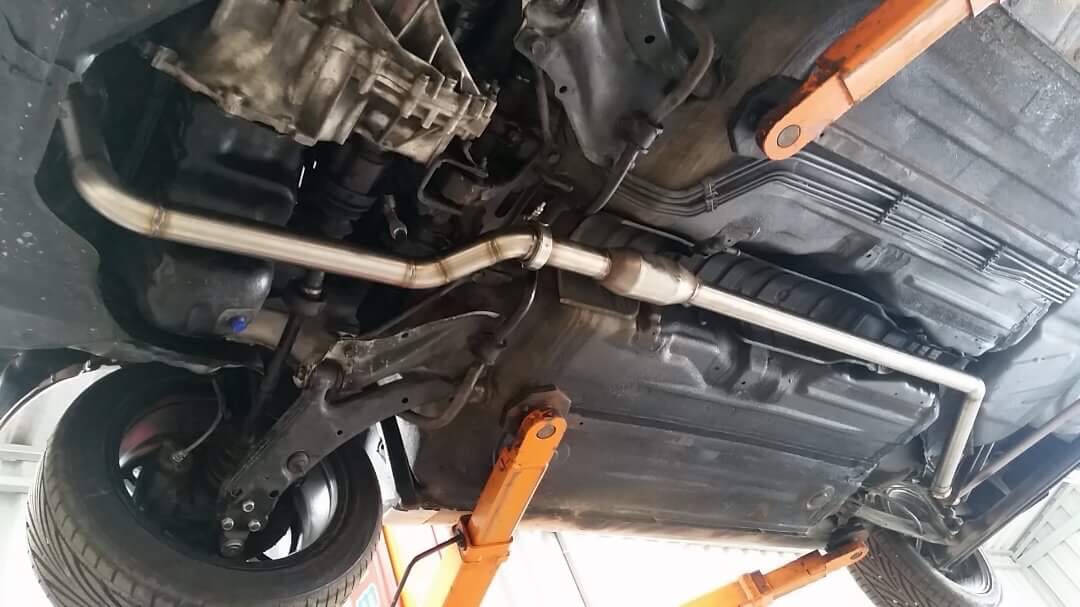

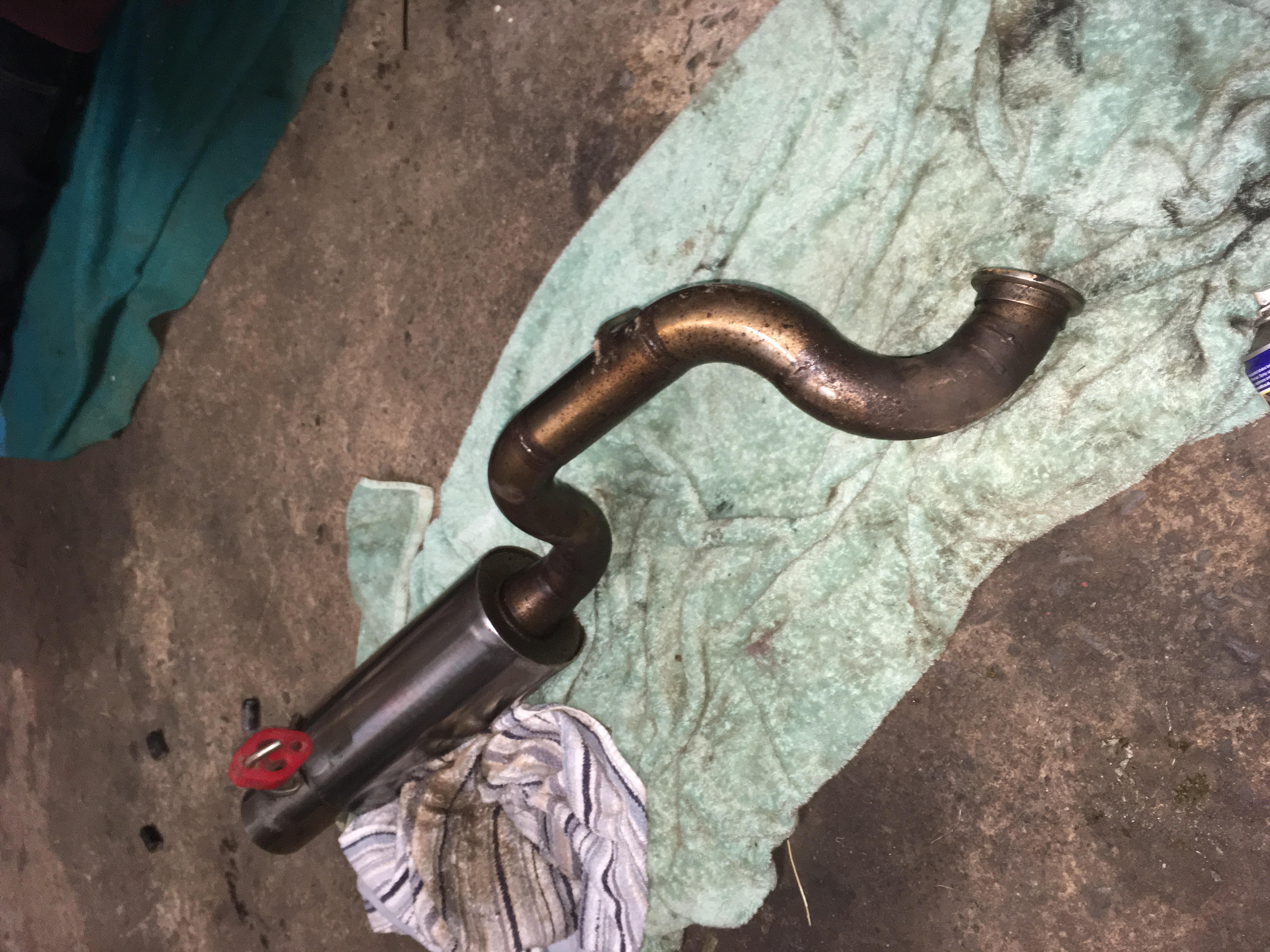

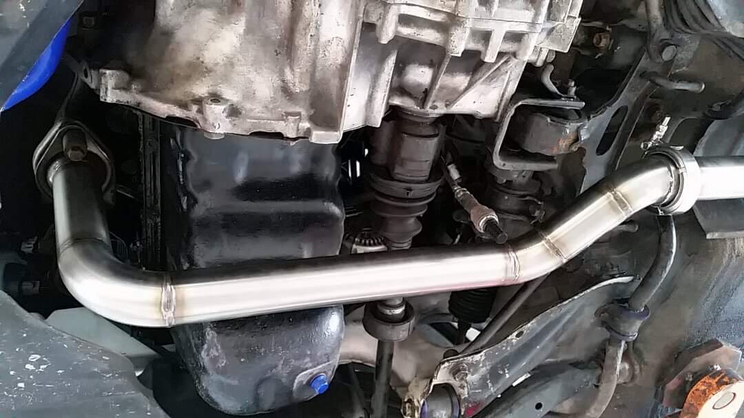

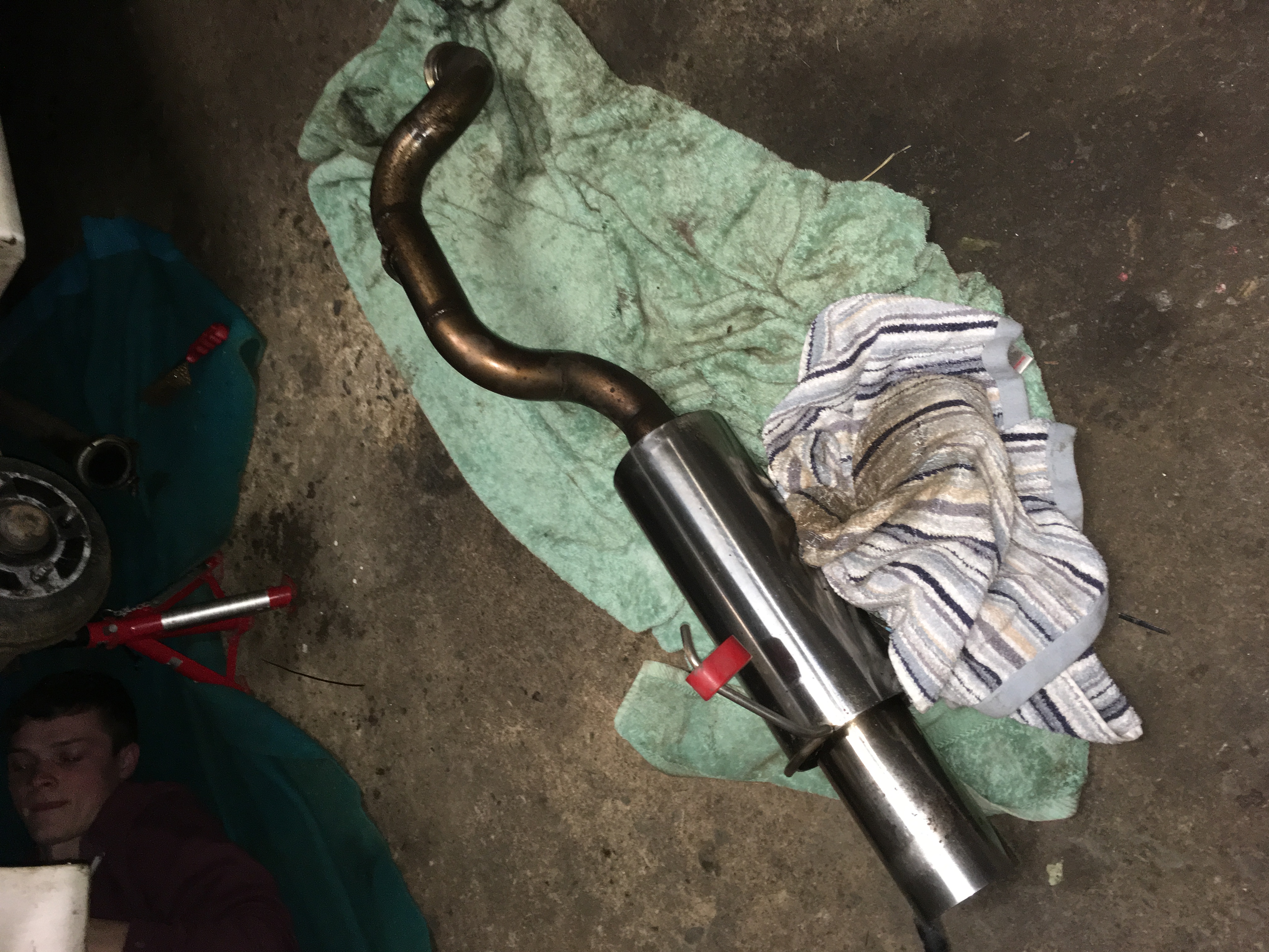

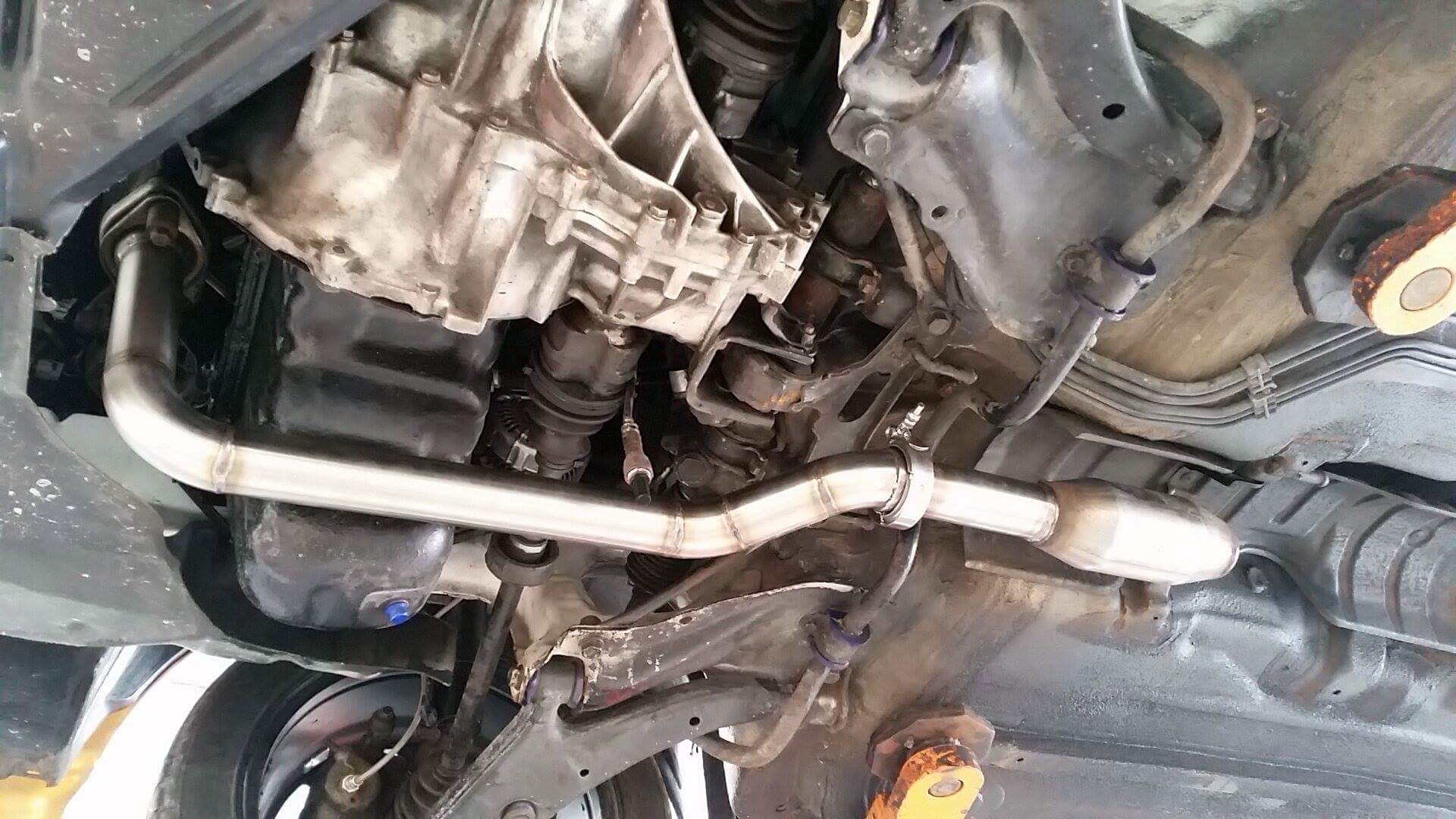

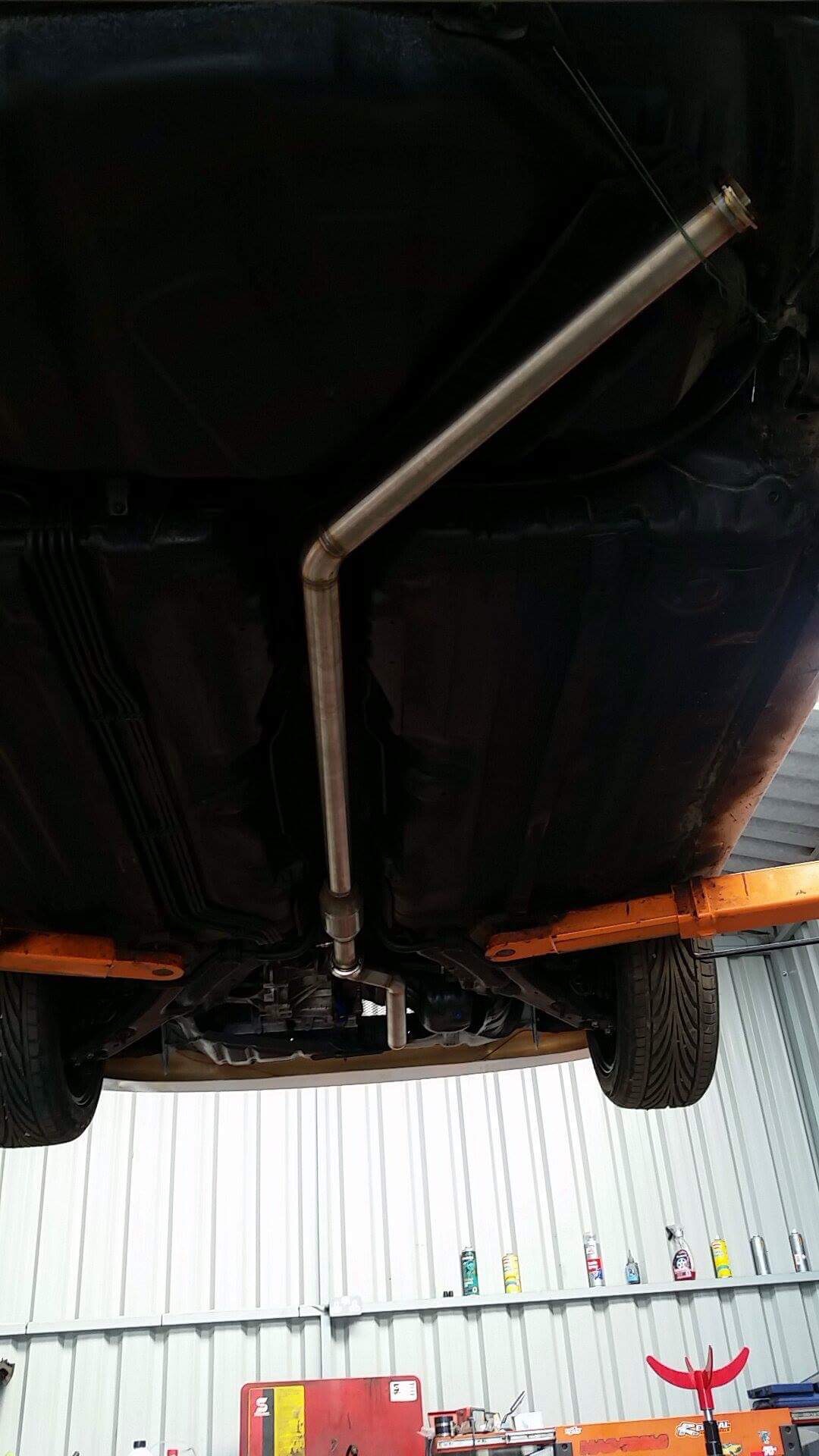

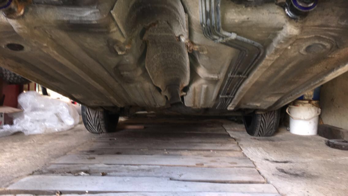

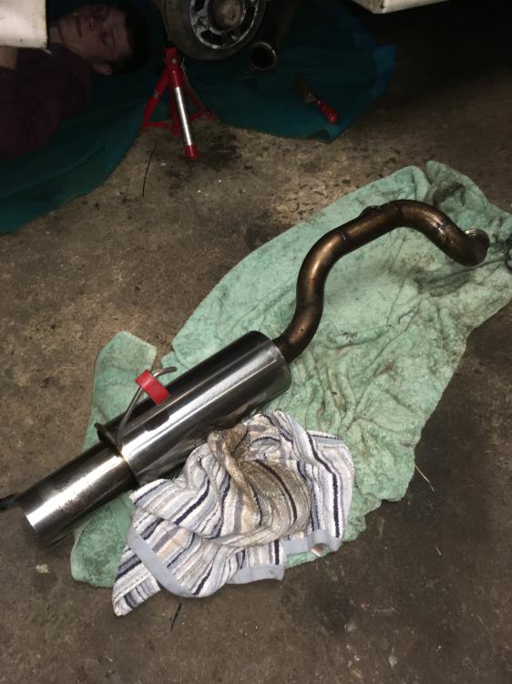

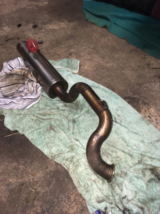

Ryan.Truesdale Posted April 17, 2018 Author Posted April 17, 2018 I was originally only going to put a steel exhaust on but I was convinced otherwise as you can see. This was custom made using 2" stainless pipe and v-band flanges. The small silencer is actually from an evo however it looks a lot like a cat so we put it up near the front. The pictures of the back box are recent ones. It actully sounds pretty damn good I was very concerned that it would sound like a Corsa or a 1.4 civic. Quote

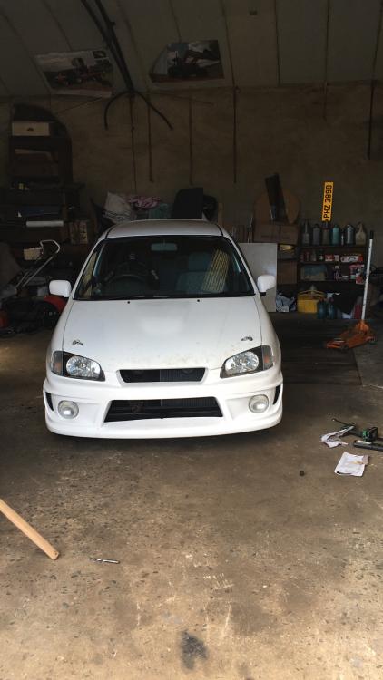

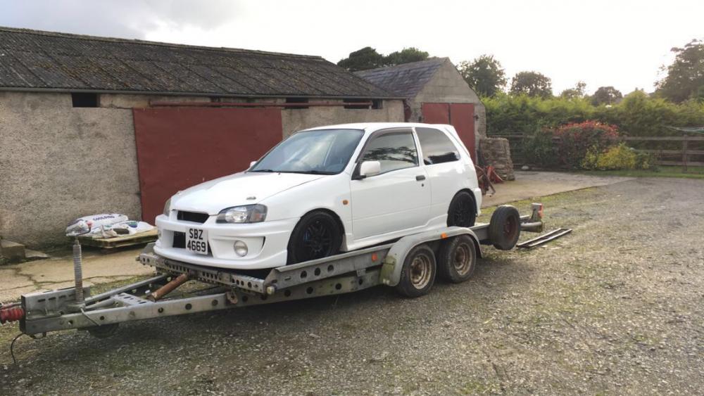

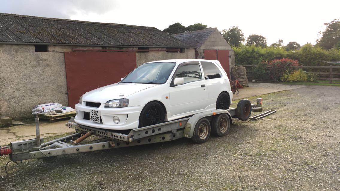

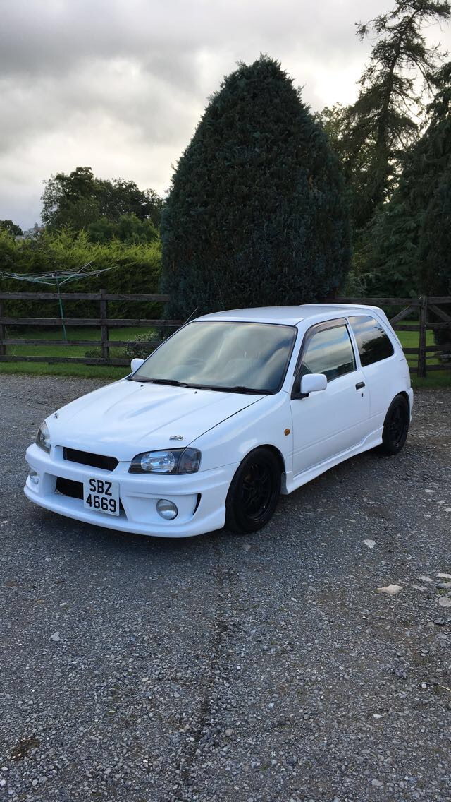

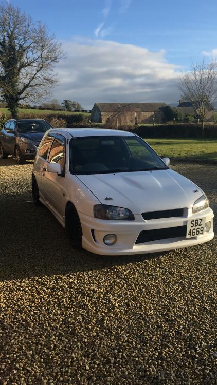

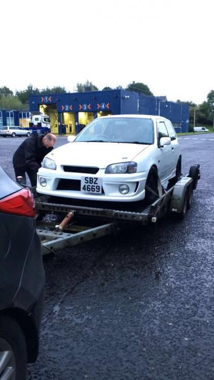

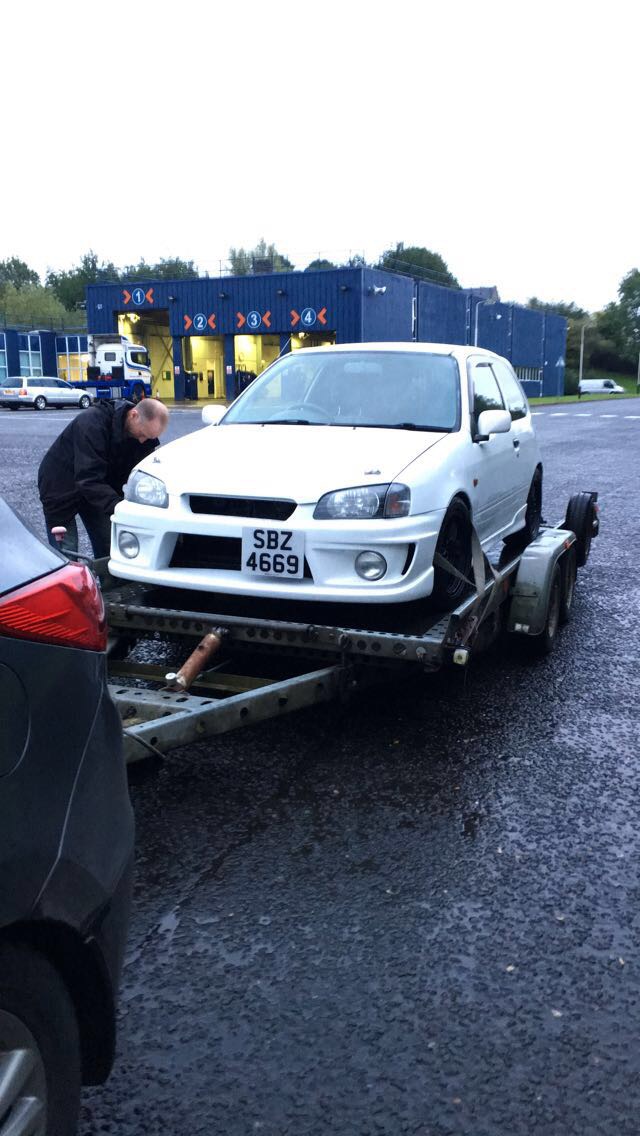

Ryan.Truesdale Posted April 17, 2018 Author Posted April 17, 2018 The finished product! Off to mot Trailered it there as I hadn't insured it yet. Front window washers stopped working after taking it off the trailer but other than that no issues and it flew through. Quote

Ryan.Truesdale Posted April 17, 2018 Author Posted April 17, 2018 Drained the engine of oil. Of which there was about a pint of.... oh dear. I knew the engine was burning oil but I didn't quite realise how much. This was within 3 weeks of me getting the car finished. I was actually surprised that I was actually quite calm and not really that annoyed about it blowing up, it was more an inconvenience than anything else. Quote

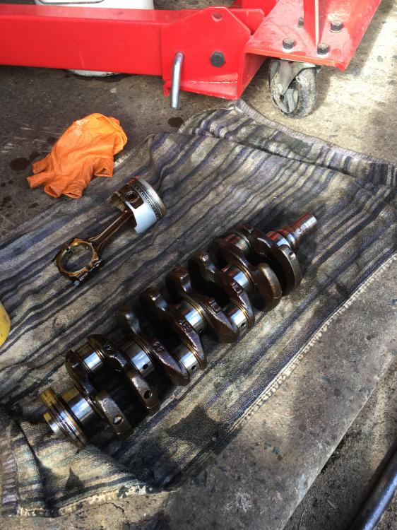

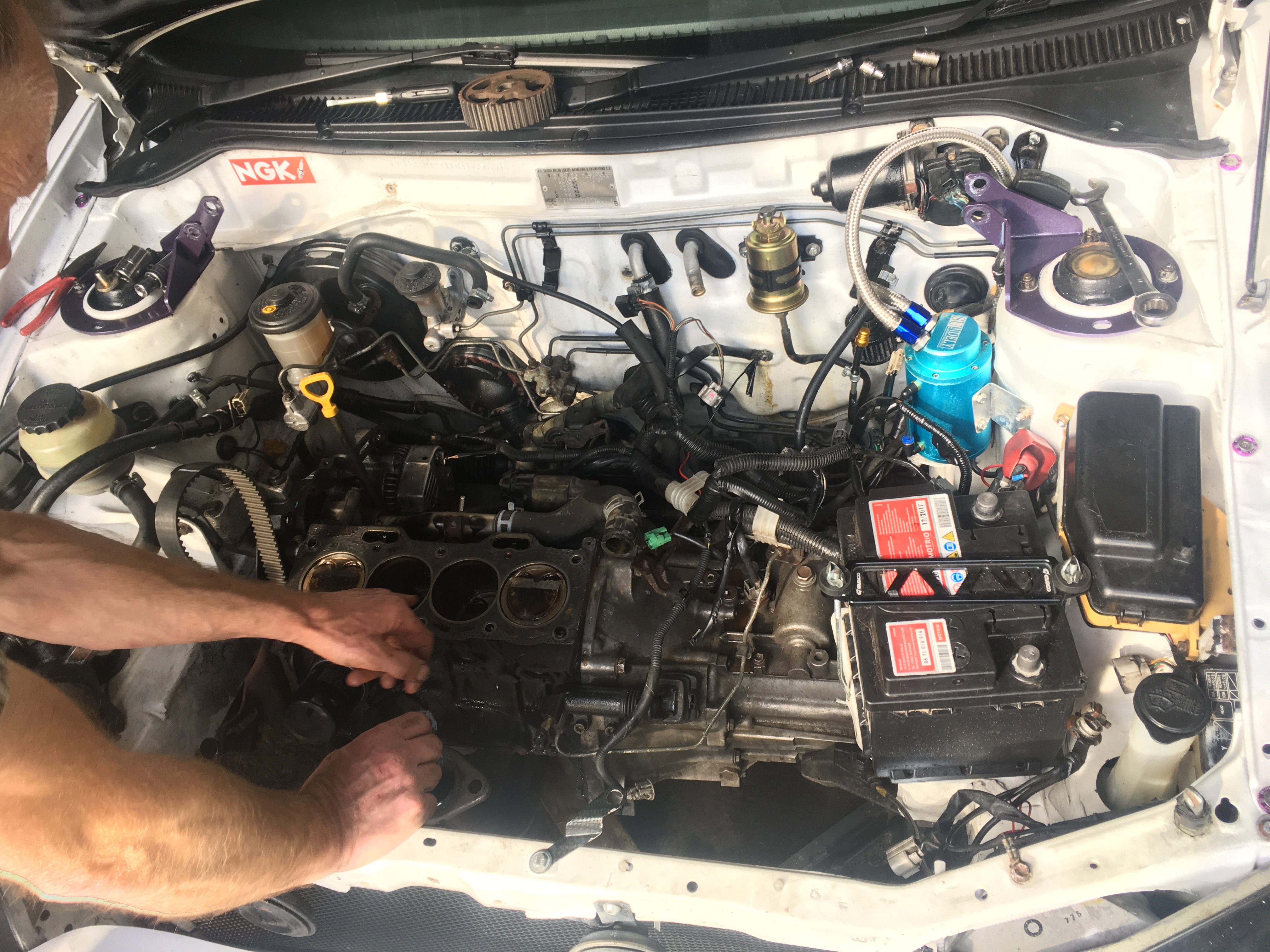

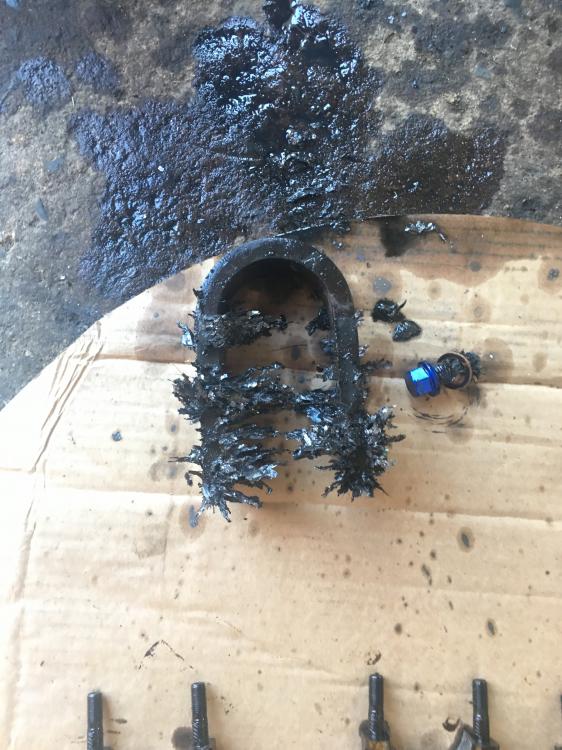

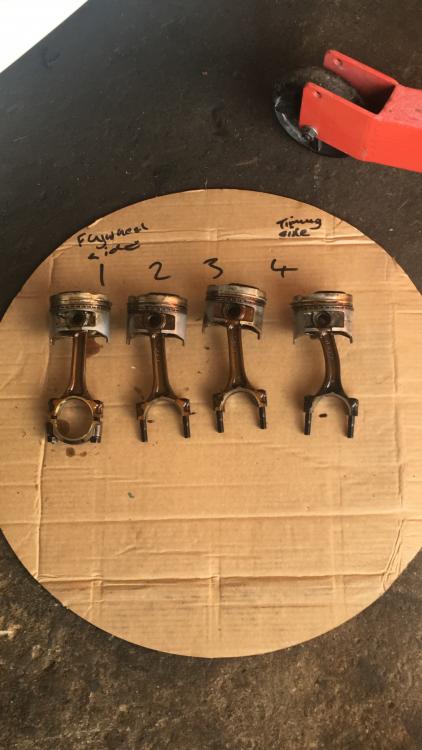

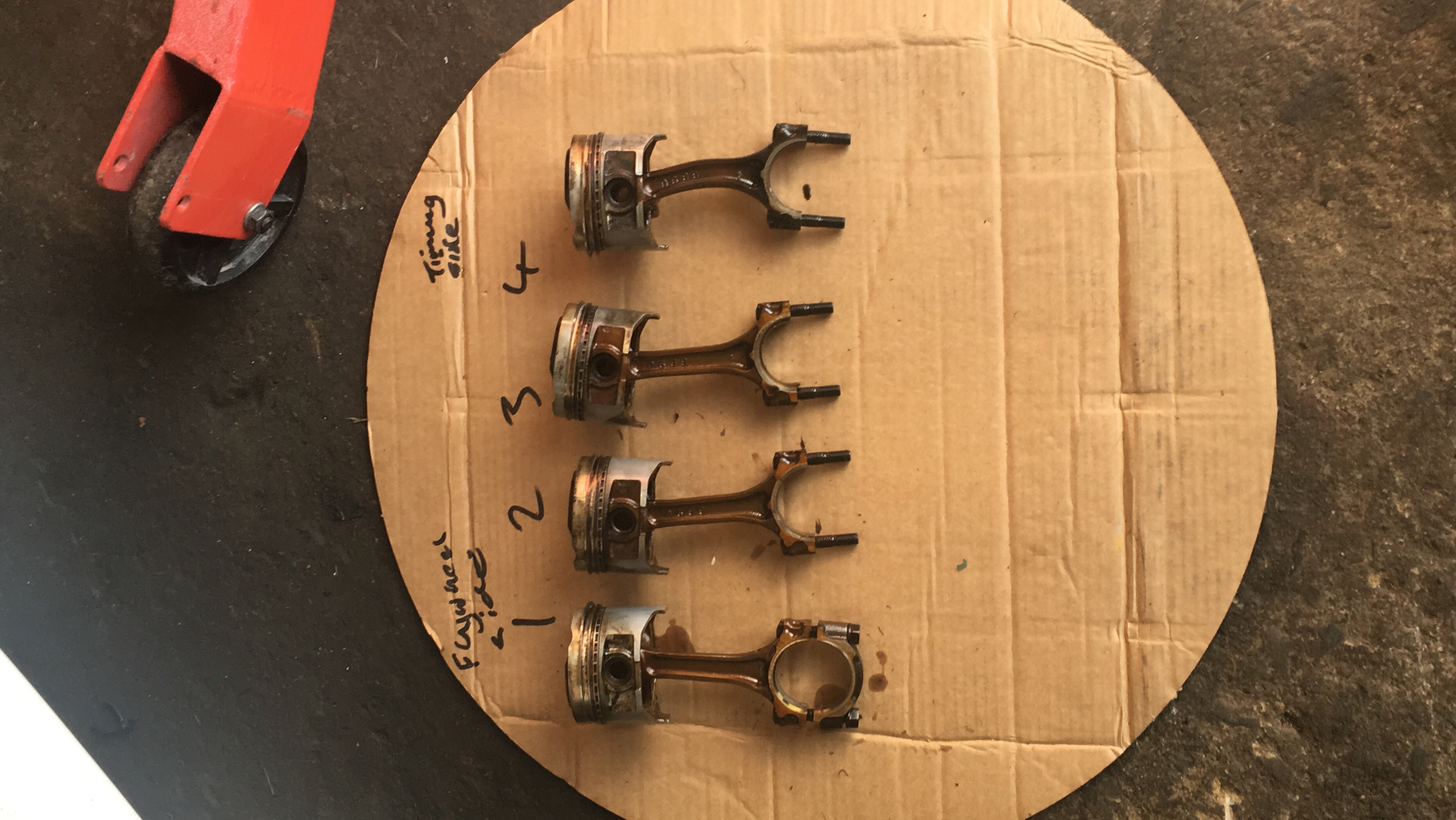

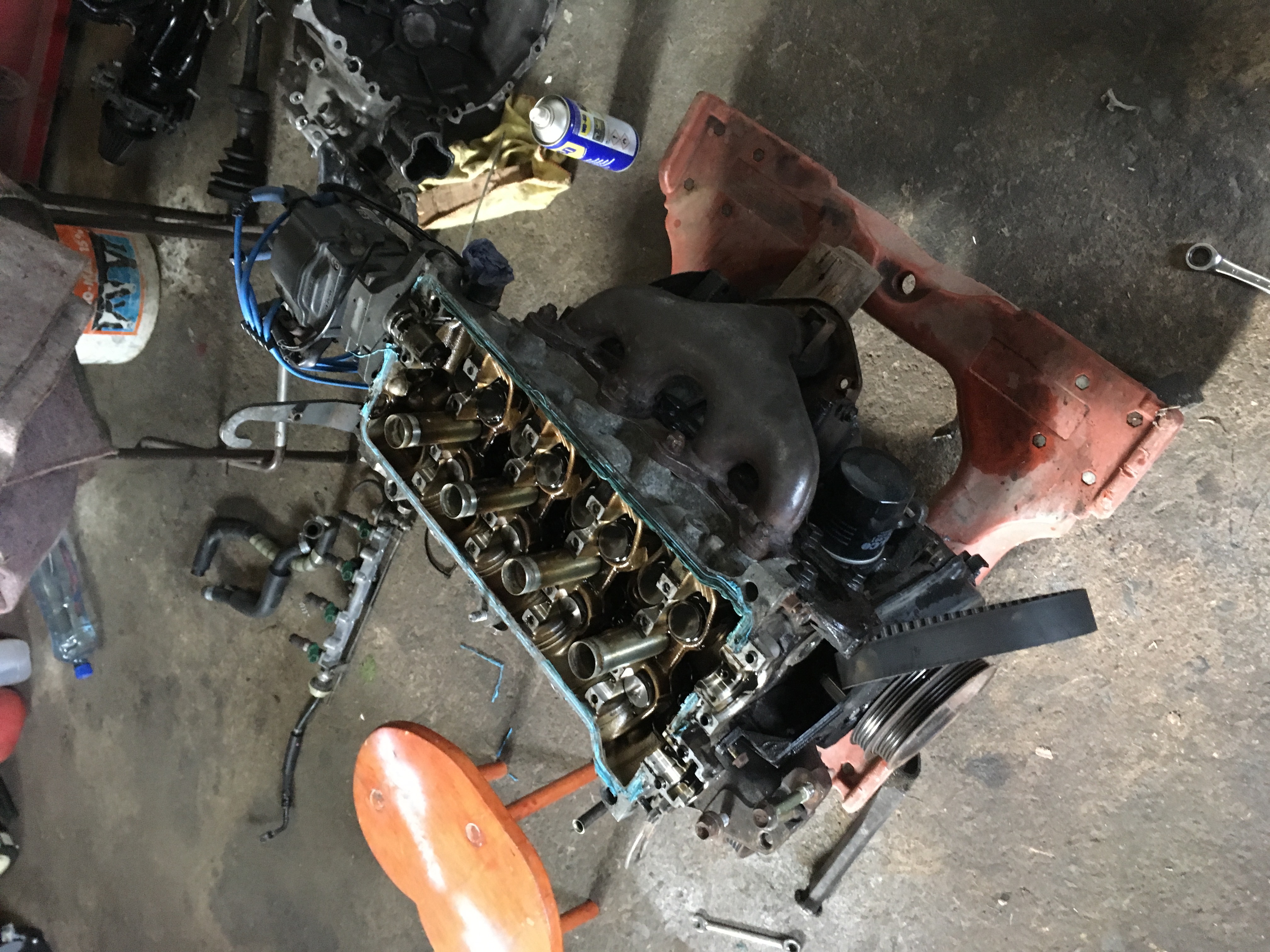

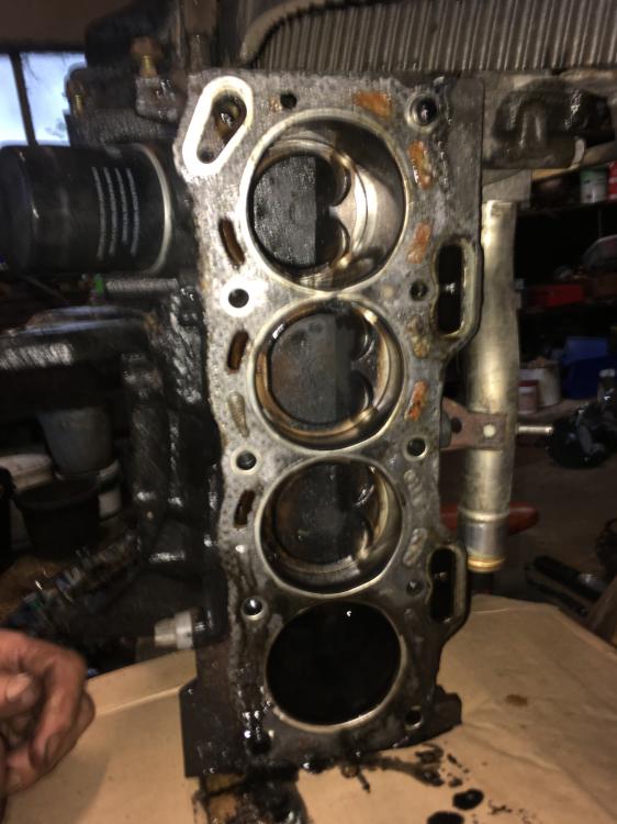

Ryan.Truesdale Posted April 17, 2018 Author Posted April 17, 2018 Decided I'd pull the engine apart see what damage had been done and possibly rebuild it. This was the first time I ever took an engine apart (and it wouldn't be the last).  There was a stupid amount of oil in the intake, some actually can out of the manifold as I took it off. The pistons were black with oil and the sump was full of what was left of the bearings.  Then to top it off a bent conrod! Quote
Ryan.Truesdale Posted April 17, 2018 Author Posted April 17, 2018 Decided I was going to rebuild it as there was no damage to the block. So I  sent the crank to get polished and got oversized bearings to match it. But could I find a conrod? Nope. I then ended up just buying an engine. This new one supposedly only had 80.000 miles and came from a granny's car but I had no proof. So I took a gamble on it... bad decision LoL Quote

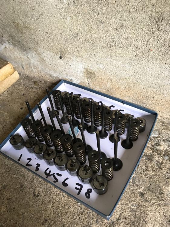

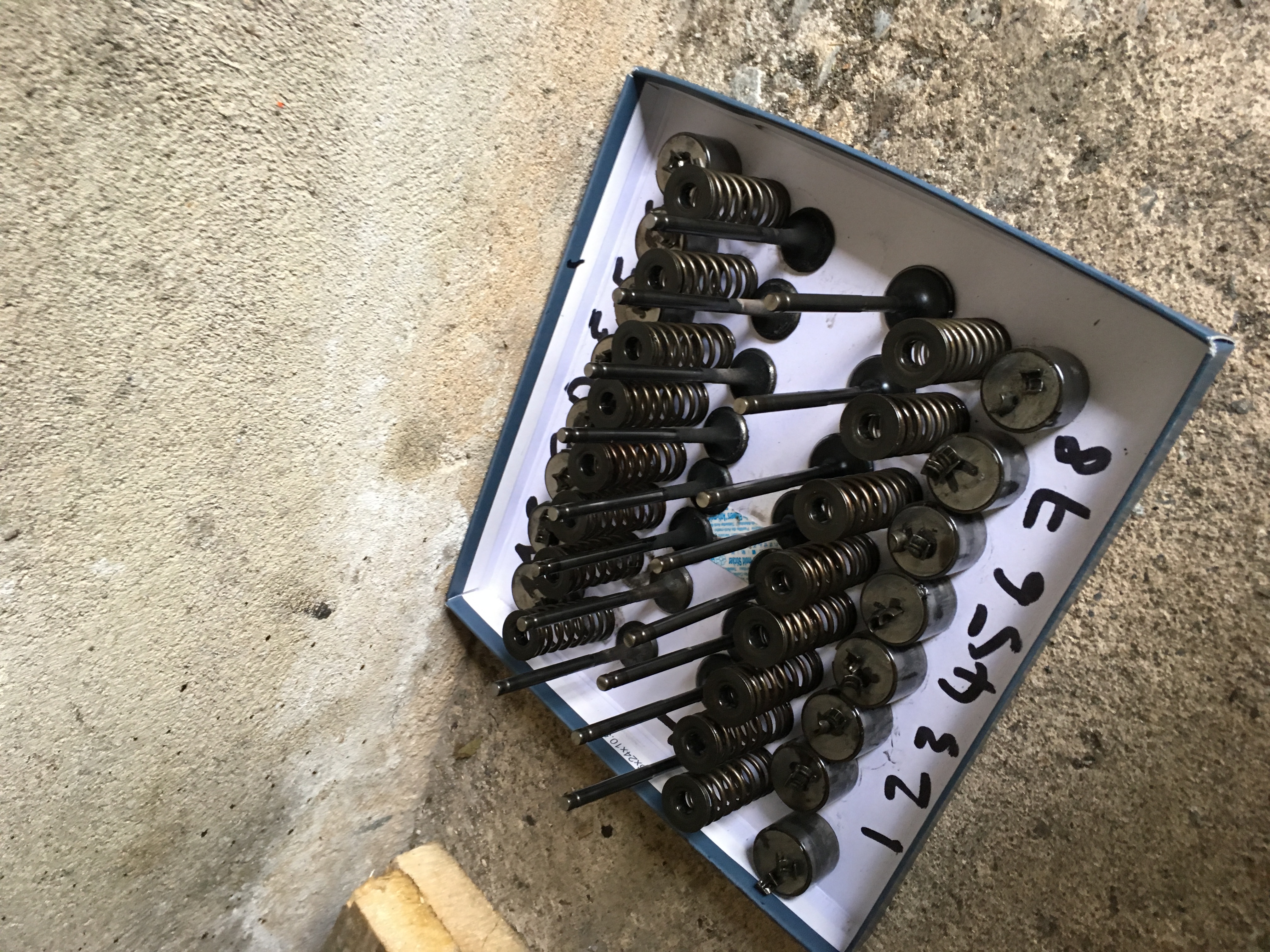

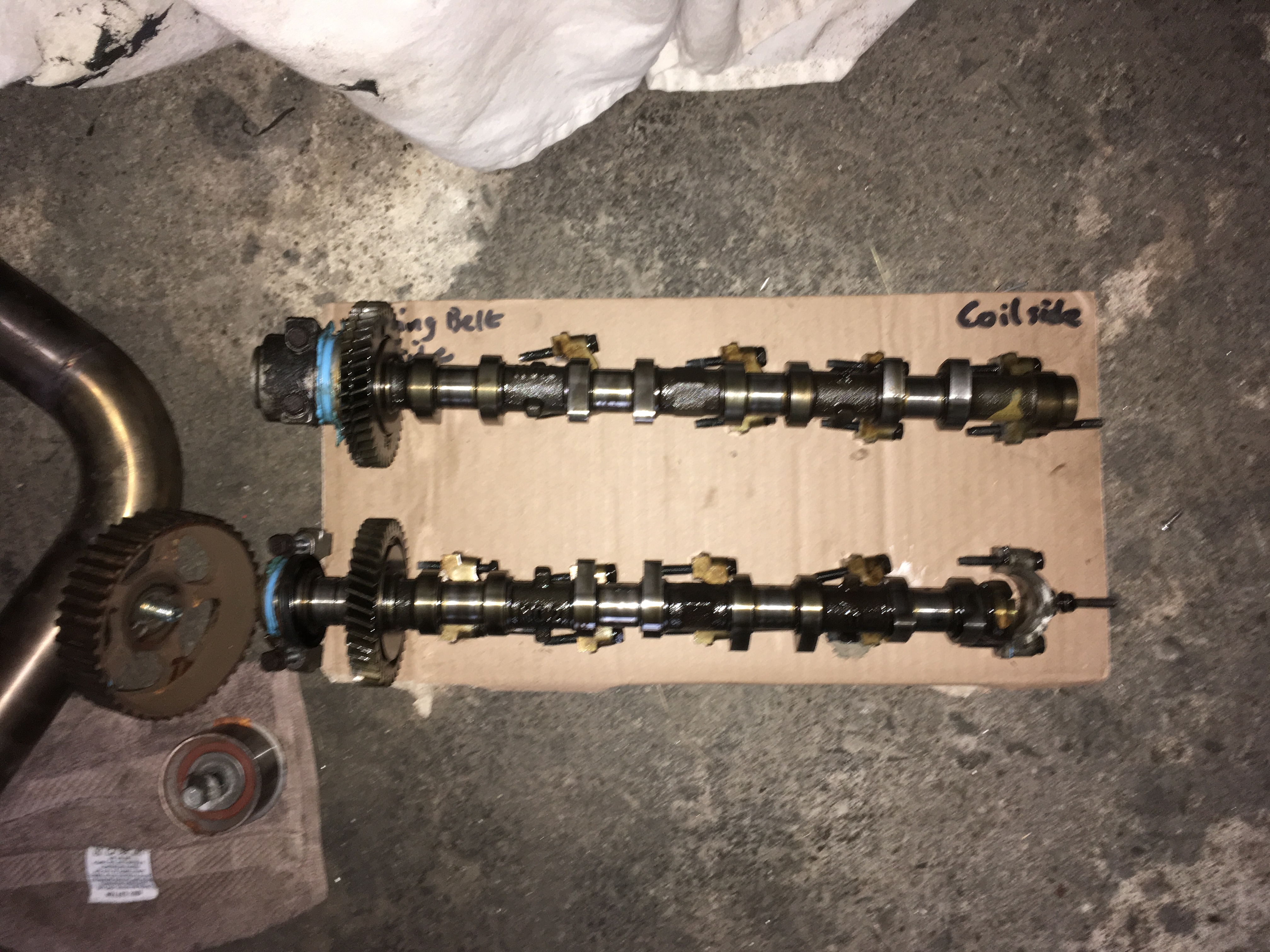

Ryan.Truesdale Posted April 17, 2018 Author Posted April 17, 2018 (edited) I had to do something about the amount of oil being burnt as it got to the point that if I drove it too college and home (45 mile round trip) there would be no oil on the dipstick. The smoke out of it was embarrassing! I had already got a full gasket kit as I had planned on rebuilding the old engine. In it there was valve stem seals so I decided I would do them in the head of the blown up engine and then swap the heads over at the weekend. Edited April 17, 2018 by Ryan.Truesdale Quote

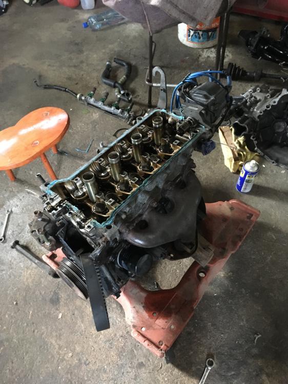

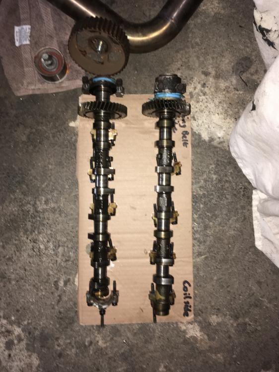

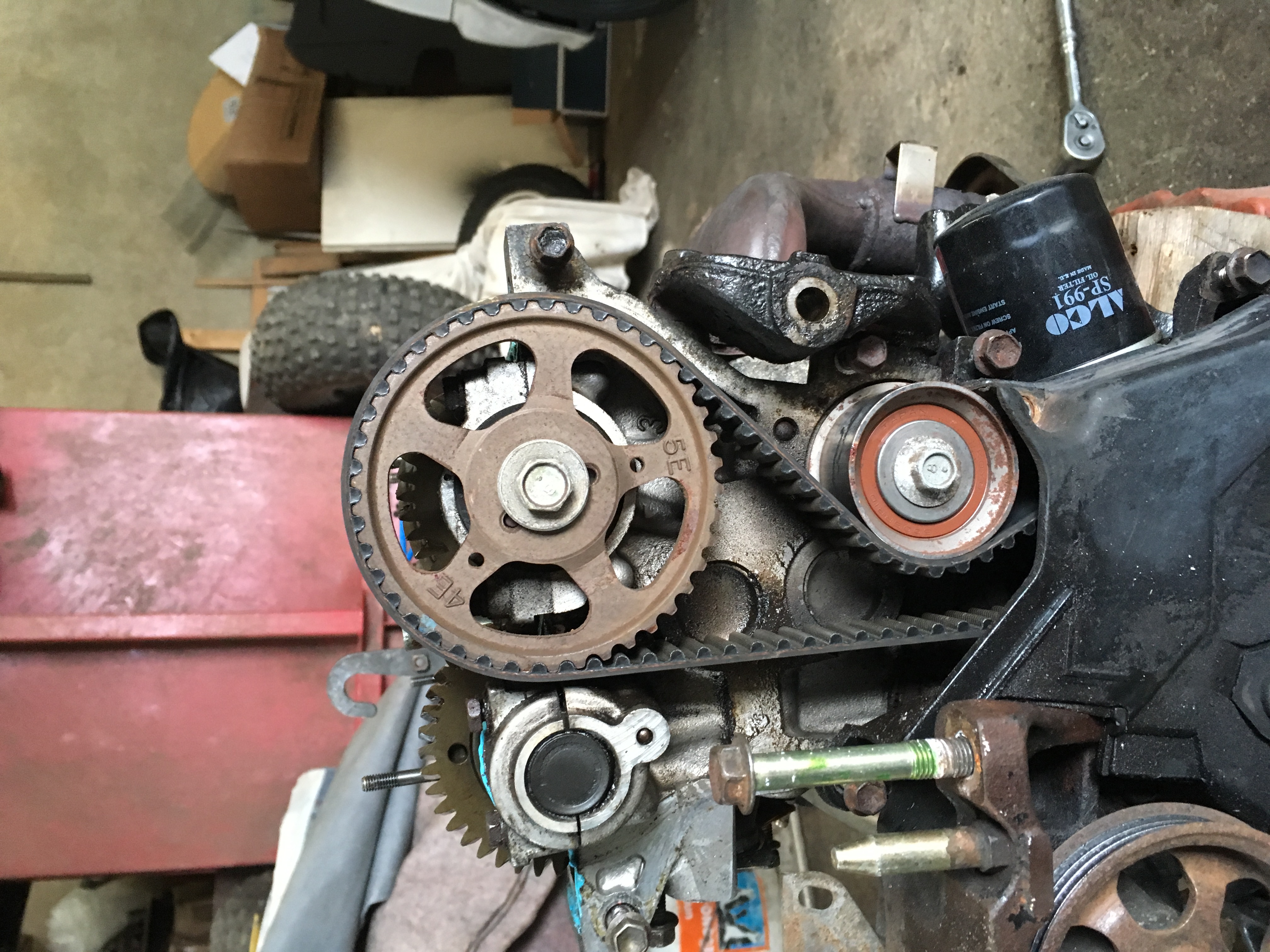

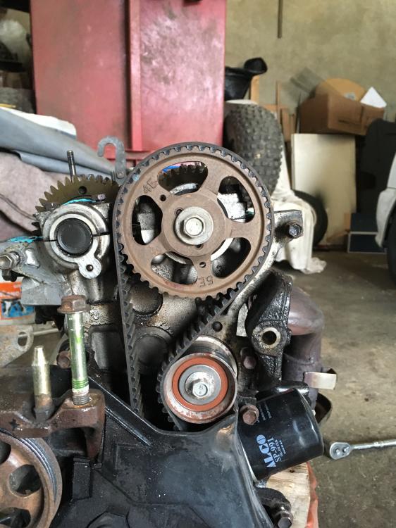

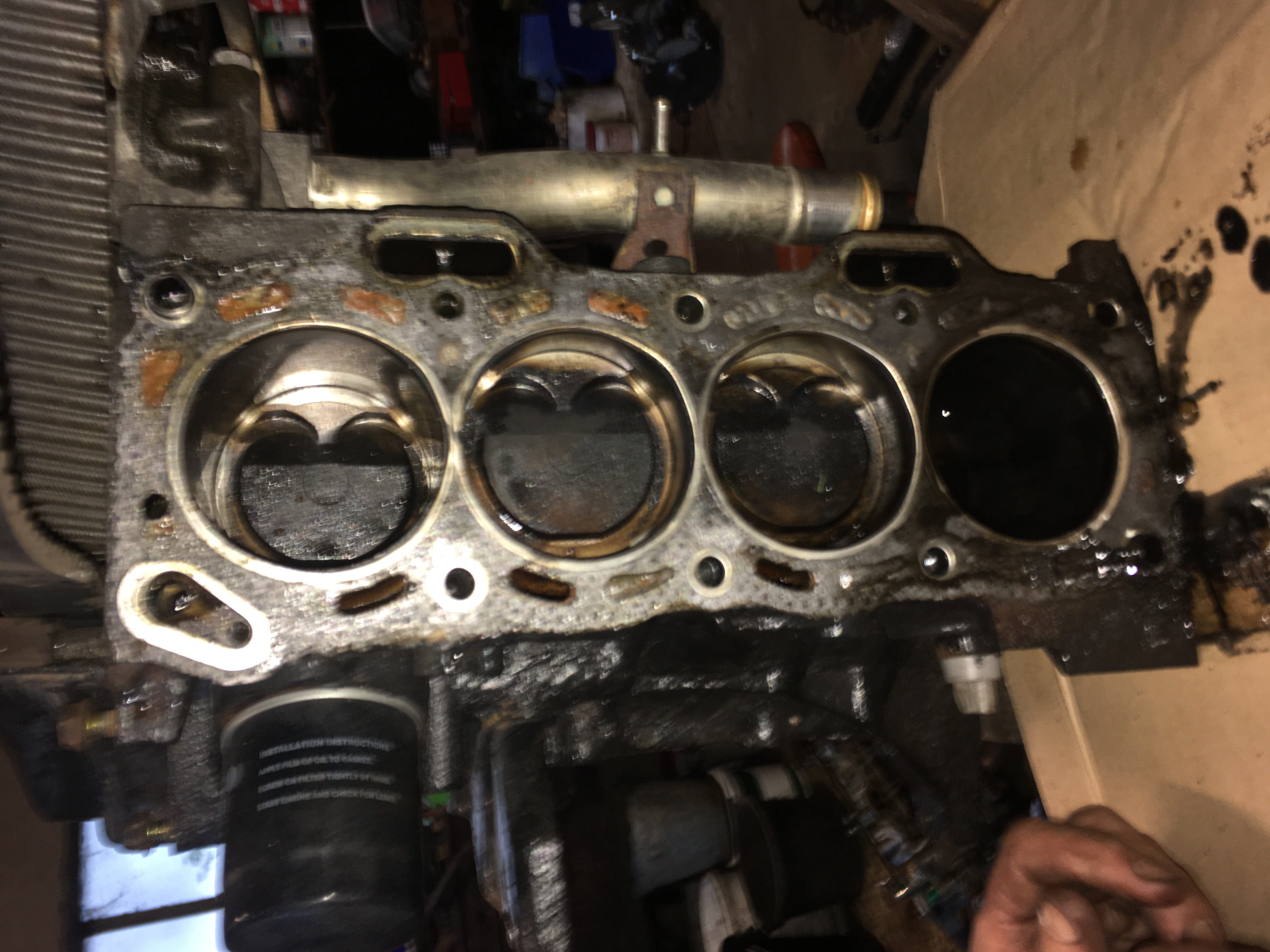

Ryan.Truesdale Posted April 17, 2018 Author Posted April 17, 2018 Halloween holidays 2017 I pulled the engine too bits again head off, sump off, bearing caps off and pistons out. I was getting good at this! I could now have the head off within an hour.  My problem was piston rings and a lack of oil return ports in the pistons. from memory there was either two or 3 broken rings and all the ports in the pistons had been clogged up with old lumpy, shitty oil. So I ordered new rings and a set of bearings, I gave the block a quick hone up and down twice on each cylinder just to take the shine off. Between myself and my dad we had it rebuilt within a week 2 nights of striping it, ordered the parts and then a day of building. Managed to get the timing slightly wrong when rebuilding it. Which resulted in it just piping and banging like a wrc car and not really going anywhere. However we got it fixed quite quickly and things seemed to be going well, only time would tell. Quote
