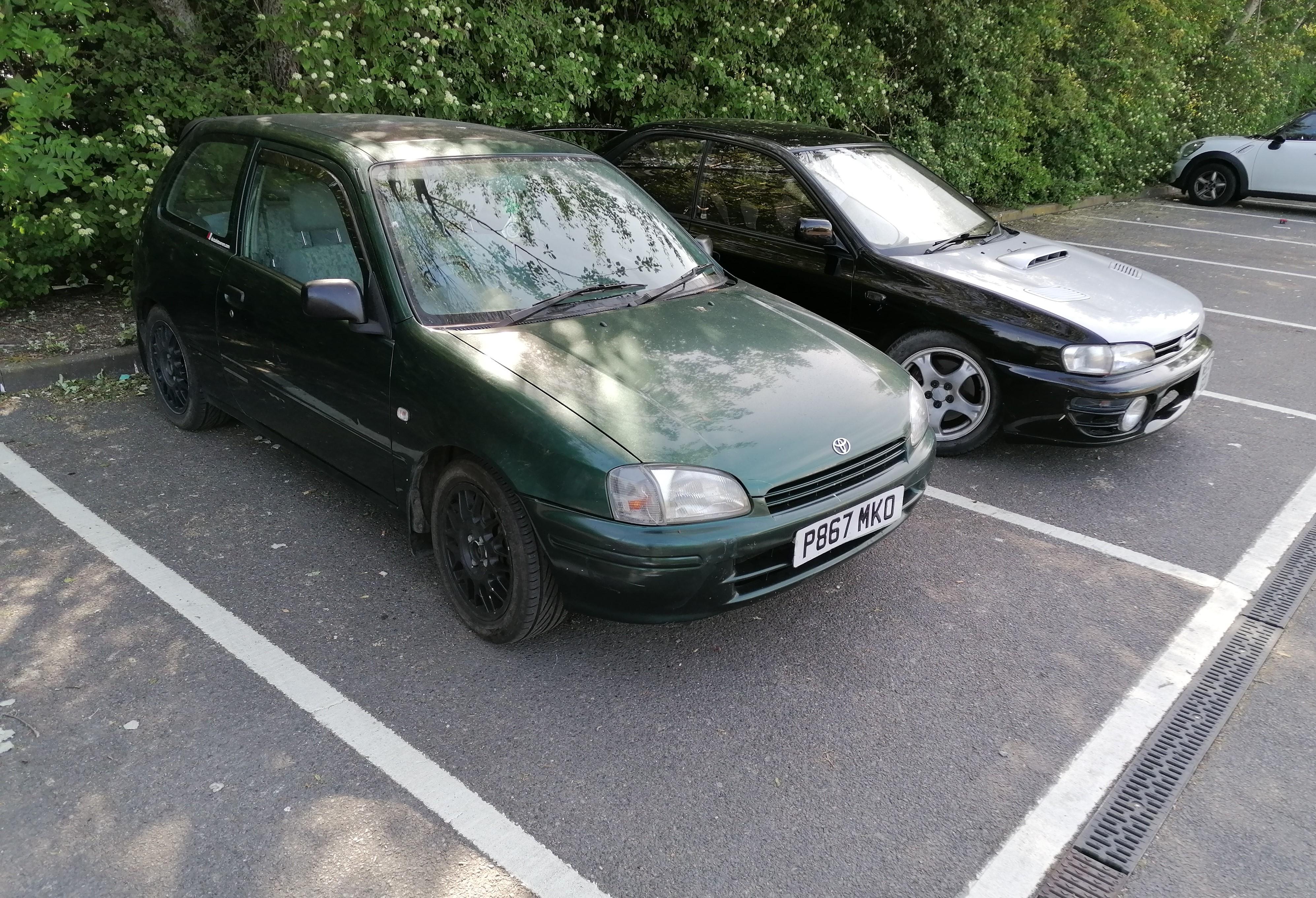

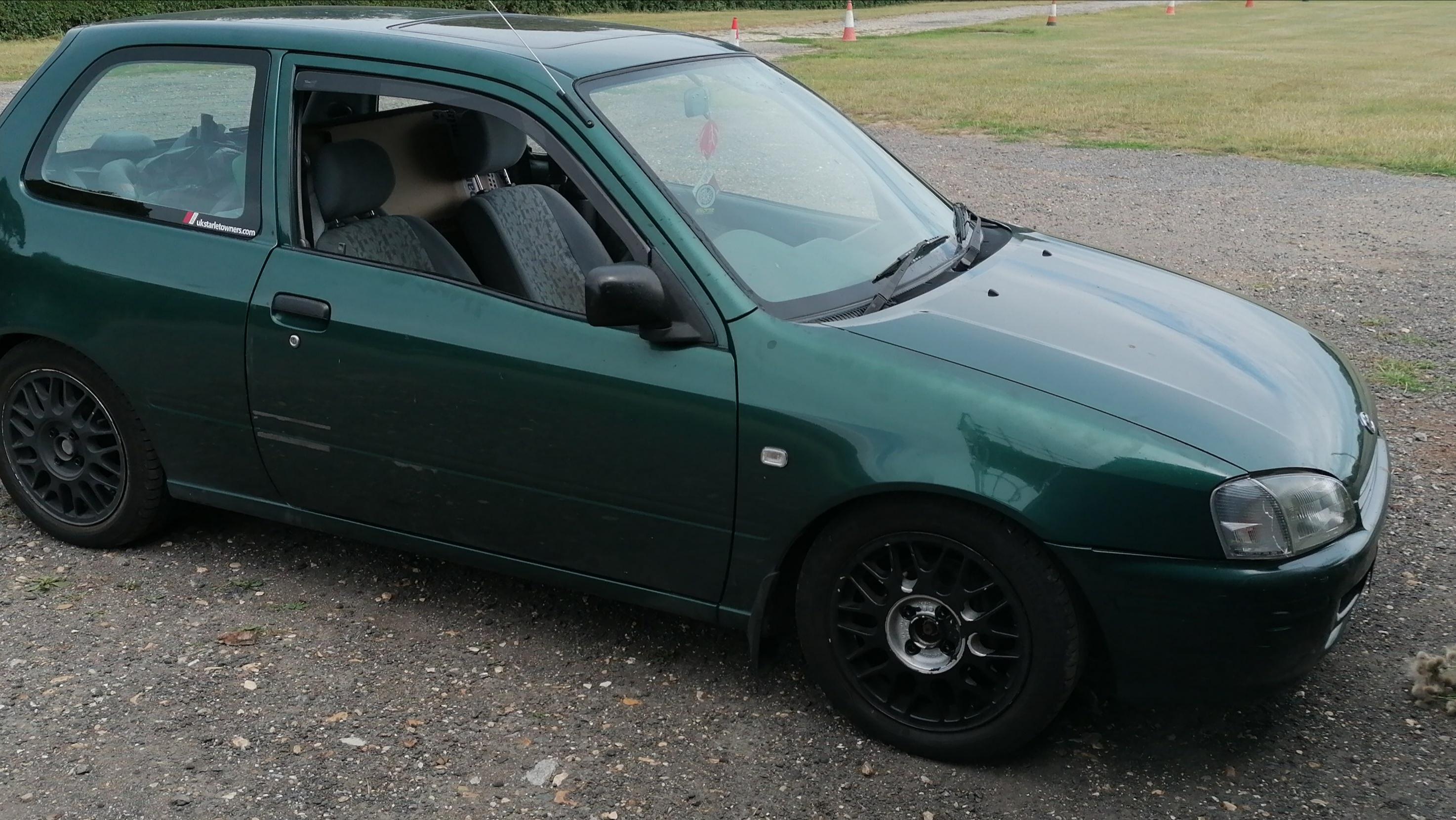

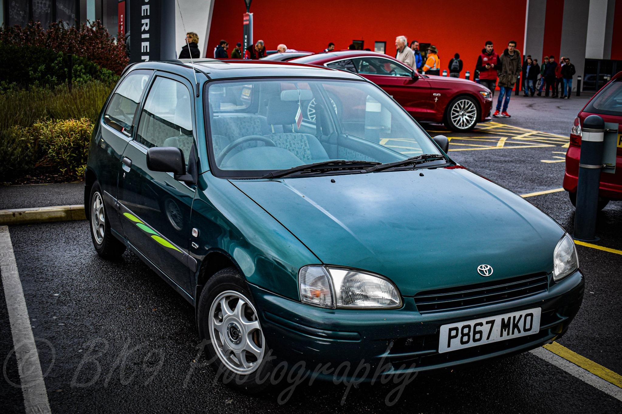

I bought a new starlet in september 2019 only a few months after I passed my test as my last one being killed by a bmw who was driven by an idiot who pulled out of a bay incorrectly without looking and caught me with as they came out.
The starlet I found was a perfect example basically with only little scrapes and paint work being the only issues. It was on 40K miles and it didnt even ever have an advisory on the MOT minus a issue with the license plate.
I also decided that this starlet was going to be the one that actually gets modified. This was mainly due to a good mate of mine named chops on here convincing me to and selling me most of the parts.

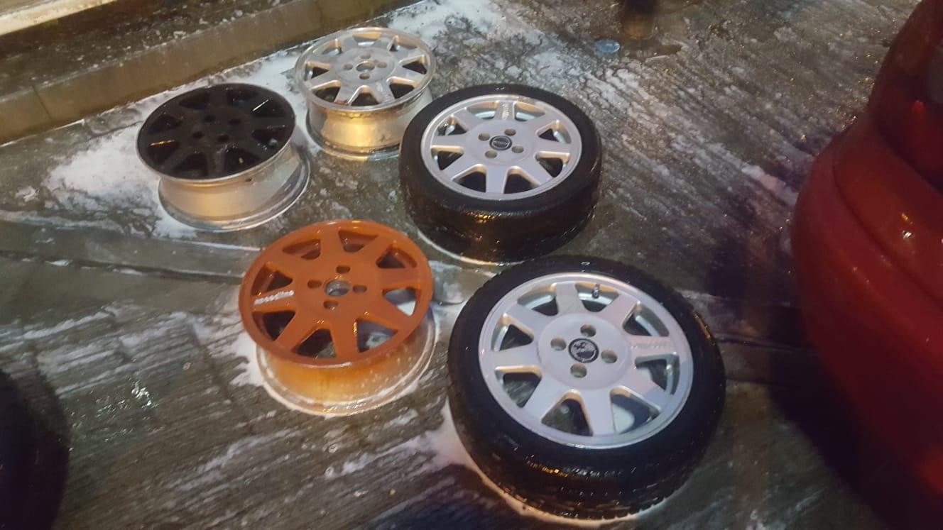

So far I have done corolla inlet manifold, clear indicators, Mazdaspeed ms03 wheels (I bought some sr speedlines and repainted them in an anthracite colour but I prefered the ms03), air filter,  a short shifters I've got the hypersport one at the box and a timing advance.
New Corolla mani
Mazda speed MS03 3 spoke wheels

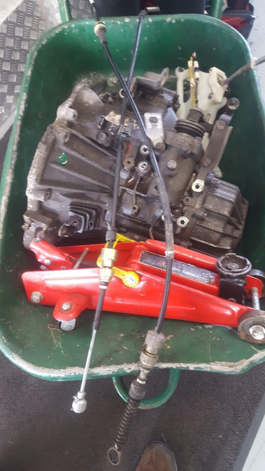

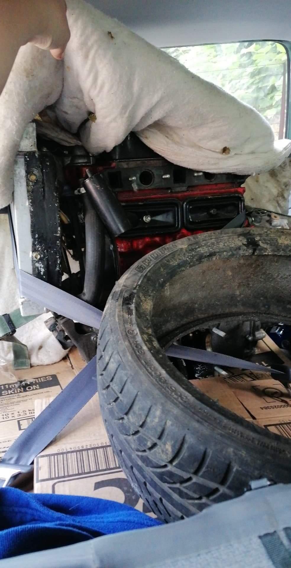

The things that ive got but not put on the car is a corolla g6r 6 speed gearbox, Glanza spoiler, upgraded anti roll bar, 4-2-1 exhaust manifold and an anti lift kit.
G6R C160 gearbox with the 4afe bellhousing and all the cables and linkages for the conversion

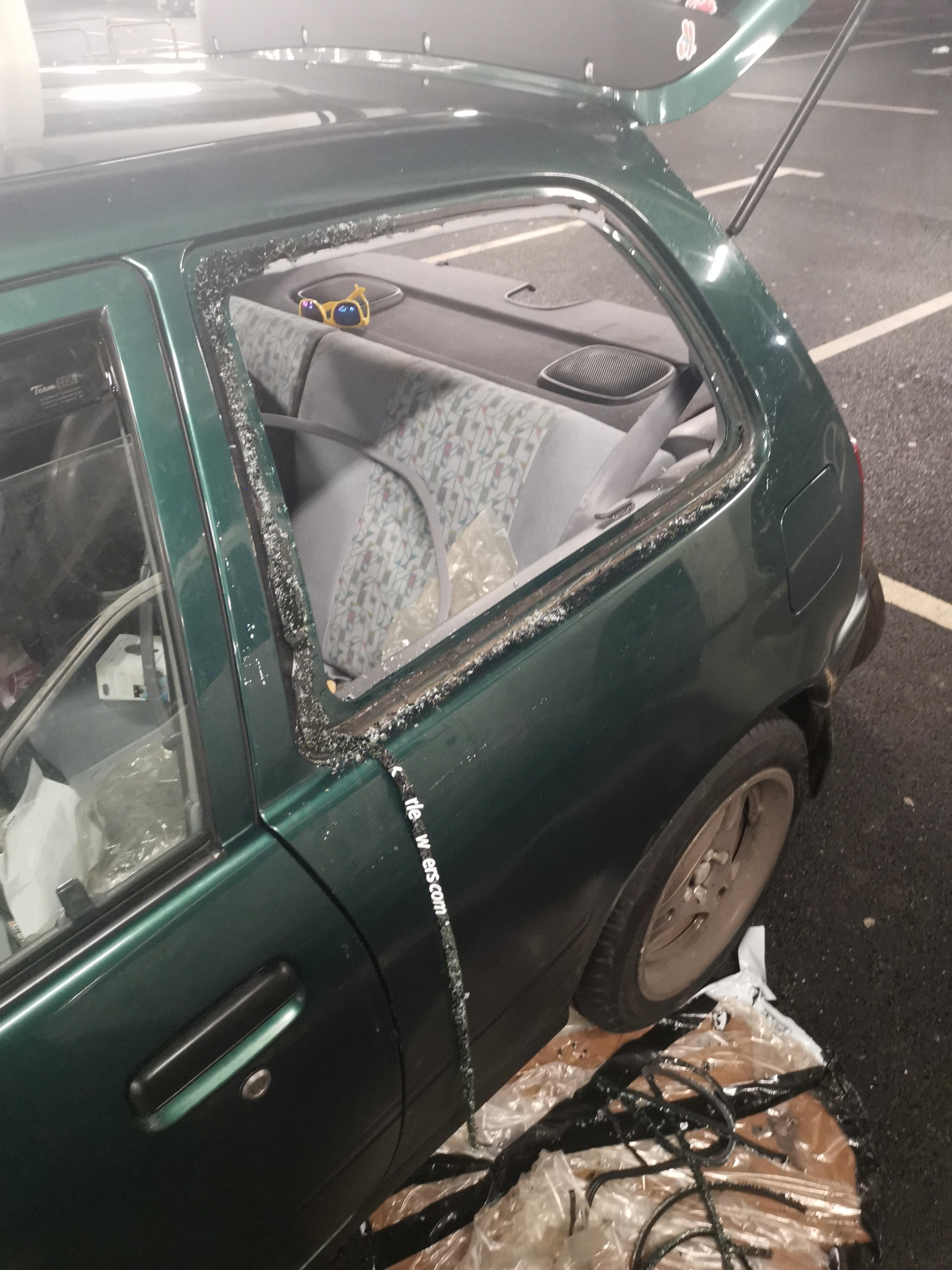

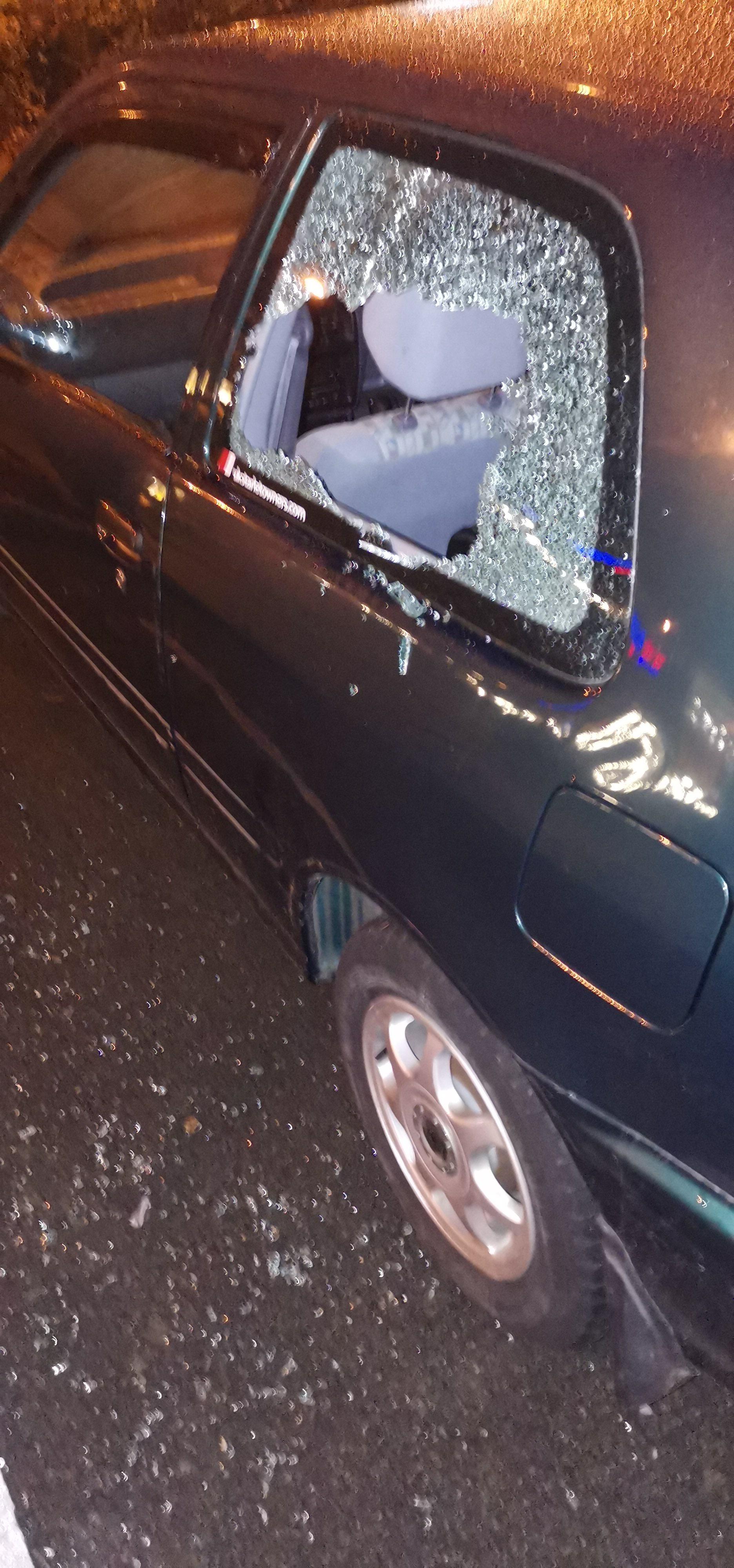

On christmas eve my window was smashed so I also gained a wooden window

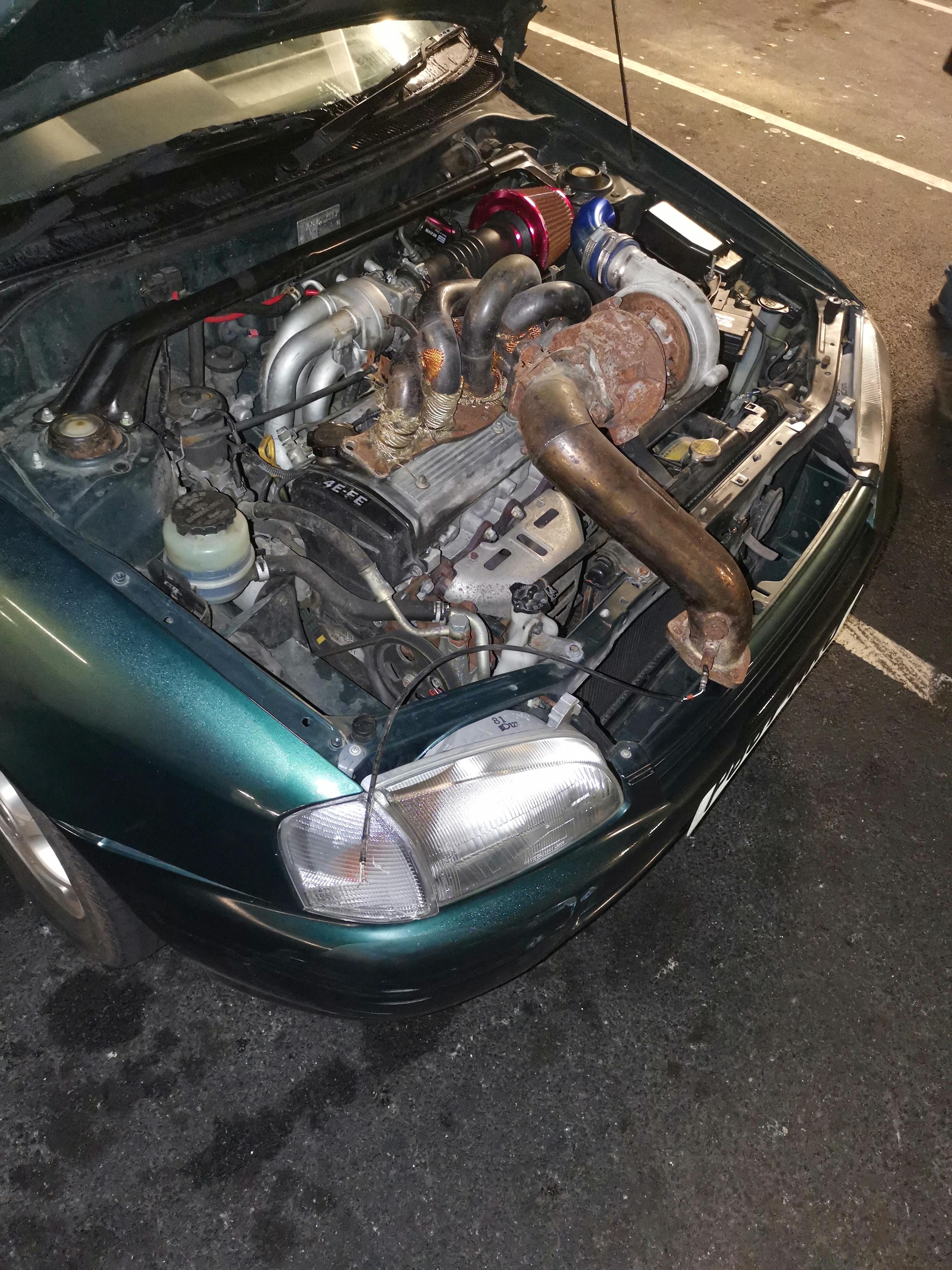

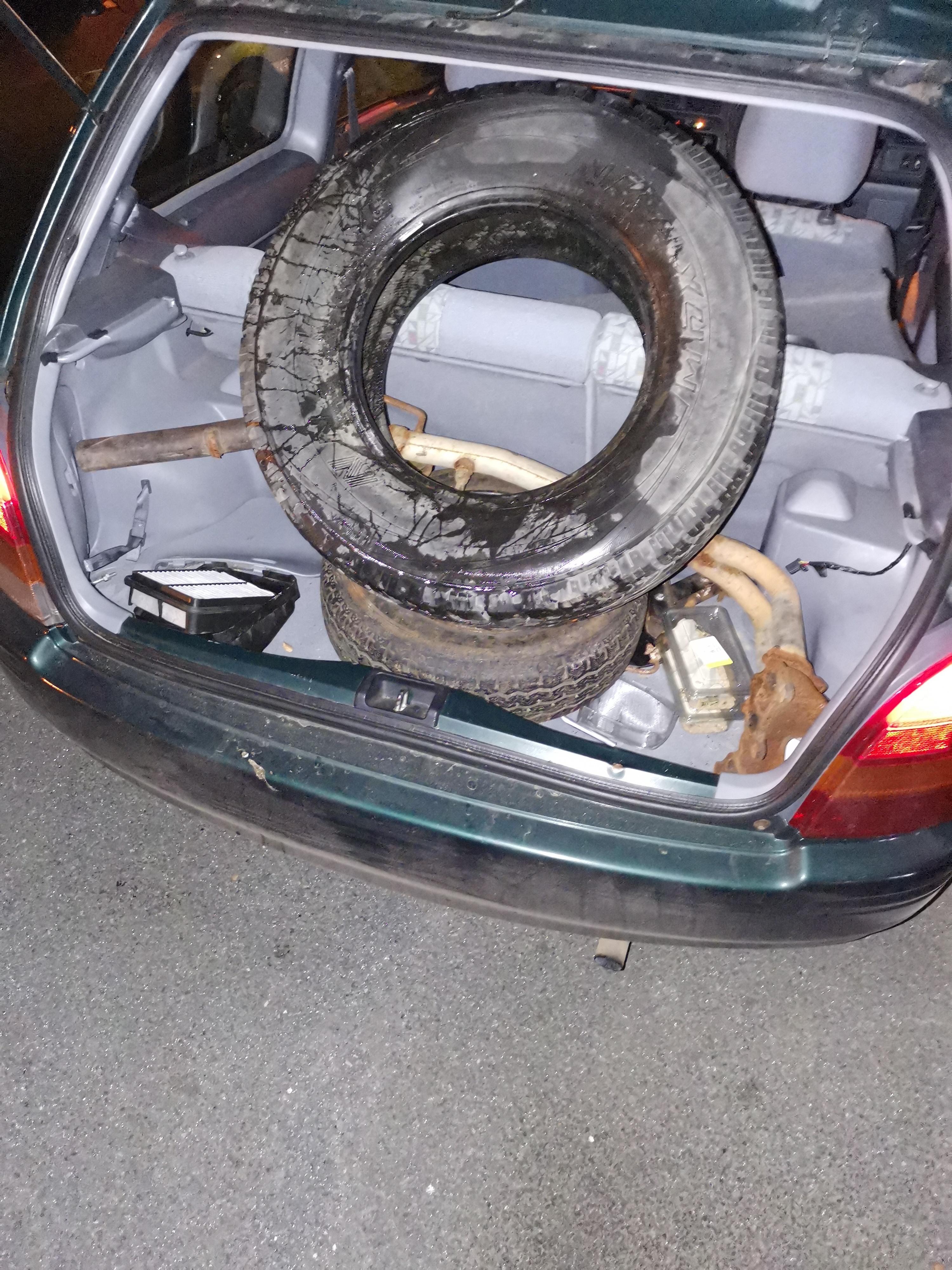

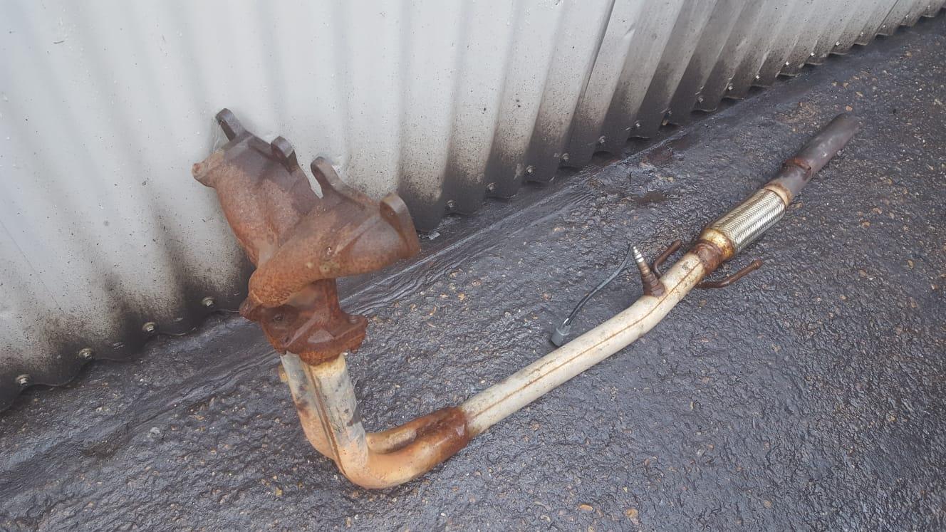

4-2-1 which i believe was from a corolla or it could be custom but was bought from a mate who said its corolla.

Waw wat exhaust manifold and down pipe is that off.

The exhaust mani is a 4-2-1 corolla mani its a rarer part than the inlets as people didnt think to take them off before they scrap them unlike the inlets which got removed

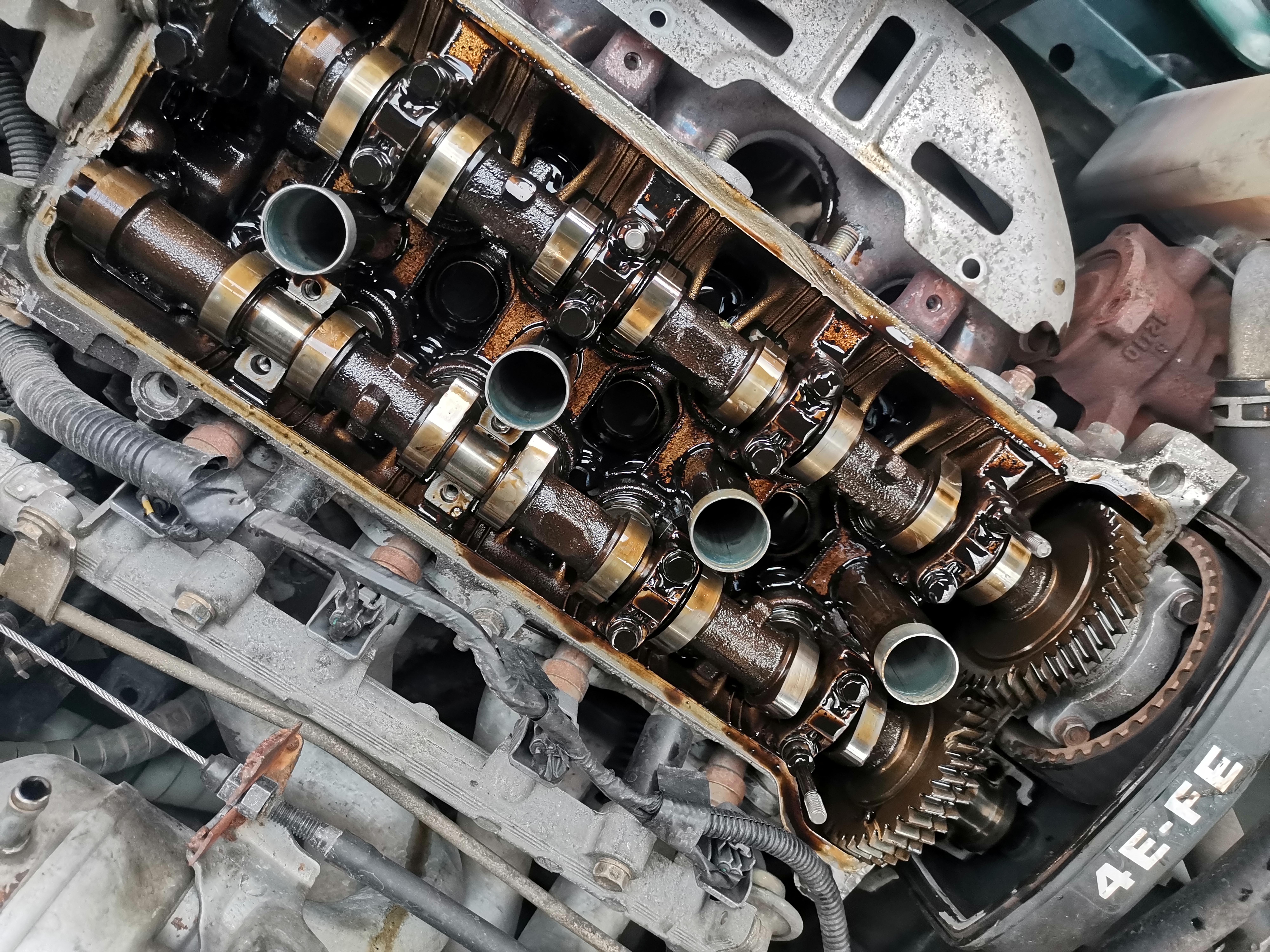

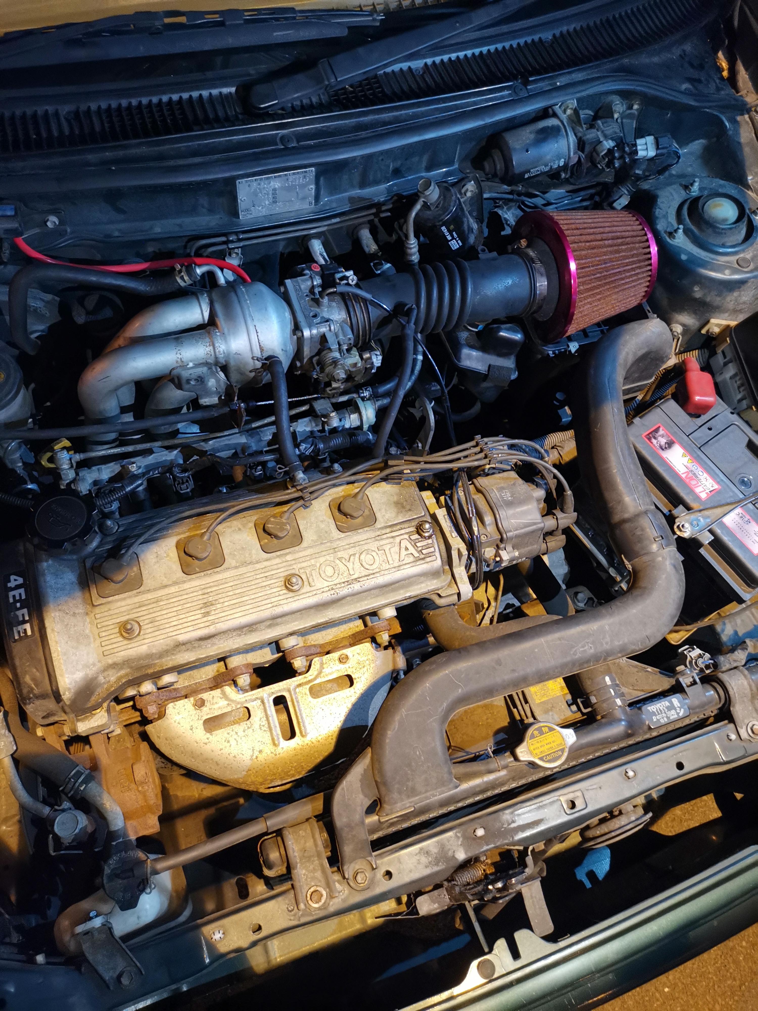

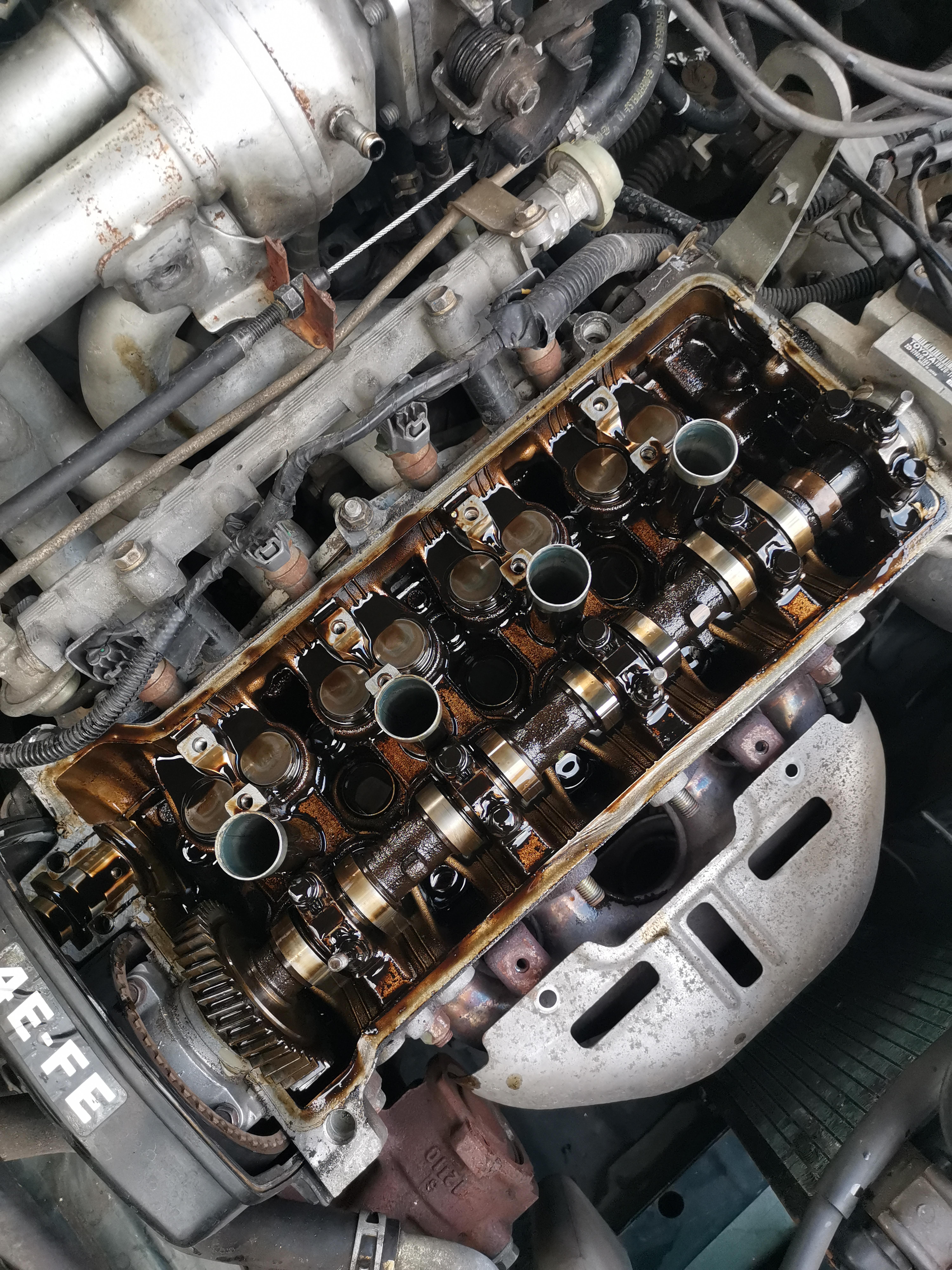

So as suggested by Sam44 I installed a turbo inlet cam. I bought this off of chops and installed it with him. Dont worry I did an oil change after this I know it looked very bad.
IMG_20200217_160318.thumb.jpg.feb1b02b193d03e490781884cd4749f1.jpg  IMG_20200217_155952.thumb.jpg.1ce424b391e5d1392901d5b5bc56db75.jpg
I then attempted to fit my 4-2-1 manifold and it didnt go well as the pipes didnt line up and i only had a coupler no flexy pipes so for a week I had no exhaust on my car and it sounded like this. Also I can see that some point around here was when i cleaned up all the gunk from my rub strips and made it look a little nicer.

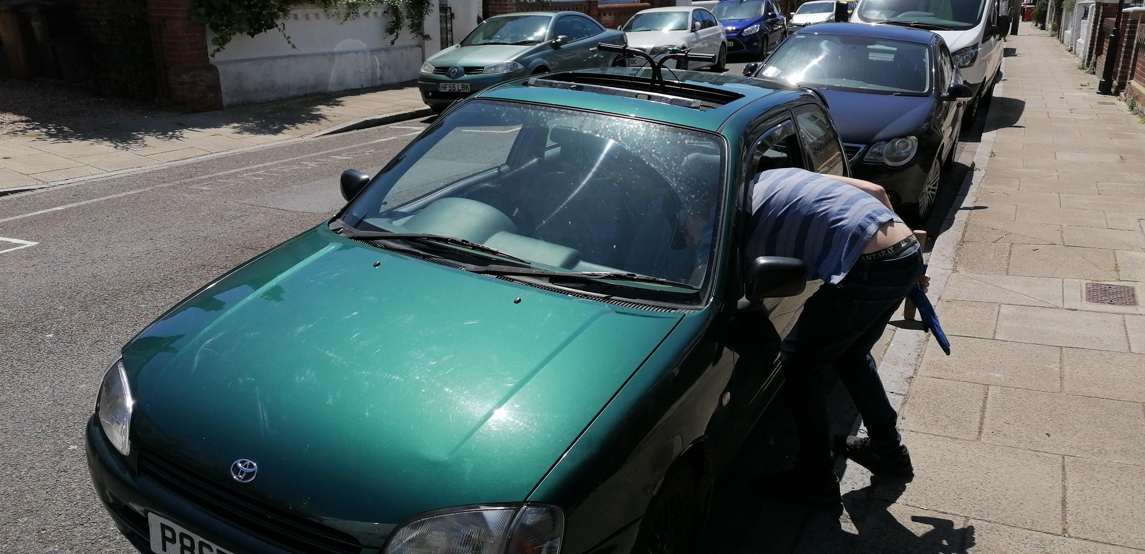

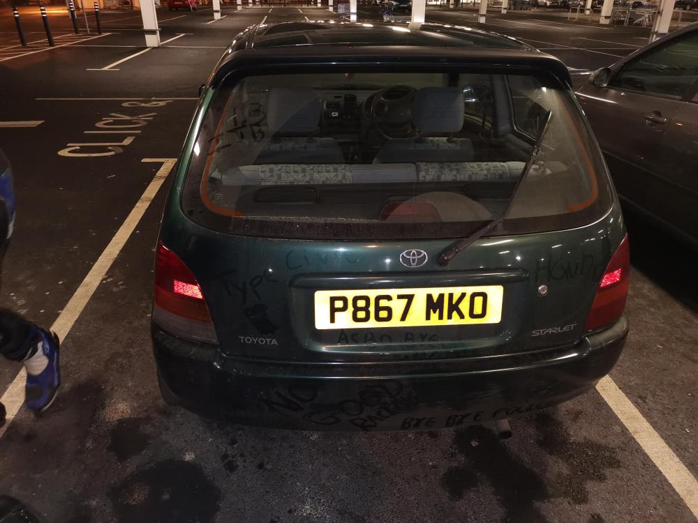

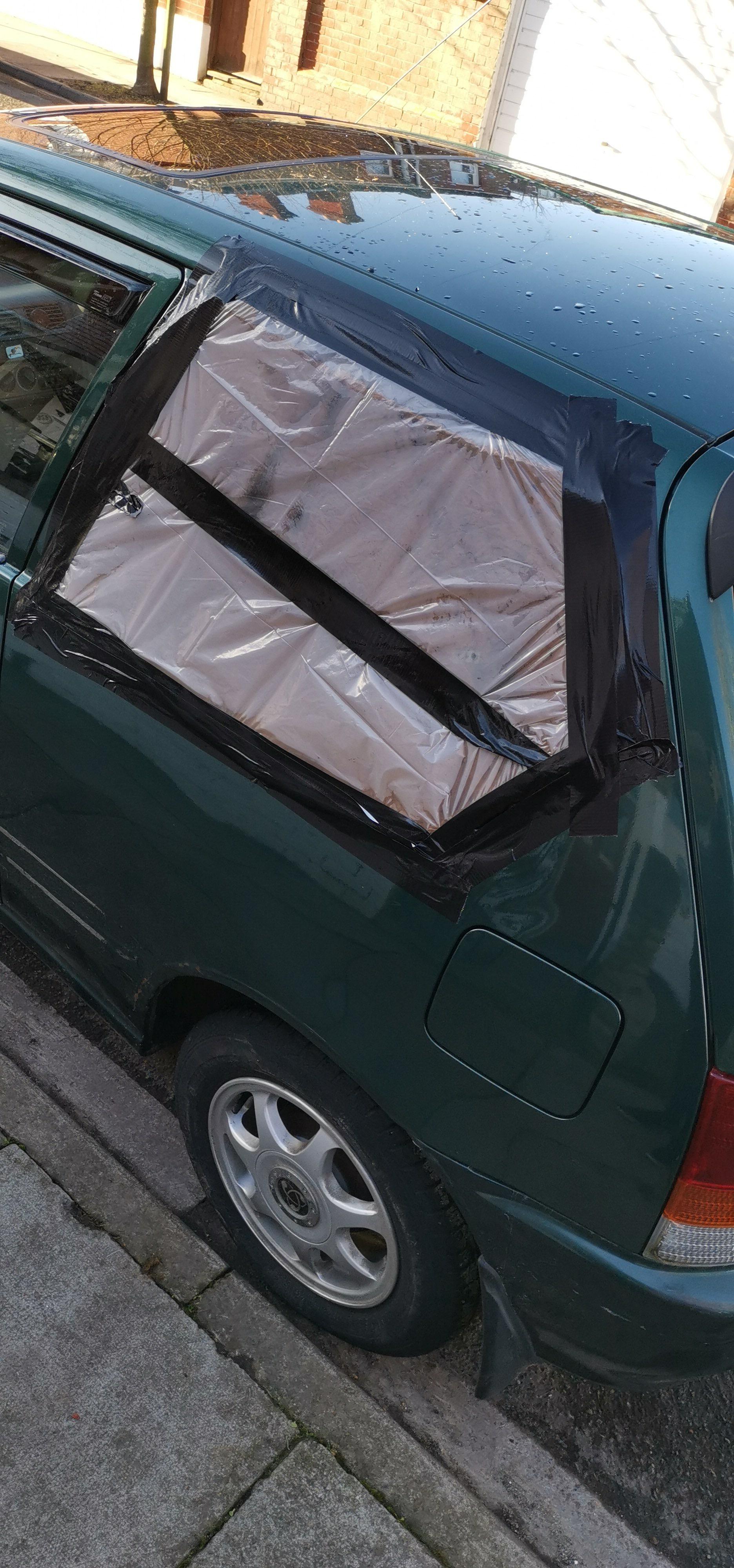

We then fixed my rear window in tesco car park with 3 small tubes of sealant that turned out to not be enough so my window now leaks a little whenever I pressure wash my car but it doesnt in the rain so thats fine.

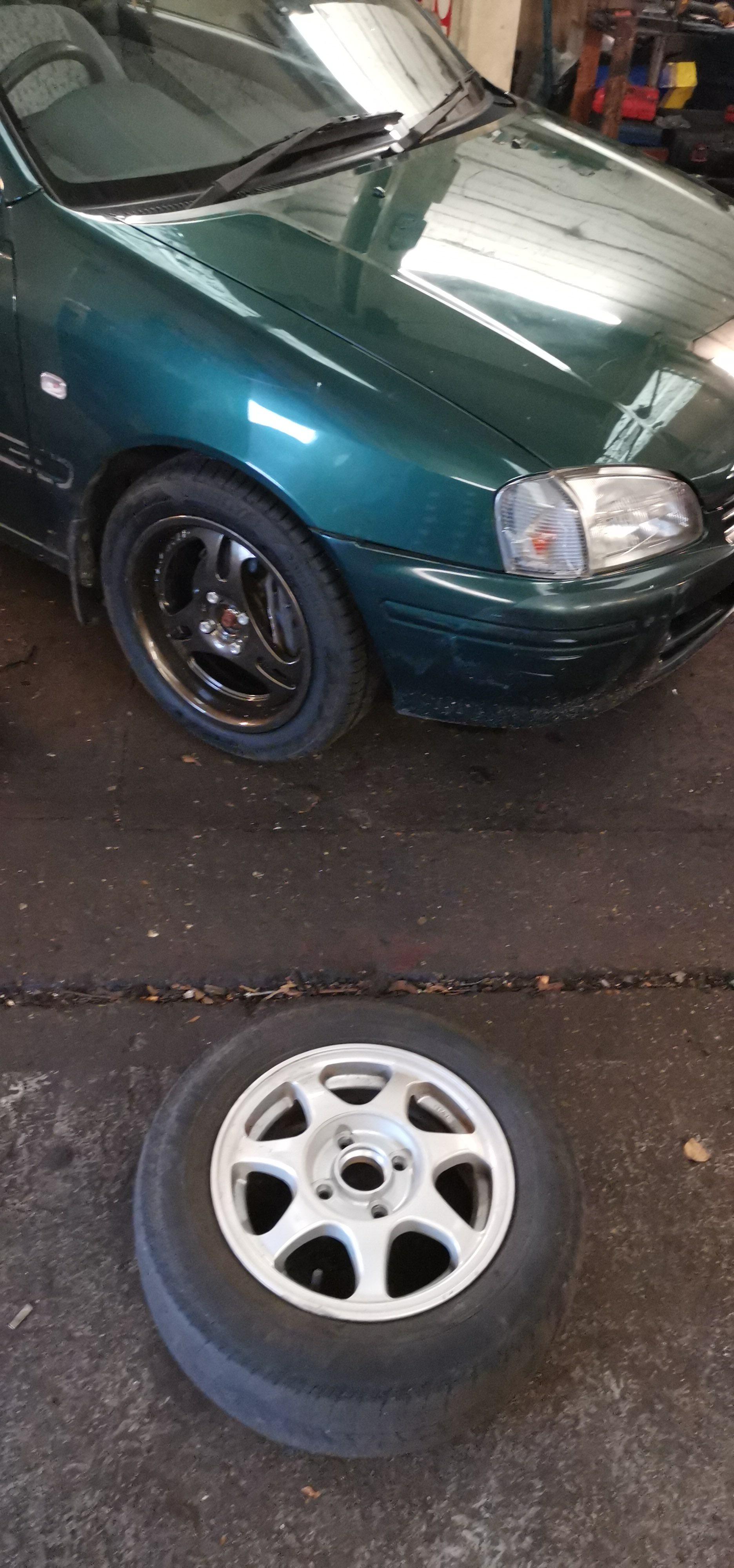

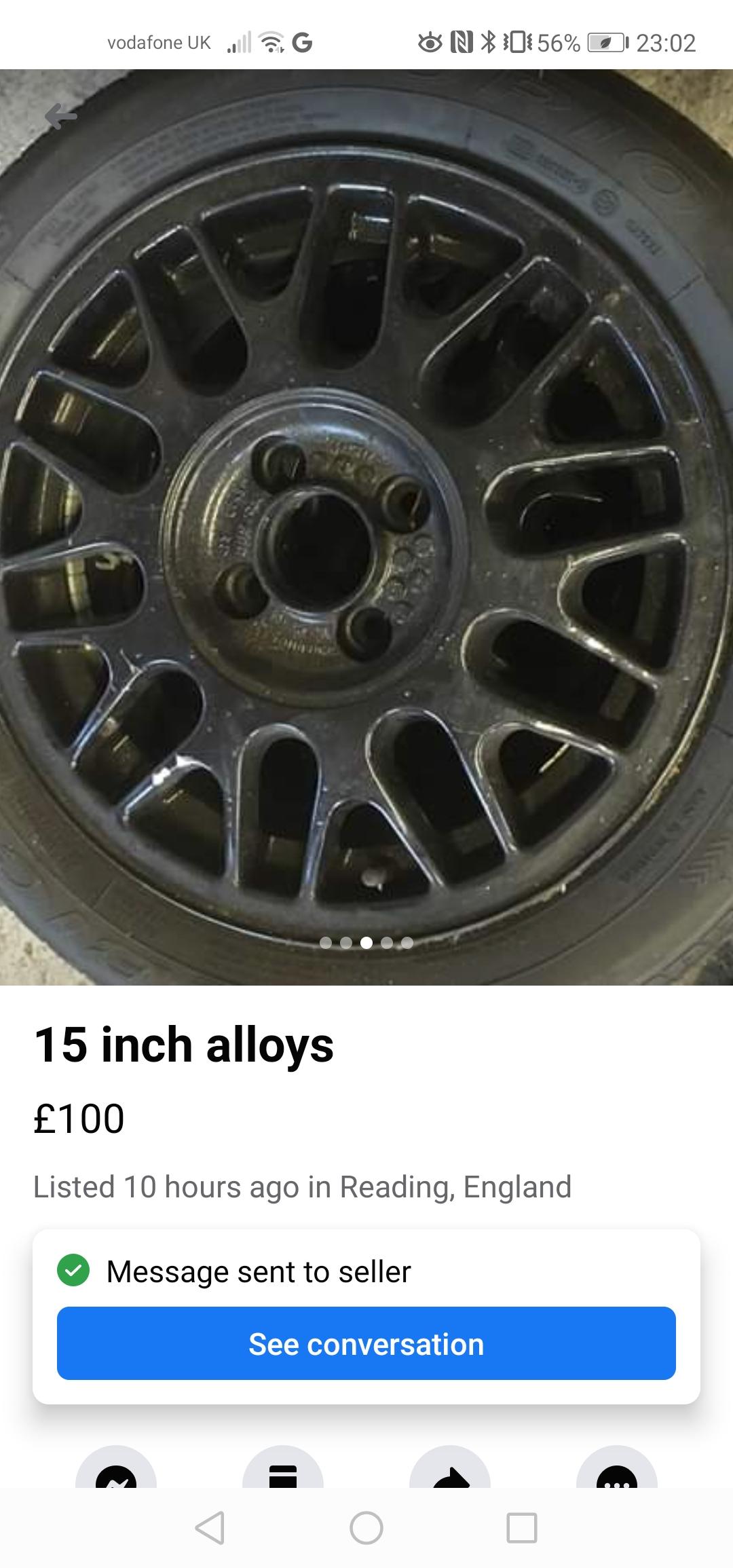

After this we then fit new wheels to the car as it turned out that 2 of the MS03 mazda speed wheels were slightly buckled (that's why in the video you can see im still running two stock wheels) so they were sold to a mate who skids on them now and i bought these BBS wheels. I only bought these wheels as they were cheap and the correct size for the car. To be completely honest I have never really liked them and the previous owner had sprayed them really badly so they are pealing now and I want new wheels but I dont know what ones to run.

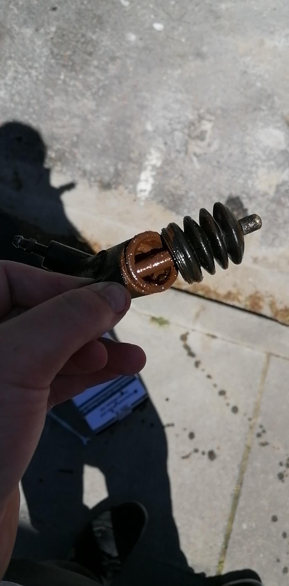

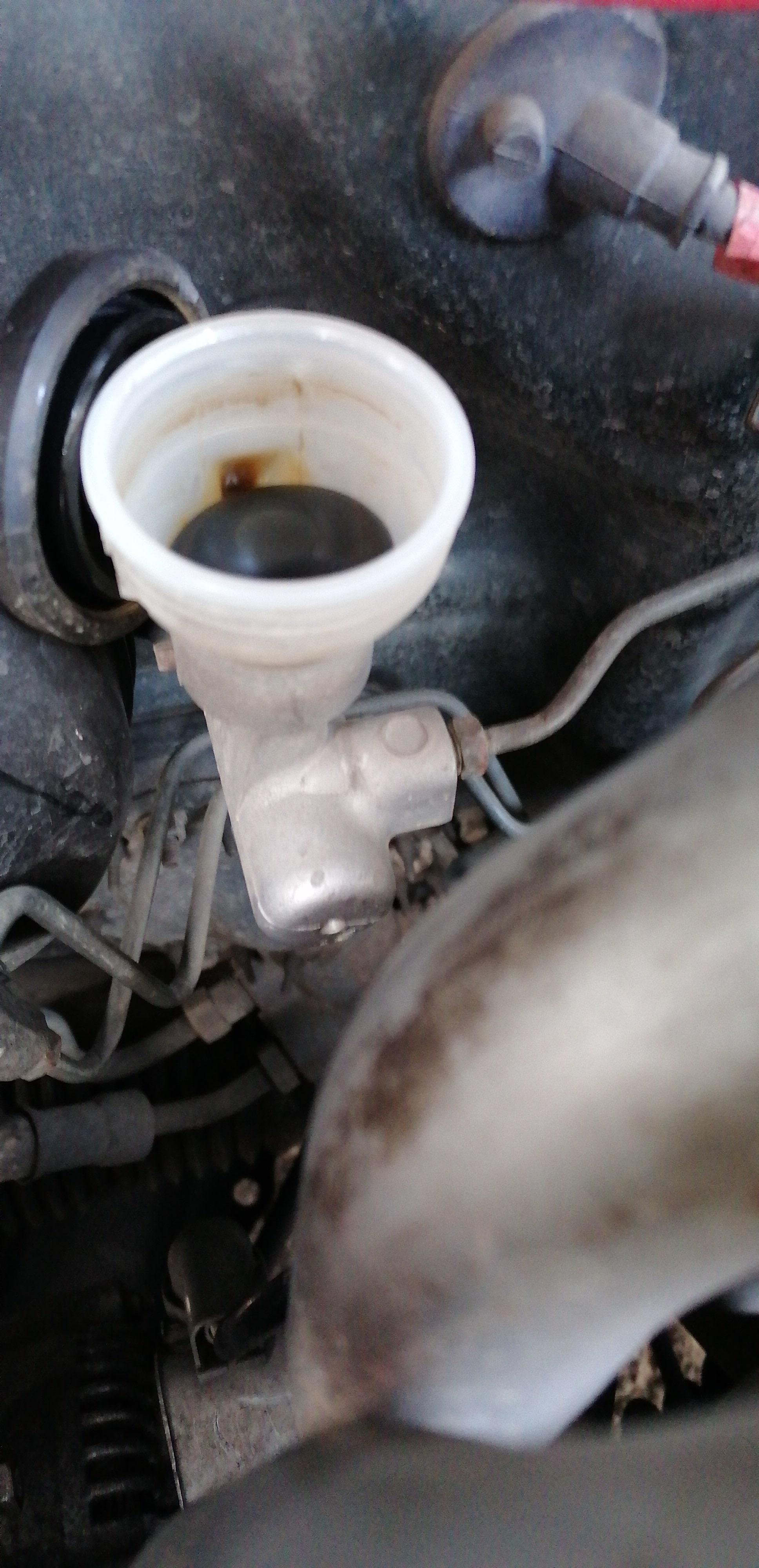

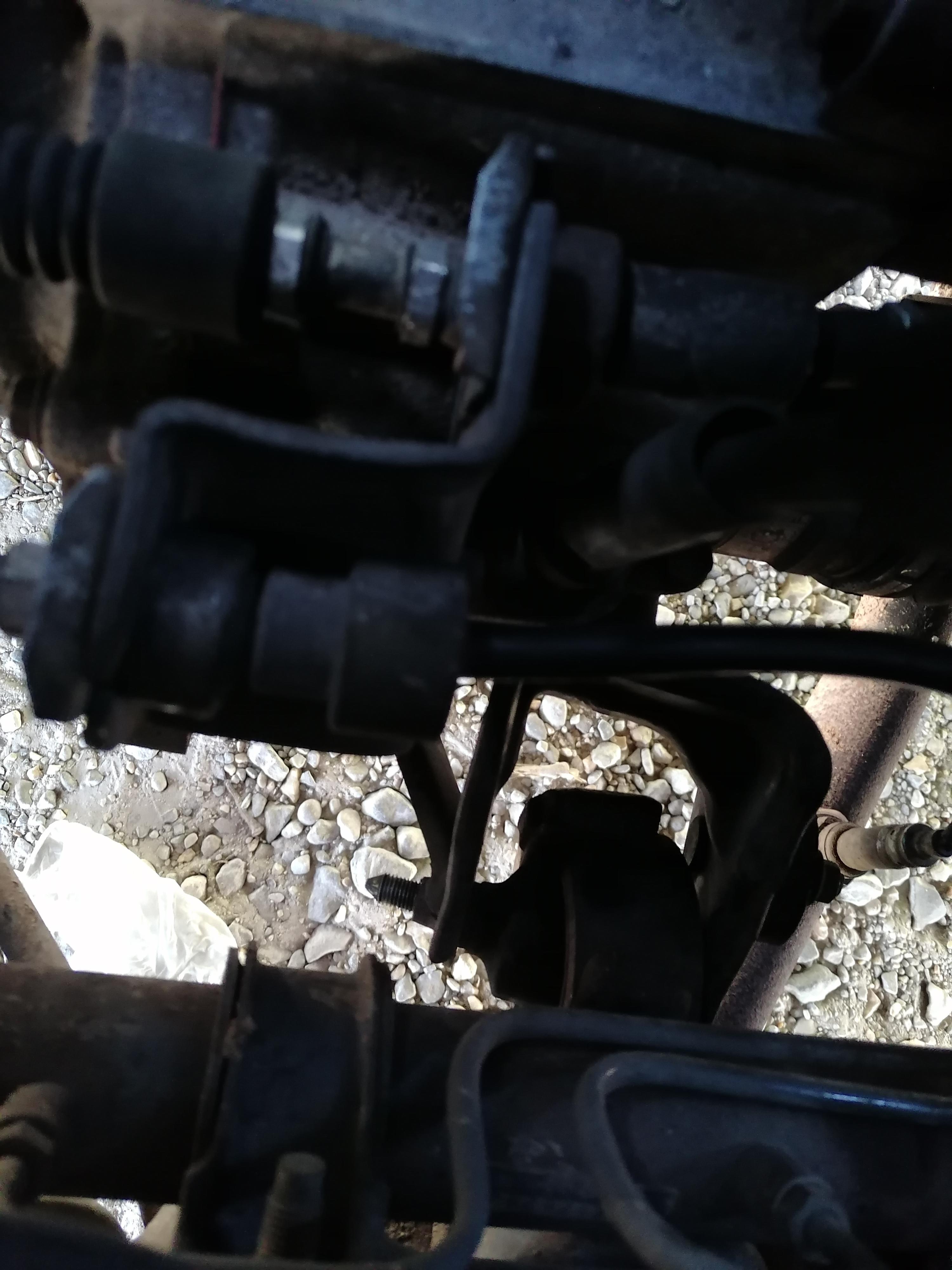

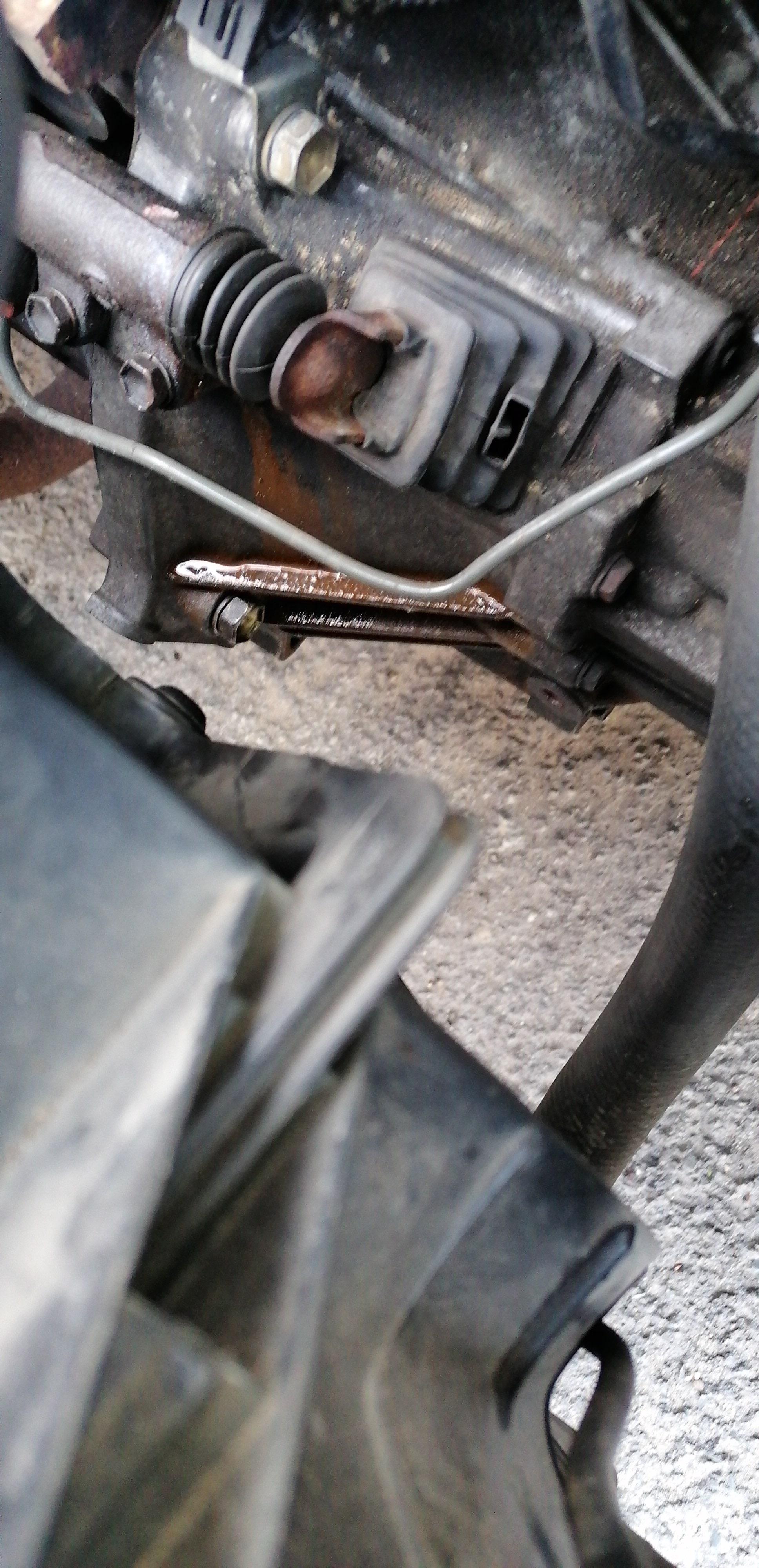

After I installed that my slave went so I then installed a new slave and you can see what the old one looked like.
IMG-20200505-WA0012.thumb.jpeg.1f22c440c1273e9c280056be1504e3b8.jpegIMG-20200505-WA0010.thumb.jpeg.d8709a56f583e0243d137f39a36eb4d5.jpegSnapchat-741376991.thumb.jpg.19c989b05ac6231d9285bd4ccb14c243.jpg

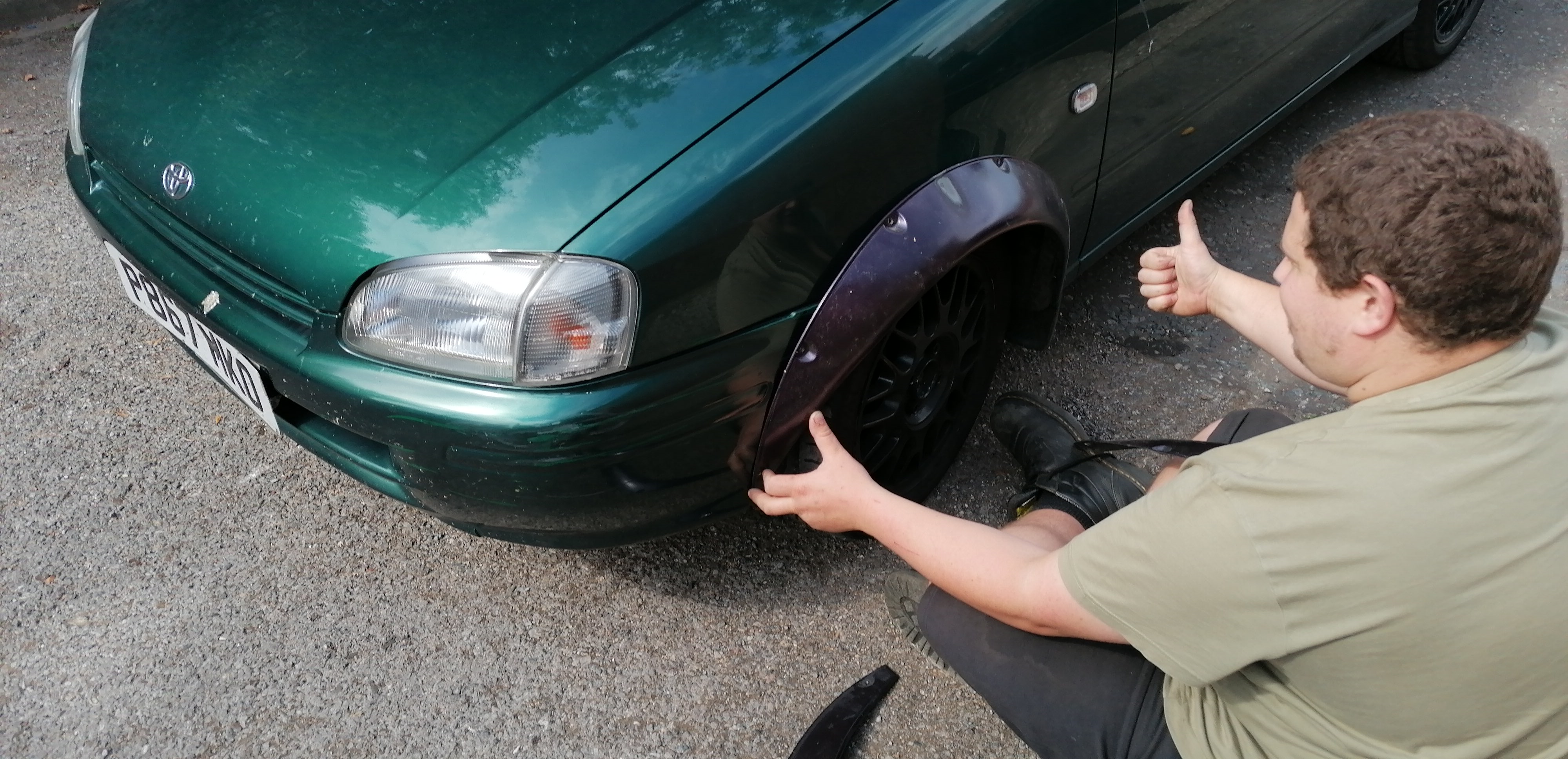

This next mod was one i did as I needed to repair something. So it turned out that when we installed my new gearbox we hadnt torqued up the bolts on the back of the box this caused the engine mount rubber to go so i then bought all new powerflex poly yellow engine mounts for a better responce but not to have it so hard its not dailyable still
I then installed a set of meisterR coilovers which dropped the car a decent amount. In this photo you can see where I ran out of toffee wheel so i couldnt get all the rub strip tape off and you can also see the wheel paint peal.

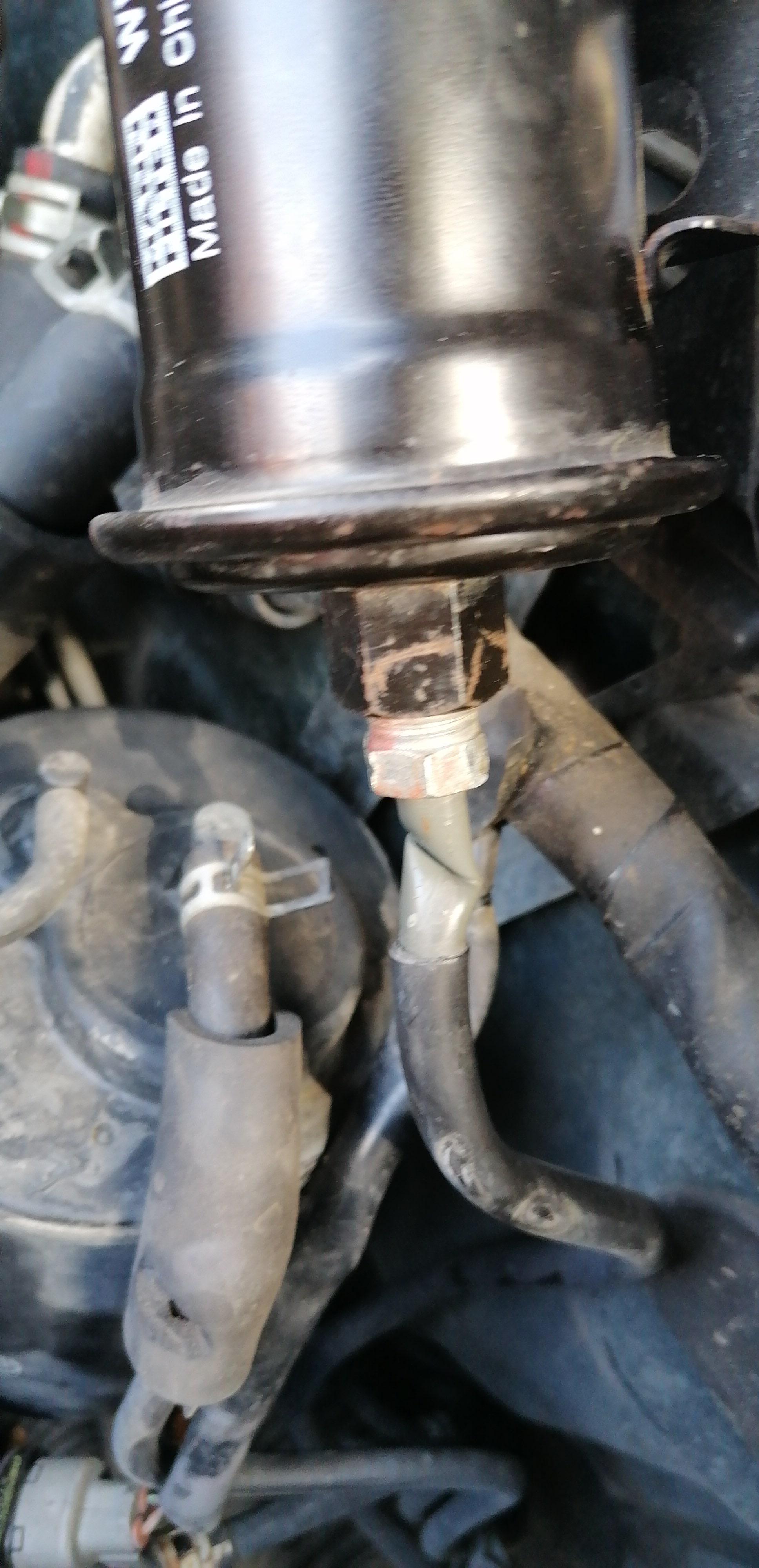

The most recent "mod" I did was an accidental fuel filter delete. I was changing my fuel filter out and i accidentally kinked the pipe that goes out the bottom of the filter and we tried flaring the pipe but due to the amount of pressure on the connection as it had been shortened it just kept leaking so for now I have a flexy pipe instead of a fuel filter as I had to get home and it was the only way we could think of

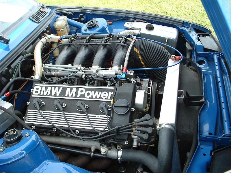

Last pic of my favourite itb intake manifold. 50mm slide throttles, carbon fibre 8 injector airbox from Tim Harvey's Labatts M3

Can confirm, gearbox was from a 4efe corolla e11, cast manifold was allegedly from a 4efe corolla e10. Cam was from a ded fte (rip). This cars a real screamer, sat next to my actual rolla g6r all day long. I wanna get some itbs on it , turbo valvesprings and maybe a massive head skim and see what these funny little undersquare 1.3s can really do.
